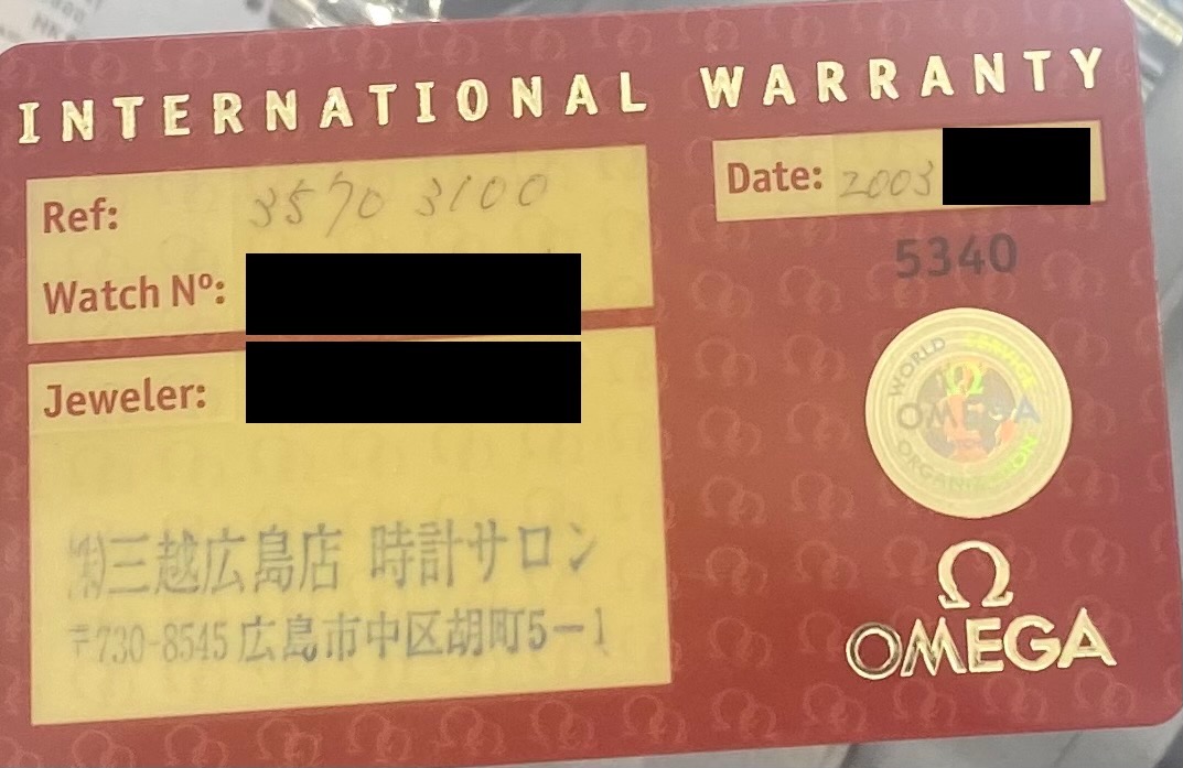

I have an opportunity to purchase what I'm told is a genuine mitsukoshi speedmaster.
I have attached a photo of the warranty card. I couldn't find any reference photos of what it should look like. Do any experts on here know if it's correct? I can't read Japanese either, does the text in the jeweller field indicate that it's from Mitsukoshi?

That says it's from the Hiroshima Mitsukoshi watch salon. So the card looks right. You'd need someone with access to extranet to check the serial to confirm it's a legit Mitsukoshi that's the quickest way.

The warranty card looks correct for this watch so it is probably legit. You can ask Omega to check if the serial number corresponds to the Mitsukoshi model. Hesalite crystals are very easy to determine, they are plastic and look, feel and sound different when tapped, plus they have the Omega logo imprinted in the center. As always, it comes to condition and price.

The book Moonwatch Only has a page dedicated to the Mitsukoshi edition. There's not much to the watch itself. It's basically a dial/hand swapped 3570.50. Serial # should be in the 77,08X,XXX range. 5340 code on the card.
