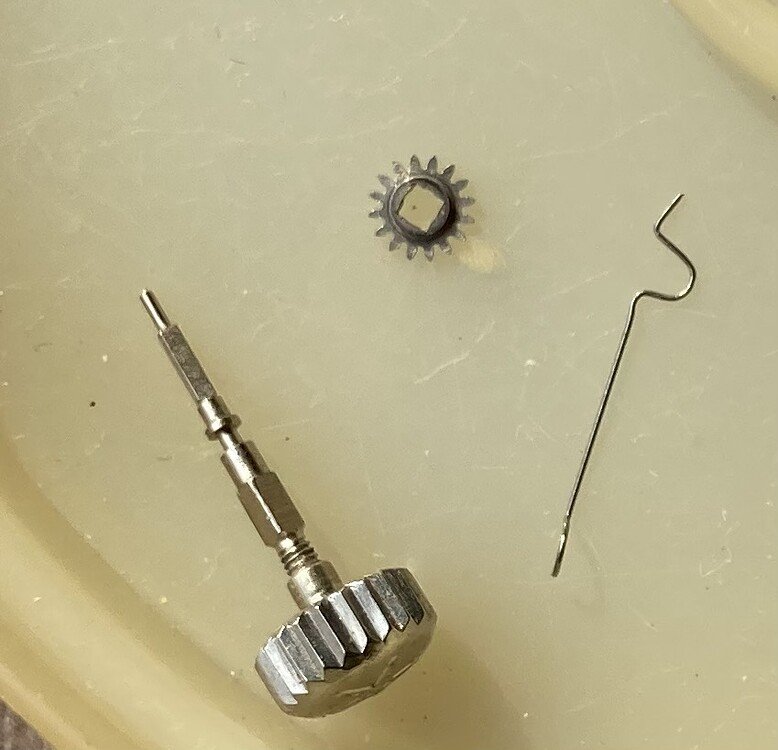

I'm missing the spring for the gear that rotates the inner bezel on this one. From what I read, it's a fairly common problem. The gear is present.
Anyone know where to find one or who can fix it? Possible to make one? Haven't shown it to my watchmaker yet.

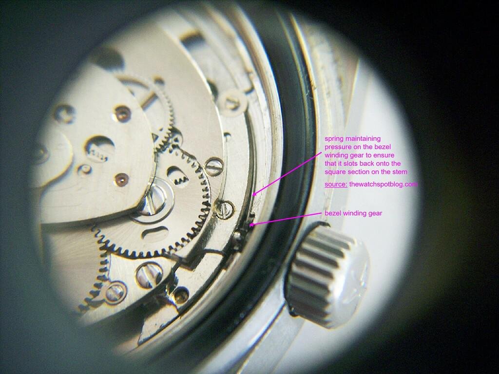

I would be very interested if anyone has a source or is going to remake them. I need at least 6. The problem is that anyone who doesn’t know these watches - and that’s a lot - removes the crown, takes the movement out of the case and….lost spring. I bet this has frustrated and confused many watch repair shops over the years.

If anyone can perhaps send us a good picture of one...
Or even better, allow us to borrow one for a while, perhaps we could have a watchmaker make a few for us? This is the closest I came to a picture.

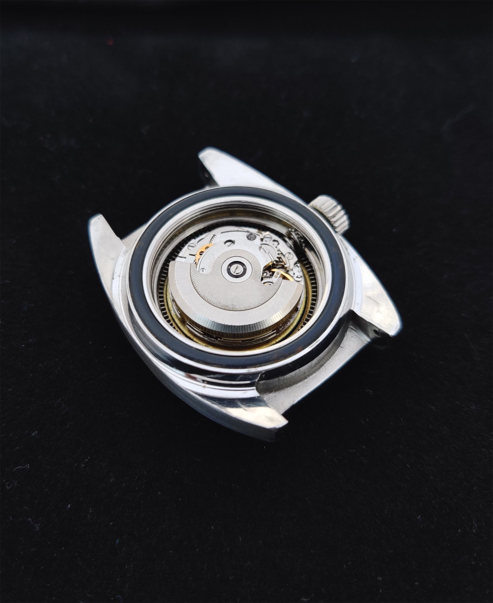

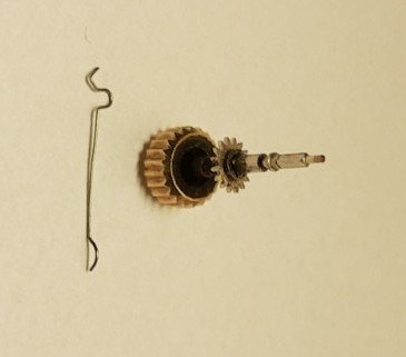

And now seeing that a coil spring was used in this one. I think this spring was used in a Seatime..
