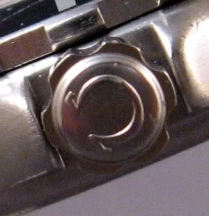

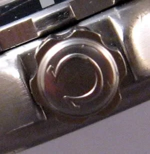

(Resurrecting an older thread and @Archer' comment) That's the six-lobed crown for the first generation of 396.1042.
Any chance of finding the part number of the round crown for the second generation? (Picture below is of the automatic version, but the quartz version also changed crowns.)
