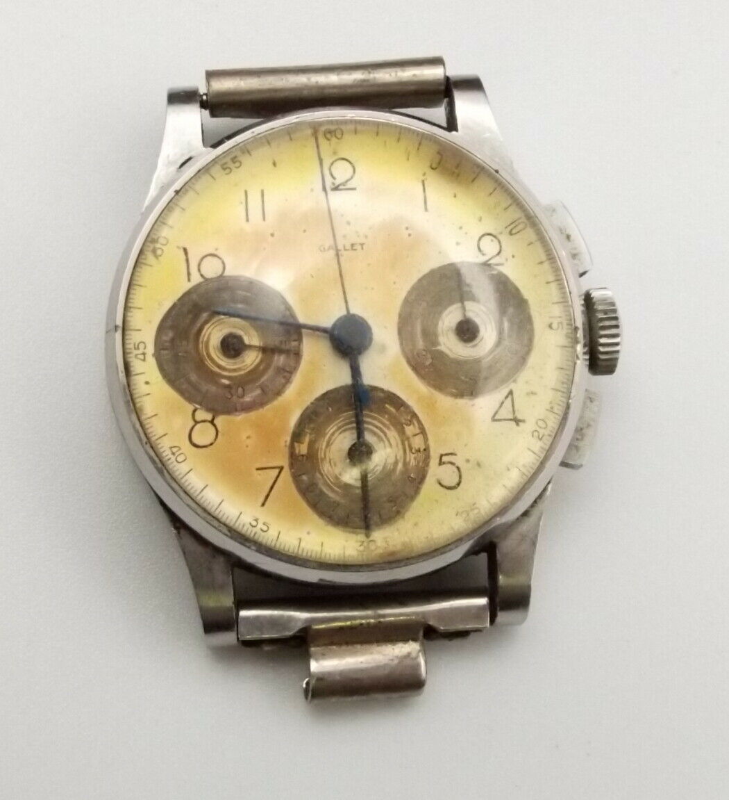

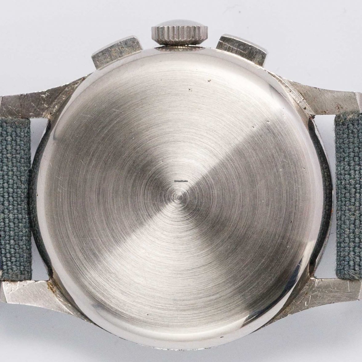

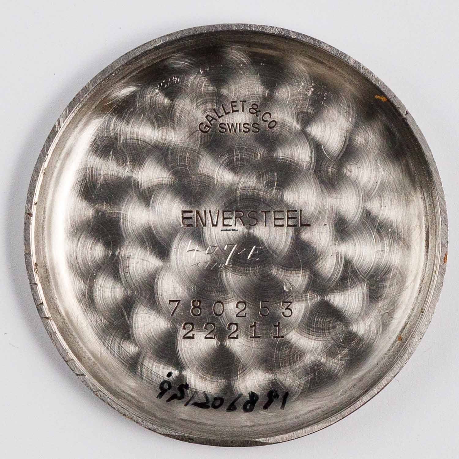

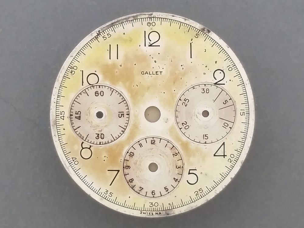

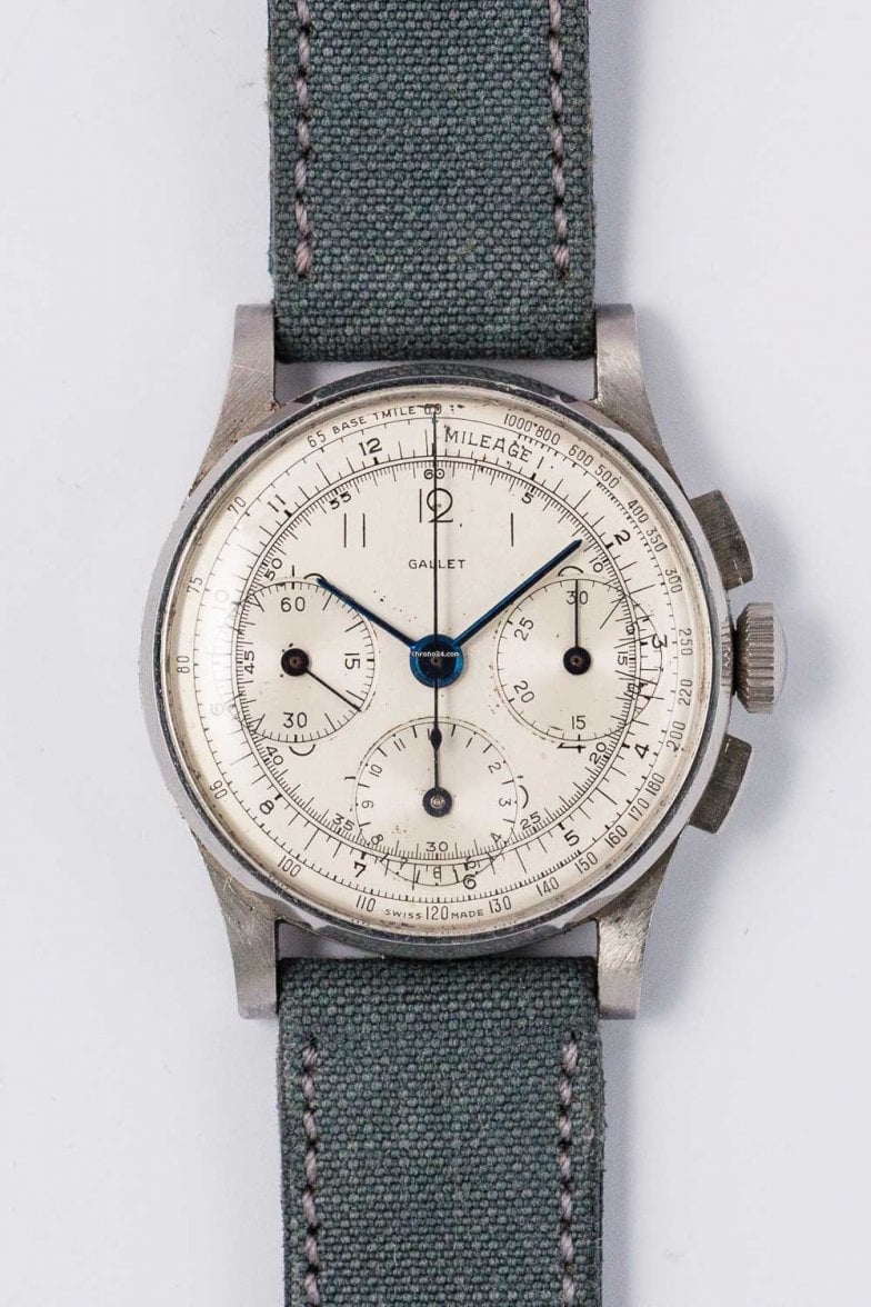

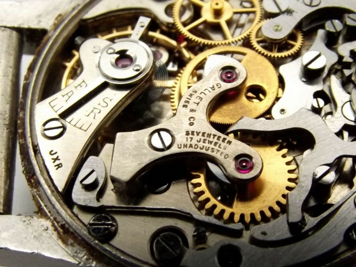

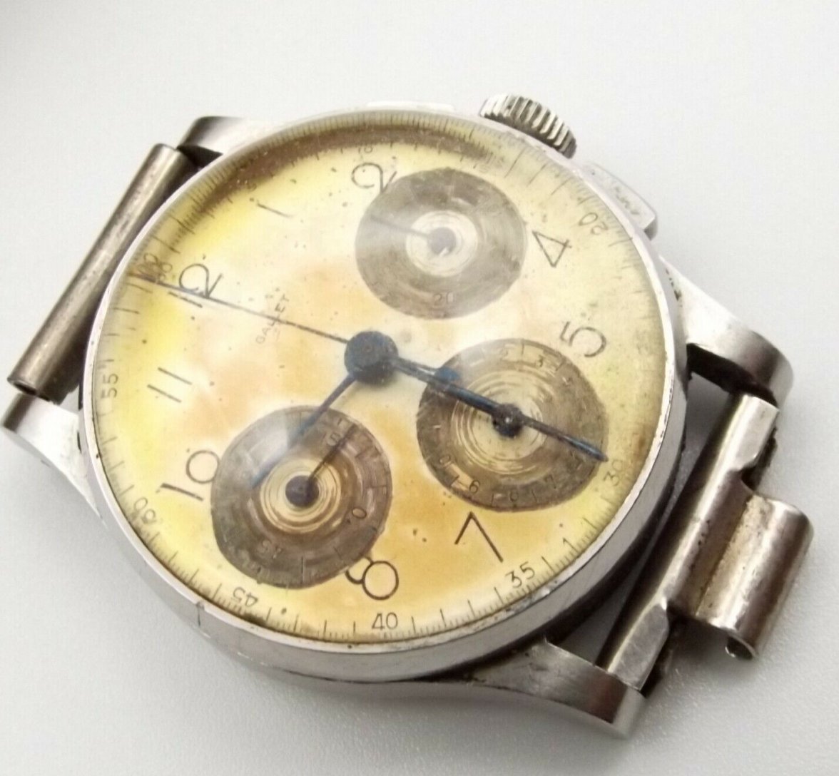

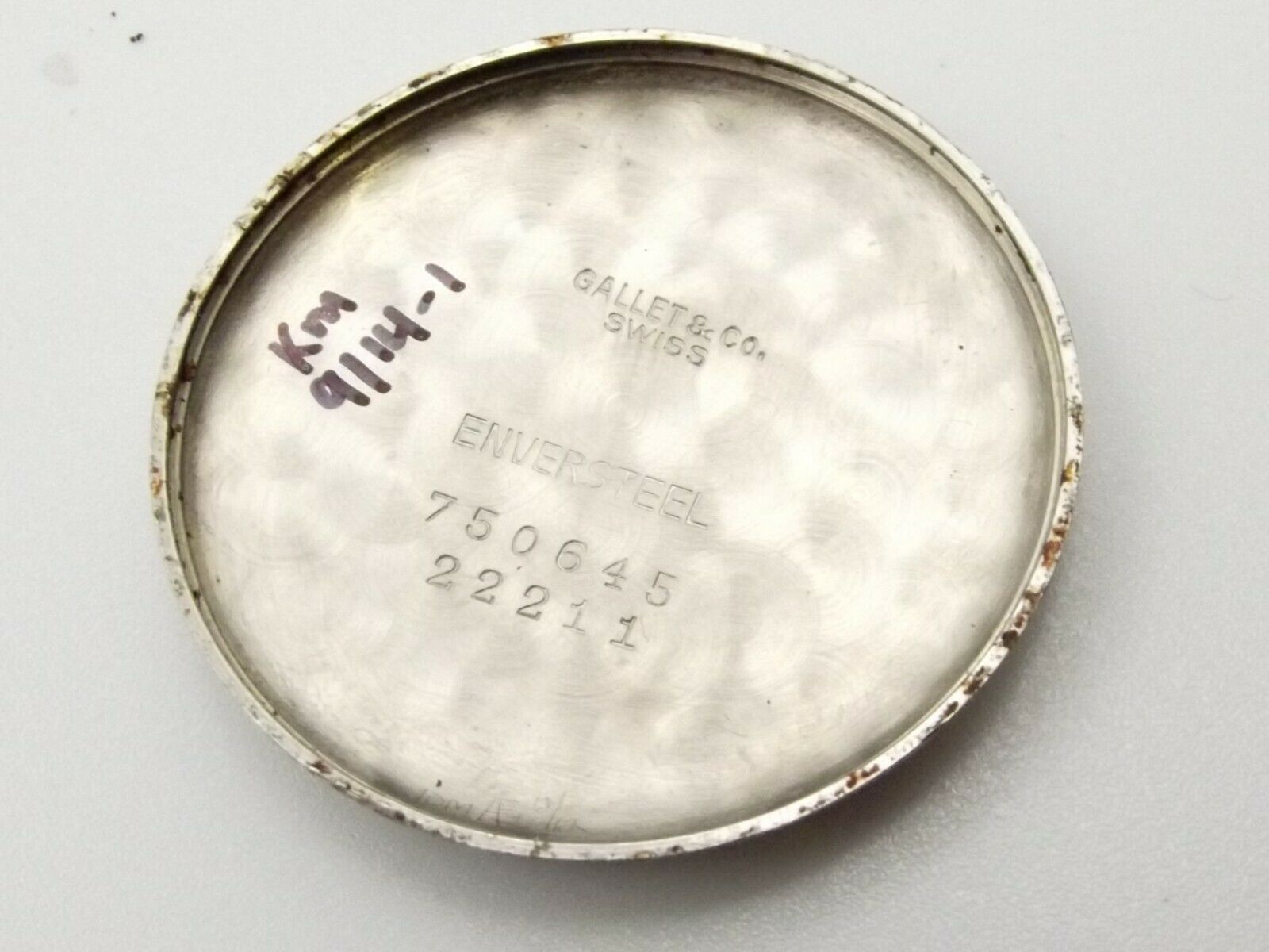

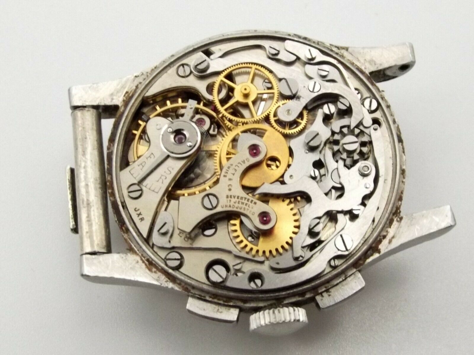

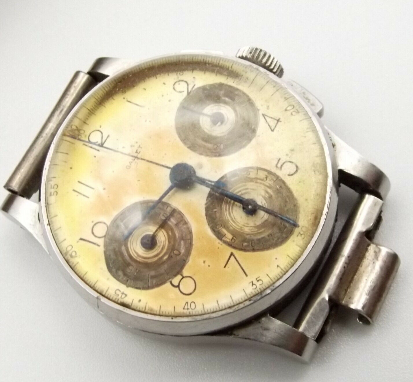

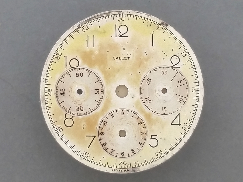

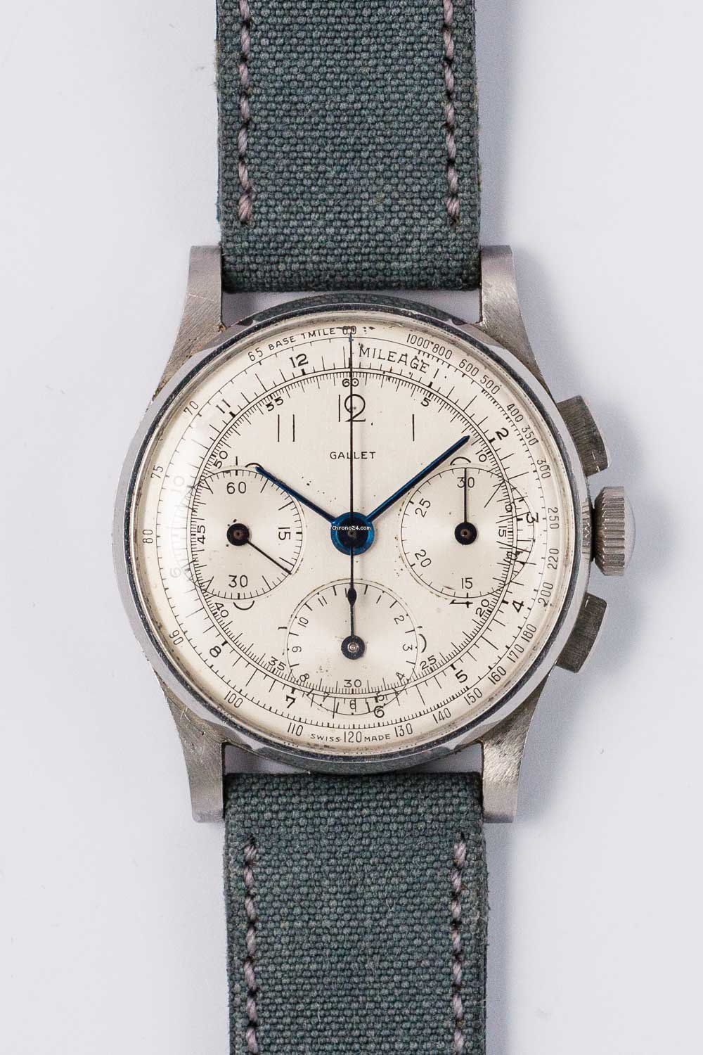

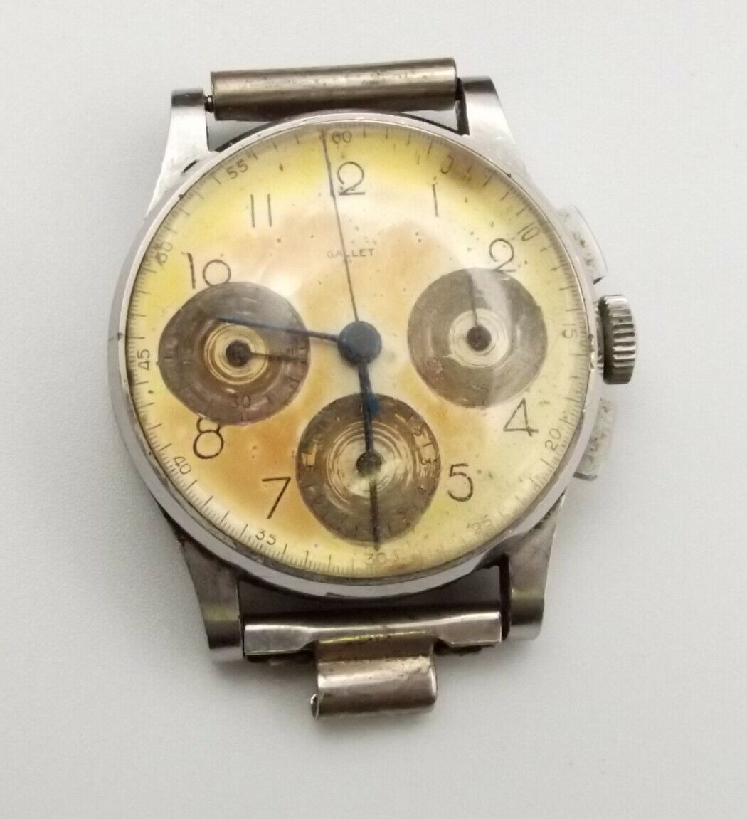

I recently acquired this fascinating piece. I mostly collect Gallet Chronos and this one was a real find! Very Early Gallet MC 12 Universal Geneve Martel Movement. I have sent it to Gallet for their museum service. Gallet has already cleaned the dial and I have included before and after shots of it. A very rare piece owned by a USAAF pilot I believe WW2 vintage.

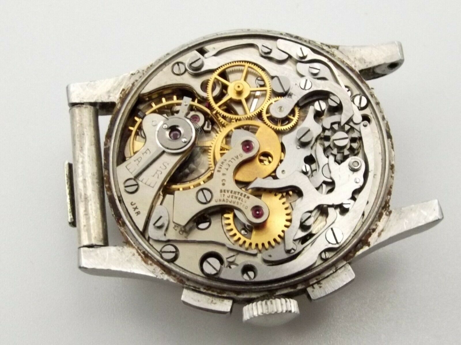

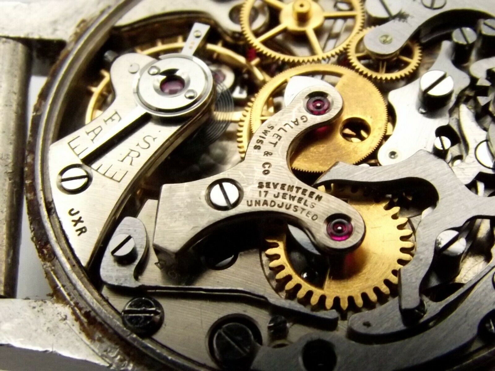

Very cool ! Is that stamped cal 381 ? I can't quite tell under the bridge. Whats the case size? What was on the subdials that was able to be cleaned off like that?

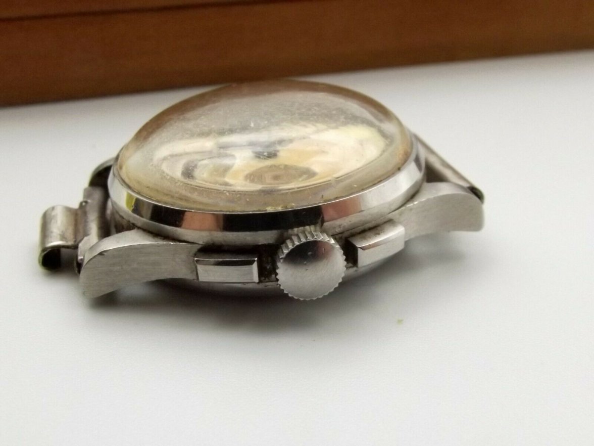

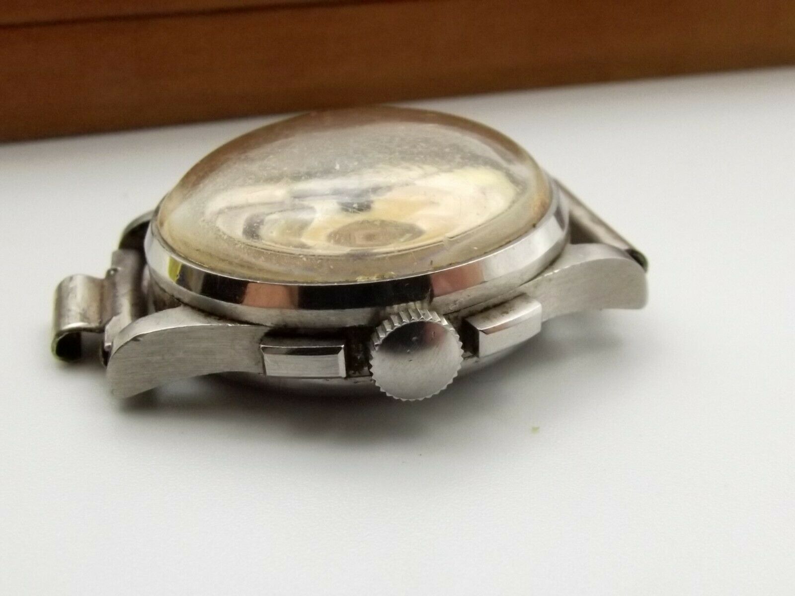

I was thinking cal 281. The crystal is perhaps the most interesting part. 😀

It is a Cal 281. The Crystal is interesting. Gallet says it might be a custom made crystal made to magnify the dial and telemeter for easier reading.

I get confused which alt brands substituted the 2 for a 3 in the movement numbering (eg 281/381, 285/385, etc)
Yes that crystal is pretty wild. the highest of the high profile domes?

Apparently the last time the watch was serviced the Smaller register hands were not adjusted properly and rubbed against the dial which caused the black marking. Gallet was able to gently clean these black marks with mild detergent to remove them. Gallet is currently doing a full museum service. The case is 32mm without the crown.

interesting, I wouldn't have expected such good results from a cleaning, you are very lucky !

Actually I think they also used Silver Dip. Which they first indicated was a risky procedure. I thought it was more important for the watch to have a decent dial due to the damage caused by the poor service in 2014. They took a digital photo of the dial before cleaning with the solvent and detergent in case they might need to reprint the dial as the silver solvent dip is a crap shoot at times with dials. They then cleaned the dial and used the silver cleaner and this was the result which was to me an exceptional outcome. The folks at Gallet Service have 7-8 of my Chrono's right now and I have to say they provide spectacular service backed up by years of Experience. They aren't cheap but they do a fantastic job. I sent in a Gallet Excel-O-Graph in pieces and they machined many parts, and restored a Chronograph that I thought could never be restored.

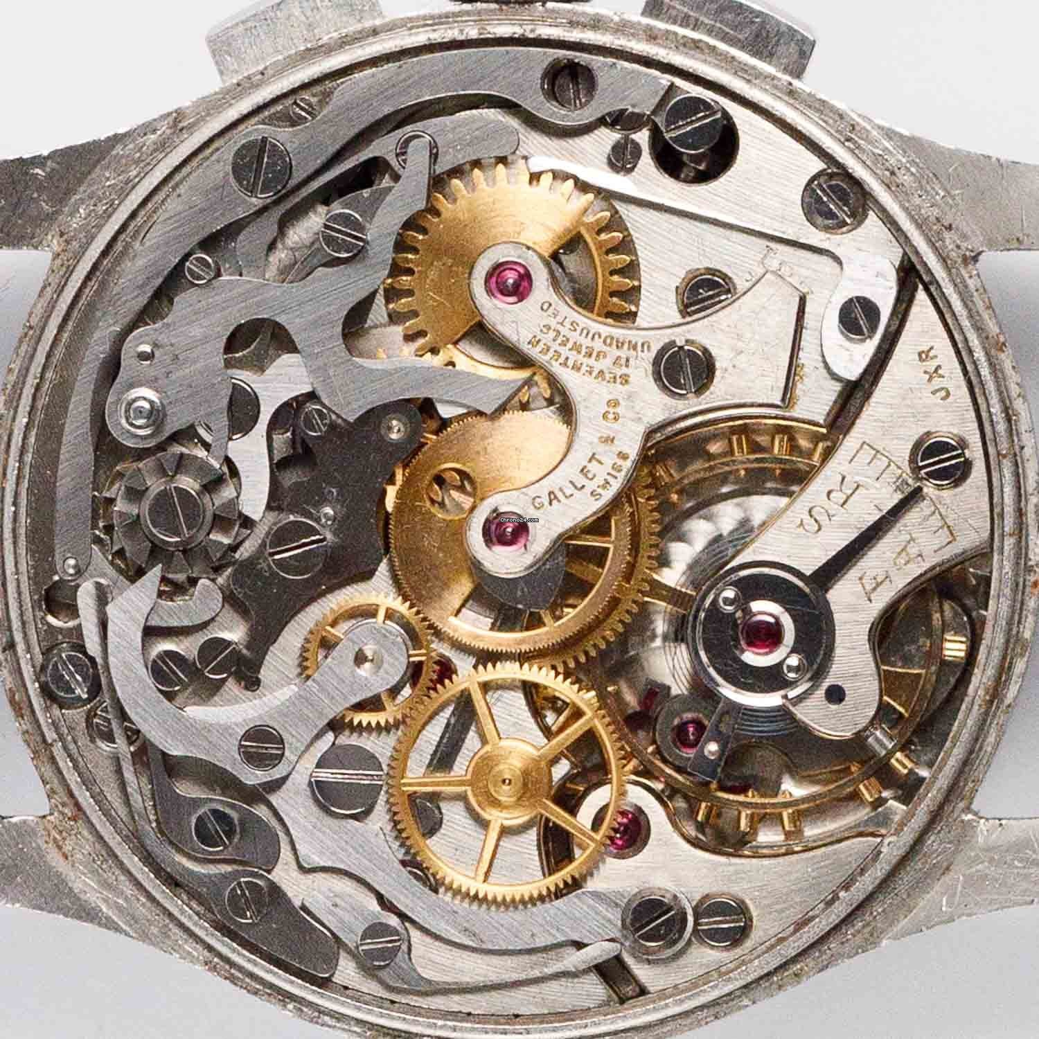

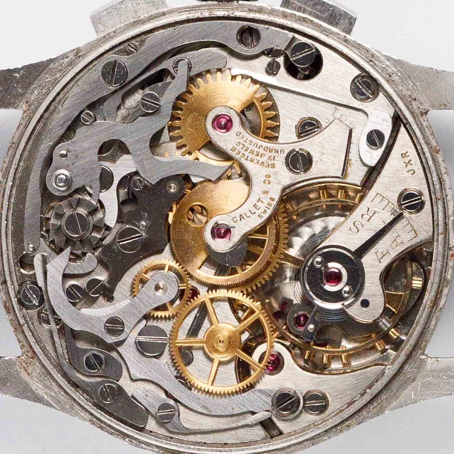

That movement is a Gallet signed valjoux 71 isn't it? Did Gallet make any adjustments or is it a standard valjoux?

One can see the 281 inscribed 😉 Same strange place as on the watch of the OP
