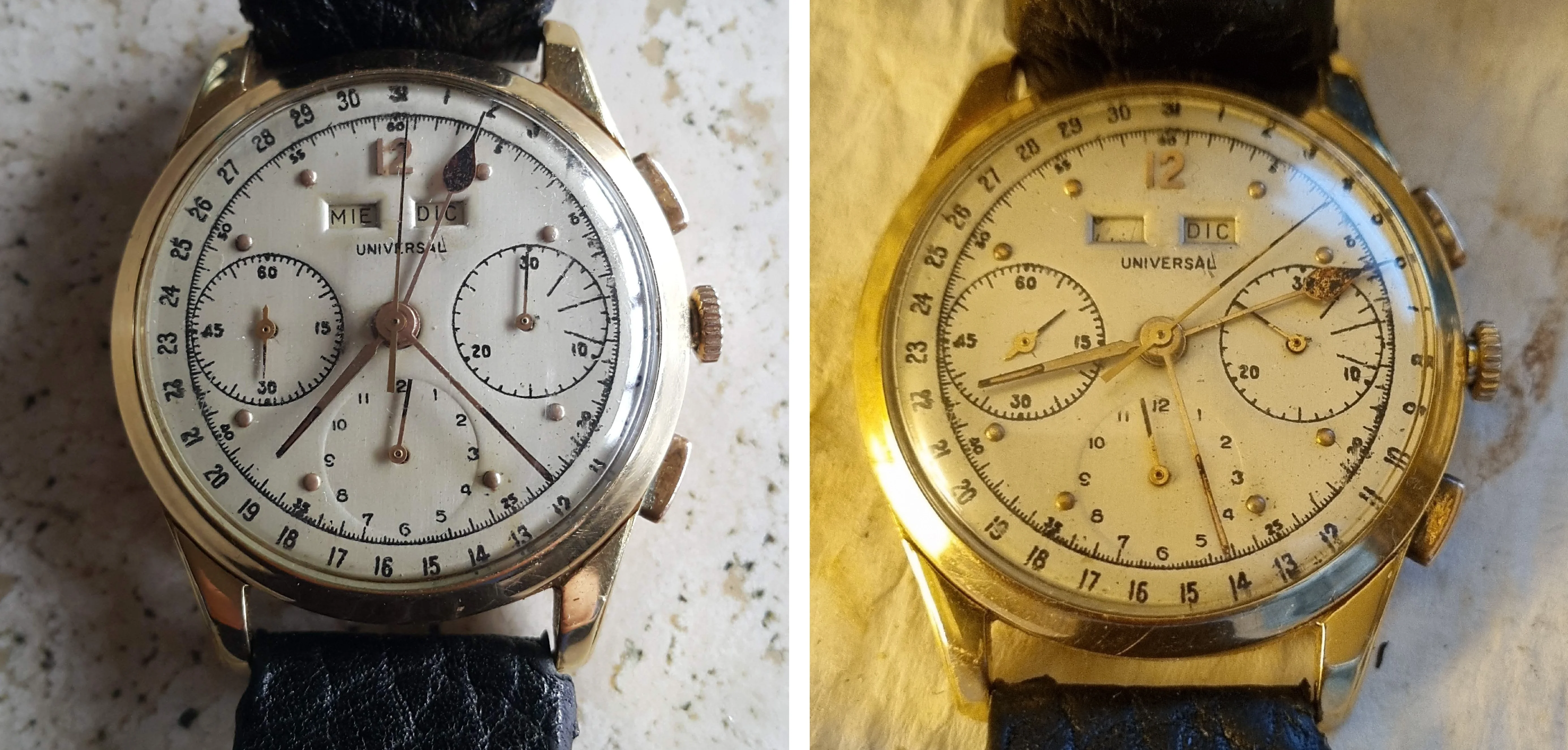

I am seeking historical information on a very early Universal Genève Triple Calendar Chronograph that has a peculiar mix of components. I am trying to determine if this is a documented factory assembly or a later repair/frankenwatch.
Watch Details:
  • Brand on Dial: Universal Genève
  • Model: Triple Calendar Chronograph (Dato-Compax style, 2 Registers)

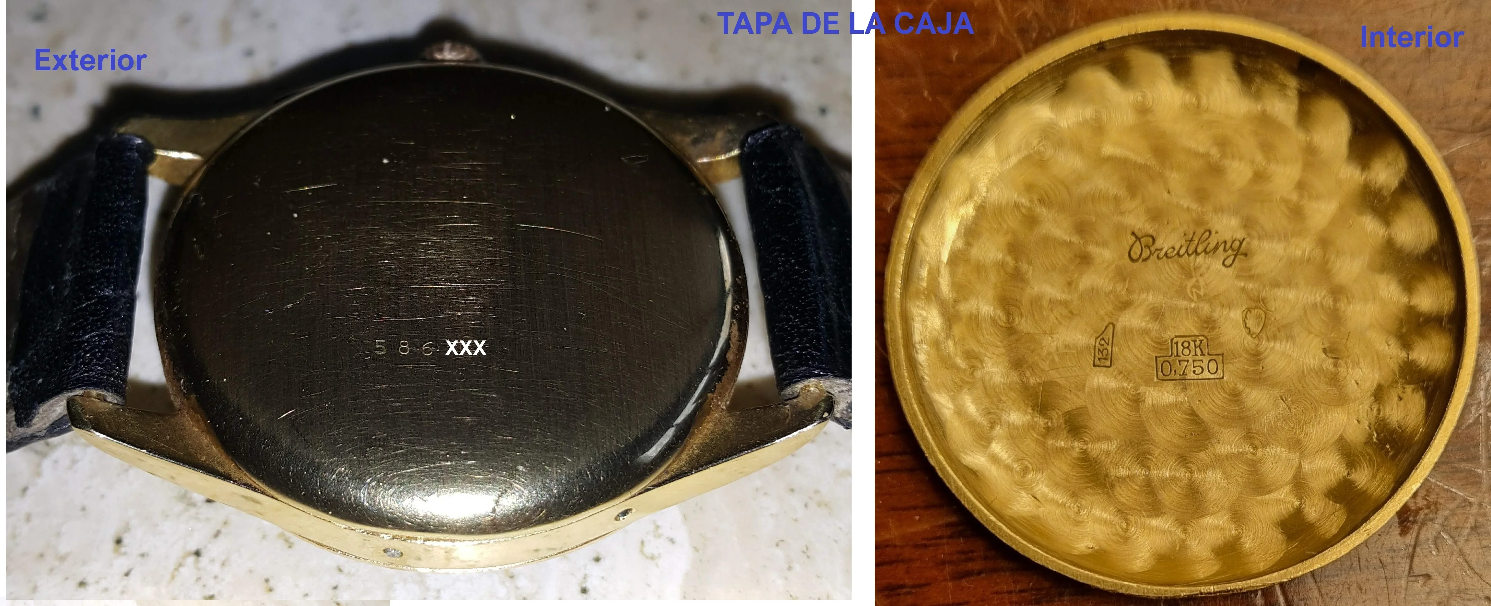

  • Case Material: 18K Yellow Gold (Stamped 18K / 0.750 inside the caseback)
  • Case Serial Number (Exterior): 586531 (This number dates the watch to the very early Universal Genève Compax era, approx. 1930-1936)
  • Movement Calibre: Likely a UG Calibre 481 family (based on $481$ seen on the plate)
The Anomaly (Mismatched Components):
This is the core question:

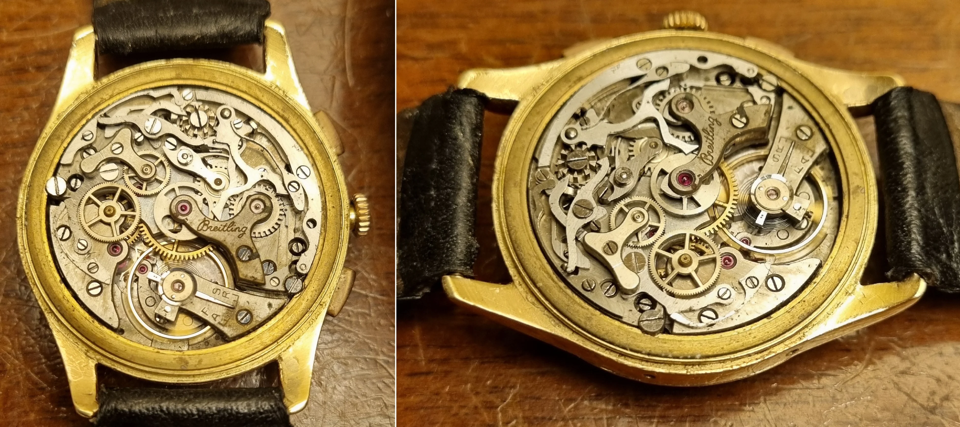

  1. Caseback Interior: The inner caseback is stamped and clearly signed "Breitling". It also bears a second number: 132.
  2. Movement Bridge: One of the movement bridges is also signed "Breitling" (which is likely a repair part replacement, given the UG dial and serial).
My Question for Historians:
  • Is there any archival record, period documentation, or known case of the $586XXX$ Universal Genève serial range being paired with a Breitling-signed 18K caseback during the 1930s or early 1940s?
  • Does the inner caseback number "132" correspond to a known Breitling case supplier batch?
Any information on whether this assembly could be a rare, factory-sanctioned cross-supply or simply a Frankenwatch assembly during a later service would be highly appreciated.
Thank you very much for your expertise and time.

Appears to be a valjoux 723 movement. And I'm pretty sure an 18k UG case would start with "1", not "5". It's just a franken with a horribly re-painted dial and mis-matched hands.
I don't know why people use AI for this, and then don't even put in the slightest effort to check the junk that comes out. Where is the 481?
You'd be better off trying to track down the Breitling connection.

Nothing about the watch is UG, except that someone scribbled universal on the dial.

Try the Breitling forum - it is not a Universal Geneve watch.
