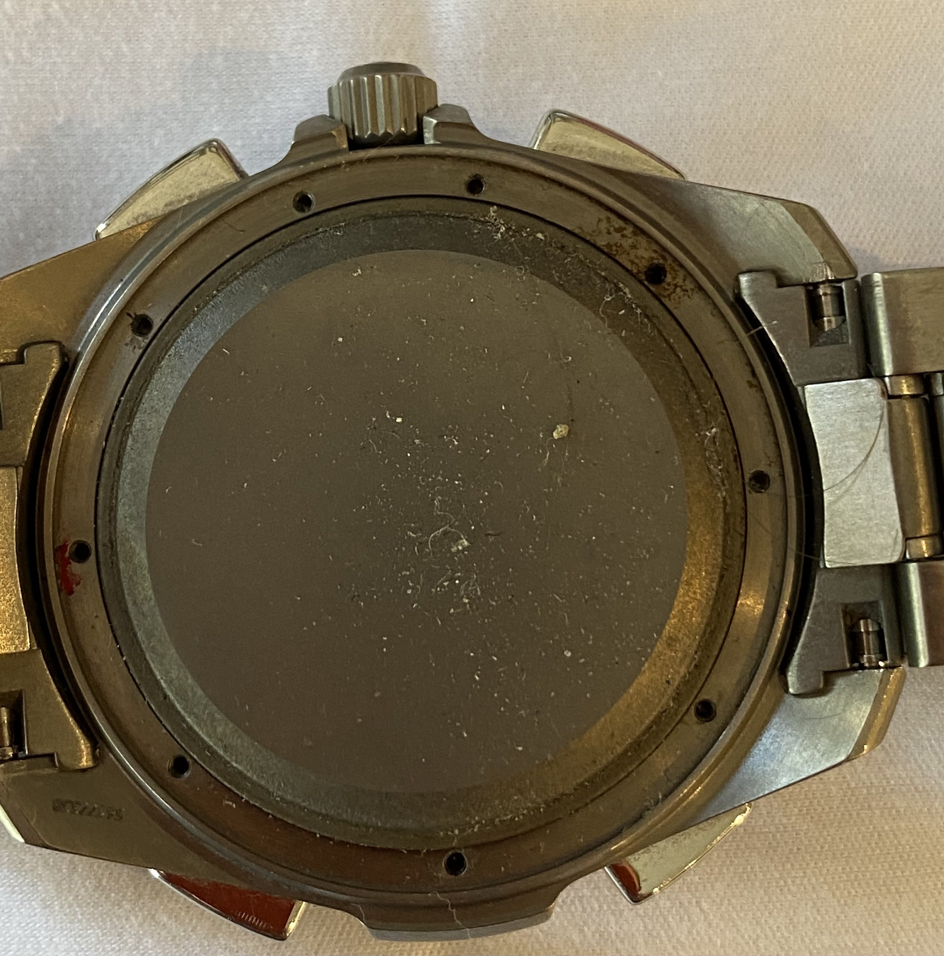

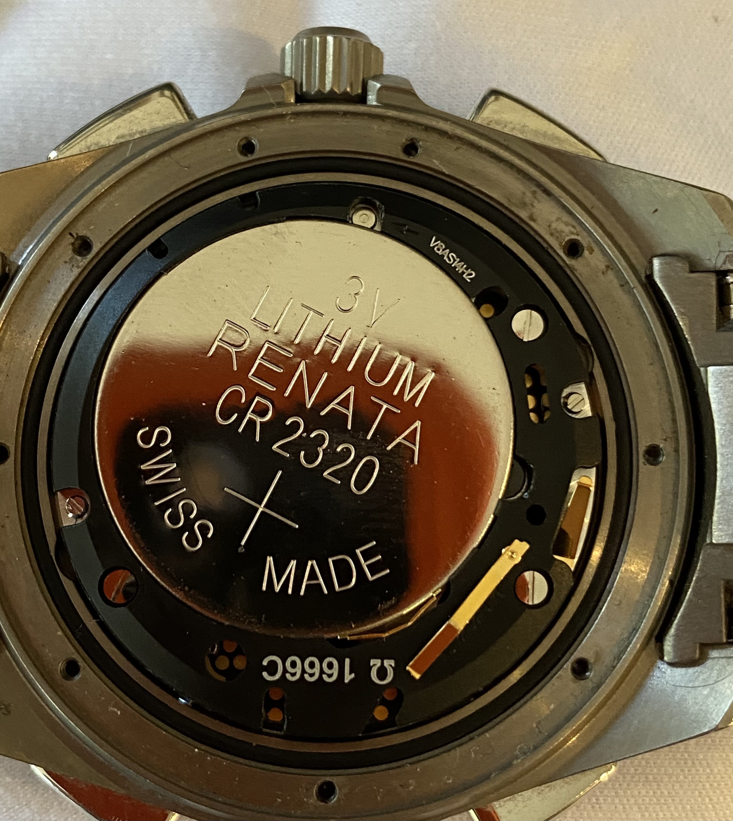

Can any one of those changing the cell themselves show some pictures and comment on mistakes to avoid ?
I think the most important would be to obtain good quality screwdrivers in the first instance. The screws are small and easy to strip.
Once they’re removed there’s a cover beneath the caseback. My understanding is this is part of the design that allows resonance for the 80dB alarm.
Lift off that cover, pop out old battery, put in new battery and reverse.
Excuse these photos as there’s a whole load of junk under the case back and it’s a watch I bought used. It’s subsequently been back to Omega for new seals etc.

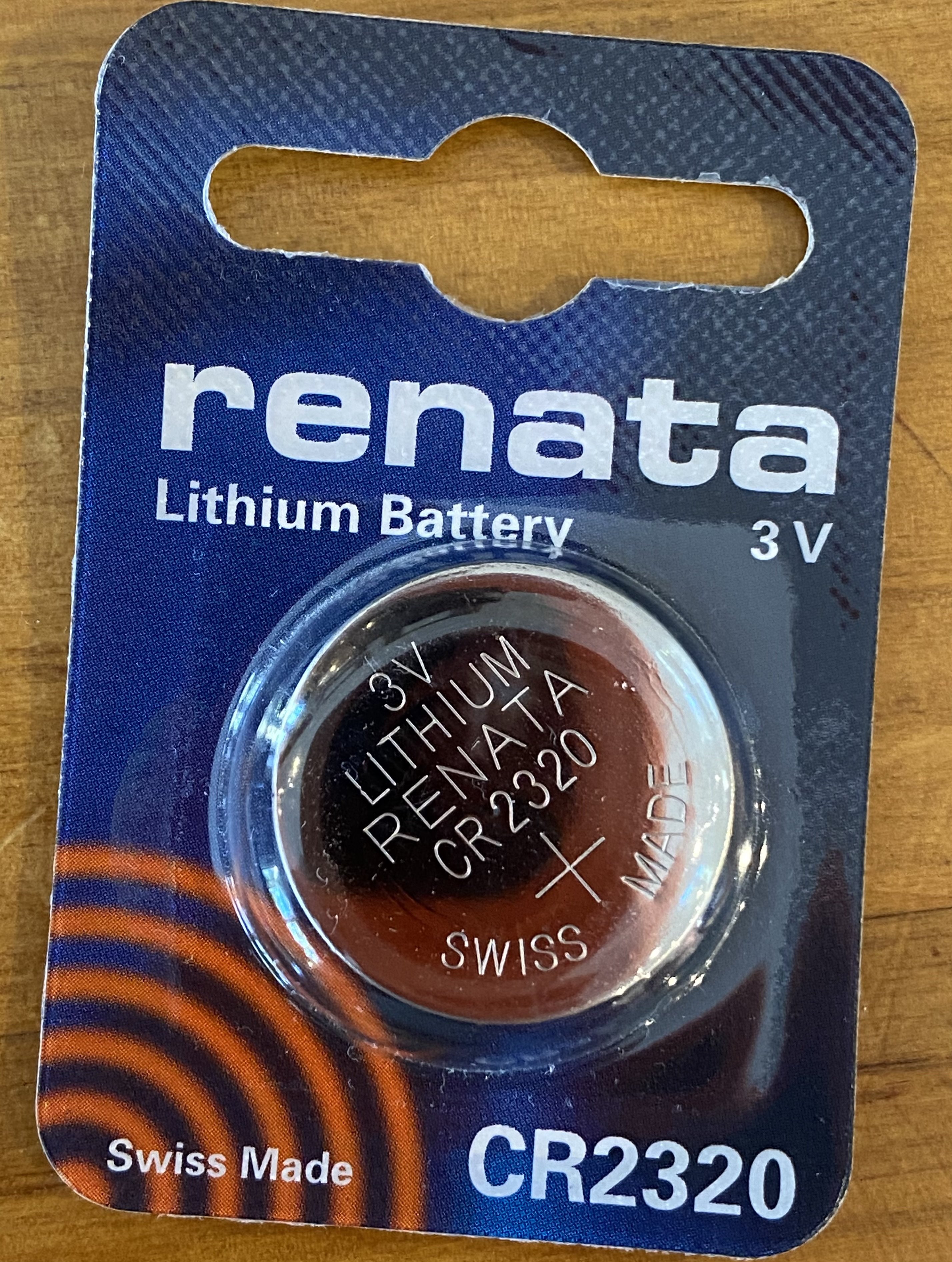

I posted this some time ago in a different thread:
Tools & equipment needed:
1) 1.2 mm screwdriver. I bought Bergeon and still managed to break the tip during removal of the second screw. Fortunately I also bought replacement tips so it wasn't a show stopper.
2) Tweezers (helpful during installation of screws)
3) Plastic pry tool to remove battery (toothpick will not work). The battery is held in position with a spring piece pressing against the side of the battery. This makes removal not as straight forward as it seems. It's not tight, but it does require a little prying.
4) Silicon grease
5) CR2320 lithium battery (not available in most of the obvious locations). I checked Walmart, a major grocery chain and 2 of the major drug stores. None had this. As a matter of fact, they all had the same displays. I had to order the battery.
Here is what I did and what I discovered. This isn't advice, merely my experience:
The screws are tight. Now that I'm finished, I wish I had replacement screws since I buggered mine up a little throughout the removal and replacement process. They will still be removable the next time, but they are a little buggered. I will not do this again without having replacement screws available. Once the screws were removed, with the dust cover in place (finger holding it on) I cleaned the groove surface the resonance cover seats in. After that, I removed the dust cover. Pry out the old battery and install a new. The new one is installed by pressing it in against the spring located on the side of the battery cutout (receptacle). There is a second spring in the bottom of the battery cutout. Turning the case over may result in it coming out (which I have read is a pain in the butt). I didn't turn the case over so it wasn't a problem. Once the new battery is in, I removed the o-ring from the dust cover and cleaned it off. Then I applied a very light coat of silicon grease to it. Put the o-ring back in and install the resonance cover. I used a crisscross pattern to tighten the screws.
Once all that is done, the watch must be reset (UTC, T1, T2 and any alarms, PETs or MET). The hands require synchronization after the UTC is set. Put the watch in energy saver mode and follow the owner's manual directions to advance the hands to the 12 oclock orientation. Once they are set and you take the energy saver off, the time will advance to the T1 set point.

I hadn't realised how big the battery actually was - I suppose it needs a load of power ...
