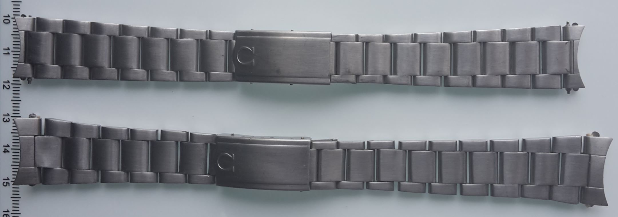

Here is a picture of the 18mm 1168 for the Geneve "Ancoretta" Diver and 638 endlinks on top, and the 20mm 1168 for the Apollo Soyuz Speedmaster and 633 endlinks below.
Buckles, covers, middle links are the same.
The only difference is the outer links that are wider on the extremely rare 20mm Apollo Soyuz version.
Many 18mm bracelets were sold on ebay as "Apollo Soyuz" for the past year for over $600... not fair...
True 20mm Apollo Soyuz never show up... or maybe once a year.

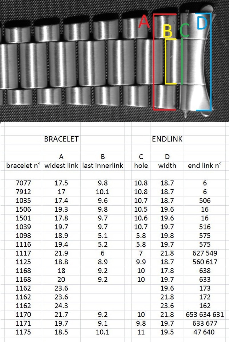

EDIT: Added bracelet sizes:
