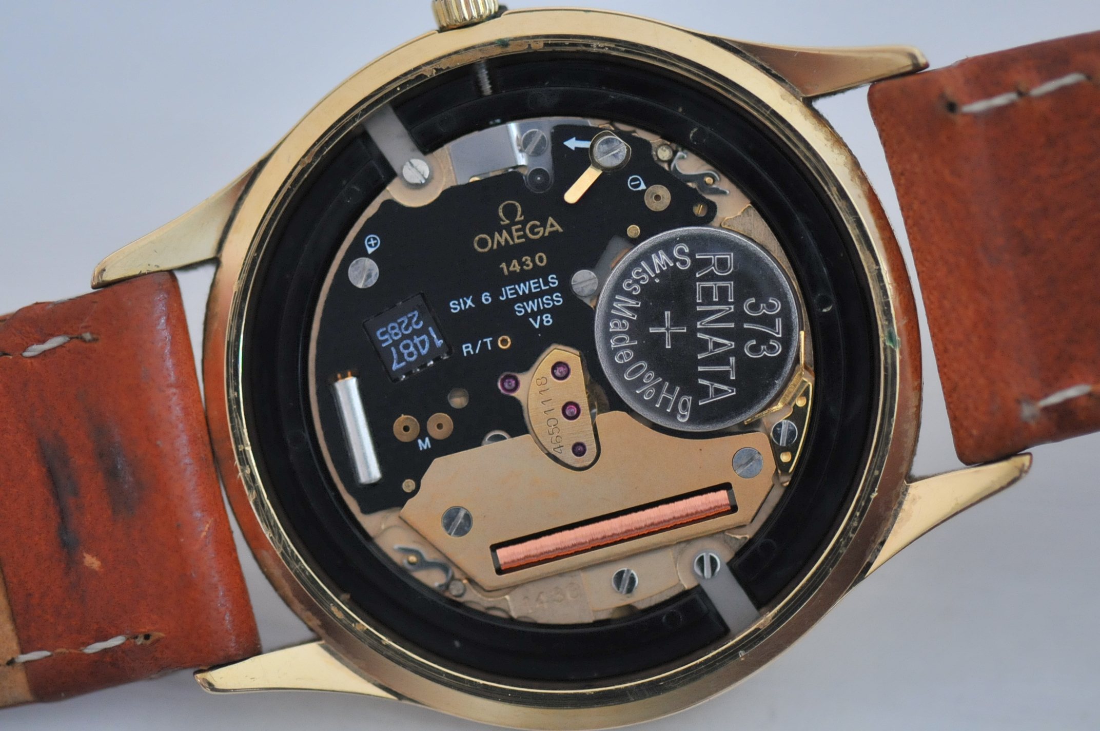

Hi
I bought this nice looking watch a while ago and i did not even bother to open it to check it inside because at the first look everything was ok for me..and after a while i open it ..and surprise..馃榾
I just post it so other can learn from my mistake..

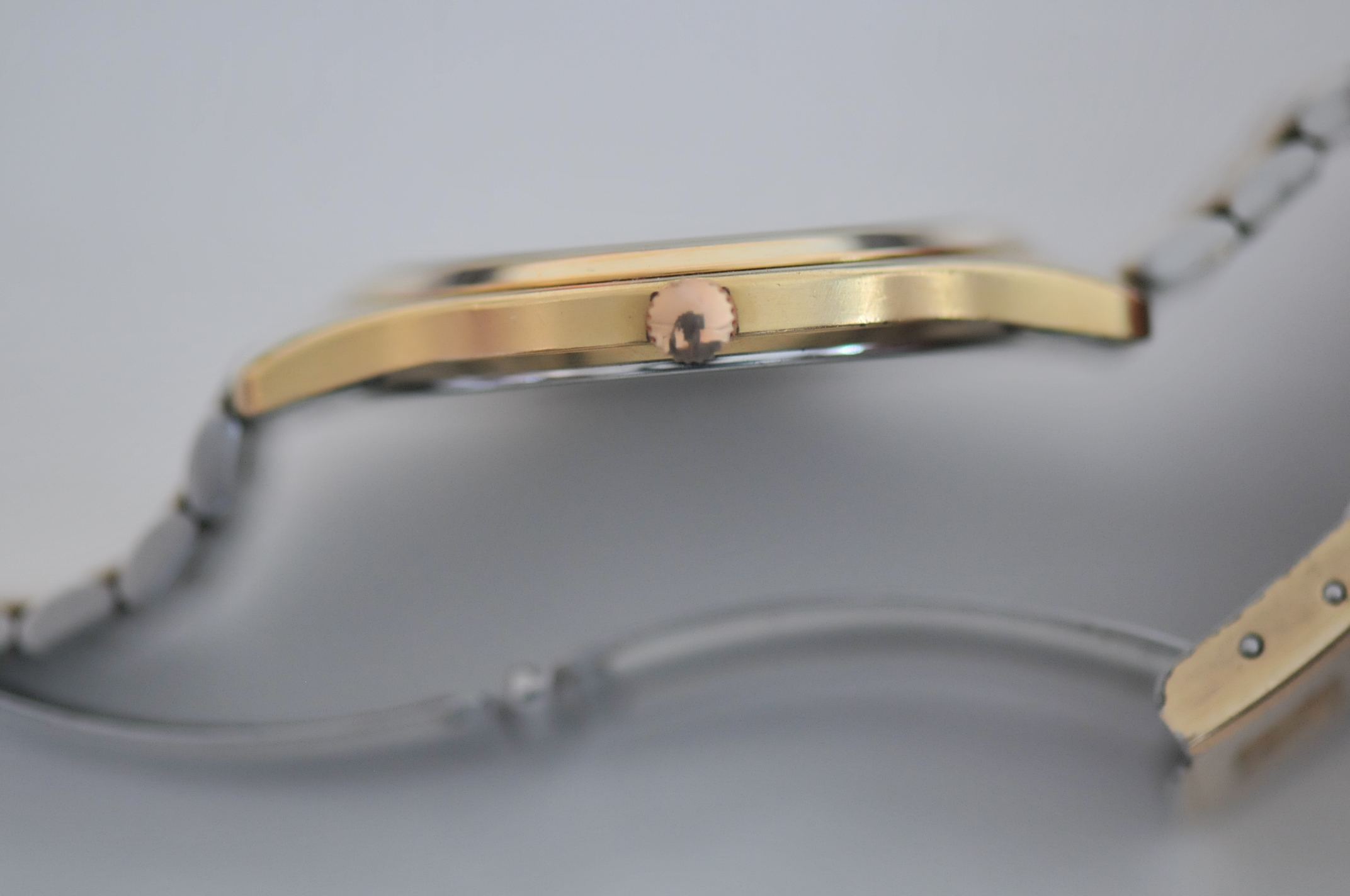

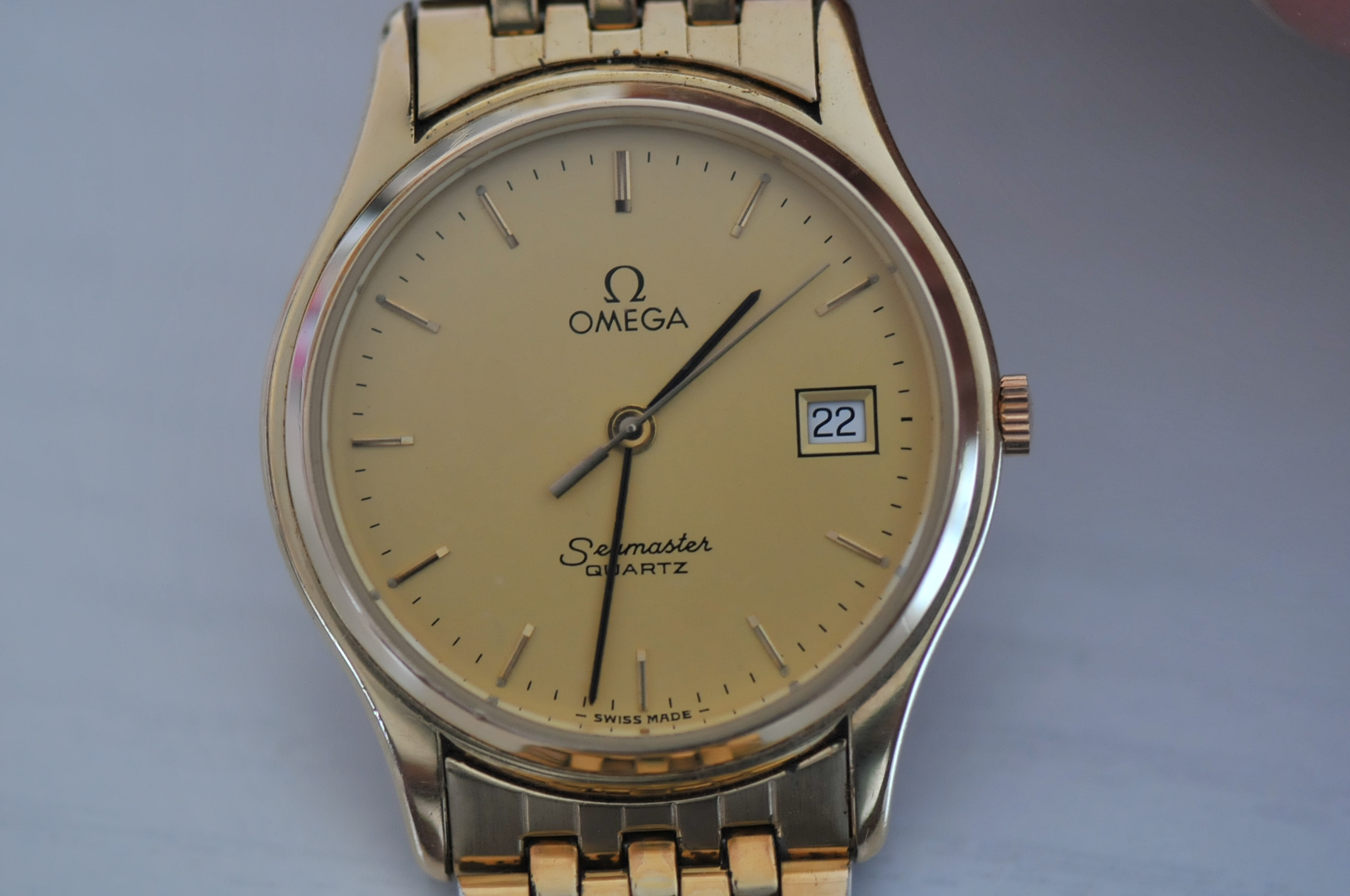

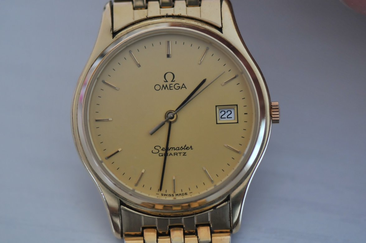

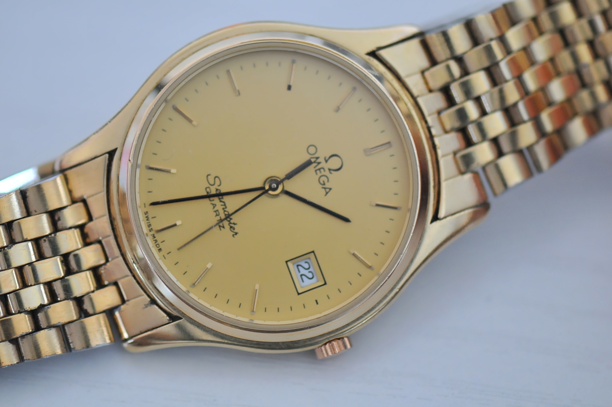

Here are the pictures with the watch..

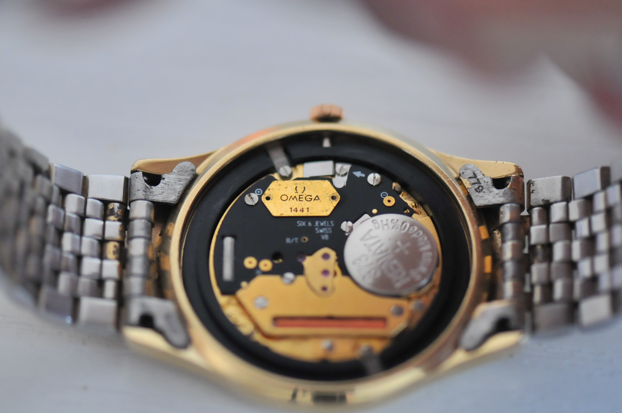

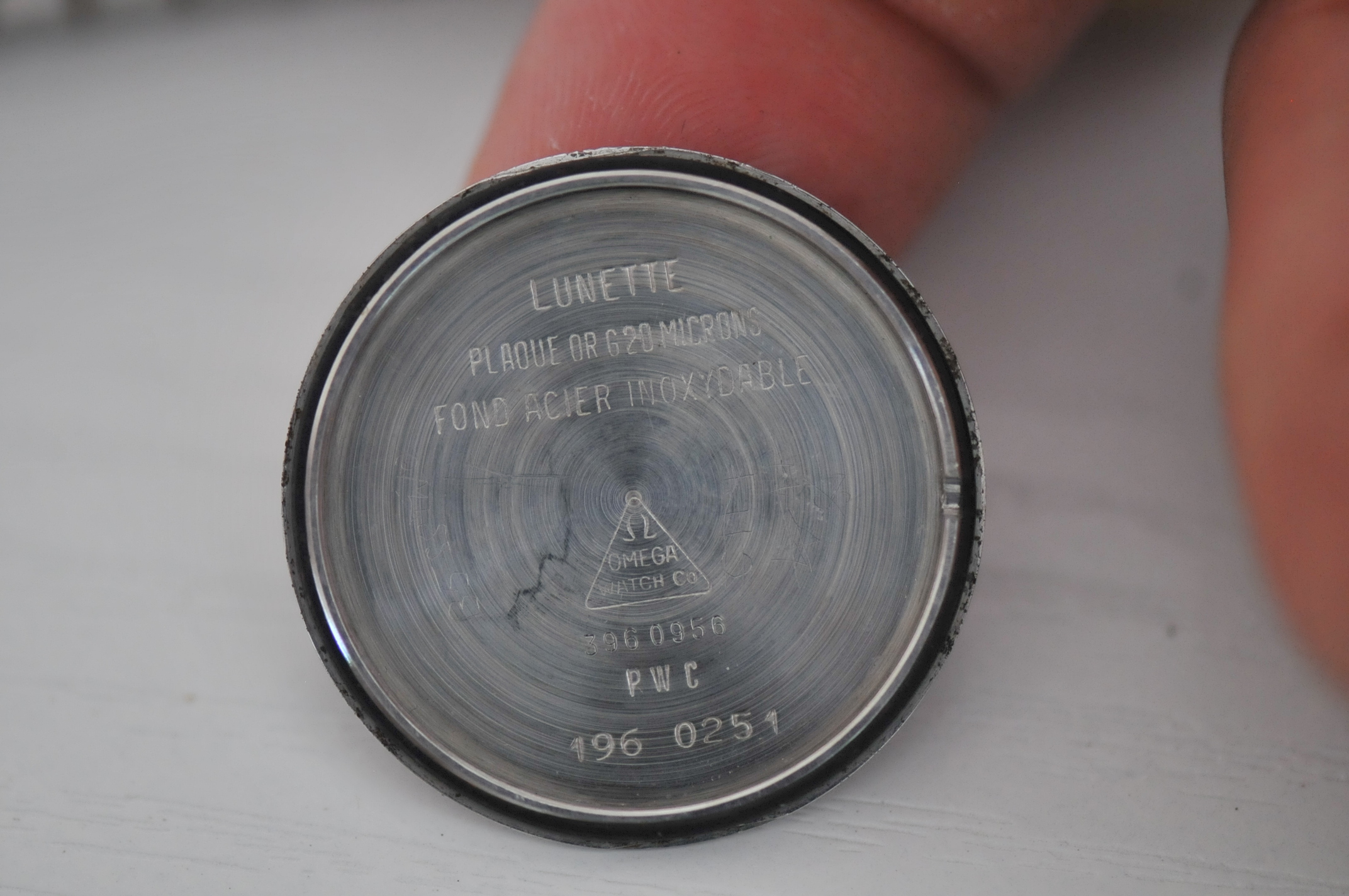

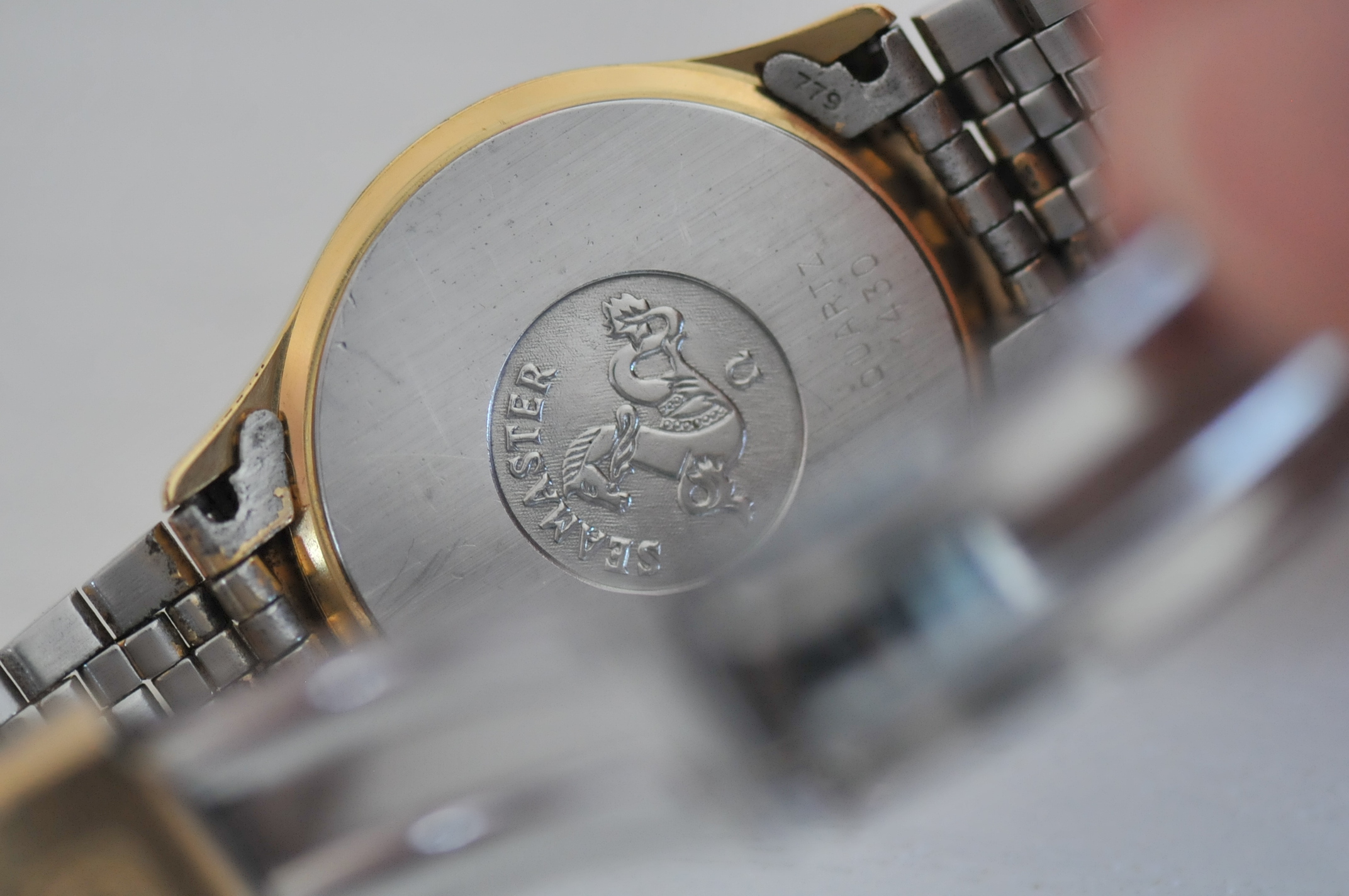

So..the Omega cal 1441 plate i assume it's glued. On the case back it's written cal 1430 which it sould look like this..

If it had been a cal 1441 it would have actually been a better watch, but it's not a cal 1441.
Is there a caliber stamped on the plate near the coil? I can't see as the pic is blurred there.

It's nothing stamped near the coil so i think it's a mechanism borrowed from other watch..
