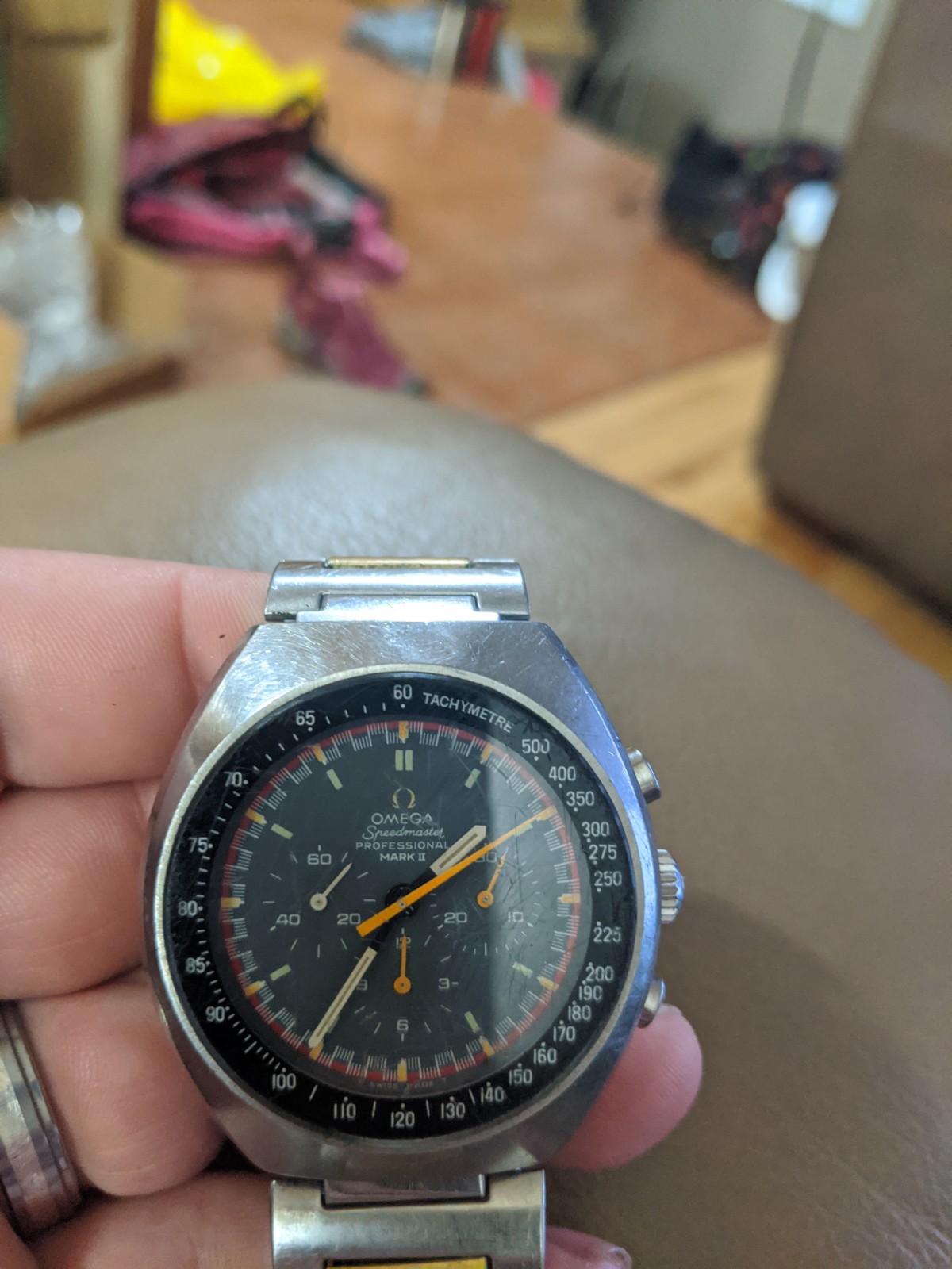

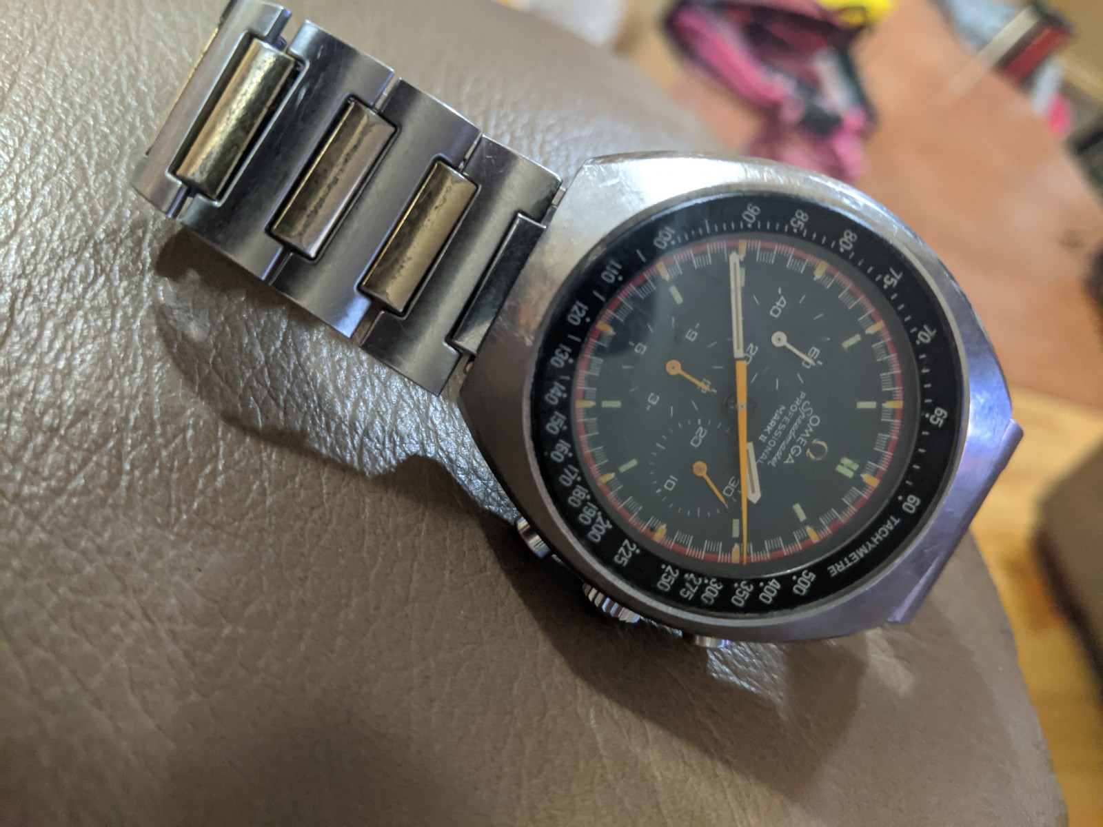

G'Day,
We were moving around some furniture in our new to us cottage and found this watch along with a couple other's and some jewellery and coins stashed under a cabinet. 👍
I really like this watch and would like to wear it.
I wound it and it all works but it does not keep proper time and I think it should have a proper service before I mess with it anymore as I figure it has been under that cabinet for a long time...
I am not a collector and dont know much about watches other than I really appreciate the fine engineering that goes into a quality watch and of course wearing a fine watch like this!
I would like to get it serviced and was shocked at the price from Omega @ $930.00CAD! https://www.omegawatches.com/custom...s-and-prices/main-steps-of-a-complete-service
I was also shocked at the value of this cool watch! At least according to a google search.
I live in the Fergus/Elora area in Ontario Canada and wonder if I just take it into the local fine watch repair place for a tune up and service, should that be all I need?
The glow in the dark coatings have worn out, I would like to restore this functionality, if possible?
What should I do to make this watch usable without taking away any value?
Any advice here would be appreciated!
Cheers,
Jon

Hi Jon,
Such a great find ! Lucky you 👍 !
This is what appears to be a nice Speedmaster Pro MarkII with the so called "Racing dial".
It looks nice, very fine dial and hands. The case doesn't seem abused. The bracelet is of no value.
This is quite a rare and valuable watch.
For your inqueries, I can't help you finding a nice watchmaker in Canada (I'm in France 🙄).
I can only say: don't send it to Omega ! They would ruin the intrinsic value of the watch by replacing everything to match the "factory spec".
The hands and dial have lost most of their luminous capacity as it contains tritium that is a radioactive isotope of hydrogen. Due to its nature, tritium decays over time and as this watch is from the early 70's, the tritium is now almost gone (its half life is about 12 years --> so about 5 periods). I understand you wish to restore this functionnality, however, this would mean replacing the dial and hands for service SuperLuminova ones, doing so would drop the overall value of the watch.
I would suggest: try to find a great watchmaker in Canada (@Archer, you're from Canada right ?) and give it a service. Find a nice bracelet/strap and wear it in good health, it gonna be a very nice daily beater 👍
Cheers.
Dr R.

What a find. I reinforce the sentiments above. The hands and dial look great. Dont fiddle with them. An independent service of this watch will also cost you real money, but is really essential. I have one that is very much like yours
1,441
3,809
what a find - just service the movement and perhaps give the crystal a polish and gaze at it

If you want to make the luminous dial work again, you will either need to get it relumed or have a service dial + hands installed. Few people here would recommend that, but make up your own mind about it. If you are concerned about retaining the value of the watch, either install a new dial + hands and keep the originals or leave it as it is. A relume will only hurt the value amongst collectors.

Jon, You have been lucky. You did not buy one for a few 1000's of Cad $$$$$.... If you want to keep your luck in the future and wear that Omega, there are no shortcuts. It needs a movement service. And anything between cad 400-500 will propel you into the cool vintage omega scene. No cheapies here. Anything less would surprise me. Ask Canadian collectors for the right watchmaker, take your time and enjoy it. Kind regards from the opposite side of the Globe. Achim

If this watch is only of any value to collectors, would I be correct in assuming that having the movement serviced would not remove any value? Just leave the dial and hands as is then?
I wonder if this dial used to be black and it has just faded over time?

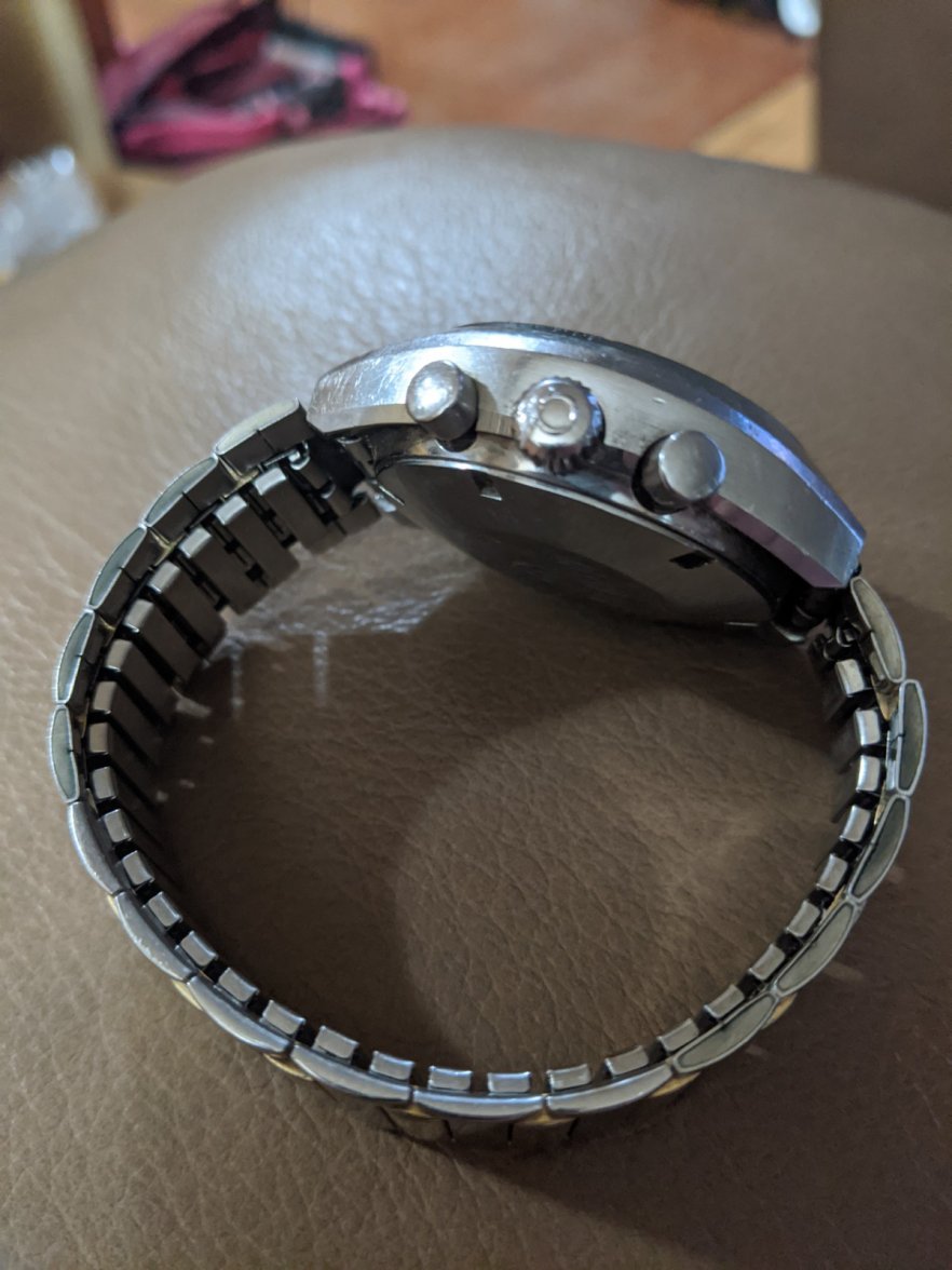

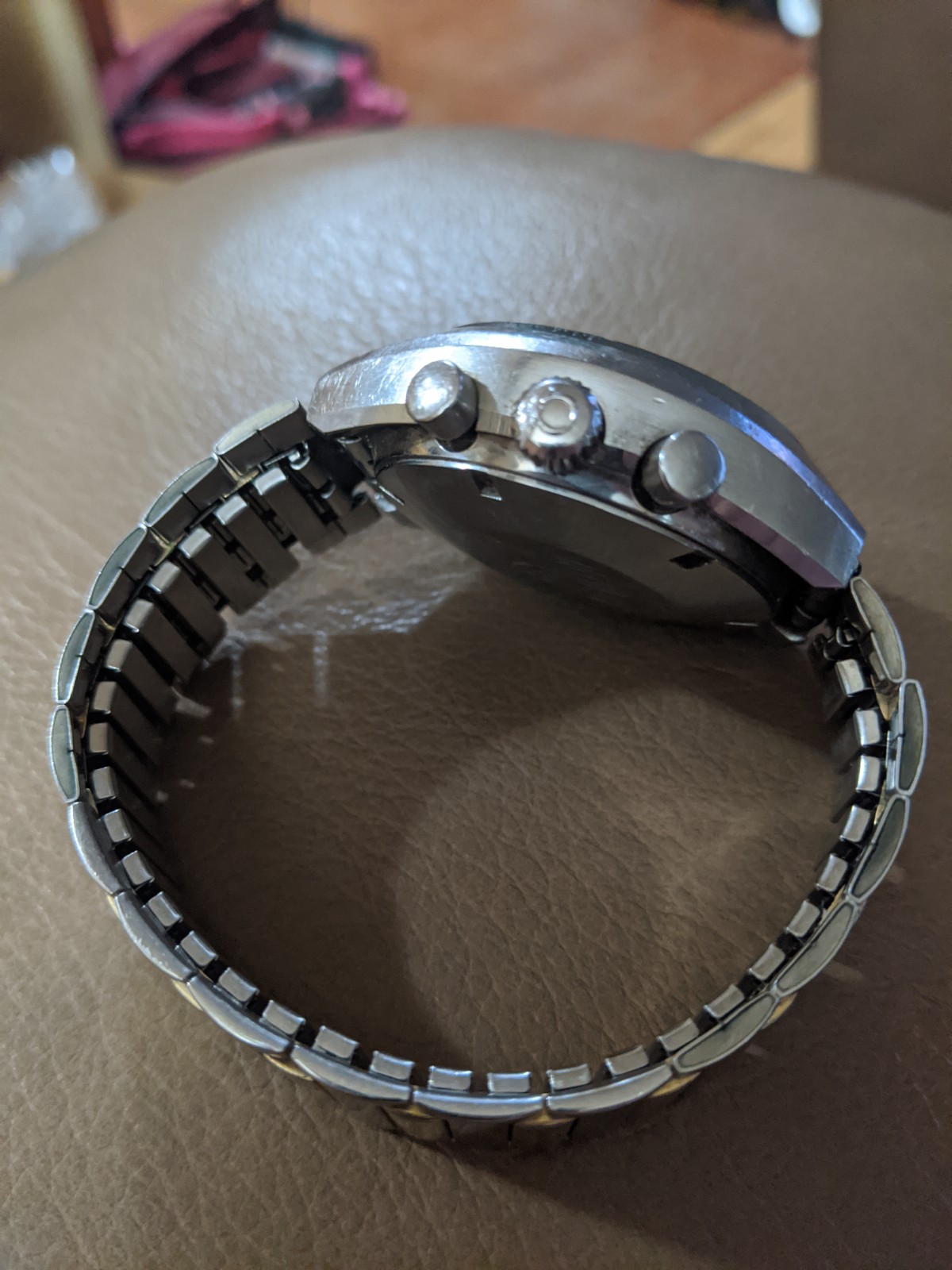

It appears the bracelet is not original, what kind of bracelet should this have to make it look more authentic?

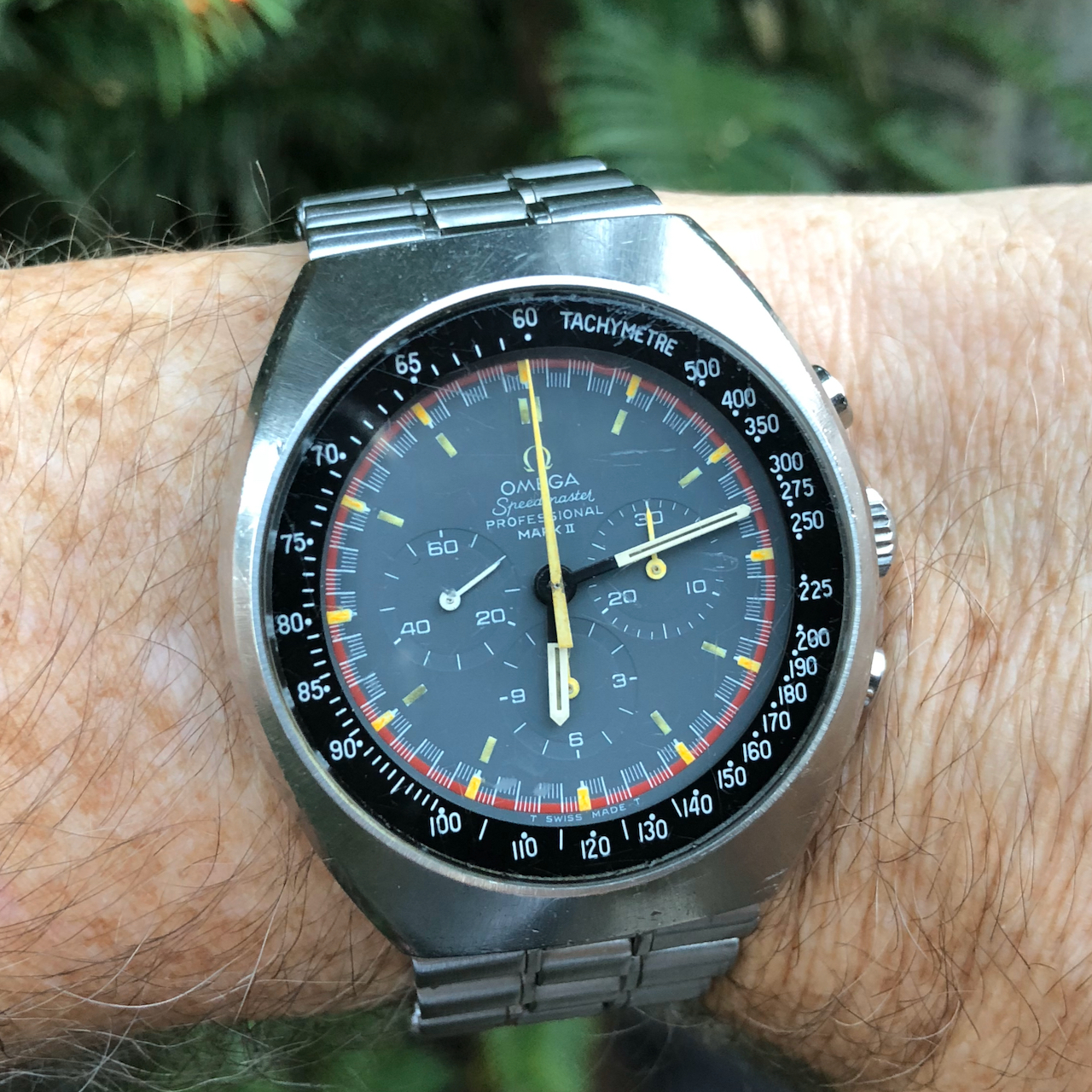

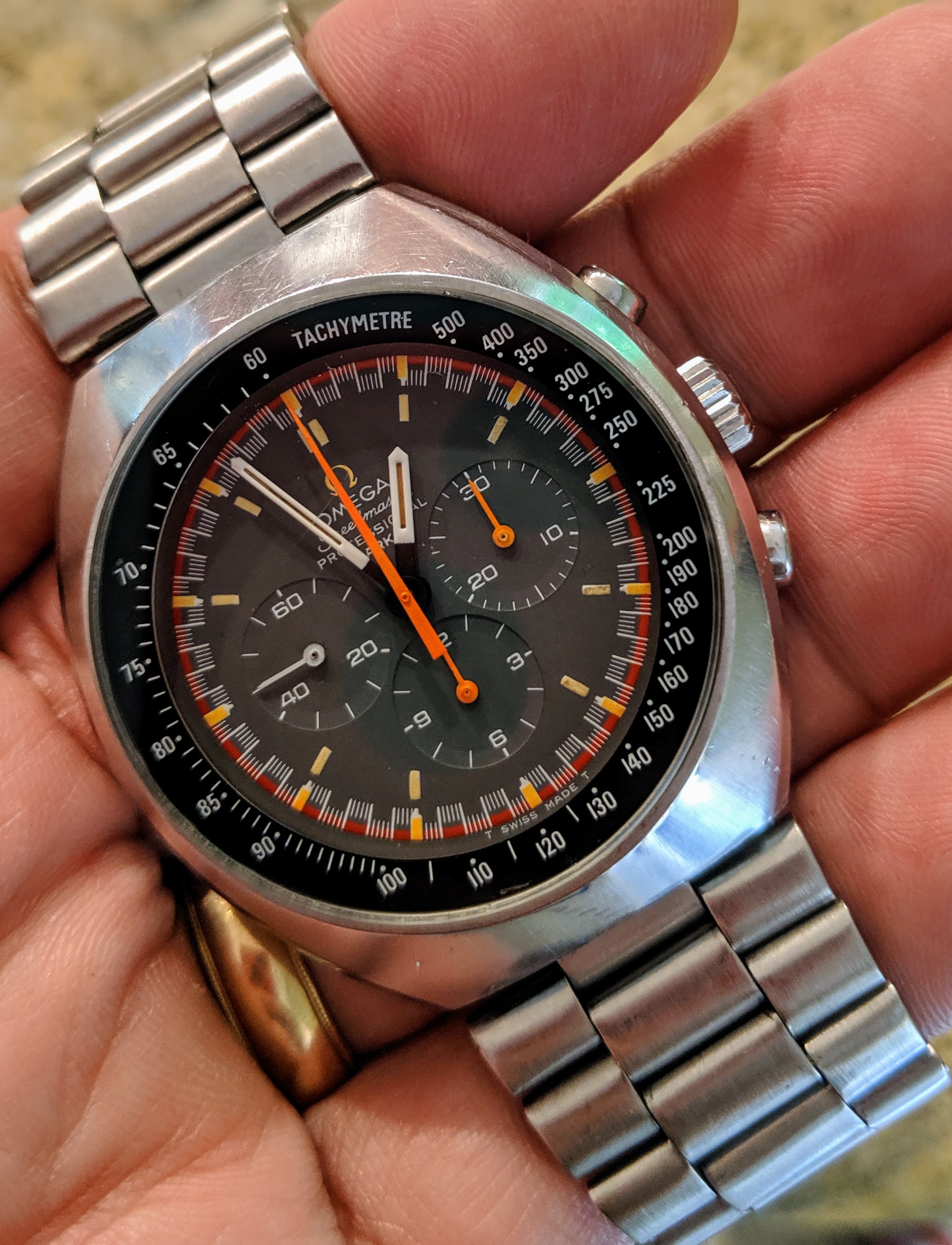

You should be able to buy a correct bracelet for $300 or so. Either below would be correct.

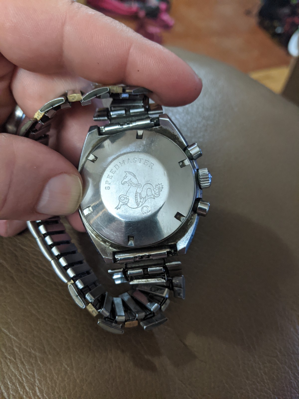

Also, get the serial number and look up at ilovemyspeedmaster.com to obtain delivery date. Could be 1969-1974 range.

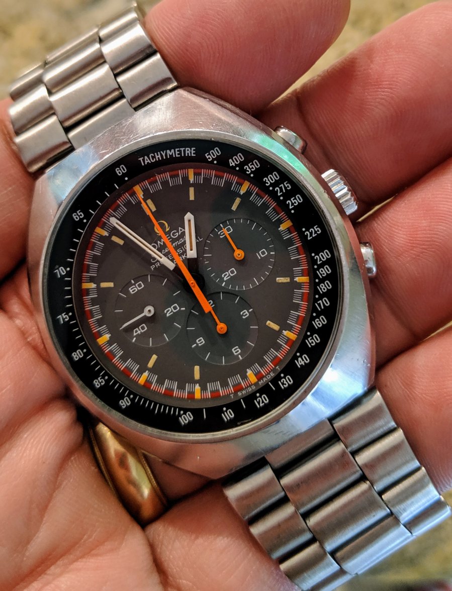

I was just basing the 5K on a quick google which displayed this one @ $5572.00CAD
https://www.chrono24.ca/omega/speedmaster-mark-ii-ref-145014--id13160616.htm
I realize that one looks like new and it has the proper bracelet but I really dont know anything about this hobby...
Out of curiosity, what do you guys figure a realistic price for this piece in this condition would be?

A collector would have the movement serviced and leave the rest alone. You can find the correct bracelet for sale on the secondary market. I am not an expert on this model, but if you are shocked by the cost of a service, you will probably be equally shocked by the price of the bracelet. I imagine it will be several hundred USD.

Since you are not a collector, I would suggest re:bracelet just find one you like and use that, rather than seeking an original. Especially if you're surprised at 500 for a service. That's actually quite fair if not on low end.
