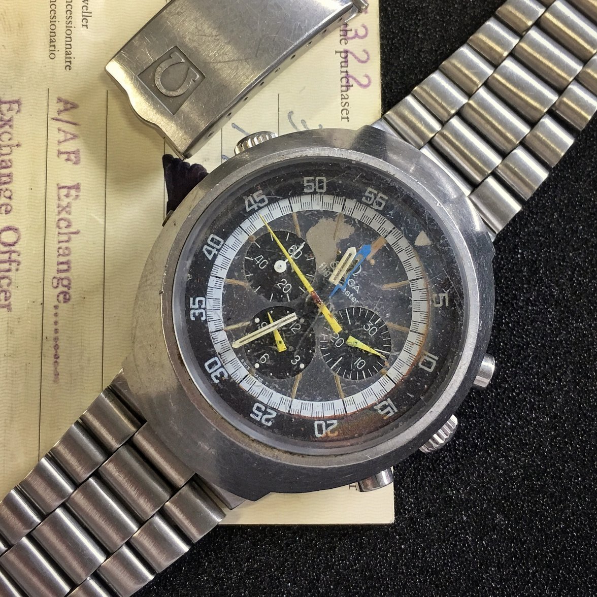

Here's one they've not touched yet, which sadly will need a new dial and hands because of the water damage and rust... it's not pretty in there:
