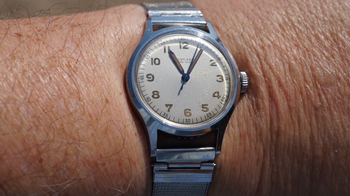

Possibly a cousin...
Very nice watch whomever is responsible.
Perseverance, patience and gut instinct.....congratulations.

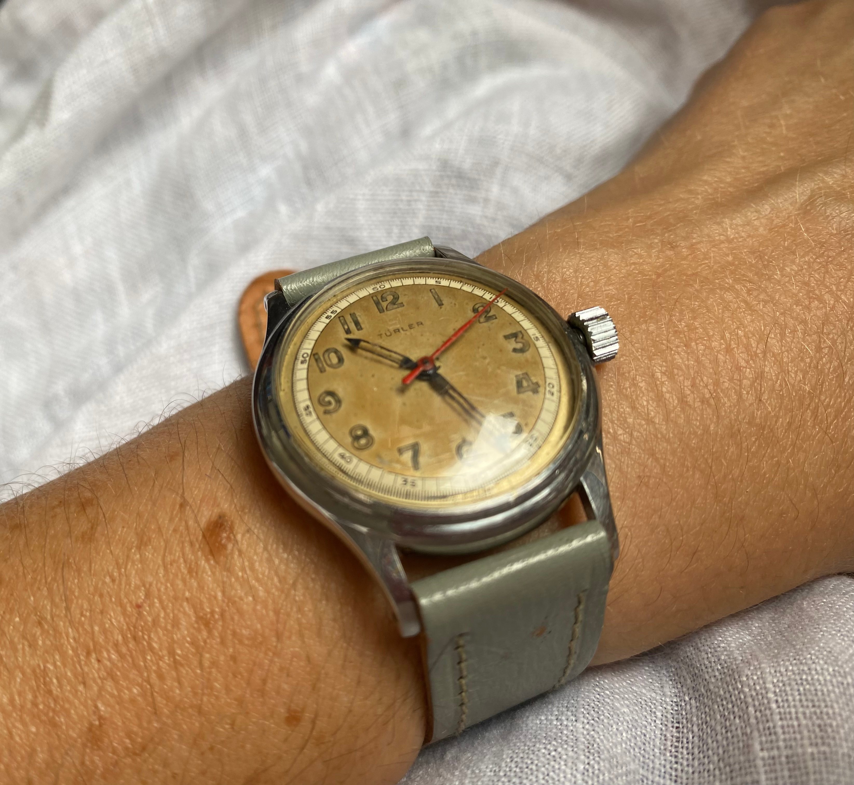

I’m now very curious to see what movement it has inside. Someone on Instagram indicated he has a Turler branded watch which has a Roamer movement inside.
I nearly raced to my watchmaker to get it opened but I already biked 15km earlier today, so I decided to be a bit more patient.
Thanks @Plees, it’s pretty scratched up but I don’t really mind. I appreciate watches that have been put to good use and frankly find a bit ridiculous some people’s repeated gloating on the social networks (not here thankfully) about their supposedly “NOS” watches.
Hah, NOS! I rarely see really NOS these days, mostly over polished, used, but promoted to unused to get a better sell.., nothing wrong with a bit of patina, specially with real vintage watched like your Türler! Great catch!

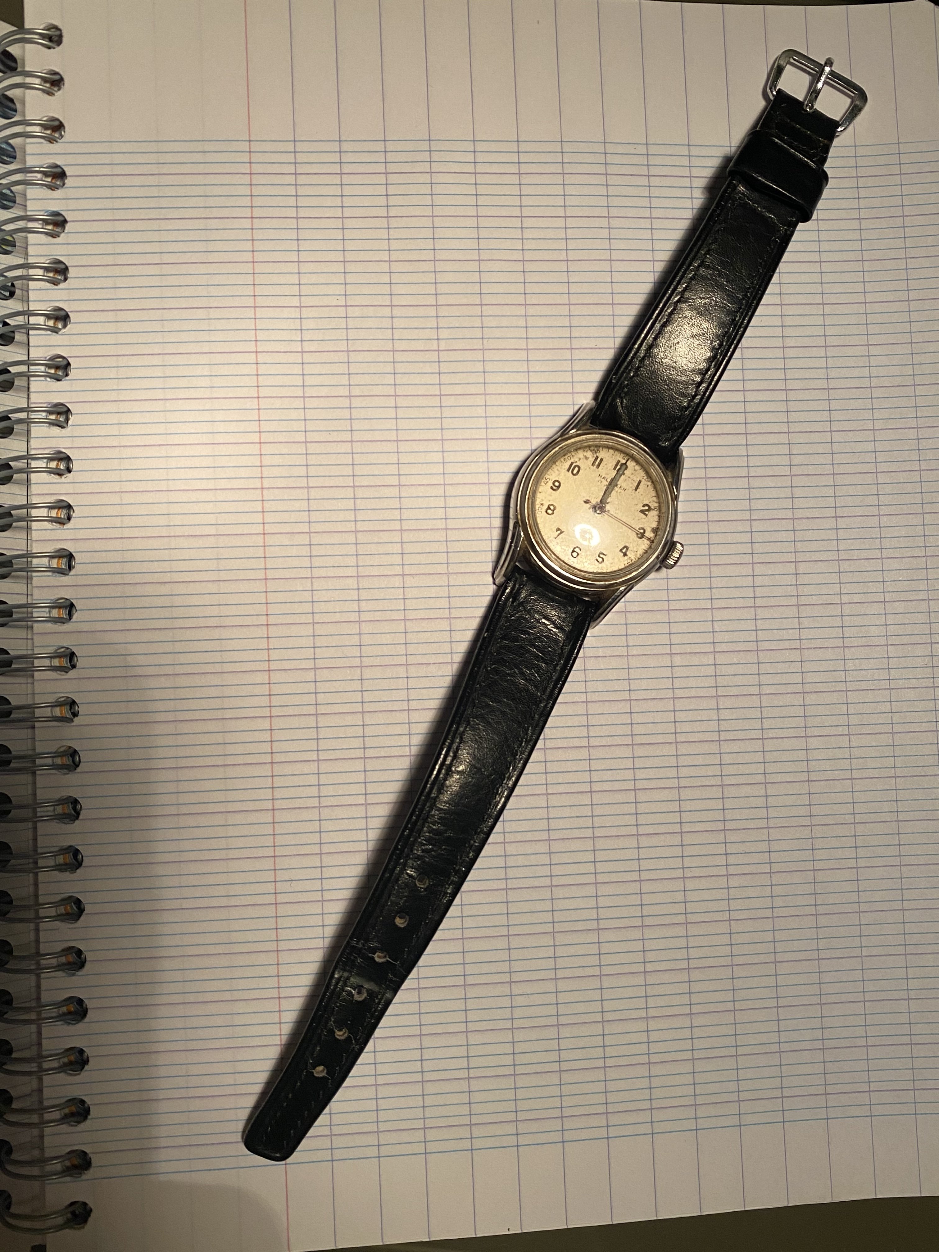

And now it even has a vintage watch strap from that era. The strap is currently missing a keeper and has a couple flaws but I like the looks (if you forget the awful replacement crown for the moment).

Big radium Arabic numbers, screw in case, what’s not to like…
Eager to see what movement is hiding there !

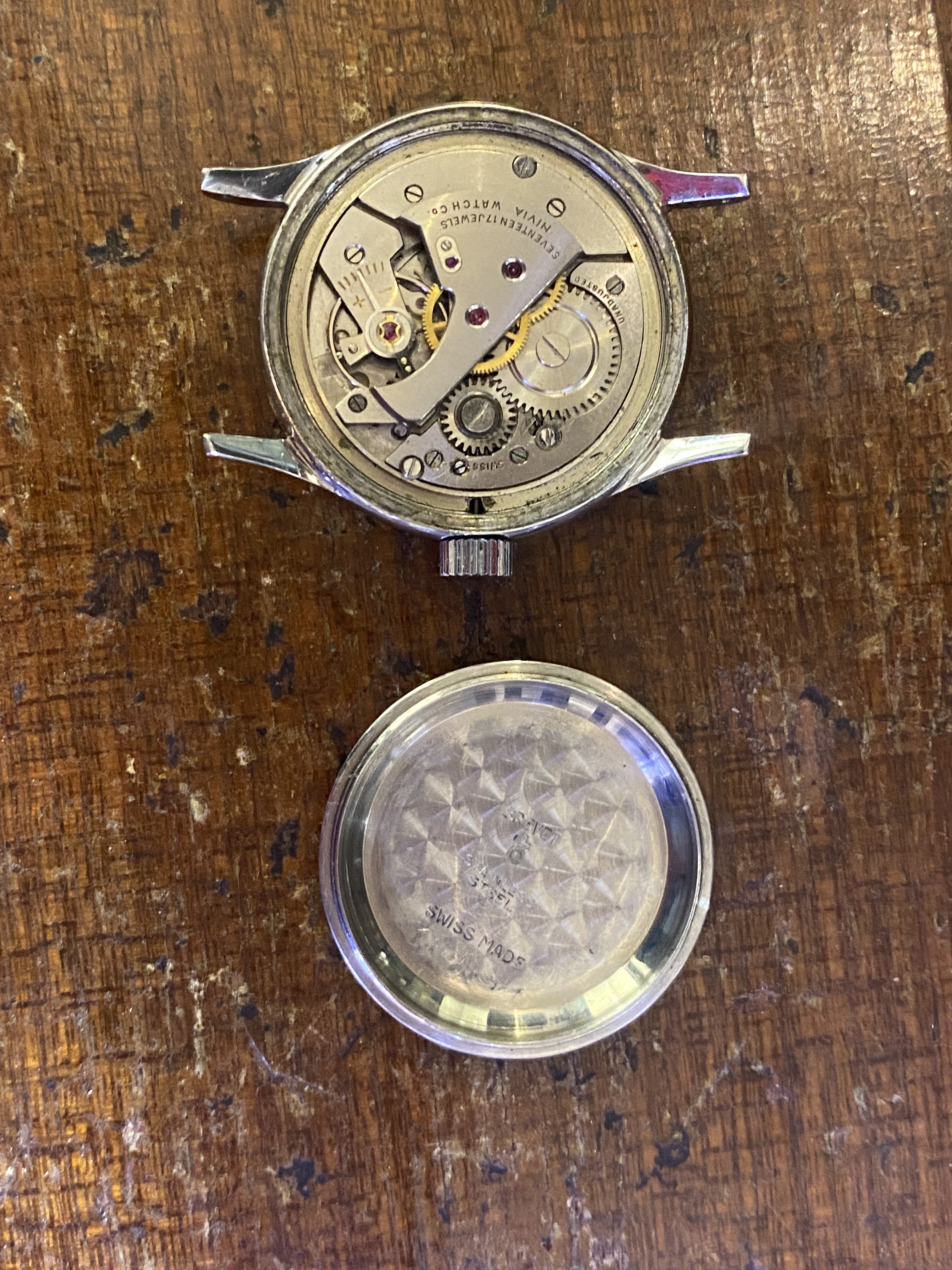

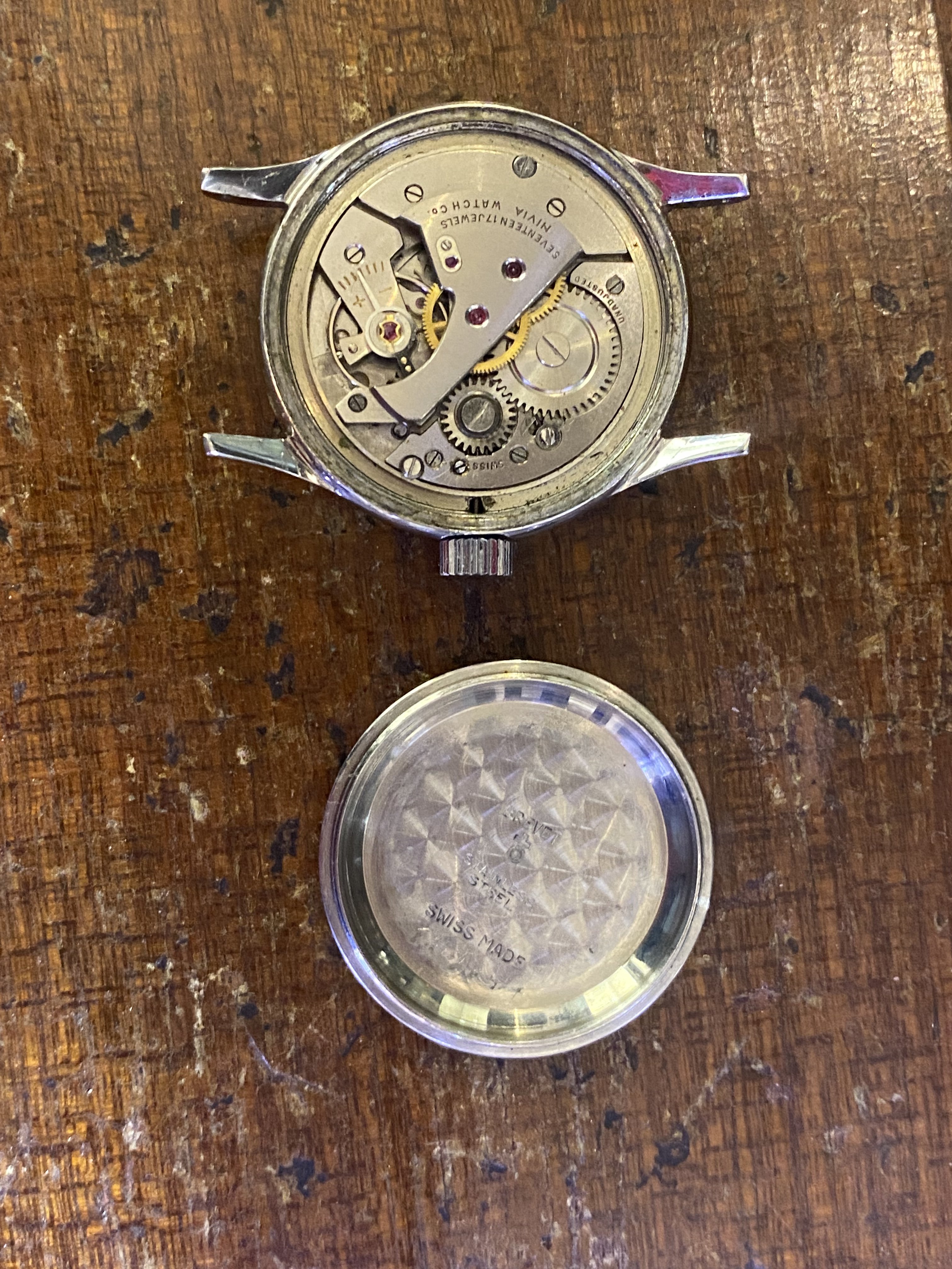

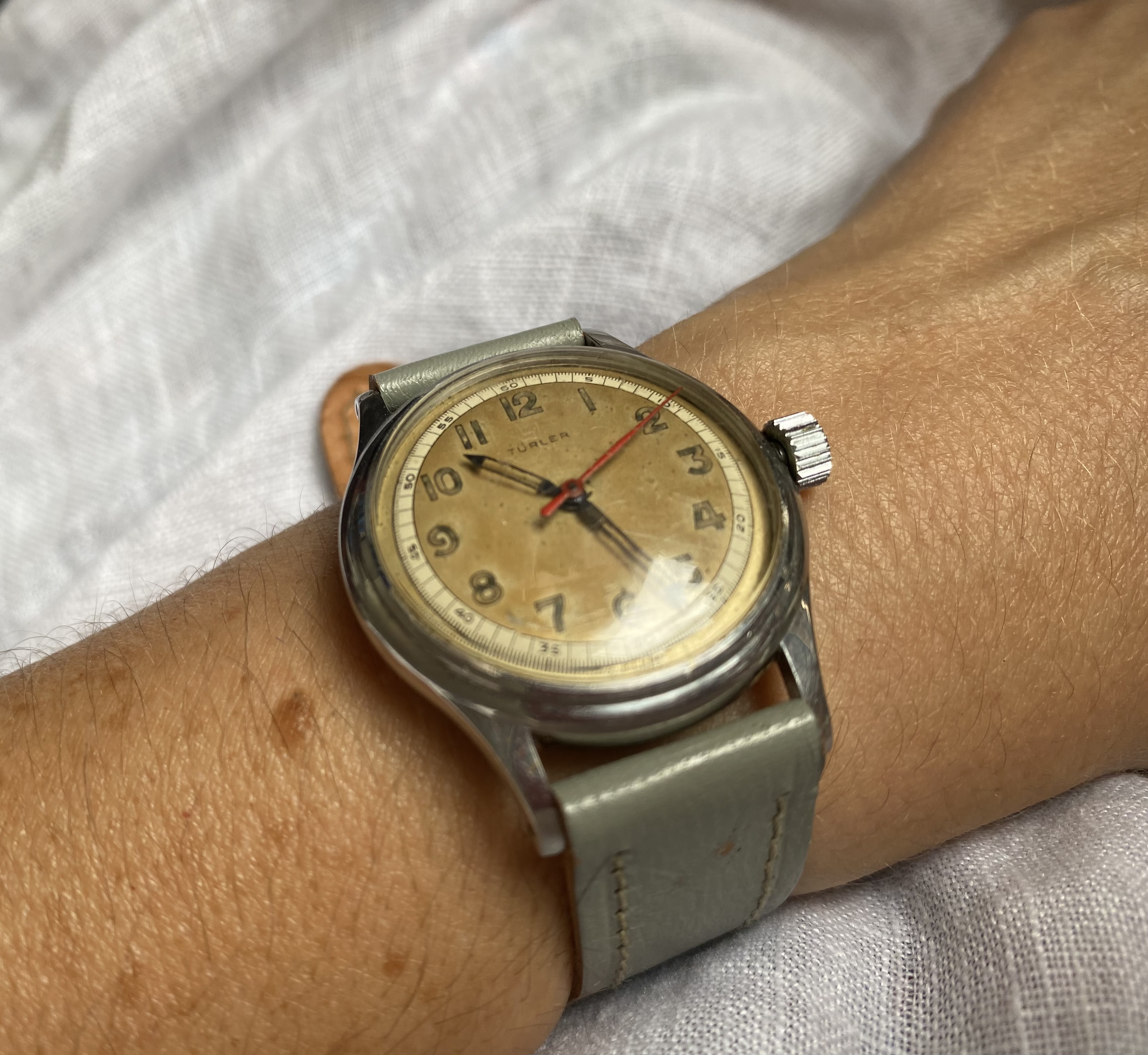

Well, dear @Servius and everyone, it took time but we finally know what’s inside that Turler branded watch.
It’s a movement marked “Nivia watch Co”,
One of our good forum pals here and experienced collector extraordinaire told me privately Nivia made some nice watches, and that the movement looks like an “A. Schild base caliber”.
Interestingly of course, there’s a patent on that very nice waterproof case.

The movement is either an A Schild 1187, or 1194, depending in diameter. These movements were found behind dials with countless names, as it was a very popular movement. Reliable, rugged, easy to service. These two movements were made in the millions, so it is not rare. NIVA didn’t actually make any part of the watch. It was like countless others of its sort, generic, produced form off-the-shelf parts. Mikrolisk doesn’t give any information on the NIVA name.

If you’d look for Nivia, you will find multiple hits😉
7,690
22,055
Thanks @Canuck, Mikrolisk does list “ Nivia SA” in Biel, which is the same brand as is written on this watch. Regardless, I think it’s a neat little watch, and I really like its screw back case.

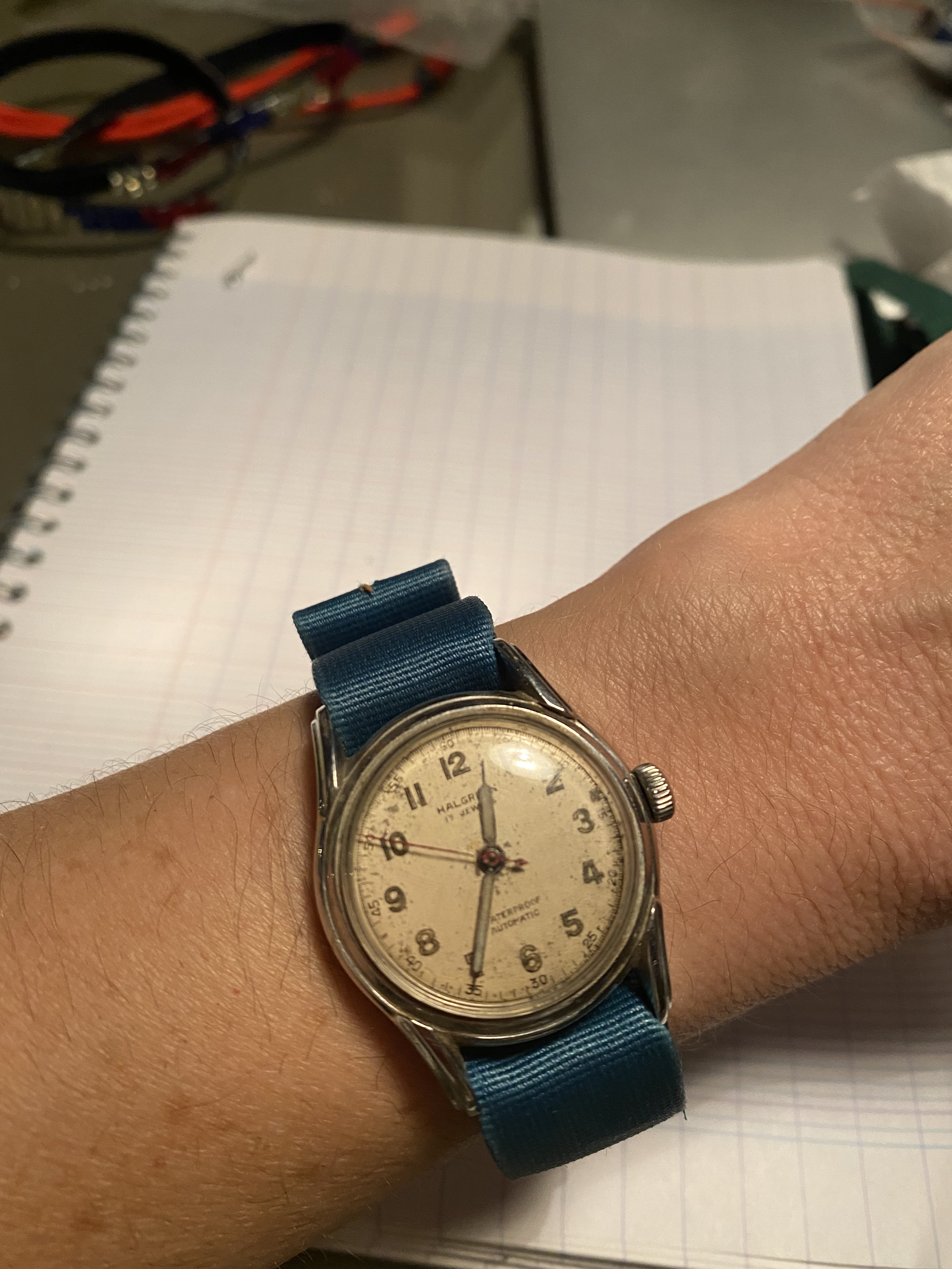

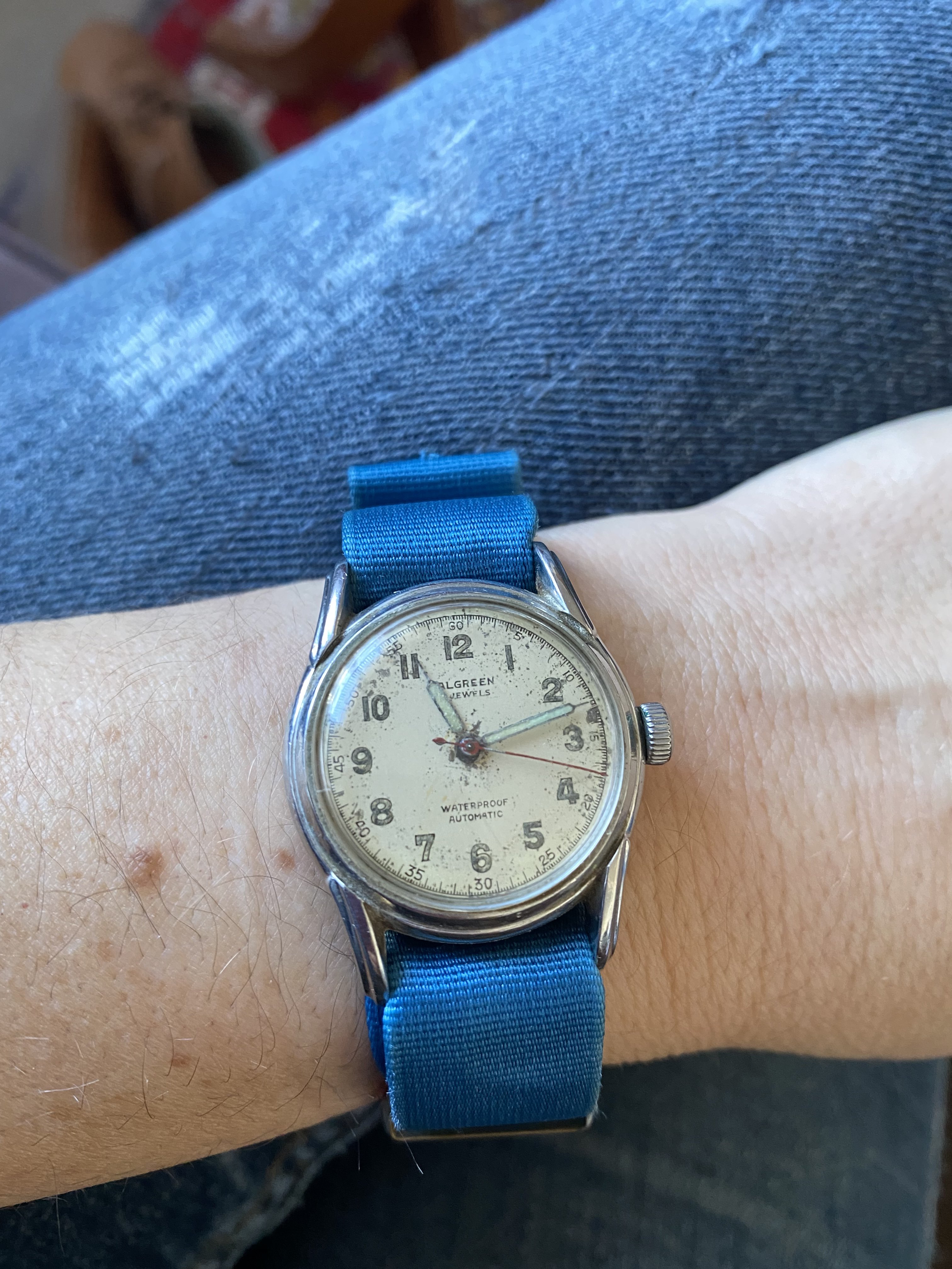

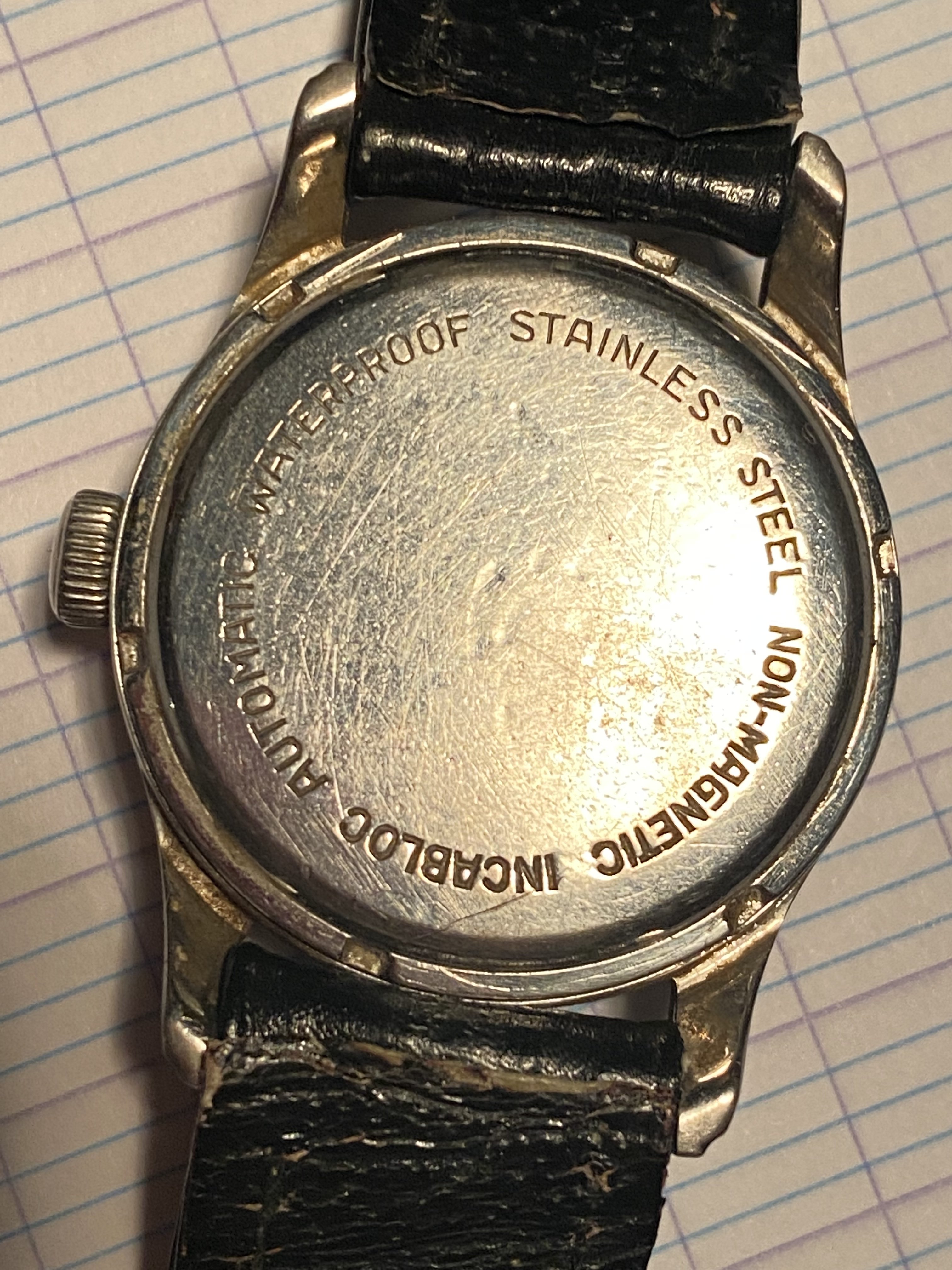

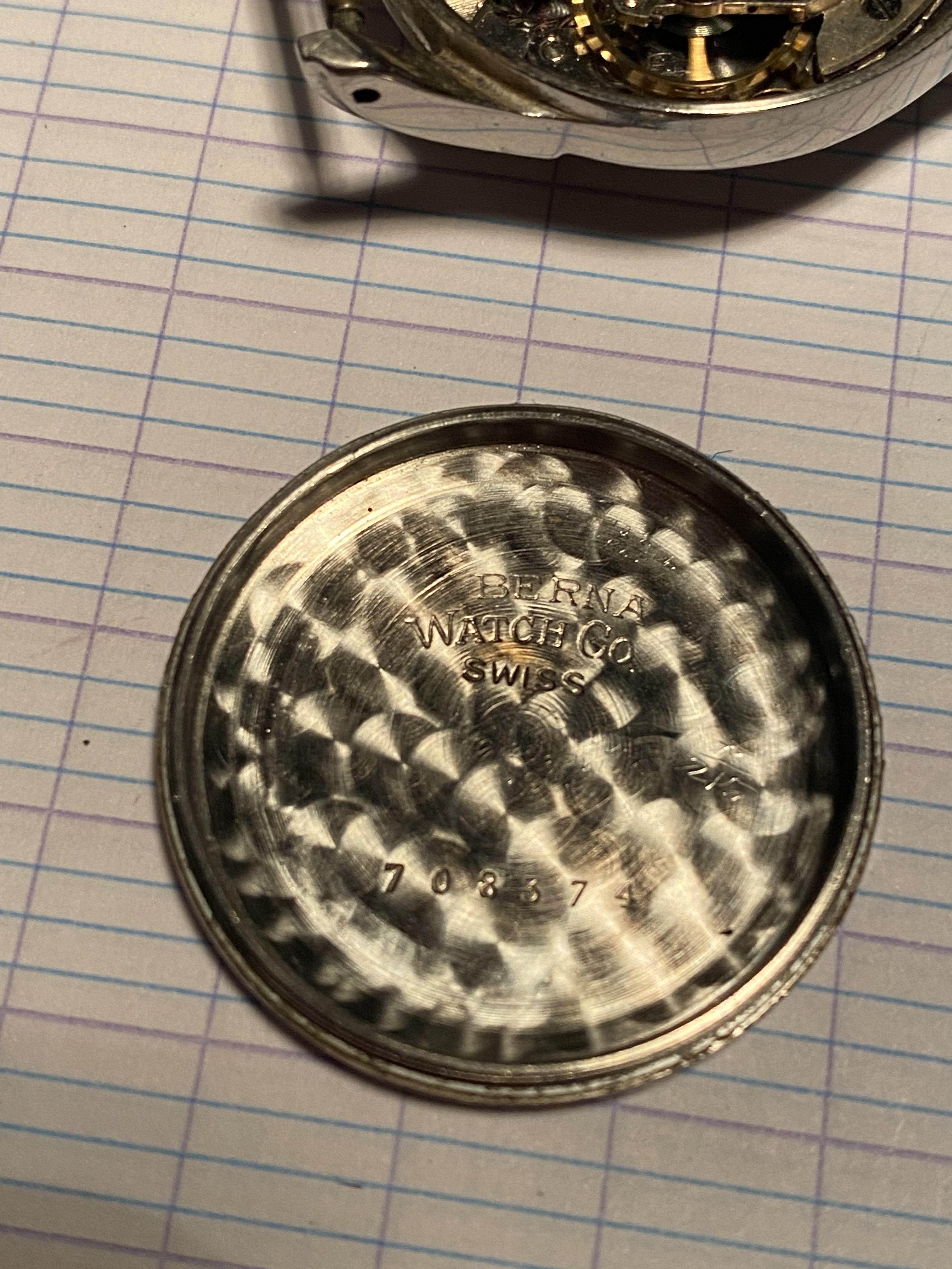

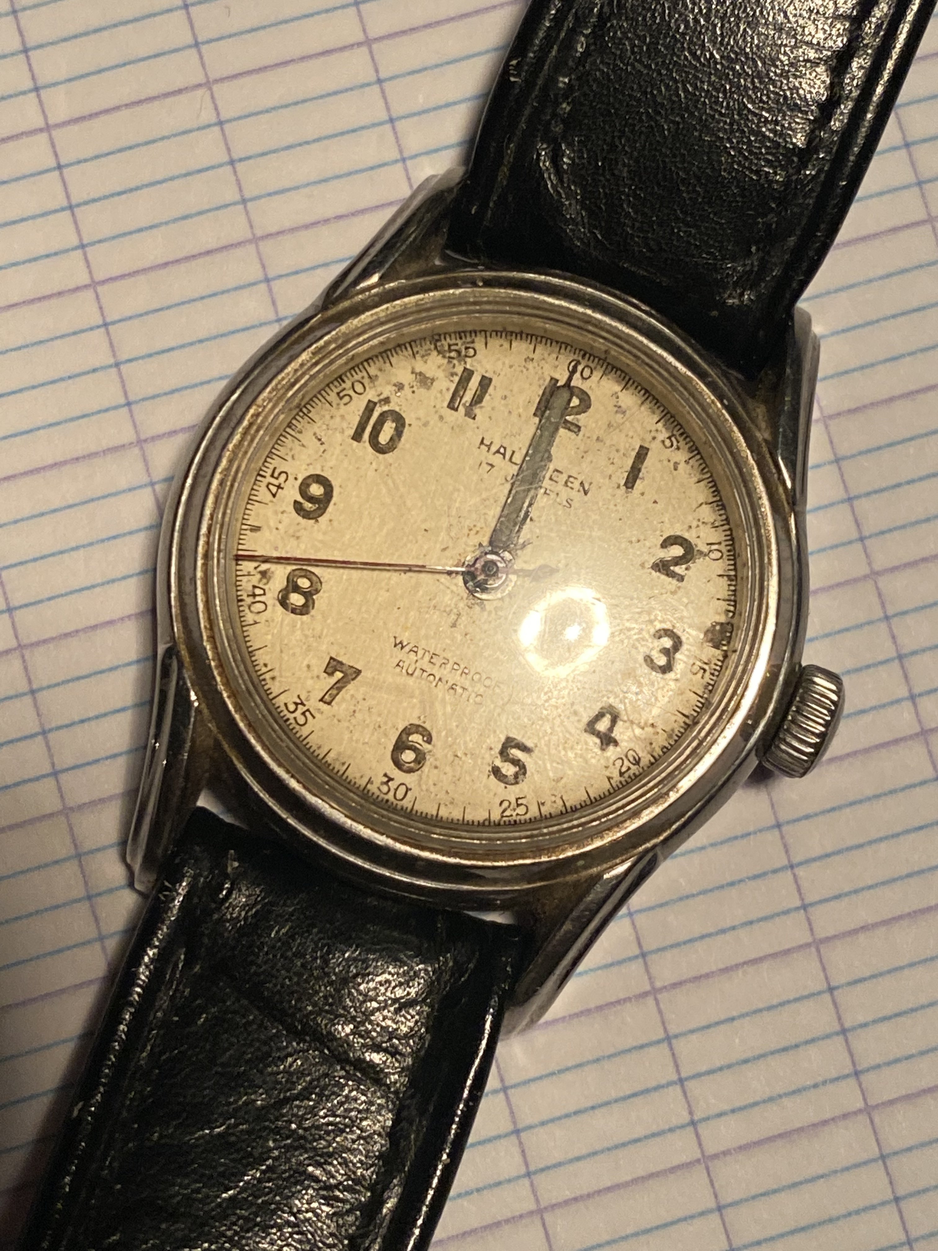

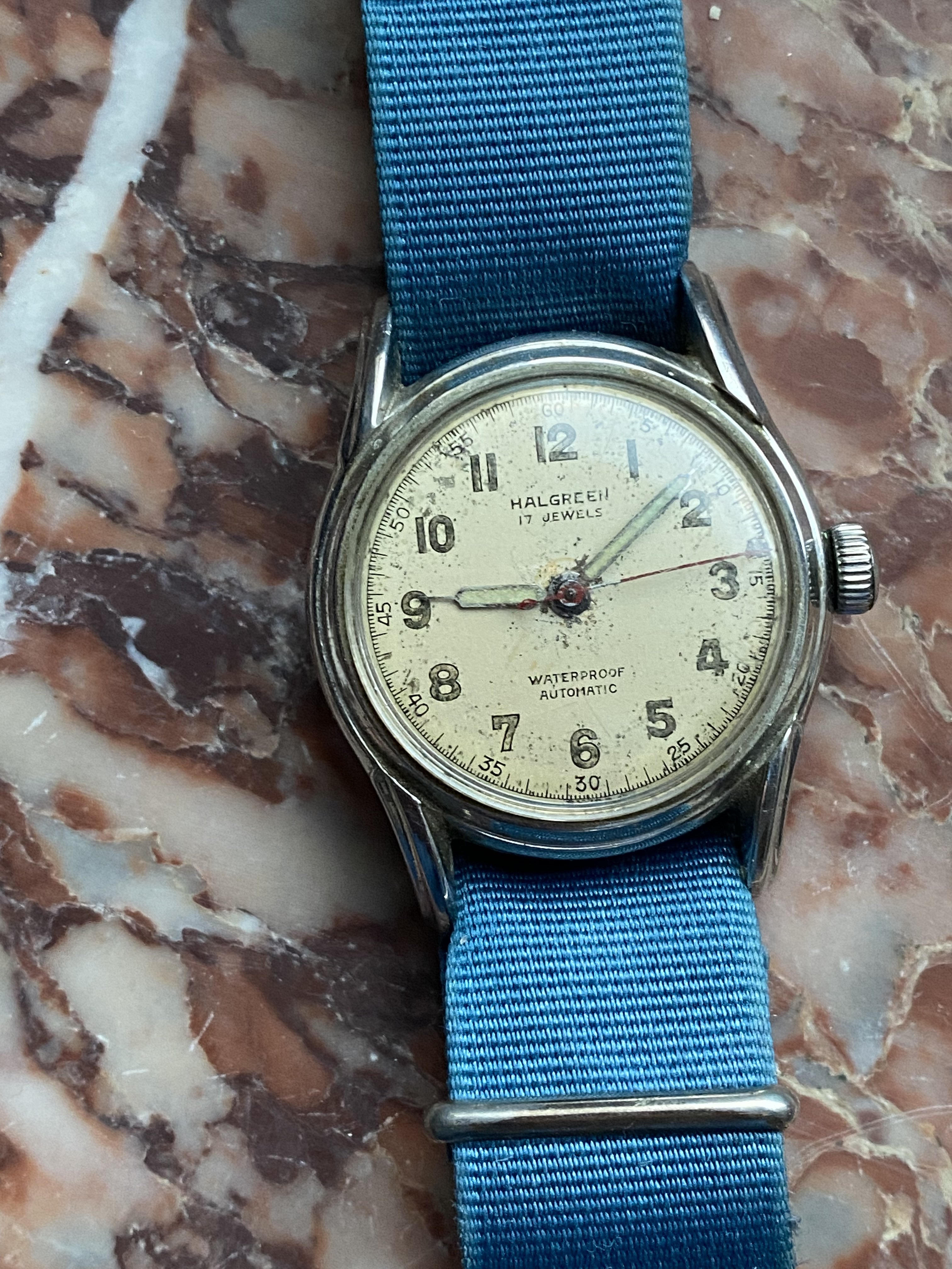

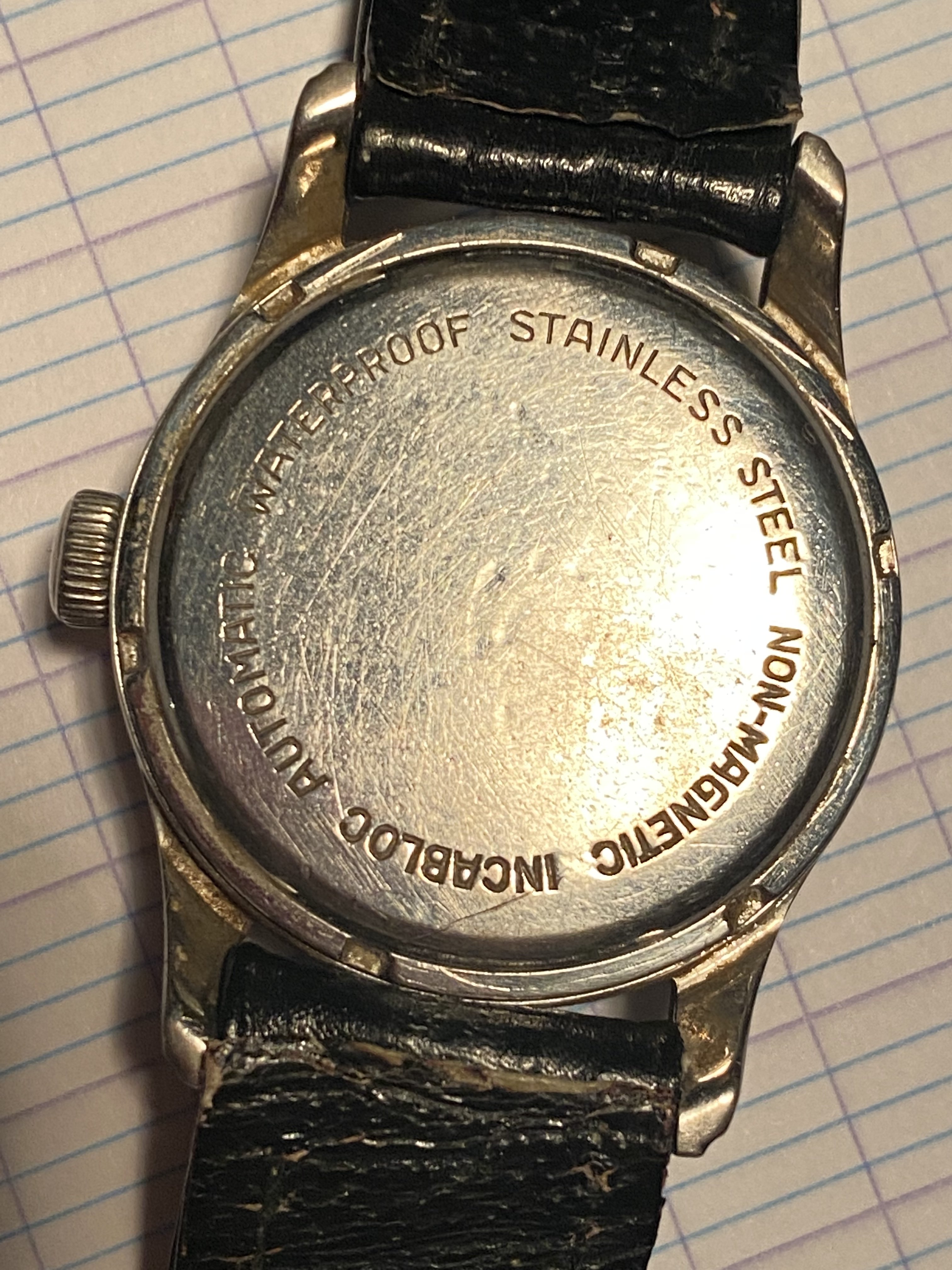

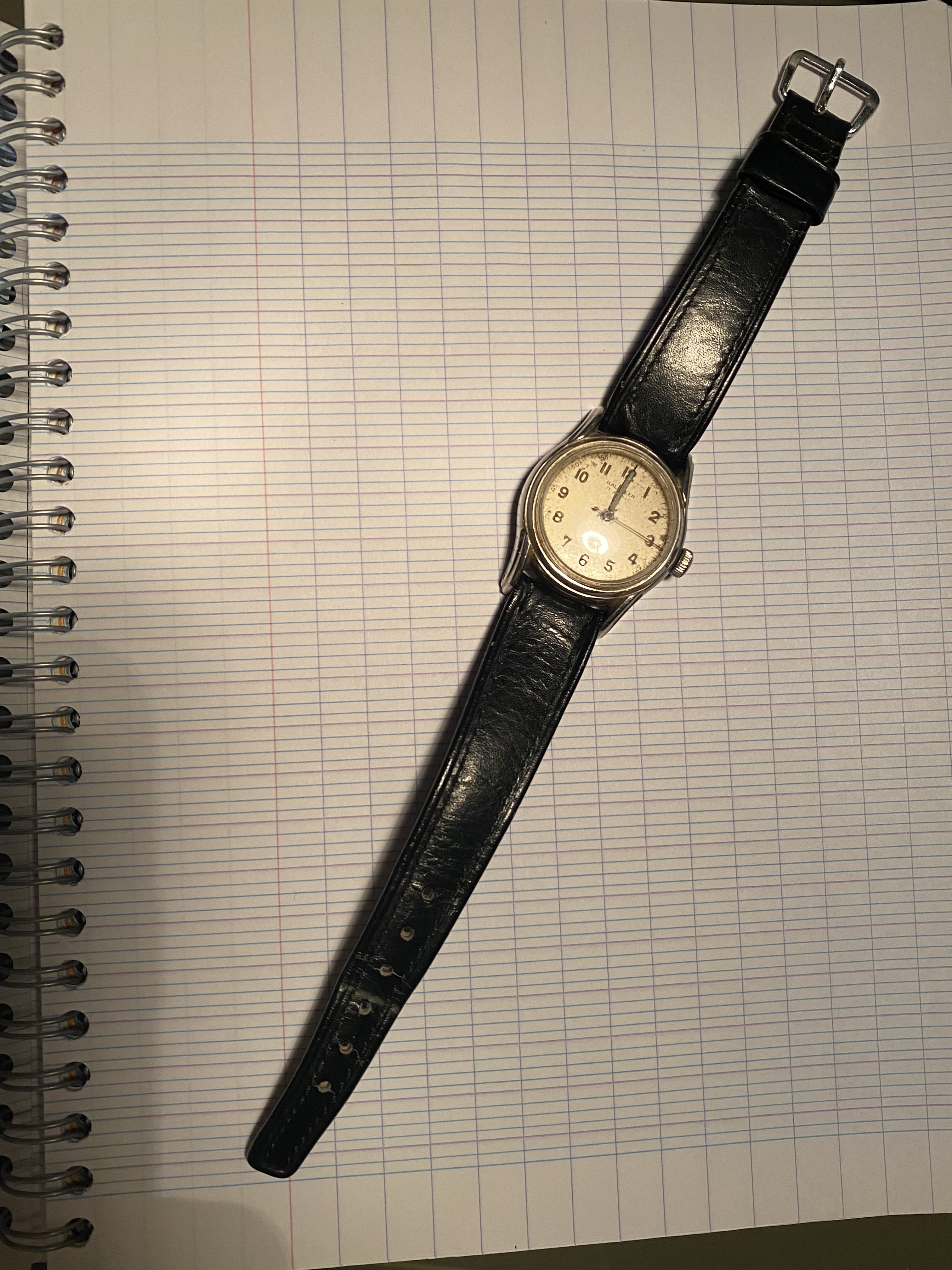

So here’s another surprise find in the department of “obscure yet good quality old watches” rescued from the 1940s era. Maybe early 1950s in this particular instance.
Another surprise is that it comes from the bottom of a closet where I was hunting for packing material. I’d forgotten I’d thrown in there a bag of old watches a member on another forum had insisted on sending me so I can play with them and take them apart. Most were cheap, broken redials from the 1920s to the 1960s. Suddenly I realized this one seemed salvageable. A steel screw back case with nice late 40s lugs, as I take it in my hand to look at it, voooof, there it starts running. Yes there’s an ugly relume on the hands, the branding “Halgreen” appears obscure, I can’t quite tell if the dial is refinished or a bit coarsely made, but it’s marked “swiss”, 17 jewels, waterproof and automatic.

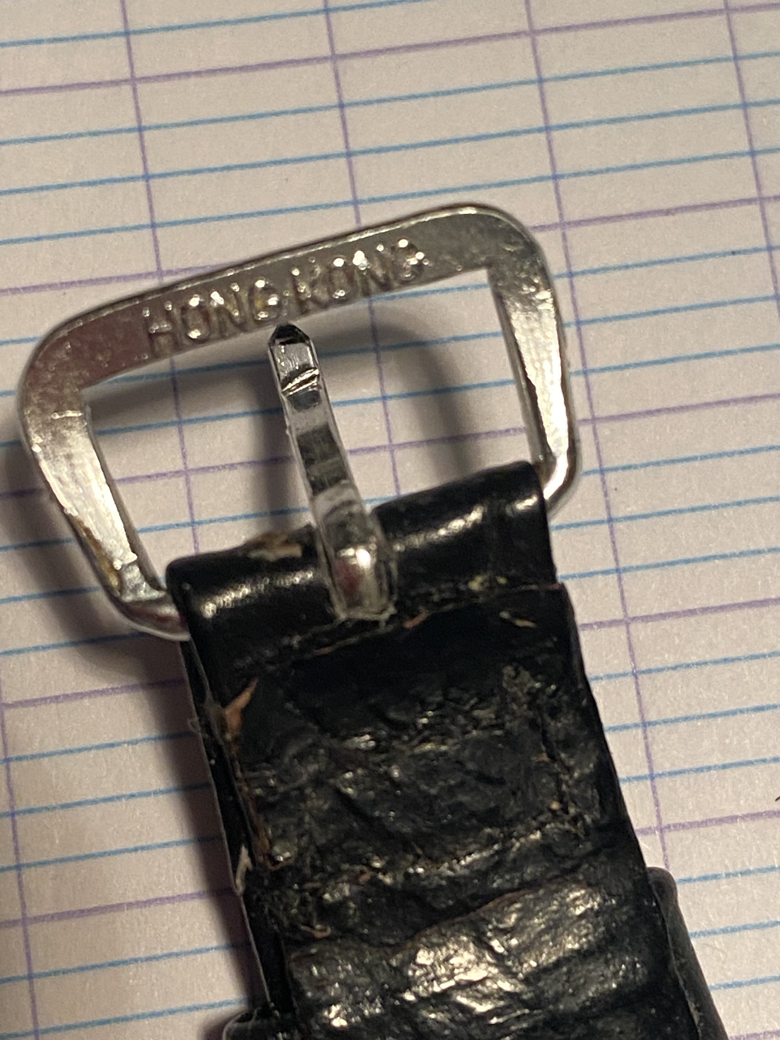

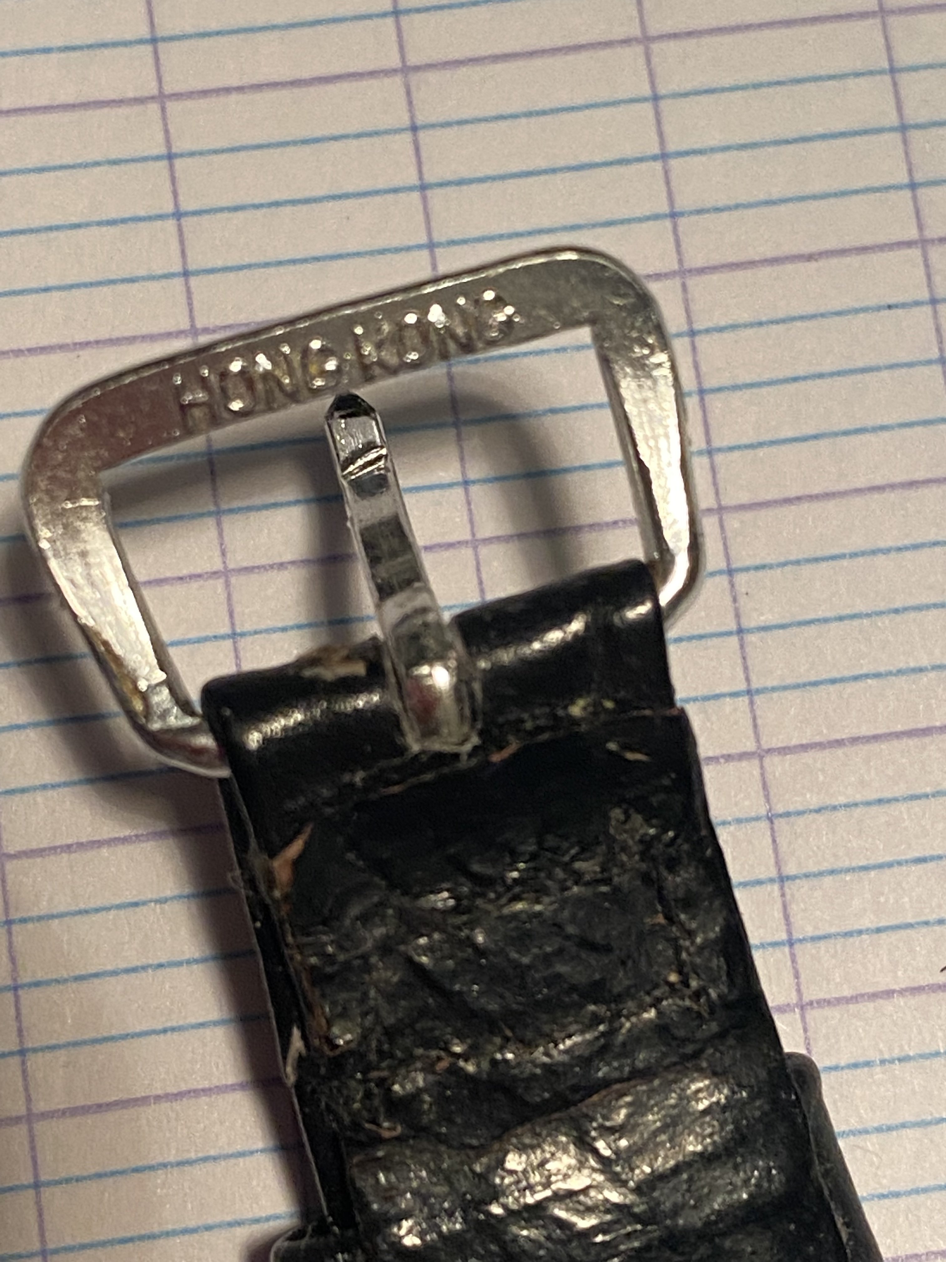

I’m stunned to see the buckle is marked “Hong Kong” on the 1950s strap.

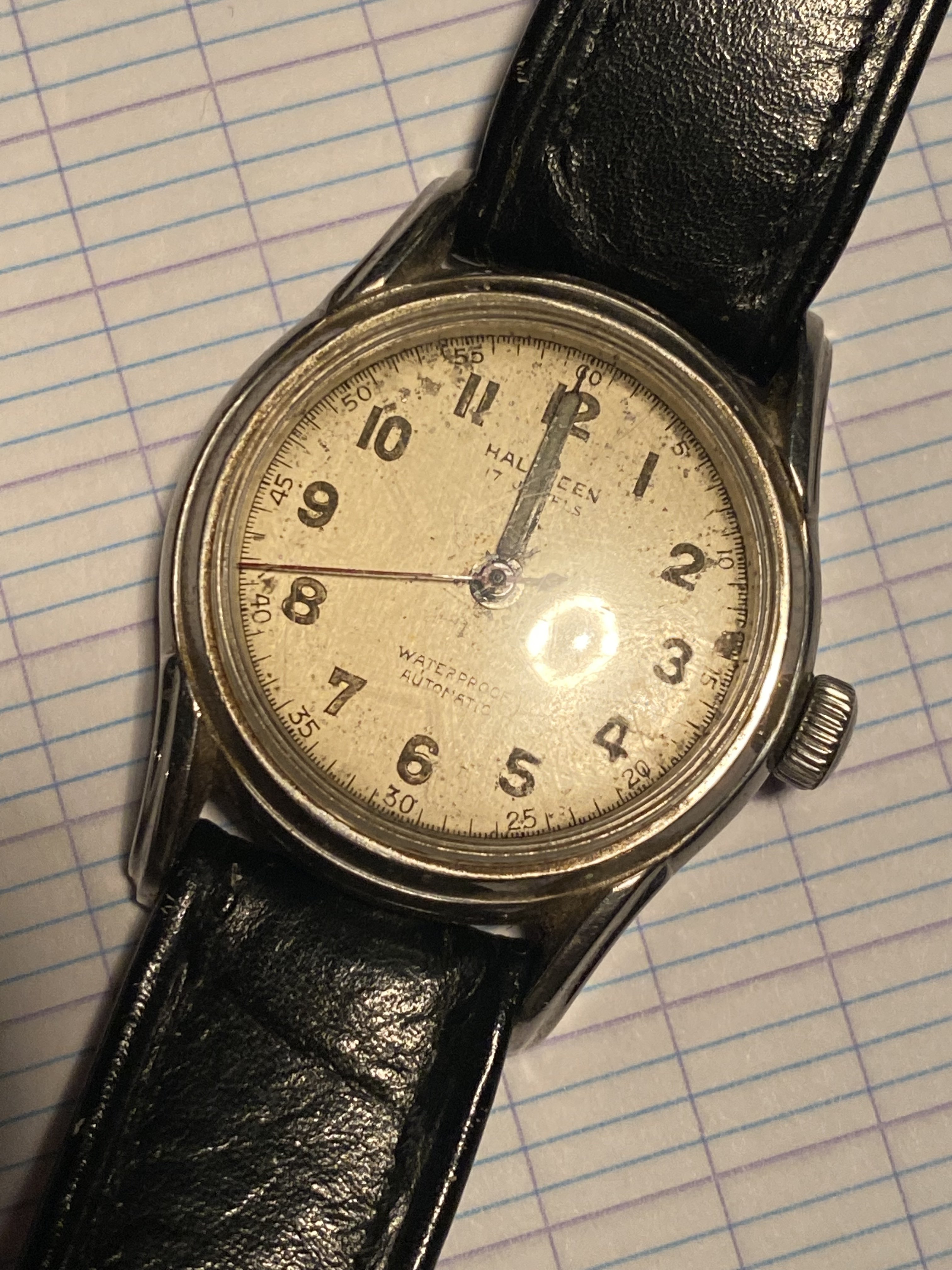

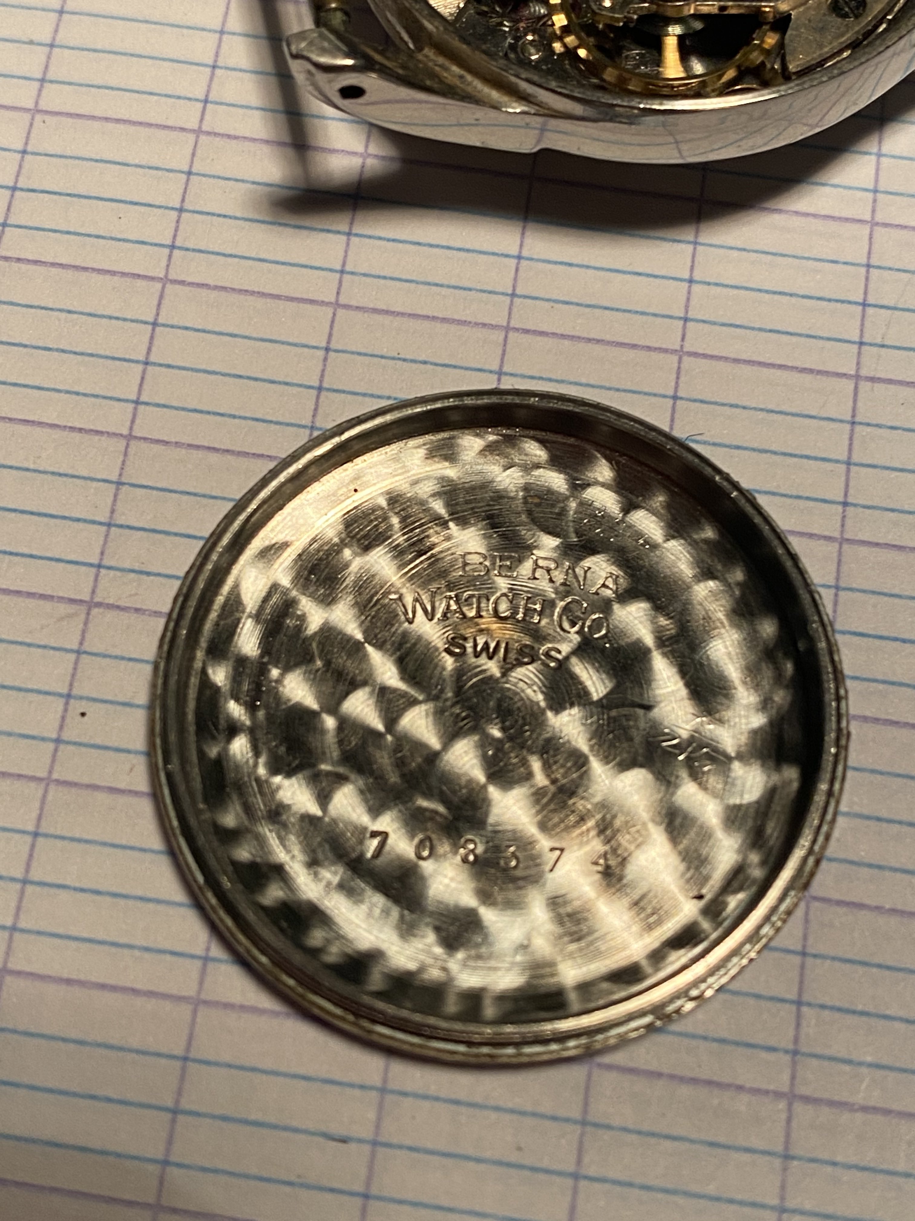

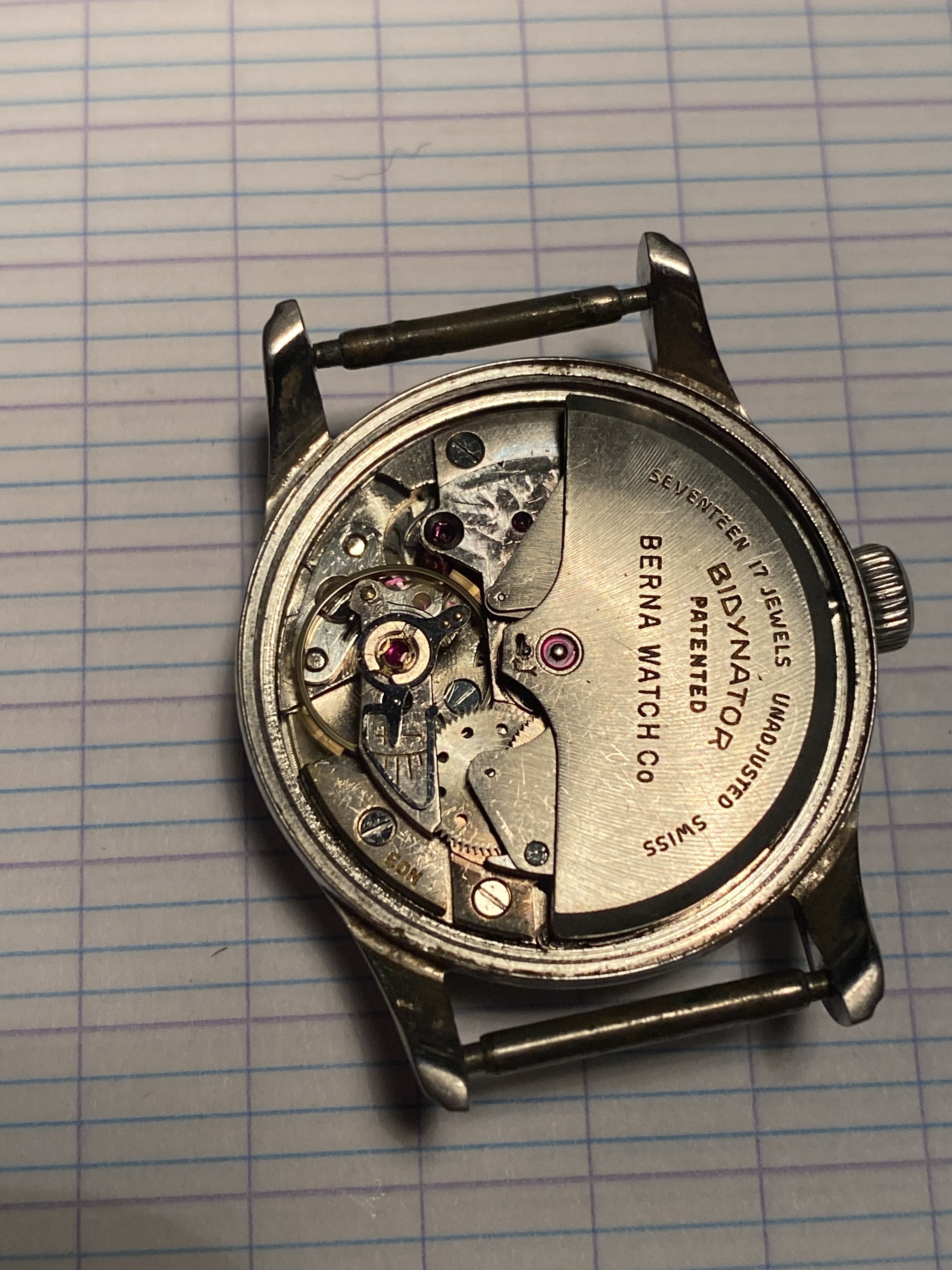

Now to what’s inside the watch. A case marked “Berna Watch Co”, and a movement with the same name and a “Bidynator” marked rotor. It’s now officially on probation, with a new strap of course.
18,835
39,170
An interesting piece @Syrte.
As you may know, the Bidynator was the world's first successful bi-directional rotor winding automatic watch and was produced by Felsa, not "that other company".
I think it's a Felsa caliber 690, it may be marked somewhere.
Interesting again is the US import marking on the balance cock. It looks like "FON" which was Fewa Watch Company of New York who were probably a company selling multiple brands at the time.
The Felsa automatics from the 690 family were used in many Swiss brands during the 1940s/50s/60s.
So you have a watch with many connections, Berna, Felsa, Hallgreen and Fewa.

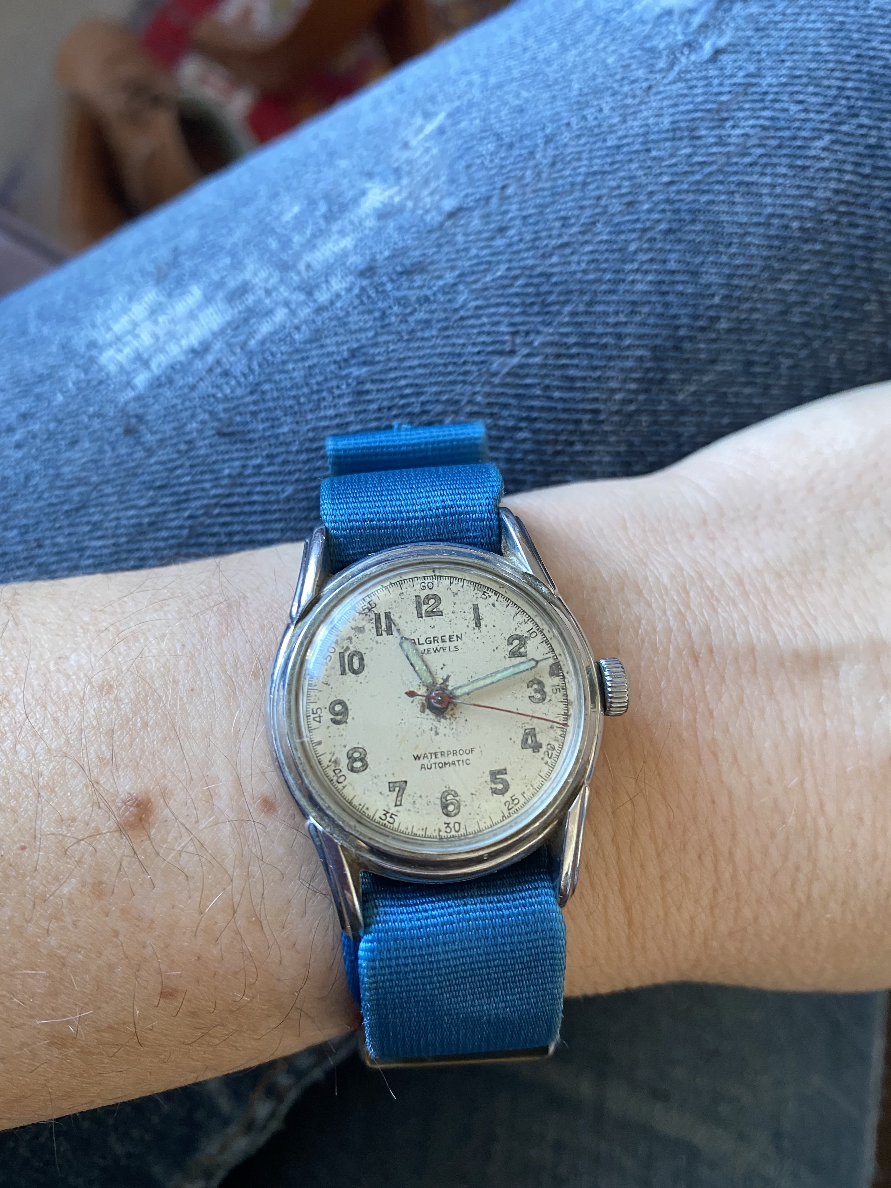

EON is "Avalaon", whoever they are. Definitely EON when you zoom it up to the largest pic (click it twice).
You're right, I thought it was an F.
Avalon/Calvert was probably another of the many American "watch companies", mostly based in New York, who were satisfying huge demand for imported watches in the post WWII boom period.
Many thanks dear gentlemen, I learned something—I had no idea the Bidynator had supplanted that “other company” which claimed to have invented the automatic movement as well as the waterproof case.

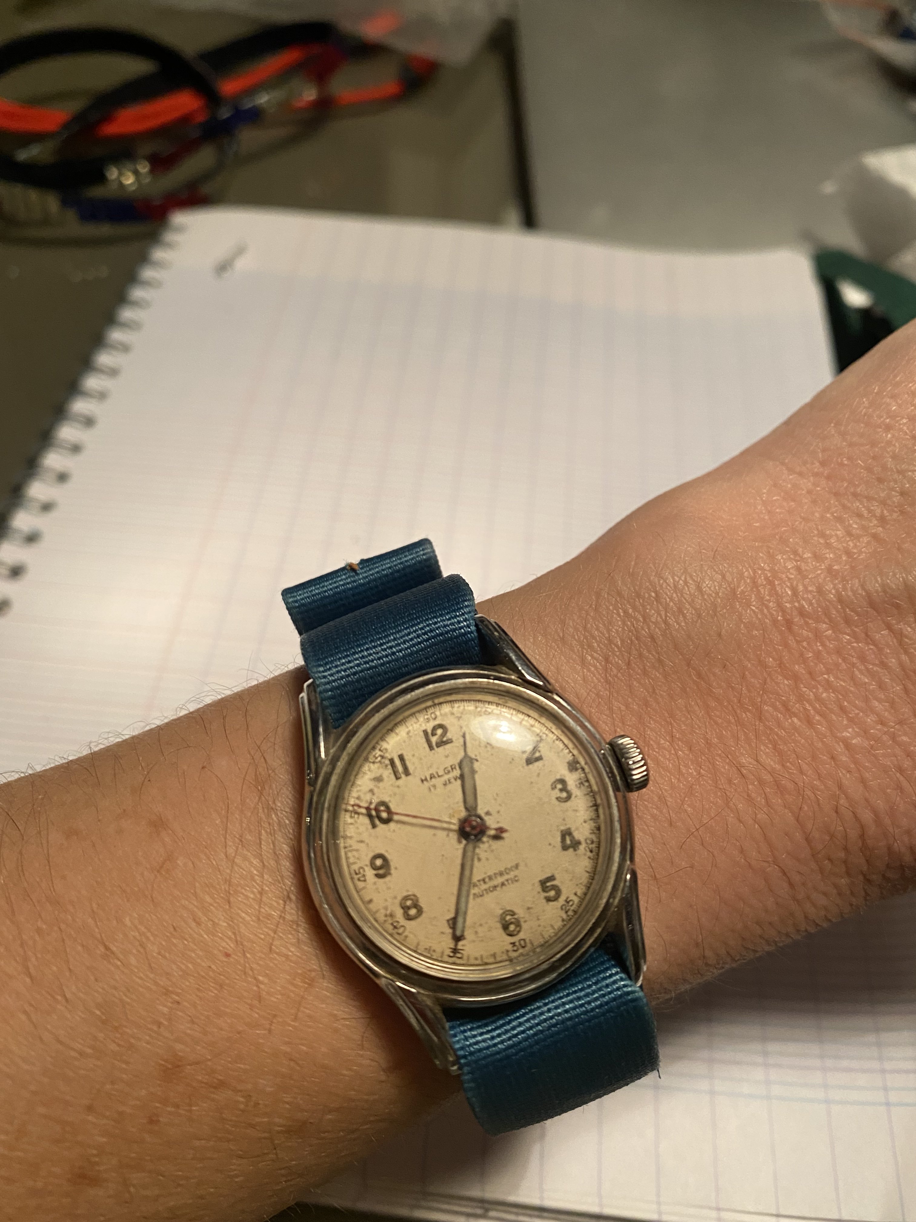

Quite amazingly this little tool here has been doing its job super well and keeping excellent time, it’s a bit of a pity the lume is so ugly and the dial is scratched up….I think the dial might be original, it has fine serifs despite some uneven indexes and the “W” in “waterproof” slightly more inky.

Mikrolisk records the wordmark Halgreen (along with Savillon and Zelia) as registered by Halgreen Inc, New York, on May 31, 1945.
Very interesting, many thanks. I may offer the watch in trade to my watchmaker for something else….

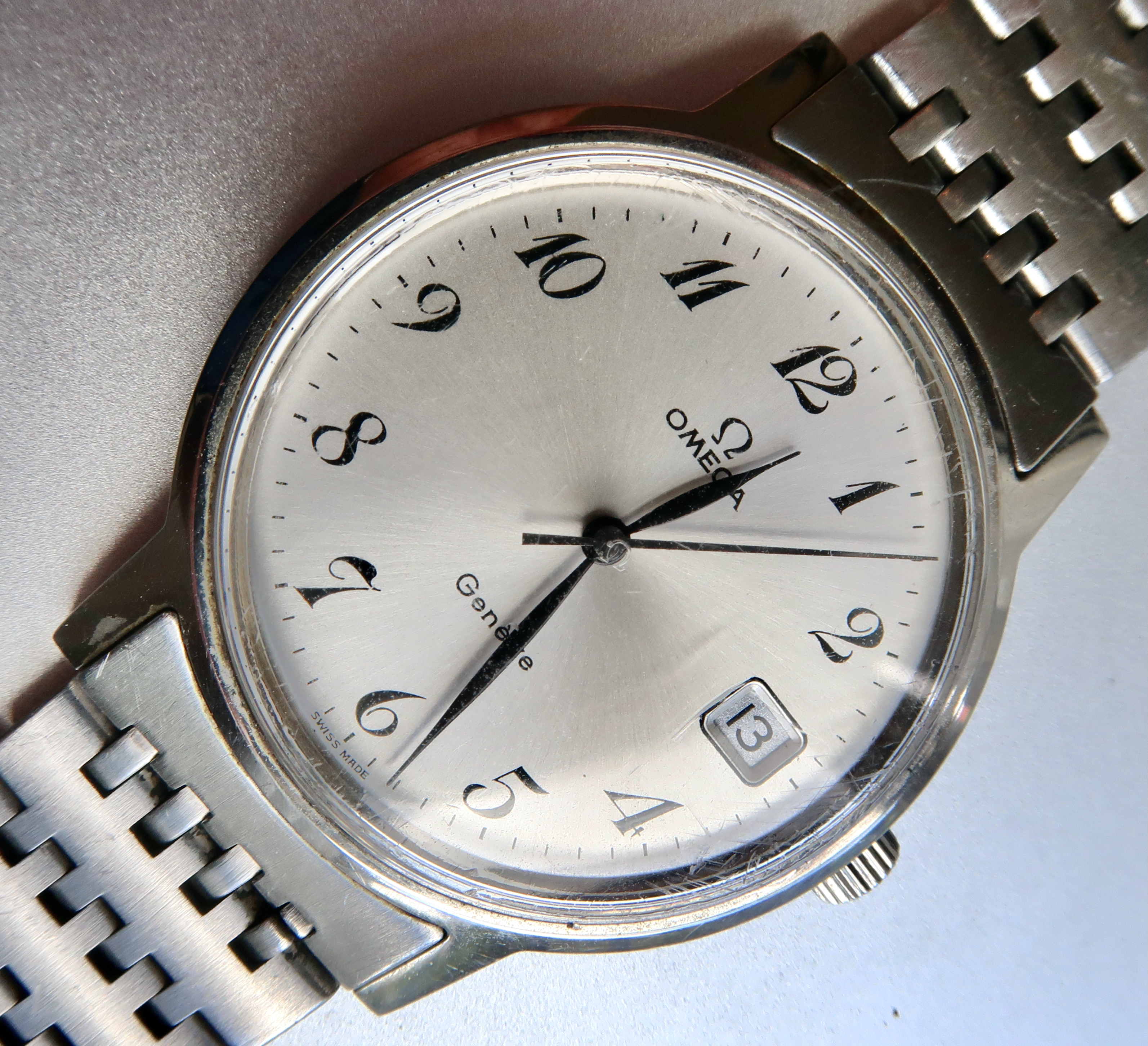

My bargain hunting wife just came home with this, from a friend who picked it up in a charity shop for $A100. 35mm case, Cal 1030 from 1972, in remarkable condition.
