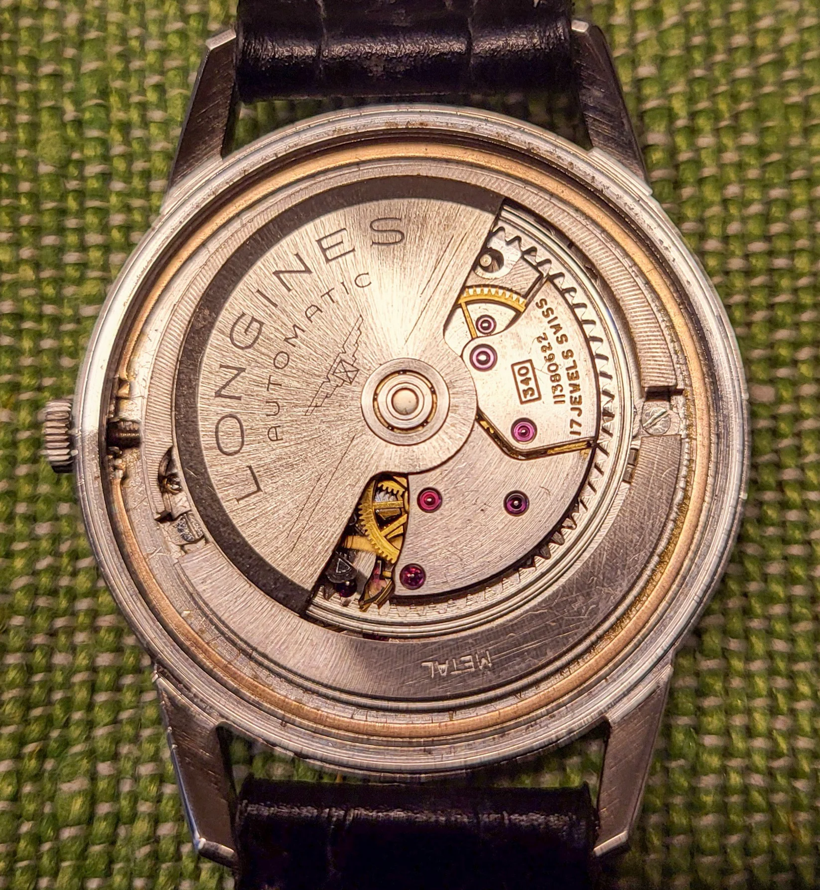

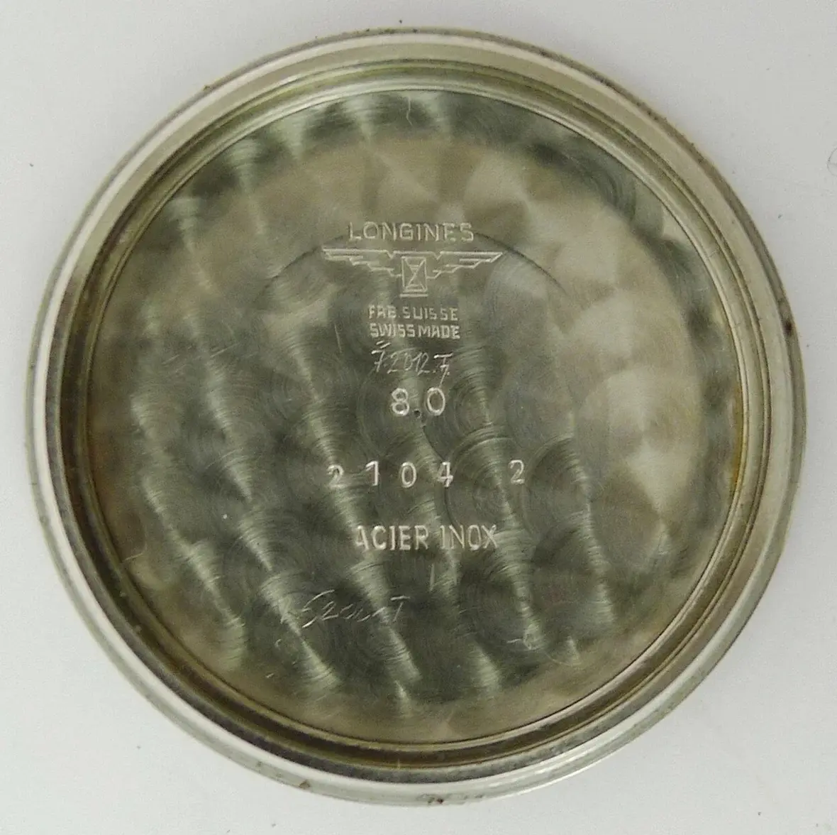

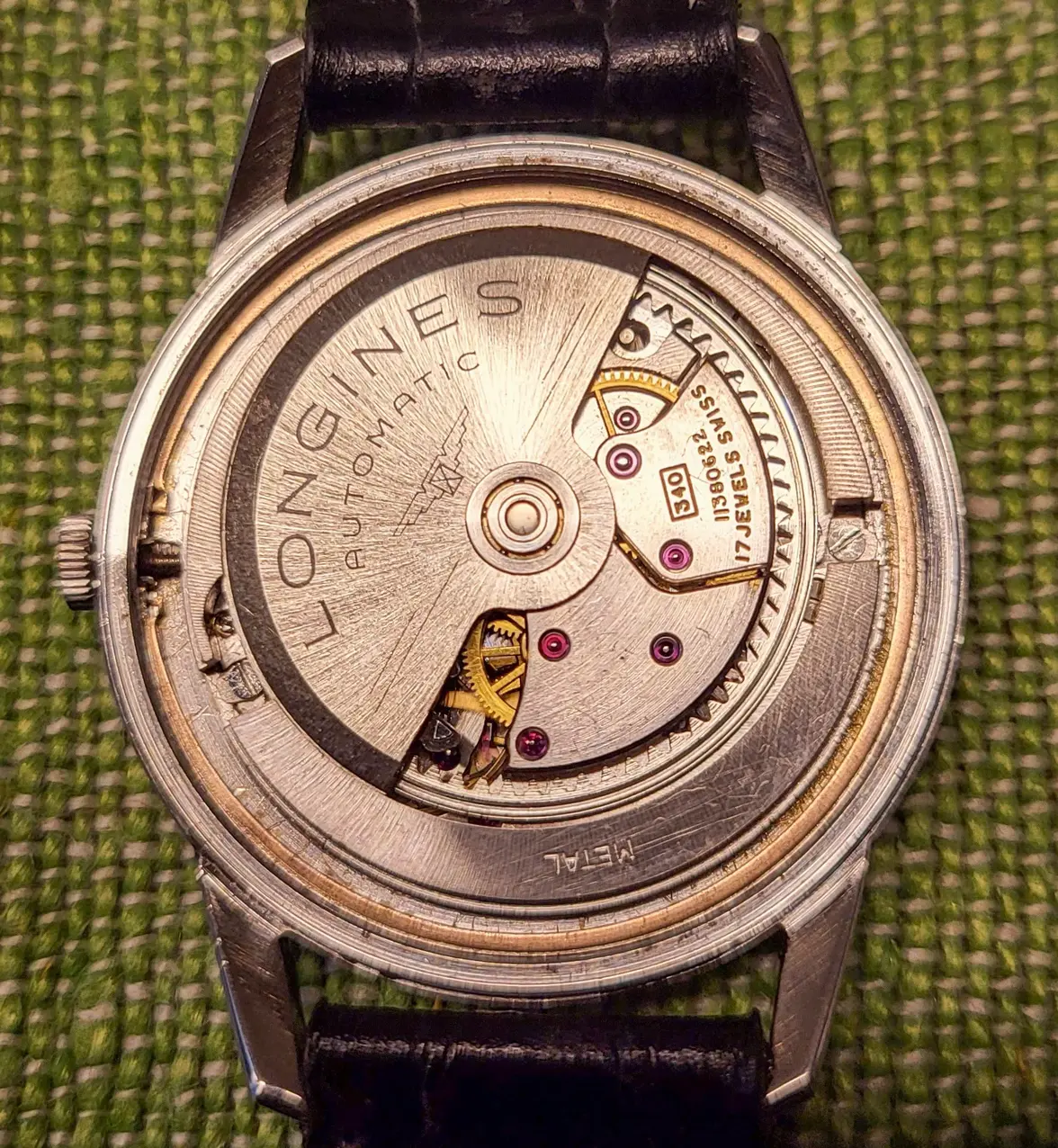

·Hi everyone, I was wondering if others have noticed similar loose movement issue with their 2014-2 Flagship using the 340 movement?
Watch is fully original and its movement is securely attached to its spacer ring.
A lock ring keeps the movement and spacer ring assembly well in place vertically, but there's a lot of side to side horizontal movement when setting time.
You can see the wear marks around the lock ring from this side to side movement.
I think I need to ask my watchmaker to come up with some extra spacer, maybe just an O-ring between the spacer ring and the case. But like said, I was wondering if this is a common problem with this model?
