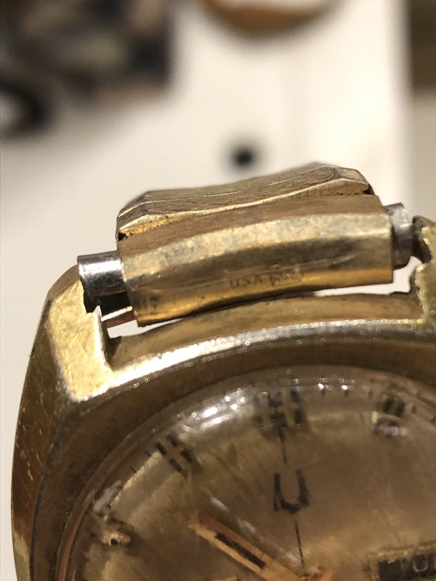

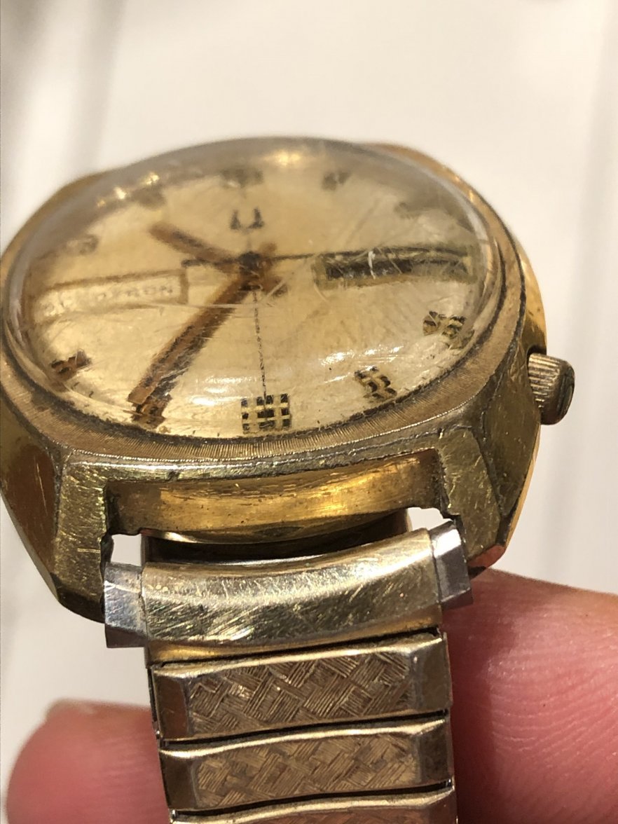

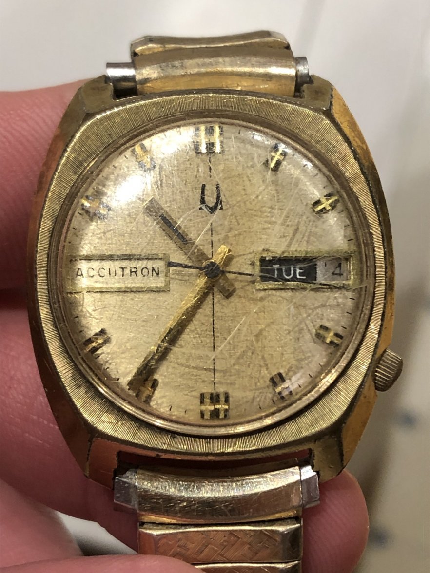

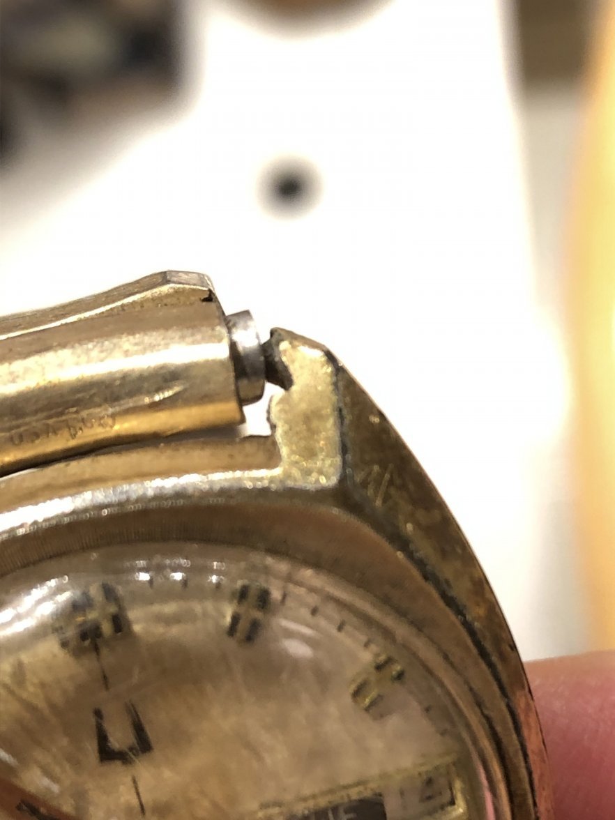

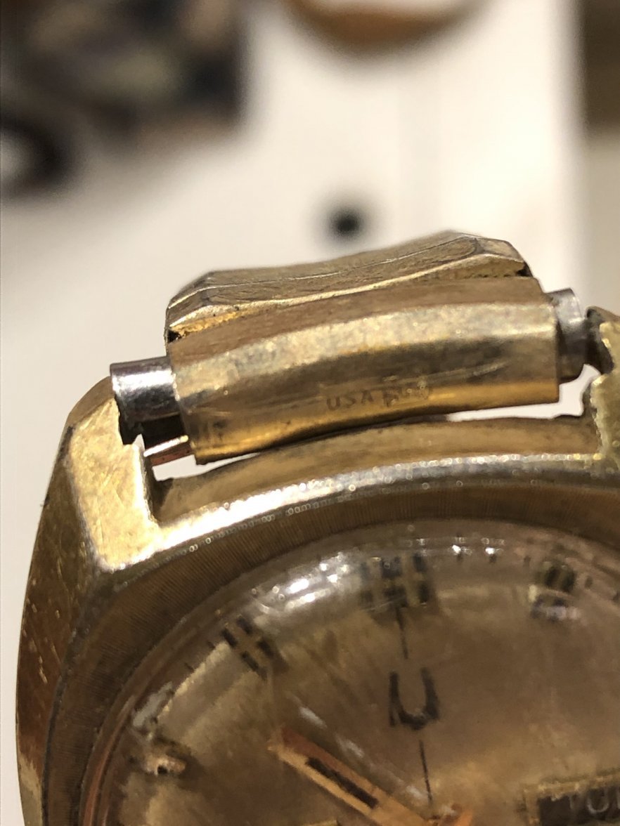

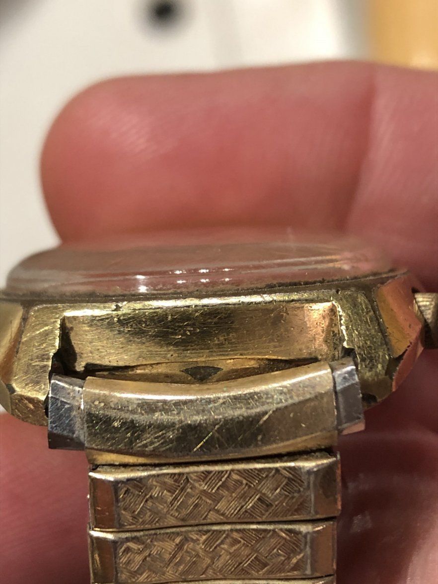

A picture to put fear and terror into the hearts of watch lugs everywhere!
Heard about it but never seen it. Springloaded endlinks is another story.

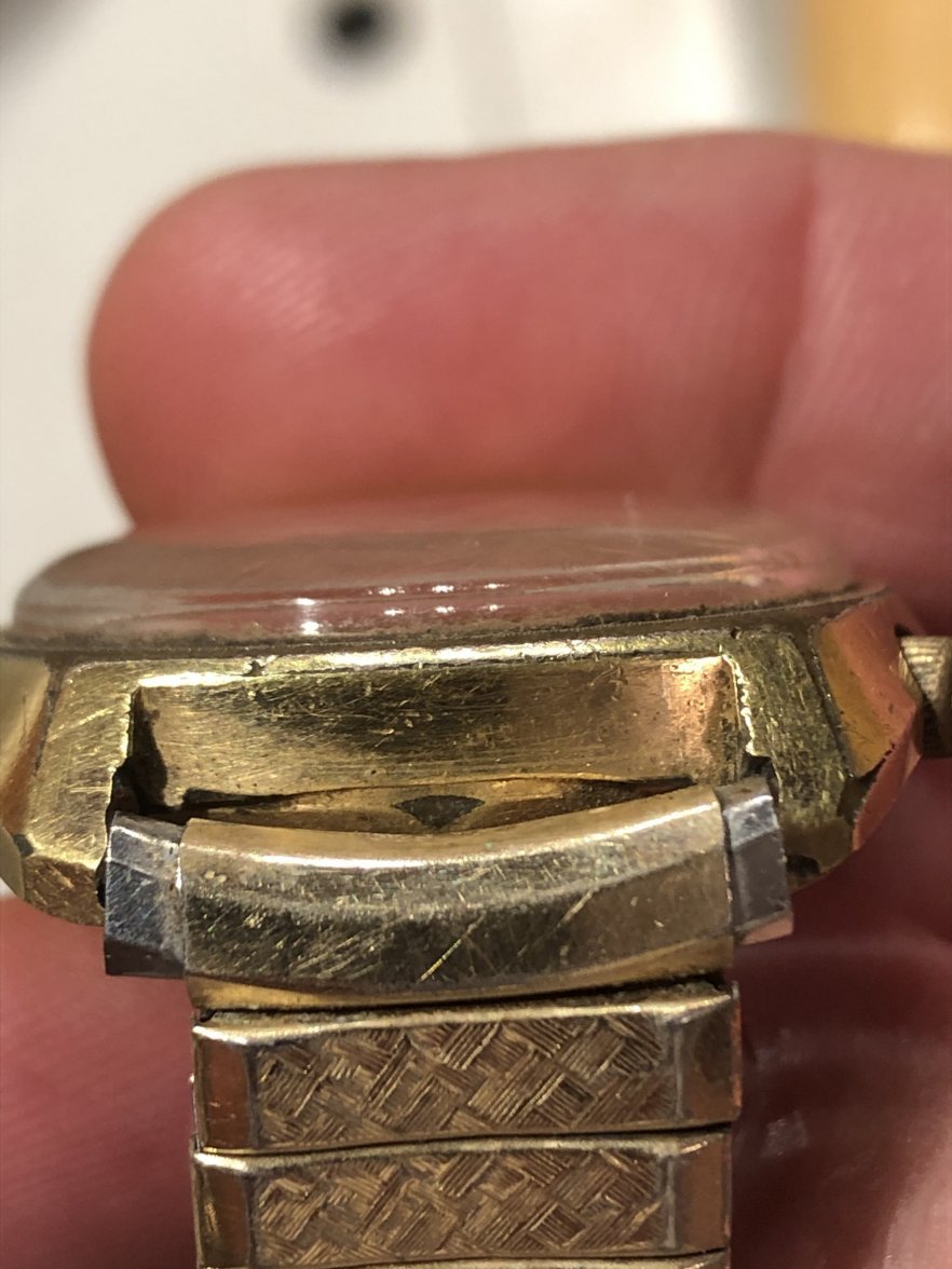

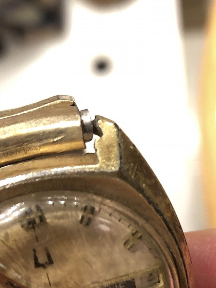

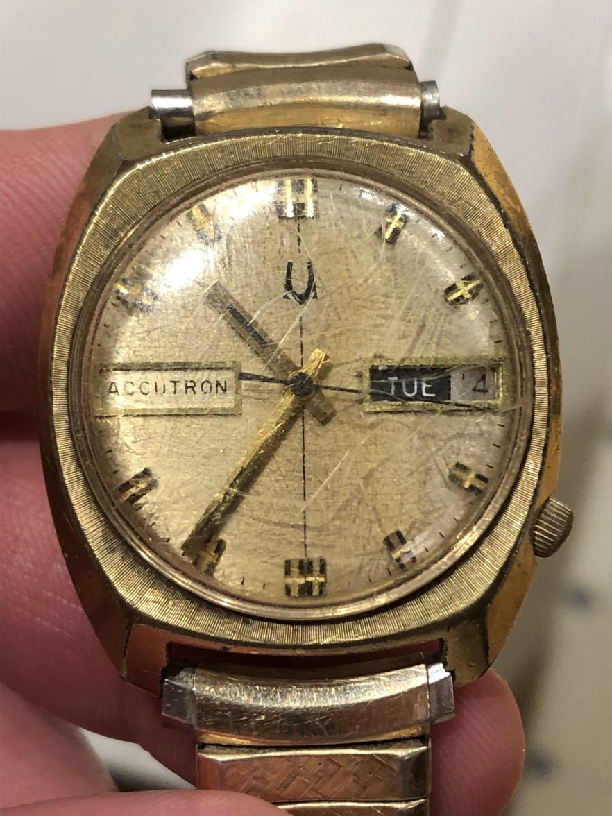

As a cautionary to anyone contemplating one of these bracelets- the fixed endlinks are fine- the spring loaded ones that self adjust from 15-20mm with firm springs in the spring bar covers will destroy your watch over time.
I have a case for my Elgin B.W. Raymond at my jeweler's shop right now waiting for her to weld up similar damage.

Now that’s tragic! But those were working watches (for the rails) and fixoflex would have been a logical choice.

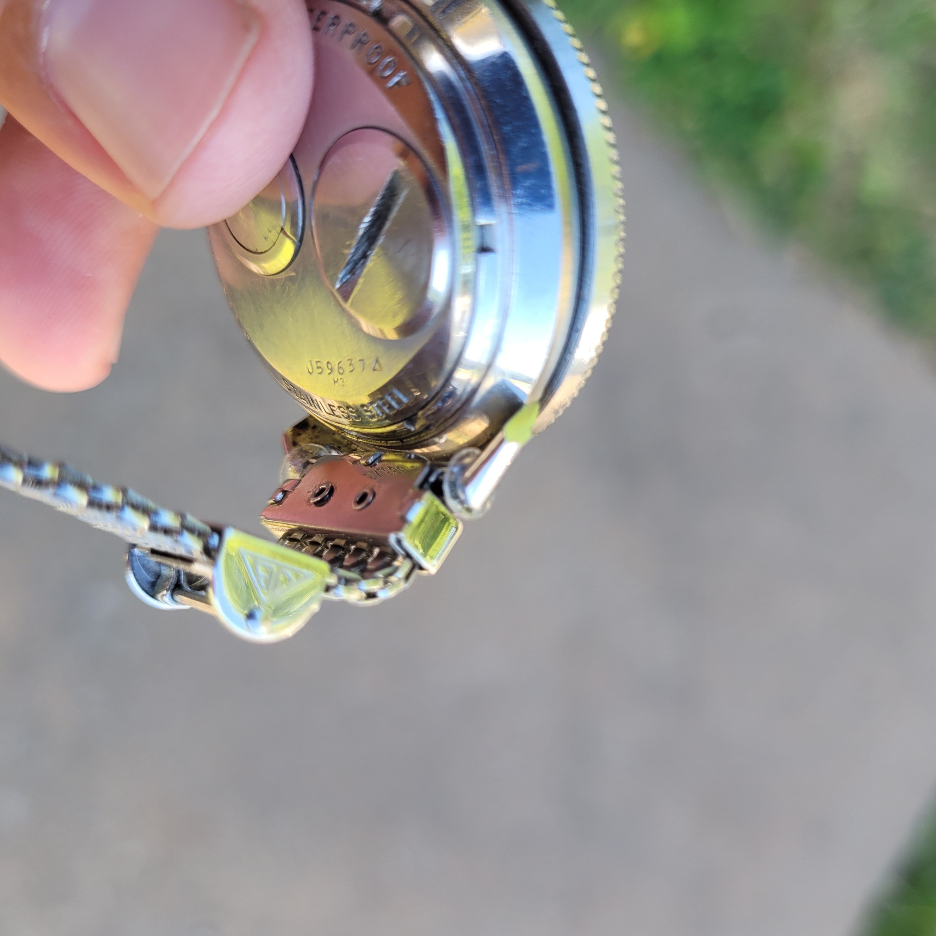

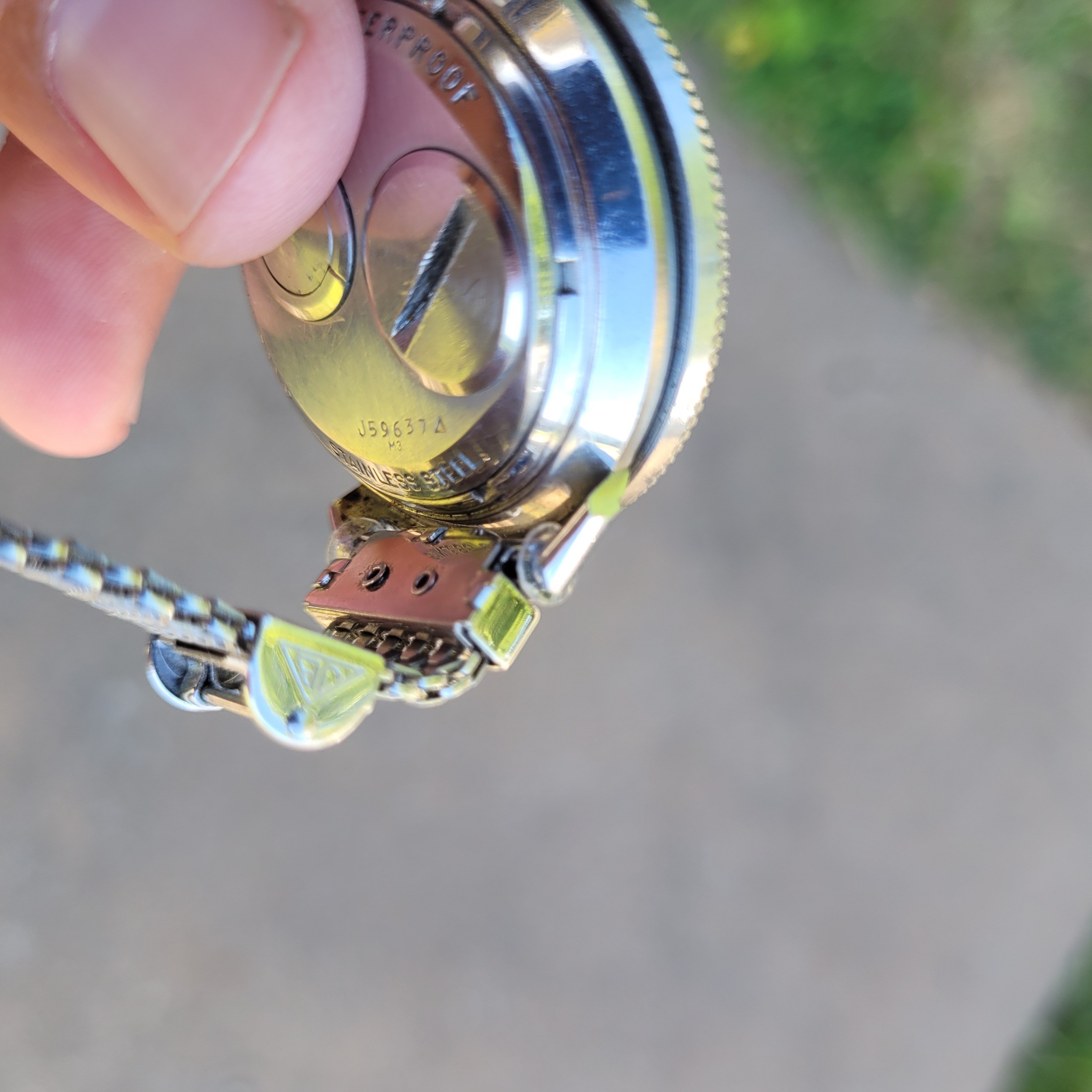

I cut small disc's of .002" clear polycarbonate that I put between the spring loaded end links and the watch lugs.

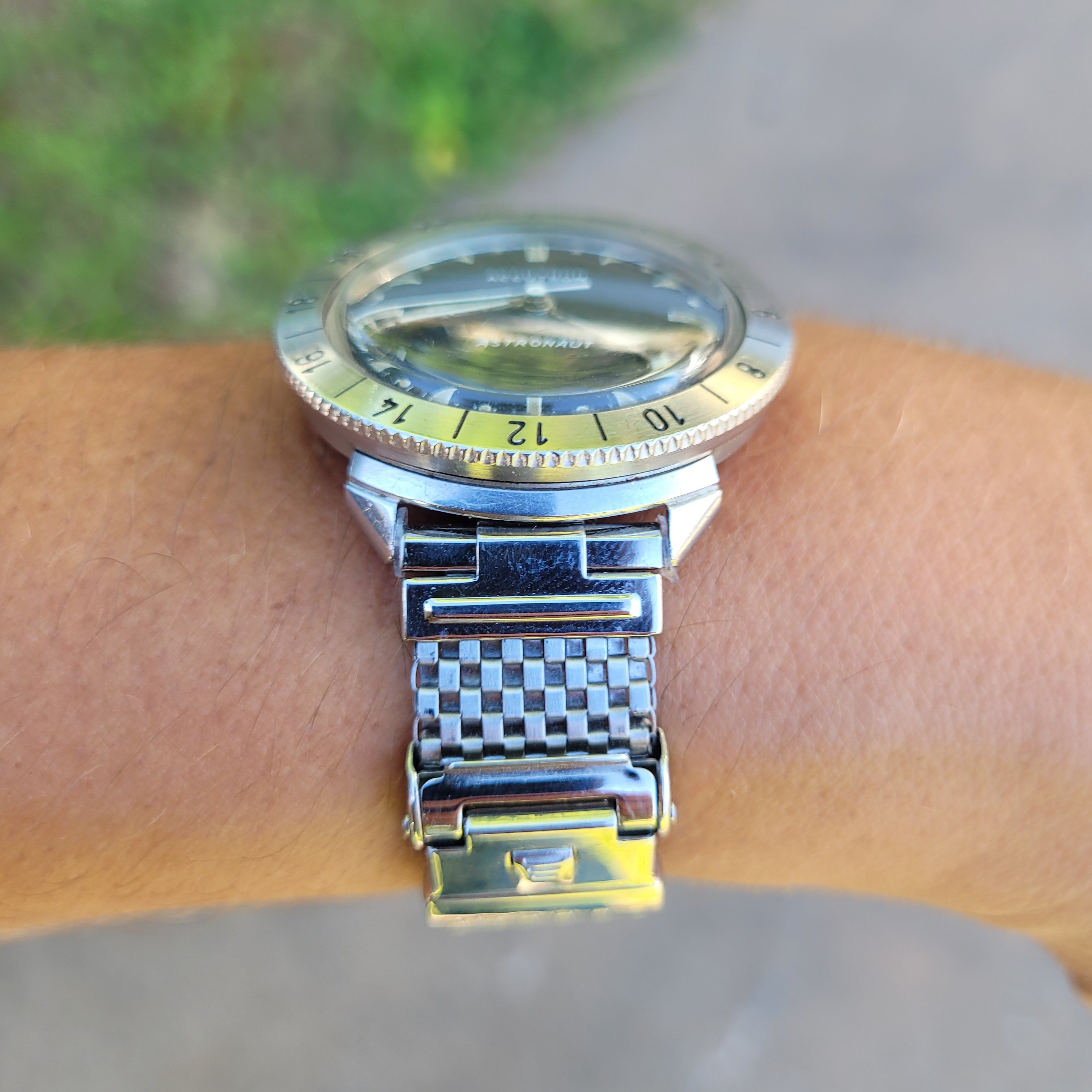

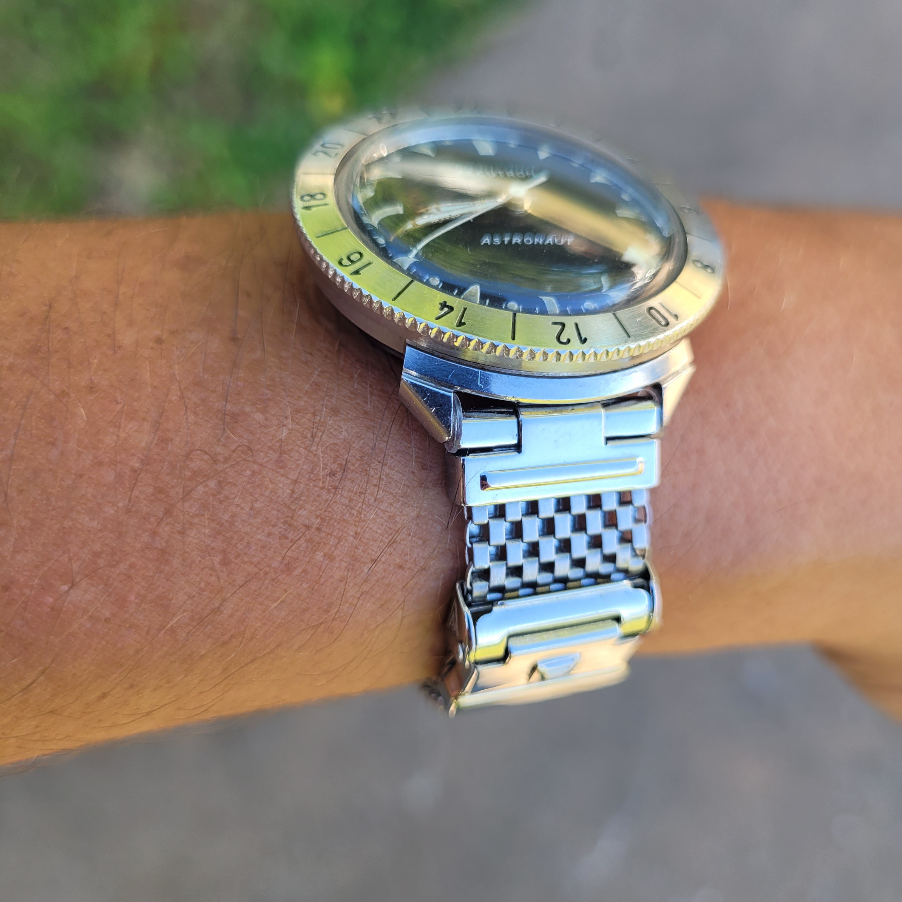

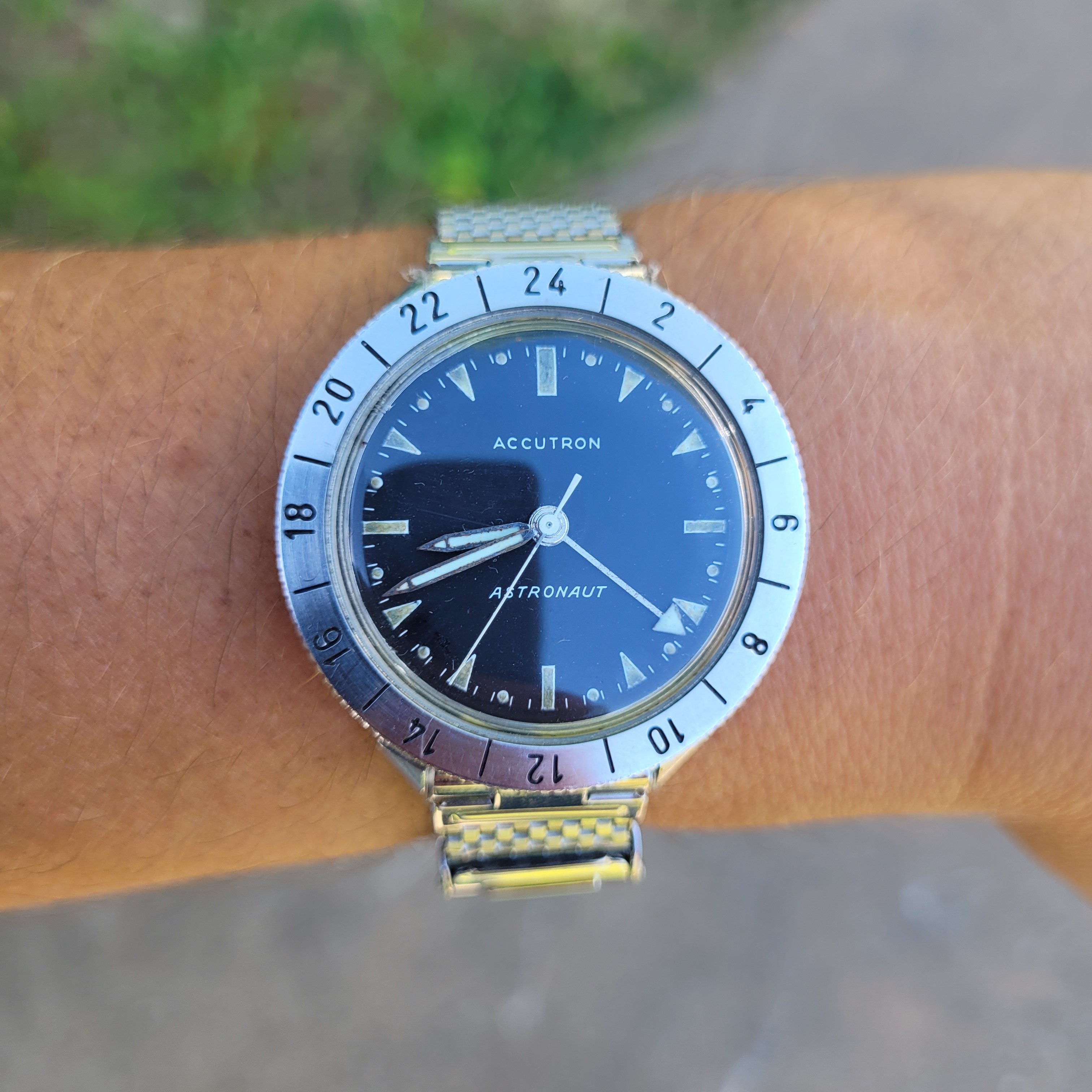

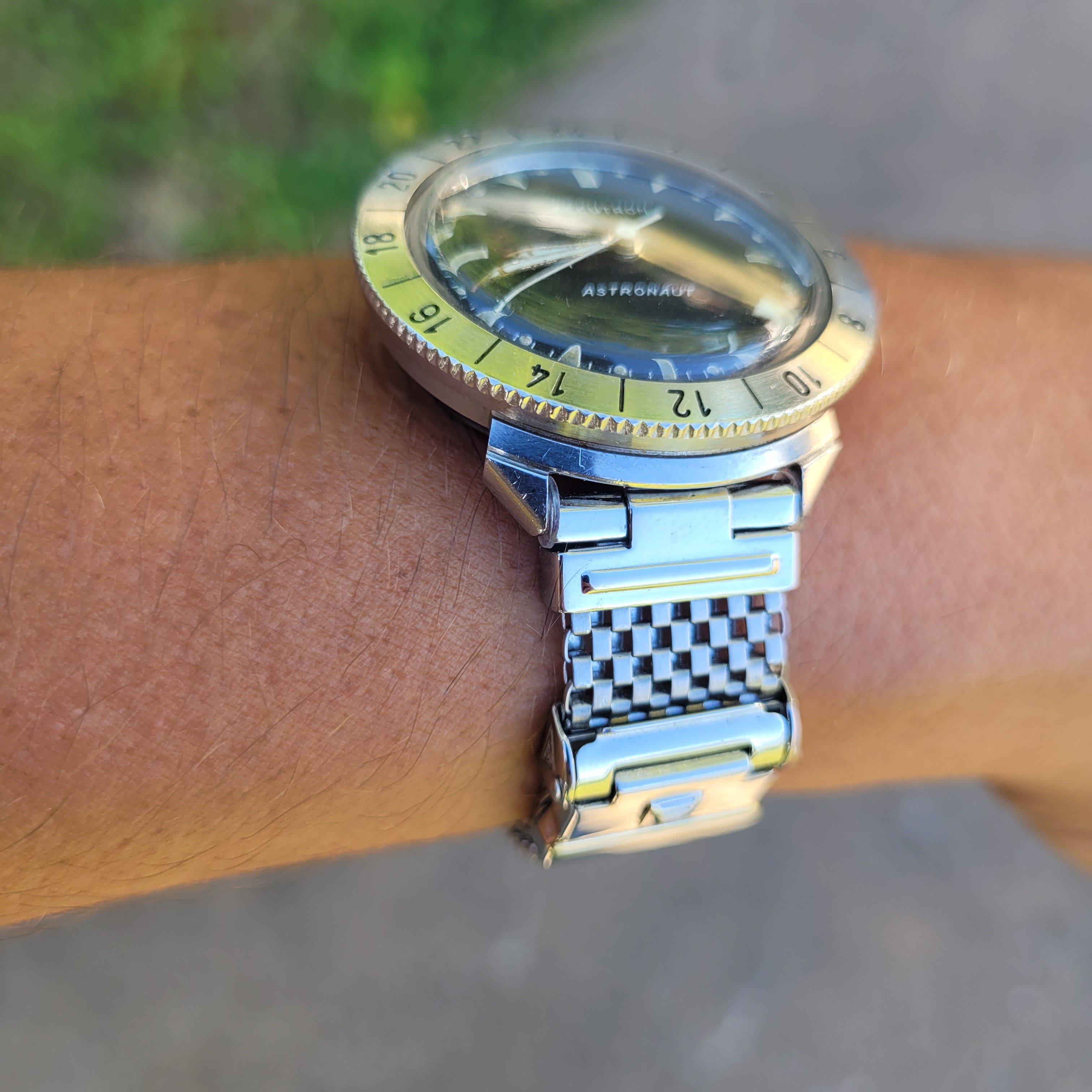

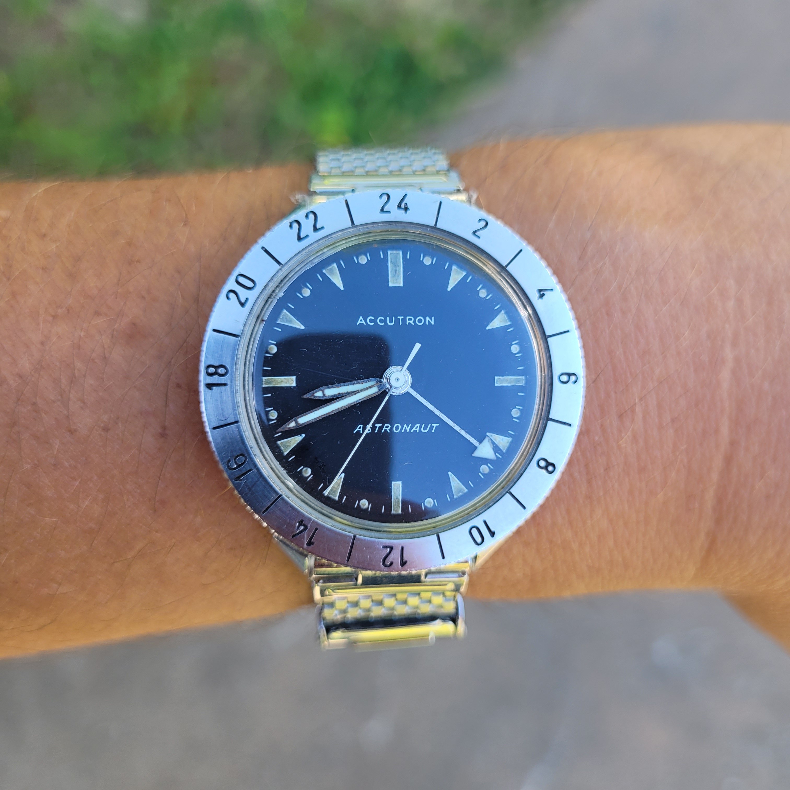

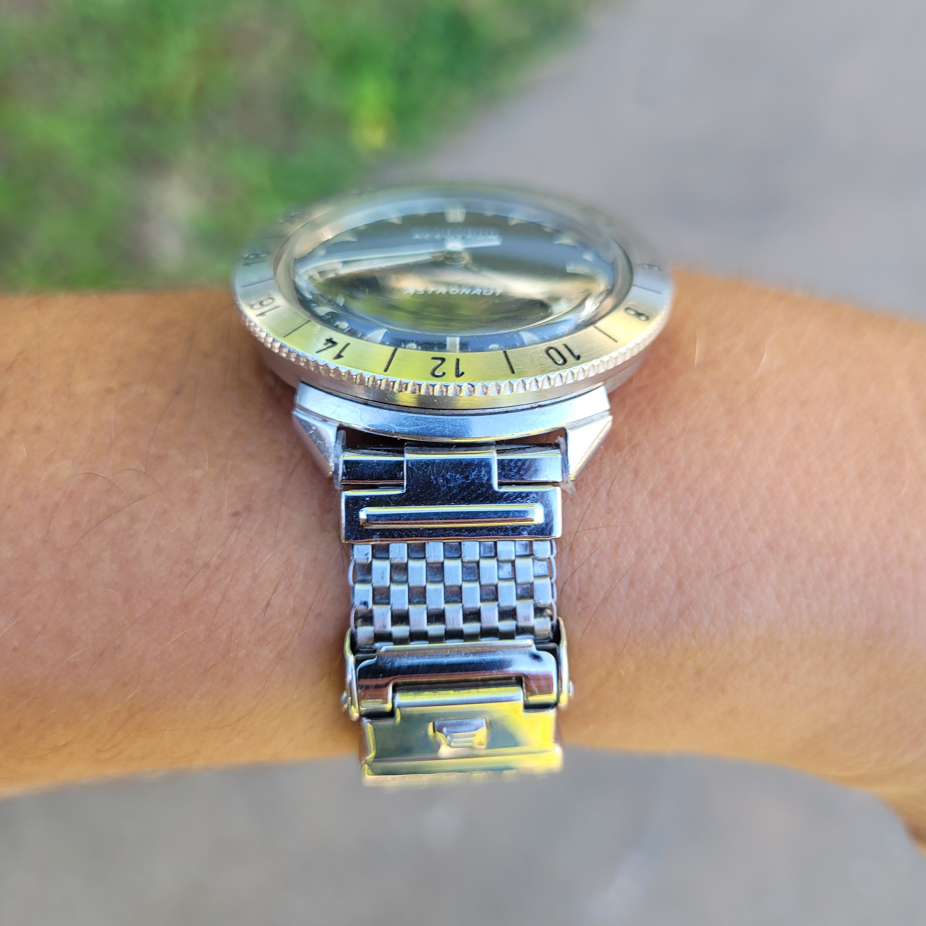

I have one of their komfits on my Astronaut, and I love it. I didn't love the little sticky gasket that they sent with it. My poly discs are much stouter.

Photo please!
Sounds like something I should be doing to all my expander strapped watches.

These are not perfect. I used a small punch to cut the discs (I forget which size), and then used a leather awl to punch the holes for the spring bars to pass through. They are not invisible but they are pretty unobtrusive.

And if one were really anal retentive, it wouldn’t be hard to file them down to perfect size and add a dot of clear nail polish to the lug side to hold them in place- easily dissolved later with a little acetone.
