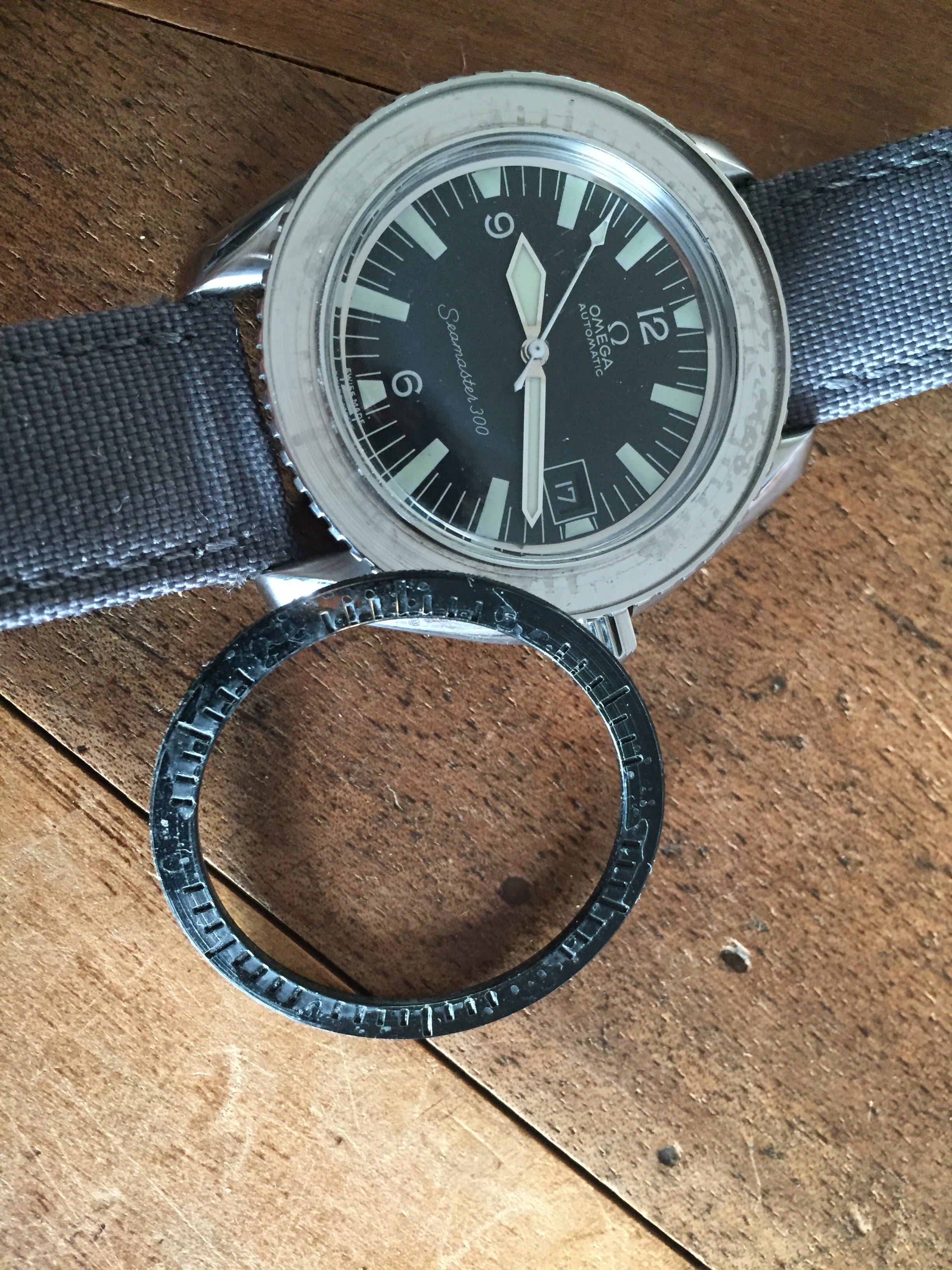

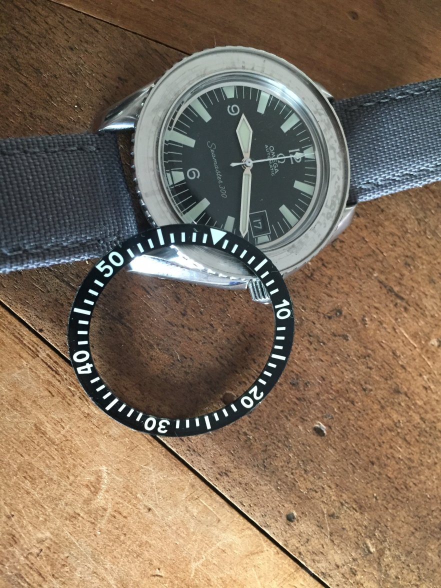

Dear friends,

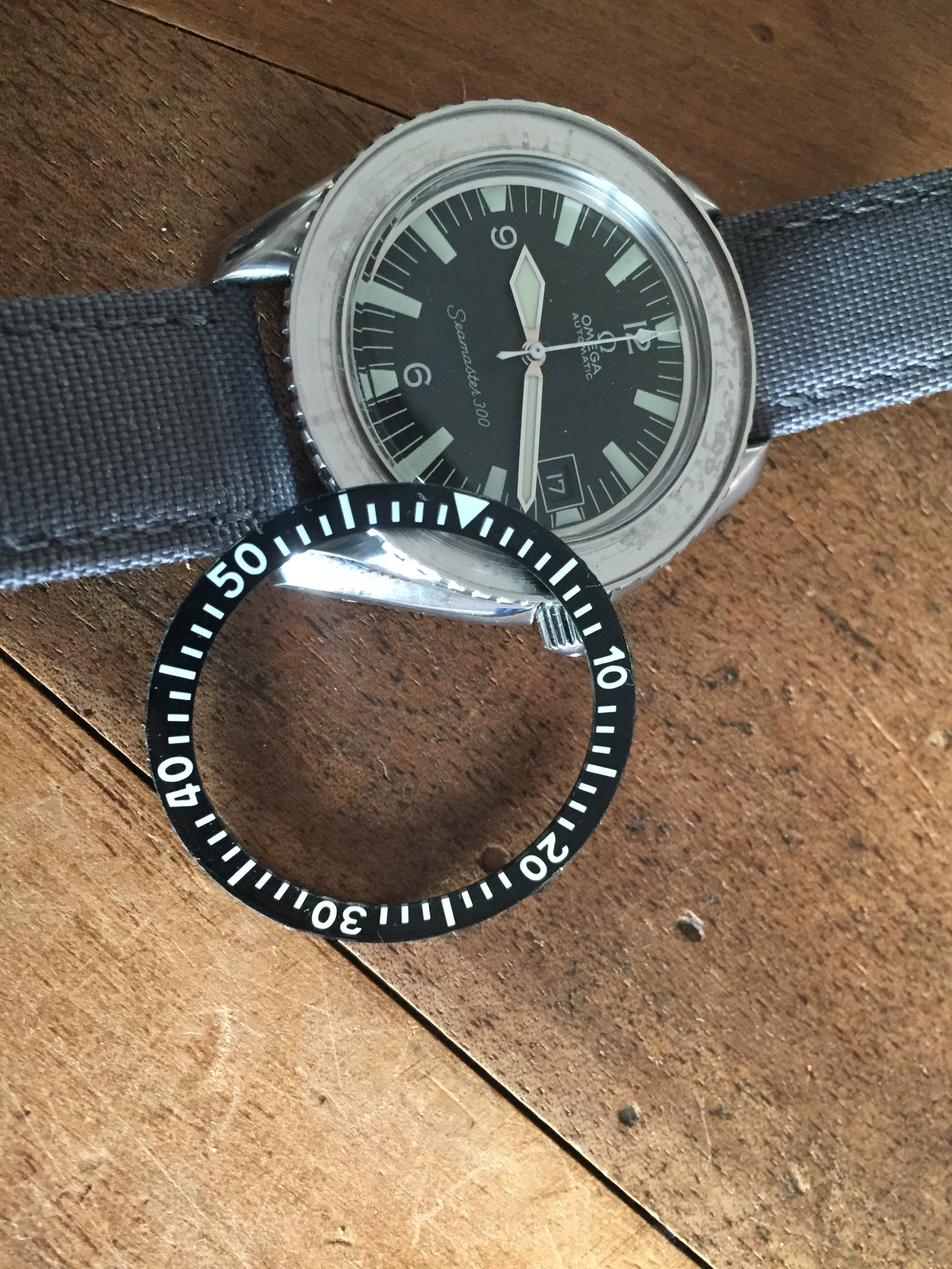

the acrylic insert from my SM300 was discreetly coming out of the bezel.
I preferred to carefully remove it before it left on its own.
It's in perfect shape, I just need now to put it back on.
I read that insert is in acrylic and painted, so I don't want to use any type of glue that could damage it.
Do you have any advice in order to do it properly with a proper glue that cannot damage this beautiful insert ?

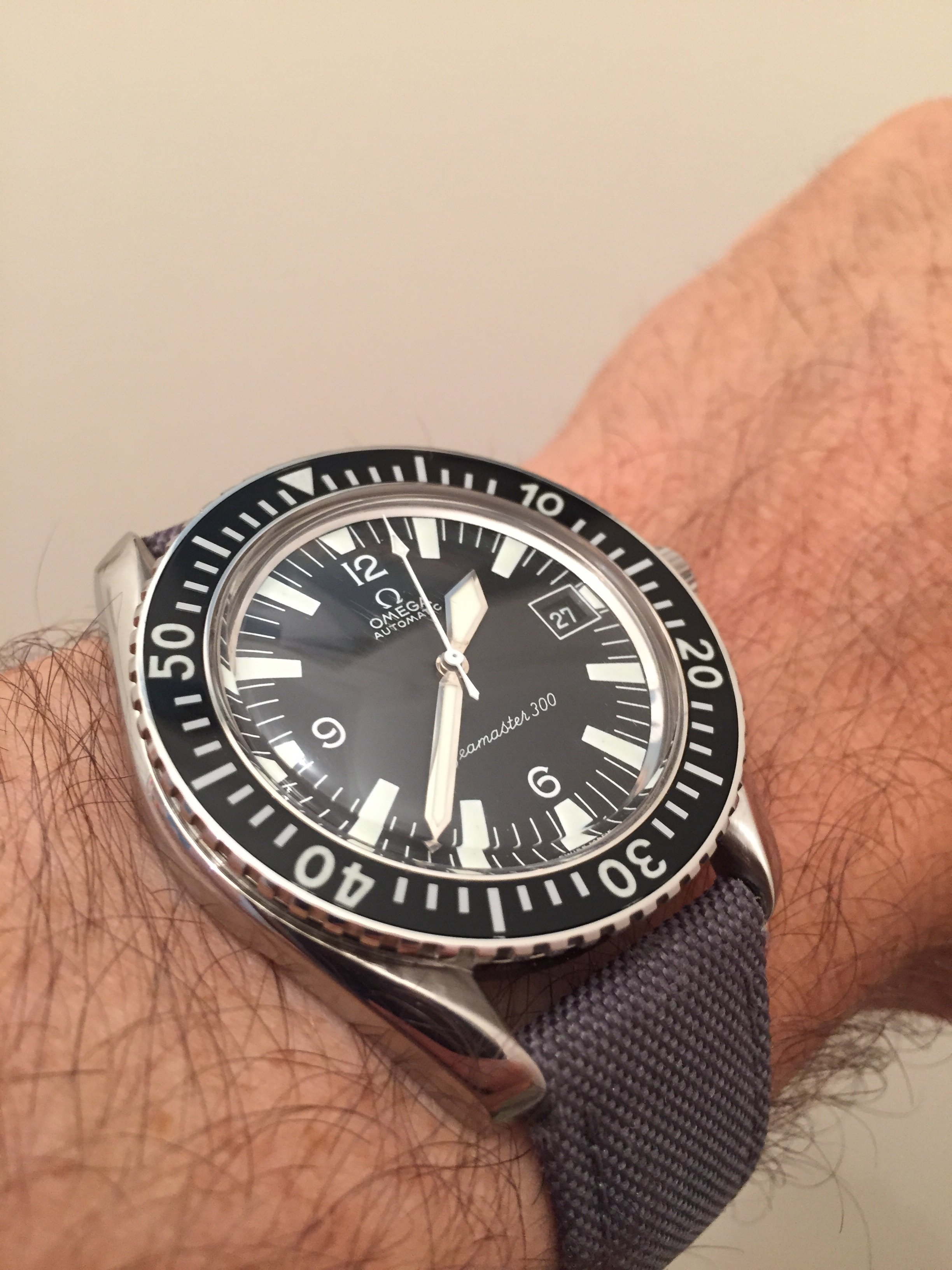

Dear friends,
I finally glued it with GS-hypo cement.
Everything is fixed now.
