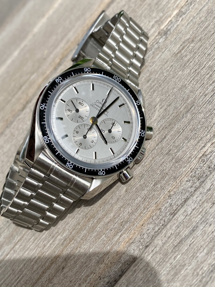

I got hands on a barely used 1479 bracelet.
But it doesn't fit my Speedy from 2019...?? What can be done? Can I file the end links or what??

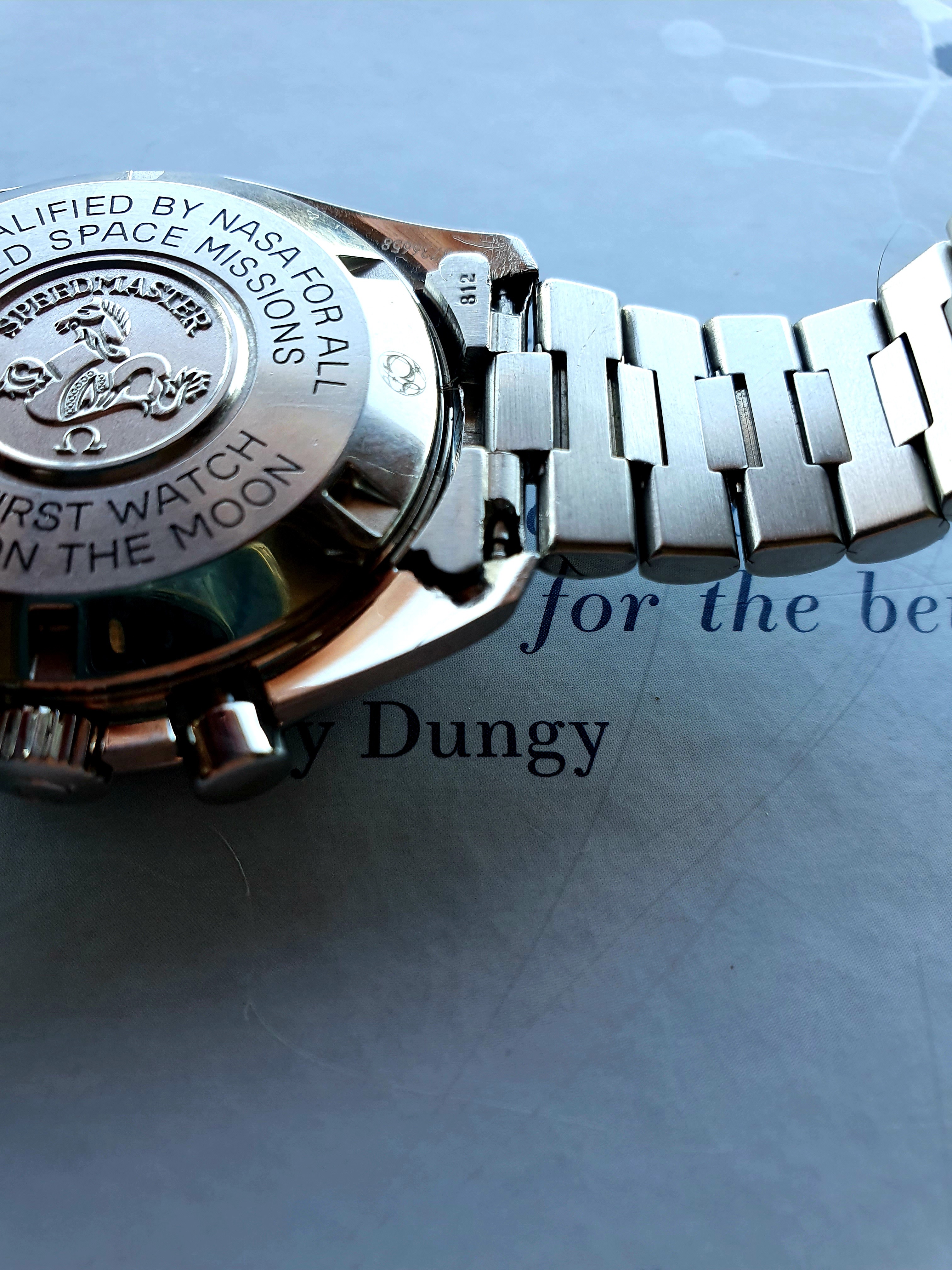

Make sure that it is really a 1479 with 812 end links and not a Omega Dynamic bracelet Ref. 1571/871 or a mix of 1479 bracelet and 871 end links.
At first glance they look the same, except the Speedmaster clasp engraving, but the end links are higher.

It is in fact the 1479 bracelet and 821 end links. I'll try other endlinks before selling the bracelet (won't ruin it ;-) )

I had the exact same problem a few days ago, after buying a used 1479 bracelet with 821 end links off Ebay..
In the end, I had to slightly file the "flat" end of the link to get it to fit.. Not much, but finally managed to get it on.. It's a very tight fit though, but's it's on, so I'm chuffed!!

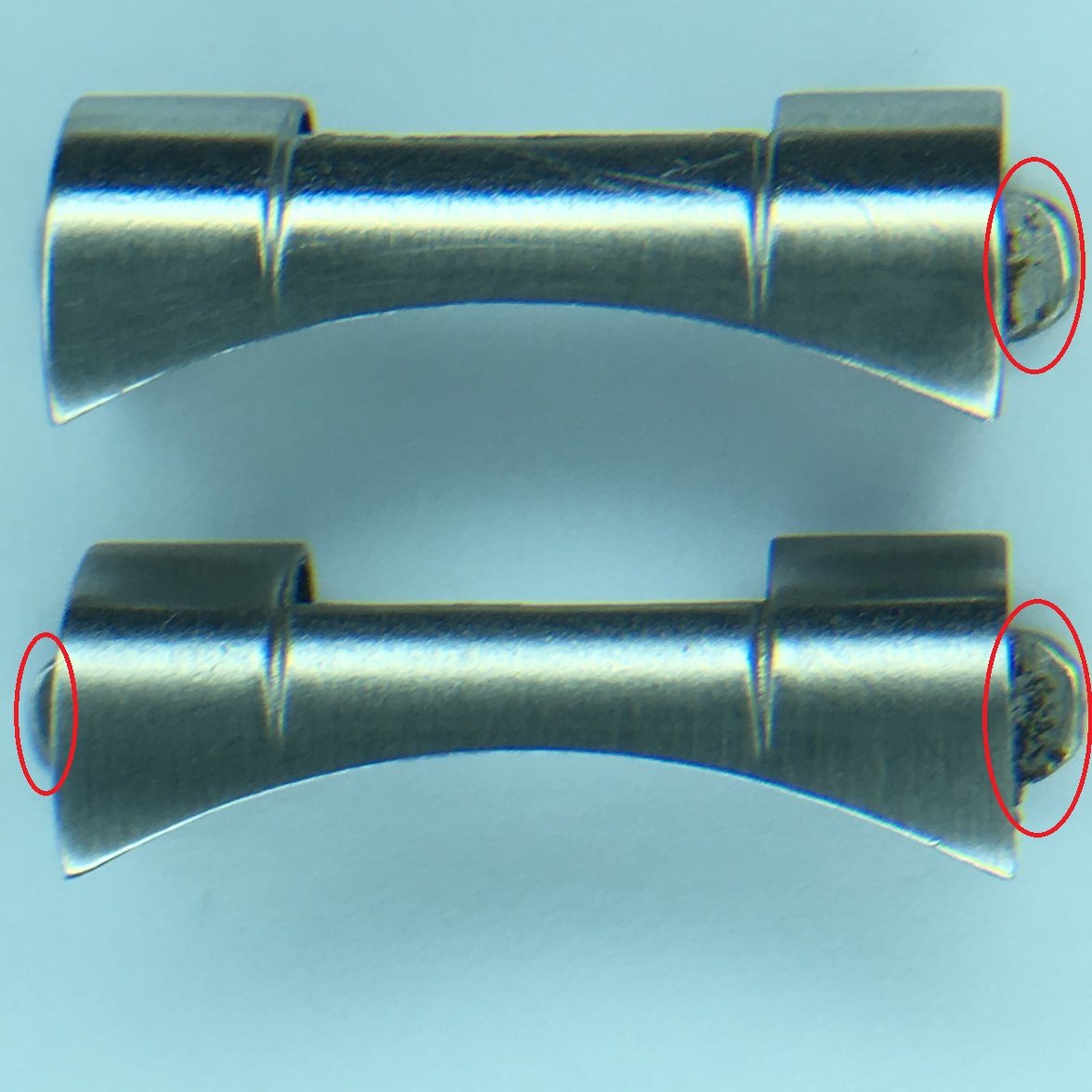

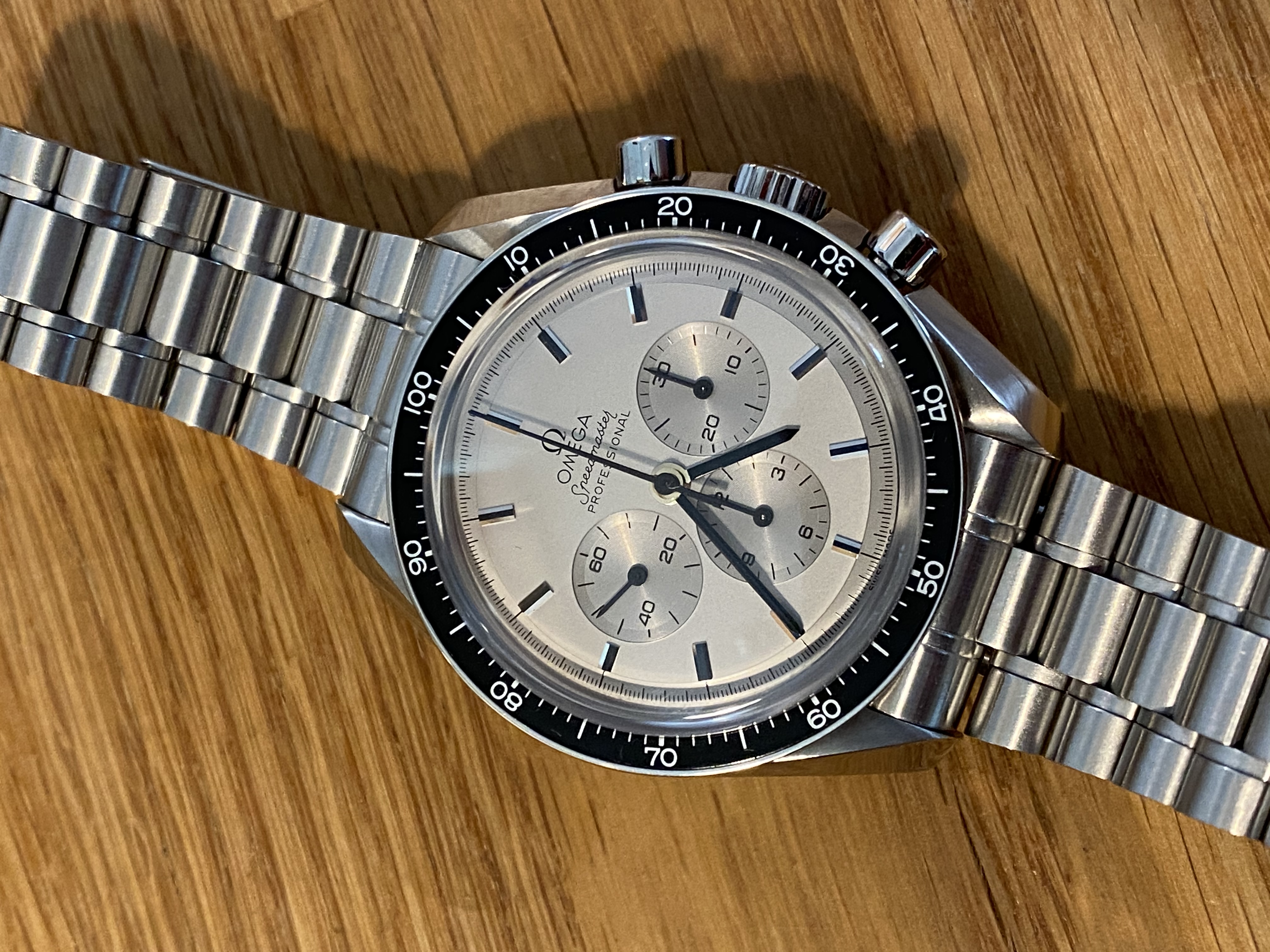

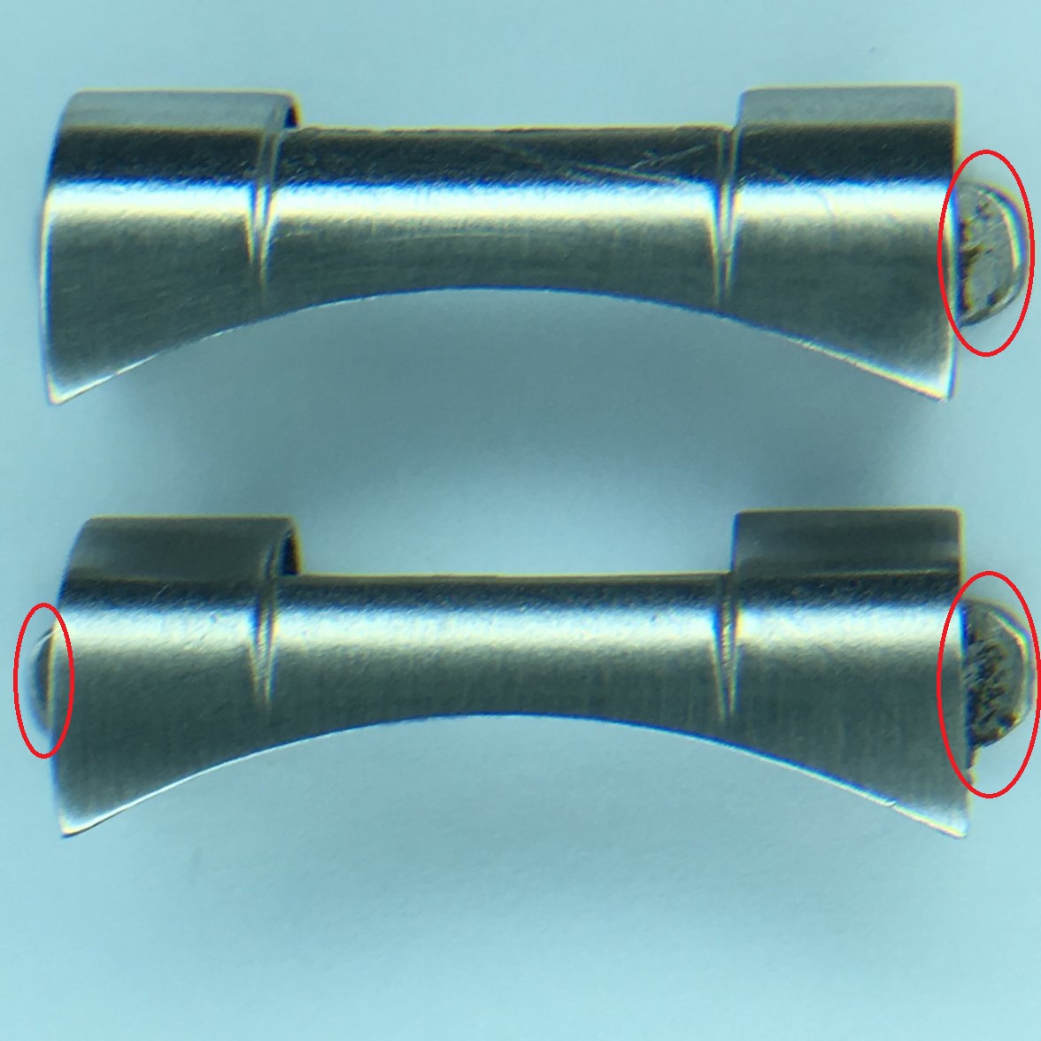

Yes, most definitely doable without too much hassle.. with a standard set of needle files. But again, you don't want to take too much off and want to go super slow on the filing.. as you merely want a fraction off.
I've circled the (inner) area of the lug which had to be filed (Google pic).. as I don't want to run any other risks by removing it again to take pictures, but you can see it's fitted to my modern Speedy (yes, the lugs are quite scratched from previous bracelet fittings).
Minor correction to my previous post. The correct end link reference is 812. Not 821.. I'm probably somewhat dyslexic.. 📖🤪
