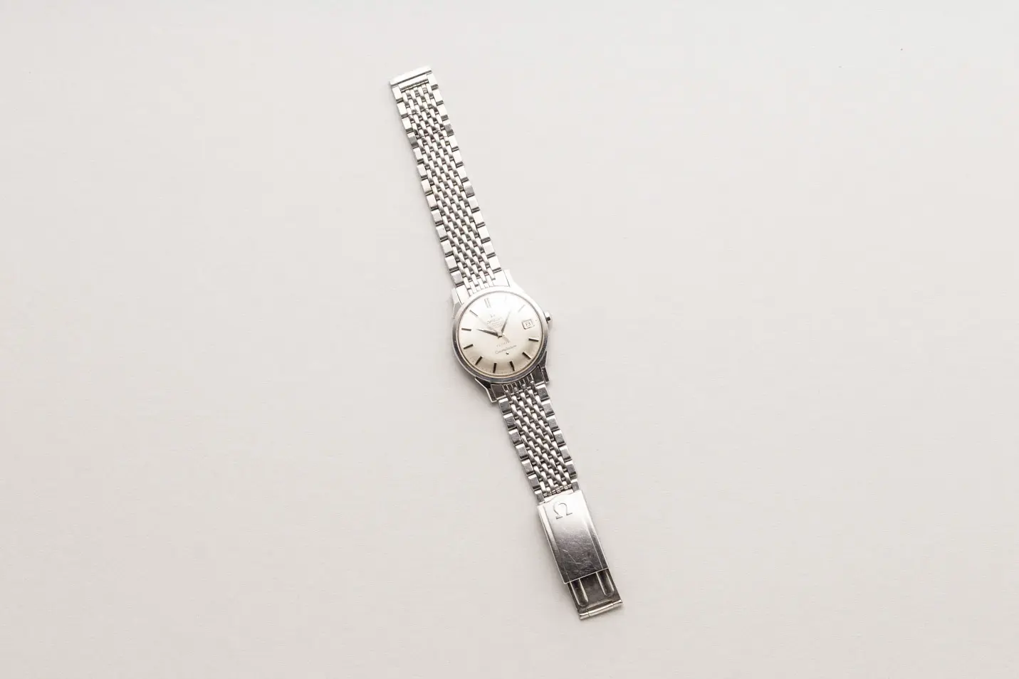

I'm a total Omega newbie - is this a reasonable price to pay for a sight-unseen watch? Is this an original band? Is this going to require heavy service?

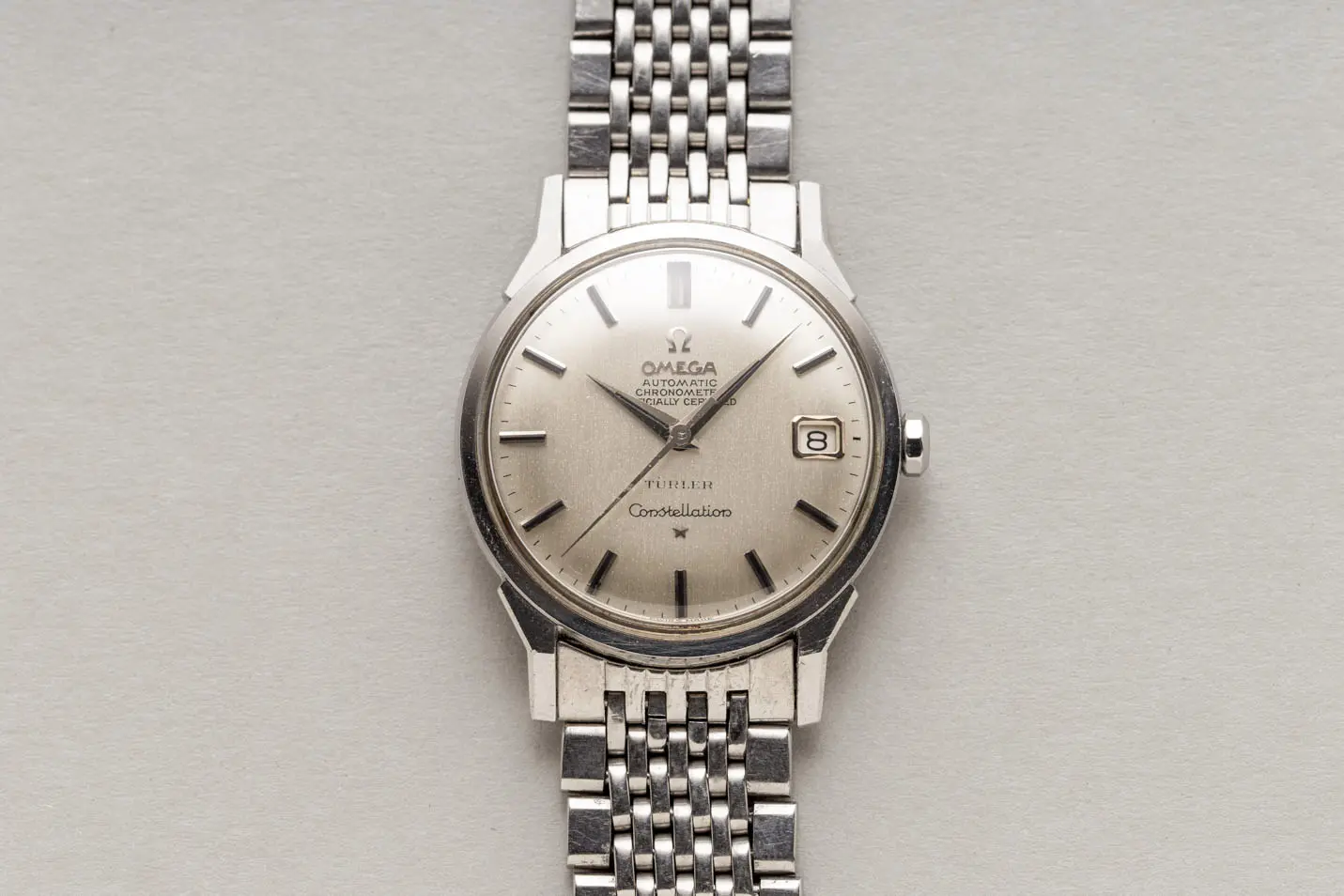

I don't see any obvious problems with the watch, but I suggest searching the forum for feedback about that seller. Their name has come up many times, and usually not in a positive light.
In general, you are always going to pay a large premium to buy from a professional dealer. So if you are going to do that, try to make sure that you buy from someone who is widely recommended.

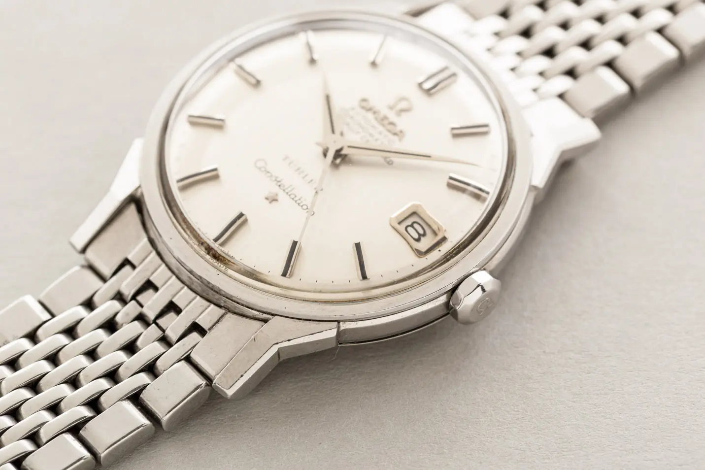

When looking at dog leg Constellations bear in mind dome dials (like the one you posted) are less sought after, collectible and valuable than pie pan dials.

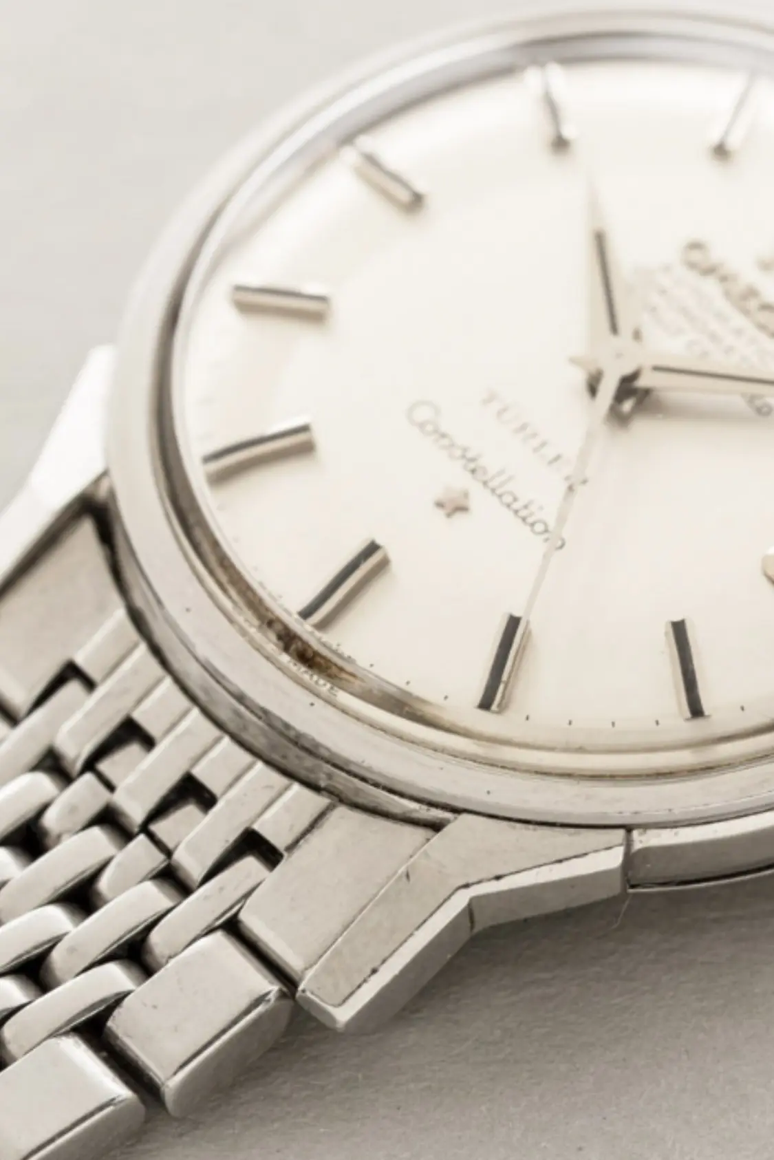

Photos are ( deliberately ) overexposed to hide flaws on dial and case. Even so I can see lots of spotting on dial. Turler adds no value.
I wouldn’t jump at this one to me it’s overpriced by 1000.

Not everyone prefers a pie pan and a dome dial dogleg is a lovely gift to buy yourself as a 30th present but this one is massively overpriced.
(Pie pans are valued more highly in the general market)

What is going on with the lugs nearest the camera?
There is no ridge there to collect dirt ( and it’s the same on the opposite angle pic )
Have these images been enhanced by AI by any chance?

Apparently just serviced by their watchmaker and still runs +25/day. But yes, very overpriced, and probably needs another service.

It’s too expensive, and the real dial should have quite many small spots.
But in the photo, we can’t see them clearly because the light was too bright when it was taken.

I think he is saying that in real life the dial is covered in small undesirable spots (e.g. blisters) that are hard to see because of the harsh lighting and photo processing.

There are also condition issues with that dial.
