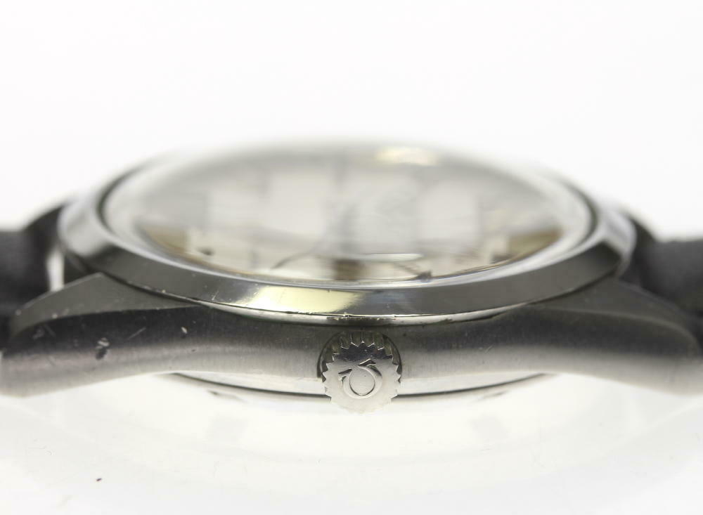

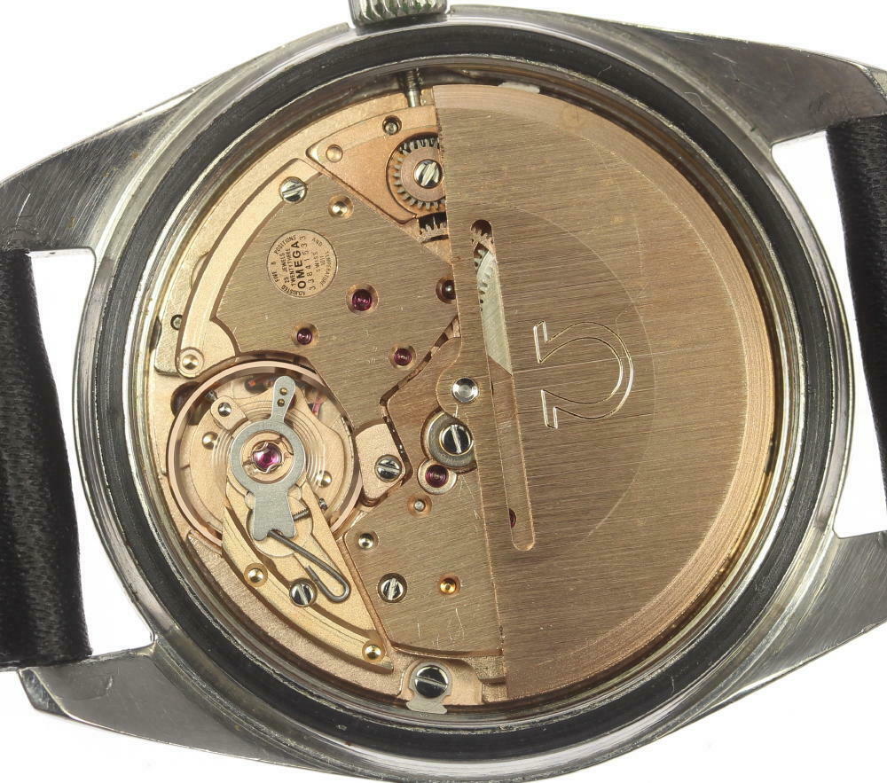

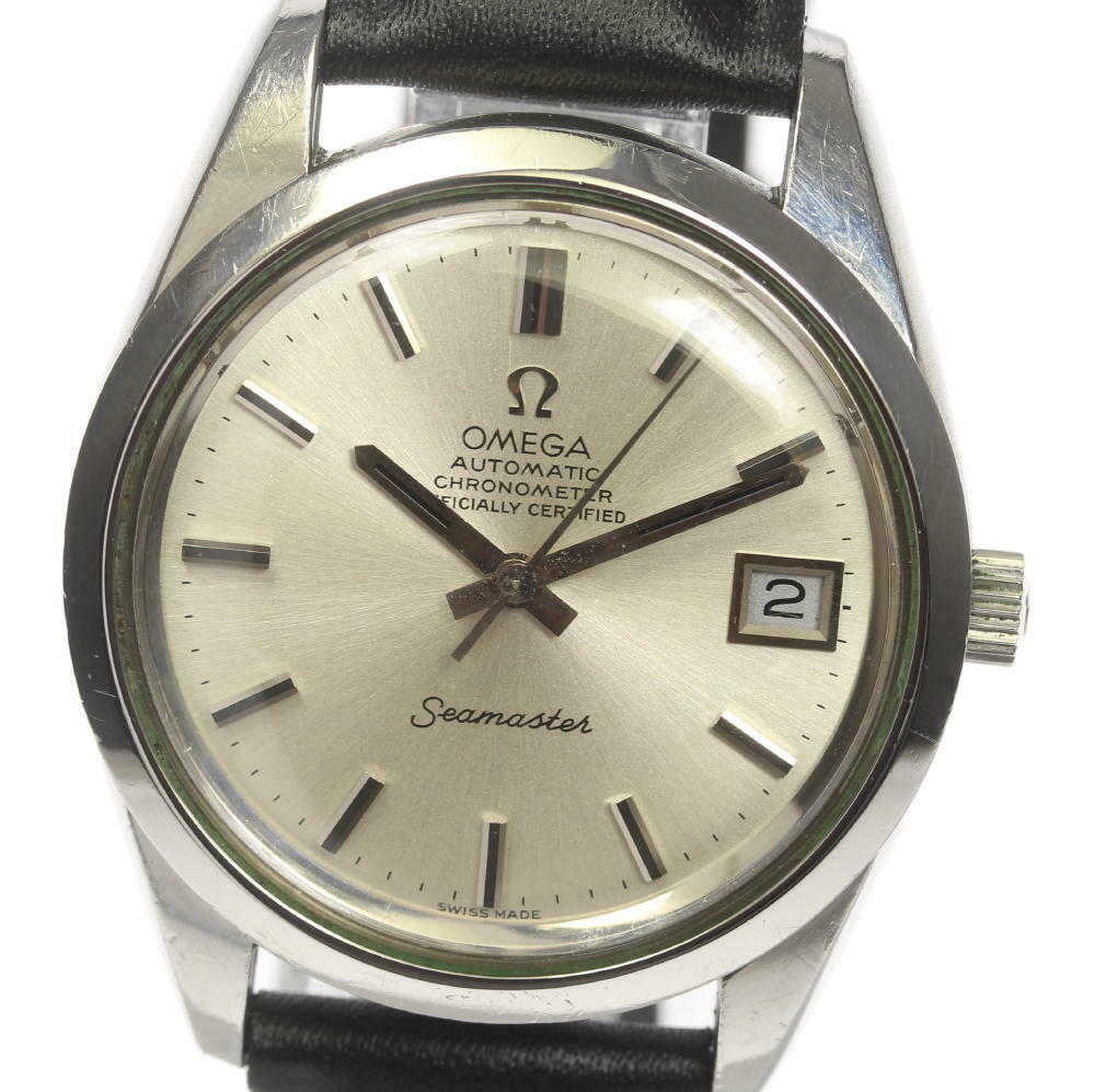

I spotted a few from a seller in Japan that I have purchased from before. This one looks rather clean? I really love the fluted bezel here but a few stains on the movement make me wonder...
Thoughts?

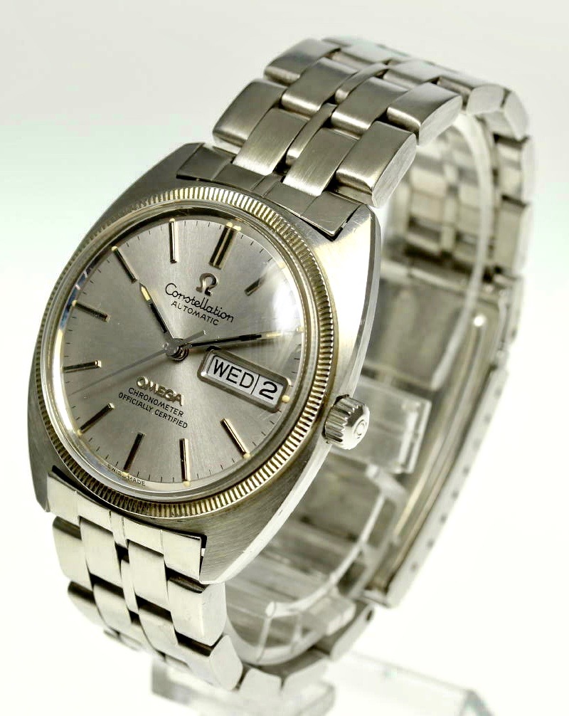

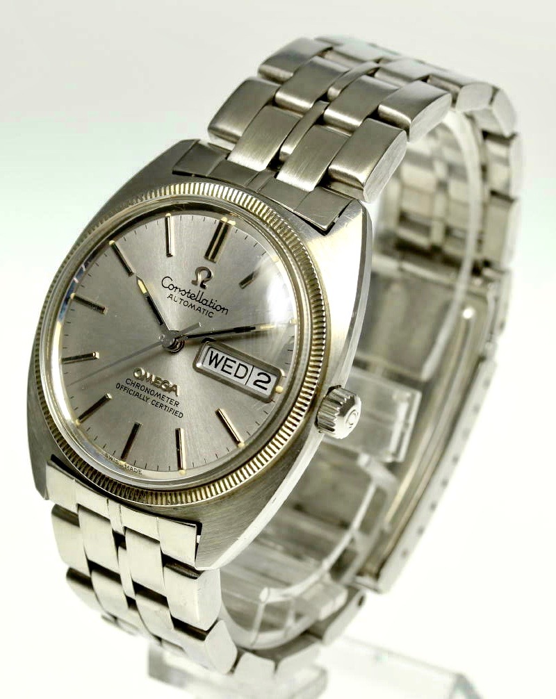

The C-shape Constellations are a good way in to collecting. The Japanese one you found is a nice example and the company is sound (I have bought several Constellations from them and have been happy with them all). However you might like to hang out for one with a contemporary bracelet and white gold fluted bezel, like this. I think the C-shapes look better with their family of Omega bracelets than on a leather band - but that is a personal view of course.

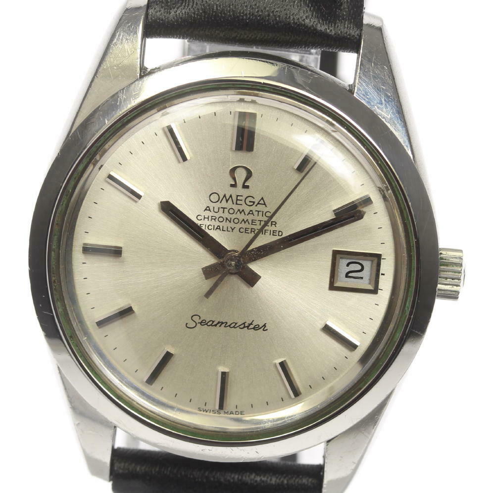

Constellations are great, but they do sell for a bit of a premium over other models - Seamasters and Geneves and no-model-name might fit the requirements equally well and stay under budget.

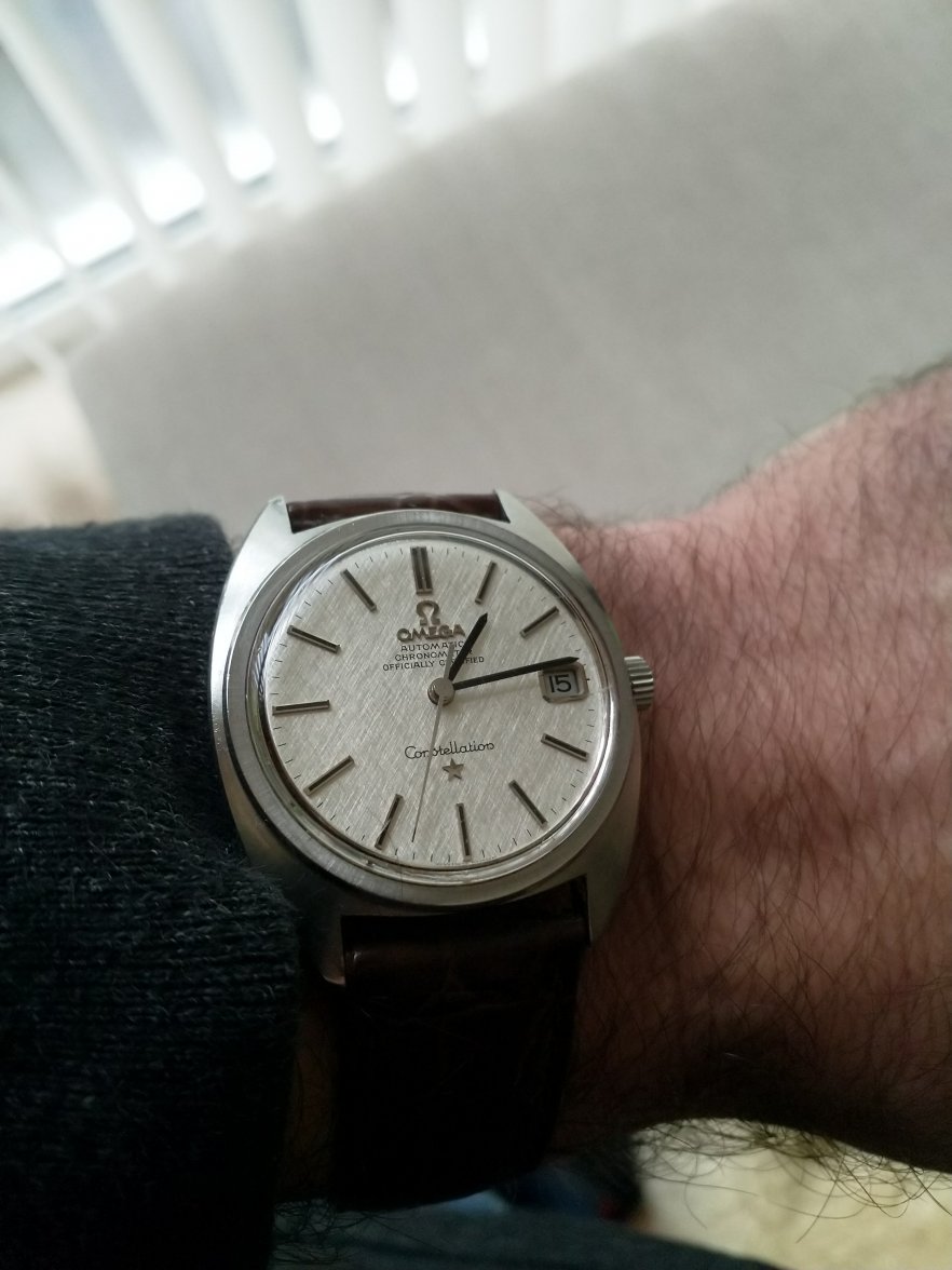

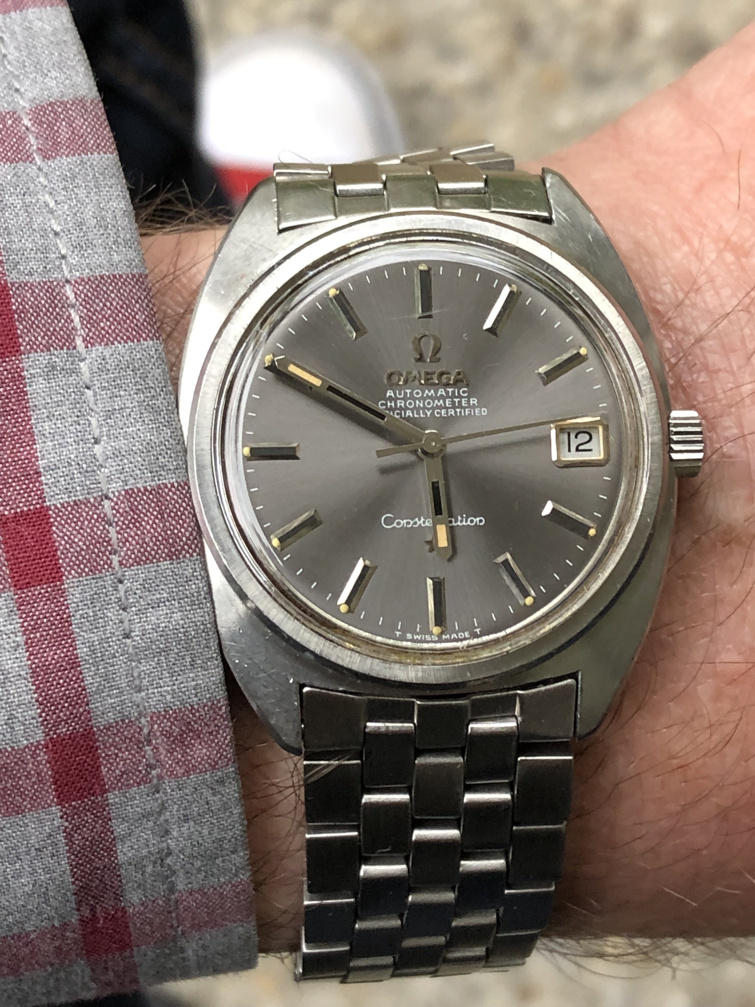

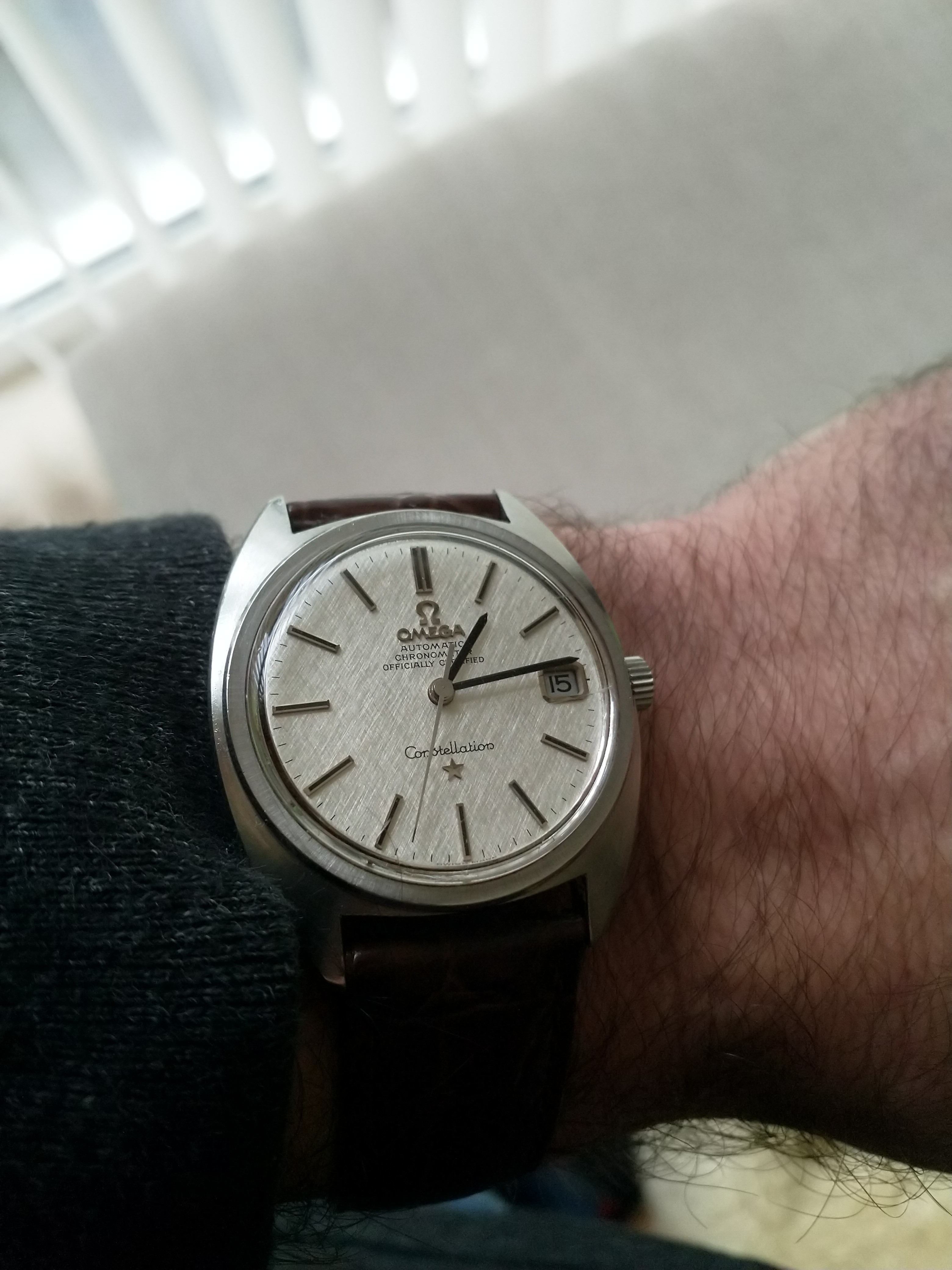

And for reference- this one is 34.5, one of my favorites for long sleeve weather

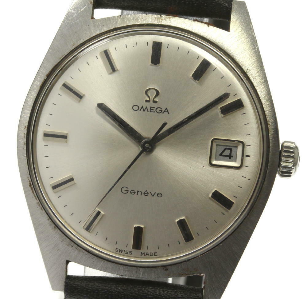

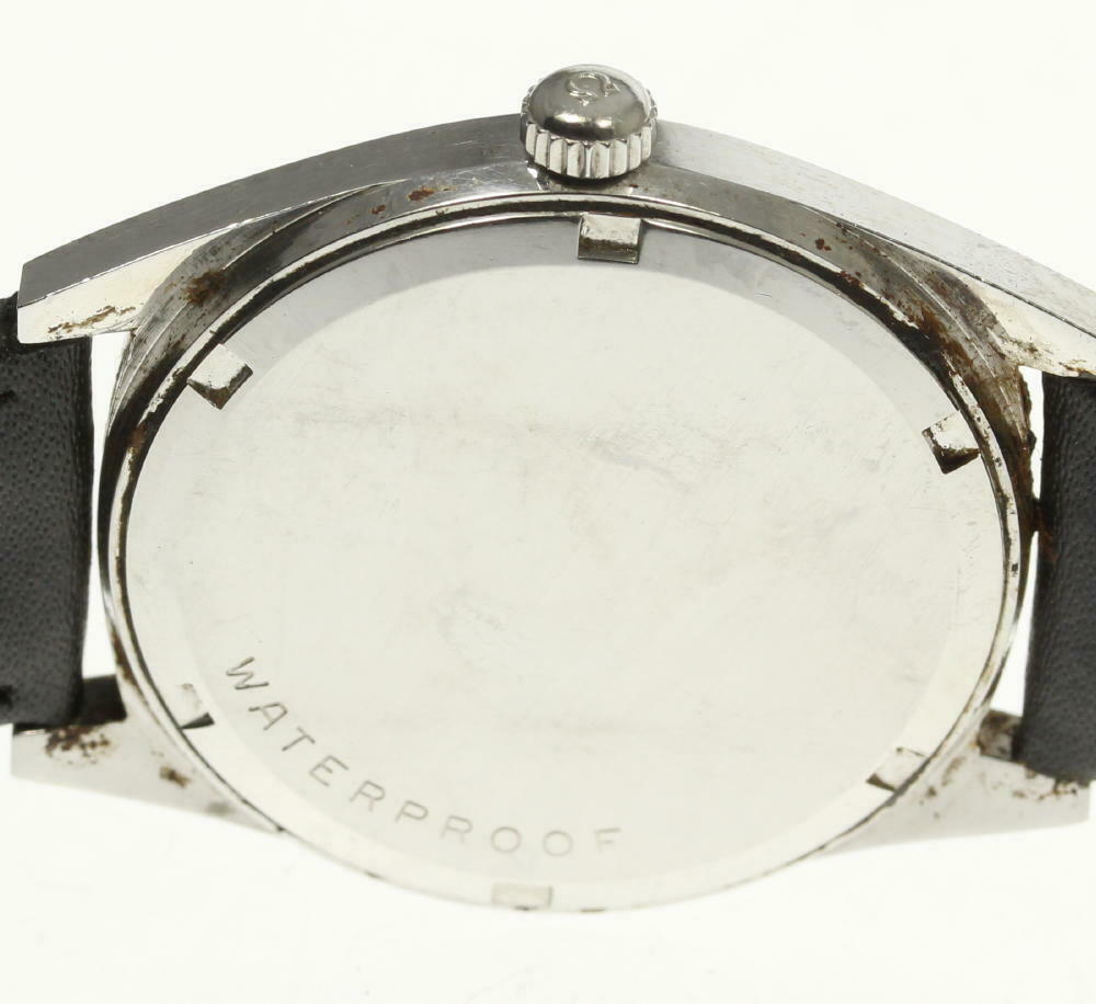

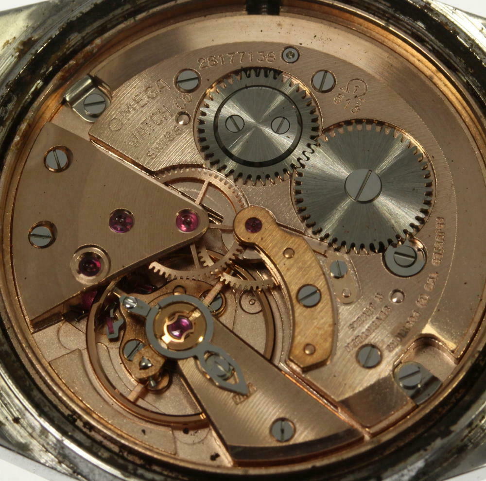

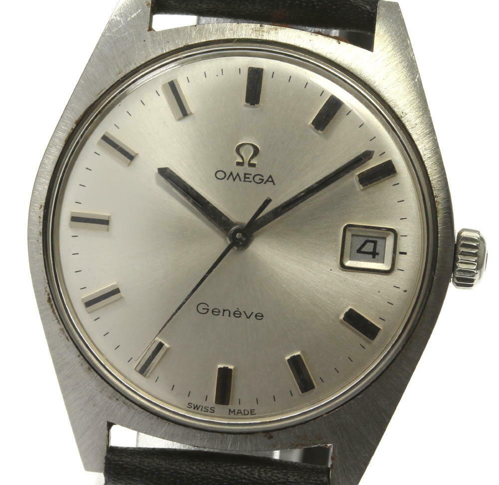

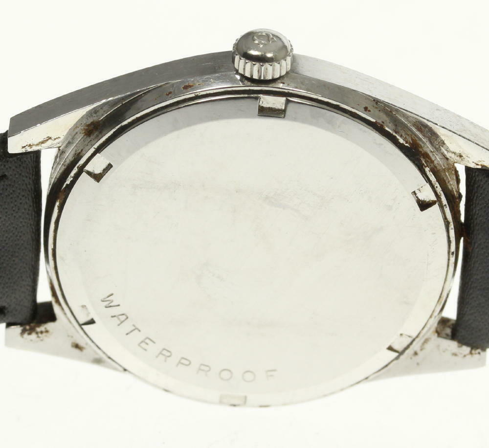

How about his one? It's cheap, it's manual wind, it's 35mm and it's my birth year. Case looks unpolished but there is some corrosion (or is it just gunk?) on the back. What do you think?
Thank you SO much in advance for your help.
2,086
2,899
Here are my thoughts:
Ref. 136.041? Looks legit and basically nice. The dial appears clean, apart from some tiny spots.

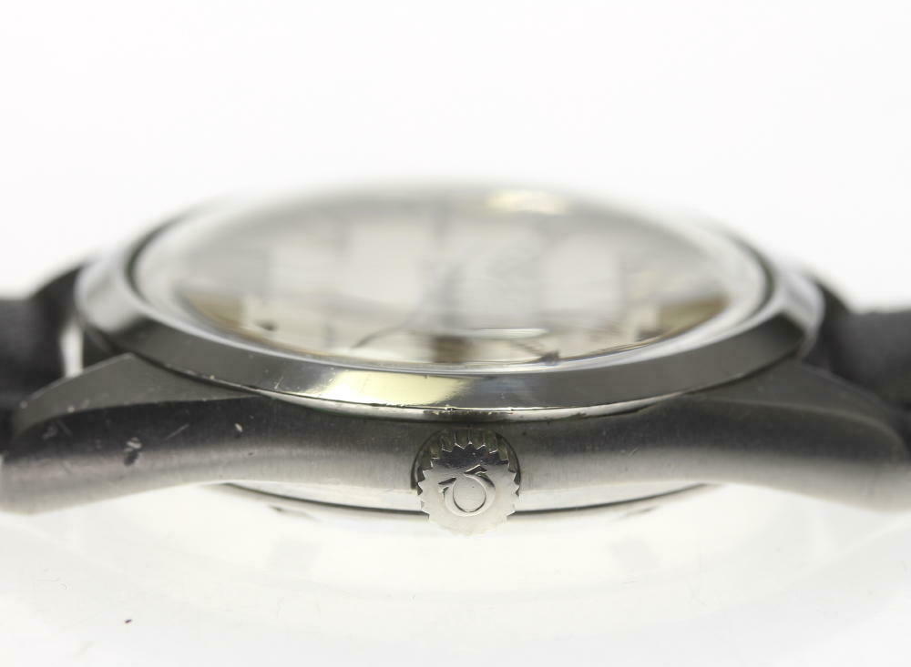

The crown is wrong.
The dirt on the back looks like dirt, not like corrosion. The watch hasn't been worn very often but case and back have been refinished non-expertly. This watch has been worn on a leather strap since purchase.
The movement looks good, but might need a service.

Dang you have such an eye for details OMEGuy, sure enough when I compare to other watches of the same reference: the crown is not original.
Thank you very much for your thoughts.
Asking price is $300. I know it's probably a bit too enthusiastic, and I have to factor in the cost of service. But would you say it's an OK purchase for a beginner?

Yep. If you really like it and you are aware of the weak points, go for it. You can't do much wrong with that price IMO.

On the topic of original crowns- Omega crowns for waterproof cases have rubber gaskets inside to make the crown tube seal. When they age and lose their ability to seal crown tube, it is common to replace the crown as part of a standard service. Omega has changed the design of many crowns esthetically over time, so when you see “non original crown” that’s not a bad thing as long as it is a factory crown for that reference with a fresh seal. Some hard core collectors insist on an original crown but wearing a vintage watch on the regular with an original crown isn’t wise- you have to assume it’s not waterproof anymore.
2,086
2,899
Agreed, but this design is off, isn't it?
