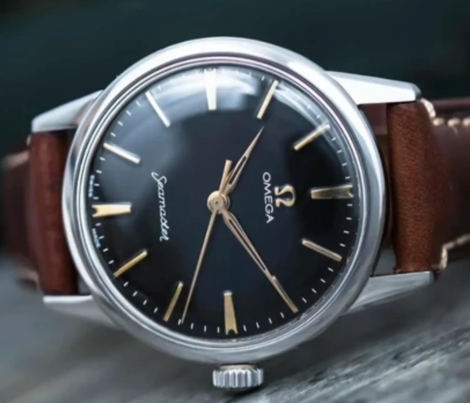

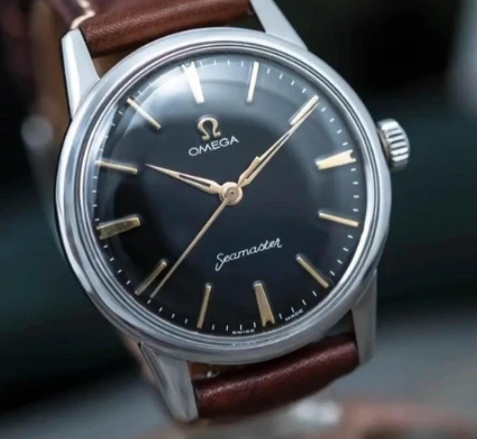

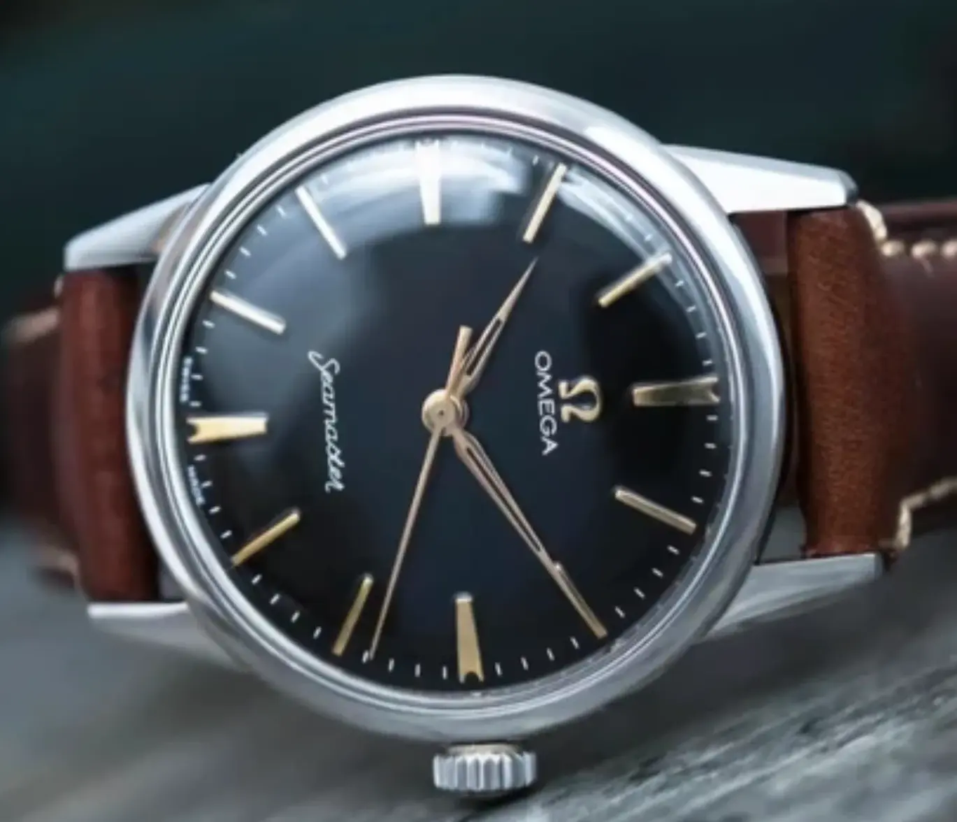

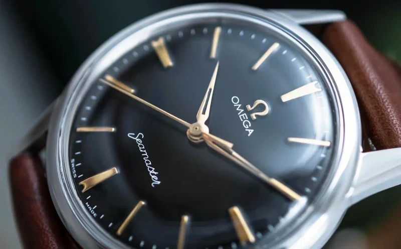

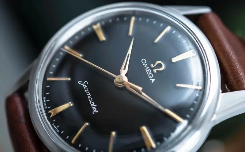

In looking around I have come across this black face Seamaster, Reference number 14390-8-SC, Caliber 284, Last serviced 05/08/2025. I am afraid, I have not done my research on the seamaster but it looks so good that I thought I would get an opinion here before going further. My questions are
is this a redial, as the dial is so clean, t
he case looks quite sharp to me ( complete Novice),
the price is 1600 euros, does this sound reasonable
Thanks in advance
Regards Babak

Hello and welcome
Black shiny dials on Internet 99% redials. This looks like redial but dial photo is so blurry can’t really assess it well.
Some sellers do this deliberately.
Text is white which is not good

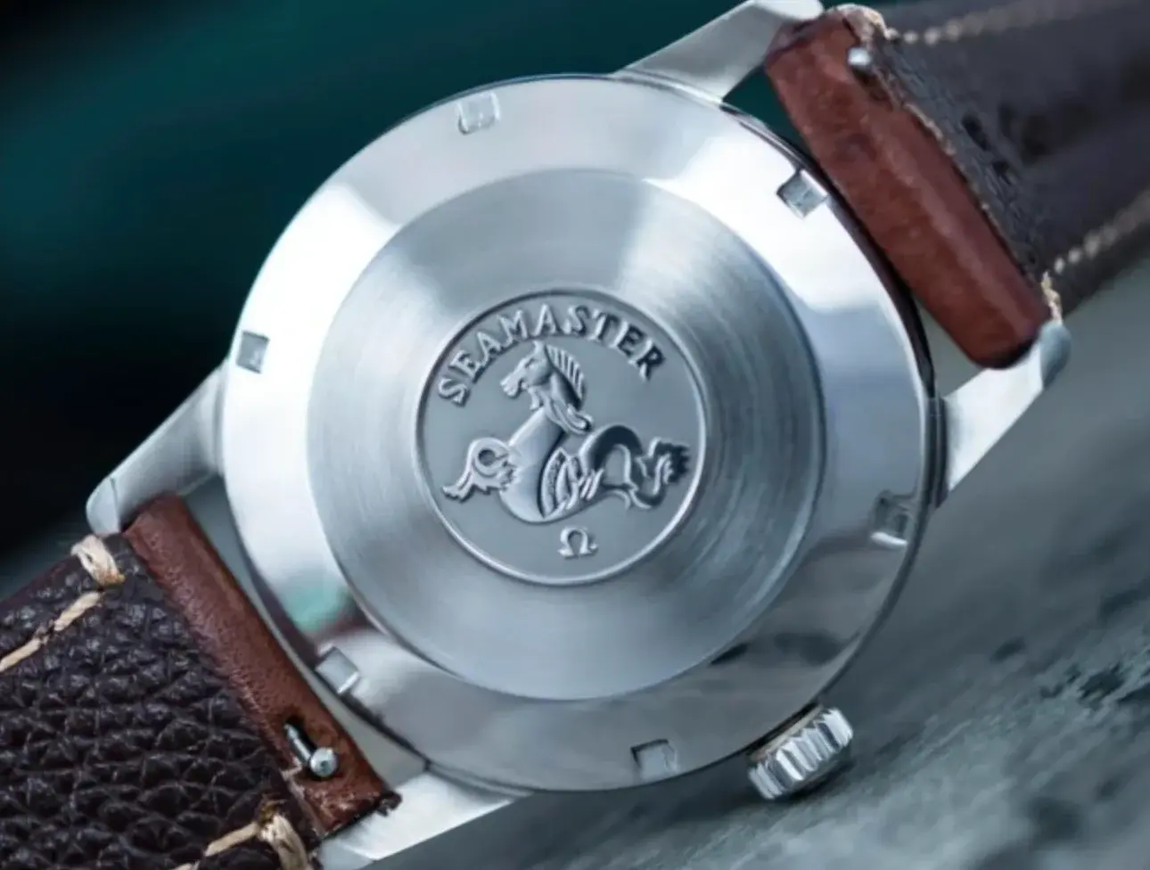

Case polished particularly back
Need magnified focused photos of dial

Thanks for that, The dial looks so good in the low depth of field photos, that it raised suspicion. I presume the white writings would become milky or cream with age?
3,501
13,366
It’s a redial. Few other issues but that alone rules it out. Price would be rather high even if this was original.

Still blurry. But not one to buy.

See the curved pits and the end of the major indices? Those used to have lume, the reason they don't anymore was because the dial was repainted. This is one to avoid and to be honest you will up your chances of something original if you just avoid anything black dialled for the reasons stated above by SOG

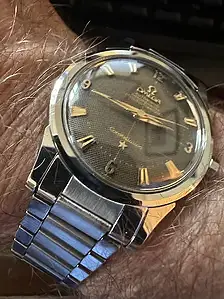

There’s a beautiful black gilt dial Constellation FS 14393 on Priivate Watches have a look to see what original black dial looks like
(No relation to sale but you can’t go wrong with seller)
Yes have seen that a lot of patina. I have a hard time accepting a dial with patina like that, But I guess that is the norm with the age.

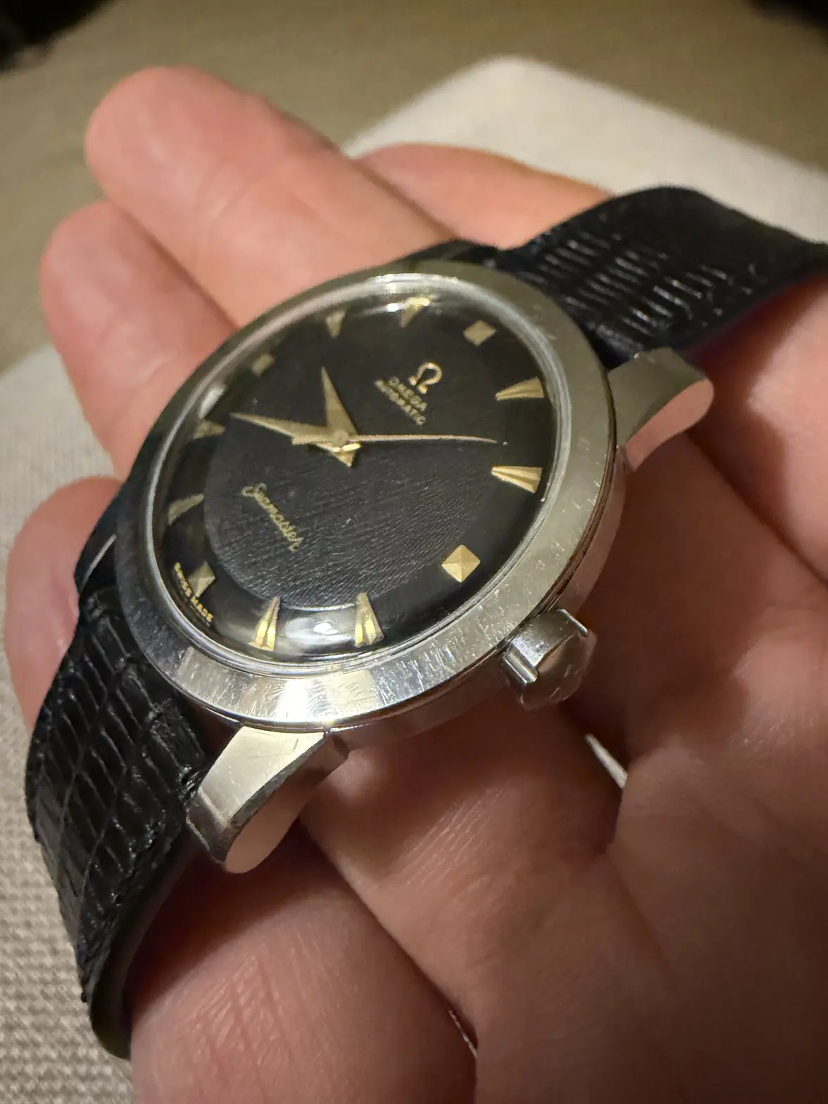

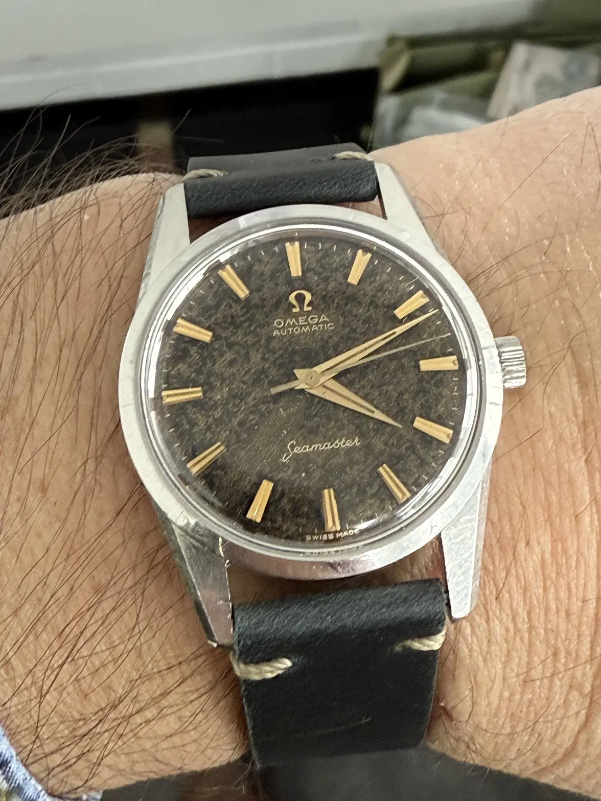

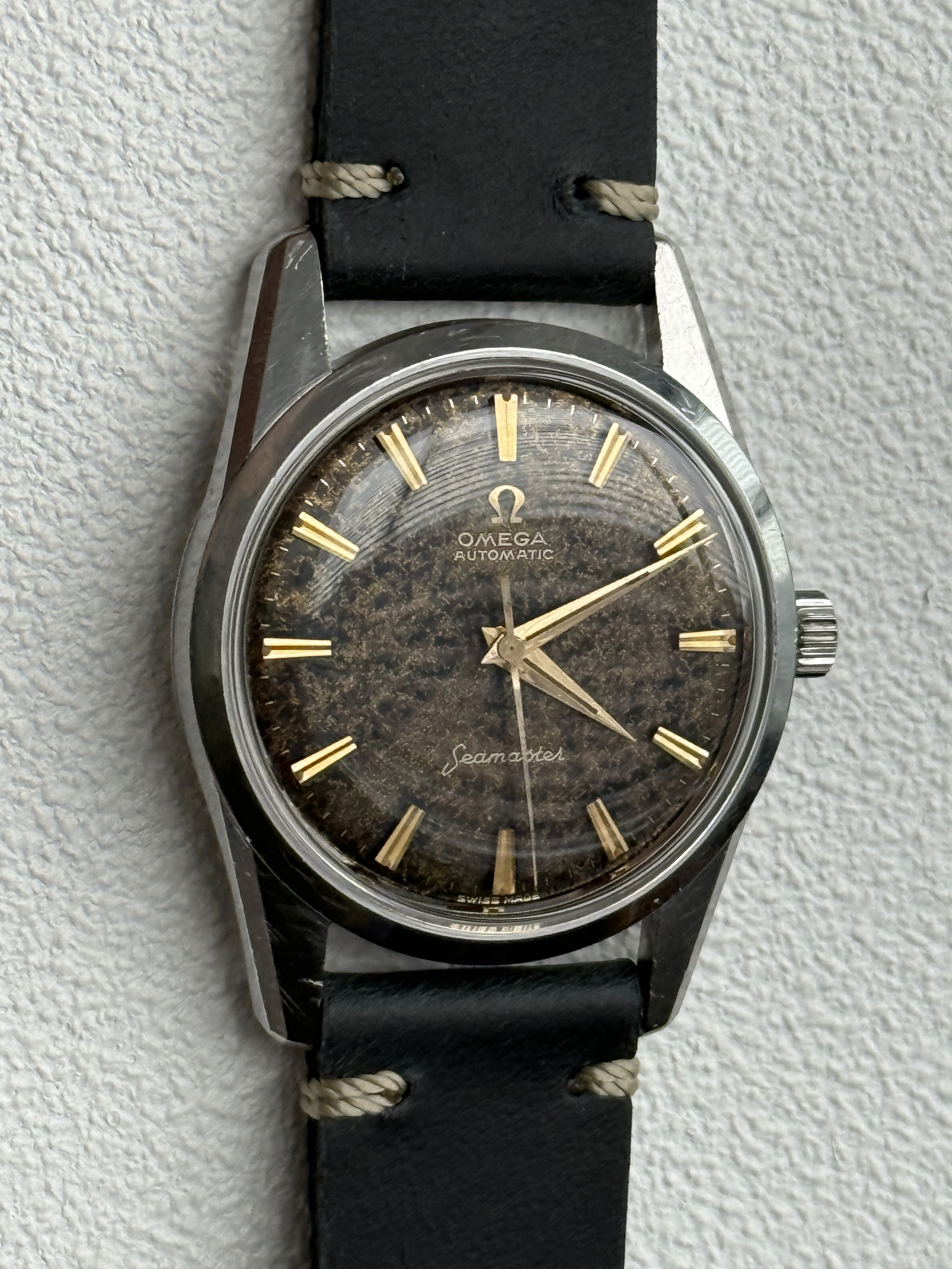

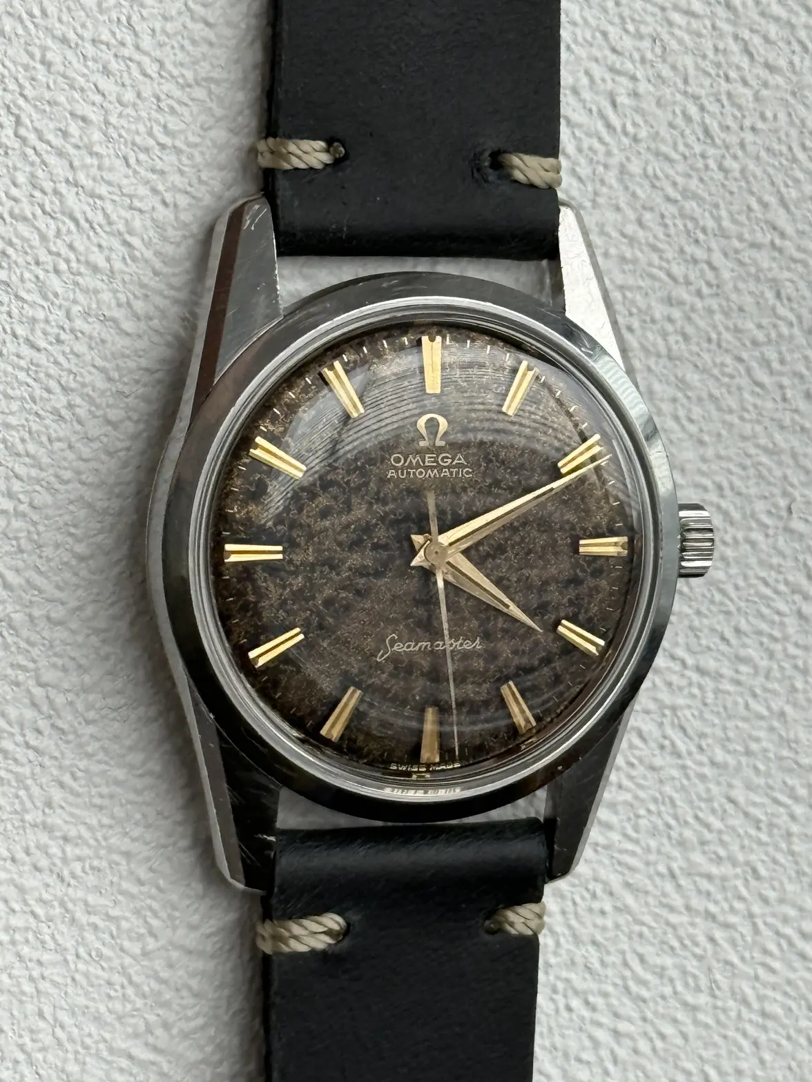

Not the same model I know, this is 14700, mine is auto and slightly later, but the case style is pretty much the same. It still bears the original Radium Lume. Some would say it has way too much patina, but it isn't unattractive (to me) and it wasn't silly money. The black dial has patinated to a gold undertone, perhaps the brass underneath showing through. This is an example of points 1 and 3 in my list above:

Not the same model I konw, mine is auto and slightly later, but the case style is pretty much the same. This is mine. Some would say it has way too much patina, but it isn't unattractive (to me) and it wasn't silly money. The black dial has patinated to a gold undertone, perhaps the brass underneath showing through. This is an example of points 1 and 3 in my list above:
That is lovely, and the patina in this case works well.

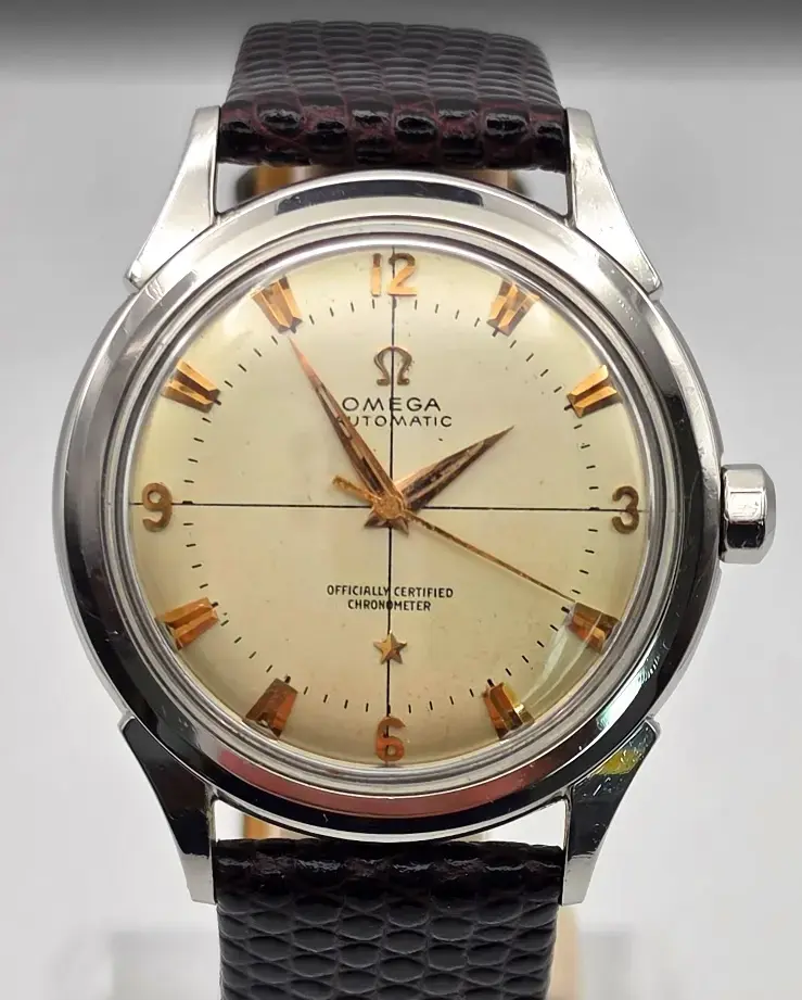

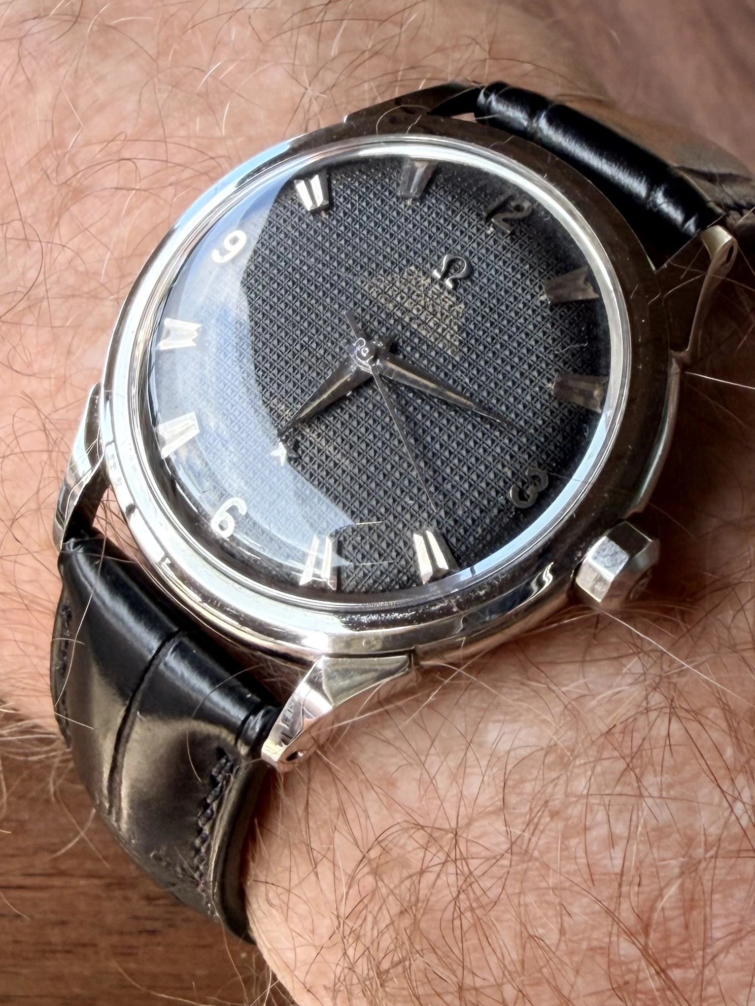

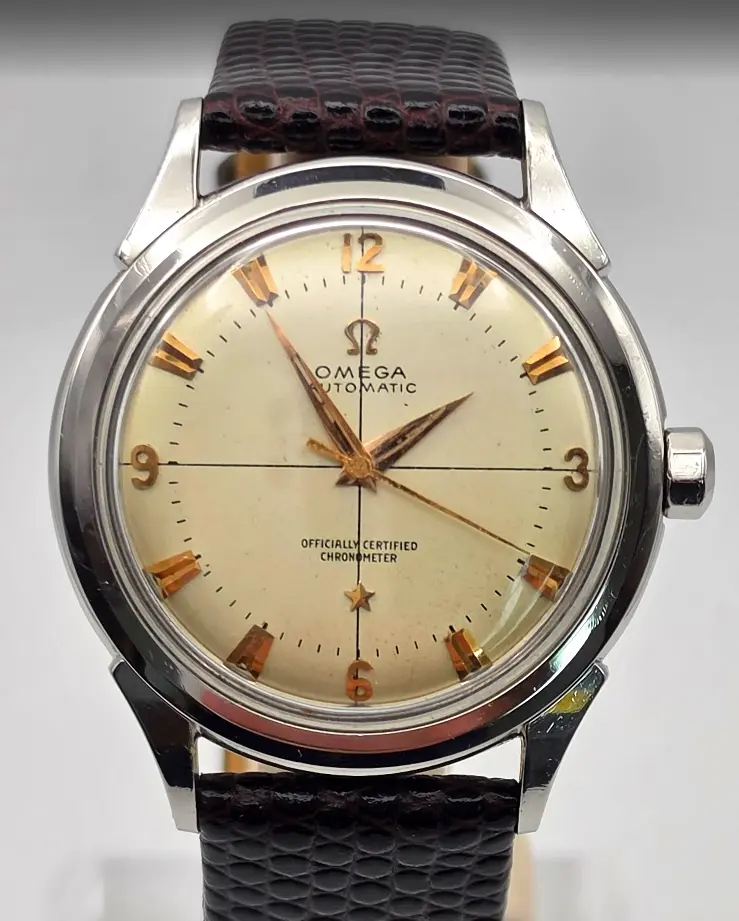

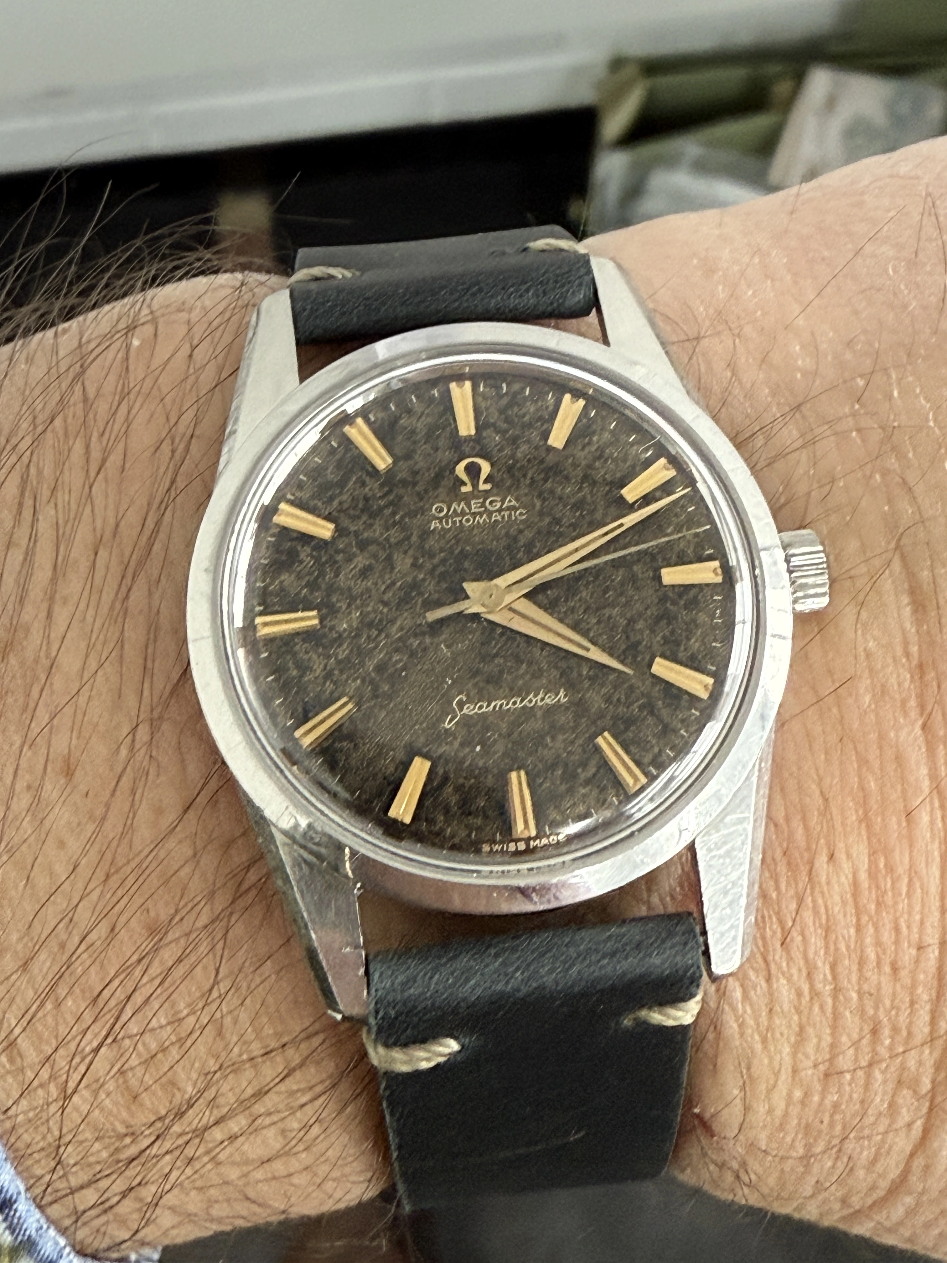

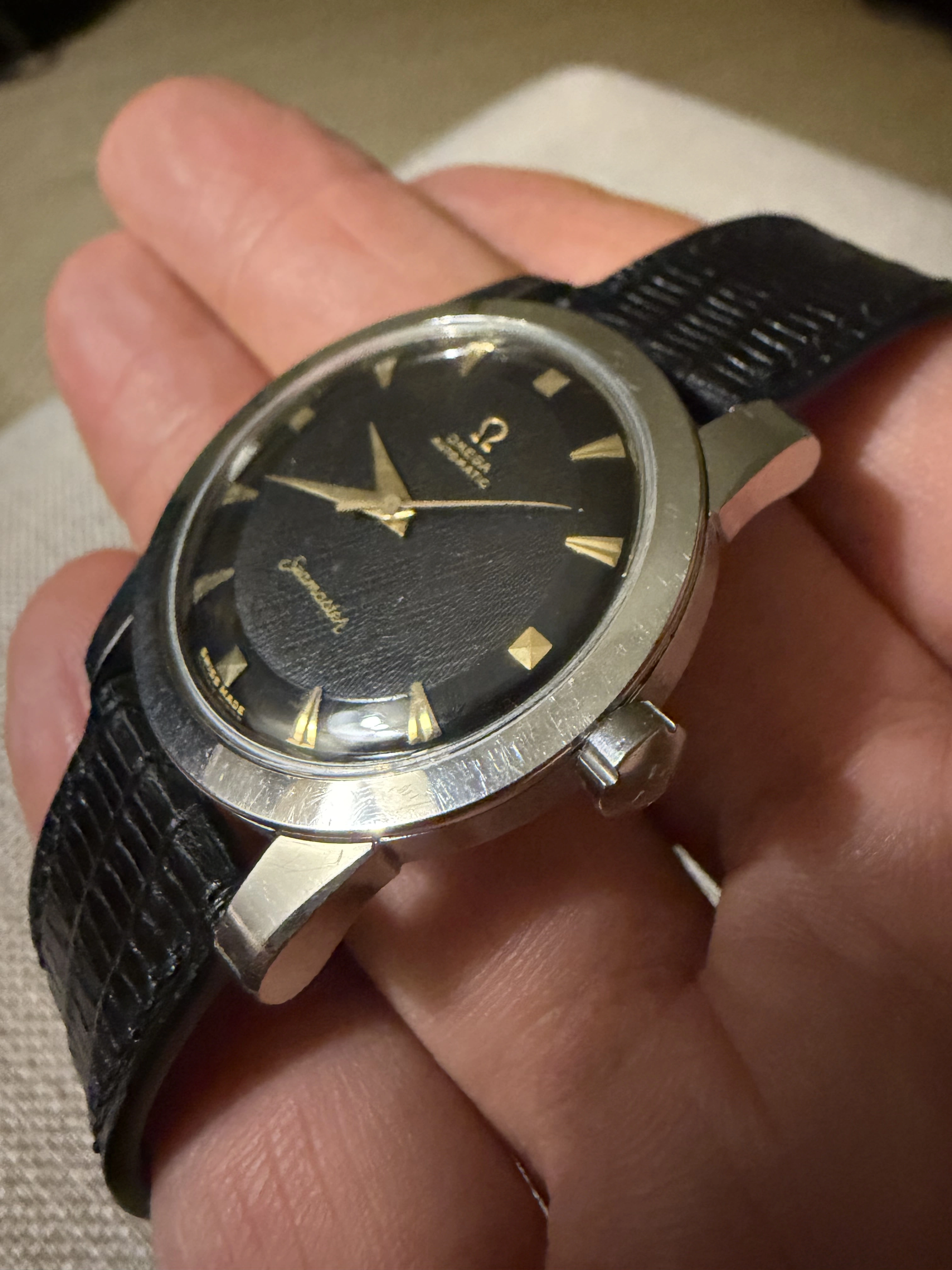

And here are a few of mine. Original, no patina, and definitely NOT cheap.

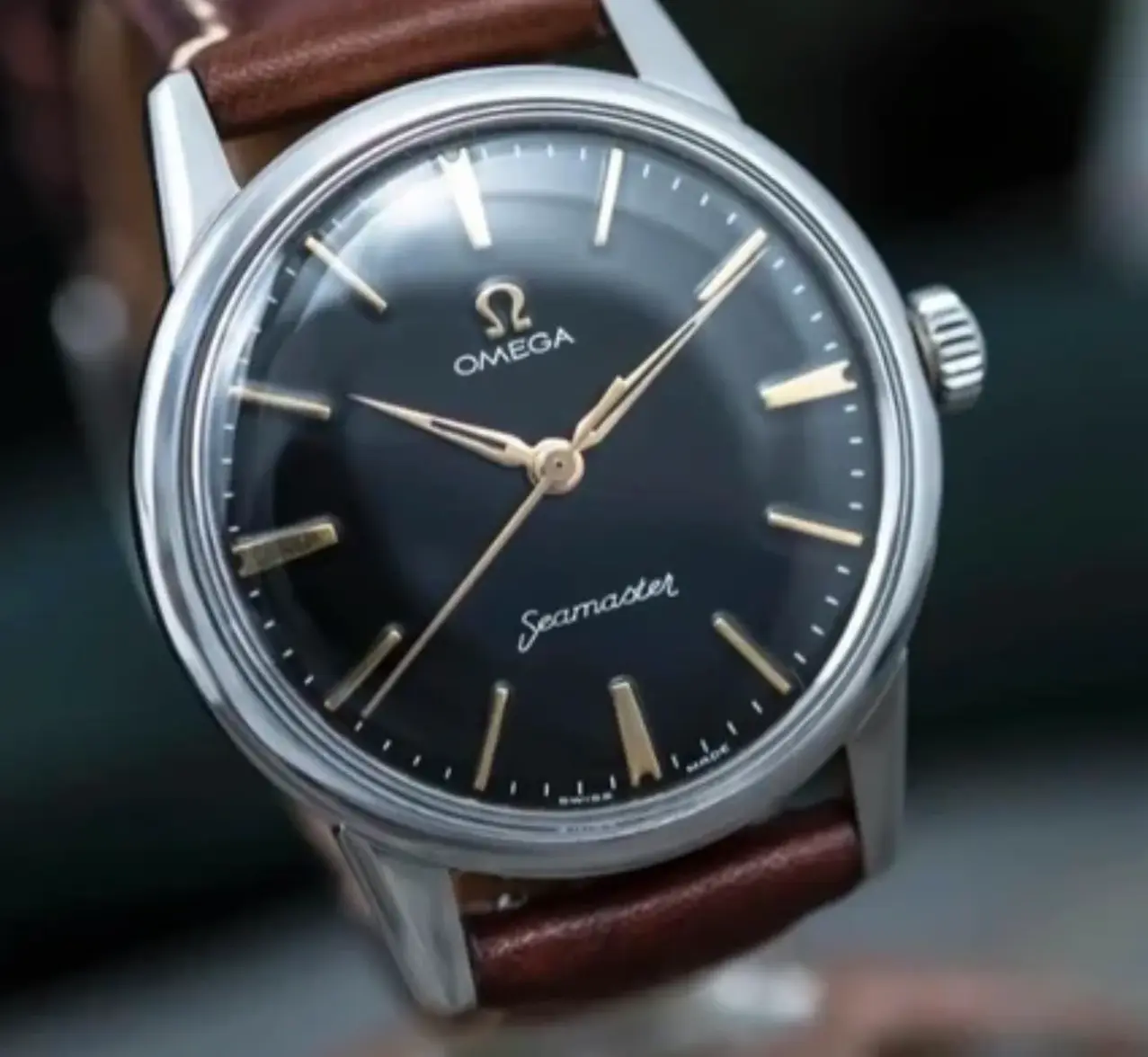

That is an awful redial. You need to look at a few examples of every watch you are considering and the redials will start to become easier to spot. Seriously, this one is obvious.
Oh but yes, you are correct, a watch of this age should use the French spelling. It gets trickier 1958-60 as there are exceptions and no defined cut off. But before this year bracket look for French, and after it should be English.

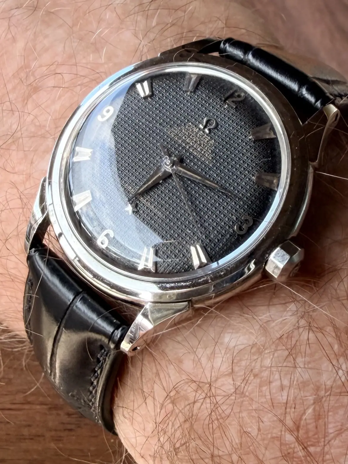

pic of the above added so the massive can judge for themselves:
OK. That is exactly what I am doing. But need a little guidance to differentiate from. To begin with anyway. I hope
