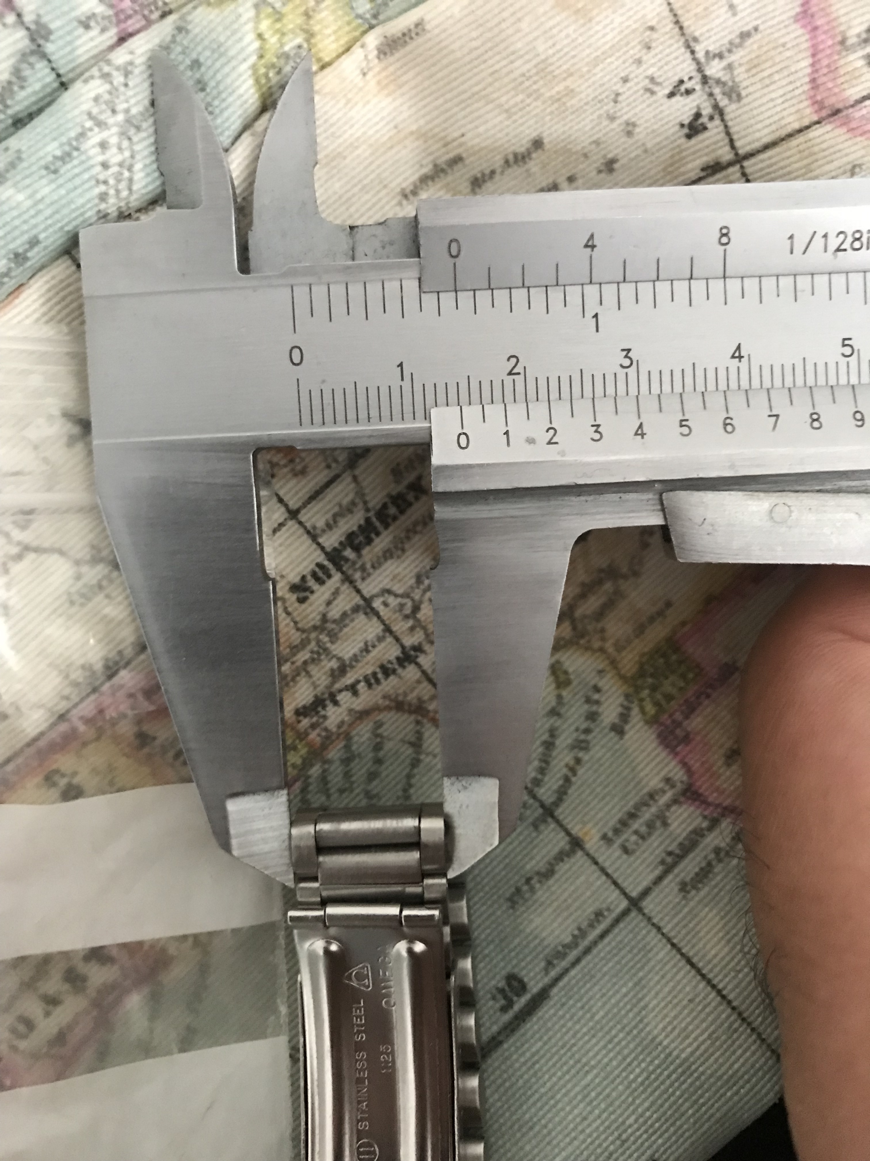

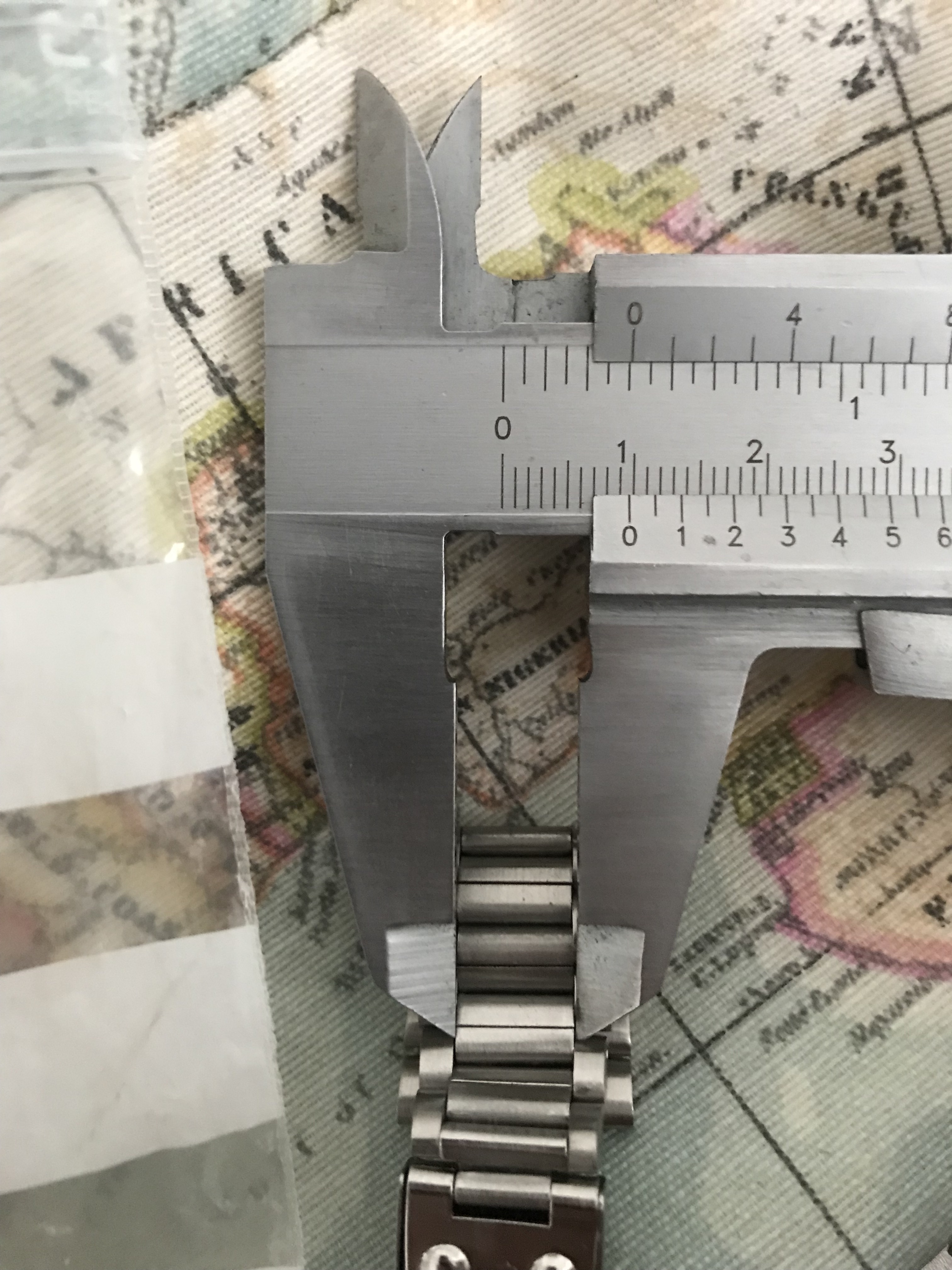

On my "1125" the middle link is 9,7
And removable links 14,2
Weird! So there are 14,15,16mm out there. It’s a minefield.

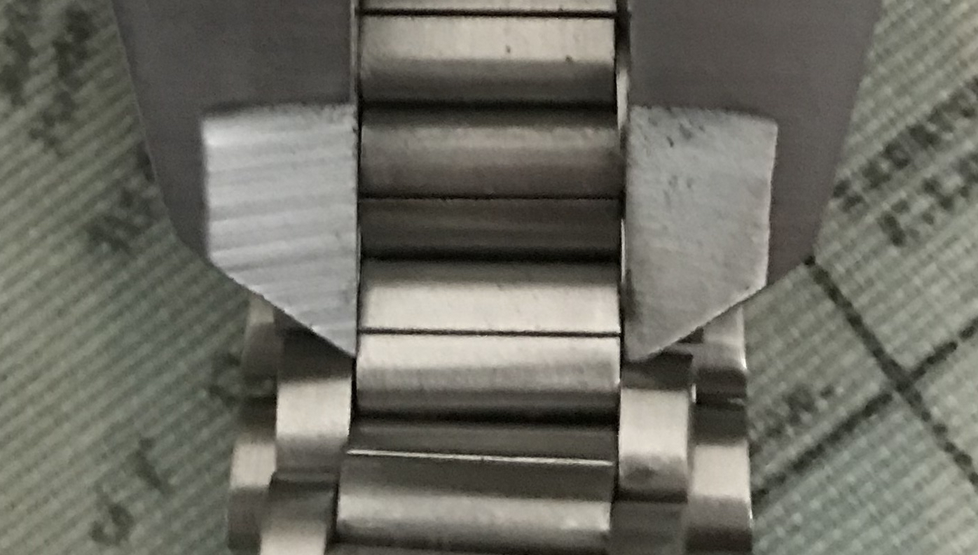

10,785
16,788
Maybe I’ll double check my measurements later with a second gauge but our centres seem to agree pretty closely.

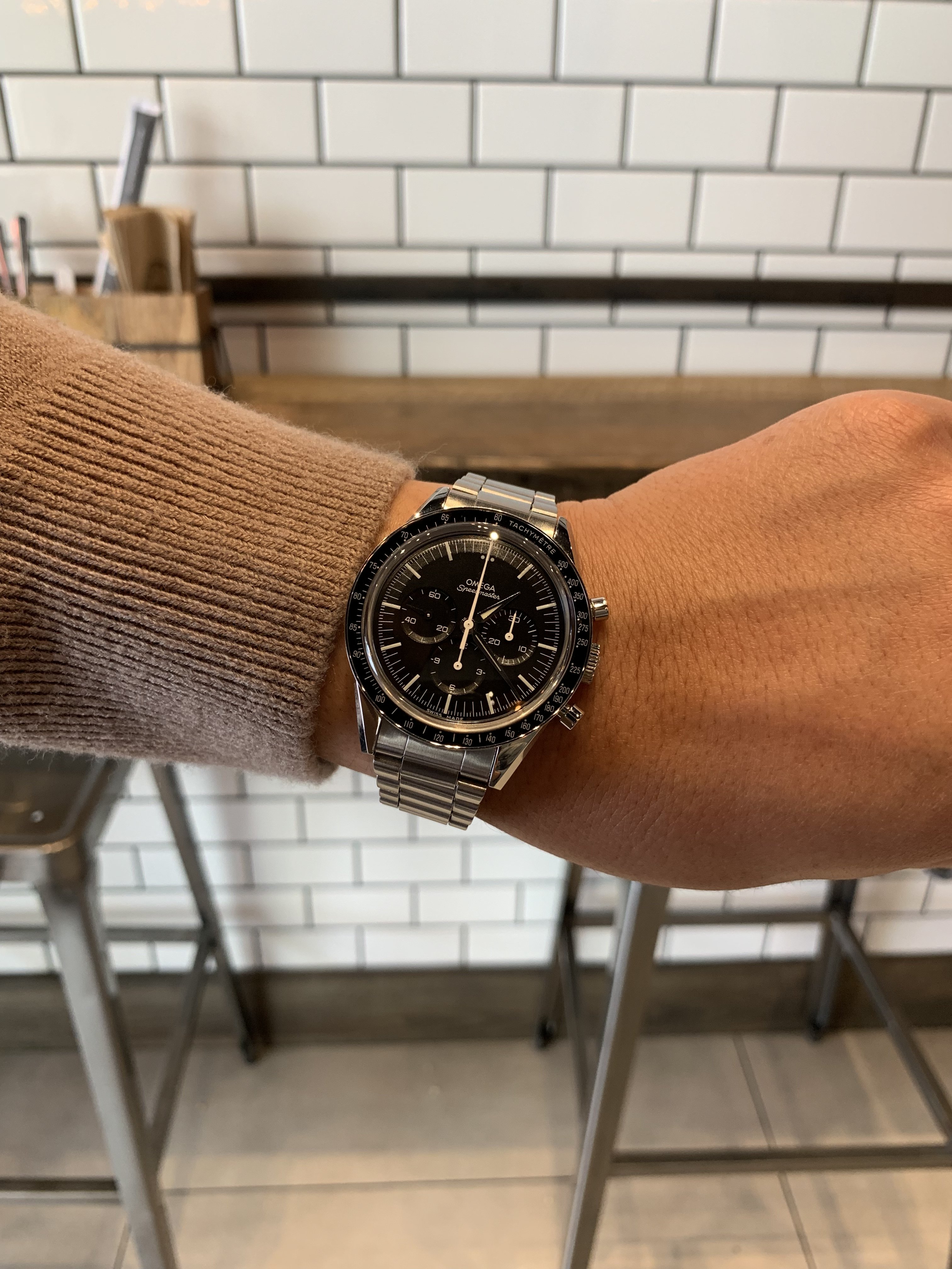

I did it! I filed down the last link with a stone, carefully, and I changed spring bars for 1,5mm.
I love this bracelet! 🥰

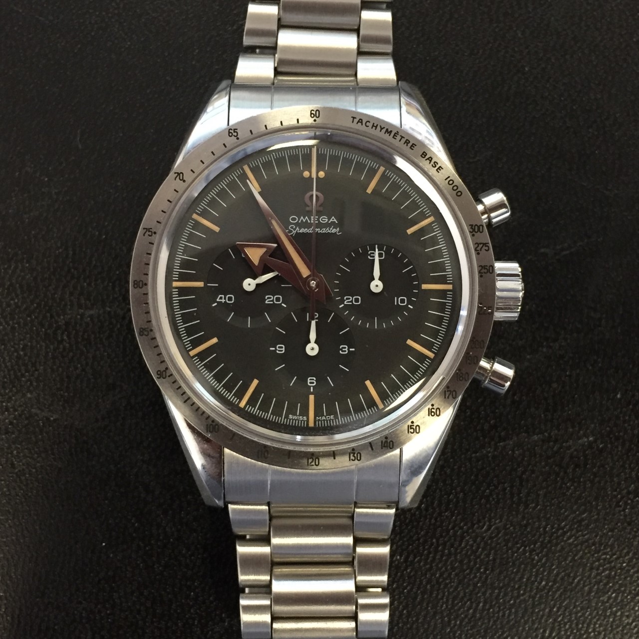

FOIS on 1068 bracelet - Not standard look. Something different, I like it.

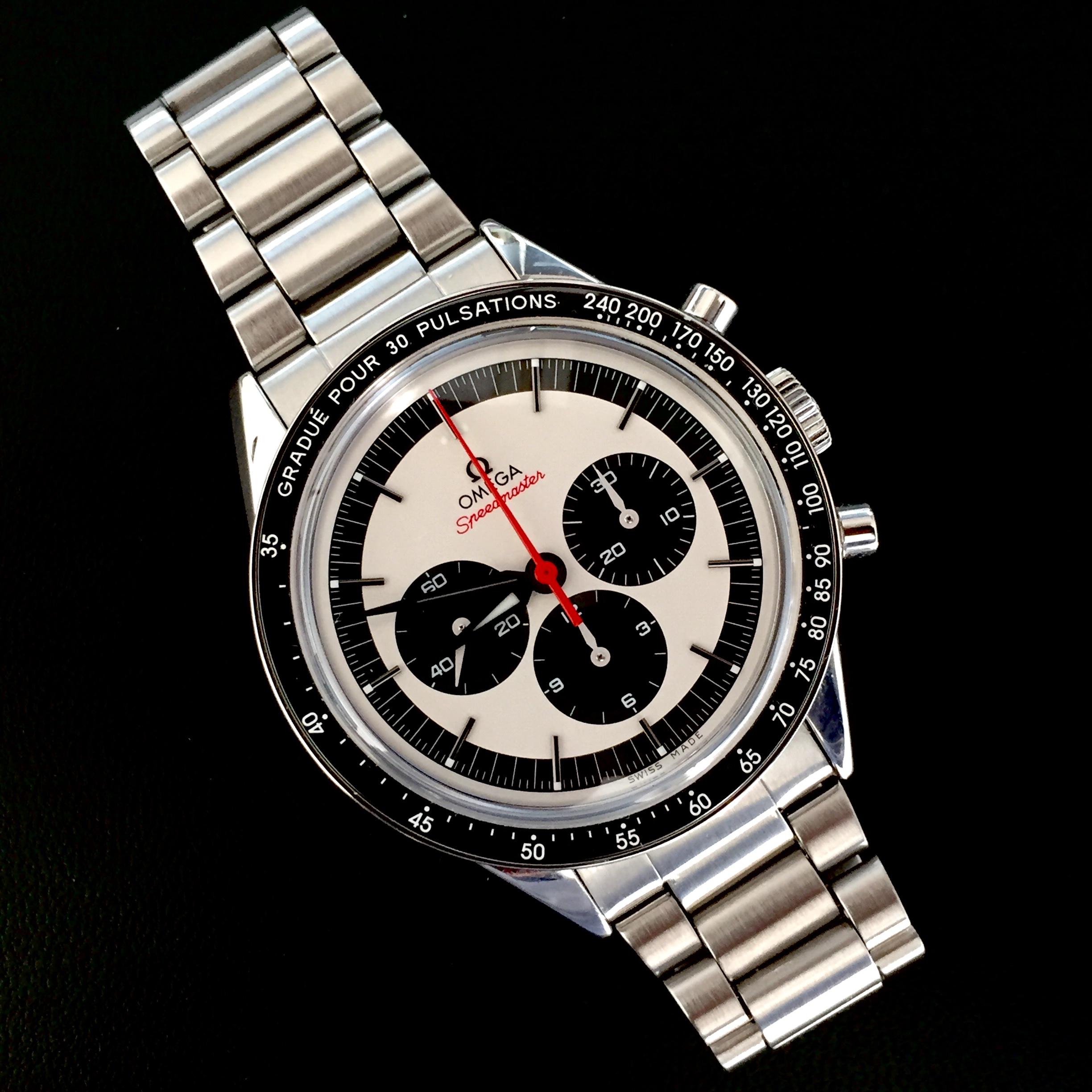

Here are a few pics.
CK 2998 with 1125 + 560
60th with 1125 + 617
60th with 1068 and endlinks from the 60th.
Cosmetically, I find the 560 for fit better within the lugs than the 617. Maybe a tad shorter.
