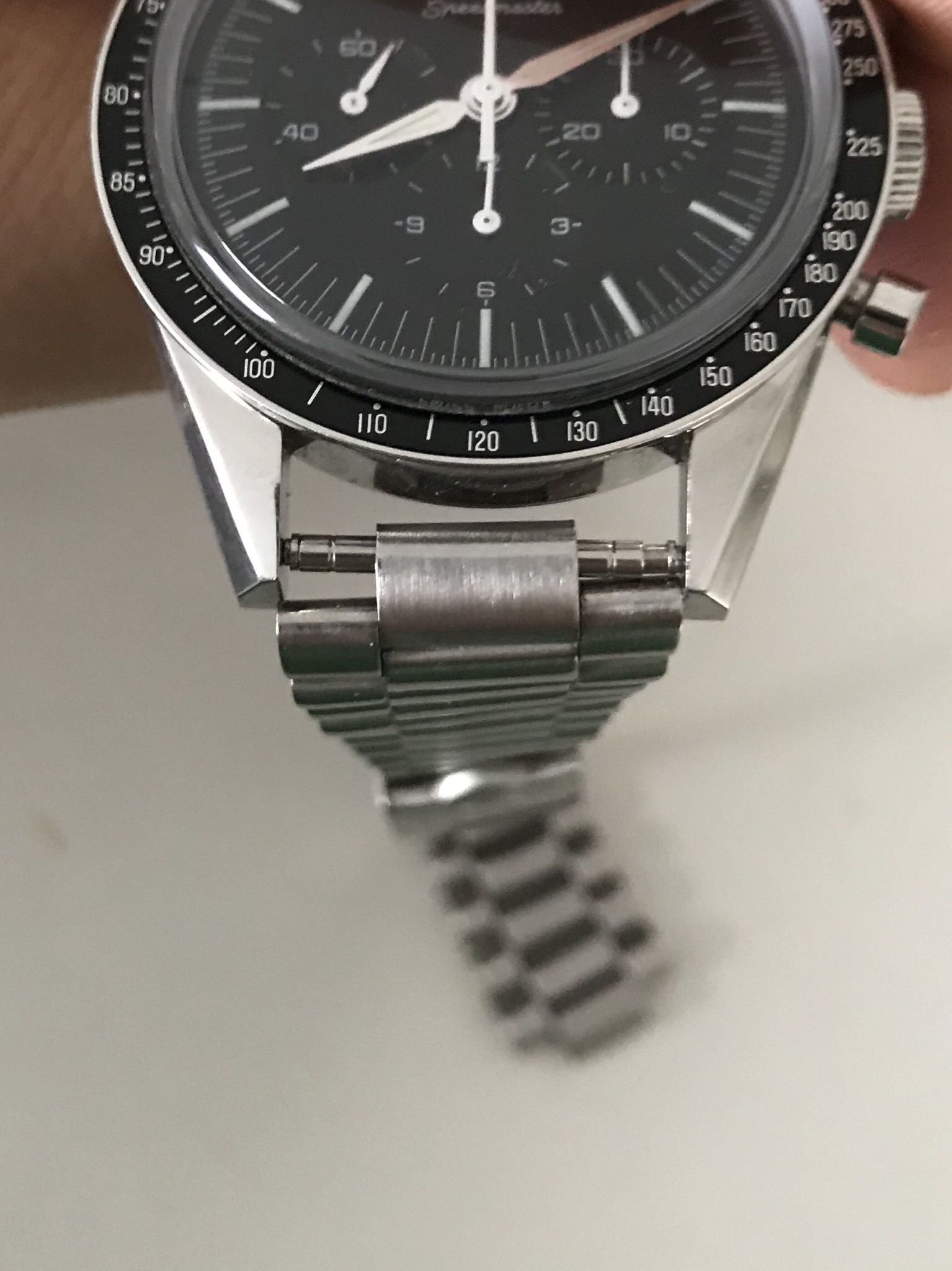

I just purchase a 1125 with 560 end link from second hand market. But I'm facing an issue. 馃槙
Last link is 19,3mm width and between the lugs 19mm as you know.
So, the bracelet is constantly in force against the lugs.
I didn't tried with 1,5mm spring bars yet, but I'm not sure than the 0,15mm diff茅rence at the radius will be enough.
Is somebody already facing the same trouble ?

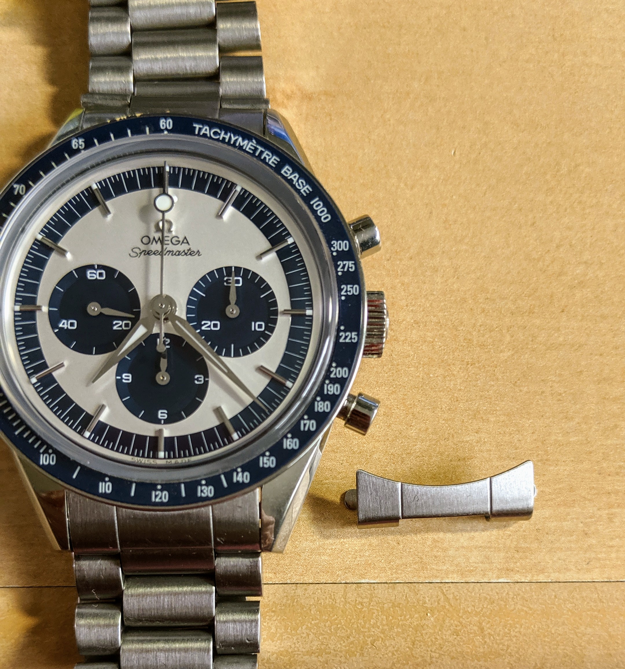

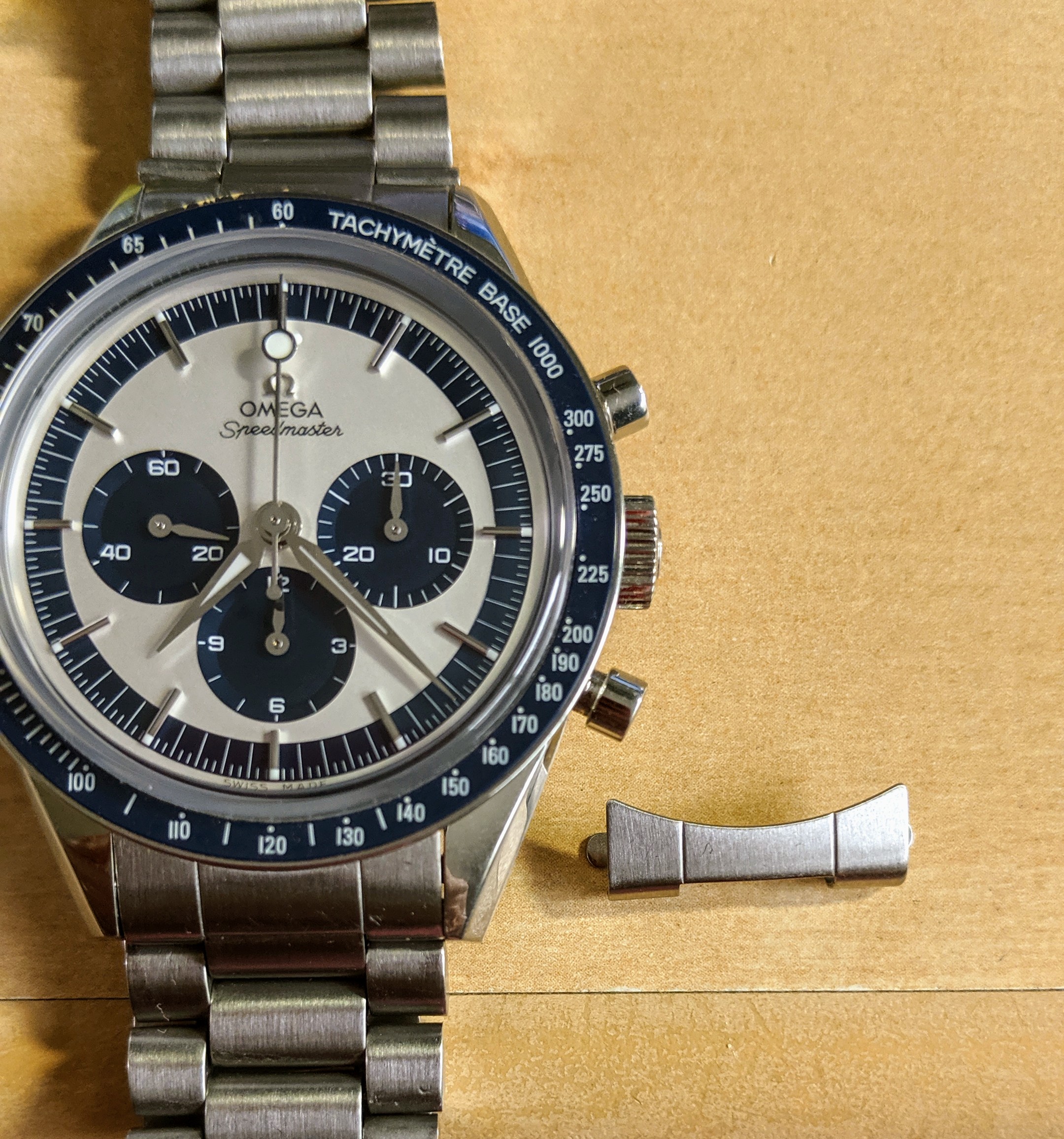

The 560 links to shallow. In my pic below I have installed 617 links and a 560 link next to it so you can see difference.

Very strange. I had my FOIS on the same combination of end links and bracelet and the fit was perfectly fine. Maybe the 1125 is available in different widths?
Thanks, but I don鈥檛 think the trouble come from endlink.
Without I have the same issue.
That鈥檚 the question.
Mine is more than 19mm width.
Somebody told me, it could be a 1171 with a 1125 clasp.
Maybe. 馃檨

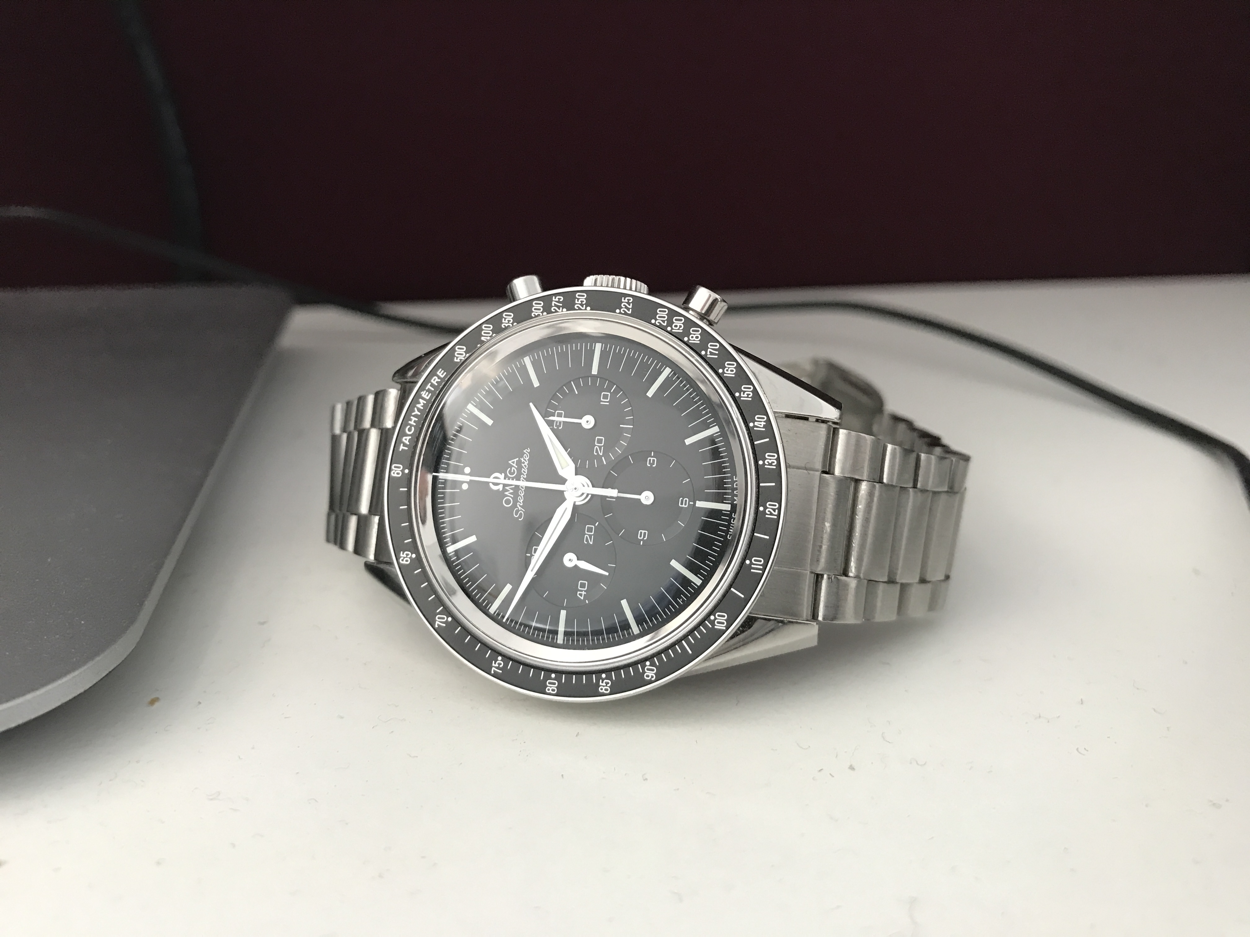

Wow I was considering getting the Professional Moonwatch, but I might have to make a change after seeing the FOIS on a Bead of Rice bracelet. That's one of the slickest watches I've ever seen.

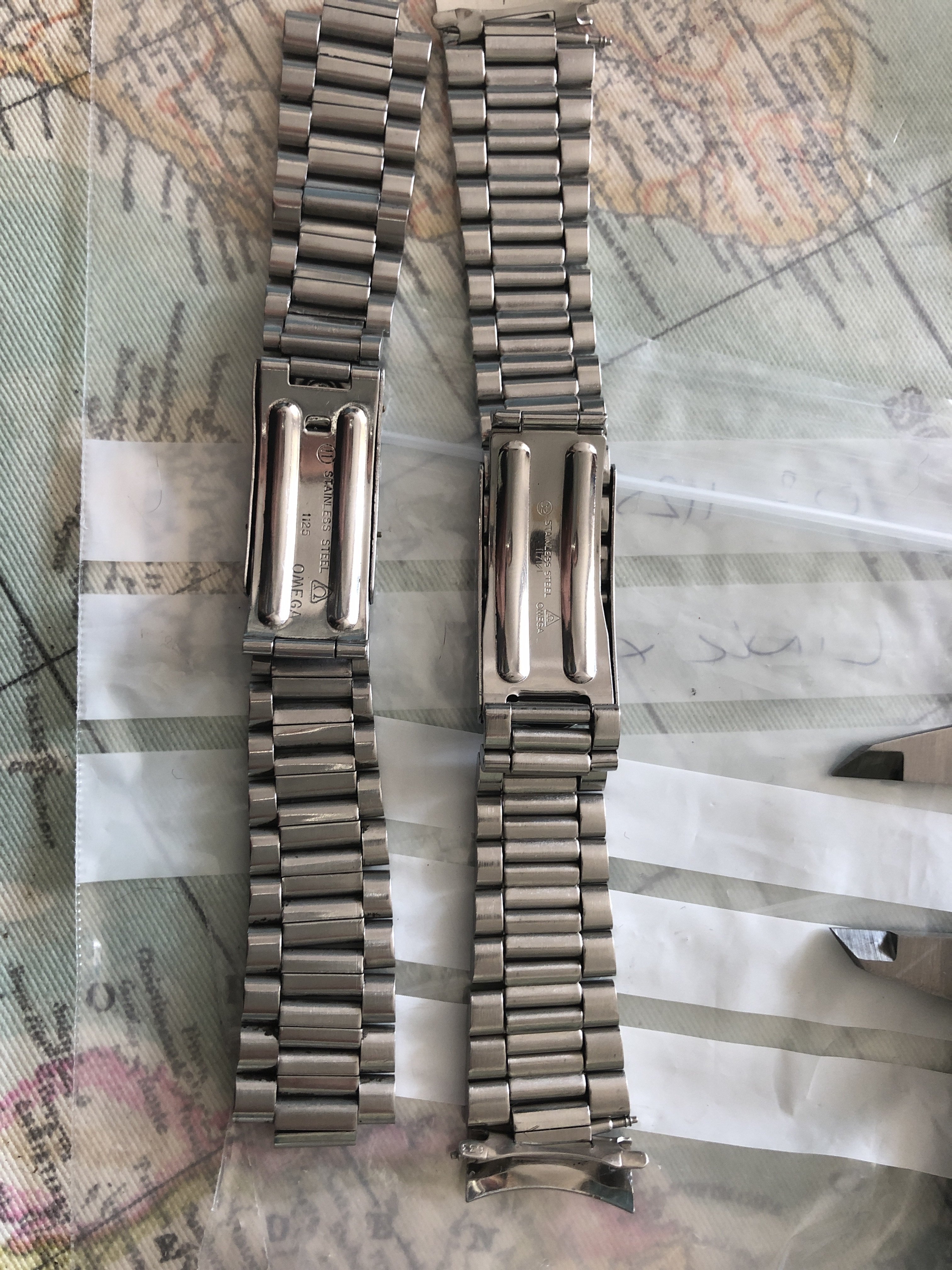

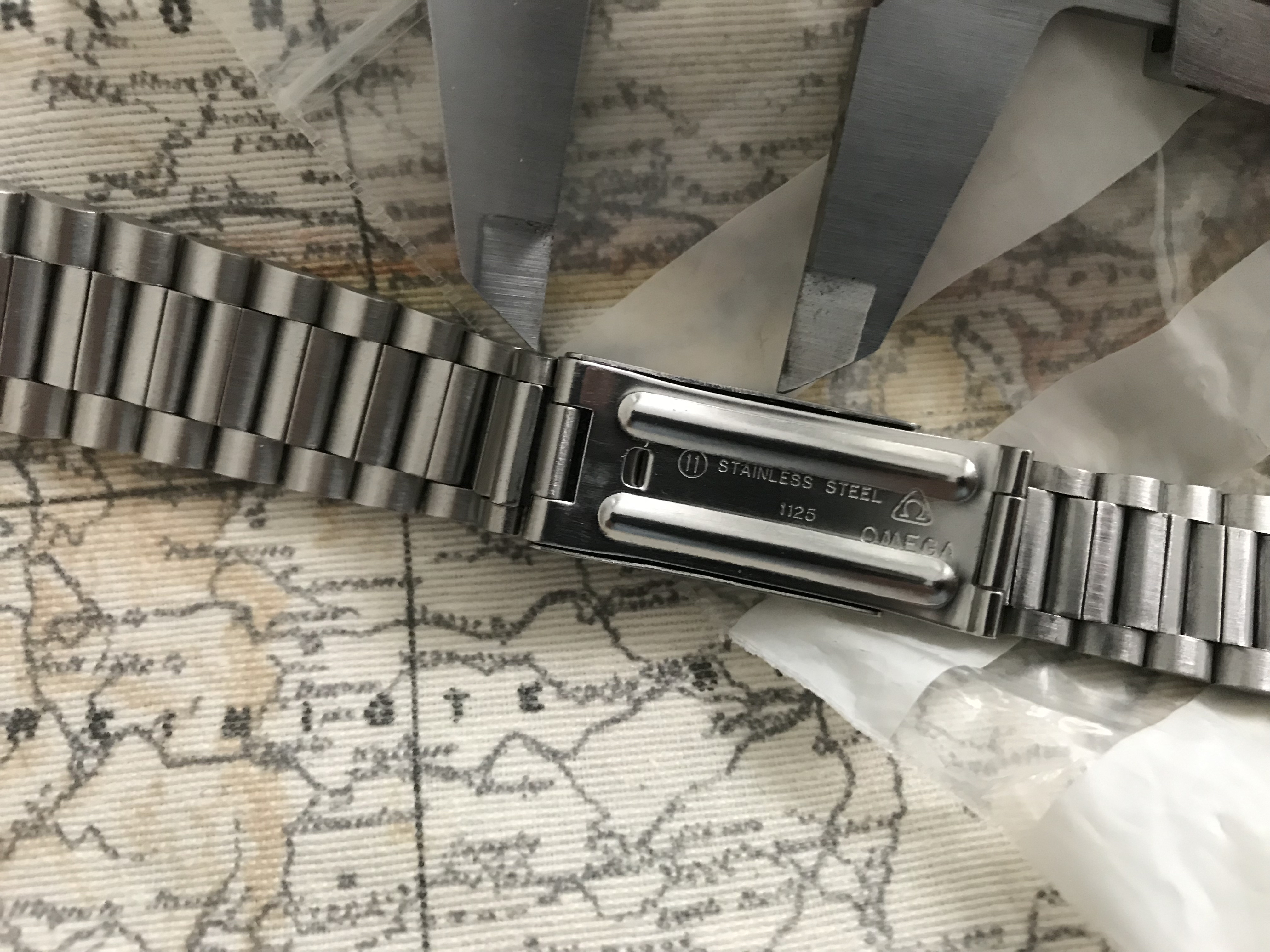

I have both 1171 and 1125s and the latter is definitely ~ 1mm narrower. I think you are right in that you have a 1125 clasp with wider 1171 fixed link pieces. My 1175 fits the straight lug case fine. You could try a curved are to move the wider section out but you don鈥檛 want to run the rock of a bar slipping out or snapping.

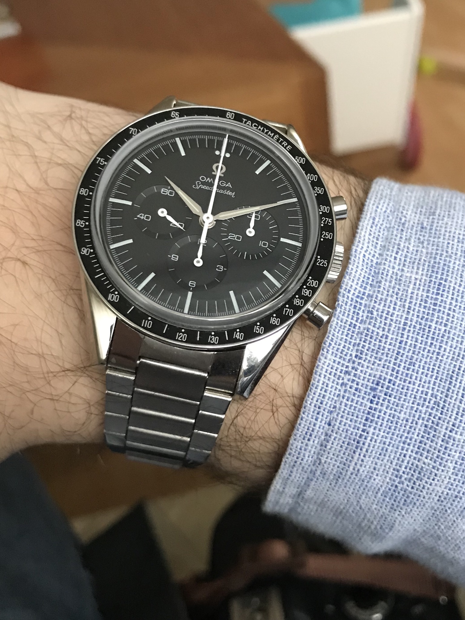

I also tried the FOIS on 1035 with No 6 end links. Great combination and fit!

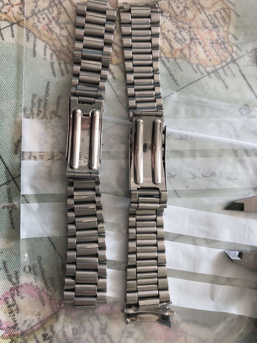

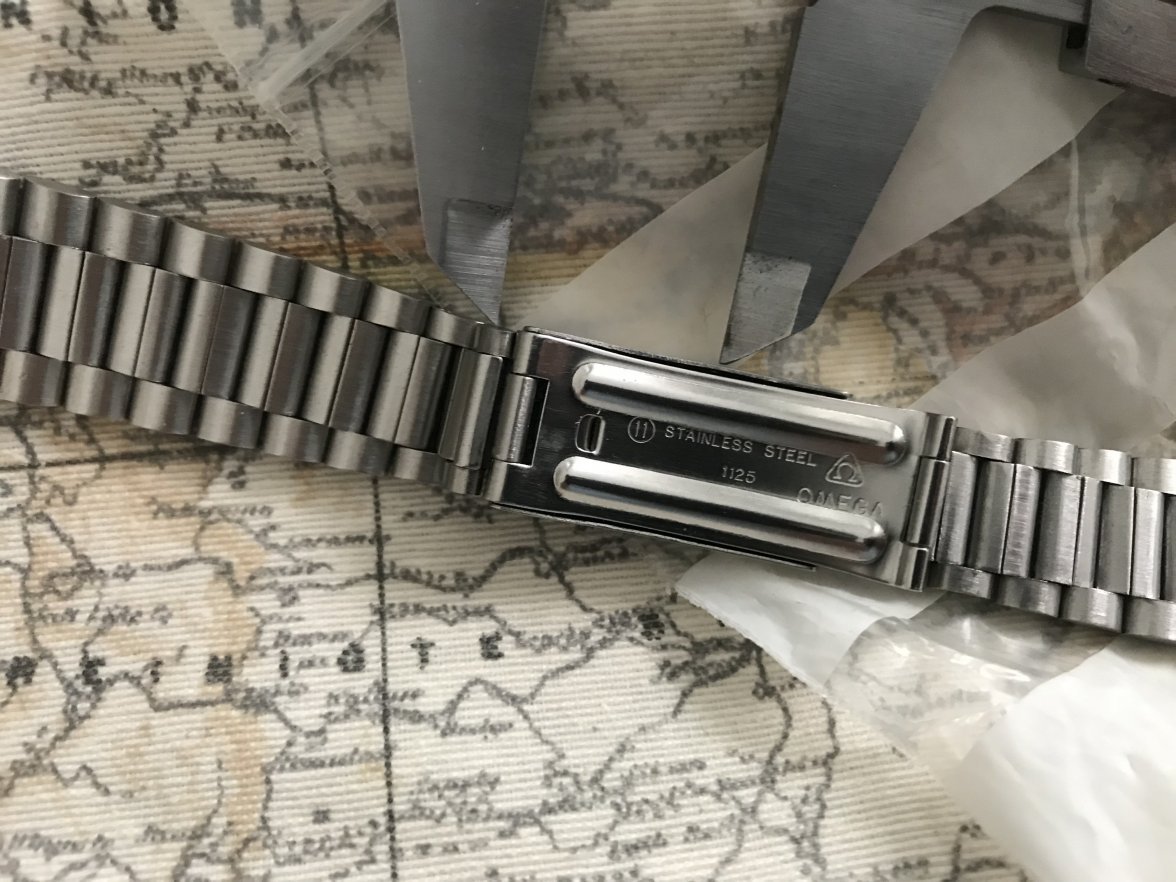

Your suspicions are correct. 1171 is 19.98mm, 1125 is only 18.98mm. Proof of life pic below

Thank you very much padders. Mine is 19,3. Already filed maybe.
I wanted to test spring bars of 1.5 and curved was an option but in any case, it does not regulate the fact that the bracelet will rub and damage the lugs.
All my watch with metal bracelet have bracelet thiner than the gap between lugs:
Rolex 16750 20,0 between lugs - 19,7 links
Seiko SARG009 20,00 between lugs - 17,75 links

padders, could you confirm the small links on the middle are same width on both ?
And I can almost do the same picture than you :

It seems the removable links on the 1125 are 15mm, the clasp is ~16mm wide. On the 1171 they are 16mm with a circa 17mm wide clasp. Quite different in fact. It may be relevant that both bracelets have been made for decades and there may be variation. My 1171/1 has pins, the earliest 1171s used screws. It鈥檚 still old though, circa 1980 maybe.
Edit I misunderstood you, will try to measure the centre links. Centre link on both comes in at just under 10mm. The 1171 seems to be 9.5mm the 1125 fractionally bigger at 9.6mm, sample variation probably.

Yes I was talking about the small bended part.
Because I saw some seller selling additional link saying compatible 1125/1171.
Mine smalls are 14 mm width.
10,785
16,788
Weird! So there are 14,15,16mm out there. It鈥檚 a minefield.
