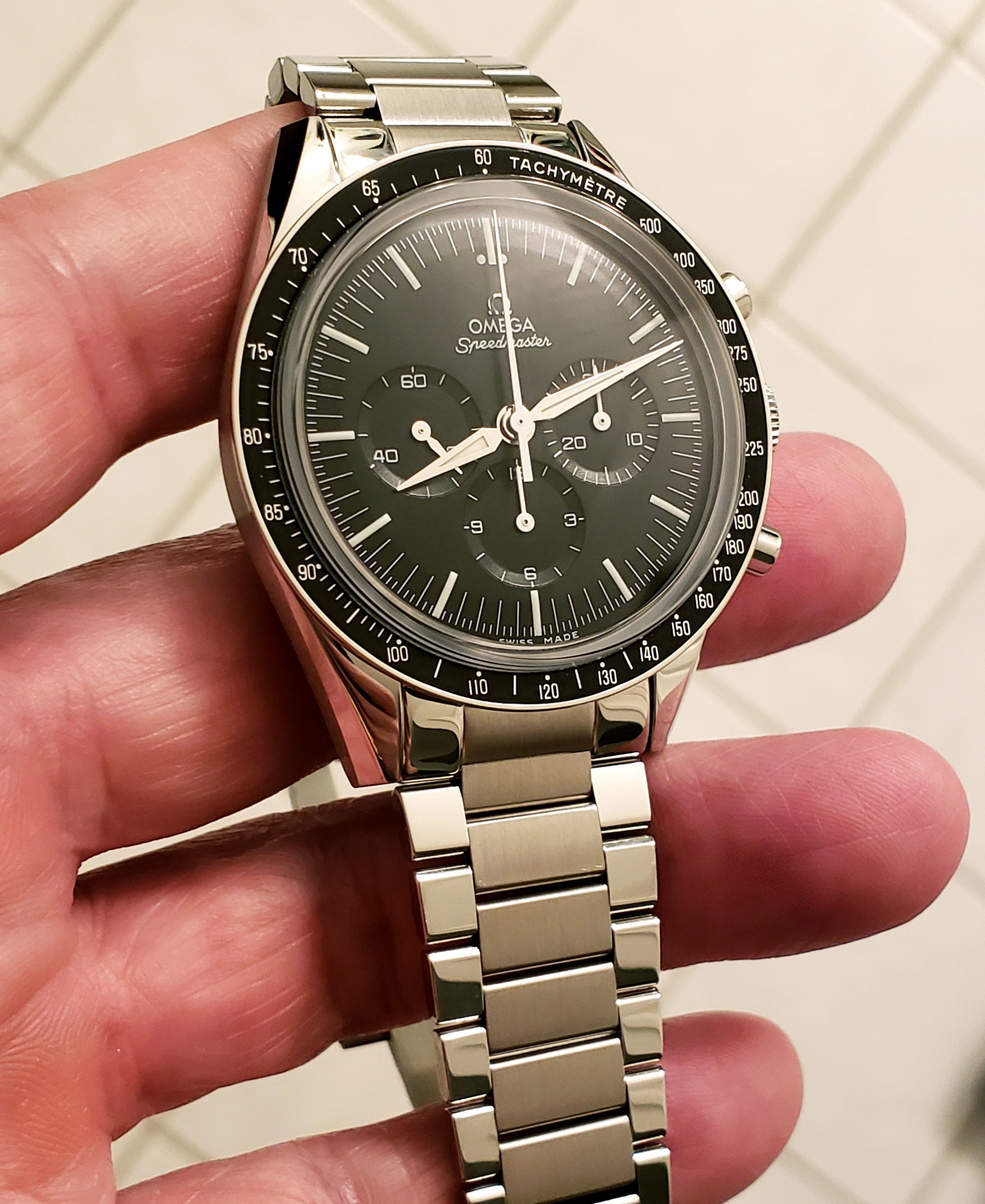

To clarify, the Ed White bracelet works on the FOIS with the US or Forstner end-links? Is thi
Thanks for all the info - you’ve covered everything I needed to know. The Uncle Seiko SELs just look too good with the way they fit the lug profile not to use them. If all it takes for it to work is filing the inner edges of the end links a few tenths of a millimetre and slightly thinner spring bars, that’s completely manageable.
I realise the Forstner end links are more “plug and play” but I’ve used them before and can’t stand them - the way they prematurely turn down changes the entire look and feel of the watch, and not in a good way.
My only obstacle now is deciding if I am willing to spend that amount on a bracelet considering I already have the Uncle Seiko flatlink with Omega clasp and I’m pretty happy. Part of me really like the “authenticity” of the thinner more flexible bracelet with vintage style friction clasp - it is certainly extremely comfortable.

My only other concern is getting a good fit, given the 321 bracelet only has one adjustment hole on the clasp and I believe no half links?
To clarify, the Ed White bracelet works on the FOIS with the US or Forstner end-links? Is this accurate?

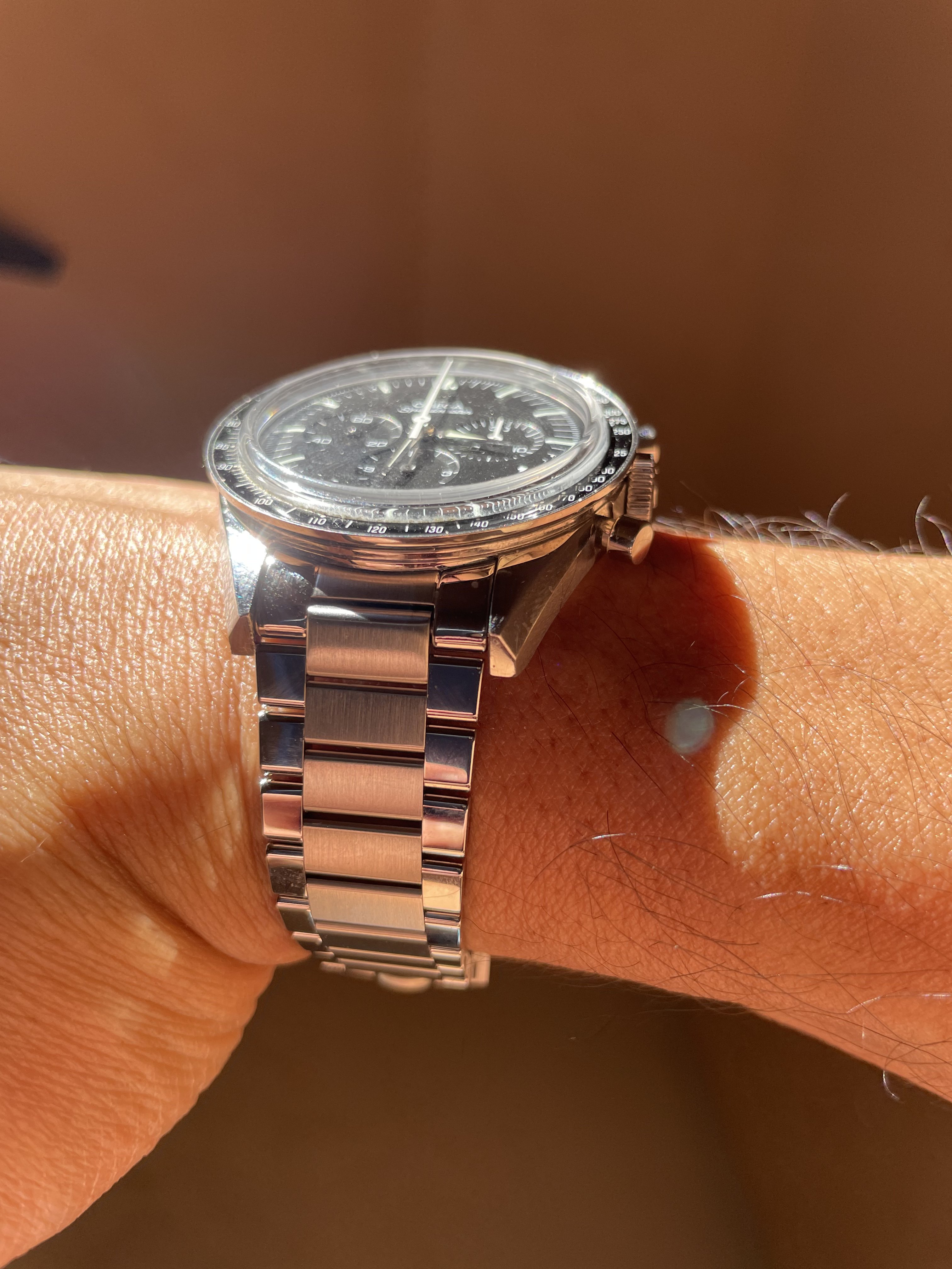

Loving the fois on the Ed white bracelet!
Did that require an end link swap? And do you have the part number for the bracelet?
Correct.
edit: sorry, ignore me. I’ve read back up the thread now.
Yes, and 020STZ012773.

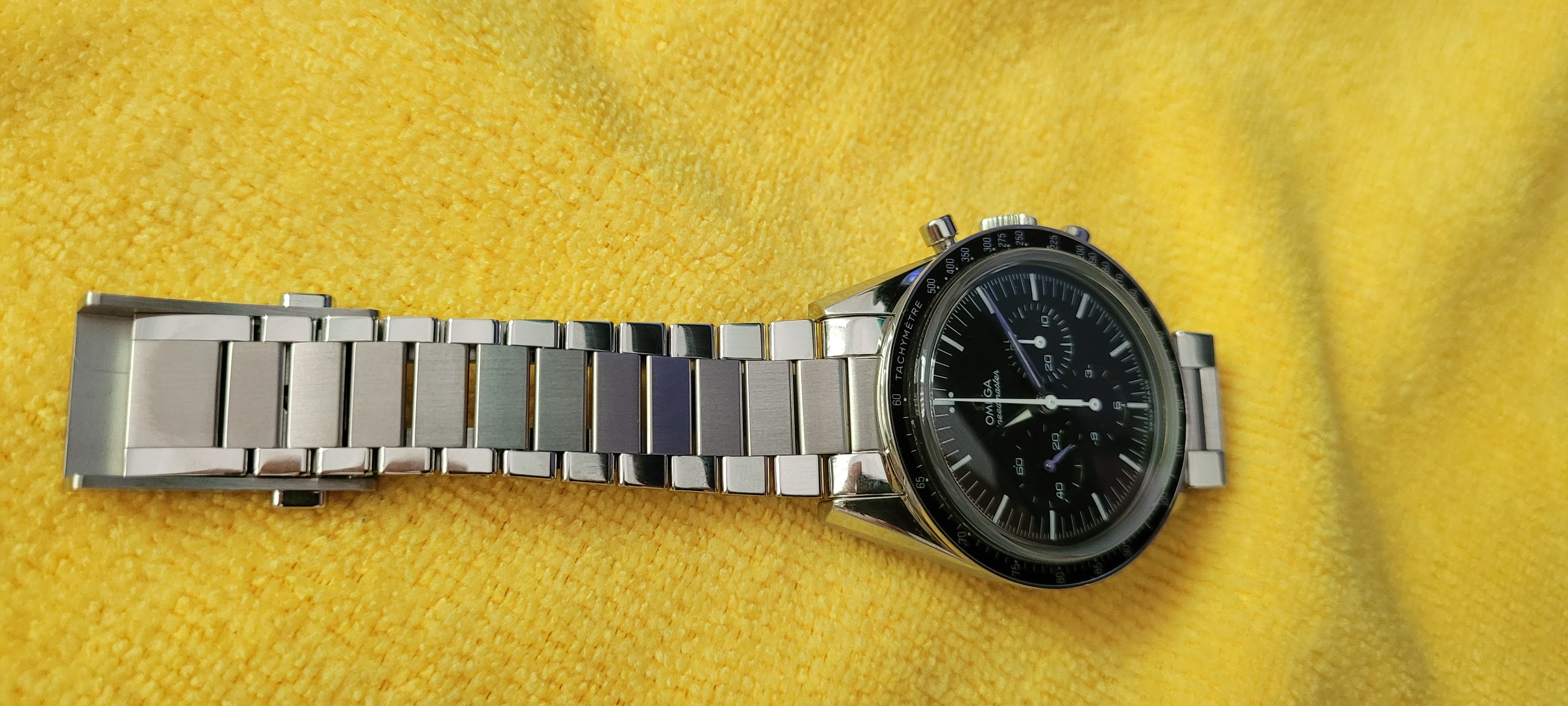

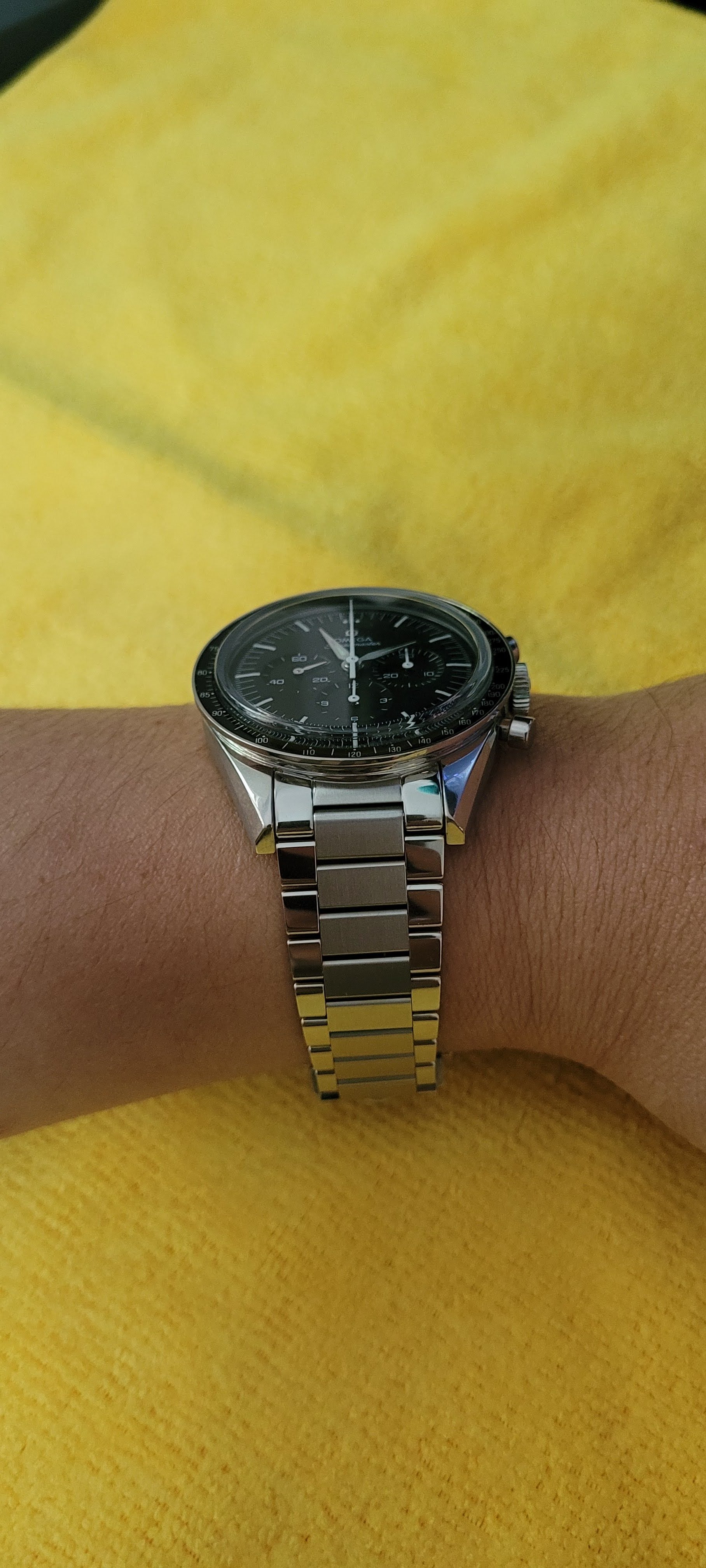

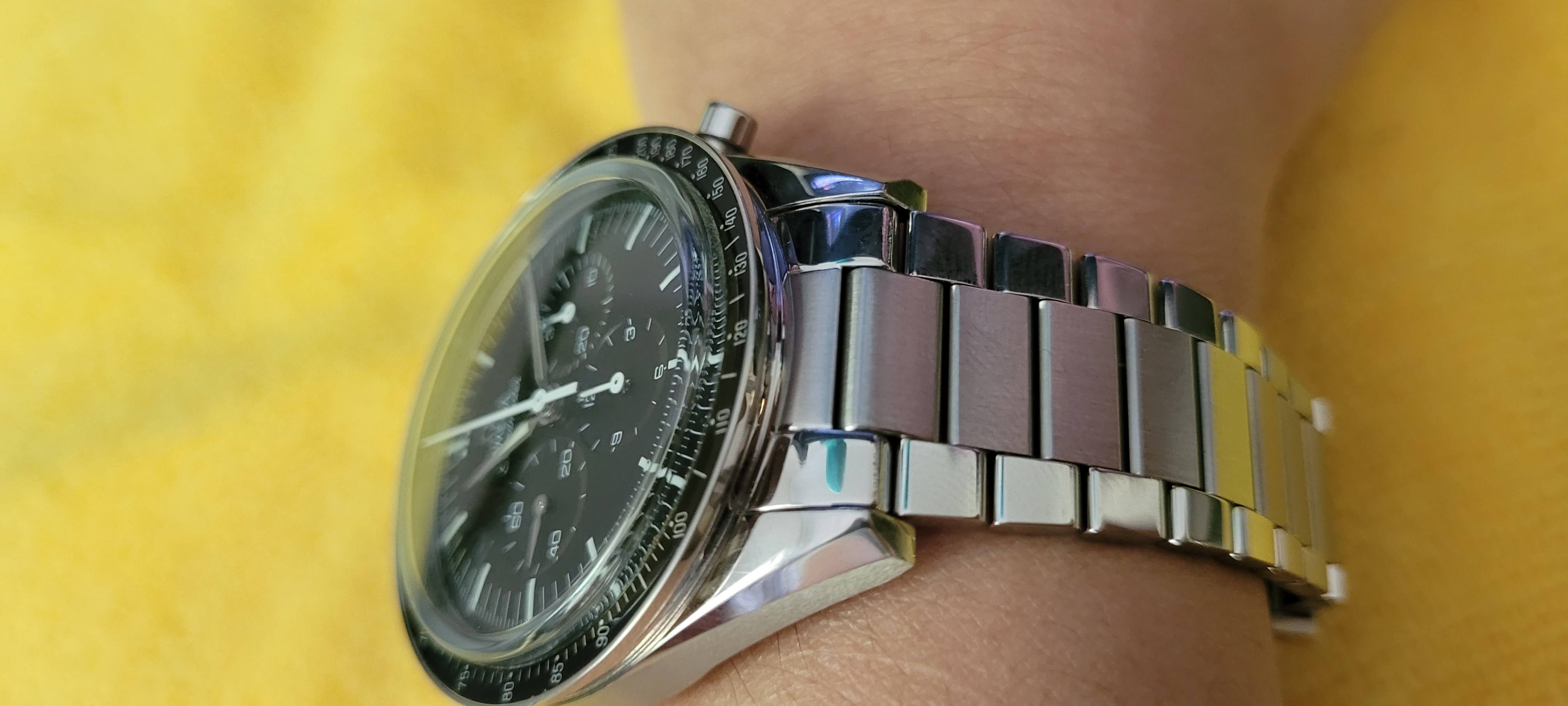

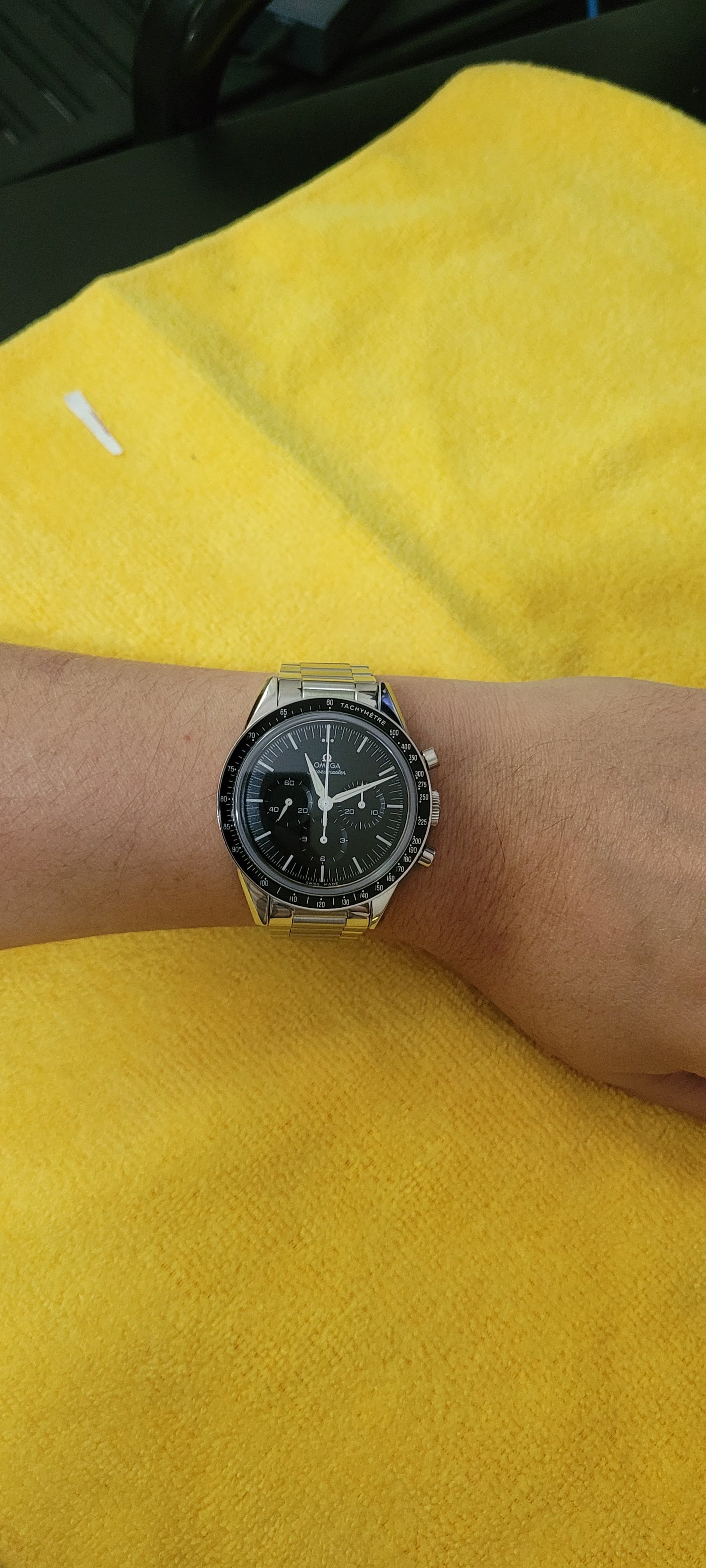

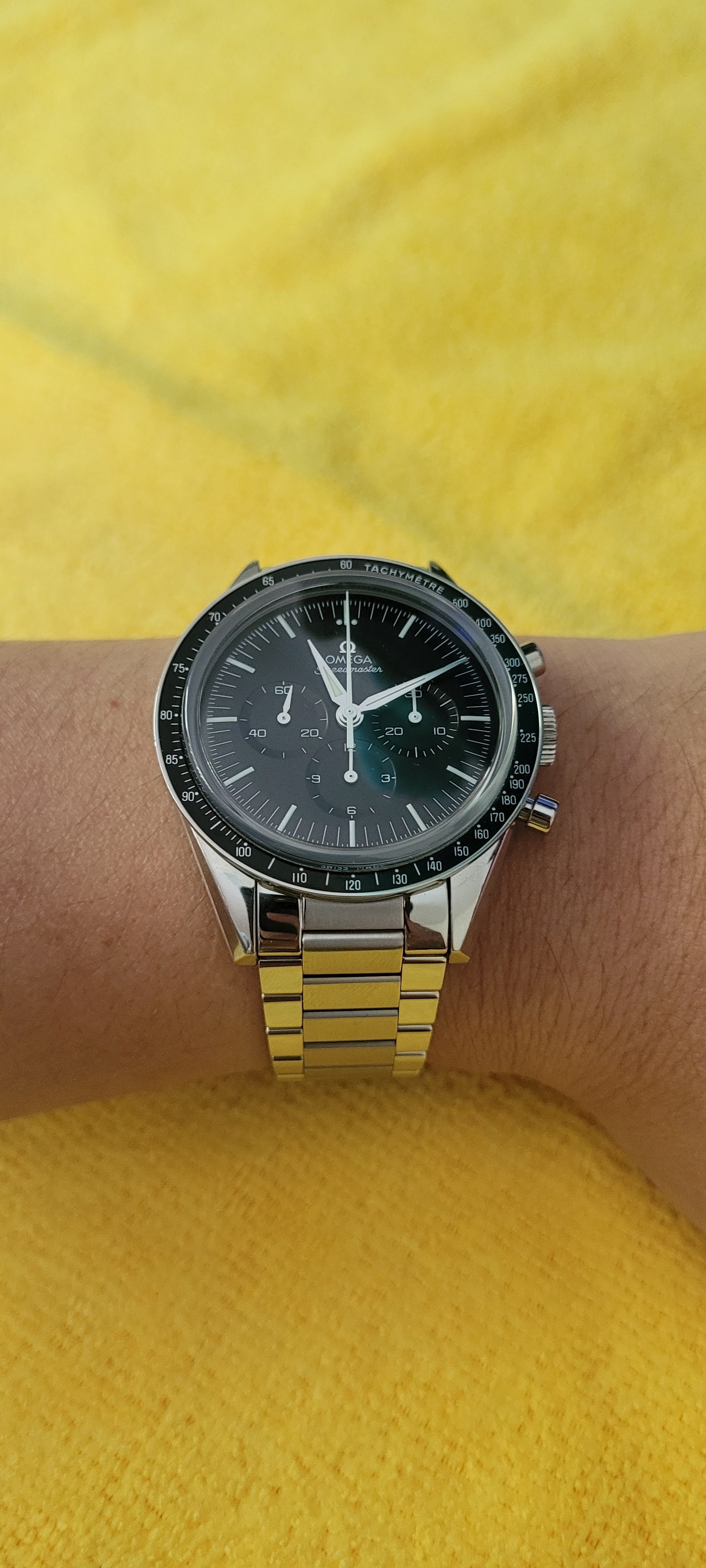

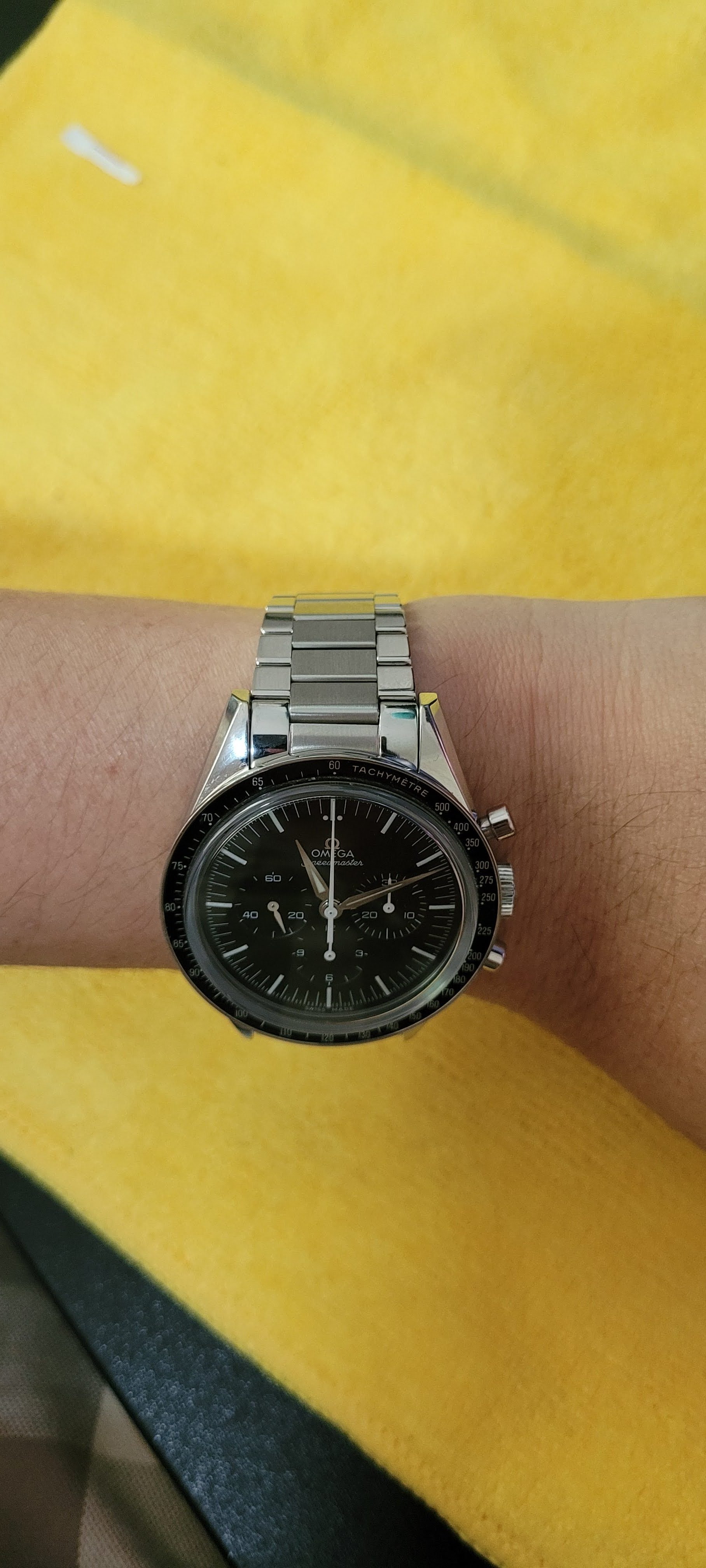

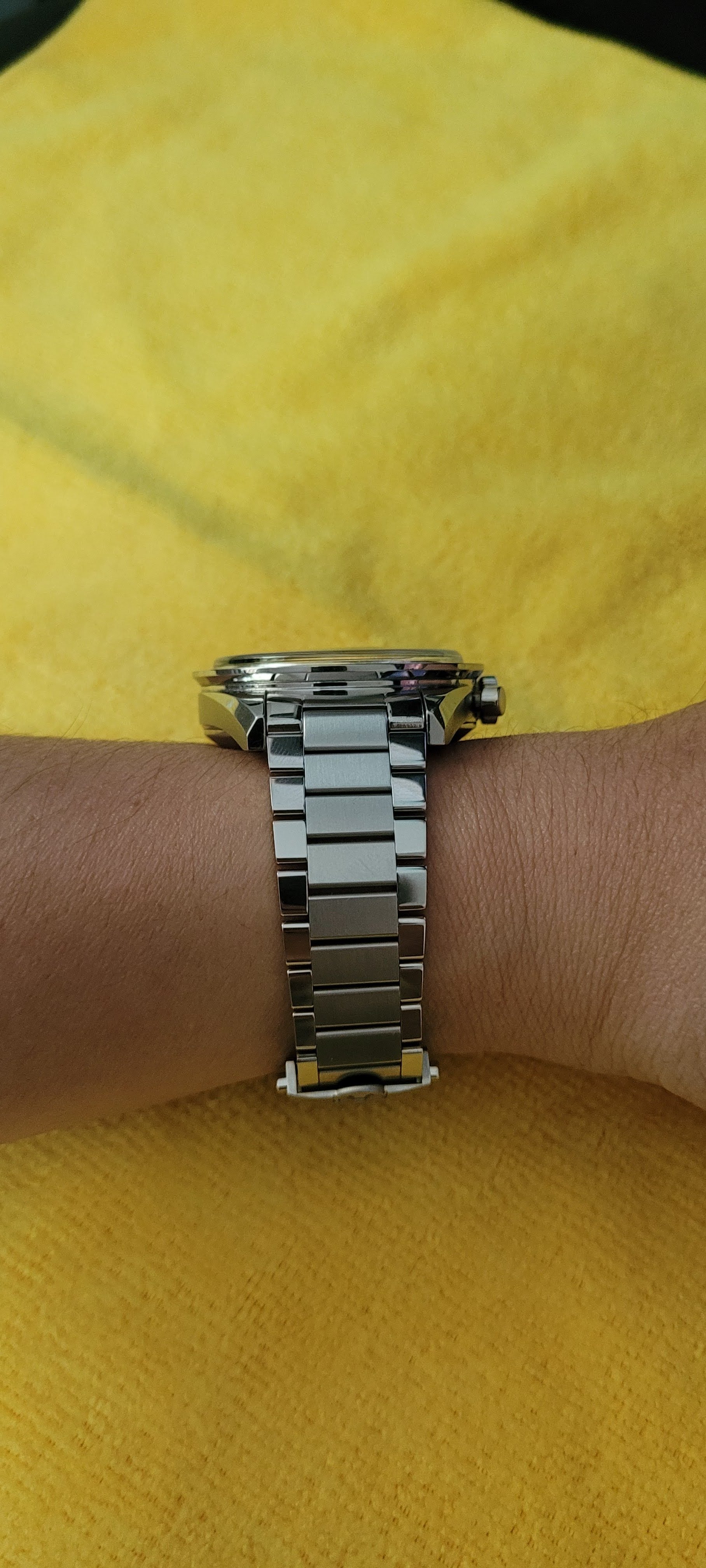

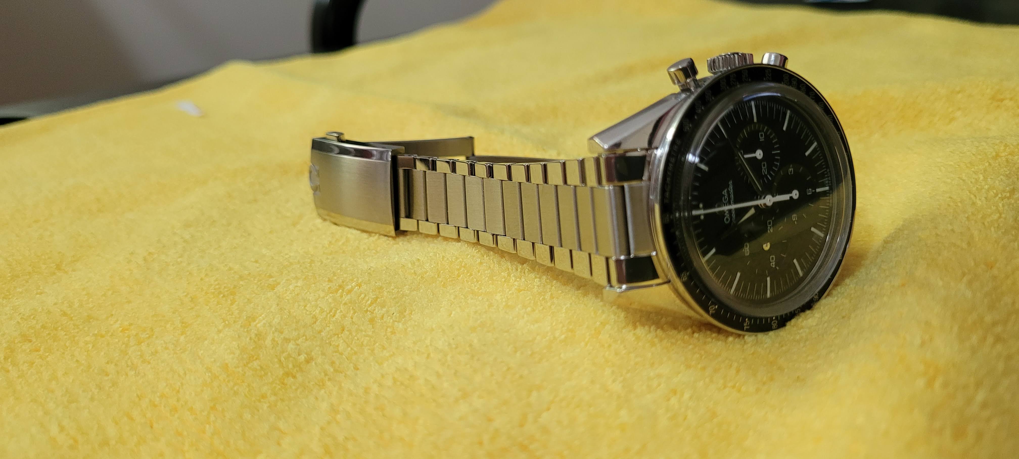

Hi guys
Also just received my 321 bracelet.
Below are some photos of it using the Forstner end links. I also own the Uncle Seiko solid end links but as someone mentioned on here, the fit is extremely tight. I couldn't be bothered buying a file so didnt fit it on the Uncle Seiko. Quite happy with the Forstner end links.
542
364
Hi guys
This is extremely helpful. Thank you .

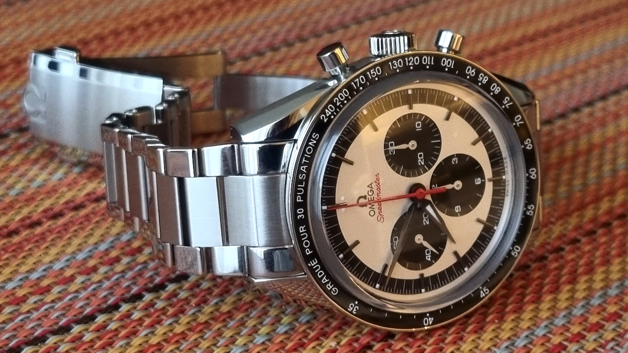

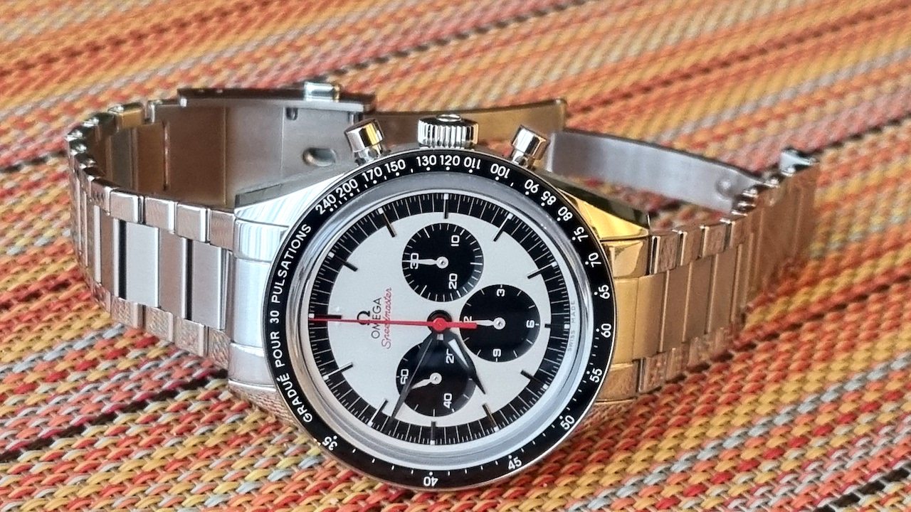

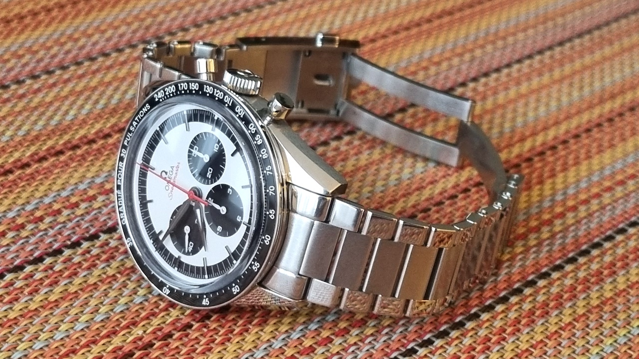

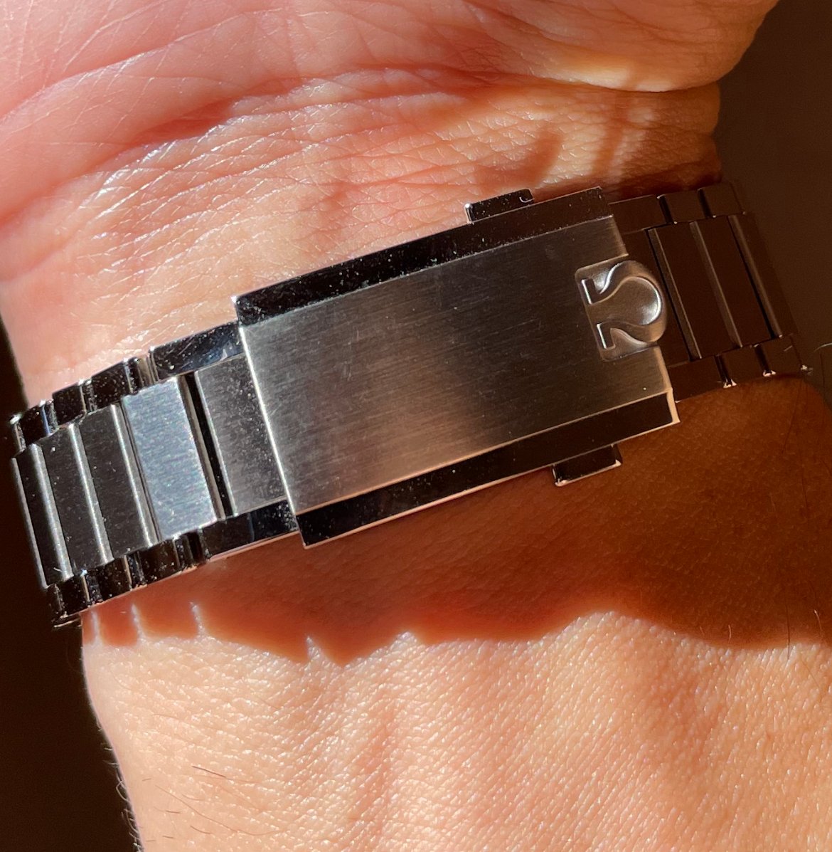

OK, now I'm done.
I have reworked/adjusted the US SELs in order to accept the OEM springbars.
I feel much better now. The Omega 2206 springbars are extremely high quality.
Here's my CK2998 with the 321 bracelet, and adjusted US SELs.
10,794
23,623
OK, now I'm done.

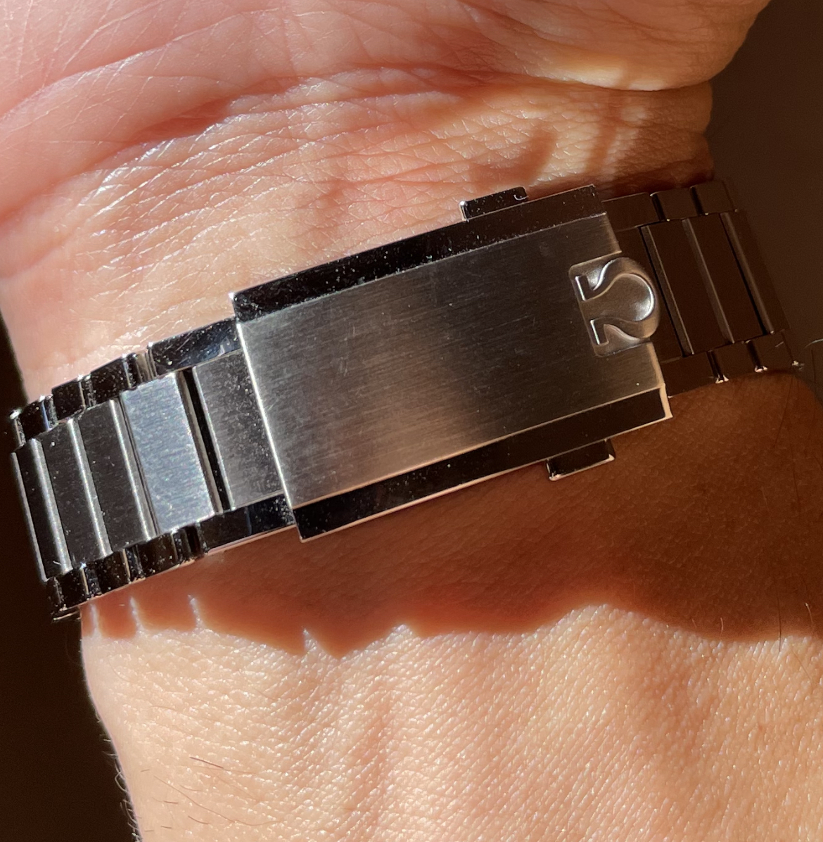

Looks great! 👍
What did you do to make the Omega springbars work with the US SEL?
Have the same setup on mine, but with thinner 3rd party 1.5mm springbars.
287
444
Looks great! 👍
Well, I have to tell you it is a bit of work, took me a good couple of hours but I’m happy I’ve done it.
The 1.5mm 3rd party springbars have a 0.8mm tip. The exposed spring loaded telescopic parts are longer and have more wiggle than the Omega equivalents. So there is quite a bit of slack in the whole midlink-endlink-lugholes assembly to make it all fit effortlessly.
The Omega 2206 springbars that came with the bracelet are 1.8mm with a 0.9mm tip and tighter tolerances all around.
When you switch for a “standard” 3rd party springbar (these are usually 1.78mm) the next problem appears: the midlink now rubs the top of the endlink and will not rotate. So the top of the endlink, internal side, needs to be filed down a bit to allow the midlink to rotate freely.
This was enough in my case to use the US SELs with the standard 1.78mm 3rd party springbar that came with the Forstner.
When I tried the Omega springbar the tips did not quite align with the lug holes, they are about a tenth mm towards the outside, and there’s no wiggle to play with. To make it fit you need to remove material from the SEL on the curved surface that goes against the case, to get the holes of the SEL closer to the case.
This is challenging to do freehand, but rather easily done using a jig I made that is a sanding cilinder of about 39mm diameter that I attach to a drill press. Little touches (burnt fingers) and trial and error until the endlinks with the OEM springbar just click in place.
Probably not for the average DIY-er, but of you’re handy and have access to a basic tool shop, it’s perfectly doable.
