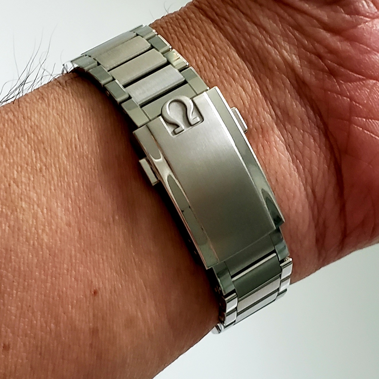

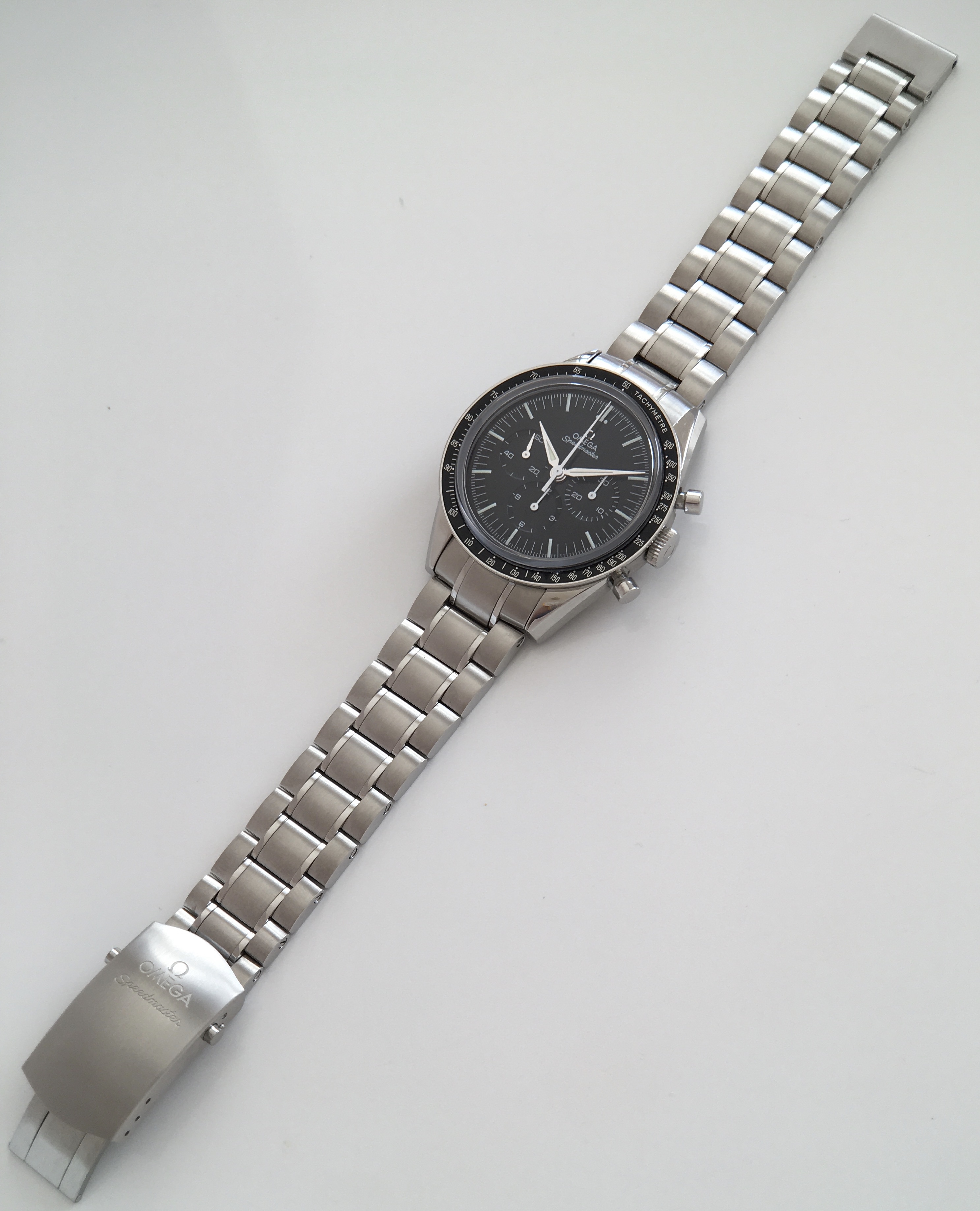

Hello everybody,
I really love my First Omega In Space / FOIS but I always wanted to wear it on a bracelet.
So I did some research and searched for 19 mm bracelets that could fit the watch.
Here is the interim result of my research.
Edit 04.01.2020: I have added a part with the modern bracelet 1587 / 986. See below.
Edit 19.03.2020: I have added a part with the vintage bracelet 1125 / 560. See below.
Edit 02.06.2020: I have added a part with the modern bracelet 1565 / 976. See below.

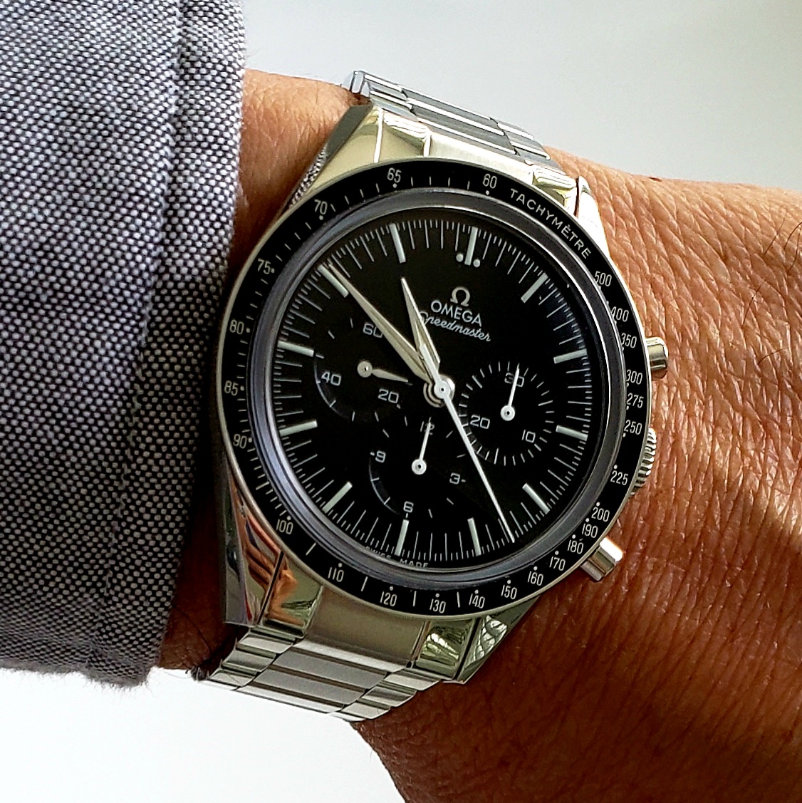

FOIS on 1125 / 617 bracelet
This is the one vintage looking bracelet for the FOIS that you can still get at the OB.
The only tricky part was to find out that the spring bars (19 mm, 1,8 mm diameter) come in two different lengths. One short version reference 2206 for bracelets and one slightly longer reference 2207 for straps. The latter ones are coming with the FOIS and making it almost impossible to fit a bracelet to the watch. Take the short version and it will work.
Bracelet reference 1125 (new from OB)
Endlinks reference 617 (new from OB)
Spring bars reference 2206 (Width 19 mm, 1,8 mm diameter, short version for bracelets)

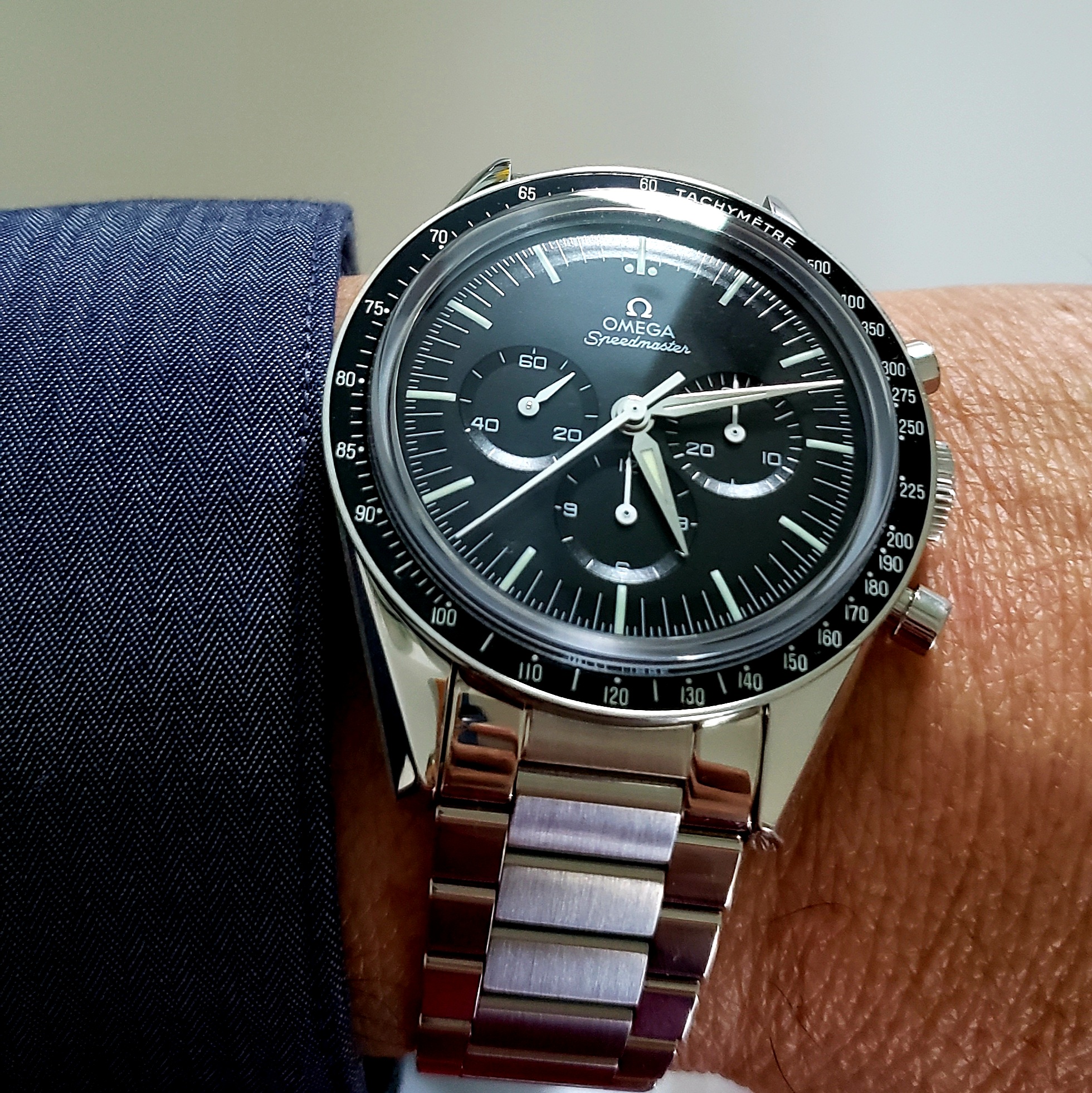

FOIS on bracelet 1098 / 540
I really love my Speedy Pro on the 1116 bracelet, so it was nice to see that the small brother 1098 fits the FOIS. And the endlinks 540 are still available at the OB!
Bracelet reference 1098 (from second hand market)
Endlinks reference 540 (new from OB)

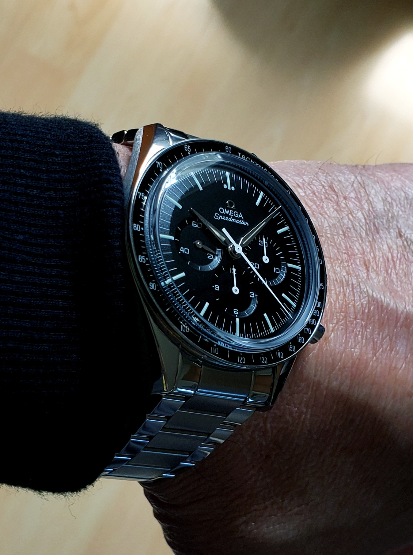

Edit 04.01.2020
FOIS on bracelet 1587 / 986
After seeing several photos of the FOIS with this bracelet, I was curious to try it out. Modern flatlink bracelet on FOIS.
In general the fit is quite good, but the small tabs of the solid endlinks are somewhat hanging in the air. Therefore the endlinks are rotating a bit around the spring bar and open a gab between watch case and endlink. See detail pictures below. Surely this can be solved somehow.
Bracelet reference 1587 (new)
Endlinks reference 986 (new)
Small tabs hanging in the air.
Nice fit with endlinks touching watch case.
Not so nice fit with endlinks rotating and opening gap.

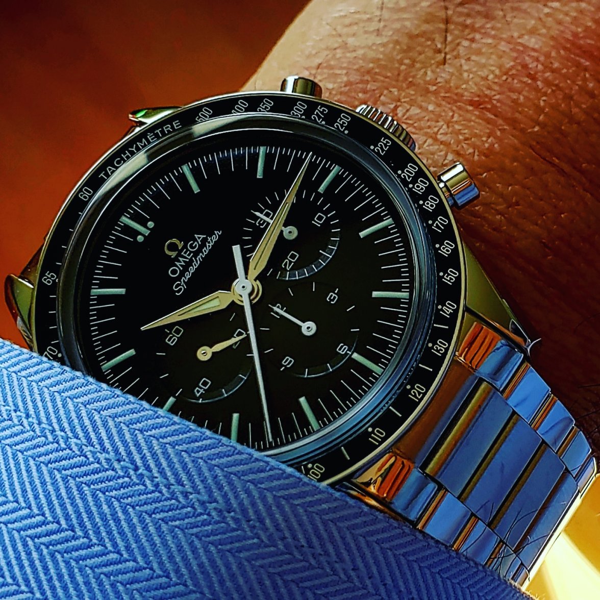

Edit 19.03.2020
FOIS on vintage 1125 / 560 bracelet
I recently had the opportunity to purchase this vintage 1125 bracelet with 560 end links at a good price. So I tried it and it fits the FOIS very well.
The vintage version of the 1125 bracelet is different from the modern version with more taper and a small clasp cover with embossed logo and grooves. I really like the taper from 19 mm to 15.5 and the old version of the clasp.
Edit 02.06.2020
FOIS on modern 1565 / 976 bracelet
I had the opportunity to borrow this bracelet to mount it on my FOIS and take some pictures to kind of round off my post.
The fit of the solid end pieces is very good, especially when you consider that the bracelet was intended for another watch with a different case shape. It is very solid and, together with the two security pushers, offers a robust bracelet for everyday use.
I assume that the bracelet 1564/975 fits similarly well, because it only differs in the links with pins instead of the screwed links of the 1565/976.
Note for small wrists: The end pieces shift the axis of rotation of the bracelet outwards, causing it to bend significantly downwards for small wrists. I prefer bracelets where the spring bar is also the axis of rotation for the bracelet.
Bracelet reference 1565 (new from OB)
Endlinks reference 976 (new from OB)

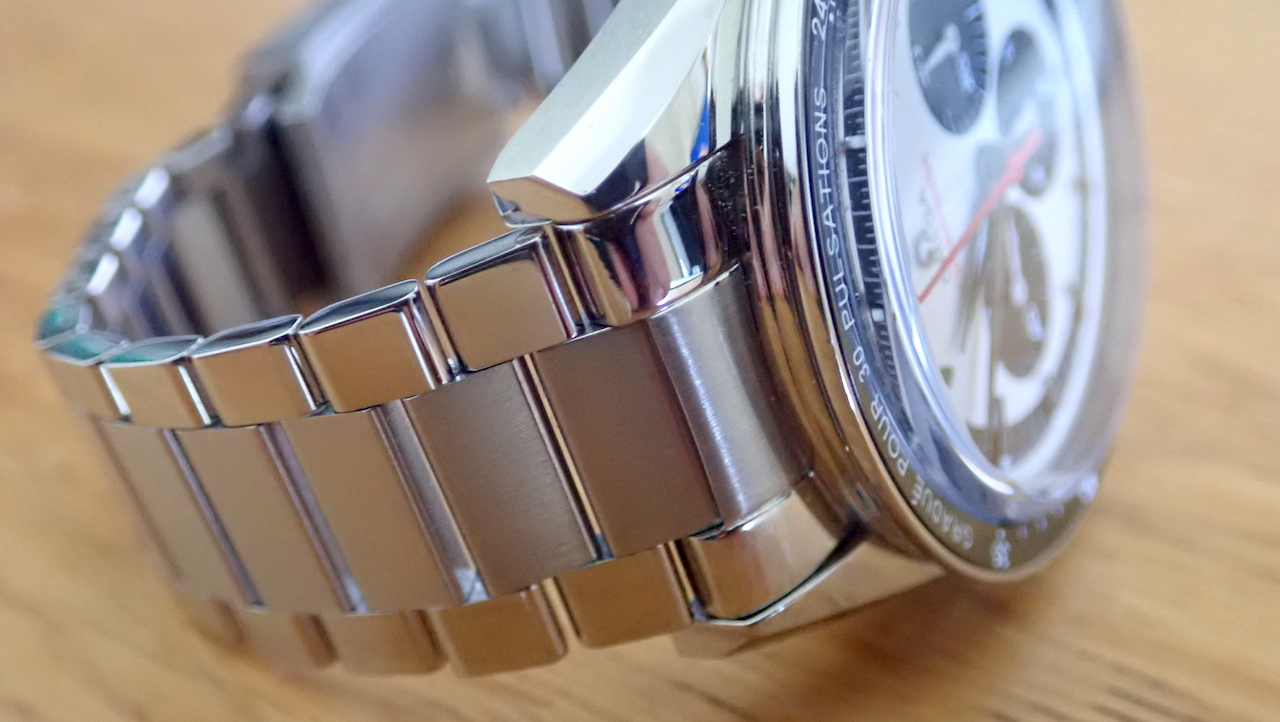

I purchased the Ed White 321 bracelet for my FOIS. The 321 end links will not work, spring bar pin hole does not line up and the back lip will not fit right either.
But the Omega 321 bracelet will fit perfectly using either Forstner (top pic) or Uncle Seiko (2nd pic) end links.

From the outside appearance, yes the Uncle Seiko's shape matches the lugs of the FOIS better and the look integrates seamlessly with the 321 bracelet. However, it takes more work & finesse to get the US installed. What I don't like about the US is that the squared off edge makes the watch feel more slab like and blocky on my wrist, as there's a step down to the bracelet. Also being hollow end links, they feel "cheaper" in my mind ( and they were cheaper, $25 vs. $50 for the Forstner end links).
The Forstner end link has a rounded edge which tappers down towards the wrist. As I have slimmer wrists, this makes the watch sit better for me. While its shape doesn't match the FOIS lugs as well as the US, the appearance of the Forstner end link is more similar to that of the OEM Ed White end link in its design. The Forstner is also a solid end link and the installation is plug & play, but it does require a slim spring bar. The thicker Omega spring bar that comes with the bracelet will not fit with the Forstner, as the 321 flat links are slightly thicker than the Forstner & US bracelets.
I think both look very nice and I've pondered which I like better. After trying both for a while, I'm using the Forstner end links because I like the way it wraps the watch around my wrist a little better. The stepped edge of the US makes the watch feel like it sits taller on my wrist.

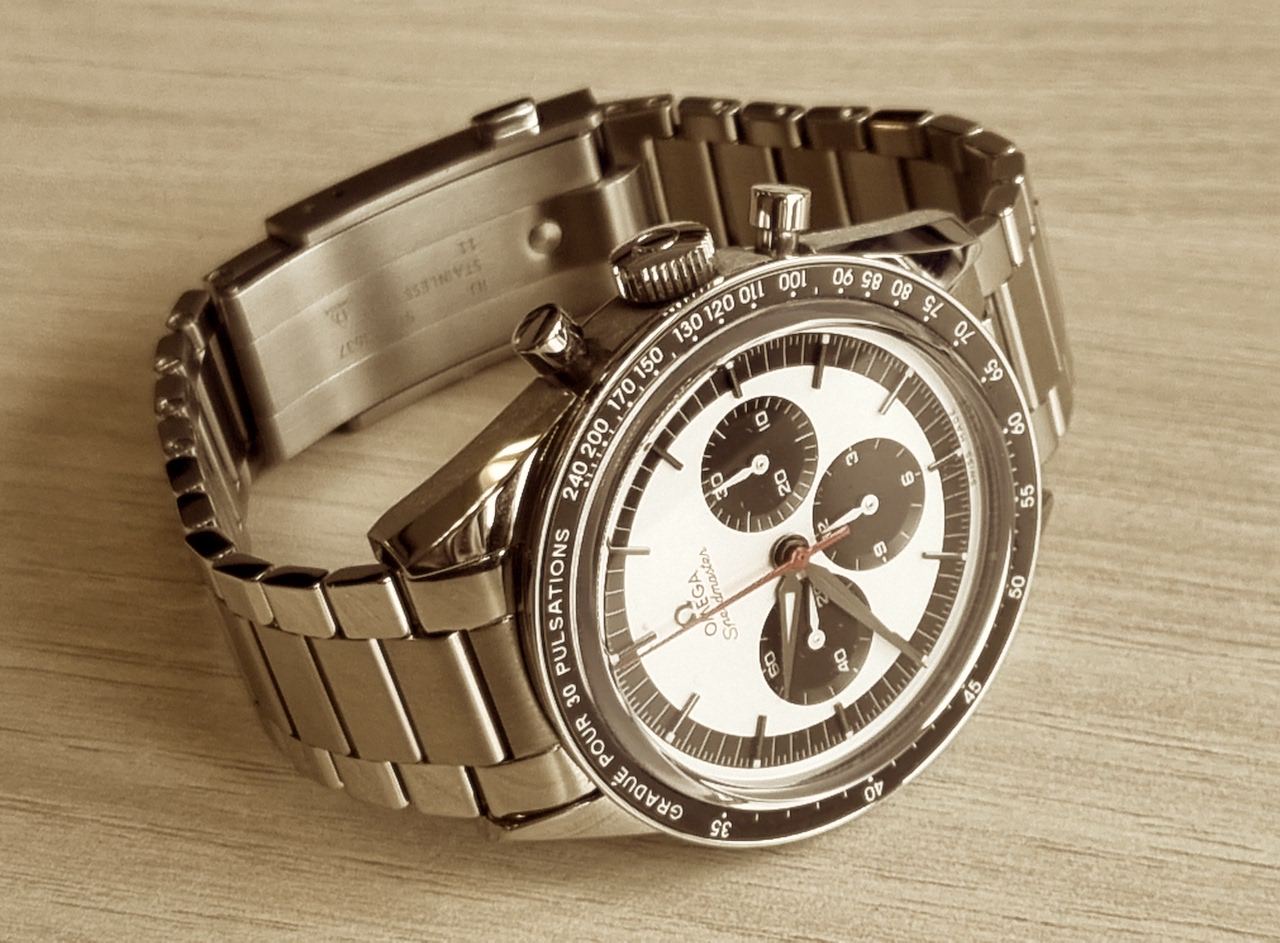

Hi there.
Mspeedster will likely chime in soon, but as he helped me going through this exact situation I'll comment on my own experience.
If you use the Forstner endlinks, they work without modification, but using 1.5 or 1.6mm springbars (the Omega 2206 are 1.8mm and the usual aftermarket ones are 1.78mm).
They look good, but in my opinion the US SELs look significantly better, following the shape of the links more closely.
You're right: the tightness is due to the width of the midlink of the 321 bracelet. In my case it would simply not rotate. I had to file the inside of the sides of the opening of the US SELs a couple tenths of mm. And then, using 1.5/1.6mm sprinbars, the bracelet will install and work just fine.
With some more clever filing/sanding I managed to use aftermarket 1.78mm springbars with the US SELs. But have not managed to use the OEM ones. With thicker springbars there's less free play and the mid link tends to rub against the top of the endlink as it rotates.
Here's a picture of my CK2998 on the 321 bracelet and US SELs.
