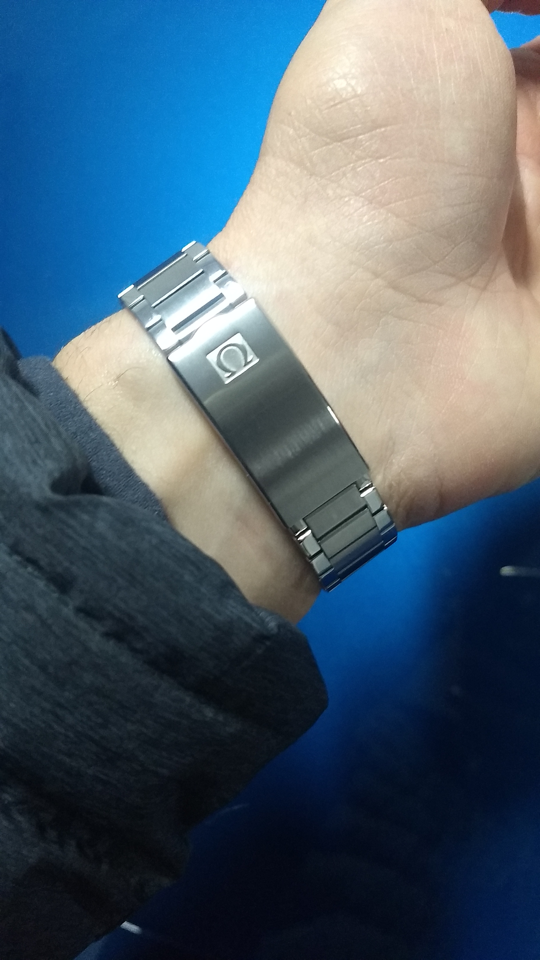

You can also combine Forstner flat link bracelet with Uncle Seiko deployment + ebay canadian Omega clasp:

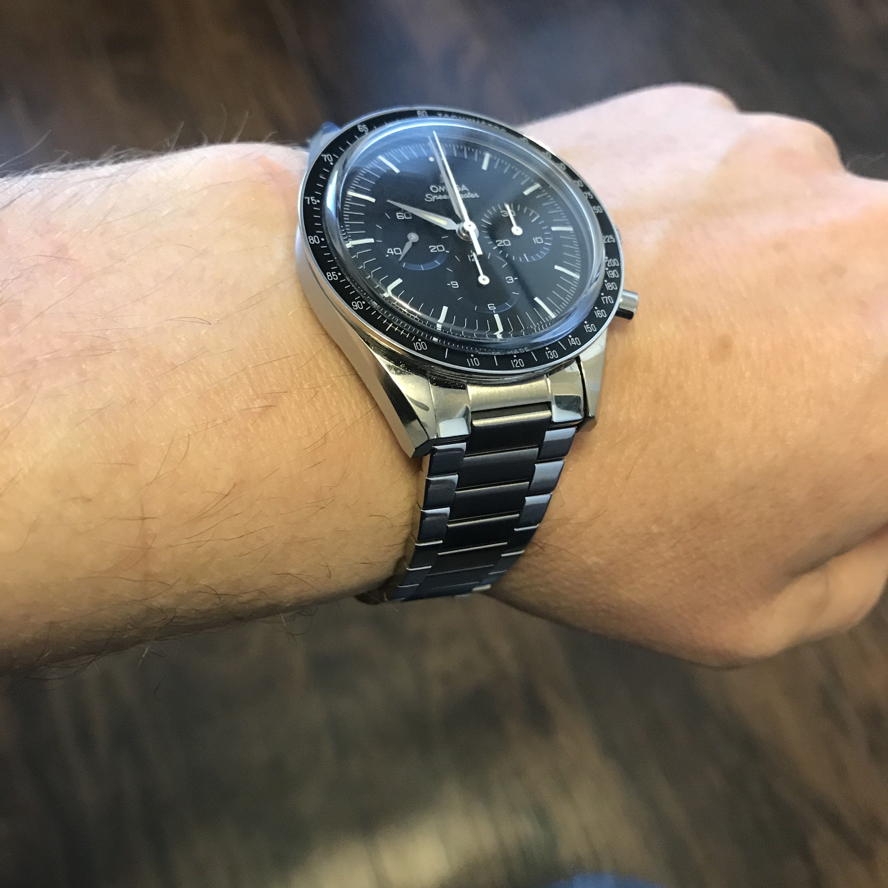

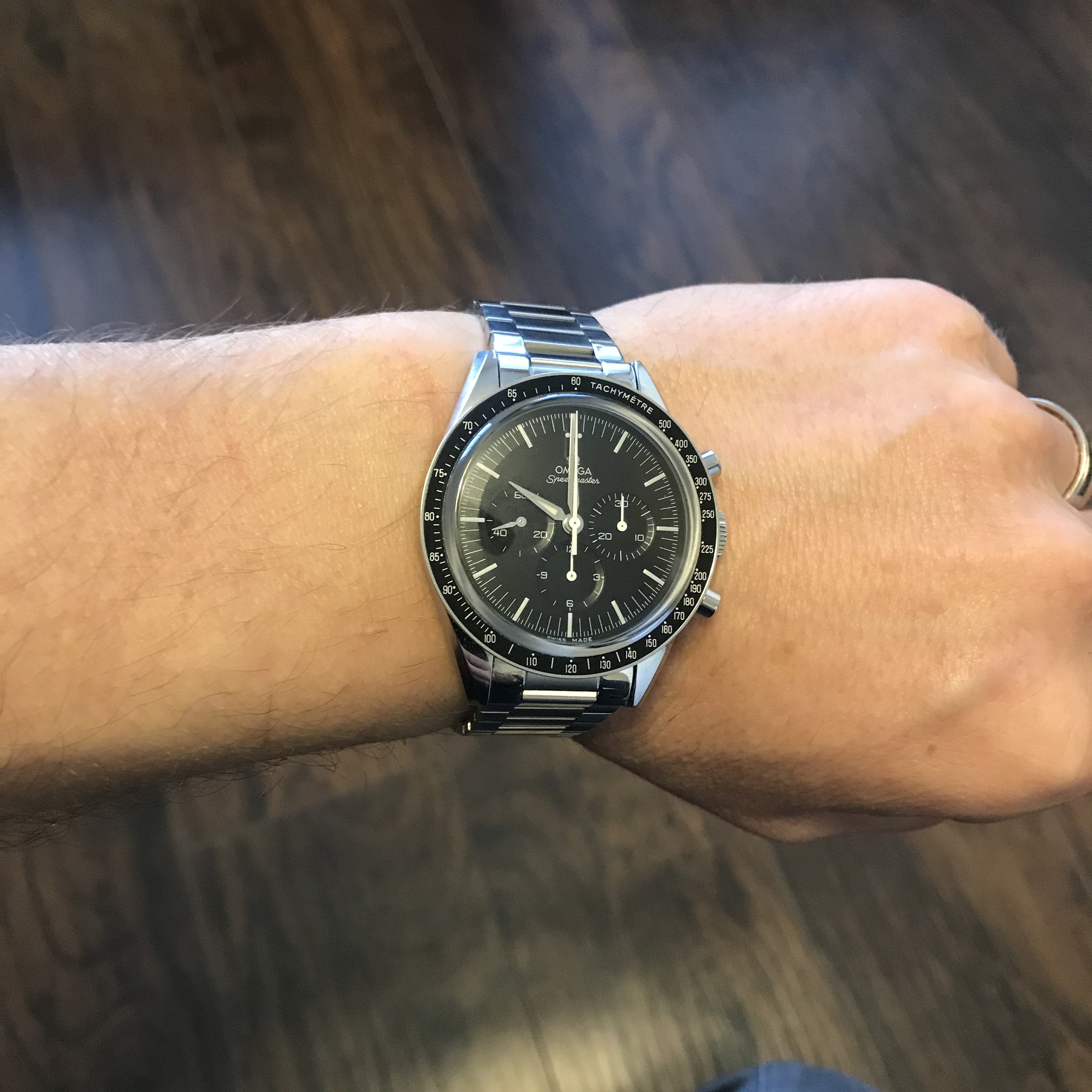

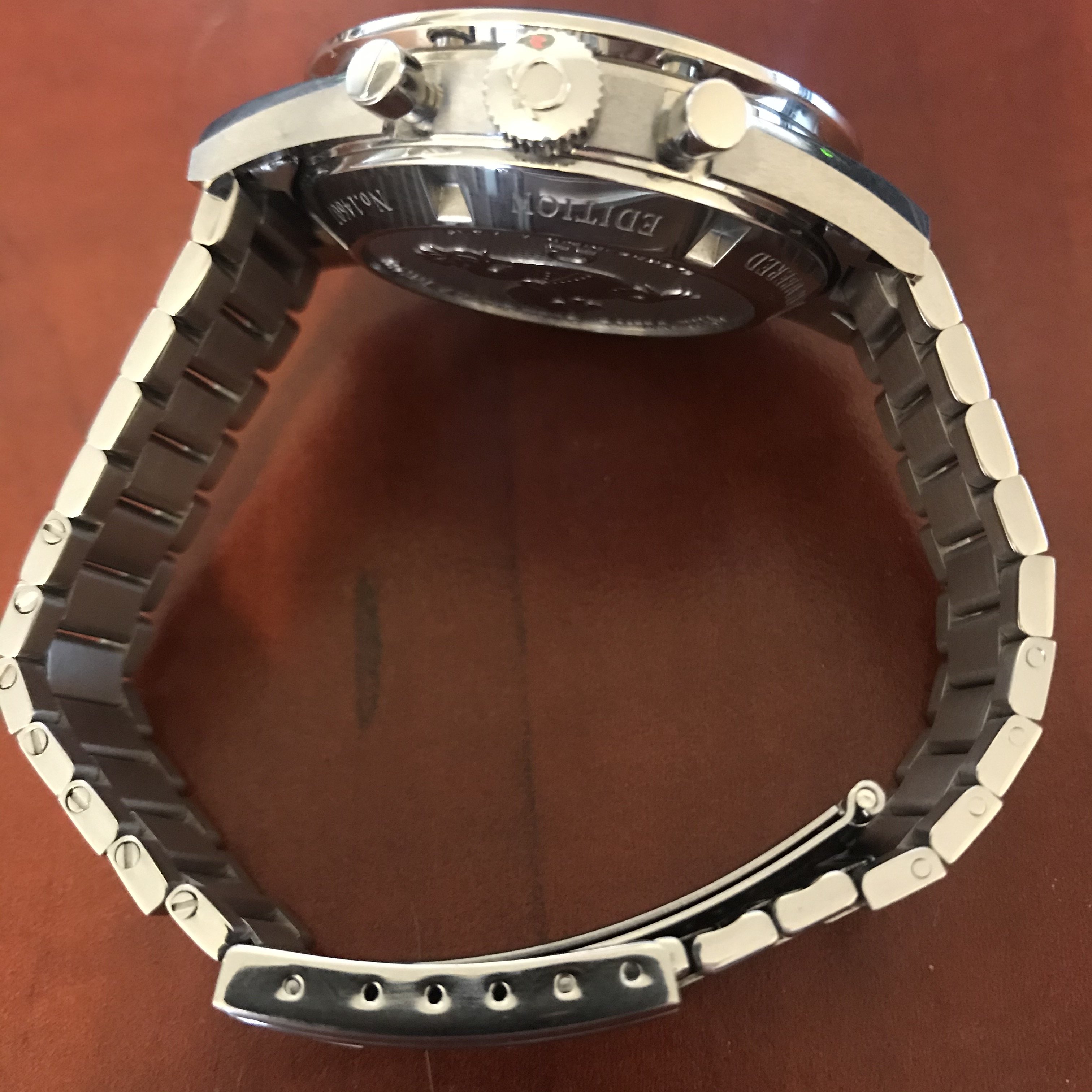

I just received a Forstner flat-link for my recently acquired FOIS. Great bracelet, very impressed with the quality and the look and feel. I've got a number of bracelets on my watches and this one is a favorite already. The spring links really add to the comfort.
I'd like to note that the adjustment method appears to have changed and it only requires removing the single screw that holds each link to the next. The two screw adjustment is not on my bracelet. The included mini screwdriver made sizing an easy job.
Please post a photo of your watch with the new Forstner.
That would be great!

I am using Forstner with uncle seiko deployment and Omega clasp. That is possible.

Here are a couple of wrist shots and another where I attempted to show the screw adjustments - only one side has a screw head, you can just see the end of the screws on the links to the right.
