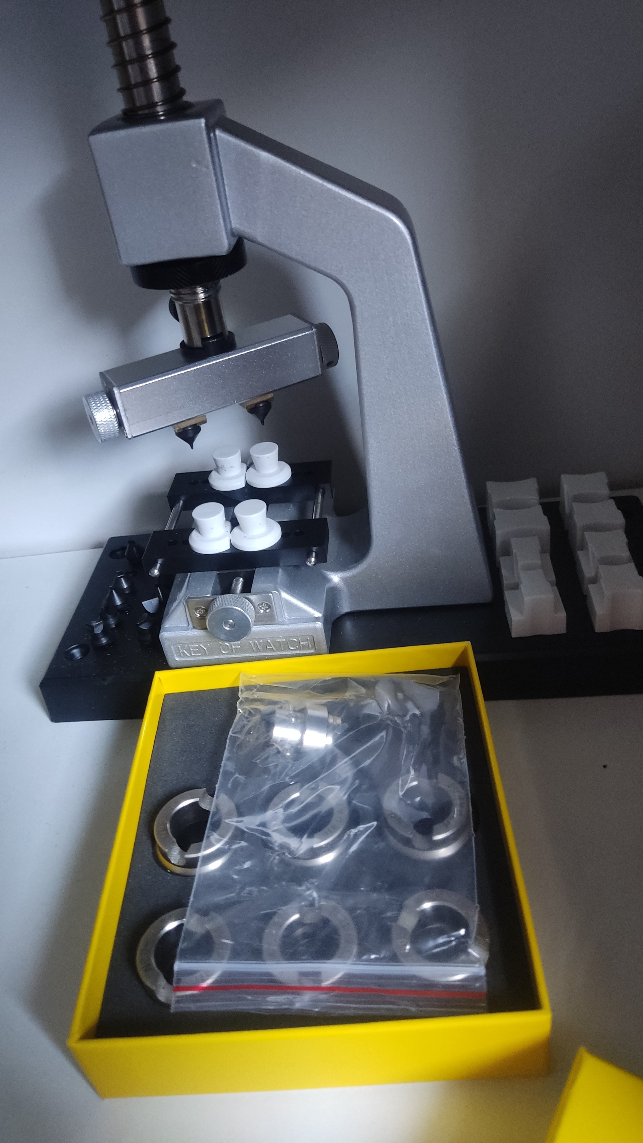

Today, my Vevor 5700 screw caseback opener arrived.
Naturally I got 3 of the broken watches I bought specifically to practice and started opening and closing them.
However the press feels sloppy. I can't align the jaxa right and it often slips. It feels like it's misaligned compared to the position of the watch. On one of the cheap broken watches, it rotated so hard, the crown broke and the watch fell apart to glass, movement and case.
Of course that's non issue since it's a badly broken non-working watch anyway... But I am afraid of this happening on a real watch...
Also the press itself makes a really nasty sound when I press it down, I sprayed some nice lubricant all over and wiped the excess. But it didn't help.
I will try to make a video when I get home.

Tbh almost all the replaceable notches for opening the back mostly seem to big/unusable... as if I am going to work on 50mm watches or so.
Honestly it feels like it would be easier to just use a good quality jaxa opener with say 3 points which wouldn't slip.
457
152
Just an update for anyone interested. Tried on standard seiko cases and it works fine. No wobbling.
Of course I placed a thin plastic bag on top of the watch back to protect it from scratches. The watch itself rotates a bit in the holder, since I don't want to to tighten it too much in place, even though the mechanism holding it is plastic so it can't get scratched.

This is the 5700 Vevor. I got it on eBay, but it's available at many places. It was recommended to me here on the forum(thanks guys) so that I don't get a sloppy jaxa and mess something up.

I have had great luck with these openers when used properly. Use the clamps between the lugs to hold the watch. The white things in the back. Don't use the case holder, it is not as secure. Also, I'd suggest using different tips, not the sharp pointy ones but the ones that fit better into the entire groove in the case-back.
If you watch a few YouTube videos, it might help.
12
31
The white clamps in the back will def. keep the watch from coming off. I doubt the pic you posted is of the setup after the incident but just to be sure those clamping pins need to be surrounding the case at roughly 2,4,8,10 o'clock... where the lug meets the case body.

The sharp ones seem fine with a good plastic bag over the watch. But I will try the other ones too. I will look for some videos too. Thing is, for smaller watches(30mm), the experience wasn't good. While trying on a LM, it just works.
Thanks, I will try using the white clamps.

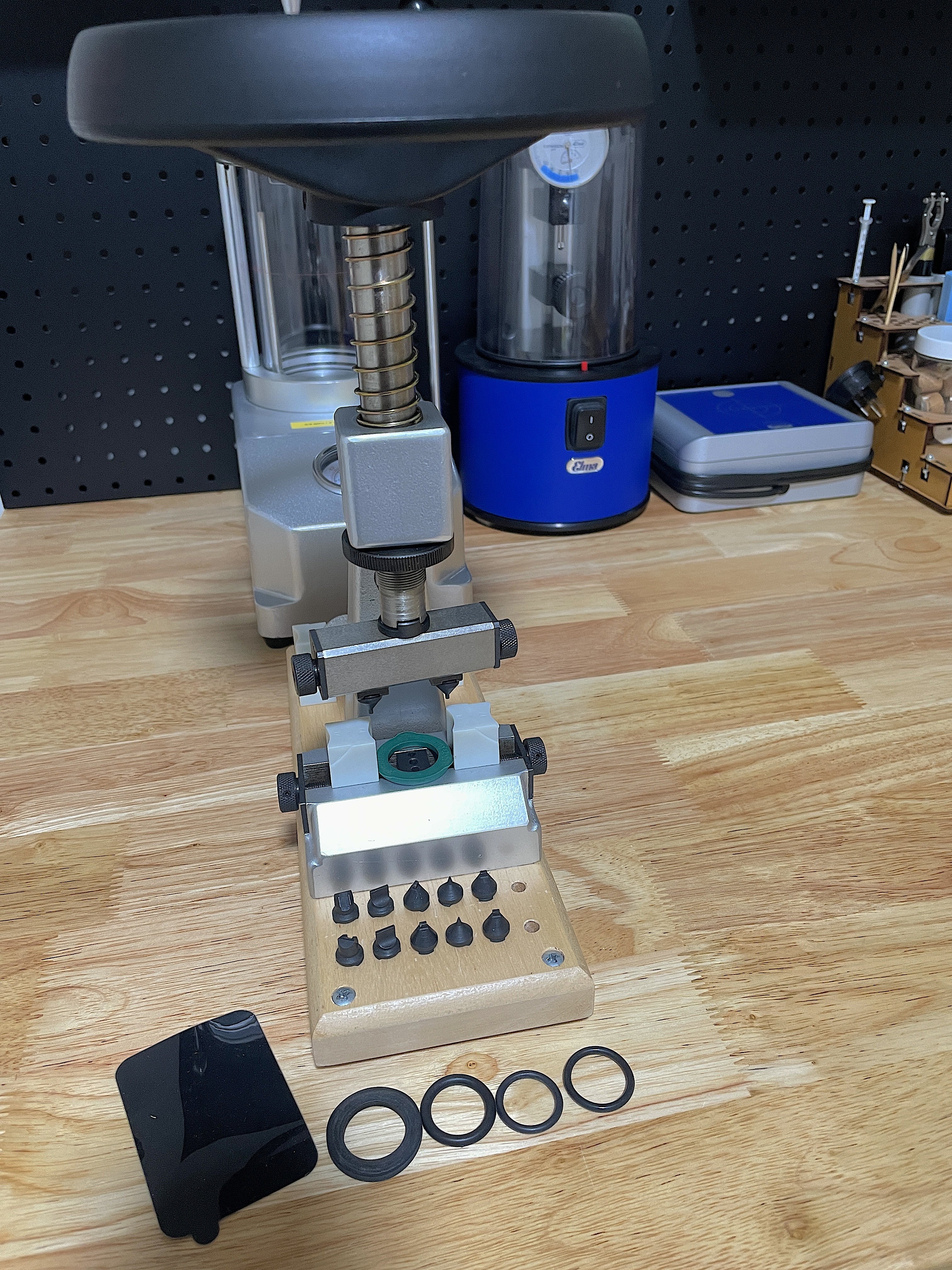

Like Dan said, get rid of the clampy part and use the white blocks according to lug width.
Use of a thick bit of plastic on the bed of the platform will protect the crystal when applying pressure to the caseback (I use washers/O-rings).
The tips of the pins can be lightly polished to remove any sharp edges, I don't use a plastic sheet over the caseback and don't get any scratches.
When the watch is properly set on the platform and the blocks are comfortably against the case, gently lower the opener down to the caseback and align the pins with the caseback slots/holes.
While maintaining gentle downward pressure on the winding handle, spin the lock nut up to the head stem so that you have light pressure on the caseback. You should be able to take your hands away and it will be all ready to remove the caseback.
Start opening the case, when you see movement, loosen the lock nut slightly and repeat.
After doing a few of your junkers, you'll get the hang of it.
