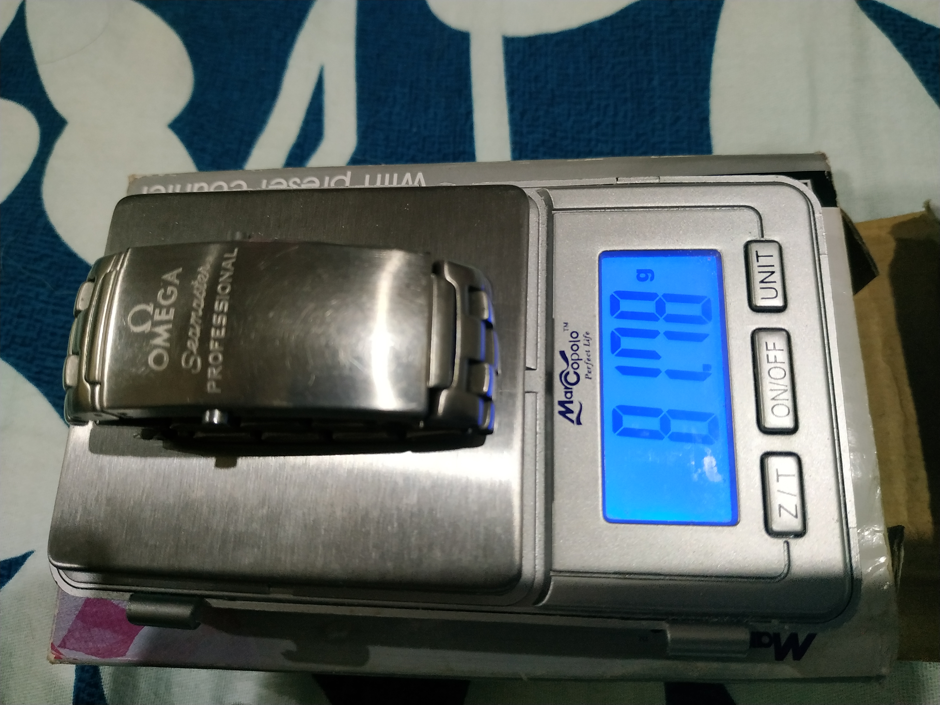

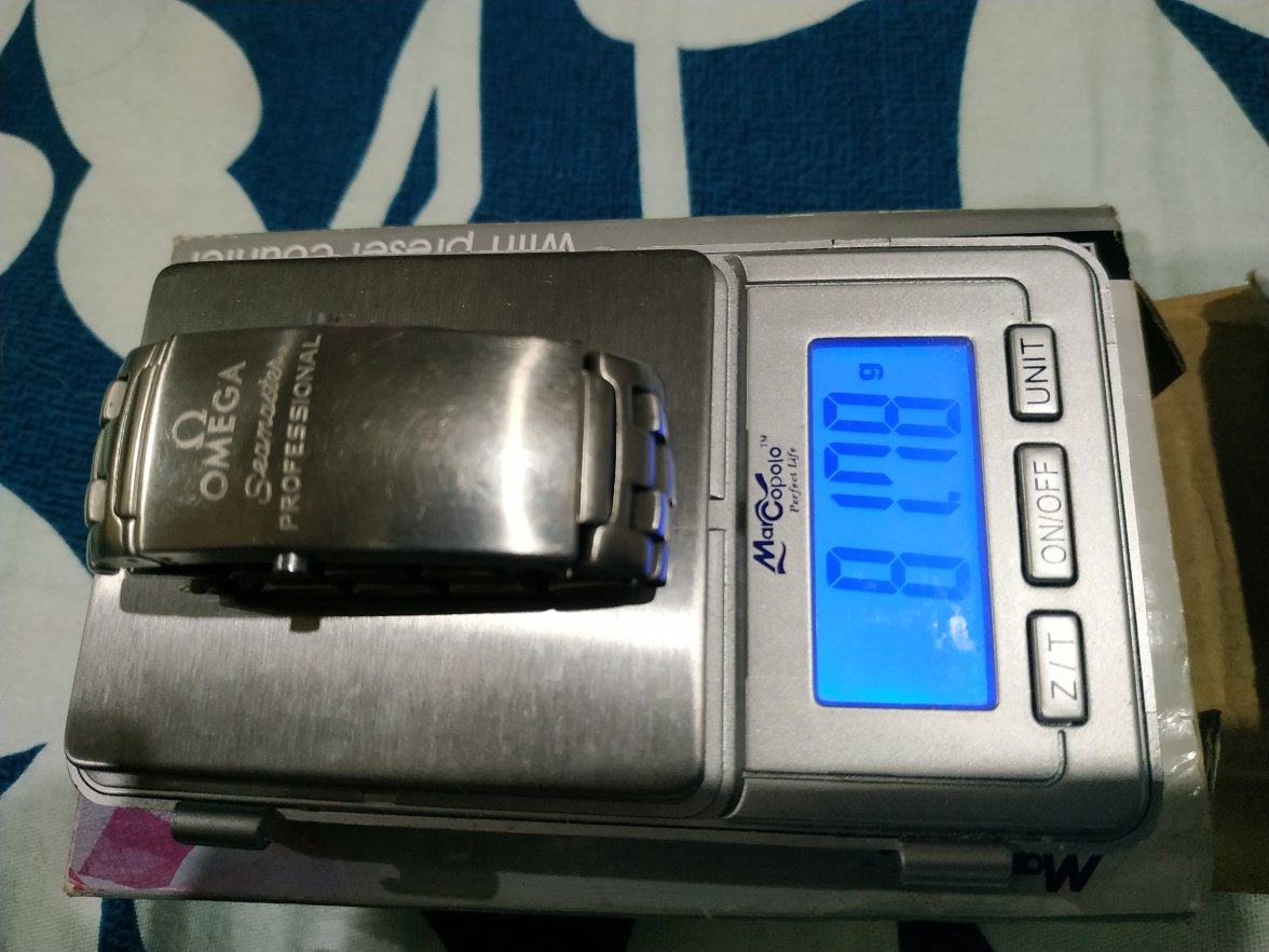

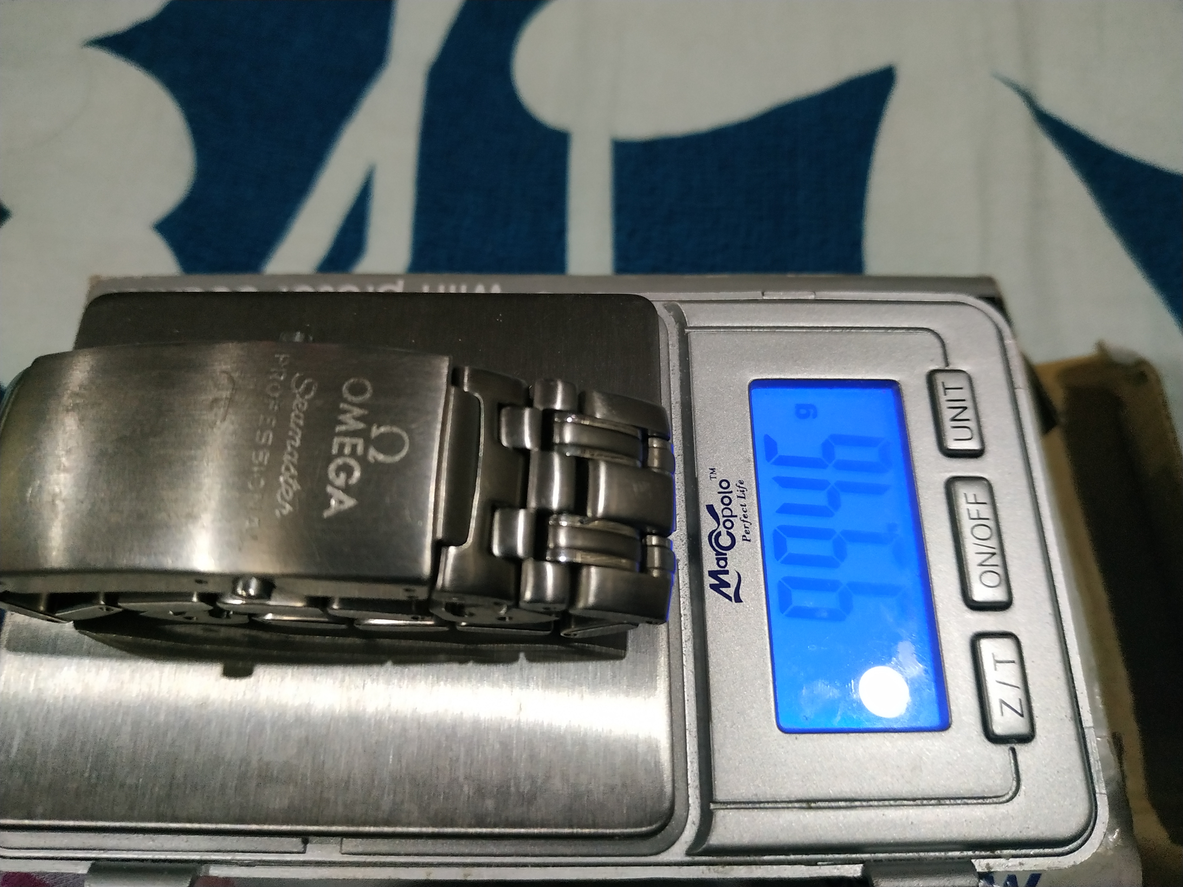

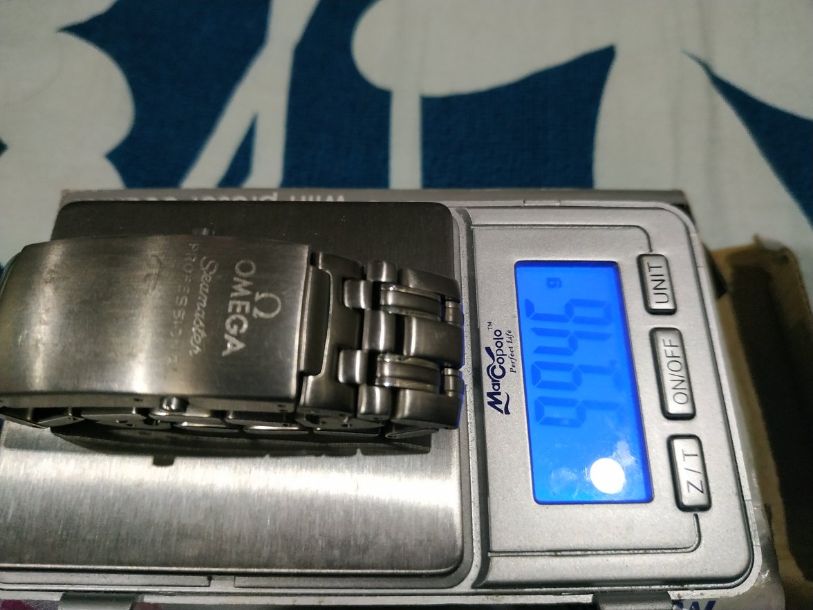

I took the weight of both the braclet:
Bracelet A weighs 99 gm
Braclet B weights 81 gm (please note it is not a complete braclet with around 2 links less)

FYI:
1) a Titanium SMP* weighs ~98g in total, that is head and bracelet, meaning the bracelet is likely around half that.
2) a single steel 20mm Bond SMP link weighs ~5g
*actualy this is the weight fitted with 1610/930 Ti bracelet which due to taper etc might be a few grams lighter than. the Bond style I guess.

@padders thank you, this information is most helpful.
So can we assume that both are original steel bracelet?
I think so but the weight does allow for the 2 possibilities suggested above, namely it’s either fake or a Ti clasp has been swapped onto a steel bracelet. I am leaning towards the former, Ti looks pretty distinctive with a dull grey matt finish, yours looks like steel.
