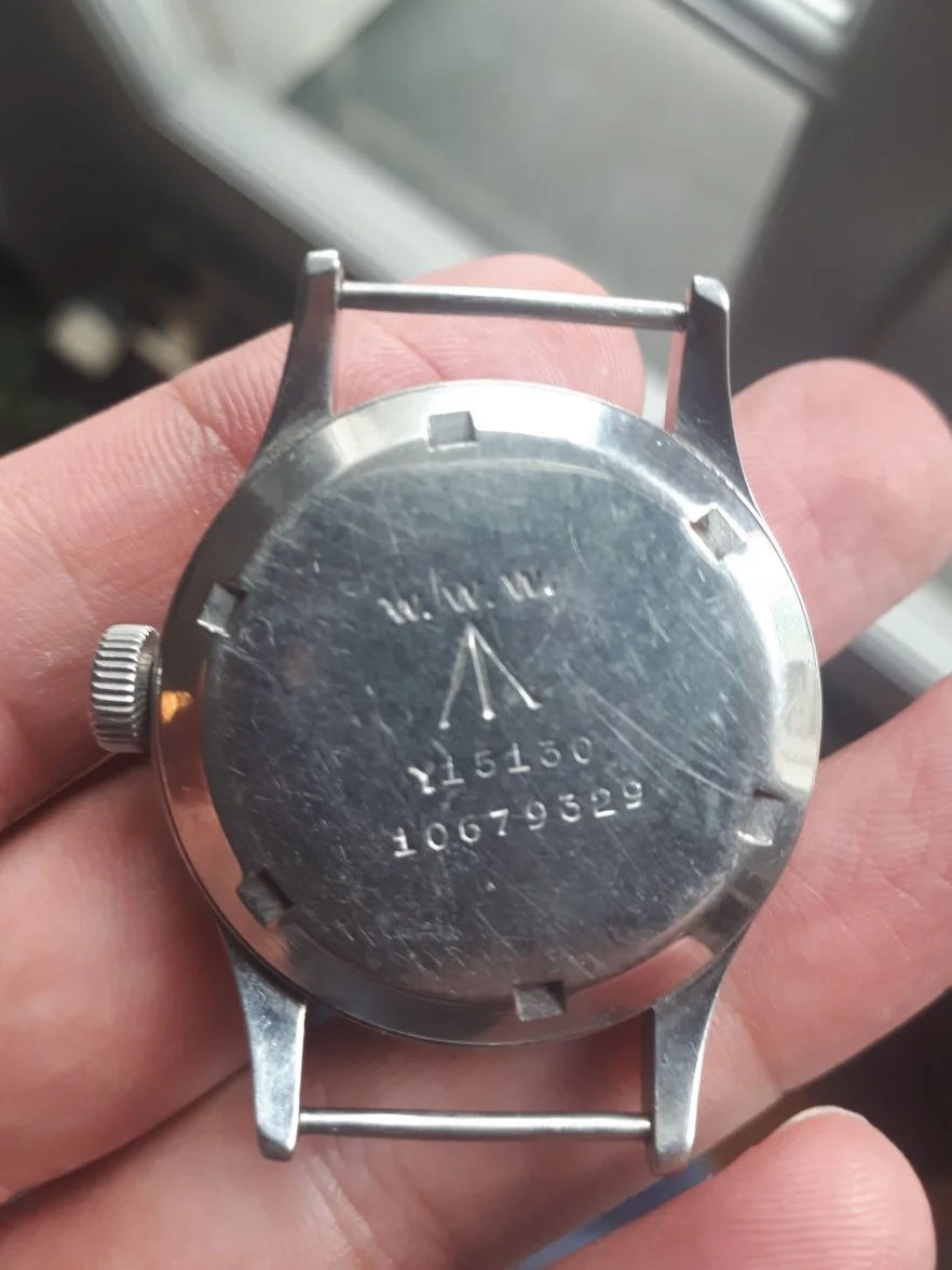

I don't like any of the case back engravings either, an image of the inner case back would be interesting. I would return it if possible.
The case back is not pukka. There is an equation where you take one number from the other and for every single Omega WWW the resultant figure is identical... not on this one!
There is? How can that be possible? Pleace do present it.

You subtract the MIlitary Y serial Number from the 8 figure Civilian serial number and it comes back with one resultant number for all Omega WWW's some of the other WWW watches have a similar equation.
Also on the Omega WWW there is a serial number stamped Inside the case itself. In a partular location (and on the US Army 2384/2179 Mil watches too)

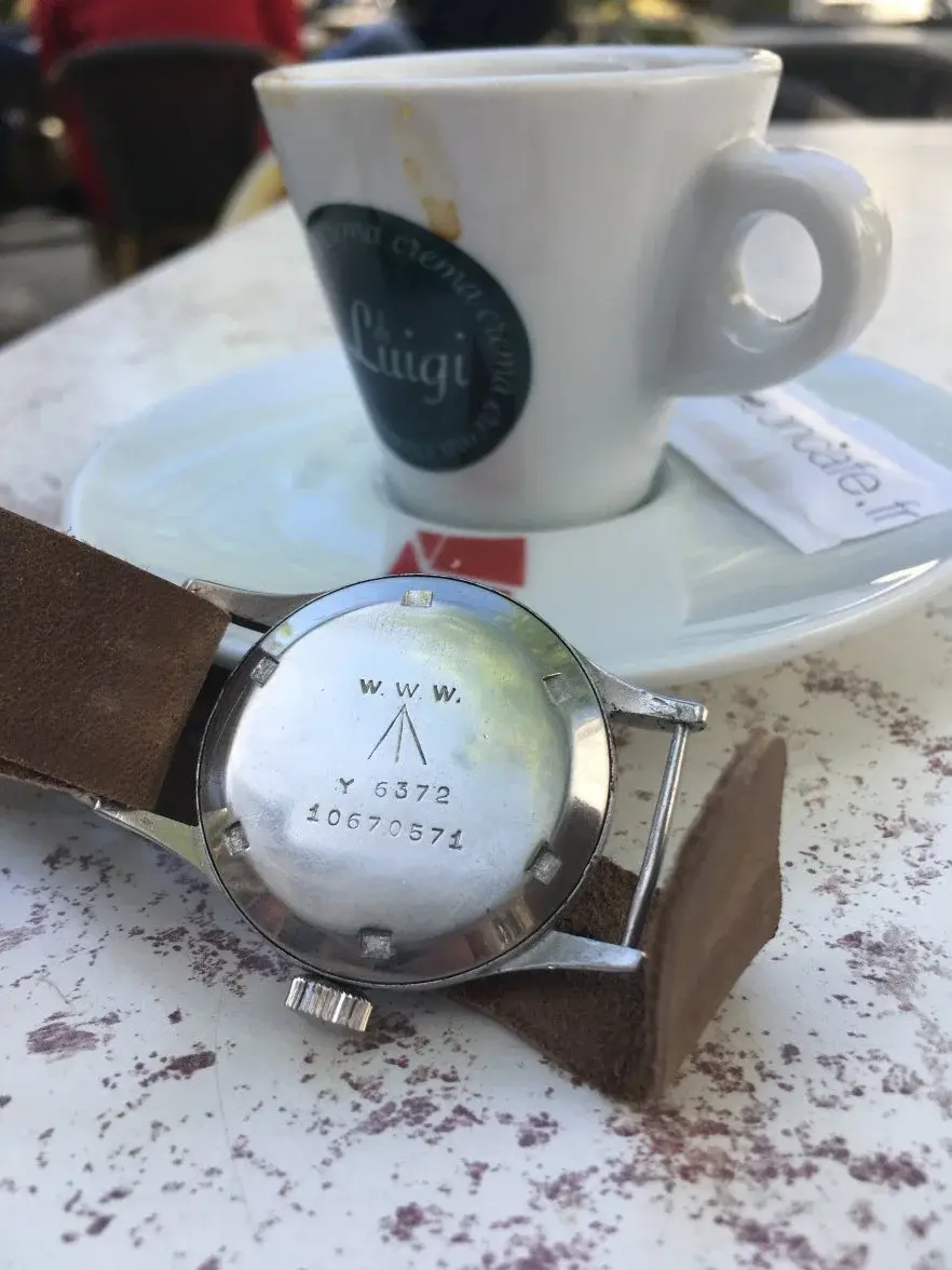

That works, the resultant number is 10 664 199 Does that have a significance?
I tryed it on these two from OF
Yes thats the number. If it isnt that number then the numbers have been faked.
