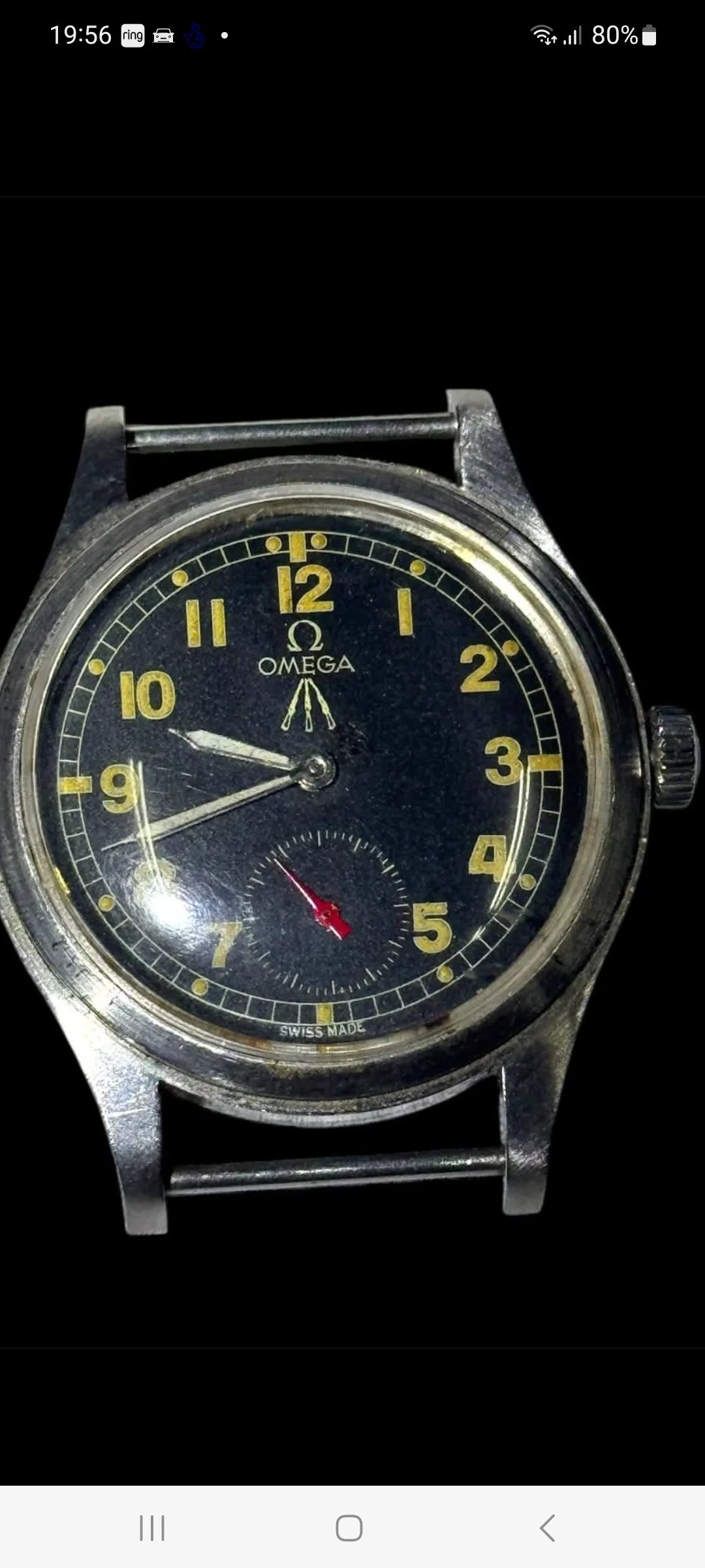

Hi and thank you in advance.I bought this acouple of days ago as it looked interesting.Its a Frankenstein.I am particularly interested in face and the 3 Rifles in particular.Thank you.

A rather interesting interpretation of the pheon (broad arrow), morphed into the Enfield trademark.
So, a fantasy redial with a set of hands from the scrap drawer. Serial dates the movement to about 1945.
It looks to be a genuine WWW but I'm not an expert in this line, others will be able to advise.

Looks like a caliber 28. Never used in any Omega military watch and dial is repainted.
Hope you didn’t pay much

It’s not the Enfield badge it’s BSA. Same city. Different brand. I suspect this kind of work is these days done where Enfield now reside, the sub continent.
It seems you paid a small premium for this thinking it has some military connection. It doesn’t. It’s not unattractive though.

I did scoll over that the first time, thanks for pointing it out, but I think it is BSA.

Well spotted @padders and @hen, you fell for my trap!
It is indeed the other motor cycle company, the Birmingham Small Arms Company.

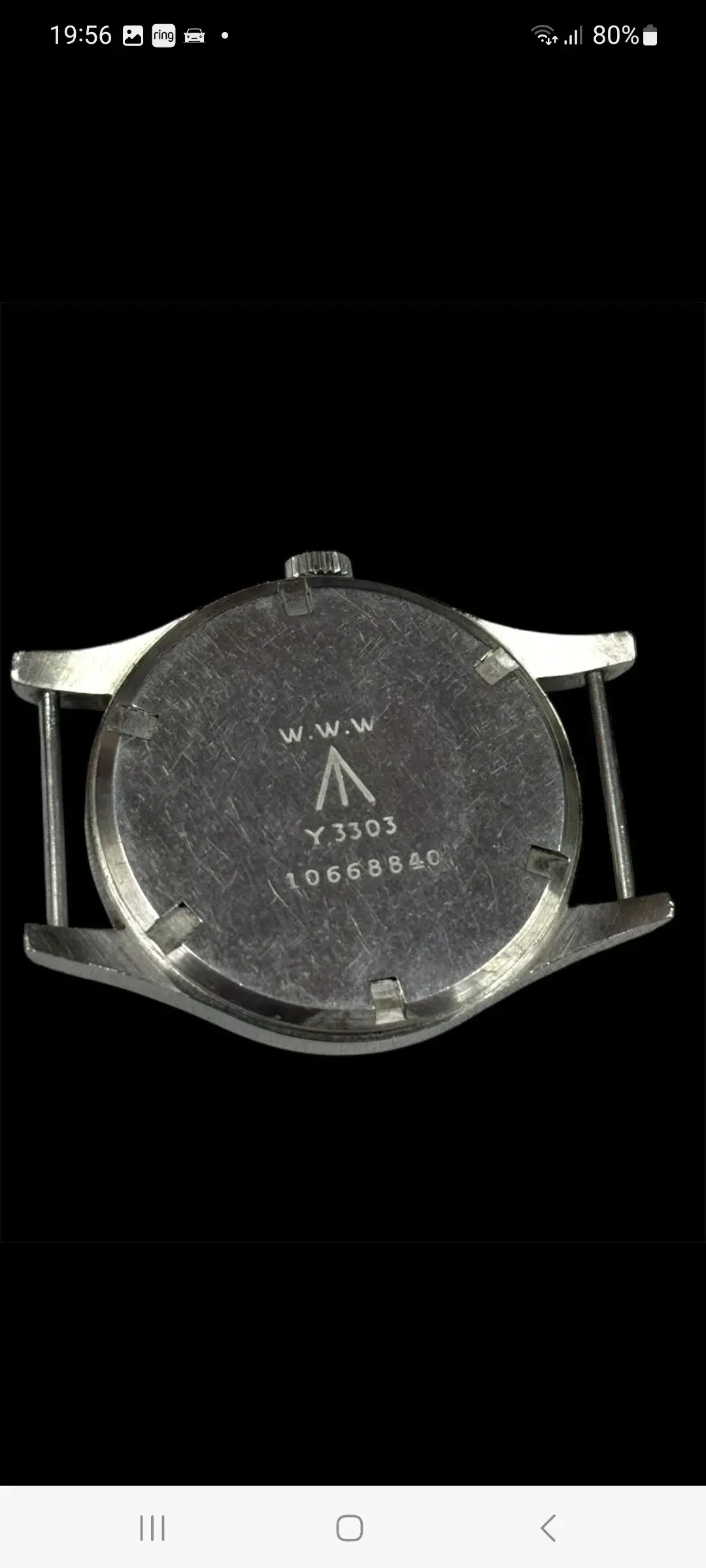

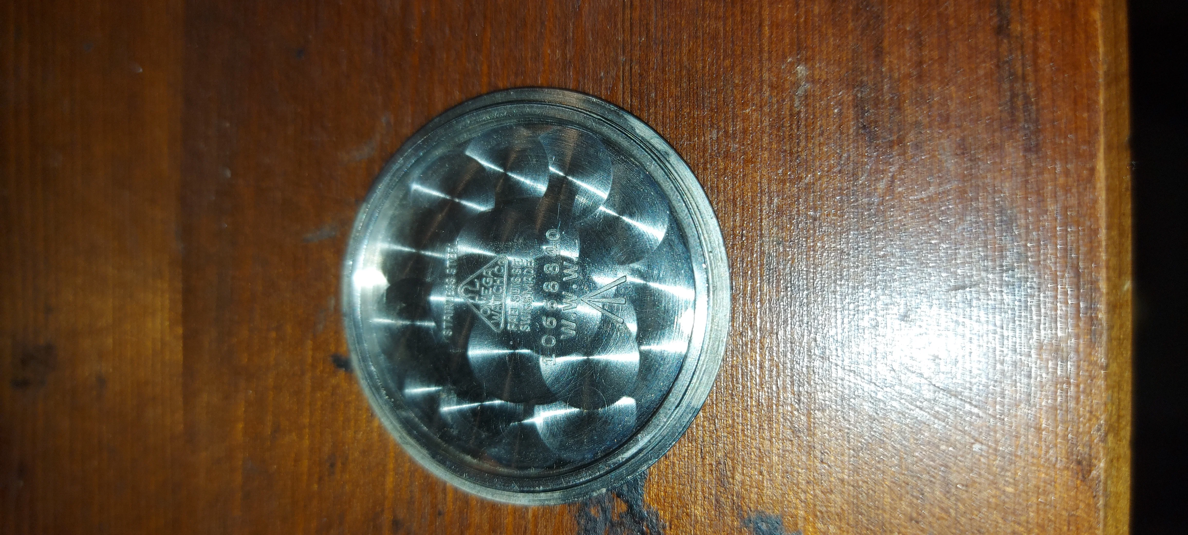

I don't like any of the case back engravings either, an image of the inner case back would be interesting. I would return it if possible.

I'm not going to post details but I don't believe the case-back is legit. And as noted, it is not the correct movement for a "dirty dozen."
So, it's not collectible in any way, and strictly speaking it's probably "counterfeit." But if you bought it cheaply and knowingly, just for fun, then enjoy.

Thank you for posting the additional image. Sadly, a complete fake.

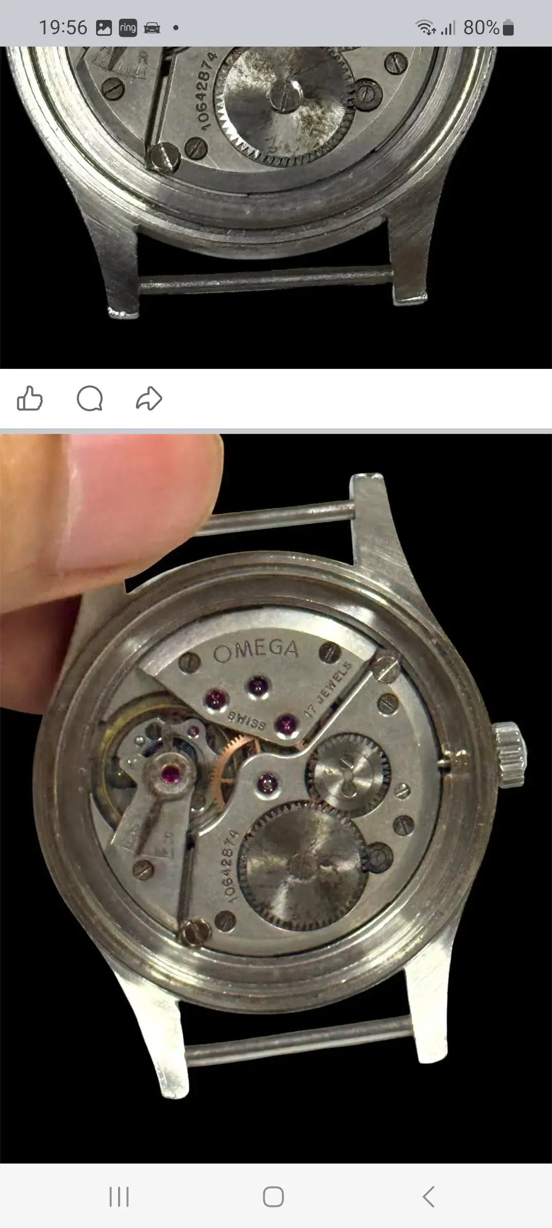

Hi, is the movement fake aswell.Thanks again.
4,519
11,129
Movement is Omega but not the right one for a WWW
It's a legit Omega cal 28. The dirty dozen WWW watch would have a 30T2.
