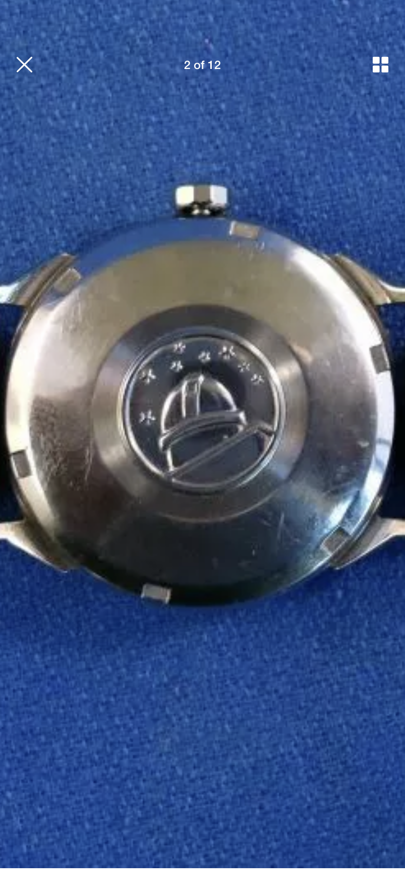

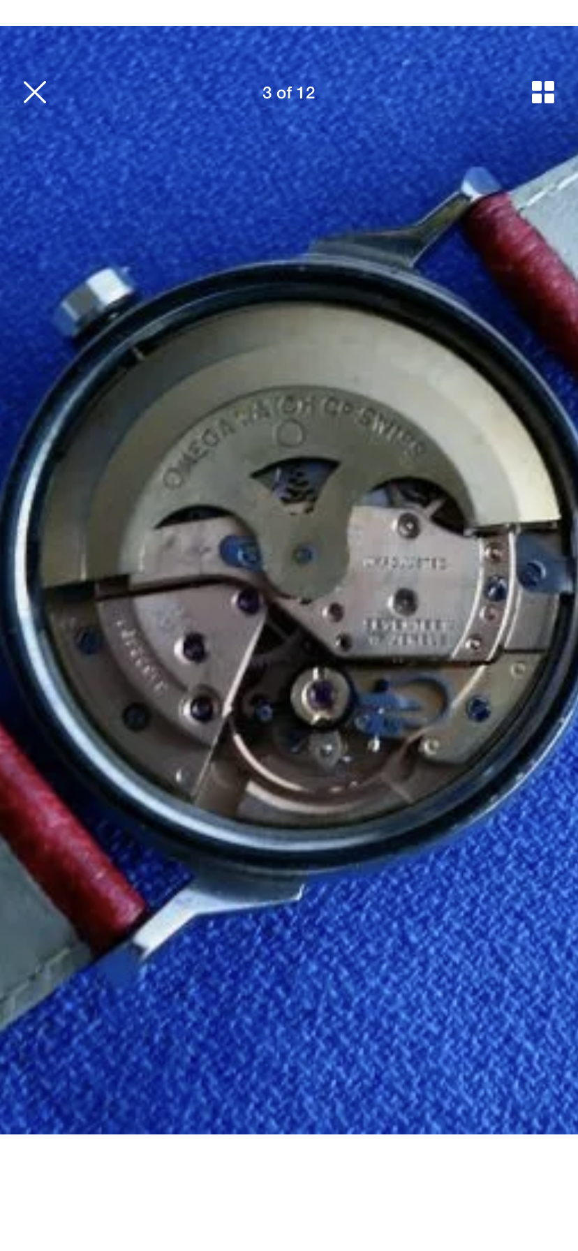

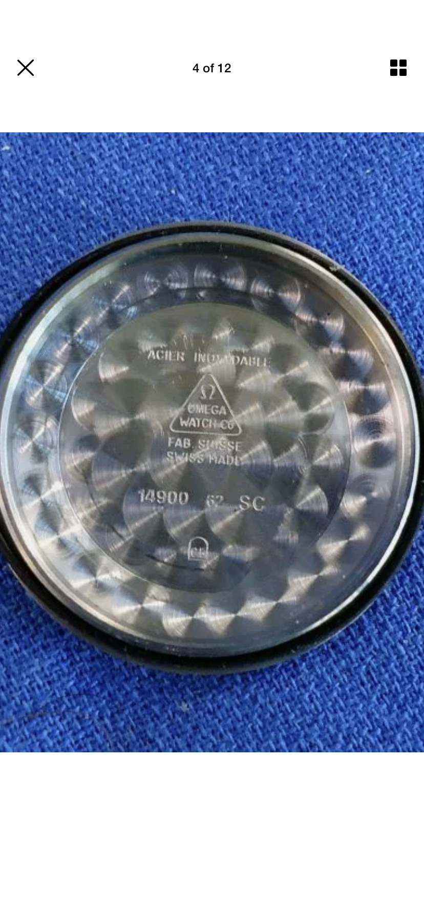

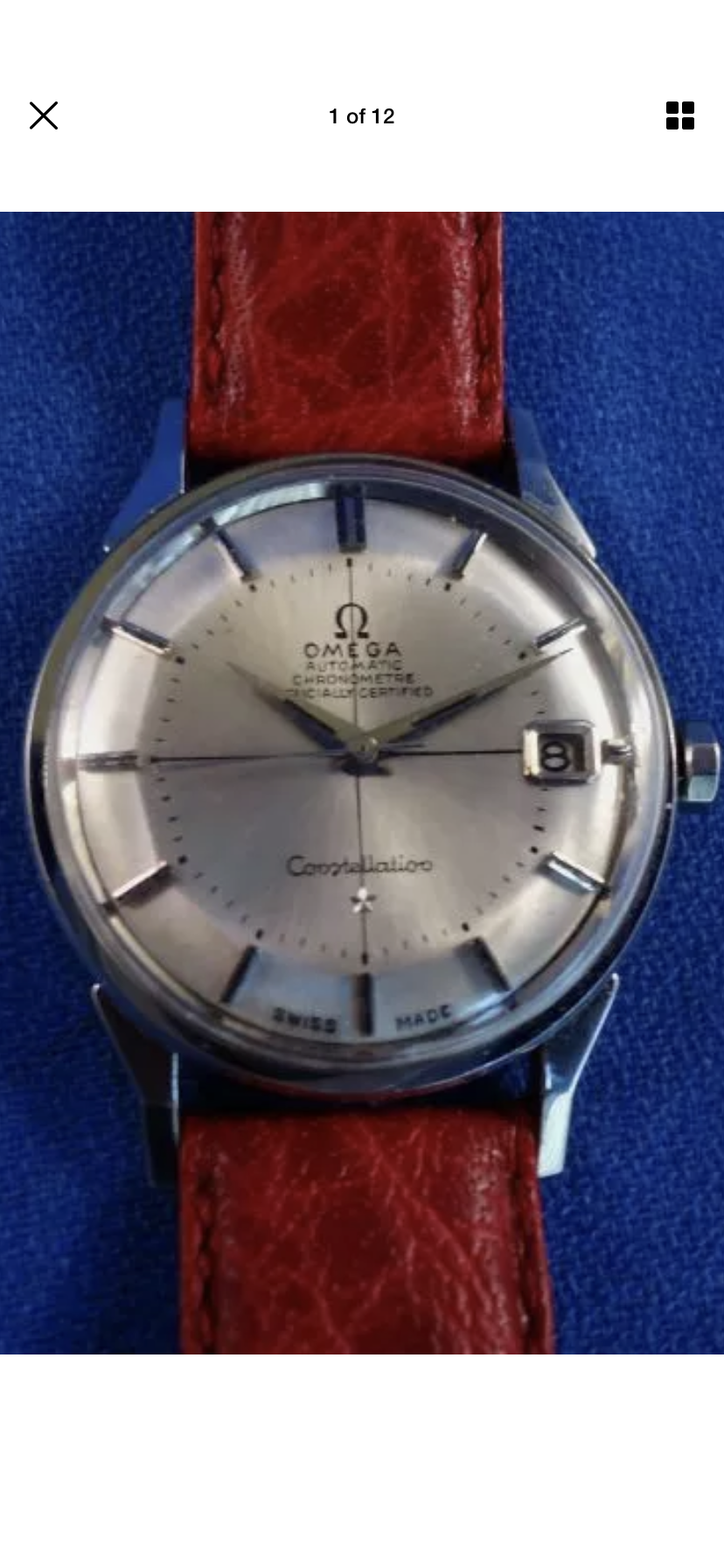

Hello all. I purchased a watch (not paid for it yet). It’s an omega pie pan Constellation. It has caliber 563, which after looking around, didn’t really seem to match type of watch. The pic on the auction are ok but not close up and a little blurry. If anyone could take a look and let me know I would appreciate it. Ty
6,832
10,502
Welcome @jcwatchdog
if you haven’t paid for the watch and can legitimately withdraw, I would do so.
At best it’s a put together watch, with what looks like a fake dial but at the very least a very poor redial.
At worst it’s all fake.
The pics really aren’t good enough to be certain.
Any more images, such as a side shot?
You are correct that a cal 563 shouldn’t reside in a Constellation.
hope that helps.

As @JimInOz mentioned, that watch is pretty much a poster-child for everything to avoid in a vintage Omega. It's really bad. You're very lucky that the purchase was canceled and you were given a second chance.
13,492
31,811

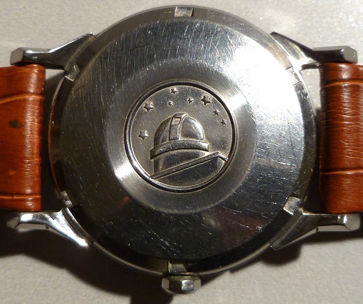

It is fake, completely fake, the ref 14900 is one of the Constellation references known to have been faked, the only thing Omega about OPs watch is the movement, which isn't even correct for a Constellation.
The arrangement and size of the stars is a dead giveaway.
Compare to a genuine back.
