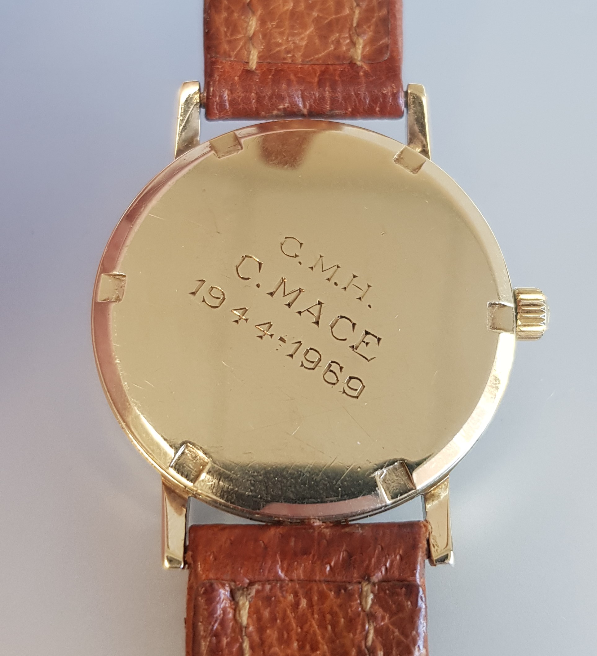

I ordered an extract for a vintage Omega Seamaster with the 601 manual movement out of interest. The piece was originally presented to an employee of General Motors Holden Australia in 1969 as a 25 year service gift.

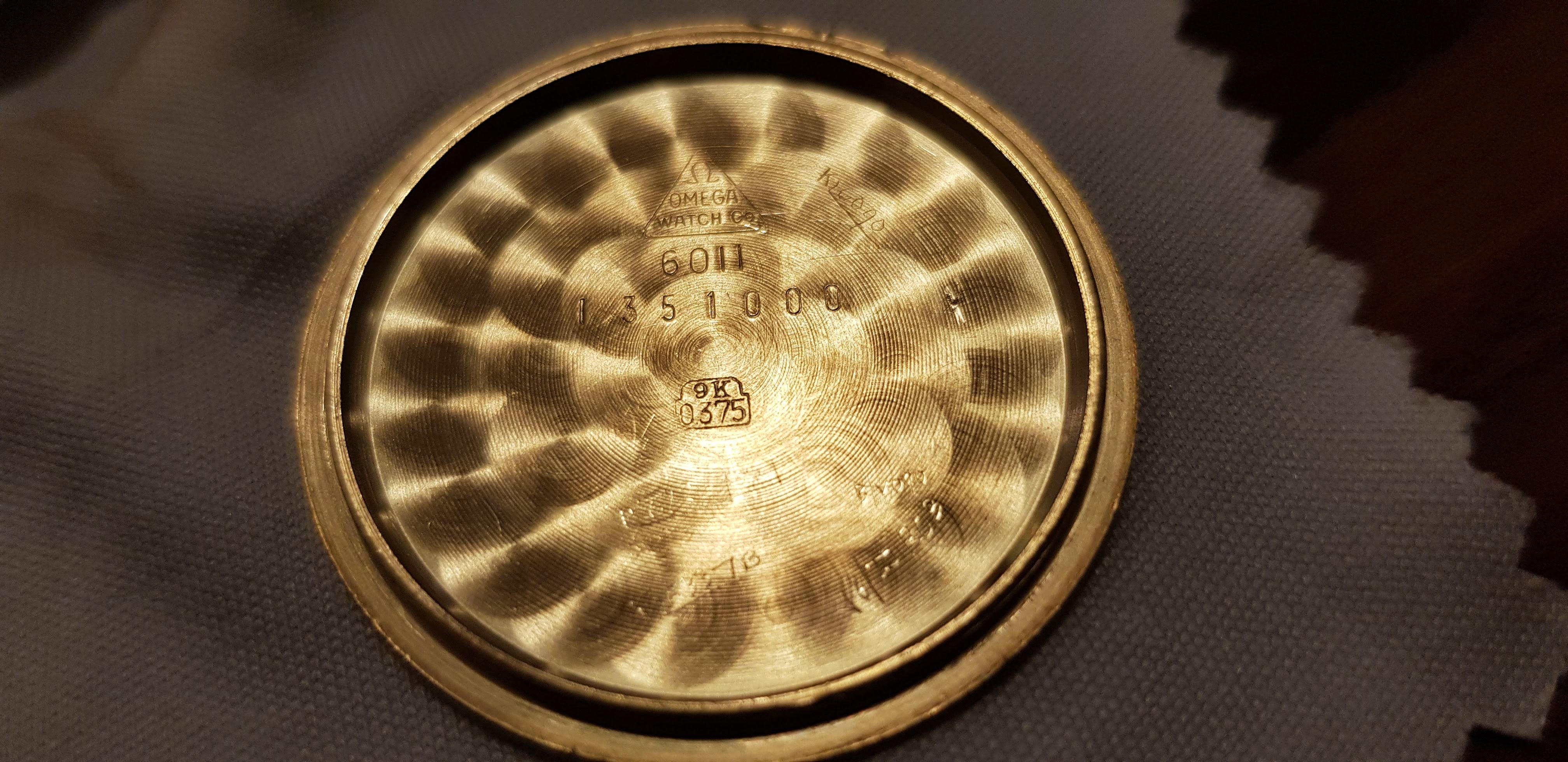

Thanks for the info! I wonder if they made this case? Shame there's no stamp on the inside to identify it. Would love to know what the numbers 6011 and 1351000 on the case back correspond to.
3,653
7,770
IMO 6011 is the case (reference) number and 1351000 is the case serial#
