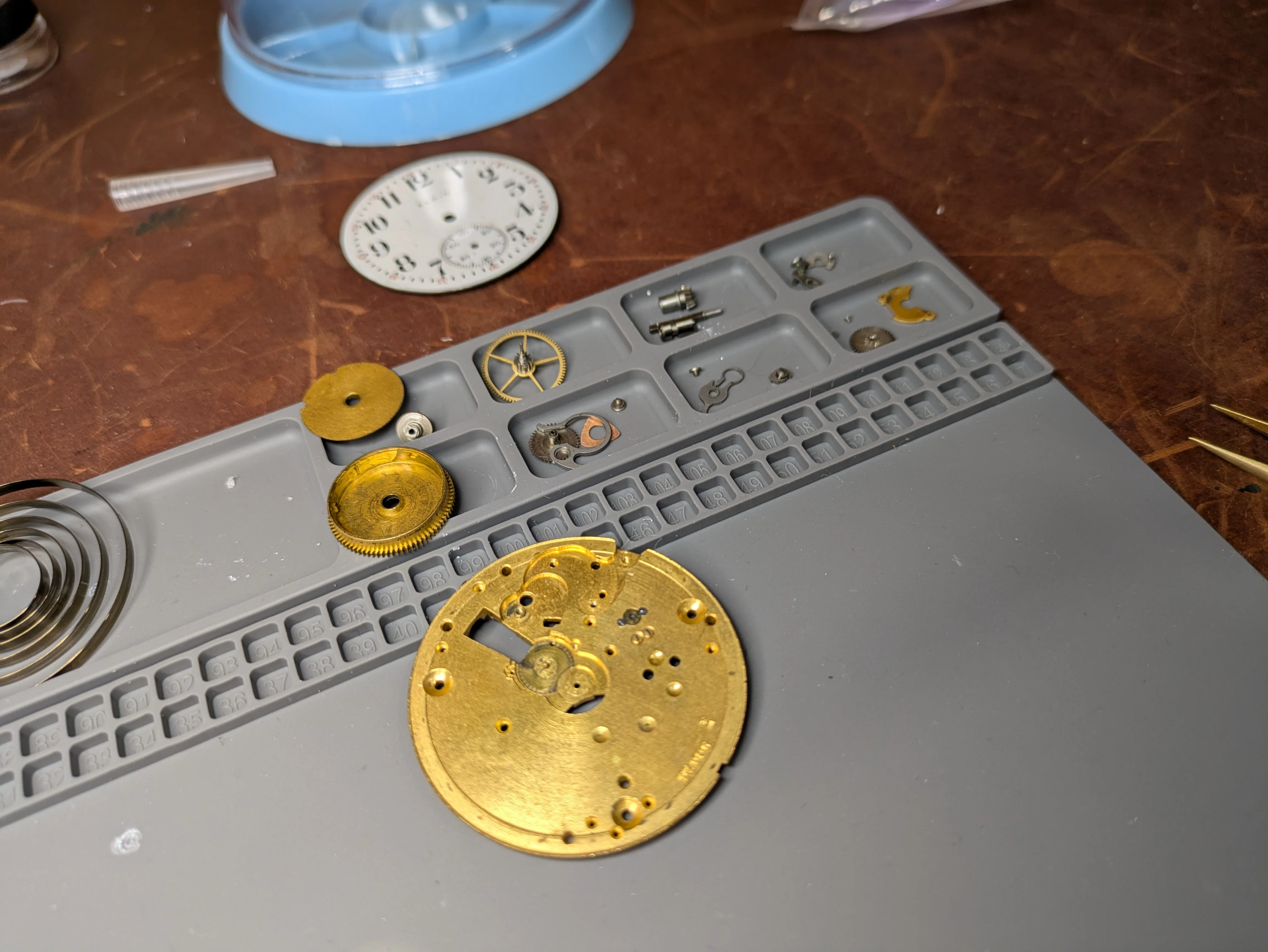

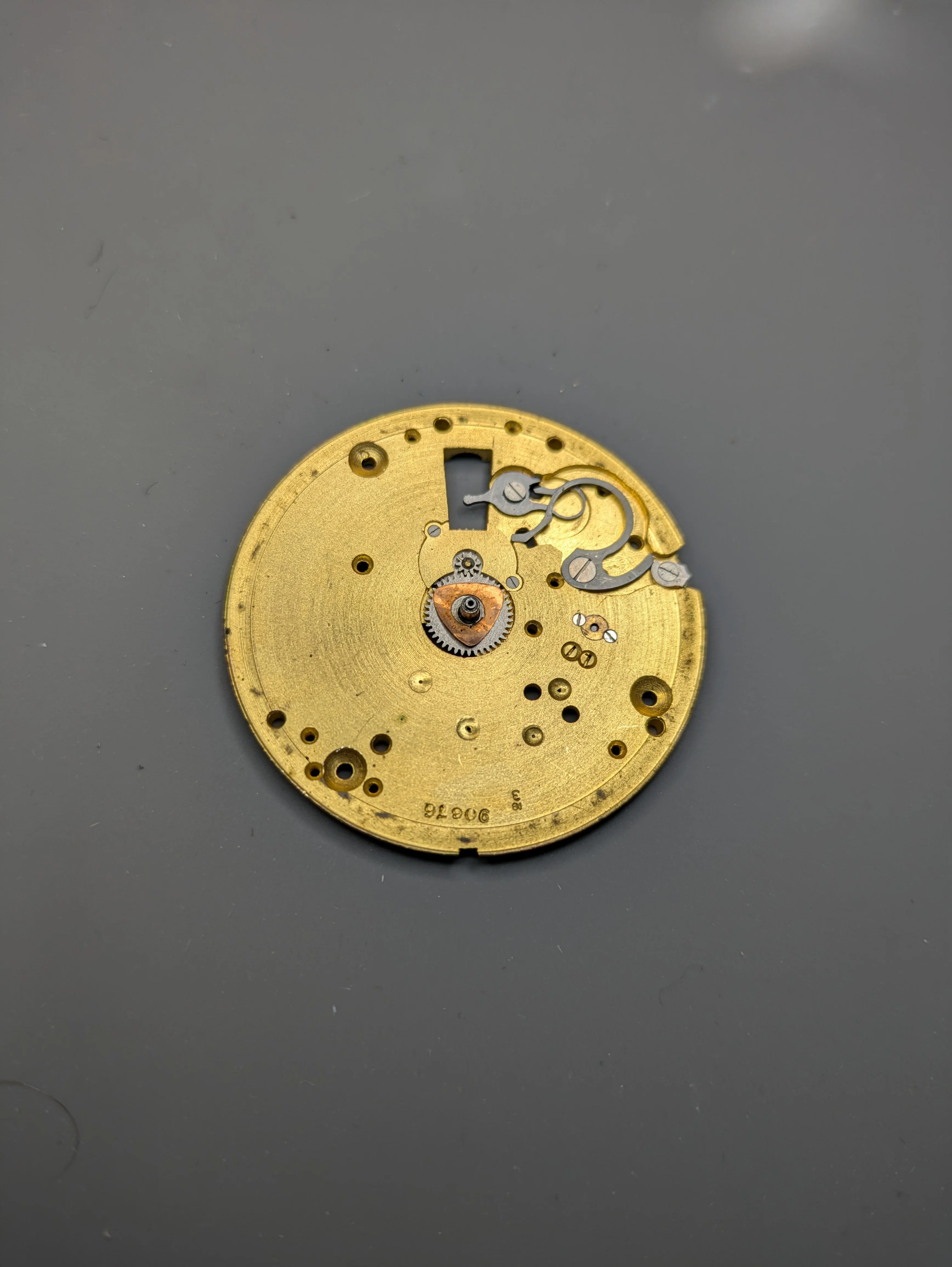

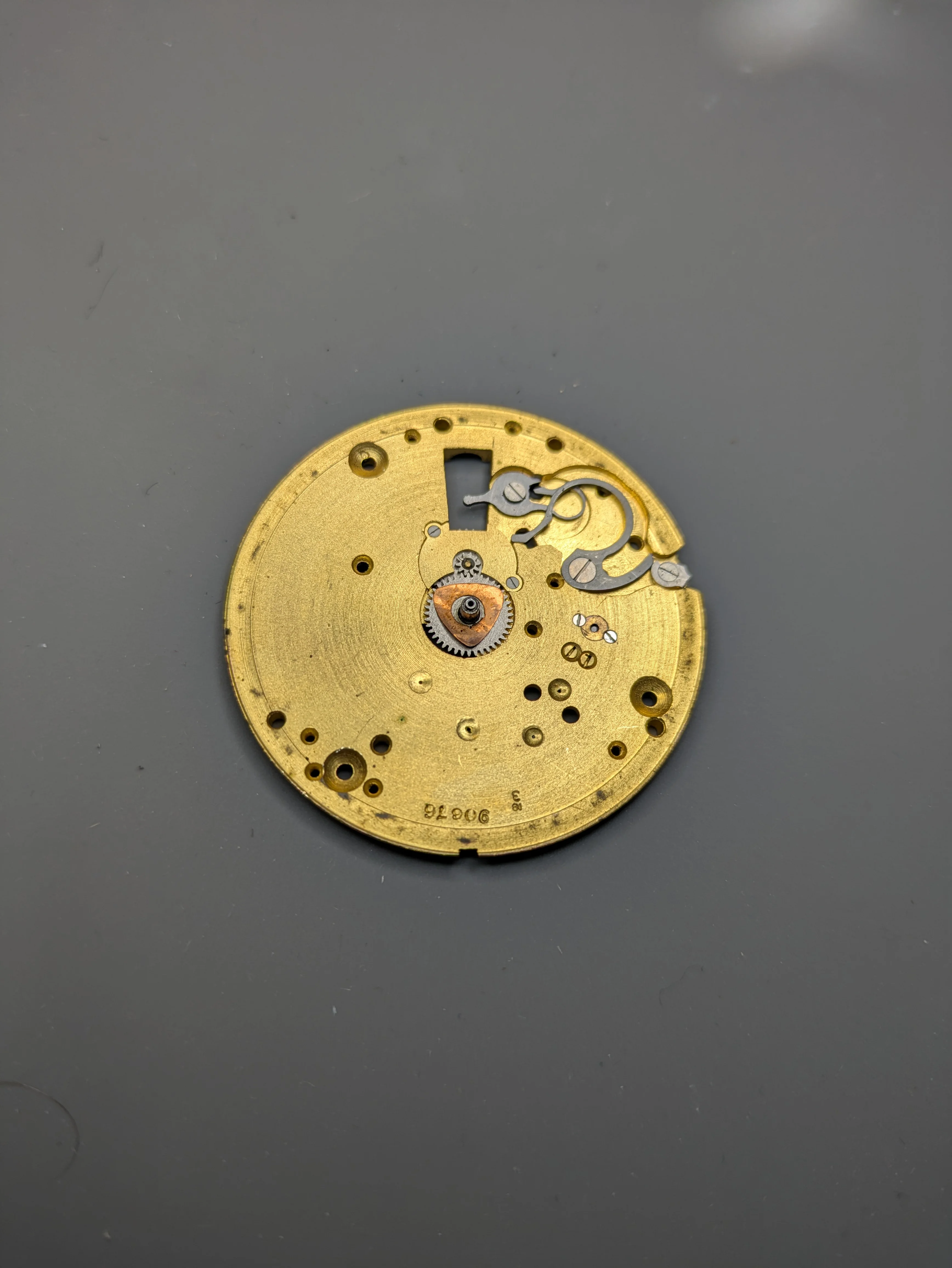

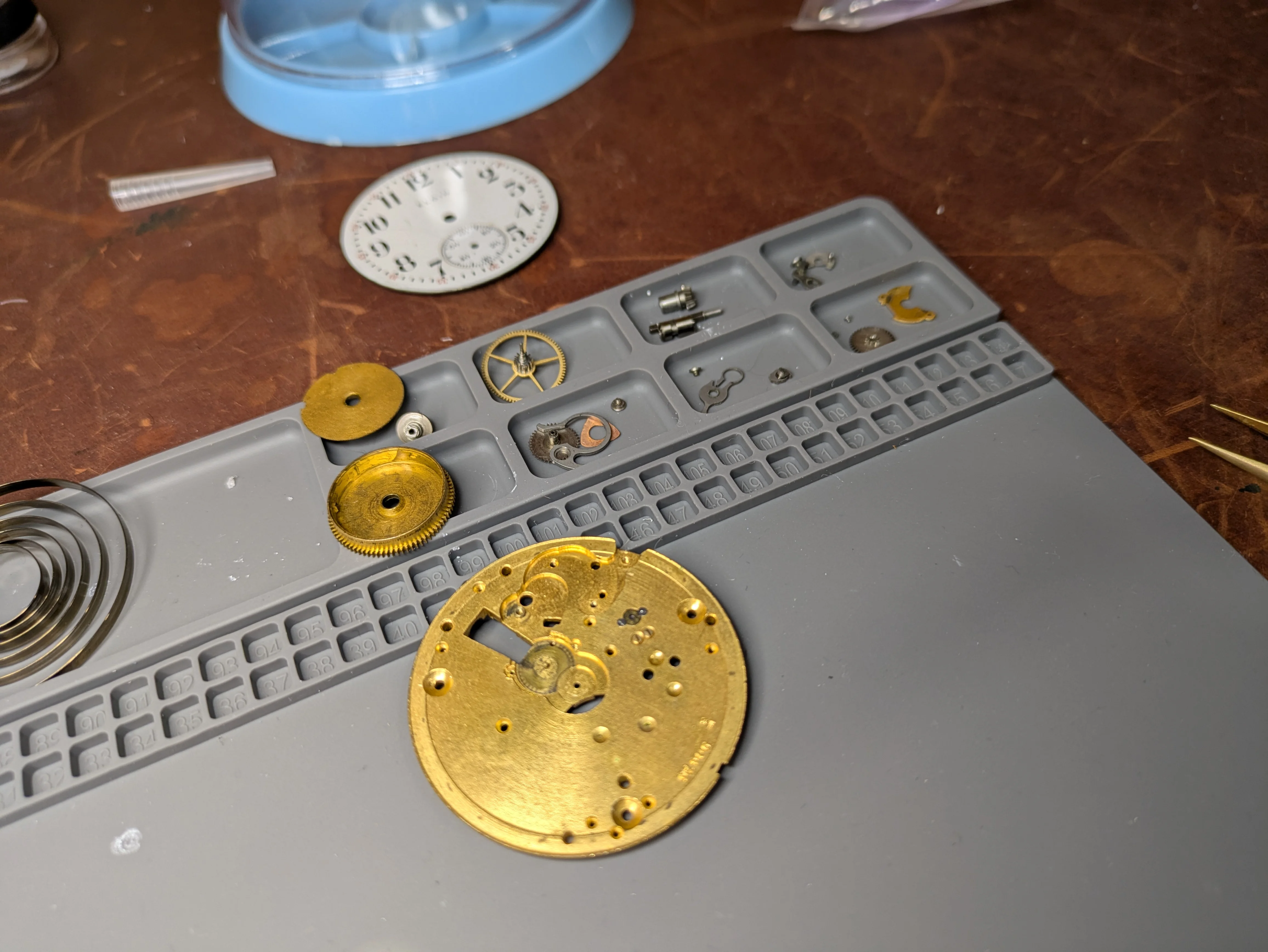

I finally got a 2nd day of working on this. I got the screwdrivers in, so I was able to pull the dial, and this side disassembled pretty easily.
HOWEVER, it looks like the little lever to switch between setting the time/not is broken? (See outside most screwed down part on the plate in the 1st picture). It actually doesn't have anything that looks broken, it just looks like it doesn't do what it is supposed to. ALSO, the crown itself pulls out/in on the case.
Does anyone have an idea how to find that part? It looks like just the nub is missing? I saw diagrams here: https://pocketwatchdatabase.com/guide/company/elgin/grade/293/technicals particularly #6.
It LOOKS like https://pocketwatchdatabase.com/guide/company/elgin/grade/293/parts/catalog/1314/293 ?
Does anyone have a good way to acquire one of these? I see a few 'parts movements' on ebay that I'm tempted by just pick up instead.

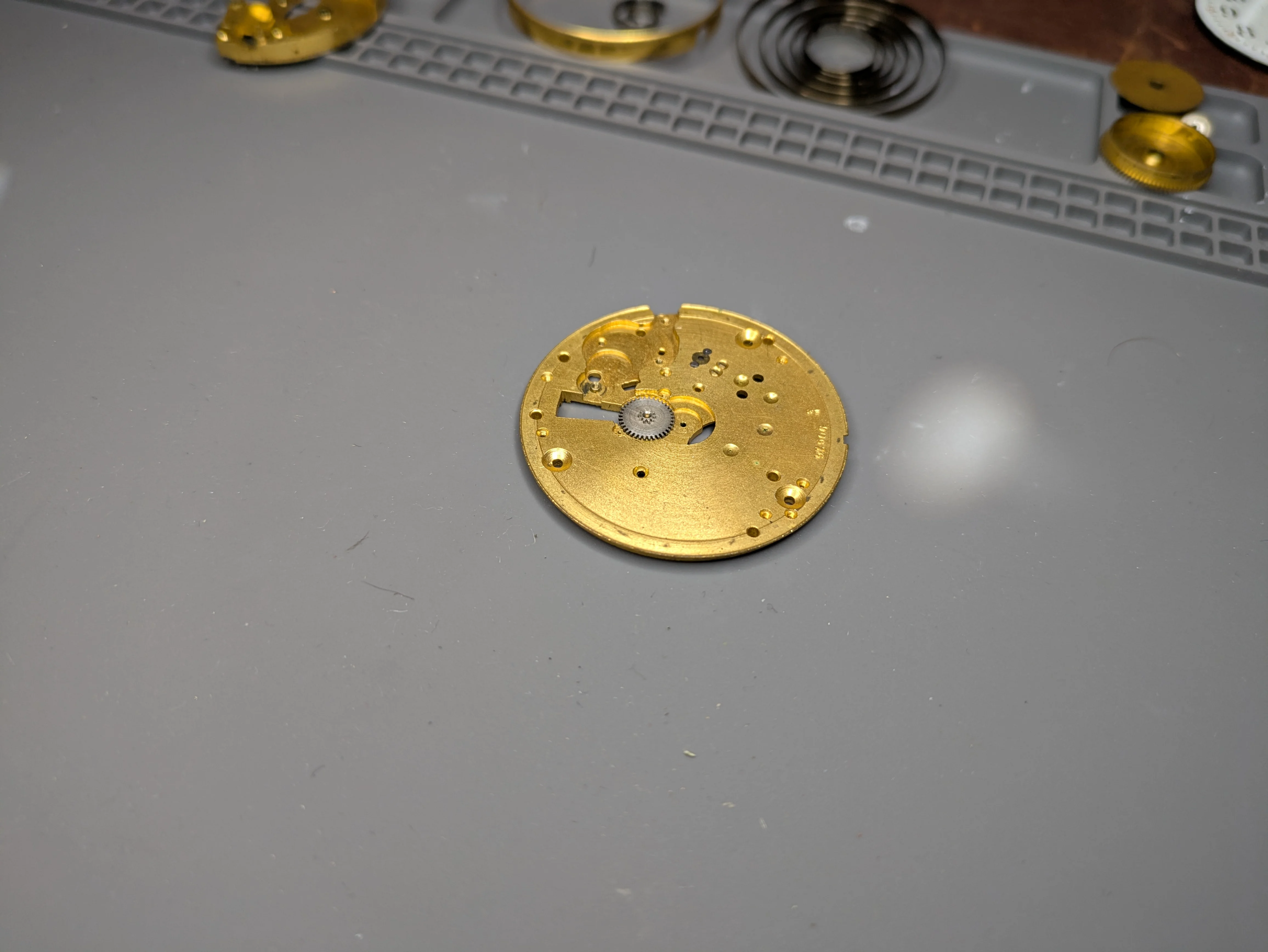

I ended up taking a risk on a $20 ebay parts movement with a broken balance. I spent an hour or two yesterday putting the watch MOSTLY back together. I had some problems with the barrel/mainspring. I had to hand-wind it because the ring was slightly too big by ONE coil. So FML on that one 😁 The arbor was also REALLY hard to get into it, I had to stretch the center coil with some steel tweezers (actually ended up bending my good tweezers trying to get it in!) in order to get it to work, but its fine.
I'm down to the balance, pallet fork, dial, and hands left to install, but holding off so far.
The broken part is.. strange. I'm hopeful that the other movement has a useful one and can just use that one (it also has hands, which perhaps will be nicer than mine?). I haven't figured out how the dial side of the keyless works functions, it is a pretty confusing thing that pokes through the other side, but it at least actually works! That little broken lever seems to be a 'prevent the crown from getting into setting mode', and works, though requires an act of tweezers to change 😀 Hopefully the replacement is the 'right' one, else I'll probably just leave it in 'crown does both things' mode.

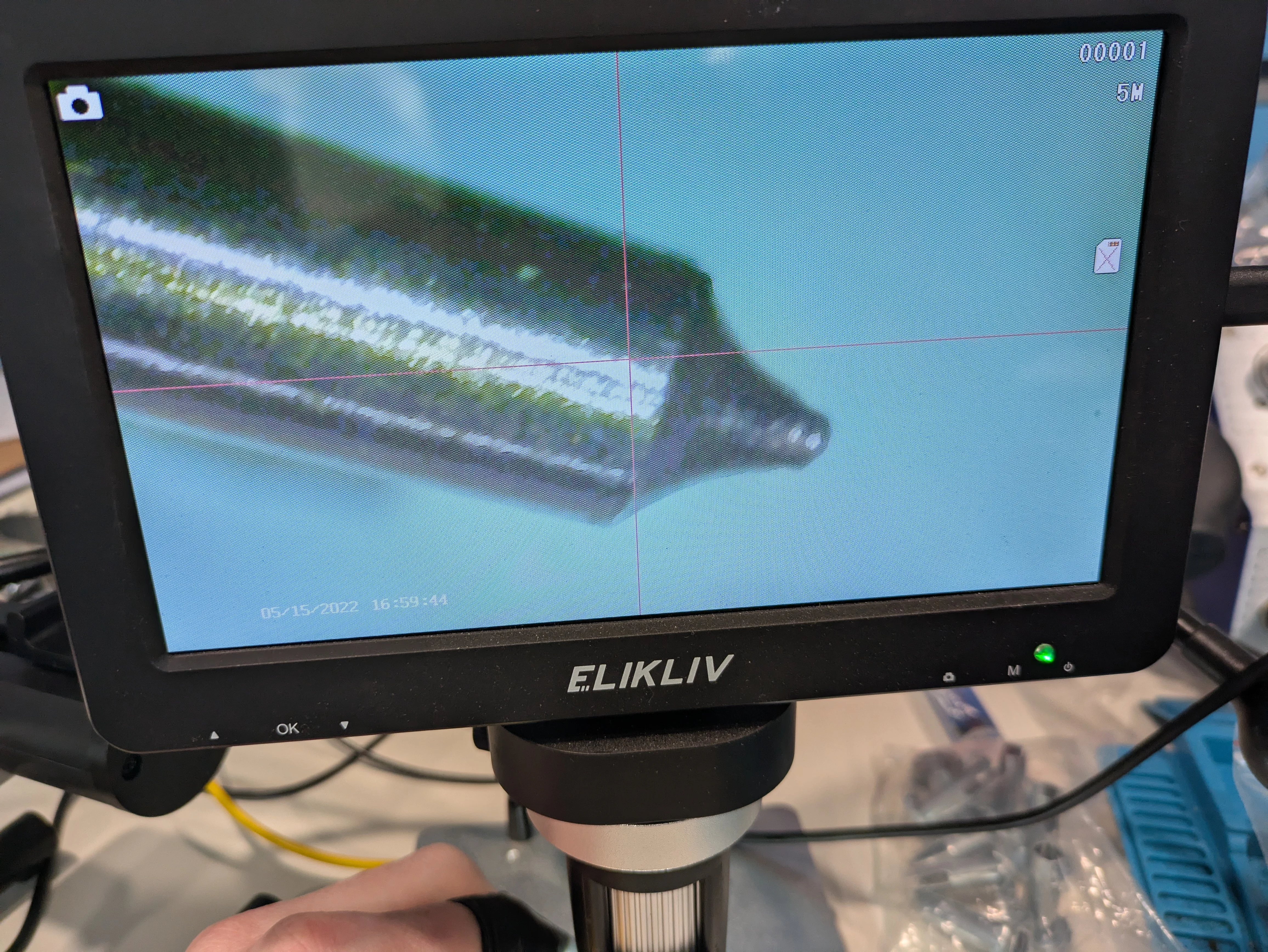

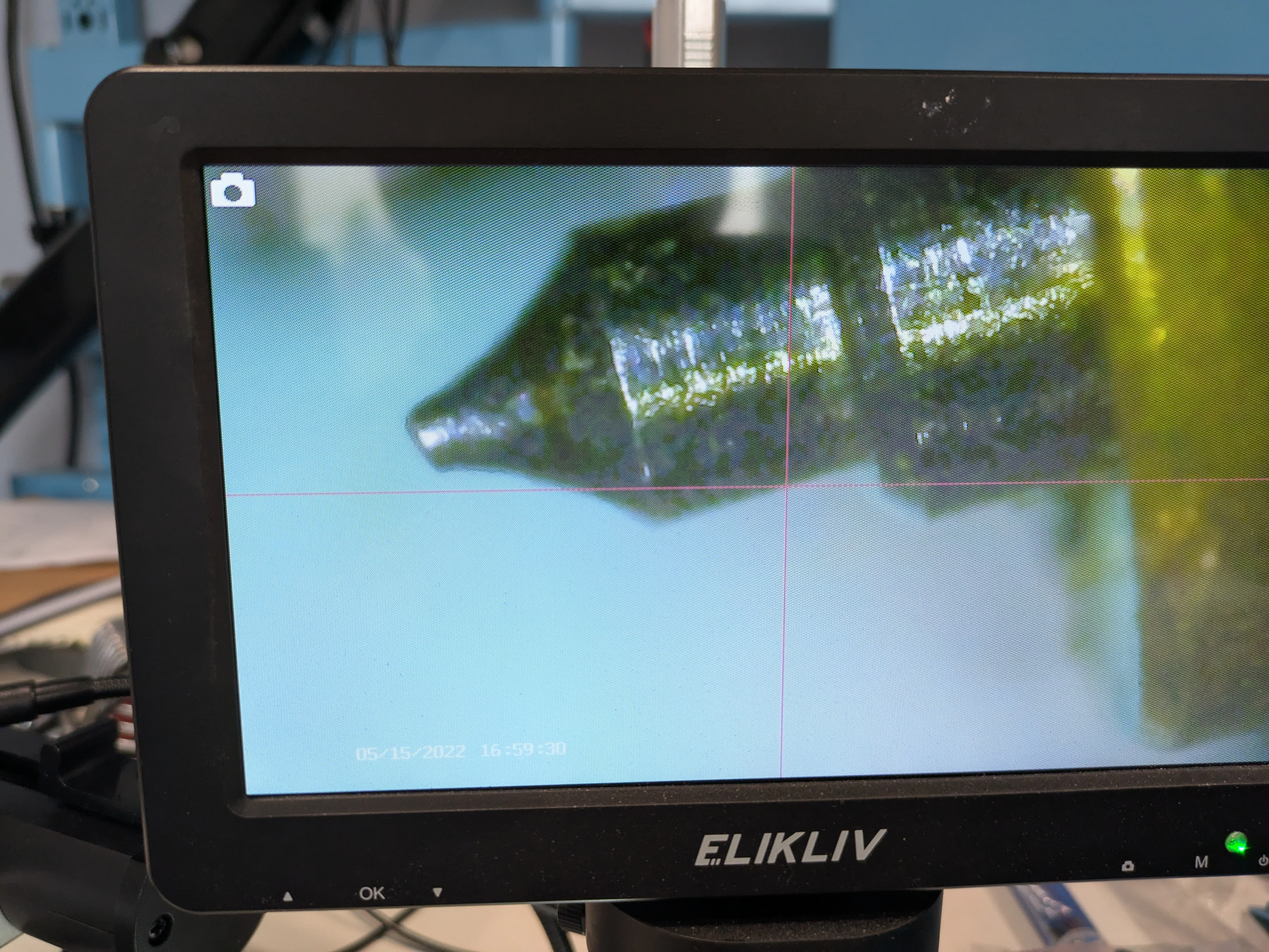

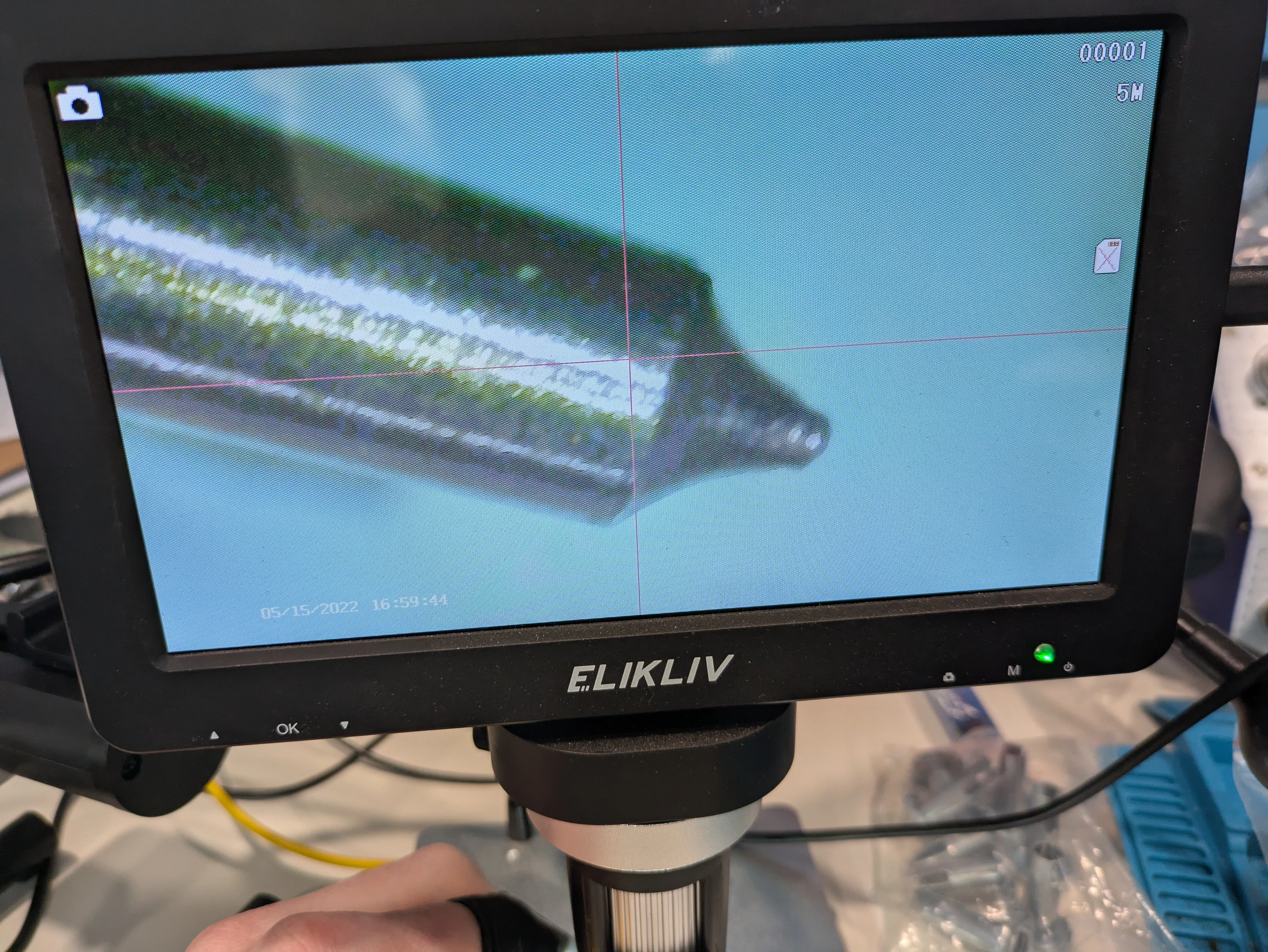

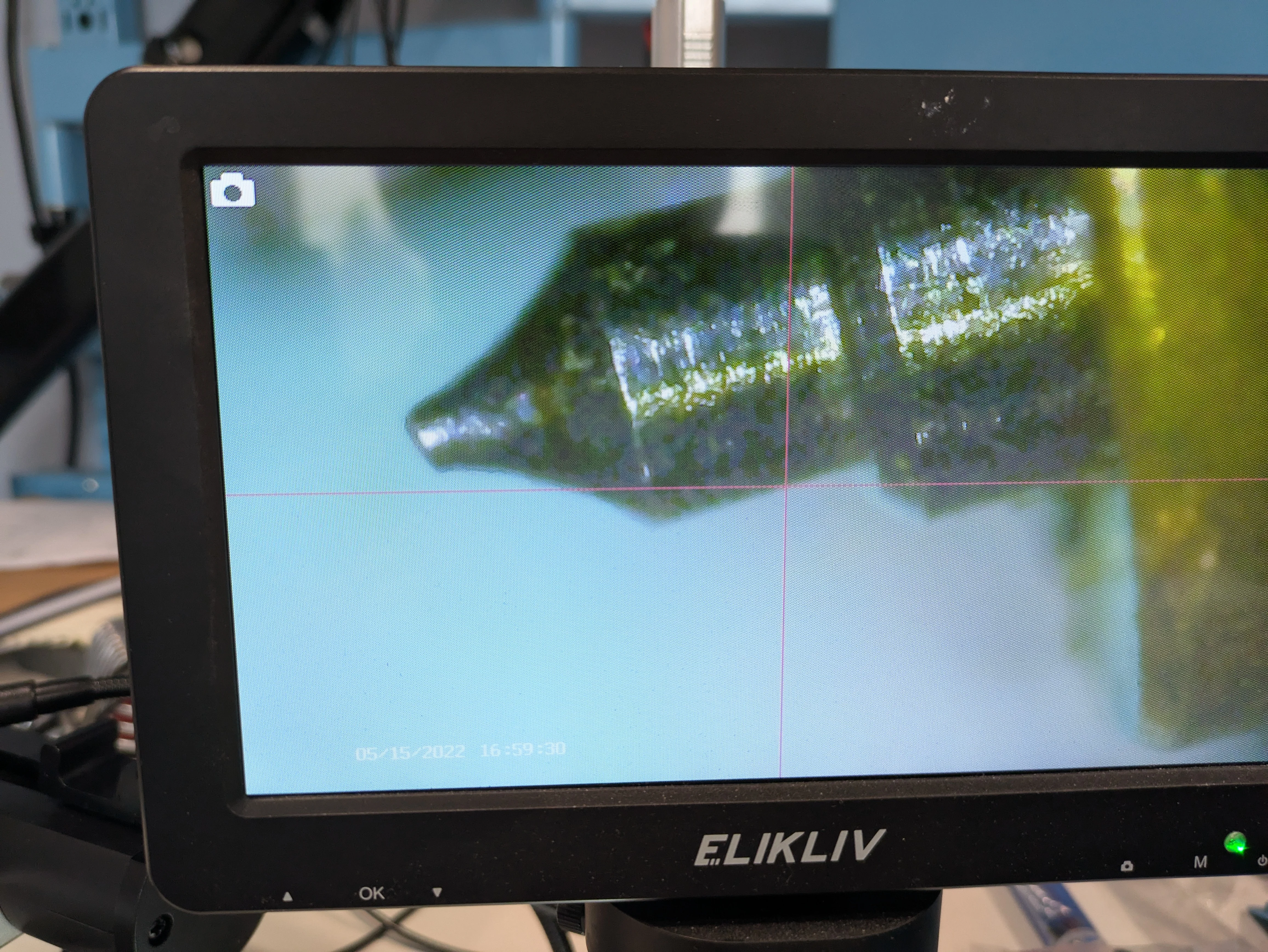

URGH. Went to clean the balance wheel jewels, which was my first time touching the balance wheel since I took it off. These are broken, right? These are both pivots for the balance wheel.
These are both broken, right? I don't think I've done this, but it likely means I'm done with this watch anyway I would need to get a full replacement balance wheel with hairspring/etc (as I'm not yet comfortable replacing the balance stem), so this likely ends this project :/
I wish I'd paid more attention to the balance wheel when i took this apart so I'd know, but I'm pretty sure I didn't cause this.
Unless anyone has a lead on a replacement they could send my way?
Thanks in advance
2,684
2,872
Yes - pivots are broken off.
Convinced myself of that 🙁 All of the donor movements I could find on ebay seem to have the same problem, so I think this one is done for (as is the replacement movement for parts that I have). Sad/unfortunate, but nature of the beast I guess. At a certain point I suspect I'll just have a pile of 'parts' movements/watches exactly in this case.
A little disappointing, but of course not unexpected.
I spent a little time finishing the assembly of the watch, which is quite beautiful all the same. Perhaps some day I'll find a complete balance for one of these (looks like Elgin 9072 or 9082), or be brave enough to start staking my own balance staffs, but today is not that day!
Thank you again for your help here.
