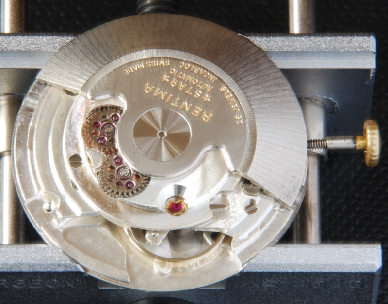

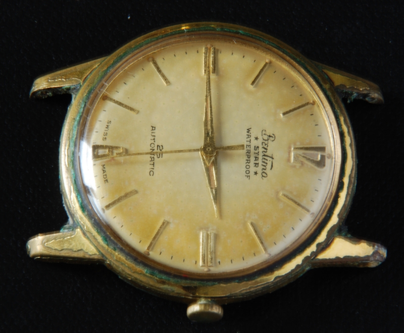

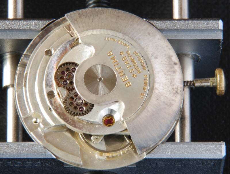

Like I said above, I have an ETA based watch open at the moment which I believe is late sixties. The case is GP on brass and is in a terrible mess. I think the only way to get the remaining GP off is by hand and I'm going to leave it as a brass finish.

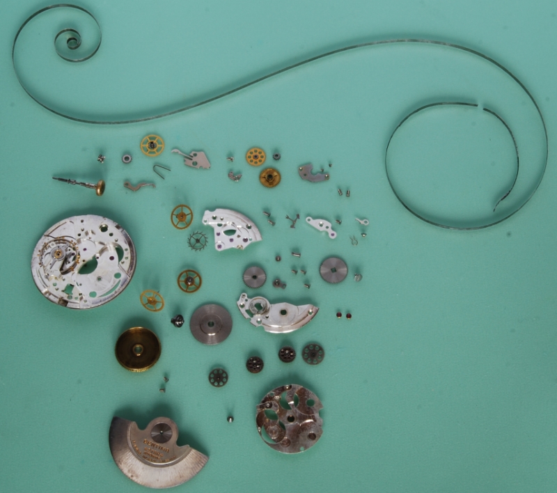

Clearly, a Bentima Star and on opening it, I found an ETA 2451. Nothing special but I'm beginning to appreciate ETA calibres as they have a good reputation.
Signed rotor, which I think is a service ETA still offer today.

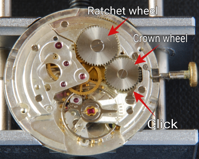

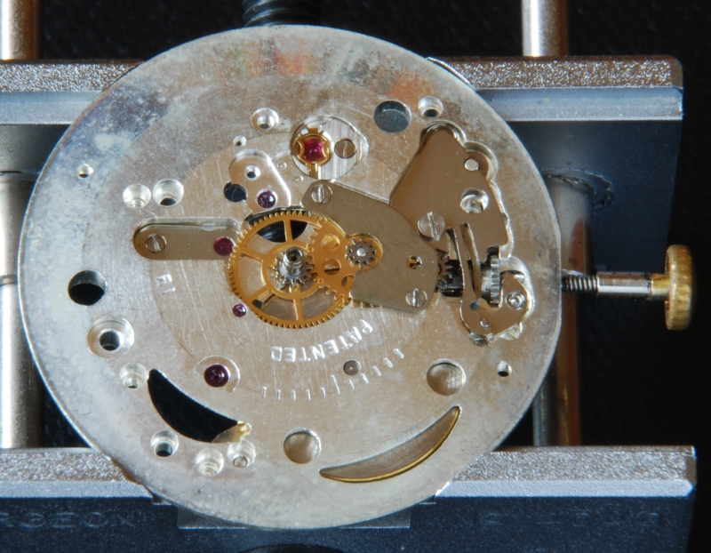

One of the aspects of this work I like is the countless ways that the designers used to achieve the same aim. Here's a picture with the auto bridge removed. What's unusual here for me is that the click is acting directly on the crown wheel. When you turn the crown in wind mode, that wheel rotates and turns the ratchet wheel - all as typically done. The ratchet wheel is connected to the barrel arbor and winds the mainspring so, typically the click acts on the ratchet wheel to stop the mainspring unwinding it again when you release the crown.
With the click removed, the crown wheel is free to slide away from the ratchet wheel which seems a bit odd. It's held against the ratchet wheel by the click and it's spring. You can see in the next photo that the wheels are no longer meshed.
So, the crown wheel is sprung like this to work in the following way:
Winding by the crown: the crown wheel turns, is meshed with and rotates, the ratchet wheel to wind the mainspring. Nothing can unwind as the click stops that happening.
Winding by the auto rotor: the auto mechanism drives directly onto the ratchet wheel (you can see a small pivot hole just off the ratchet wheel two photos above at about 9 O'clock and the auto mechanism wheel is pivoted there). As it winds, it's turning the ratchet wheel which is trying to turn the crown wheel which can't rotate because of the click so, as one mating tooth climbs up the other, it pushes the crown wheel away until it "jumps" one of the mating teeth and the click spring pushes the crown wheel back against the ratchet. The ratchet wheel has now turned winding the mainspring.
Not too many parts. The auto bridge holds the reversing wheels and it's other two reducing gears without separate screws. A small issue with the mainspring as it's in two parts...

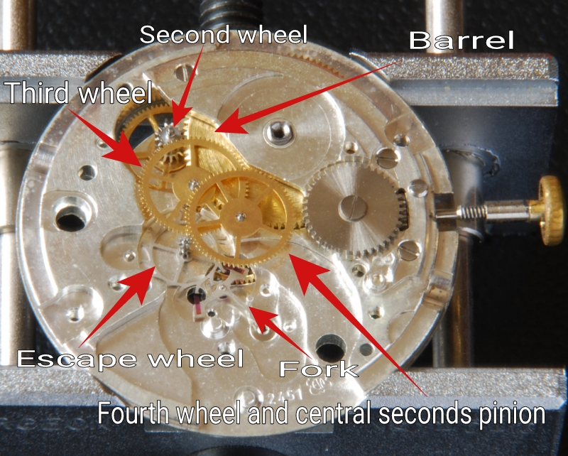

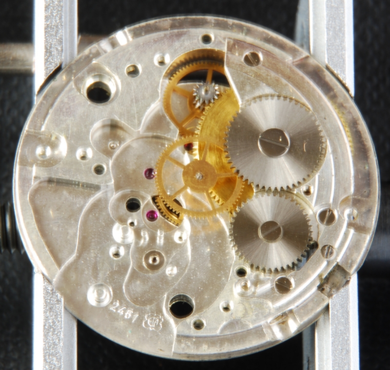

After cleaning and assembly started with the train just laid in place. As usual, the barrel drives the second wheel, which drives the third, which drives the fourth (and this will take the seconds hand as it's rotating once per minute), which drives the escape wheel and then the fork. Balance not shown which controls the fork movement.
Dial side and keyless works (second wheel not shown):
Train fitted and running.

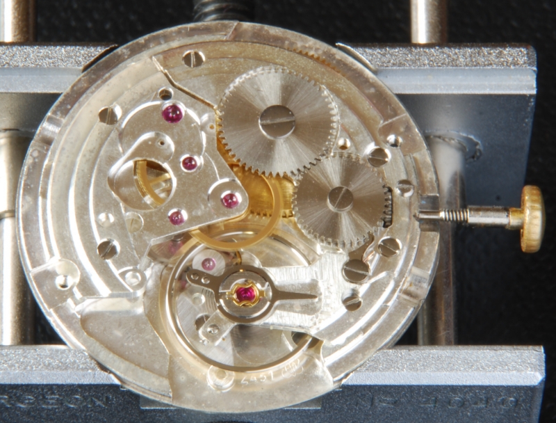

Rotor and auto bridge fitted and looking a lot nicer.

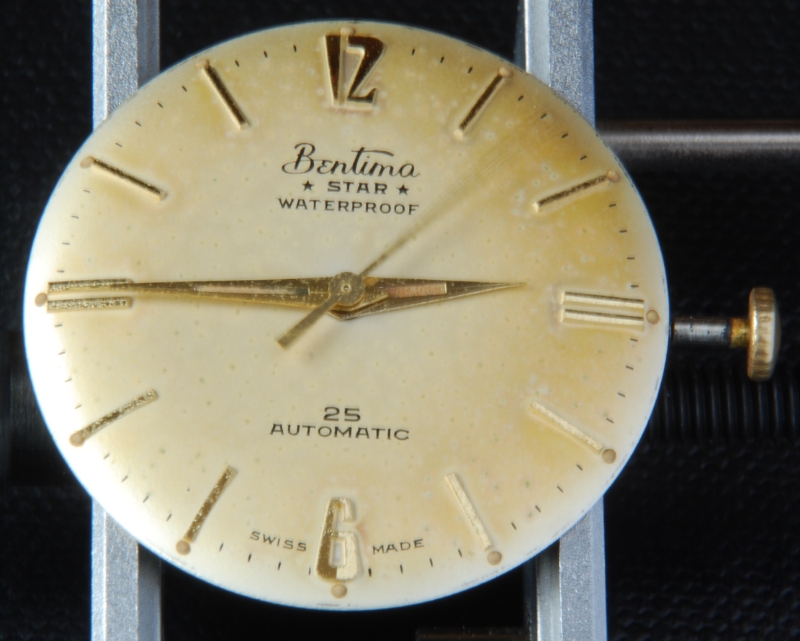

Dial and hands fitted.

Hi Chris,
You will see the DNA of modern ETA movements here like the 2824-2, 2836-2 and some others. I guess I see so much designed like this with the click acting on the crown wheel that I don't think of it as being unusual, but I guess it is in many ways quite different from the traditional designs you typically see from other brands.
In layout of the train this movement is the same as the 2824-2, and you even see an earlier version of the 2 piece cannon pinion here. Just a note that the terminology you used as it brings up a point to be aware of. While the terms you used are correct for most watches, is a bit different for these ETA movements. What you are calling the second wheel is called the intermediate wheel in ETA terms, the what you are calling the fourth wheel is known in ETA terms as the second wheel, or sometimes called the sweep seconds wheel. If you need parts, you just need to make sure you use the right terms for that brand, and not just what the traditional watchmaking terms would be.
Note that many of these ETA terms for specific parts carry over to modern Omega movements as well, particularly those that are based on ETA movements like the 2892 based movements.
As you work on more and more movements you will find some unusual designs, and you may often be wondering what the designers were thinking when they did certain things. In particular some of the calendar functions I see on older movements seem needlessly complex for what they are doing...
All good stuff though, and that movement cleaned up well!

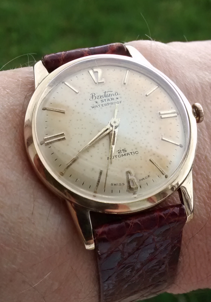

So, moving on to the case… What an awful mess this was with some gold plate left and a great deal of pitting. Now, I know we don’t polish cases on here but there is no option for this one as I’d say it’s really beyond any economic repair. I could clean it all off and try to re-profile it and then get it plated again but here, all I wanted to do was bring this watch back to life for a friend. It’s a brass case and the good part about working with brass is that it’s soft but that’s also the bad part. So, easy to re-profile but difficult to get any sort of finish other than polished so I ended up going for a polished look. It will tarnish but I’ll have some access to it later so can keep it looking nice. Worked with blocks and a couple of grades of wet and dry in an attempt to maintain some edges and then final polished. I wouldn’t be doing this on a good watch but, I’m happy enough with the result. Will put “case refinishing” on the very long list of things to look at, probably next year.
Here on the wrist with a new crystal and the movement re-installed and looking far better than the starting point a few posts above. Nothing special but nice to bring it back to life and a new calibre for me.

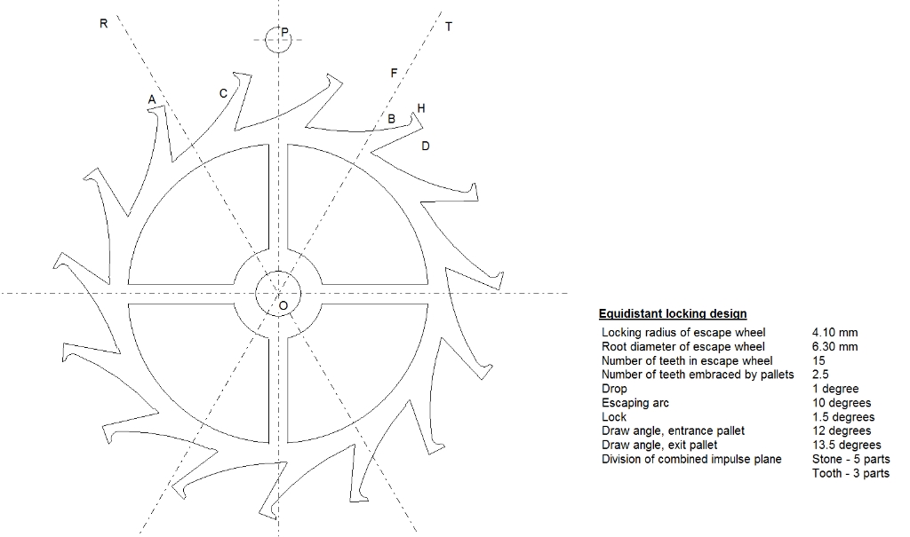

I did a little of my lever escapement drawing as well today and am quite pleased that it makes sense to me. All the labeled points are there for the construction but I've only drawn the wheel so far. This is also very interesting and quite involved. Will check this and then draw the fork and so on. I wanted to get to this as it's what I want to work on unlike the clock escapements above. Step by step though.

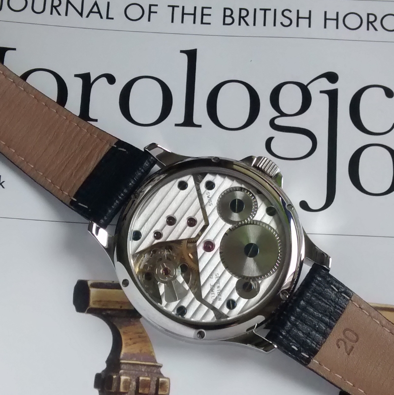

I've not posted anything about this for a week or so as I've been on the first course at the BHI. This was the Basic Mechanical Watch course about halfway down this page.
I would recommend this to anyone who has an interest in the way their watch works as well as any budding Tinkerers and Watchmakers. You don't need any experience to do it and can go in without any knowledge. There are six on a course with one instructor, John, who guides you through everything. We had mixed group of ages, spanning 25 years (me at the top🙁), and experiences with some never having opened a case before. I think you'd get a lot more out of it if you've done some pre-reading and have spent some time tinkering but it's not essential.
Most of us stayed at the BHI where breakfast and lunch were supplied in their on site cafe and everyone said the quality was excellent. In the evenings, students and instructor trooped down to the local pub where again, the food and beer were very good. Have put on a few pounds.... You do end up being immersed in watch talk a lot of the time but you also chat about most things under the sun so, definitely worth doing that.
Basically, you start with a cased pocket watch with an ETA 6497 calibre. These are big calibres and are still used by companies today, for example Panerai as well as Al at Archer Watches. So, a pretty robust movement with, in it's better forms, some great available performance. Being a pocket watch, the seconds sub dial is opposite the crown and there's also a 6498 with the sub dial at 6 O'clock when used in a wrist watch. Here's a quick picture of my 6498.
This is big, far larger than a typical wrist watch and I think minimum case diameter is 42 mm with these calibres. It means that the screws are huge so less time spent crawling around on the floor.... No complications at all so, it really is the most basic calibre you can buy but contains the same basic layout as in, say a 565 or 861 just without any complications.
Al and others always recommend getting the base movement working correctly and then adding all the extra parts so, this calibre has the same layout as many others, for example the train is barrel/second wheel/third wheel/fourth wheel/escape wheel/pallet fork/balance. This is the same as the base movement of a 565 but of course, the parts are calibre specific. As Al noted above some people rename the wheels and they can work in a slightly different fashion but if you can build this 6497, you can have confidence in building the basic part of a 565.
I'll have to do this post in stages...
Cheers, Chris

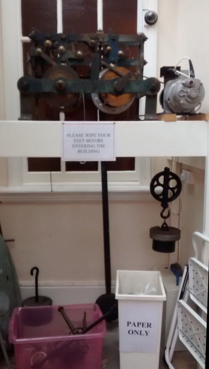

Worst part was probably this tower clock they had temporarily fitted in a storage area close to the workshops. It was so far out of beat it really started getting to me.....Note the placement of the PC box and the adjustment to the floor under the pendulum 😁

Just to follow up what Al said about how ETA names some parts. In French (thus in French speaking Suiss), you usually call the 4th wheel the second wheel, the 3rd wheel the intermediate wheel, the 2nd wheel the central wheel (well, at least when it is in the center of the movement!). For instance, see the very good courses and explanations at horlogerie-suisse.com.
I do not know why and since when French and English ways to call these parts are different. Not a big difference actually, but as Al said good to know when you are ordering parts, and when you read watchmaking stuffs in both languages.
2,219
4,952
Actually, although I make out that ETA seem to move in their own mysterious way with part naming, it is logical for the 2451 above.
For me in a "classical" calibre, the train goes barrel, 2nd wheel, 3rd wheel, 4th wheel, escape wheel. As the 2nd wheel is usually in the centre of the movement, it is often called the centre wheel. The 2nd (centre) wheel turns once per hour and has the cannnon pinion (and to that, the minute hand) attached on the dial side of the plate. The 4th wheel turns once per minute so, if extended through the plate, a subsiduary seconds hand can be directly mounted to it.
In French (thus in French speaking Suiss), you usually call the 4th wheel the second wheel, the 3rd wheel the intermediate wheel, the 2nd wheel the central wheel.
For me, the 4th wheel translation to French is not "second" as in 2nd wheel but, "Second" wheel - what I'm trying to say is that it's not the number 2 wheel in the train, it's the wheel that counts seconds. Underneath here is an Omega 565 extract and it's part 1243. The English is clear and the translation of the Spanish is "Seconds wheel" which makes sense with what I said. French is, obviously, not my first language but, that's how I read it and I'd be interested if you are thinking the same.
Note that, for me, the French translation of part 1240, 3rd wheel, is "average wheel" and the Spanish is "first wheel". Seems like everyone likes to rename into something of their own choosing! Hard for me as a Brit, living and buying parts in Spain, as well as UK and France...
Back to the ETA 2451 above....
What I labelled the "fourth wheel" as in 4th in the train is actually part 227 and for me is the "wheel that sweeps the seconds" and not 2nd wheel. The English description shows that as well.
But this a an old calibre so, when I look at the parts for an ETA 2892-2 which is much more modern, for the same part, the name has changed to "Second (2nd) wheel" in English but the French name is still consistent. I am firmly blaming the French speaking Swiss for generating this confusion😁
Yes, you need to be careful when ordering parts but, for most calibres a parts list with pictures and descriptions is available.
