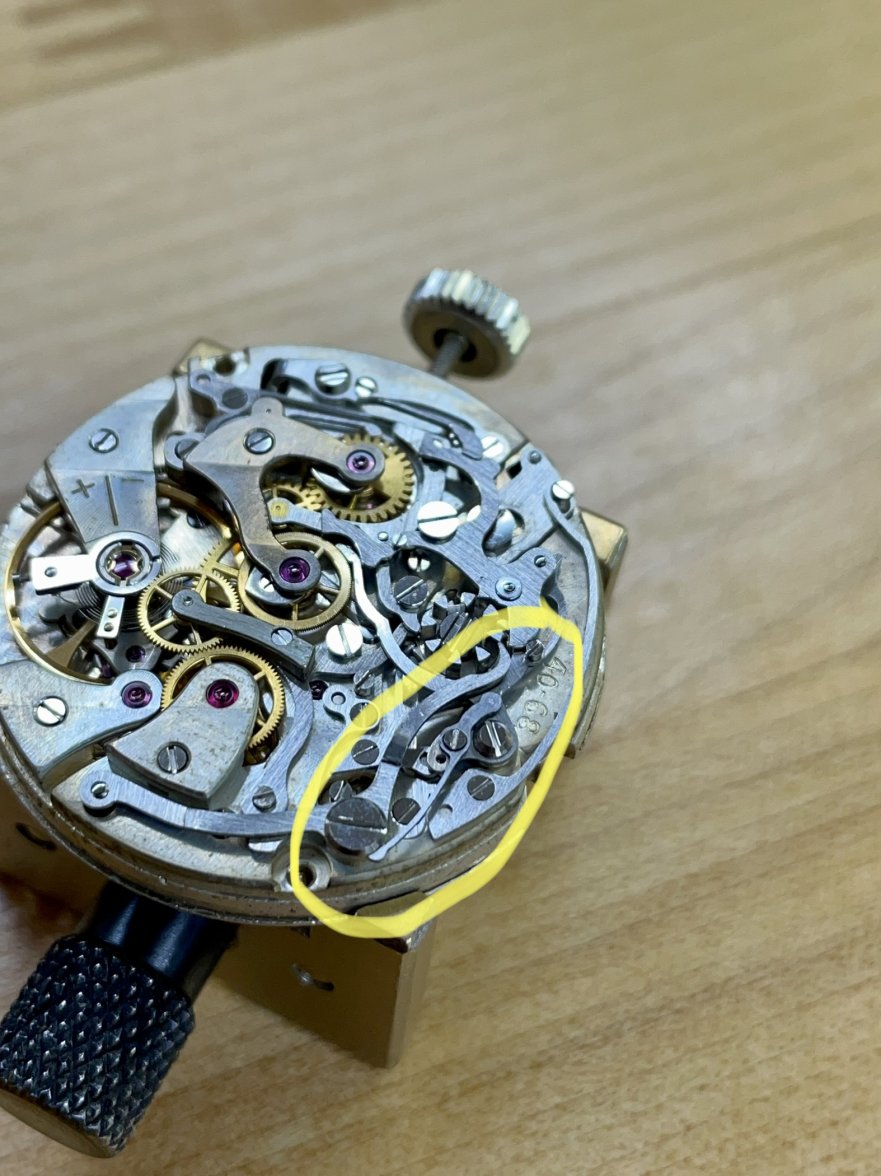

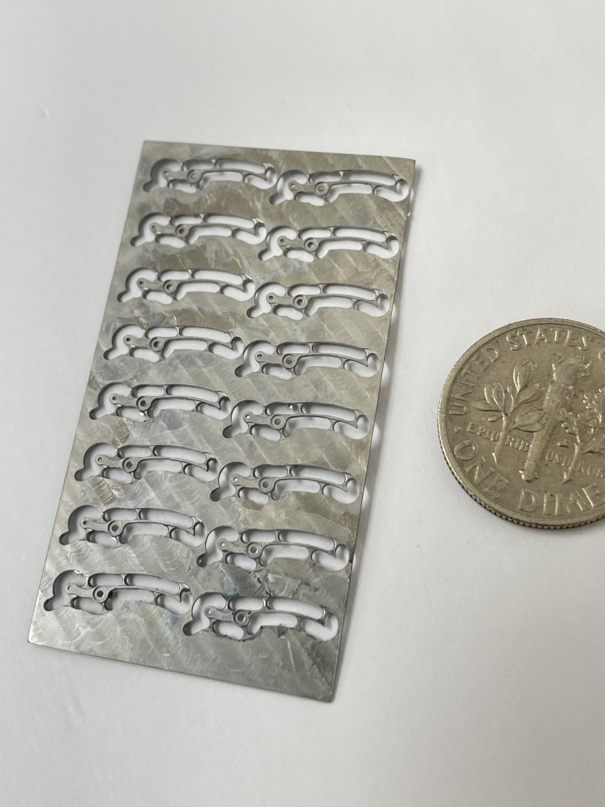

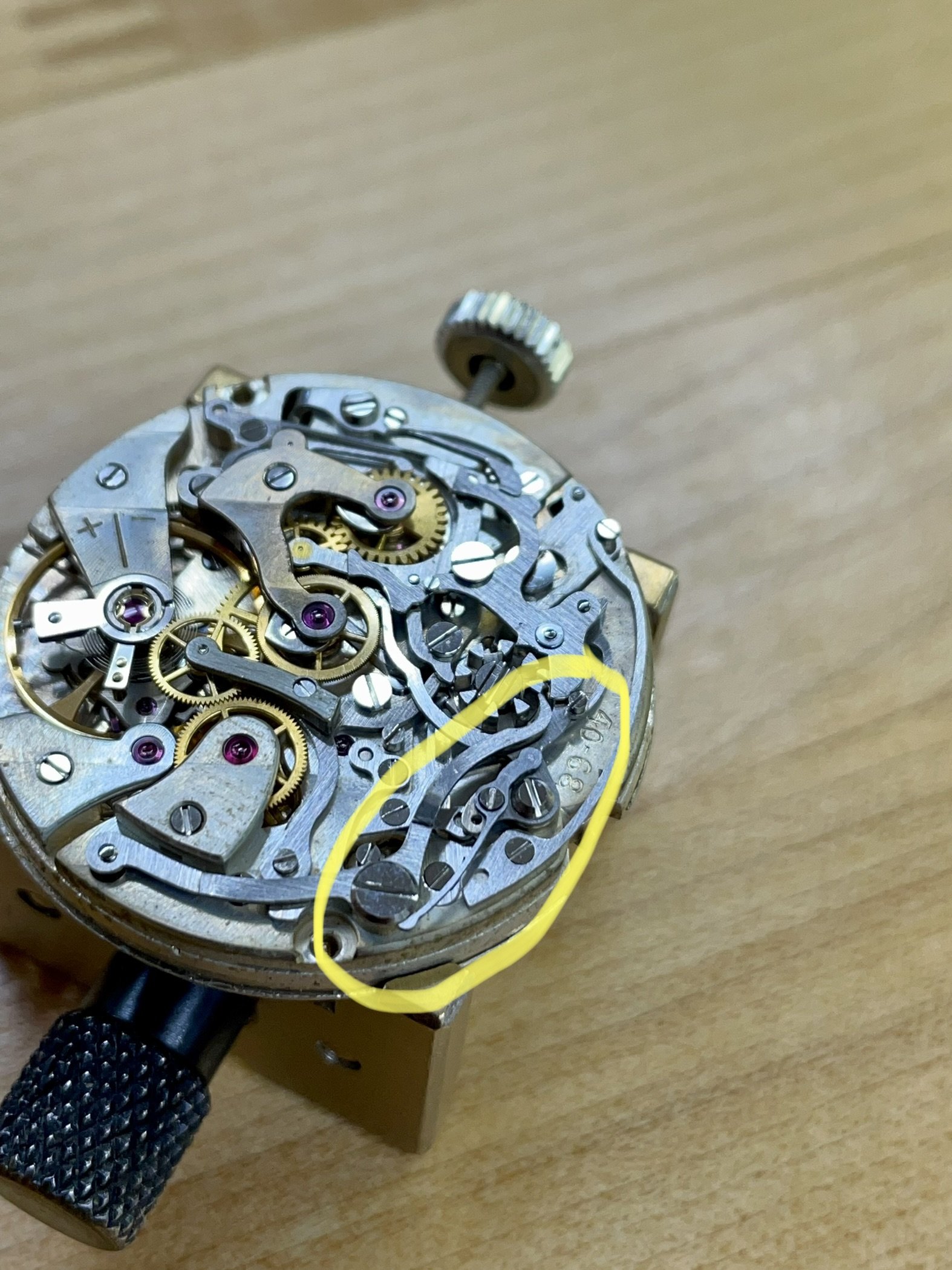

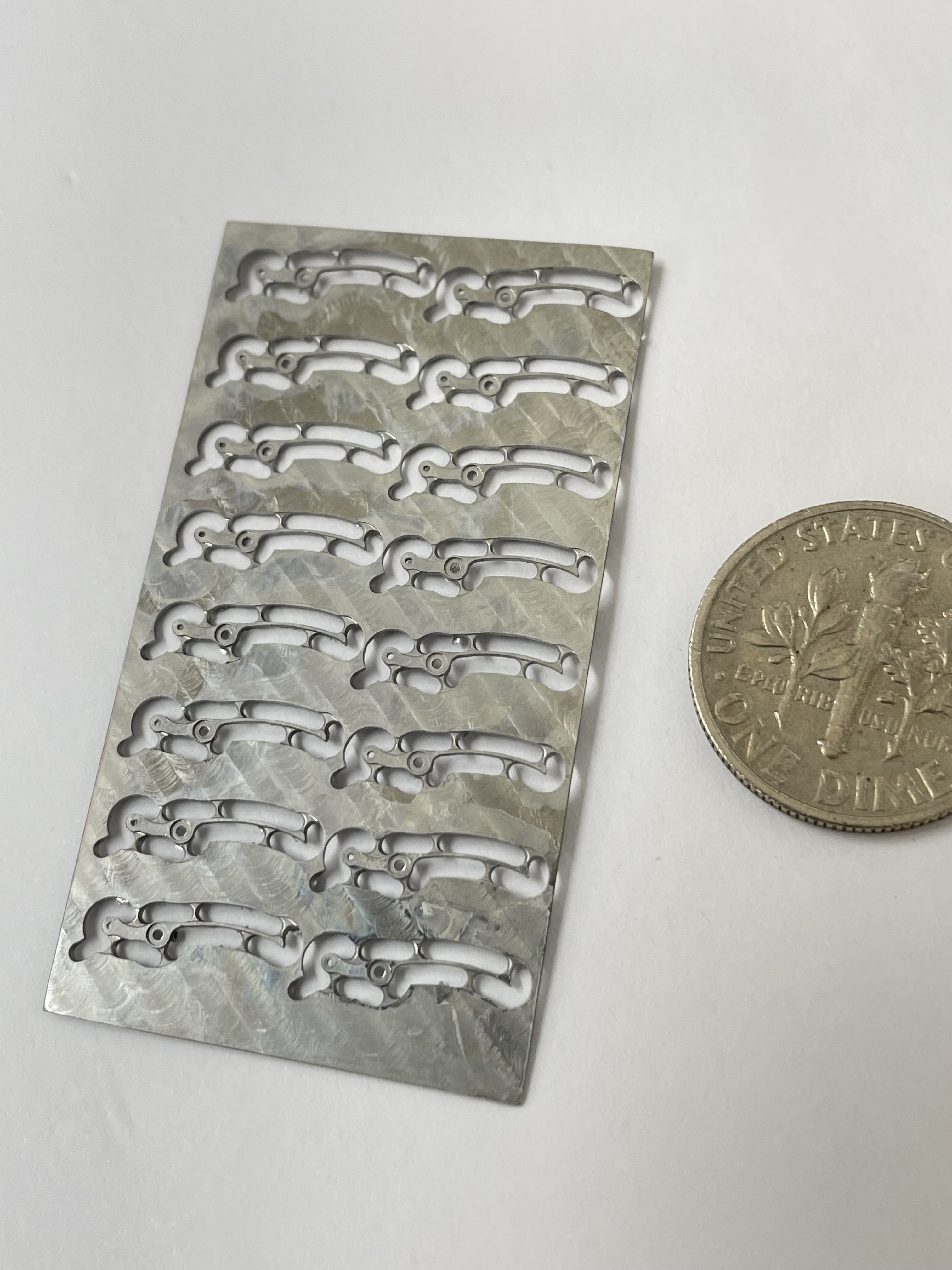

RGM is likely capable of making any part that may be needed.
One of my EP 40-68 movements needed a spring:
And so they made some for stock as well:
They have precision CNC machining capabilities.
Joe
Someone else was using the Laser CNC last night. I was working on some pipe organ stuff anyway. I think there is going to be a lot more of this sort of thing. Especially if the fiber laser can cut springs. Which the you tube videos seem to imply.
Some of the members of the Horological tours in the 1990s were into tools. They would search fleamarkets and other places for old equipment. My mentor who had a tool and die shop would also look for tools at auctions. He let me play with a Belcor[sp] cam driven screw cutting machine. My own CNC he got at auction and sold it too me for his cost. The other part was to prove a point. That one can not punch a button and have parts come out the other end. It was a lathe mill combo with an aftermarket CNC. I removed the mill and the CNC. Sometime I want to set it up as a standalone machine, with a high speed spindle.
I still suspect that some of the NOS valjoux parts and others are made on the old equipment, where it is used to produce short runs.
CNC is no panacea. It takes just as long to enter it into the computer as it would to make it with a saw and file or grinding wheel. The difference is that once entered, the master file can be used to make any copies.
This tech can also cut out the cams. Which when used with a pantograph engraver, can be used to mill out all sorts of stuff. It is interesting how my 30 year old AI textbook has whole sections on checking cam profiles for faults. Cams are a lot faster than steppers or servos. Some of these machines work faster than the eye can see.

We can easily derail this thread or get off on what I would feel is an interesting tangential subject, so I'll keep this short and hopefully it will be treated as a brief aside.
I have an SX2 mini mill and a 7x16 mini lathe and many of the accessories or accoutrements that go with them costing a multiple of the cost of the machines. I learned to run milling machines, lathes and shapers when I was in High School 馃槈
I have not personally graduated to CNC, but there are many more complex operations that can be done with CNC than can not be done quickly or easily - or at all - using old-school methods. Flat, largely two-dimensional stuff without complexity in the third dimension, no problem.
I'm an amateur. It would probably take me a full work-day to make one of those springs for the EP40-68 and it would be crude by comparison.
With CNC, once the drawing is done on CAD for one spring and laid out as a sheet of 16 and then converted to CAM and set to run on the computer that controls the CNC mill for the sheet of 16 springs, I bet the cutting operation itself took 15 minutes. Then an end mill was set to run over the surface and create the tool marks we call a C么te de Gen猫ve finish.
CNC = Computer Numerical Control - Instructions to the hardware for multiple operations
CAD = Computer Aided Design - The 3D drawing program
CAM = Computer Aided Manufacturing - converts the 3D drawing into an instruction set for the cutting machine

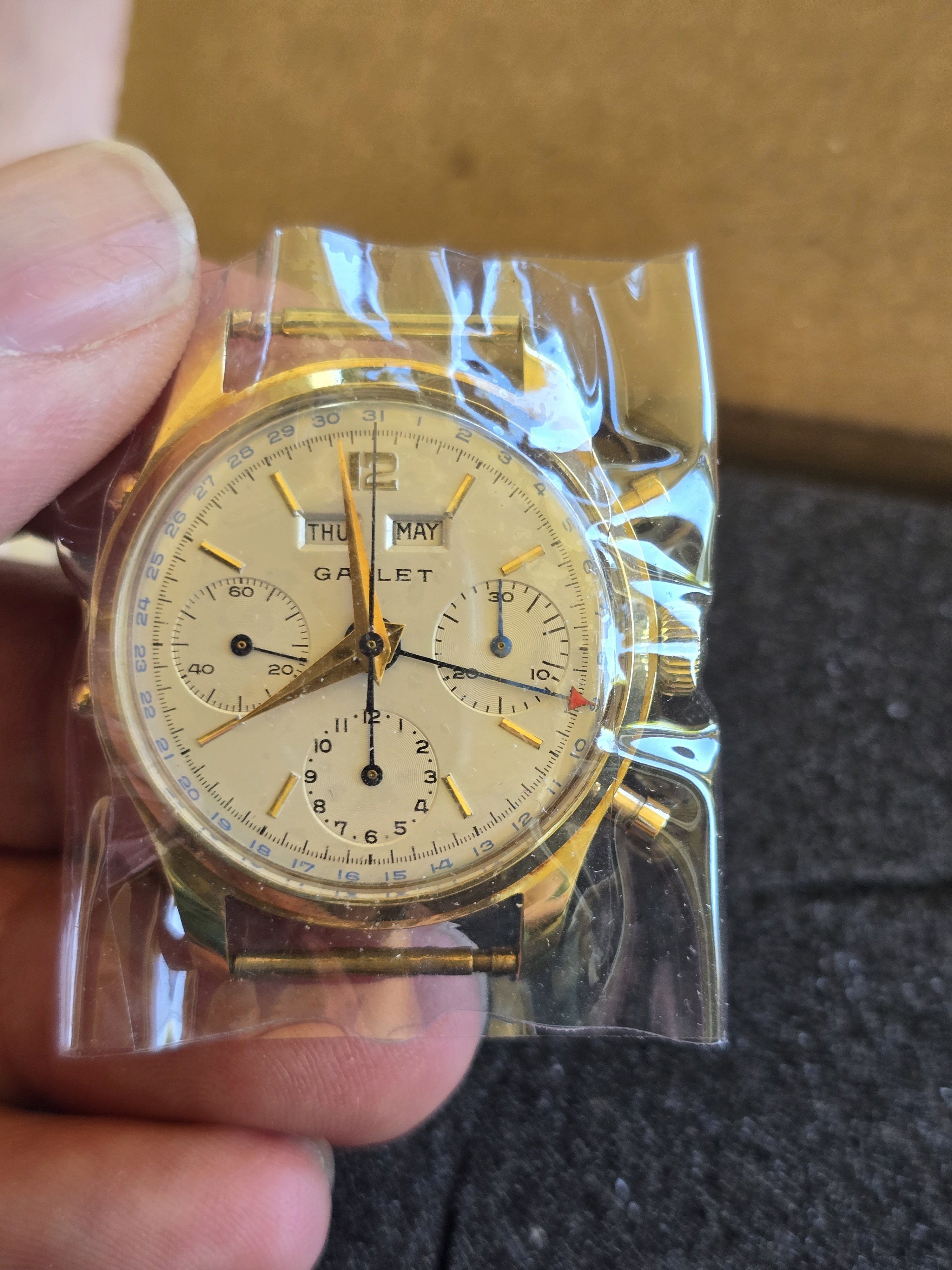

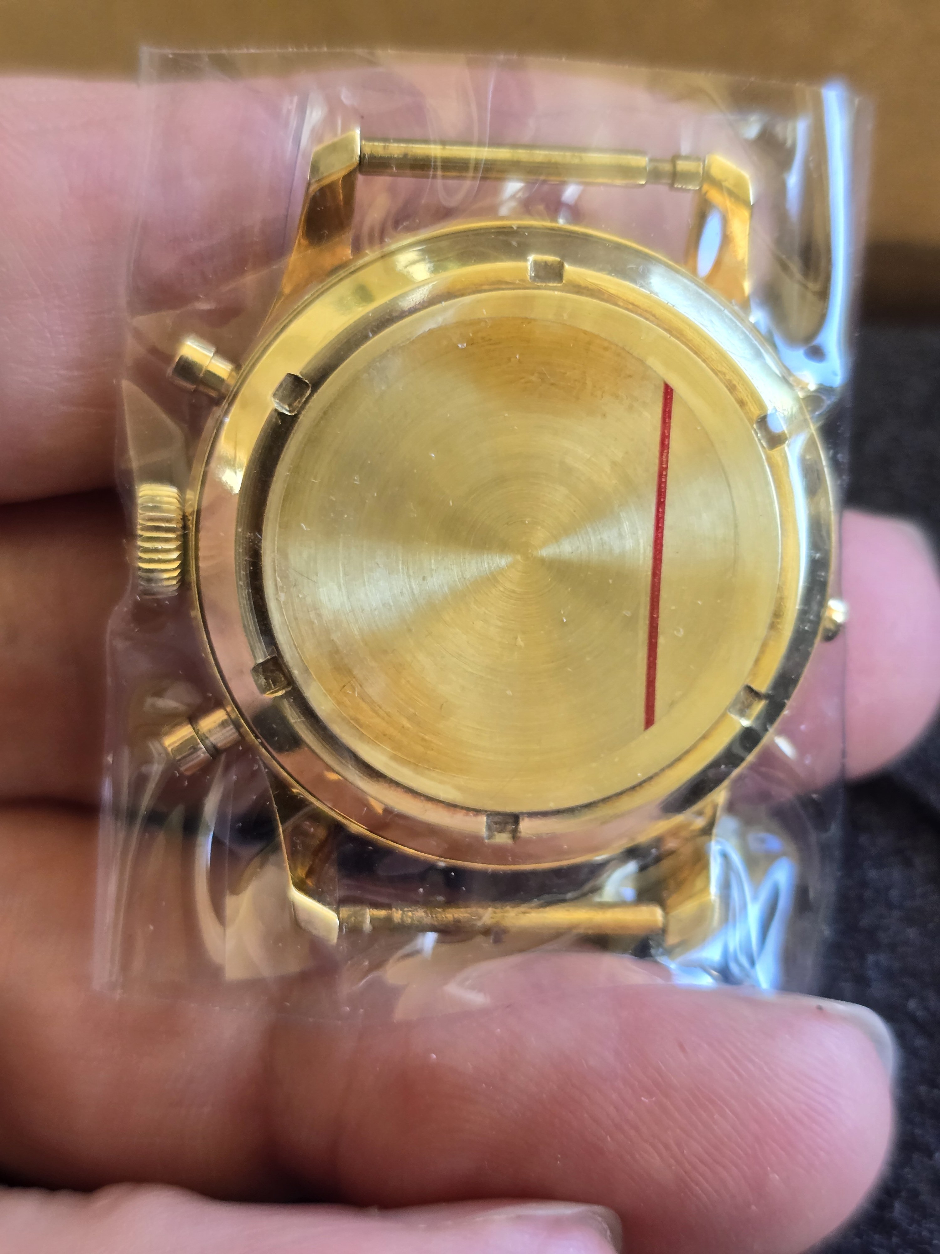

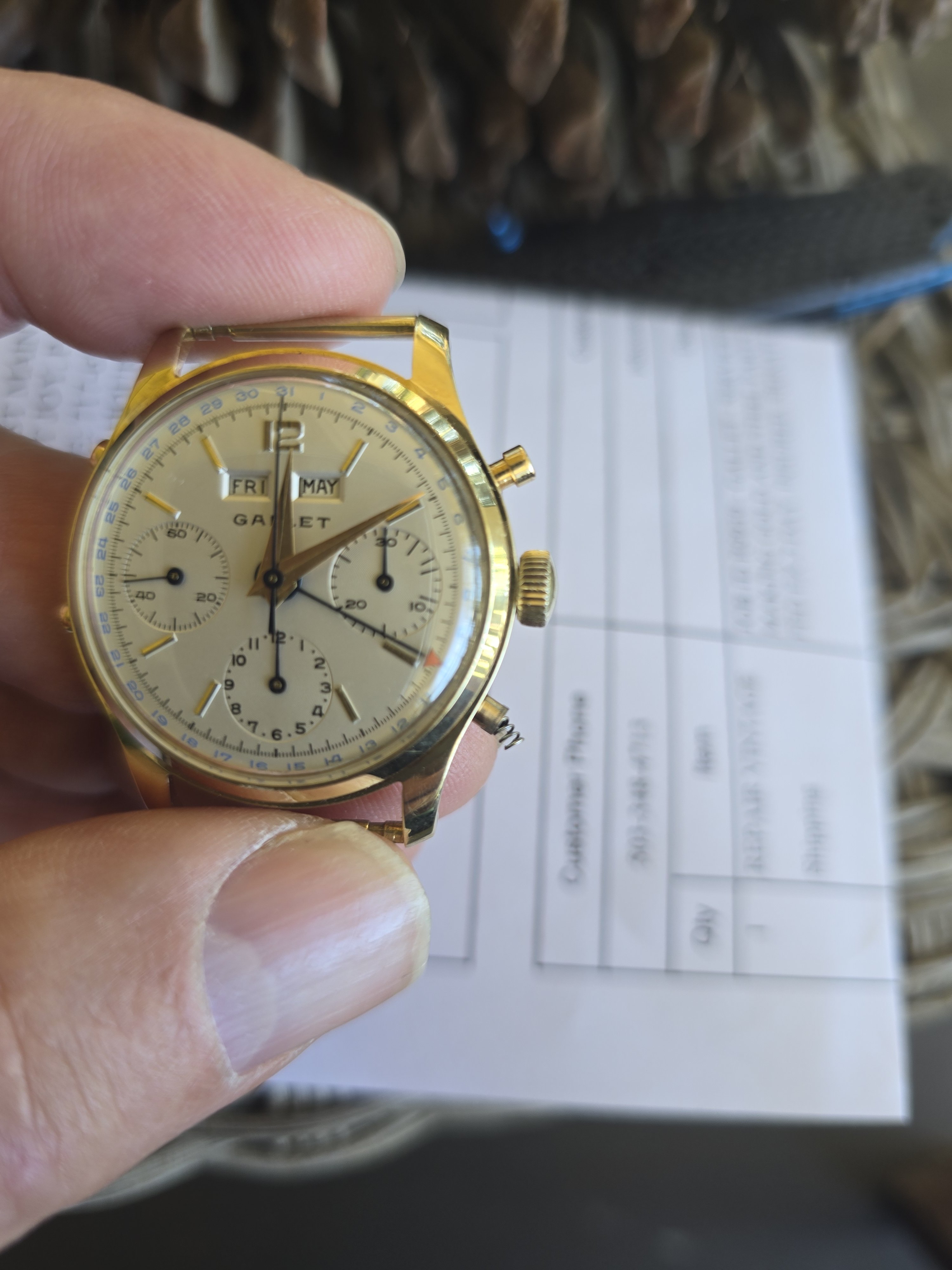

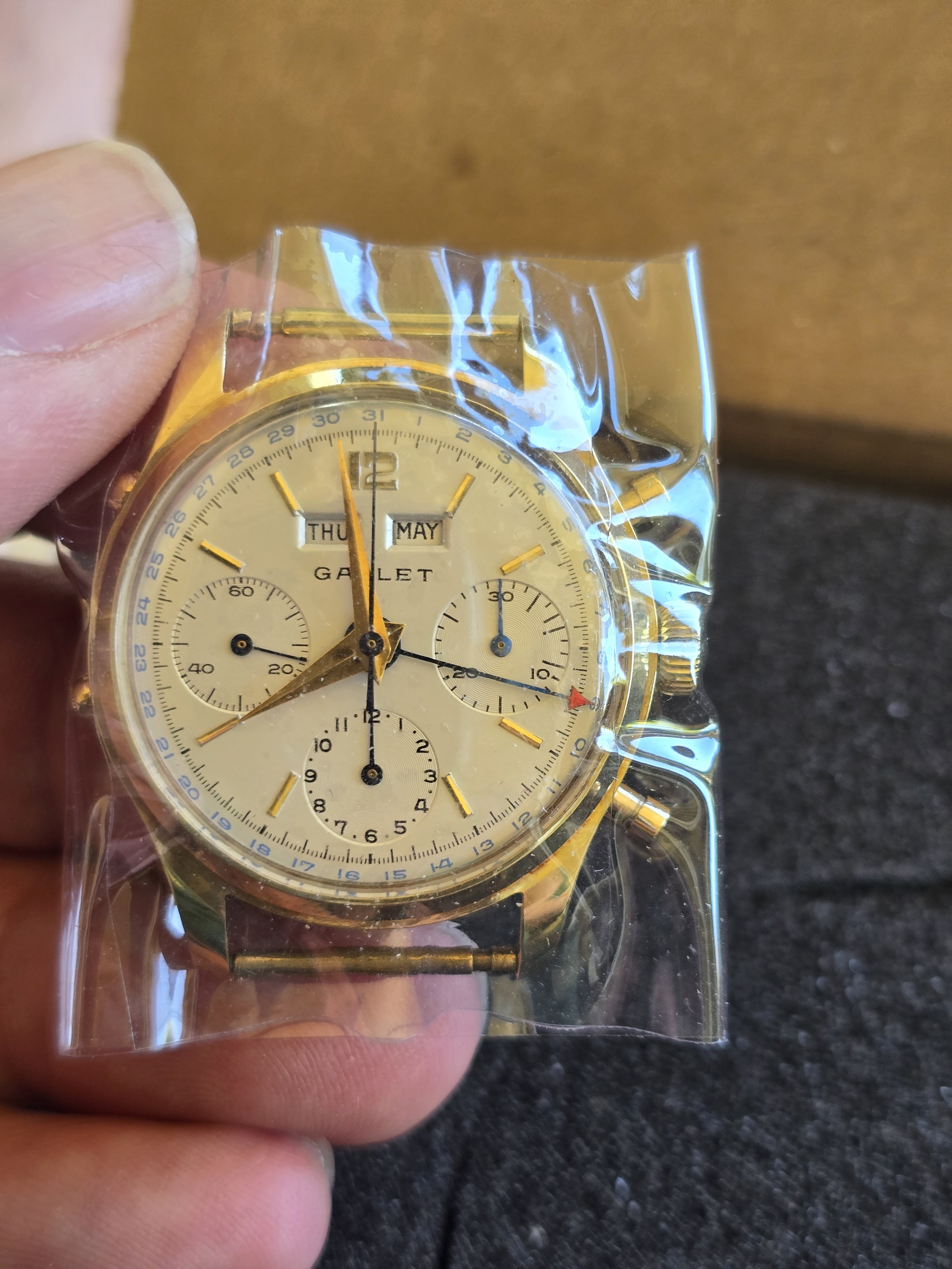

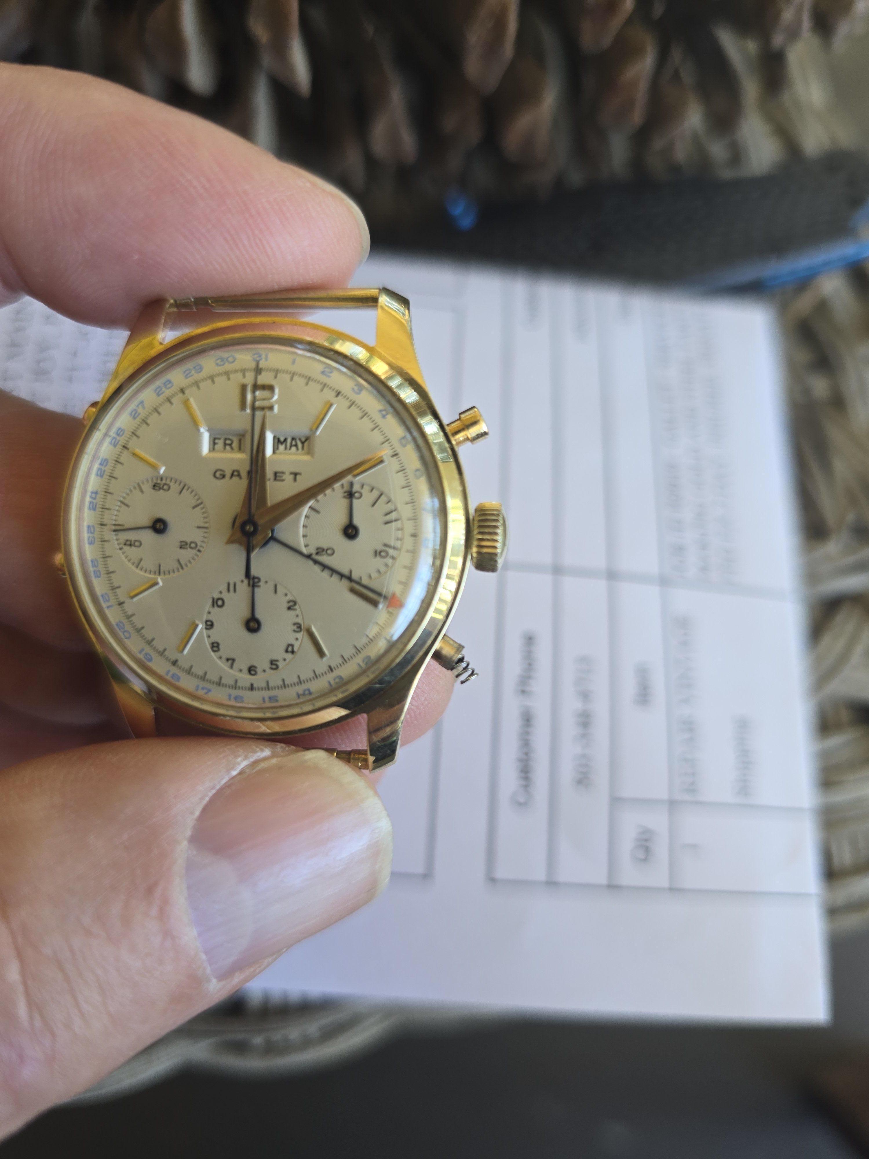

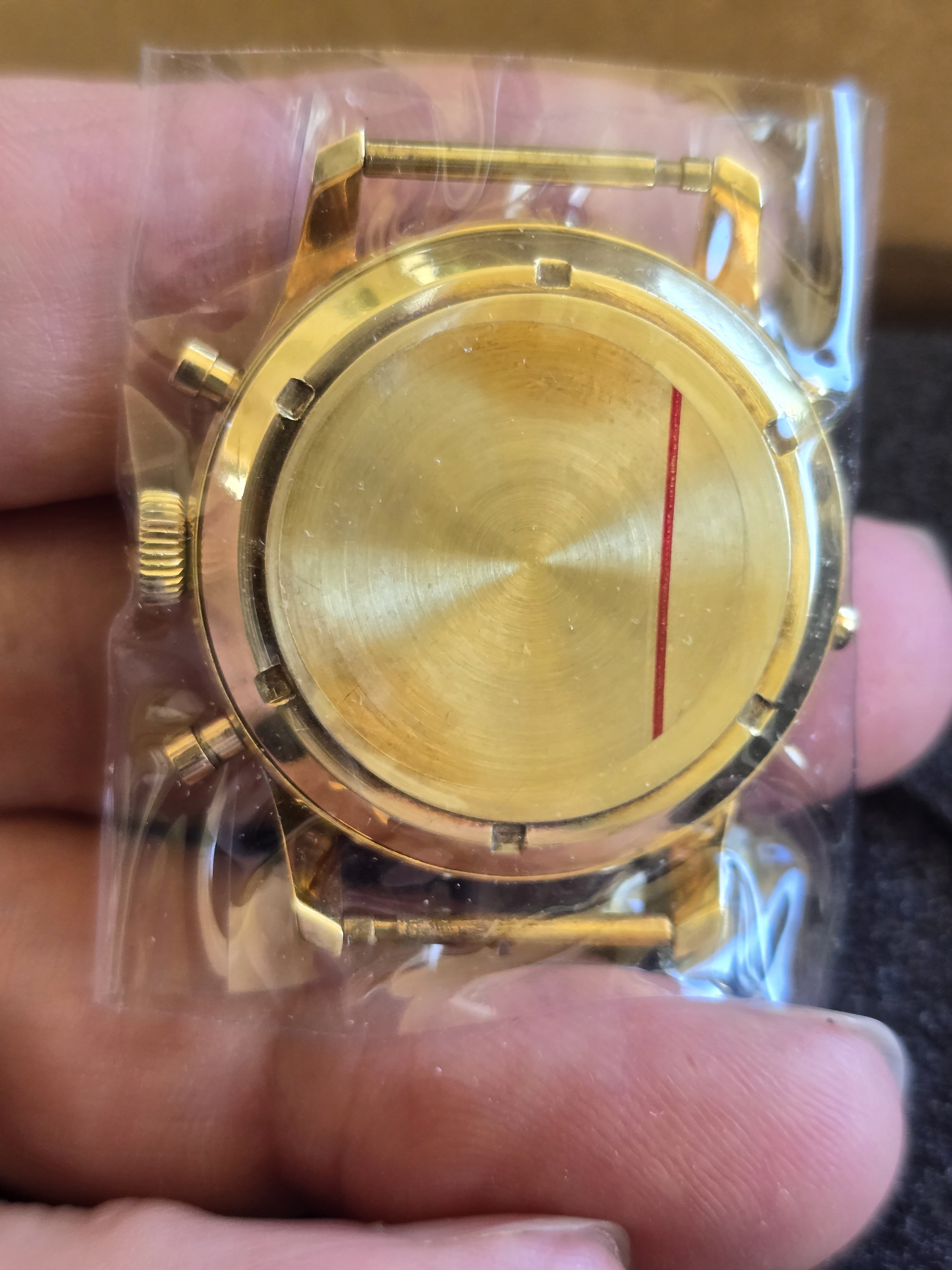

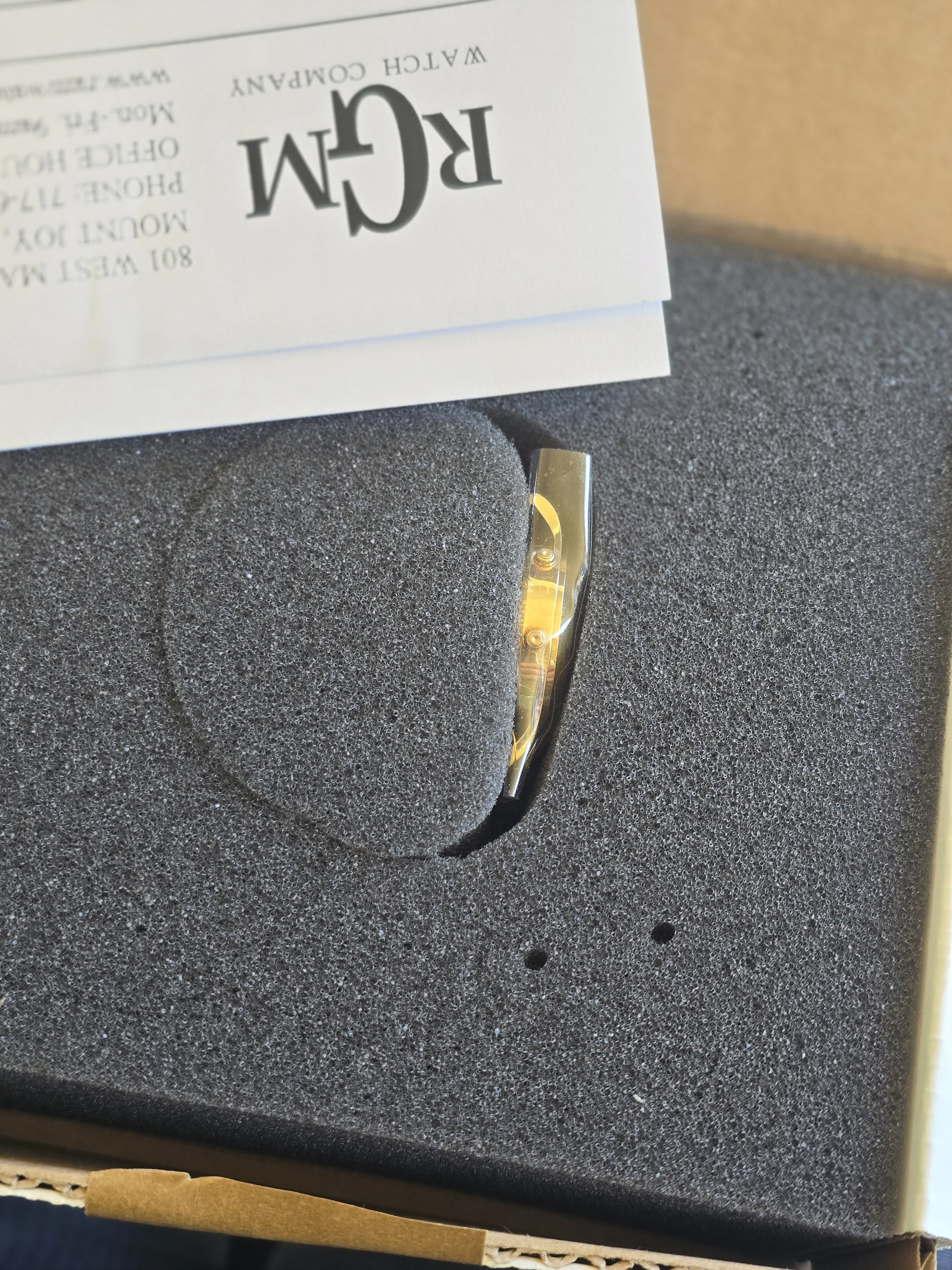

Watch arrive back from service today! Almost 1 year at RGM and 1 1/2 years at Gallet, close to 3 years after first buying it.
Looks beautiful 馃グ
Look closely at the last picture.
馃が 馃が 馃が

Bummer - I could see it was not right in the first photo...

I would expect that the watch will now run well; keep good time, and perform on the timegrapher like a newly serviced watch.
That said, I'd be disappointed as well seeing the pusher having come apart, probably in shipping as a result being barely attached and not carefully examined before shipping.
RGM will make good on something like that and I'd expect they'd put it ahead of the queue and you'll have it back in a couple of weeks at most.
Give them a buzz on the phone and let them know what's what.

I guess the first call would be to RGM and find out what the hell they did. They should not be happy with the quality of ther work. Any QC?
532
3,231
Damn...::facepalm1::
RGM will stand by their work and they won't charge for a recall.
I have used them now a number of times and I did have two minor issues.
Example: On one chronograph, when the central minute hand was between the 5 o'clock and 6 o'clock position and the chrono was running, the chrono seconds hand would catch on the minute hand. This suggests a QC miss. They did not let the watch run for a long enough time with the chrono running as well to see the issue and correct it before it was returned to me. It's an understandable oversight and something easy for a watchmaker to correct. It was an inconvenience, but not a tragedy.
On another occasion, a chronograph would very occasionally have have a little creep on the 12-hour sub-register. It took weeks for the issue to show up.
I was a little disappointed, but neither of these are shoot-to-kill offenses.
