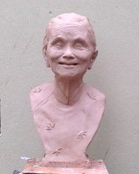

I had a friend here in Portland who sadly died early. He was a sculptor who was also a Vietnam vet. His job was as a translator so he studied Vietnamese in the Army. He kept at it and over the years traveled regularly to Vietnam. A few years before he passed, he helped start a foundry in Vietnam, which is still successful. His plan was to take sculptors to Vietnam where we would stay in a nice hotel, eat great food, and get a sculpture cast in bronze. I was looking forward to it after retiring but he passed away a few months before I could retire.

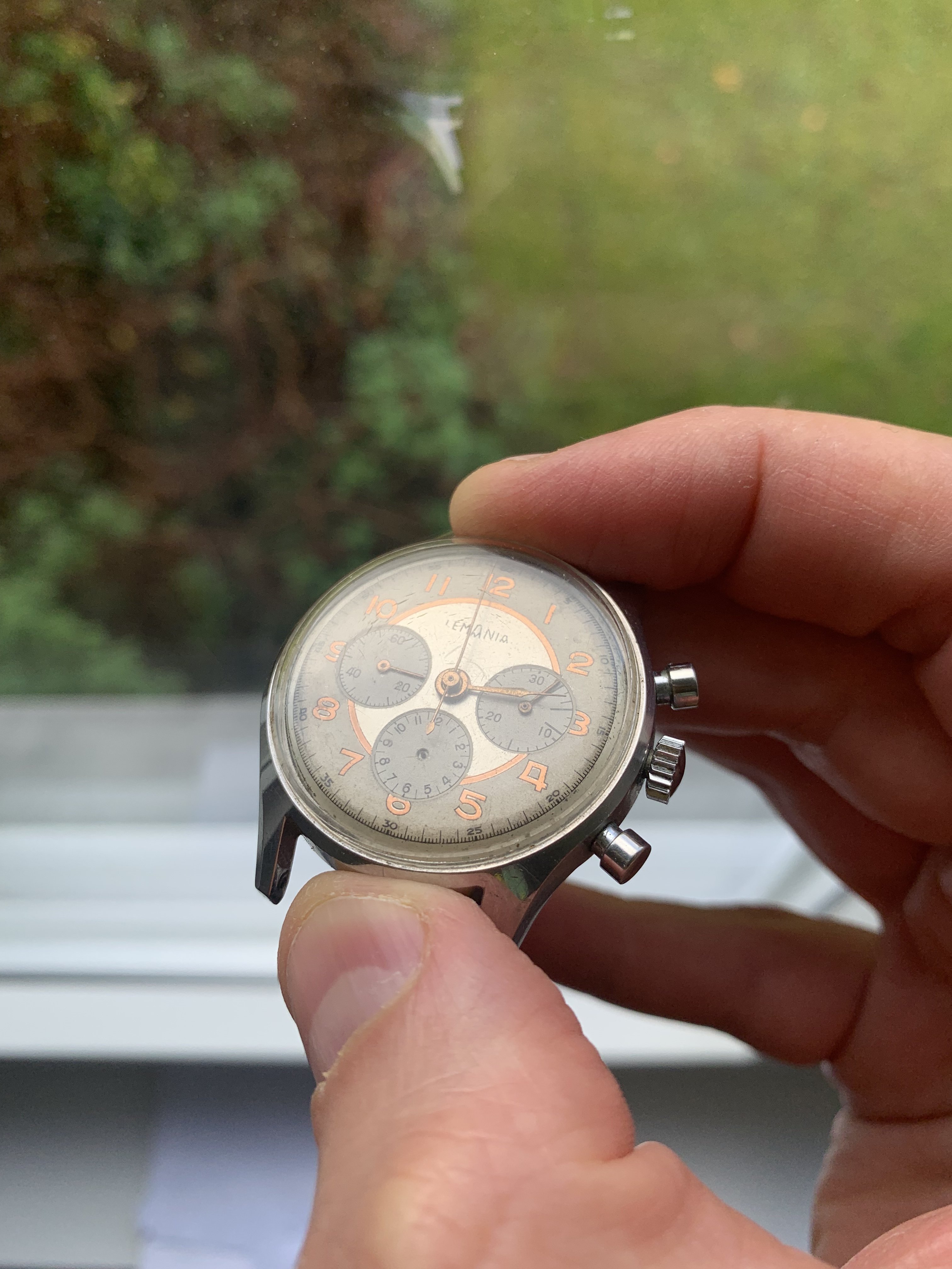

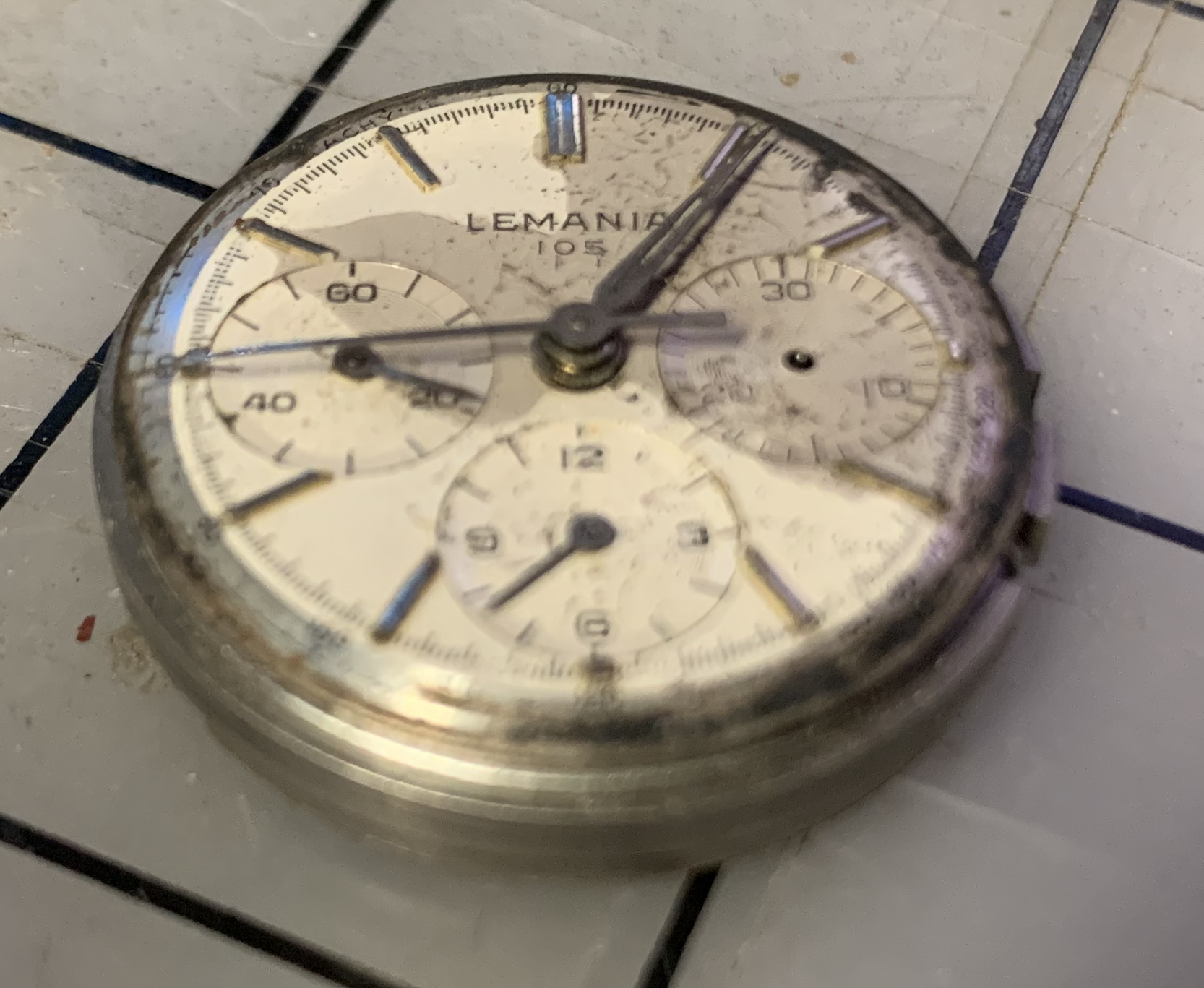

Ive probably got more chance of transforming into a luscious and lovely lady then finding the two missing hands for this recently acquired project …
2,994
4,750
Well at least you have a case for yours.
... and a decent dial, and an hour hand.
even if I had the hour hand, it snapped off the hub.
Actually the dial does not bother me. In person it has less contrast. A camera lens with better depth of field would also help ...

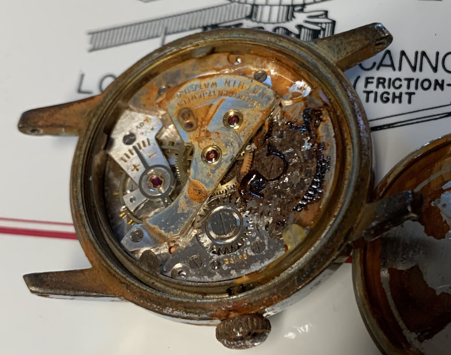

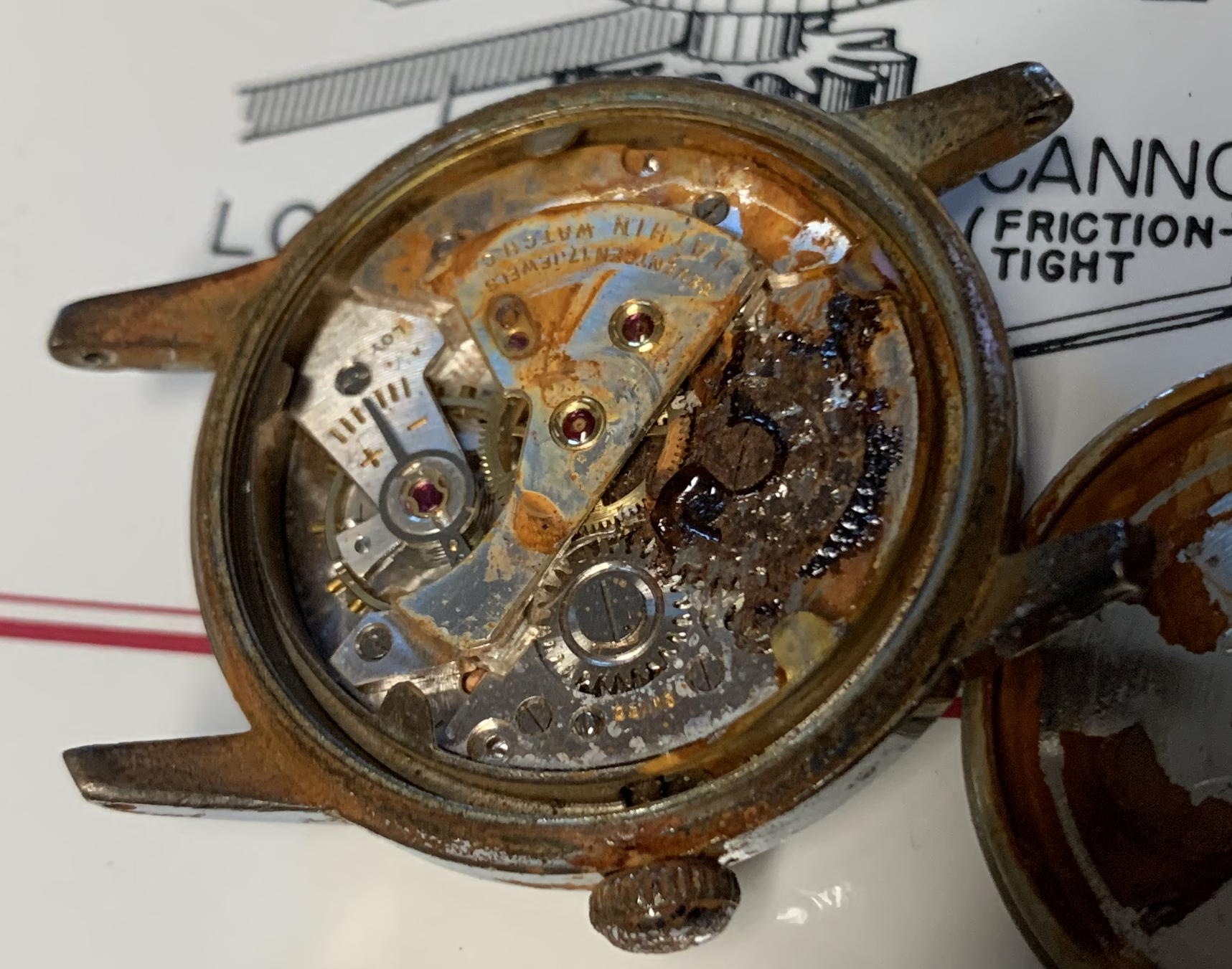

Just arrived. May not be as impossible as it looks. Good balance and can set the hands. I have more spare parts like the winding wheel. Will see what overnight in Evap-O-Rust does.
For 10 bucks plus that again for S&H not a bad deal. Balance and jewels are worth twice that.

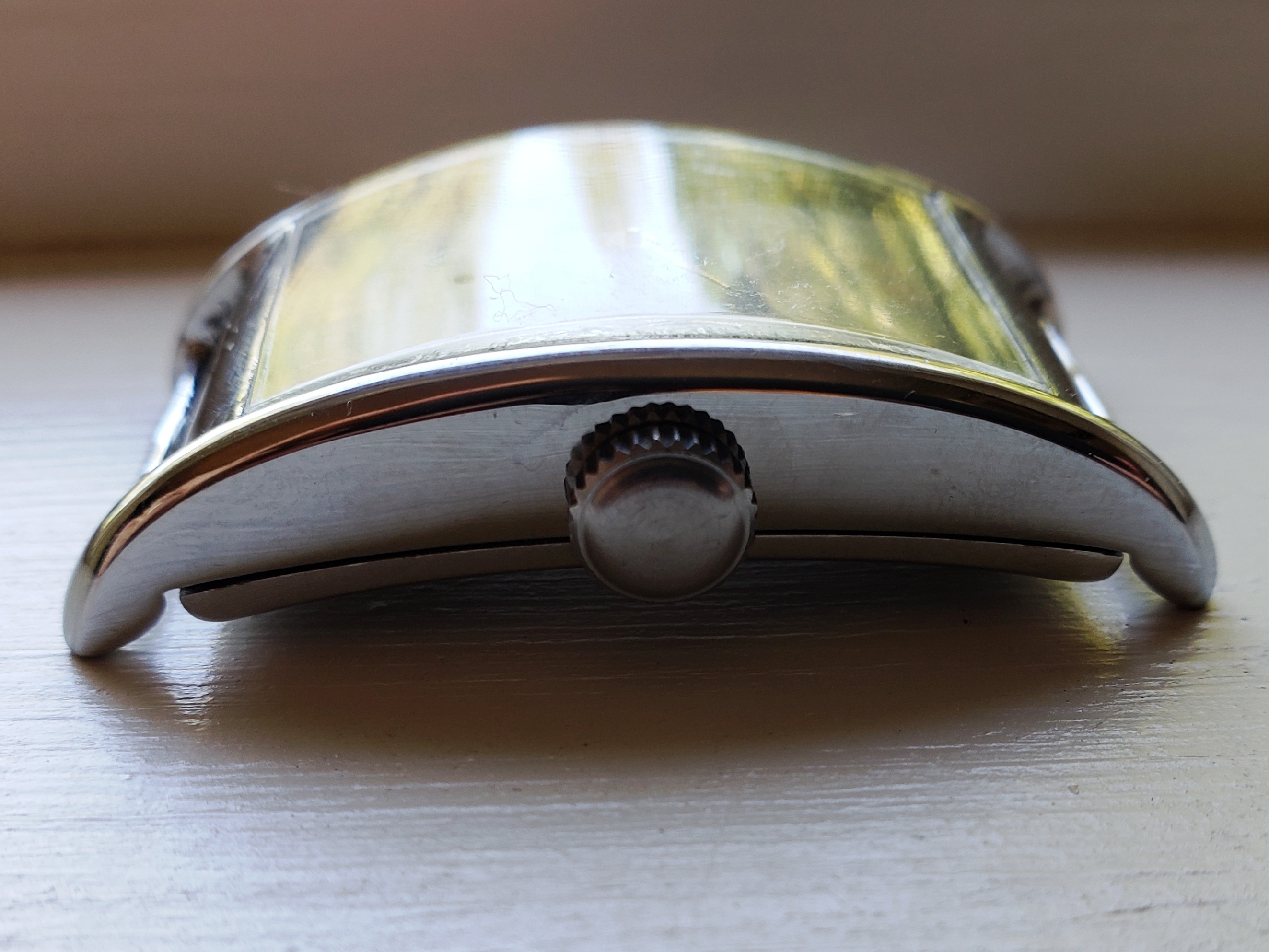

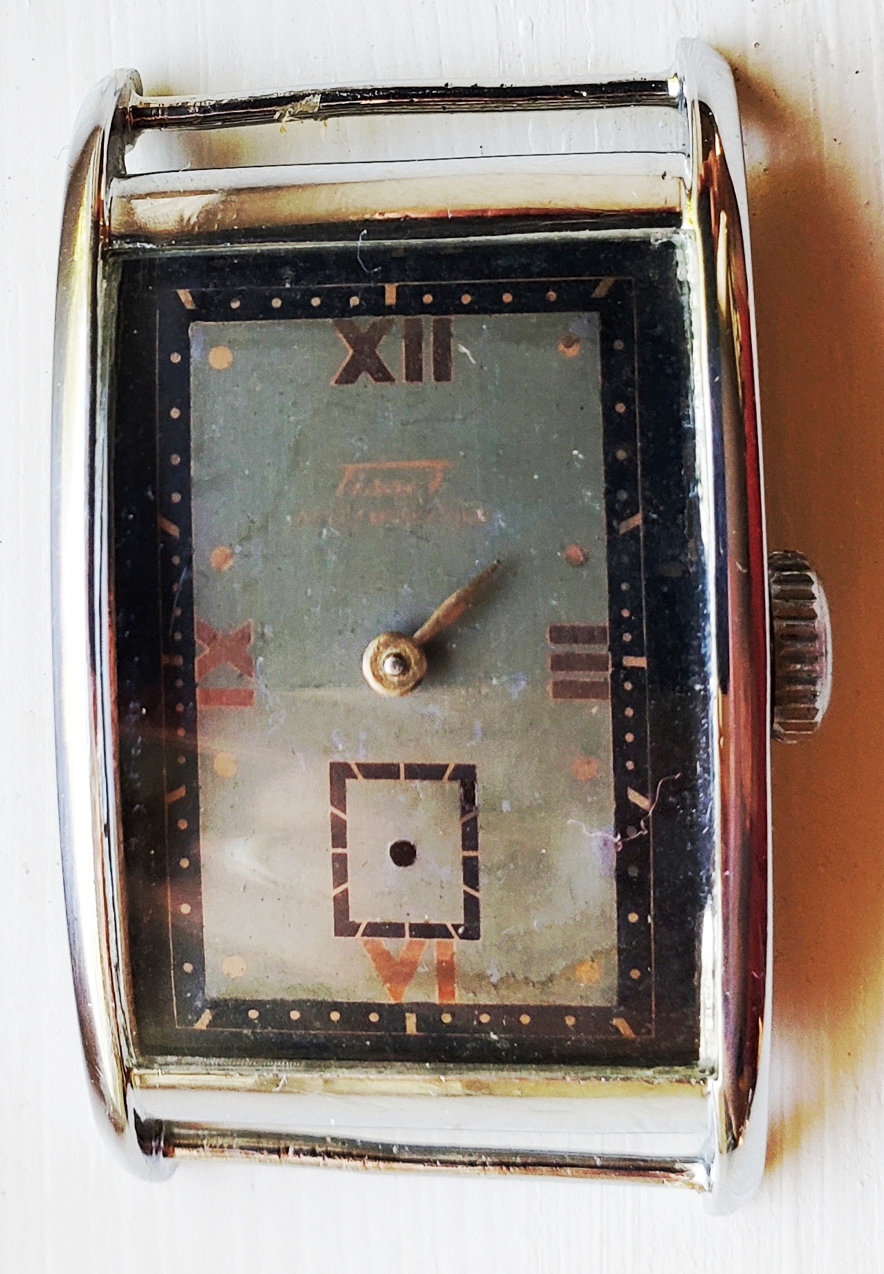

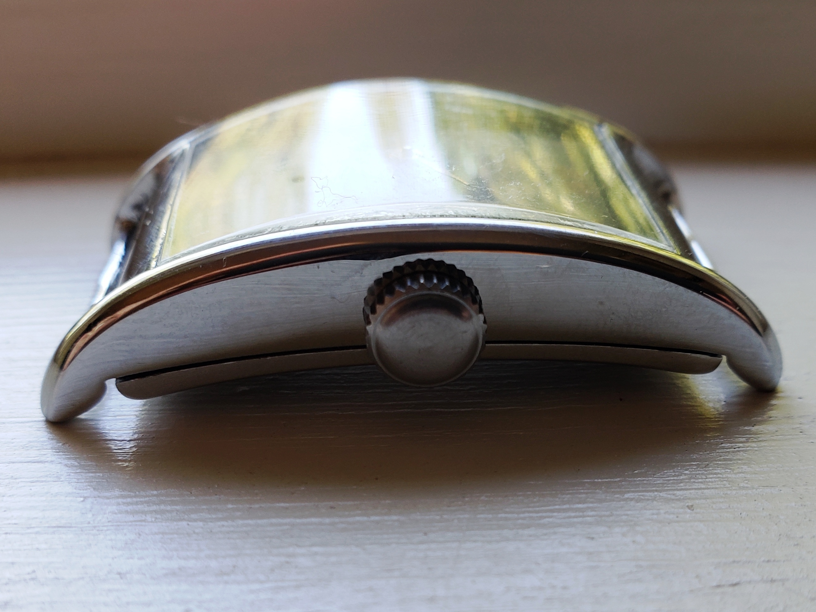

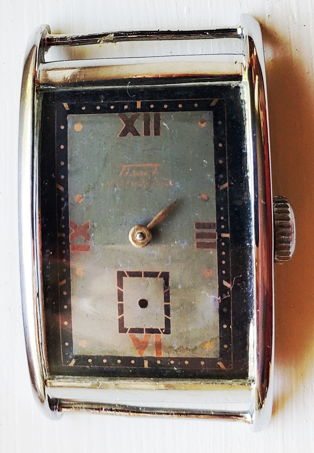

Many years ago I bought a art-deco tank project in a huge curvex case that needs a set of impossible-to-find blued leaf hands (0.6 x 8mm, 1.20 x 6mm):
13,919
54,108
Tissot can’t help you?
That watch dates to about 1940 and while sympathetic, they have no parts. I might get lucky one day with some old Bestfit hands. In the meantime that watch sits in my watchbox mocking me mercilessly, reminding me to never again buy a project watch.

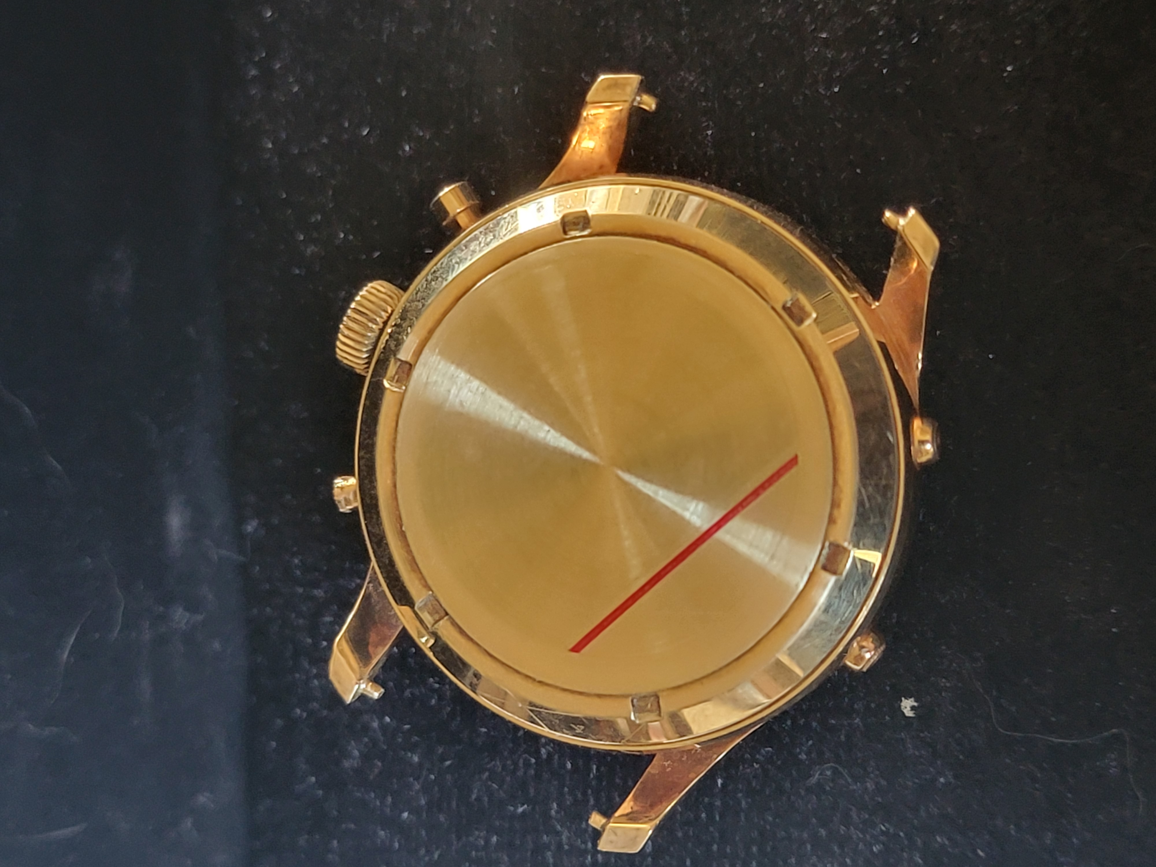

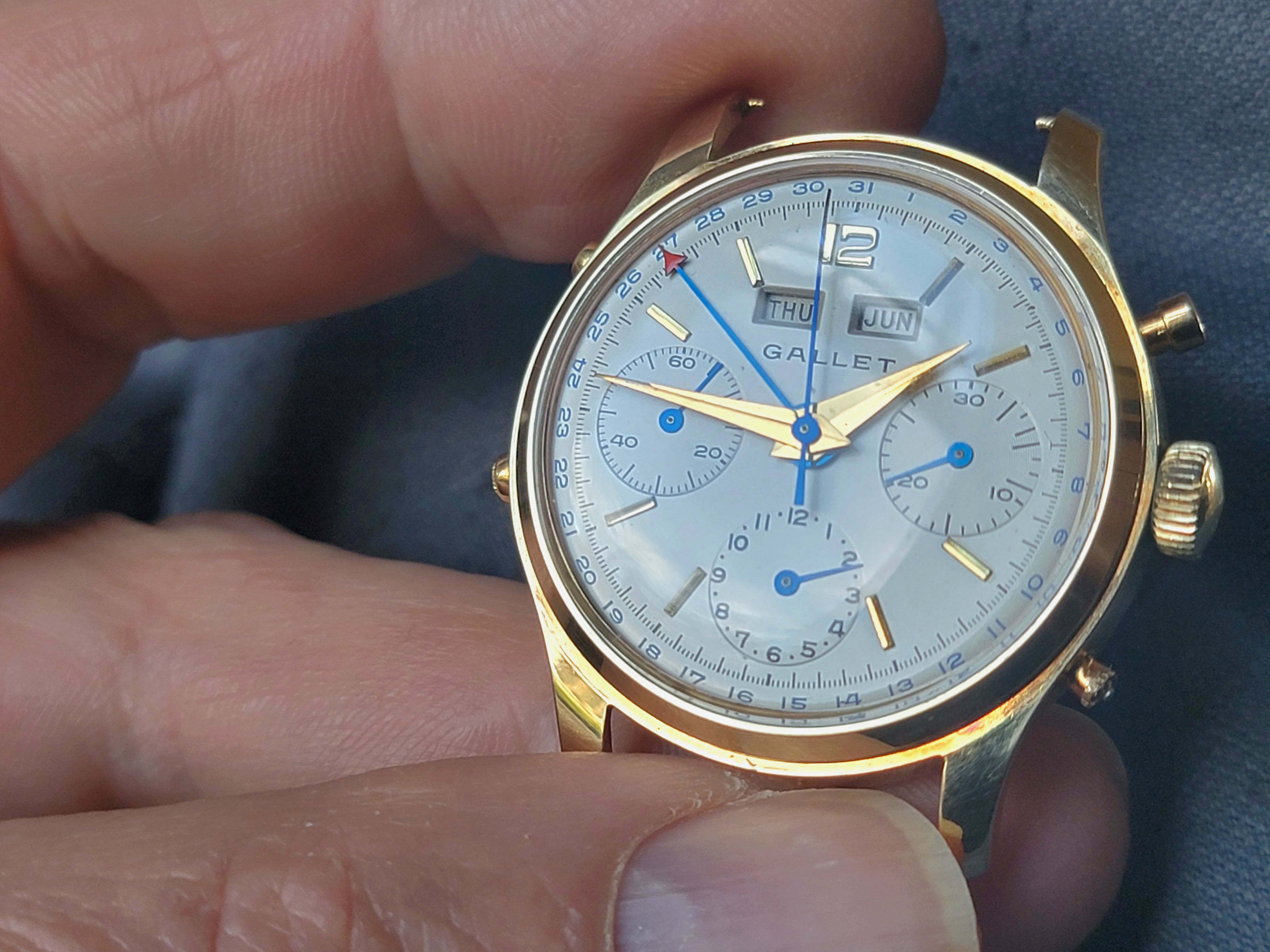

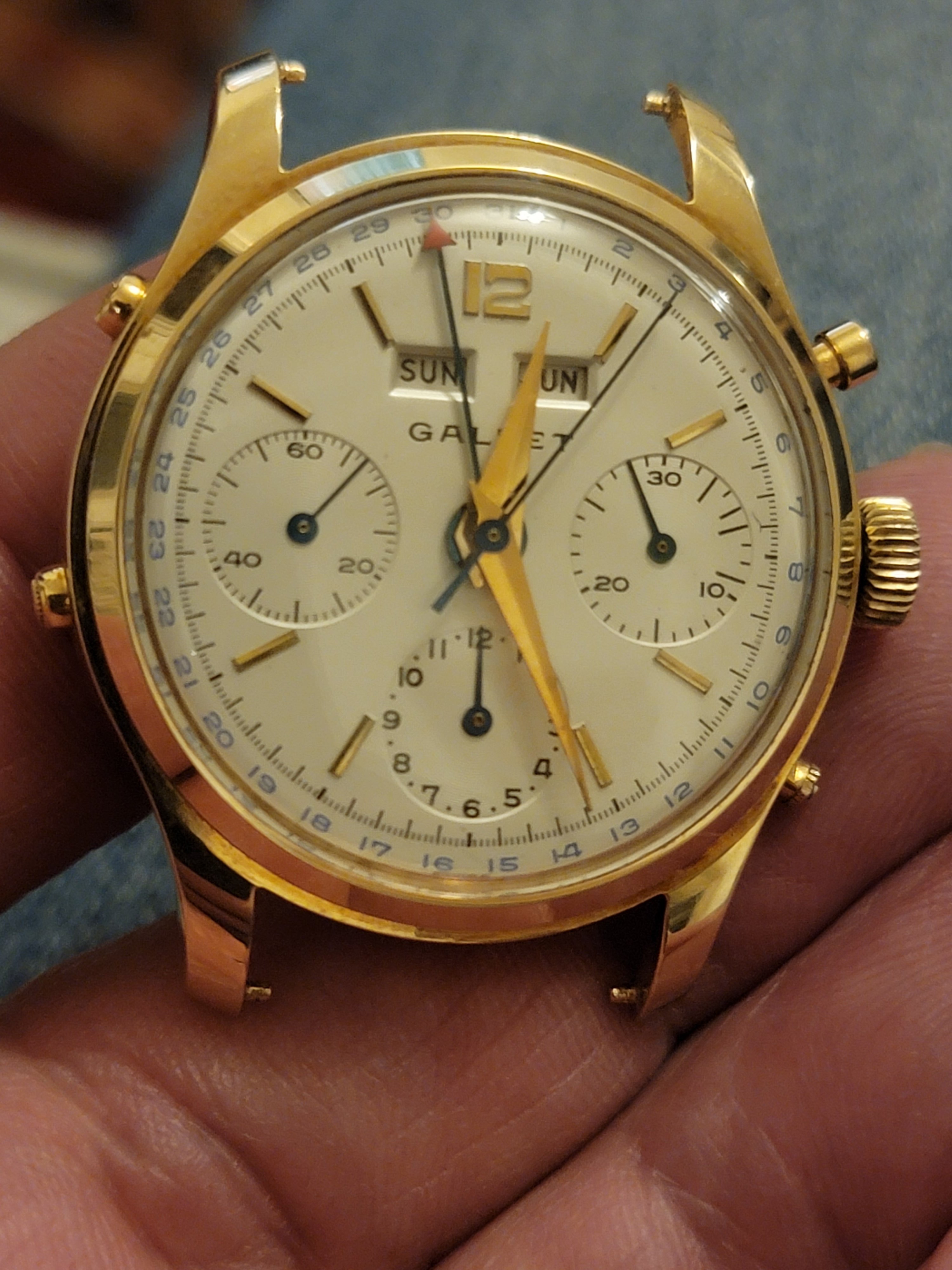

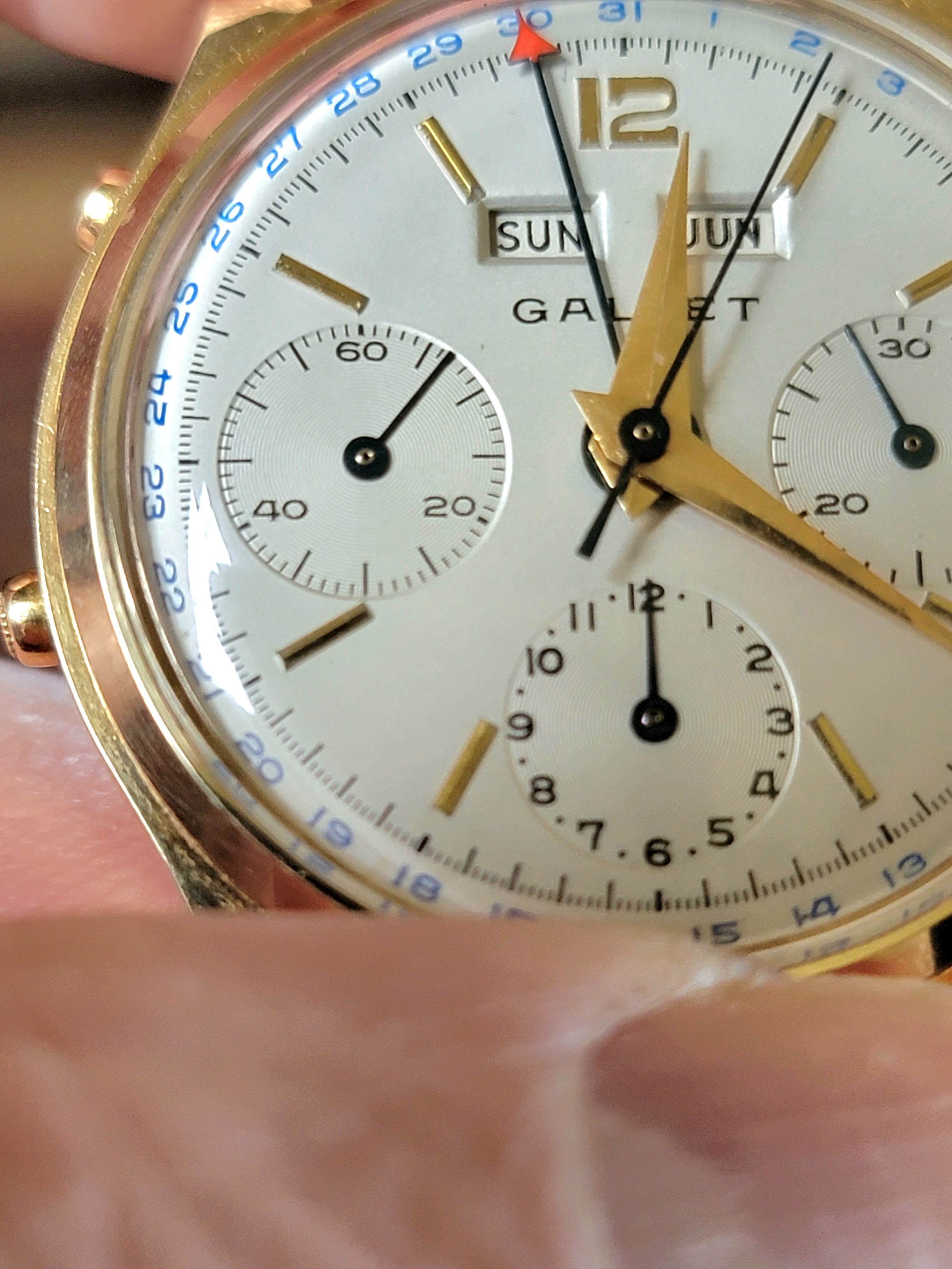

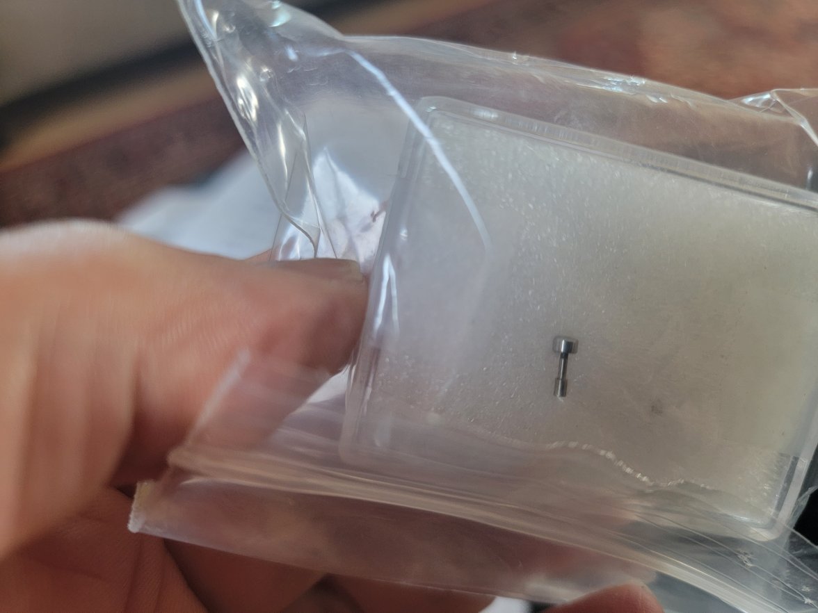

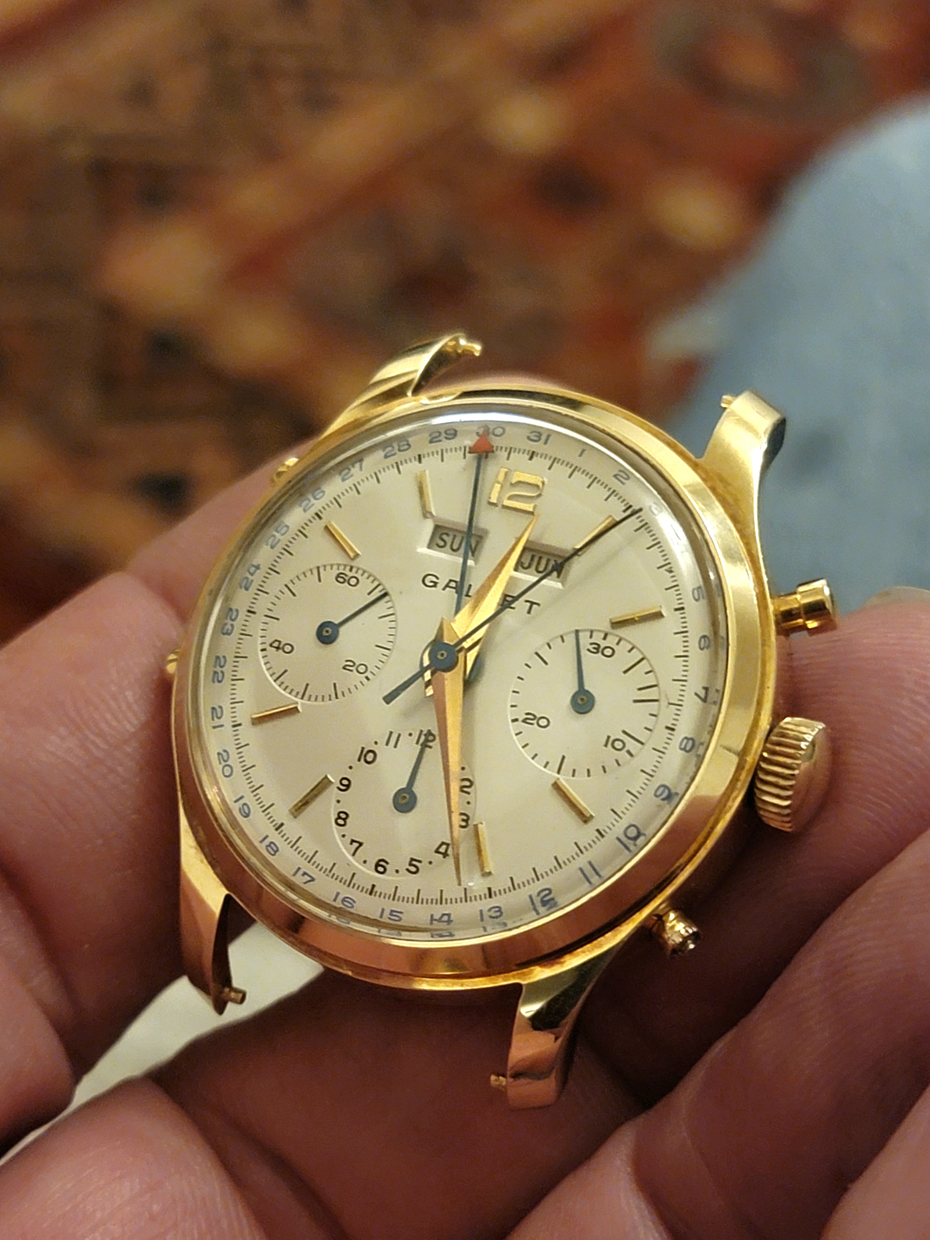

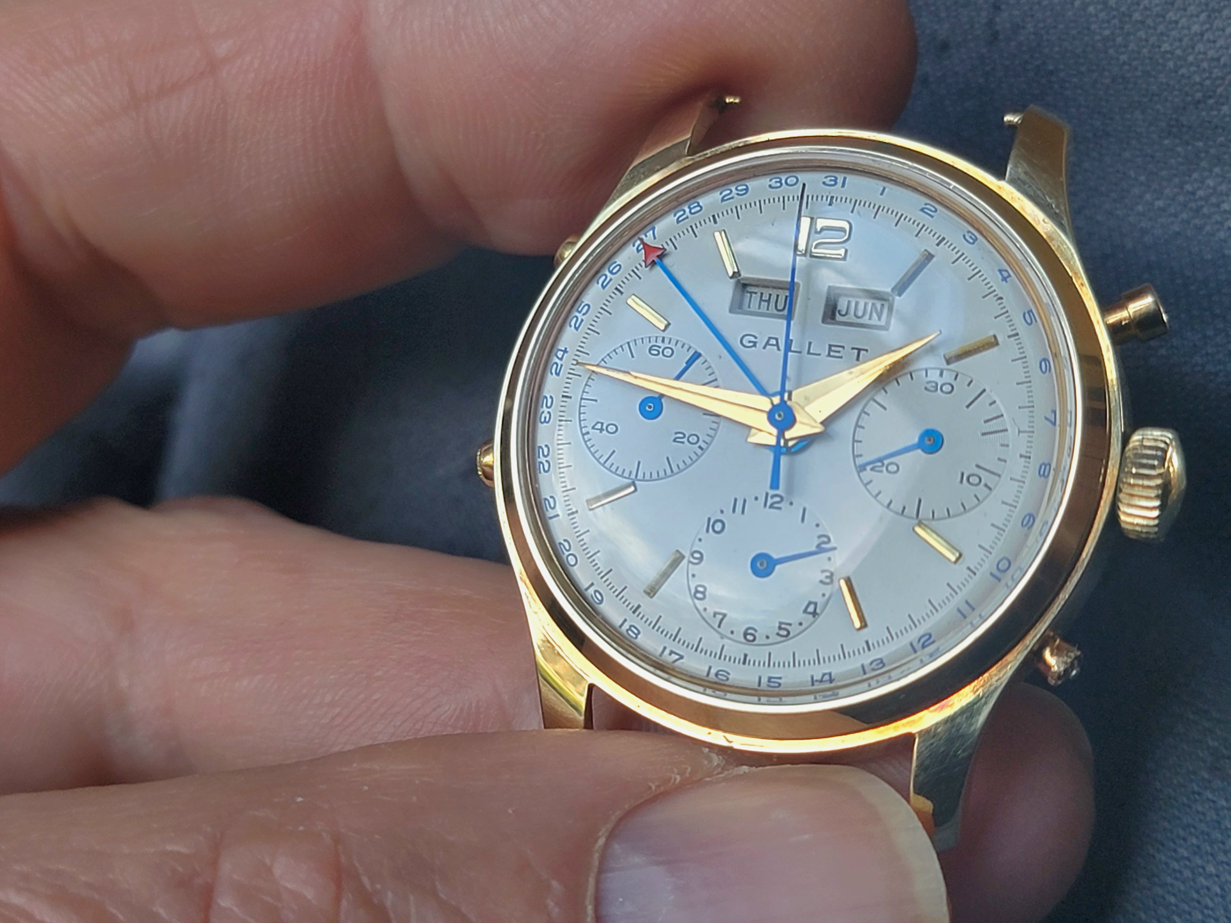

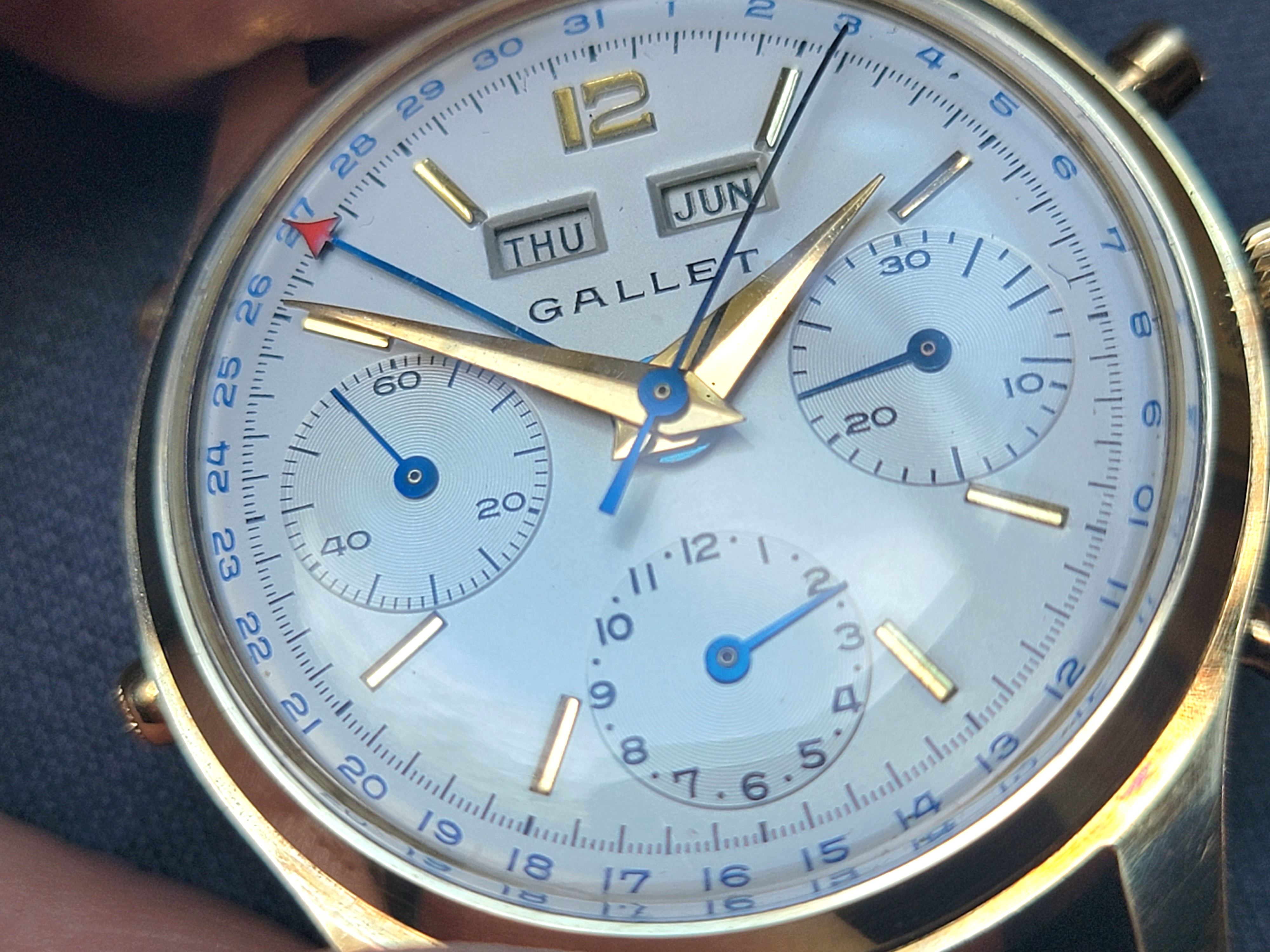

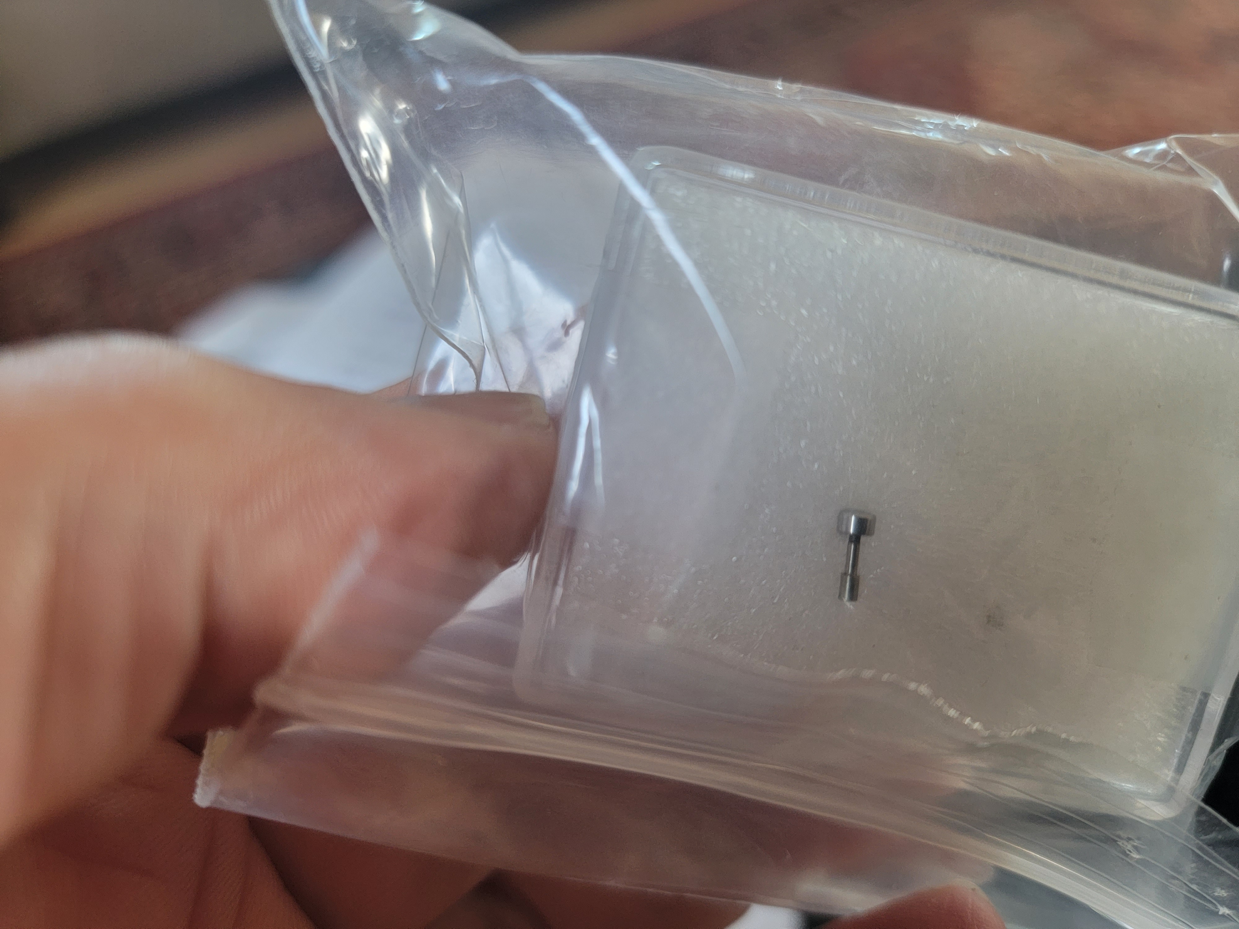

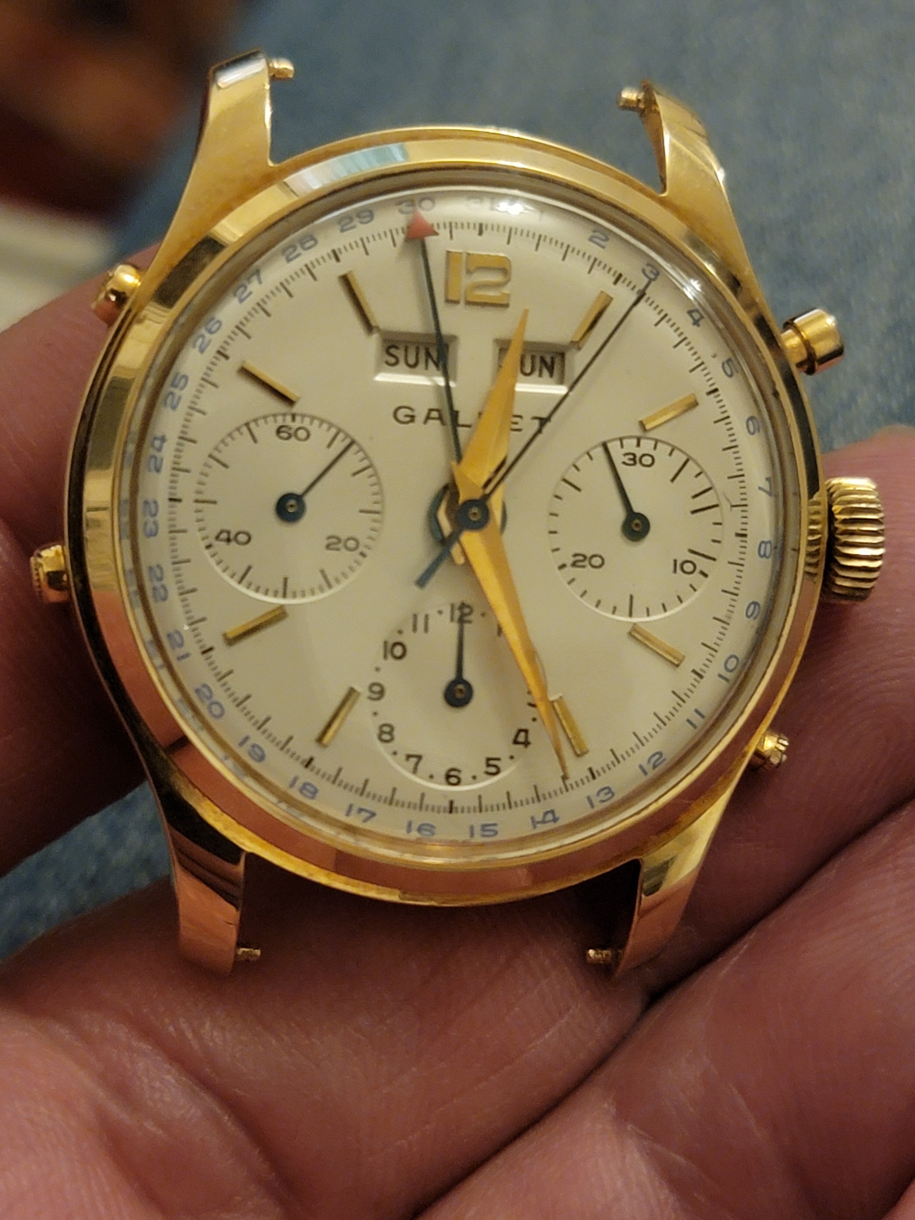

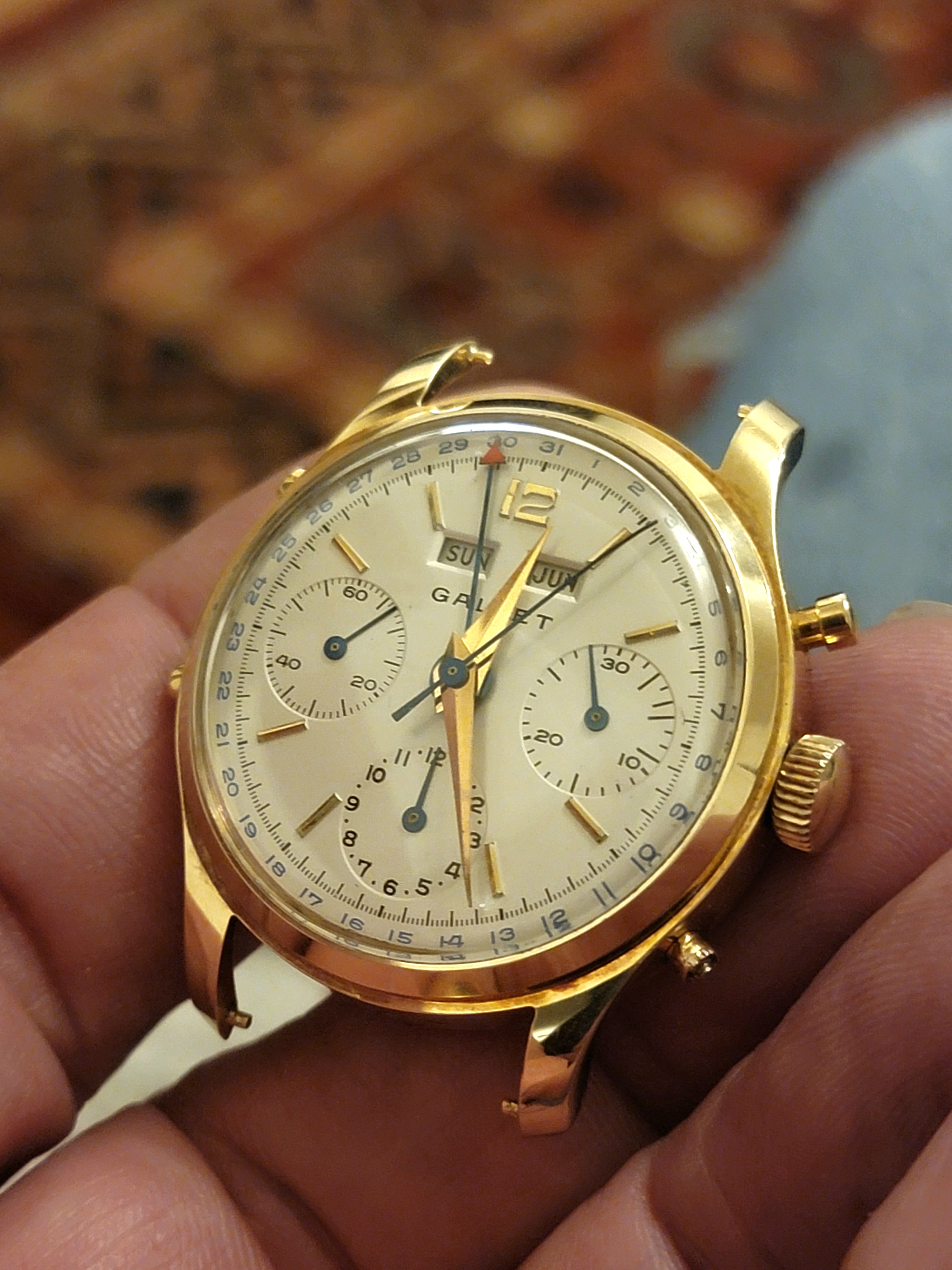

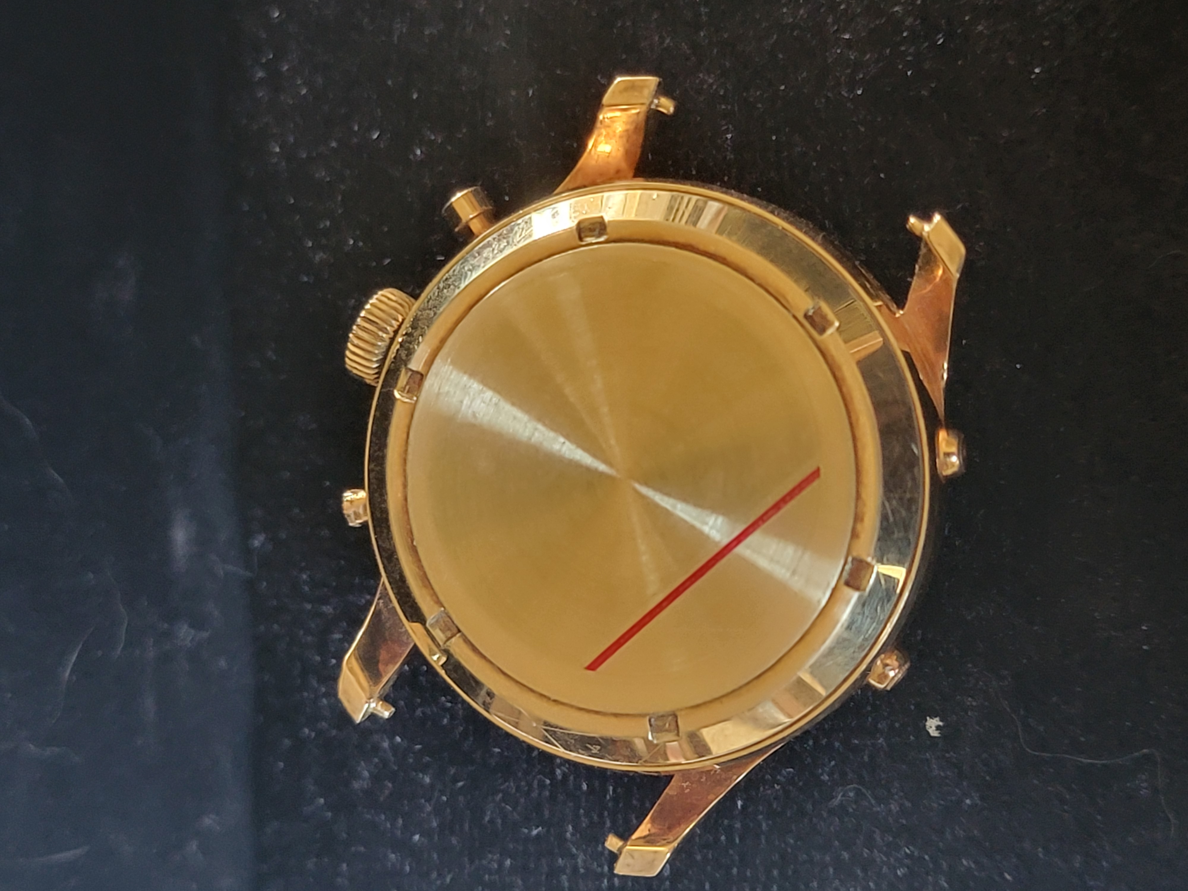

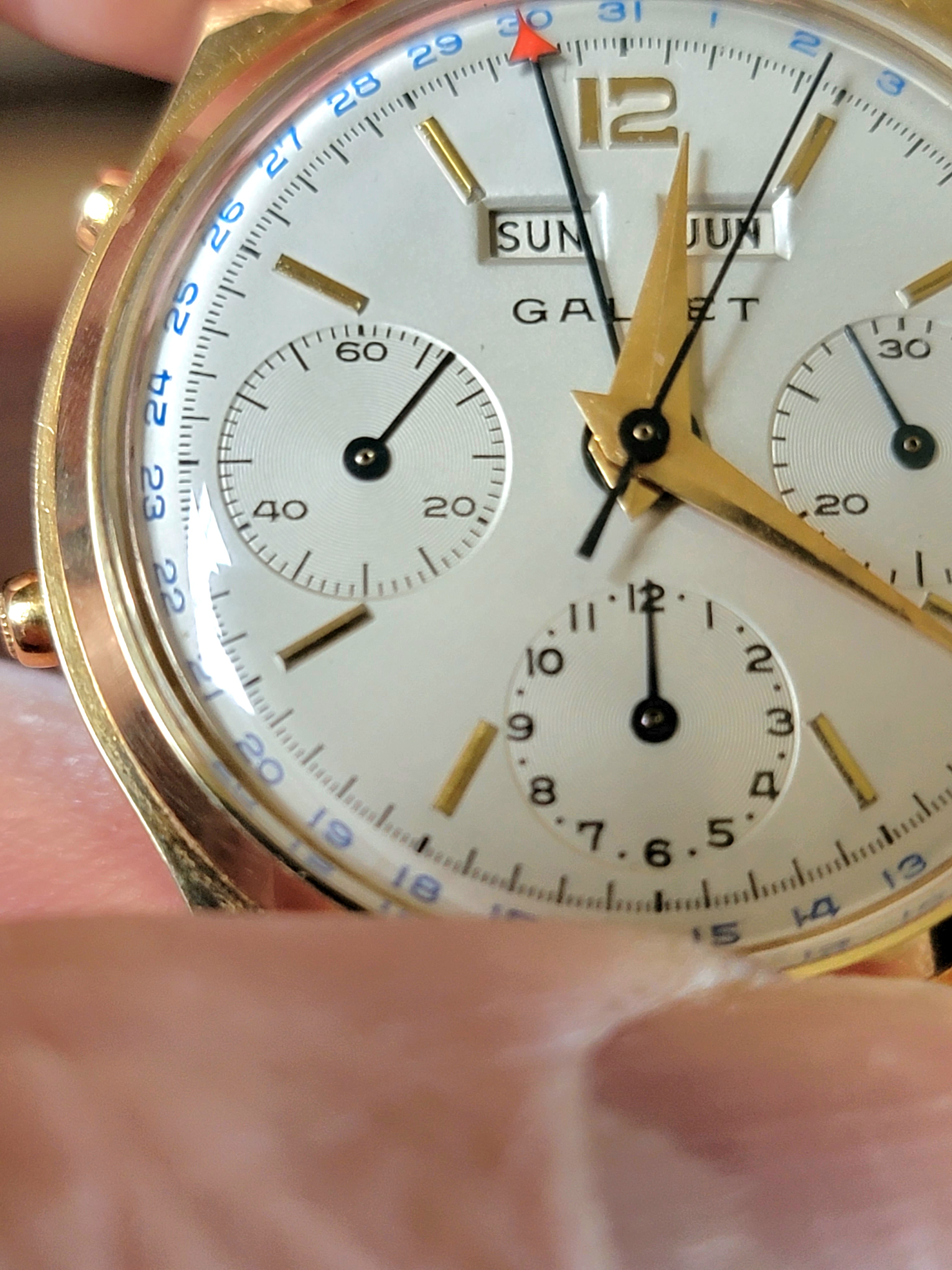

Update:
After talking to Larry at the Gallet Service center we agreed to return my watch. He did not have a pusher replacement. To his credit, he returned my service fee. What's more, he sent me a pusher he said he found at the last minute. It is steel, but I can get it gold plated if it fits.
While he said they also serviced the watch, unfortunately it doesn't run. It ran for a minute then gets hung up at about 5 seconds. They did not return any parts so I suspect it still has a weak barrel spring, or at least needs adjustment. Also, pushing the reset doesn't get the chrono had back to 12. No emotion, just the facts.
The watch looks amazing. I've got a couple leads and hope to figure this out.
Larry said thar the Multichron Service center is no longer affiliated with Gallet. He still has whatever parts he acquired and will continue to service Gallet watches, but not as the brand's official center. He made it sound like Gallet no longer exists.
The first phase is now complete. At least I have my watch back after 18 months. It still looks amazing.
EDIT: Larry emailed me to explain why my watch wasn't working, which makes sense. Also, after visiting my local watchmaker, the watch is keeping time because we loosened the caseback. Just wanted to set the record straight. I appreciated his explanation and feel more comfortable with the service. Here was his explanation for anyone interested:
"You will also notice an issue where the movement functions well with good timing until the case back with hold down spring is tightened down. Then the watch only runs for a couple of minutes. This is a minor issue requiring adjustment of dial feet that hold the dial to the movement. Since this adjustment requires removing the 2 small date corrector assemblies again to access the dial feet, we decided to wait until the watch was ready for full completion with freshly gold plated pusher cap so as to not put any additional stress on the these correctors until we were ready to complete the job."

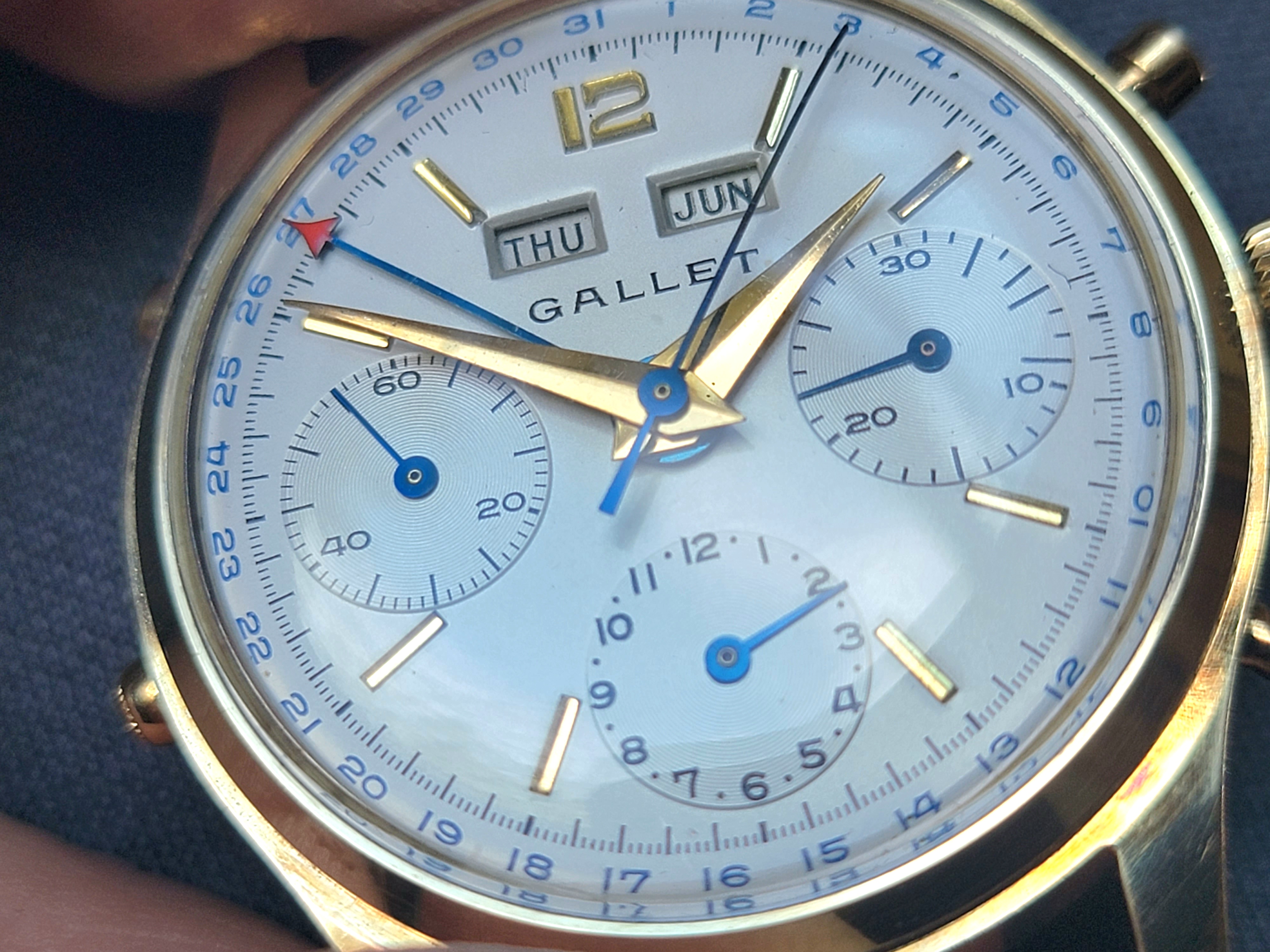

Update: Almost a year later, the watch is still out for service, but now at RGM watches in PA.
I often forget I even own this watch. Kindof a love/hate relationship.

Wow, what a ride. Can they get your pusher gold plated?
6,473
22,005
They've supposed to be making a new one.
532
3,231
RGM is likely capable of making any part that may be needed.

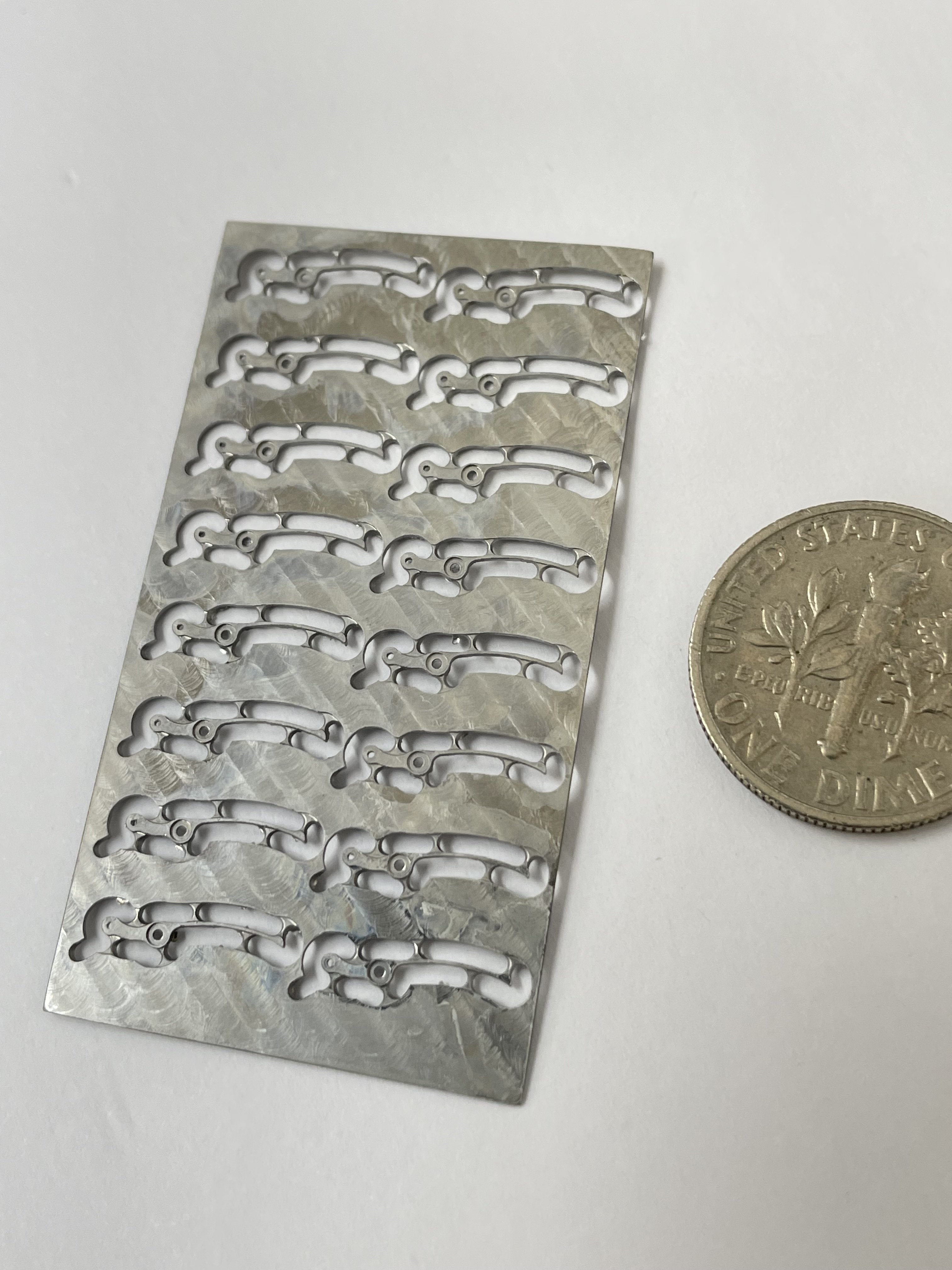

One of my EP 40-68 movements needed a spring:
And so they made some for stock as well:
They have precision CNC machining capabilities.
That said, their turn-around time went from 3 to 6 months to a bit over a year the last two watches I sent to them and now, if I were to send out another, I'd ask in advance how the backlog looks and I believe I'd receive a reasonably accurate response. I was actually asked to hold off sending in another watch at one point until they cleared some of the backlog and this is something I do respect.
This next bit is speculation.
They may have lost one or more people over the last couple of years, but I did not hear this from them. I know of two people who responded to emails over the years are gone, but I do not know whether either of them worked on the bench. In any case, something has slowed them down and part of the reason may be tied to their being a contract repair service for one or more watch manufacturers. It stands to reason that contractual obligations for warranty service will jump ahead of the queue for vintage watches.
When you do get the watch back it'll likely be in fine shape.
