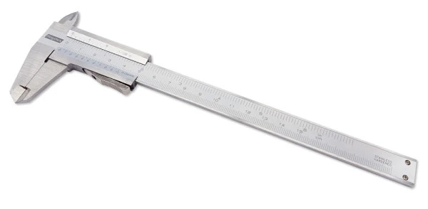

Whatever you do don't do anything to the case. Pics would help. And if you have a micrometer like above or something to accurately measure both.
