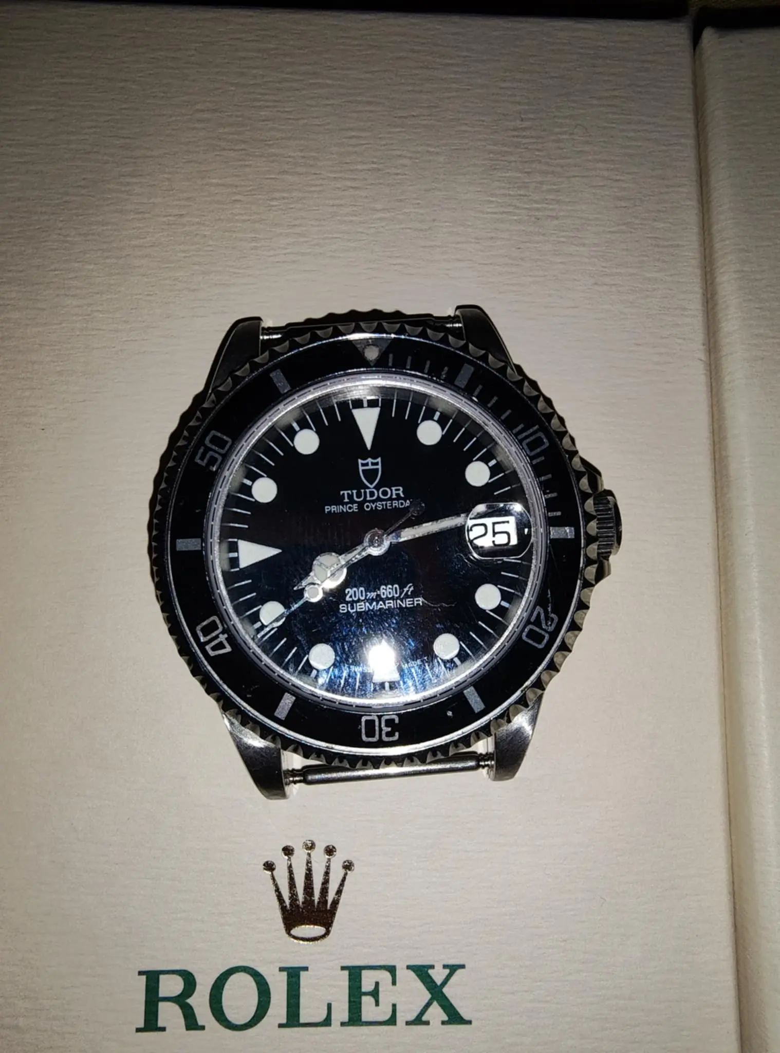

Hi folks,
I'm trying to repair the bezel (or replace it) on my Tudor 75090. I picked up a supposedly correct insert, which fits, but it does not click in or stay in. I feel like there is something missing in the Bezel assembly or the Bezel might be incorrect.
Does anyone have any ideas why the Bezel will not stay in? Does anyone have a diagram of how the Bezel is assembled?
Any help would be appreciated, thanks!
