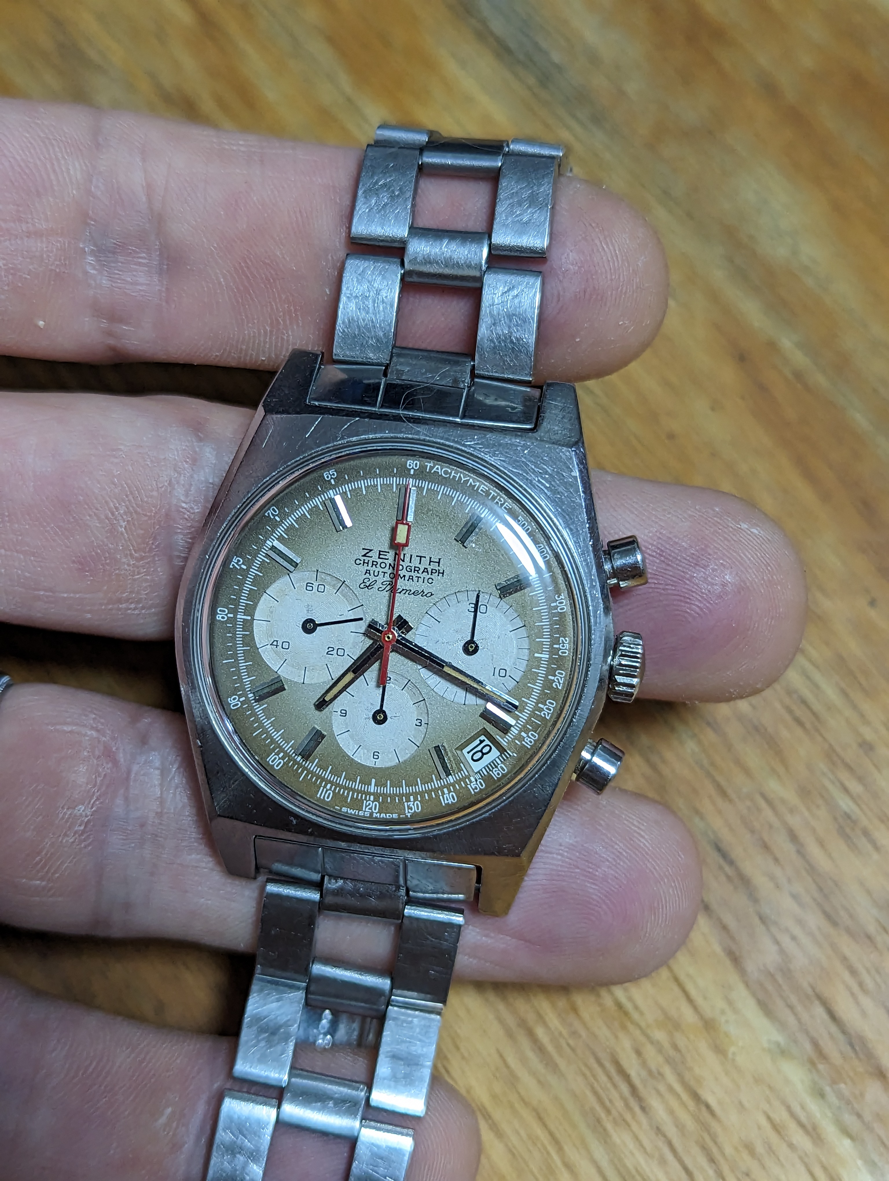

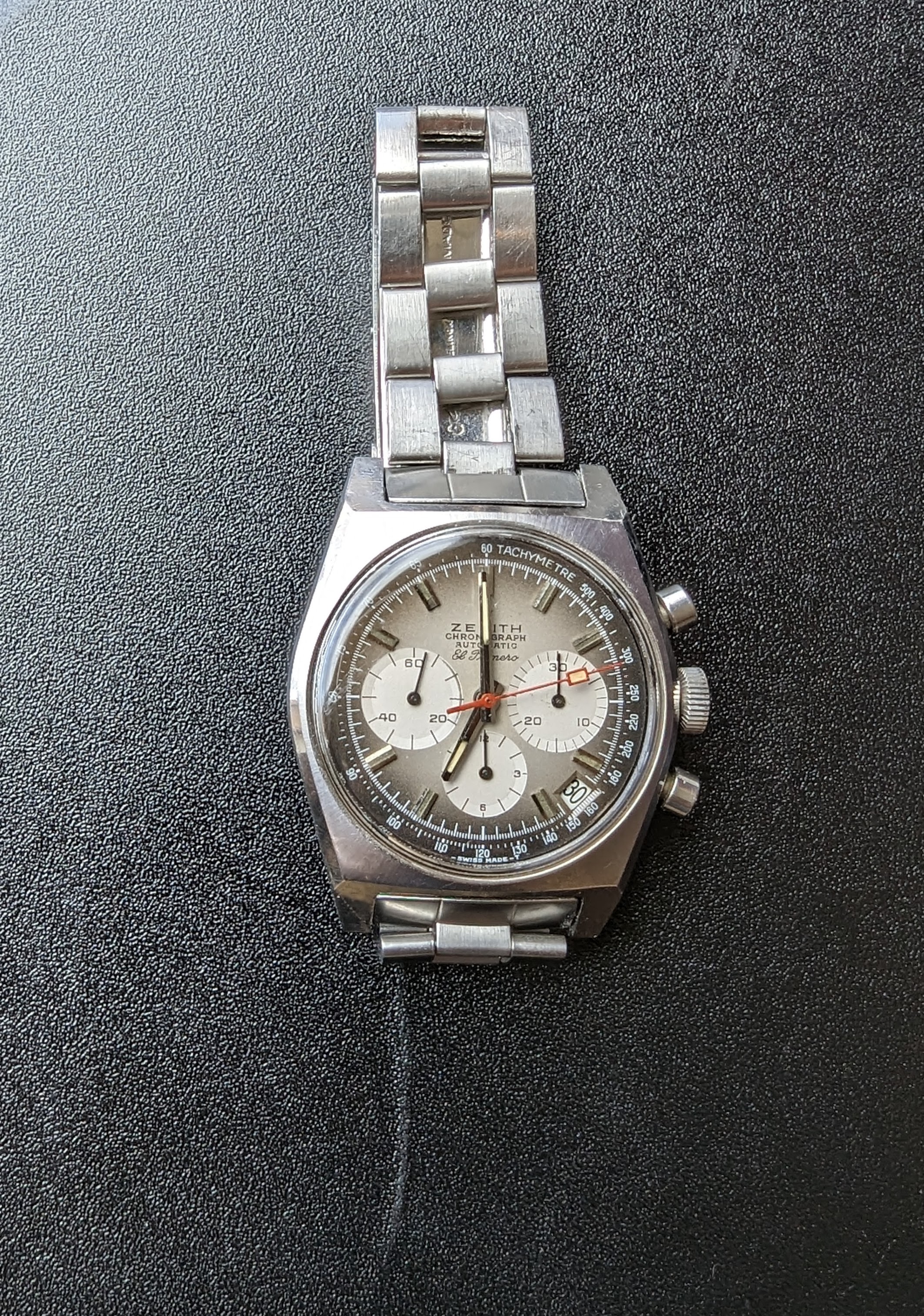

I have a vintage a385. I believe the dial and hands are original. The chrono stopped working correctly and doesn't reset to zero. The chrono second hand slides all over the place.
I took it to a repairman in S Florida, and he said I should send it to the Zenith for repairs. However, I'm well aware that Zenith will replace the hands and parts of the dial. Does anyone have a good watch repairman in the US that they can recommend who will not mess with the dial/hands?

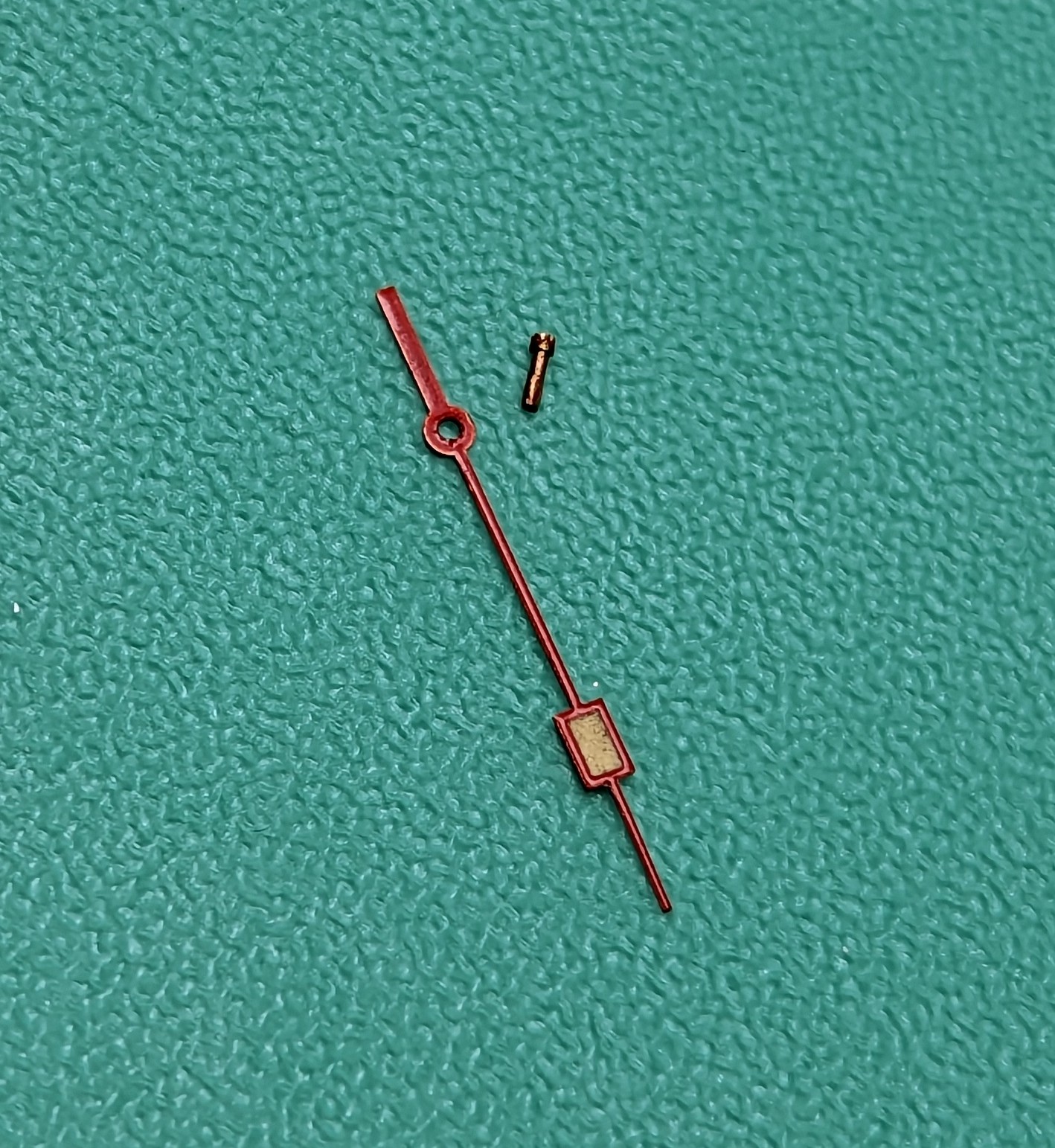

As has been mentioned, find a good independent watchmaker.
Good chance that the tube of the second hand is damaged and that's why it's sliding around. You need a watchmaker that can replace the tube instead of changing the entire hand (as I'm sure Zenith will do).
I had the same issue on mine.
