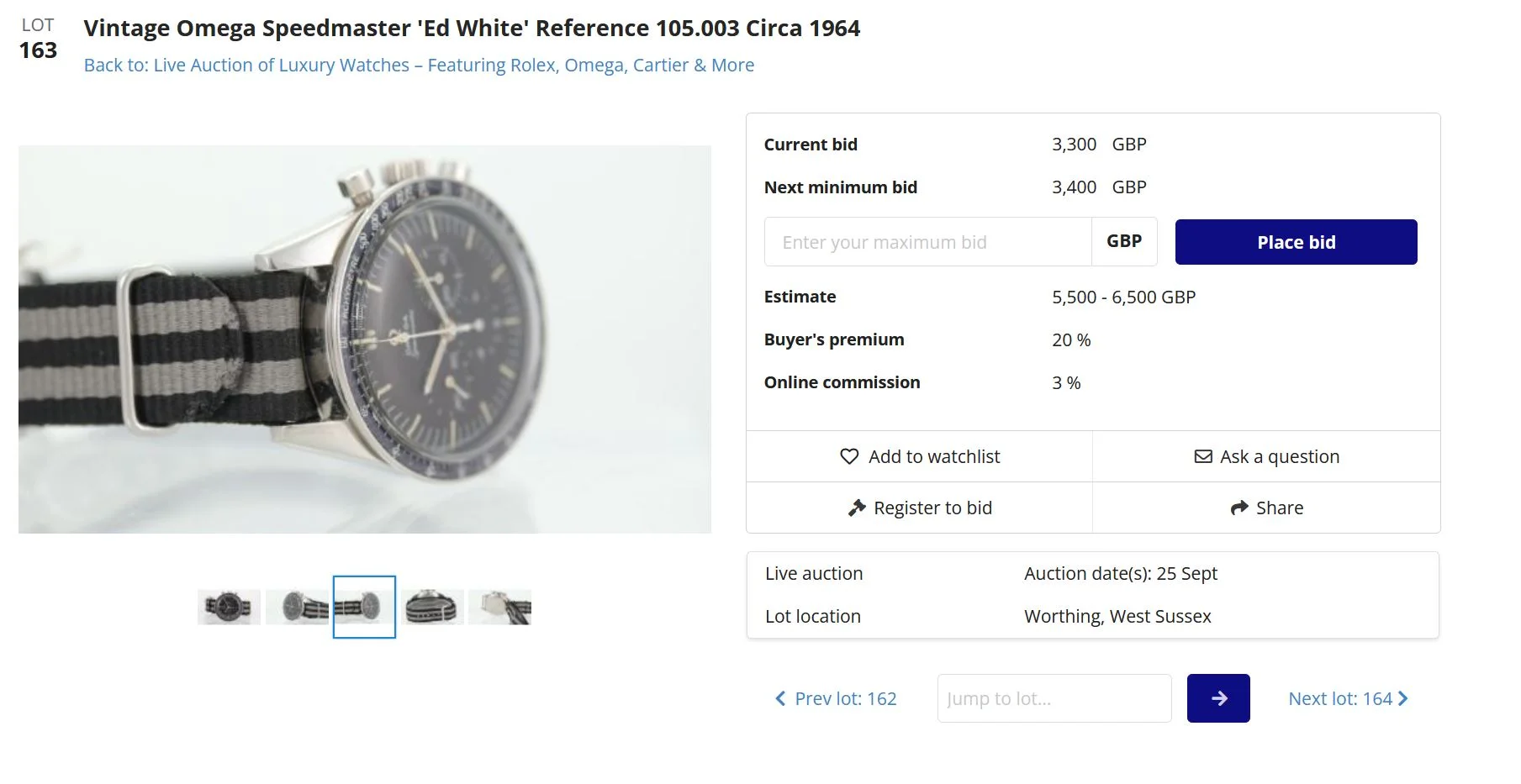

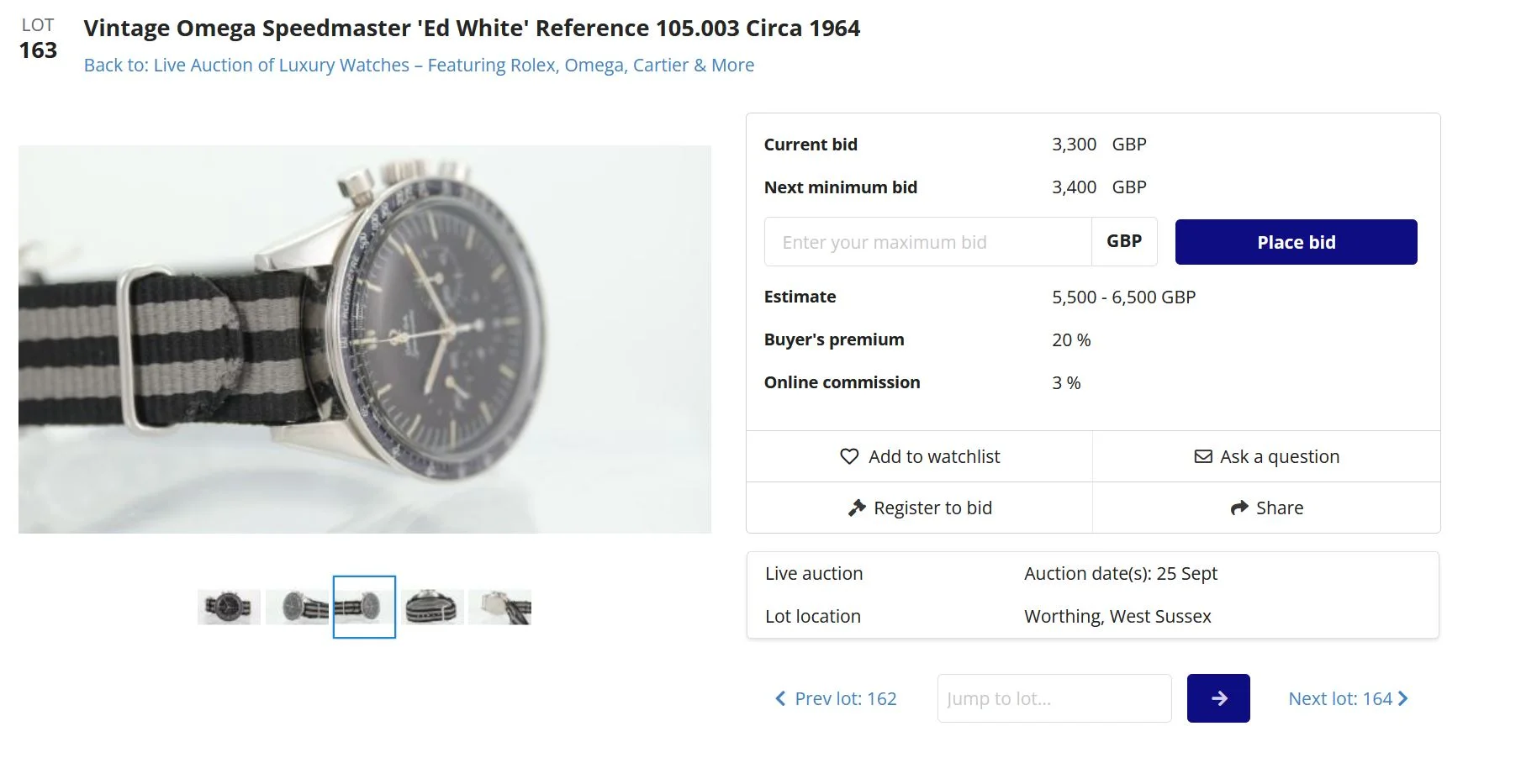

This watch was just passed by Sterling Vault in an open auction:
It is an Ed White estimated £5500 to 6500, which at the top end is equivalent to USD 10,780 with fees.

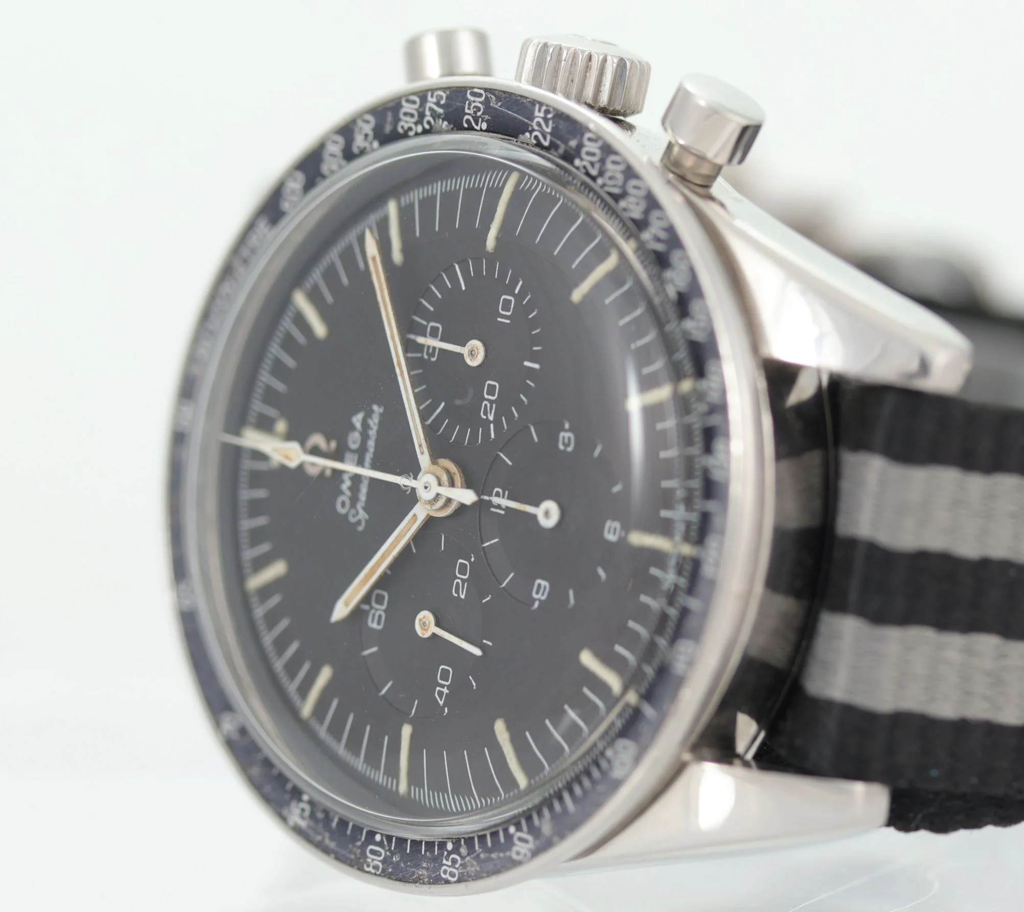

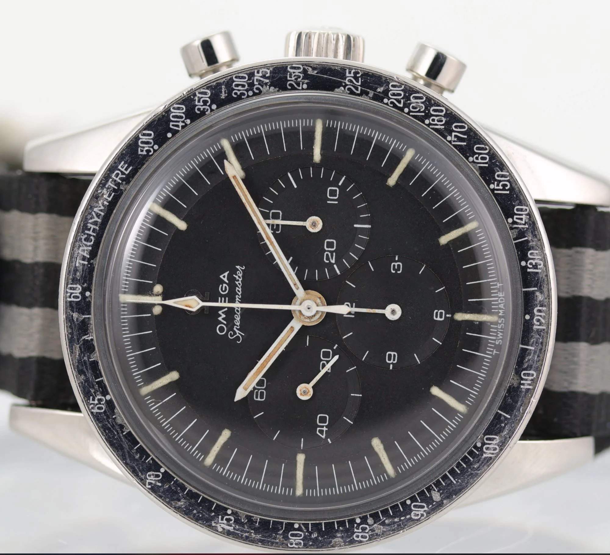

Lets look at the dial:

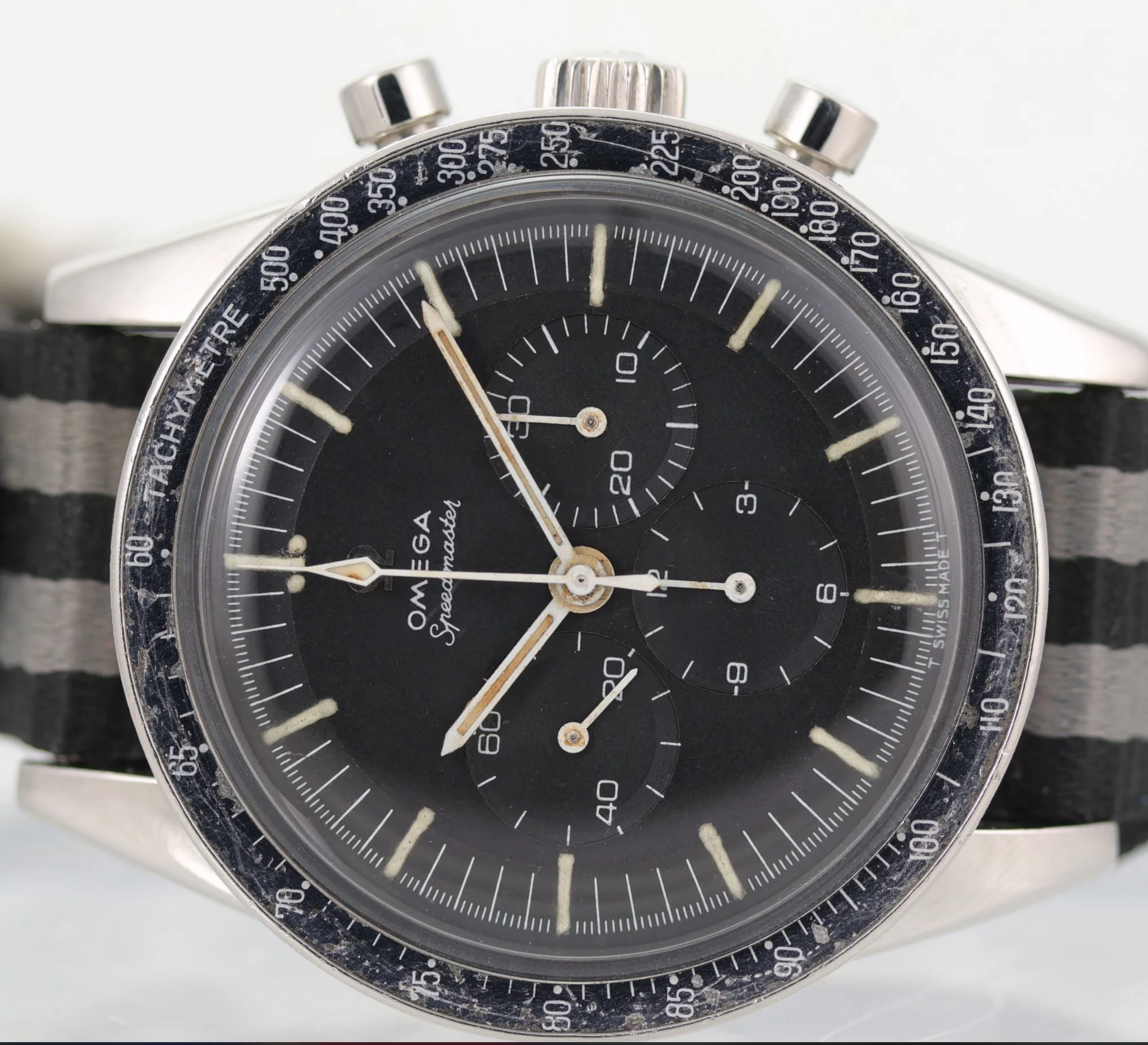

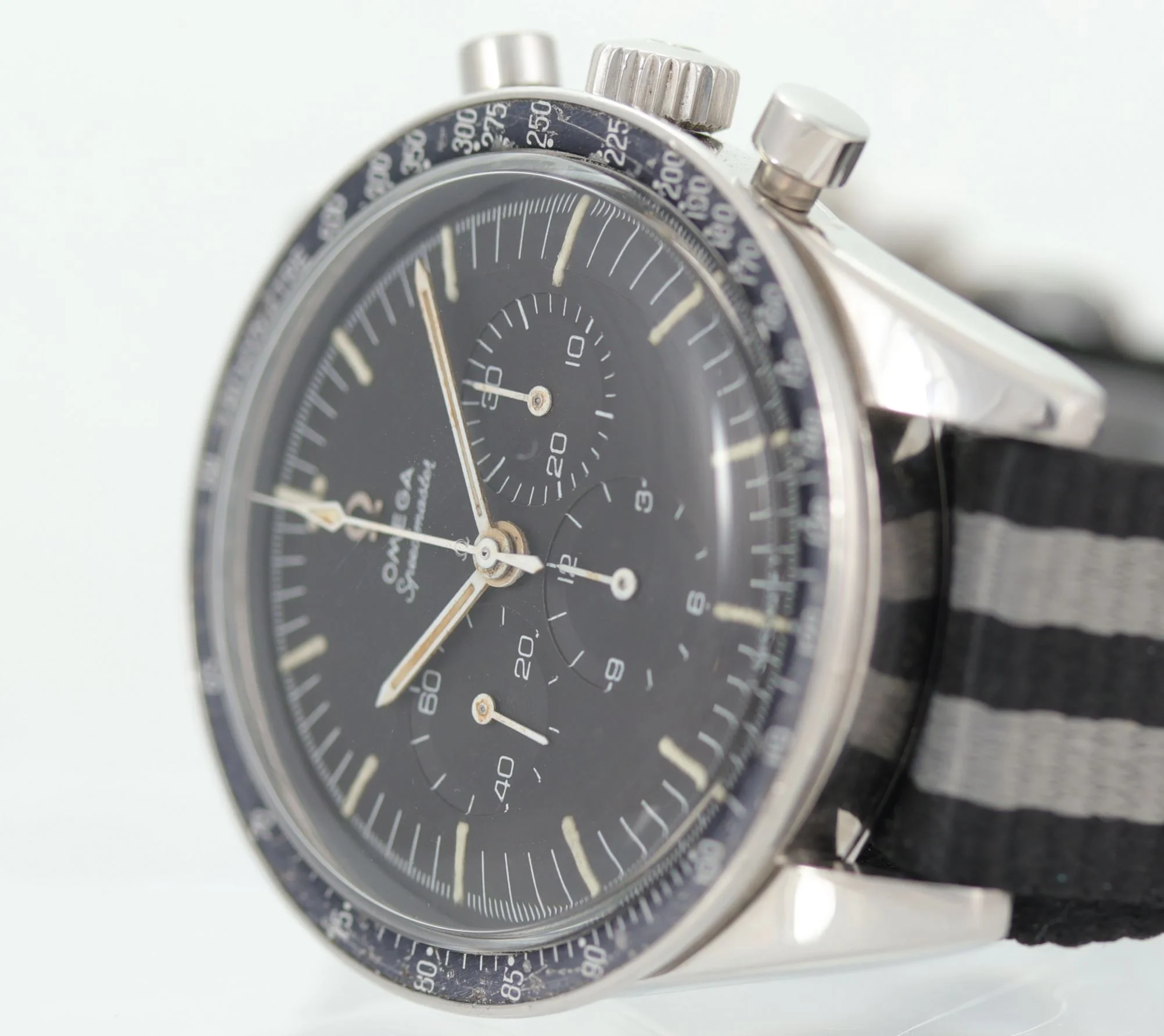

This shot is better focused than many watches I have bought at auction. (!). As we can see, the dial is an absolute text book toothpaste lume example. These are completely original, looking like old toothpaste and a little wobbly. I don't like them, but they are original, in spite of it looking like a bad re lume. At least the markers are covered, but its very hard to justify a $10k Ed White with a dial looking like this.
The bezel is an original DO90, but it is damaged and faded.
We can see an original 24 tooth crown, and the pushers are I think replacements. Open to discussion on that one.
The back is pretty good, indicating the whole case is not bad.
Overall, the watch was a fairly original, possibly rewarding watch at the right price. I had a bid in for £4300 which was promptly ignored, even though the total price would have been equivalent to $7132 with fees - which I thought that it was strong enough to buy, however the lot was passed without sale.

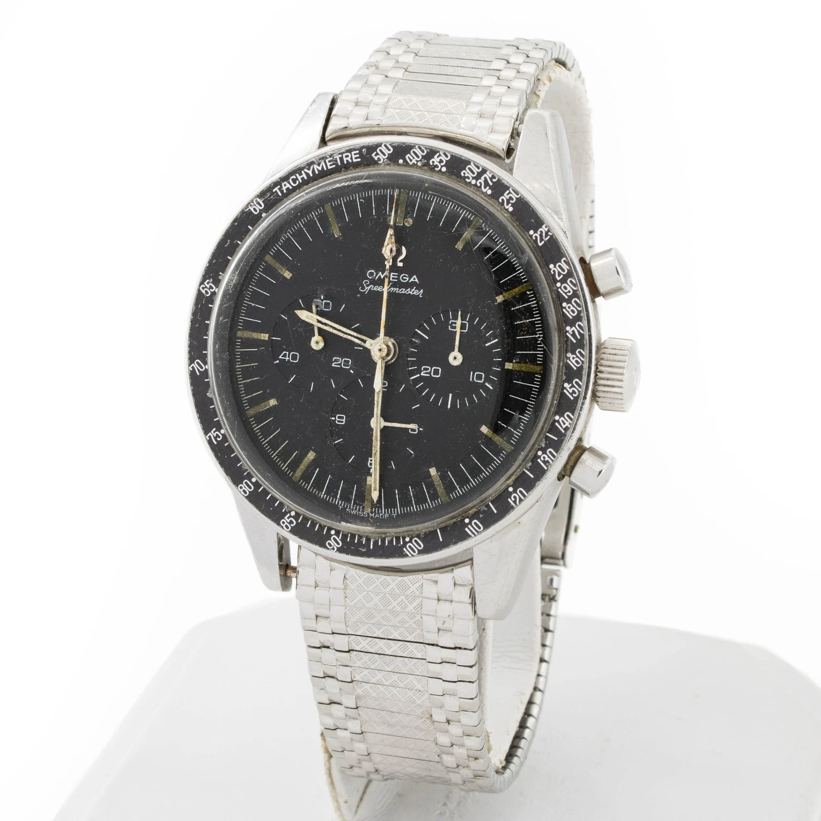

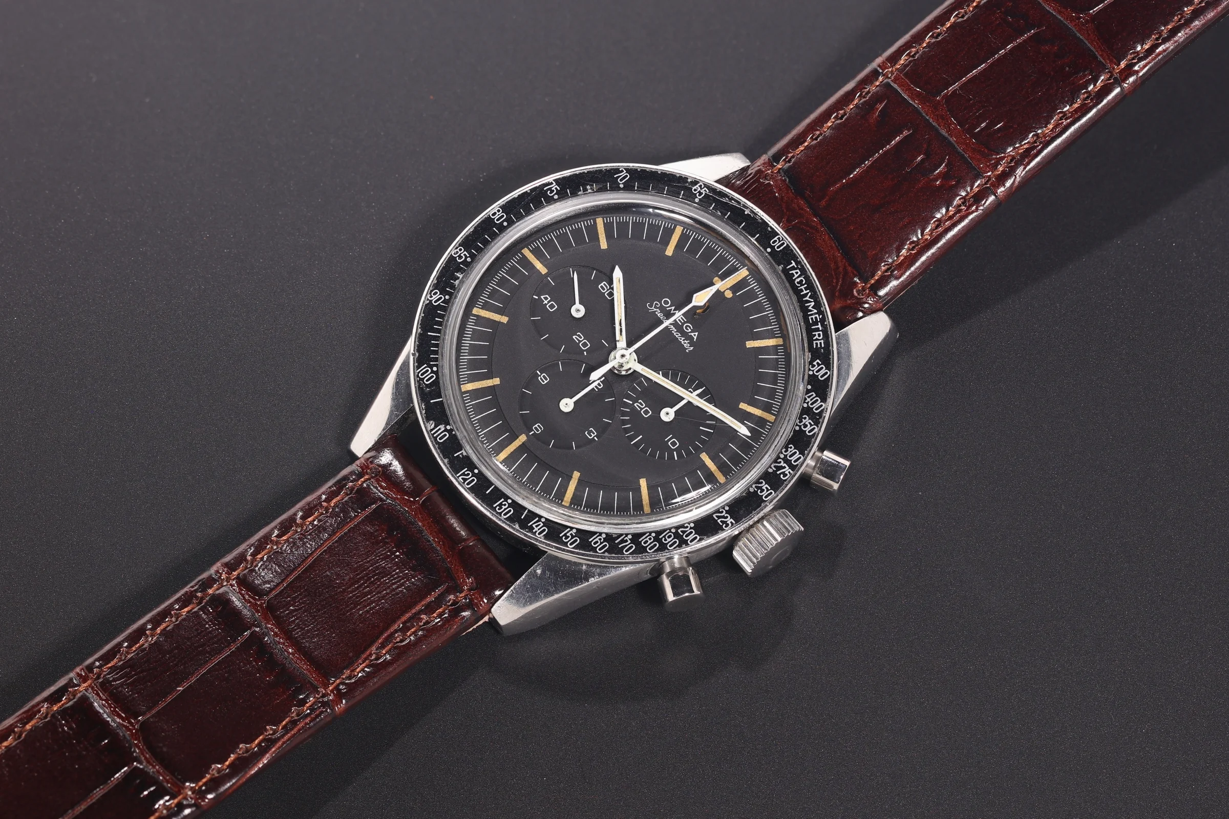

For reference, here is one of mine, which I call Very Good

Man, your watch though.... wow that case. I don't get to see many of these, but a straight lug with such clean lines is a classy thing.
