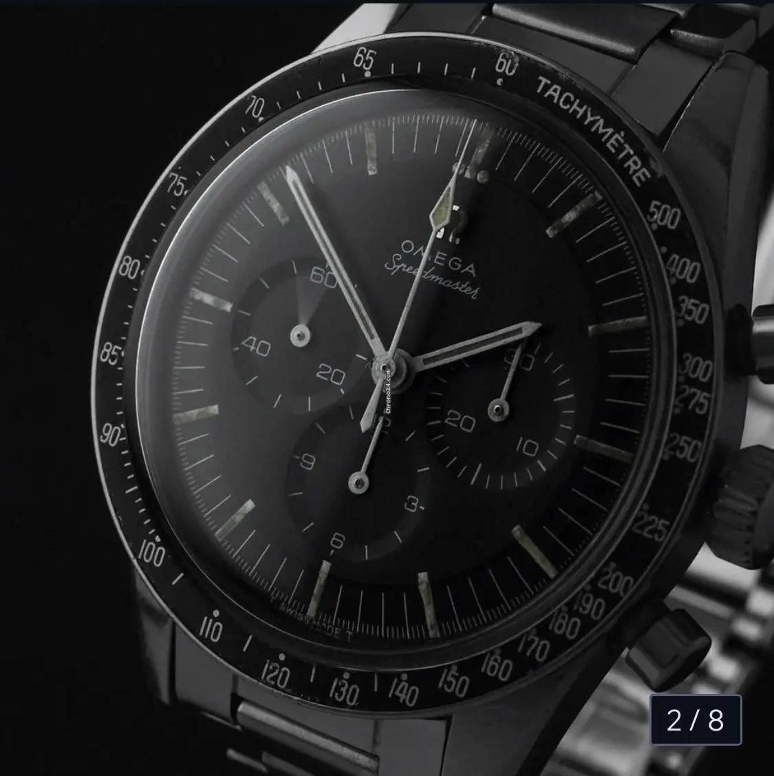

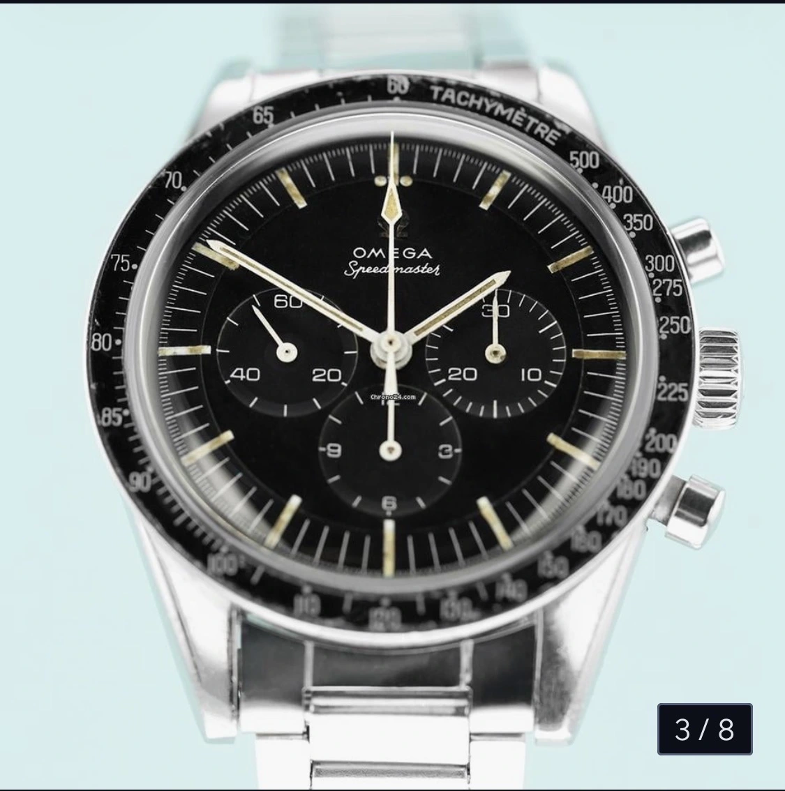

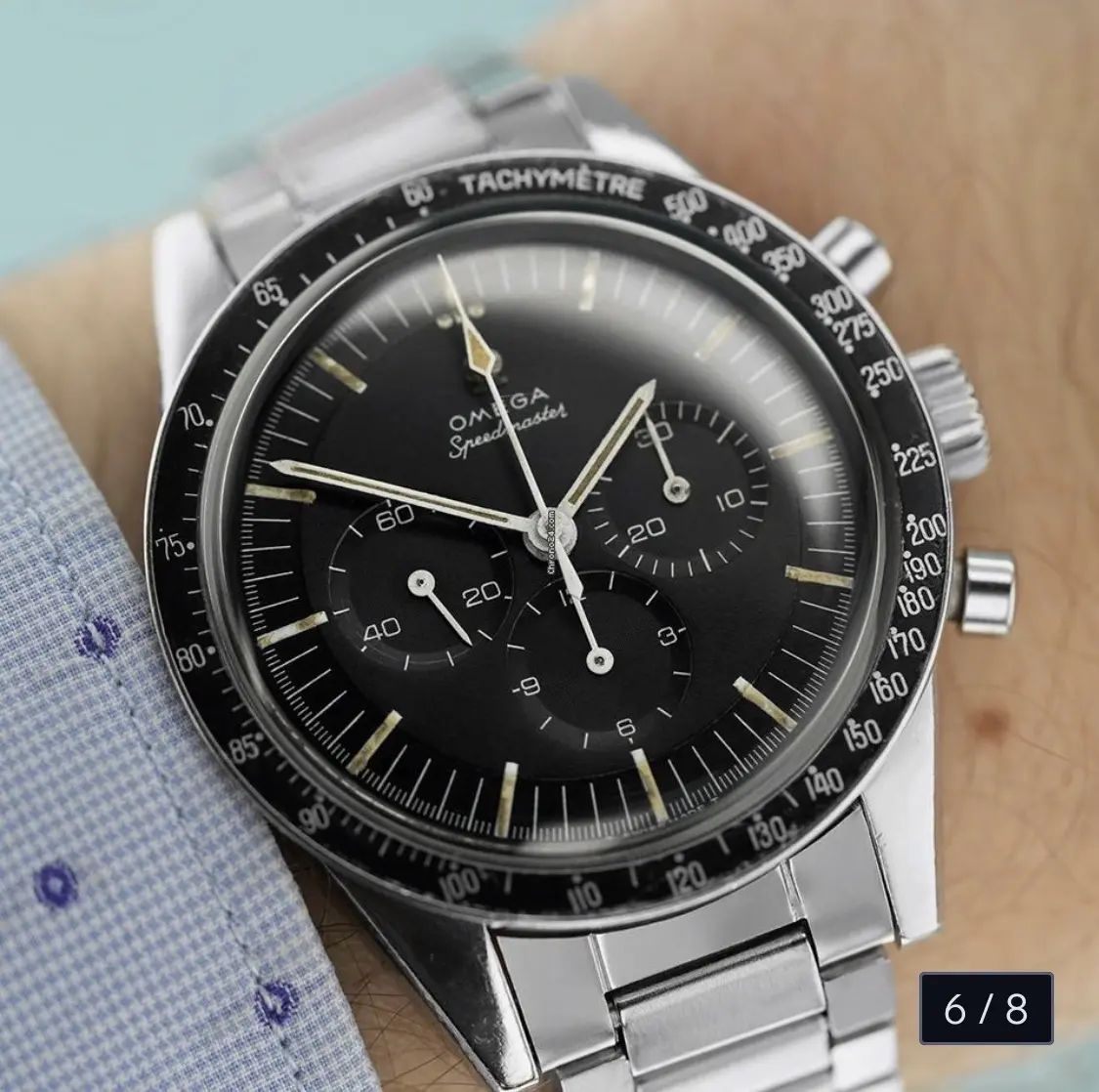

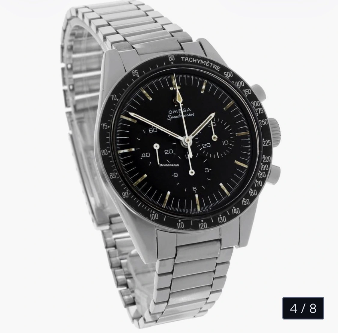

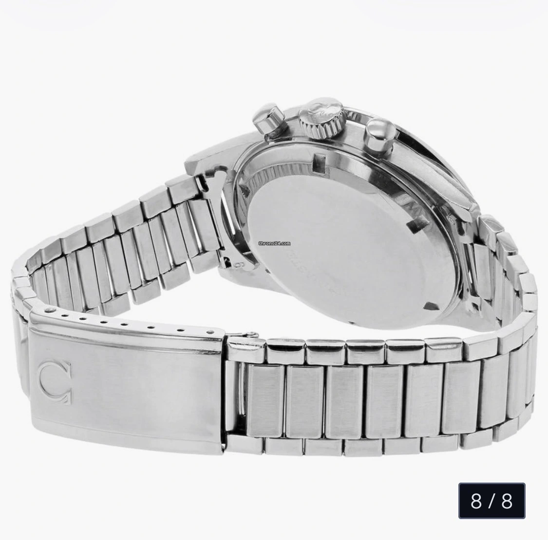

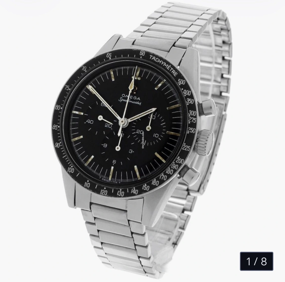

Hi all, this 105.003 is up for sale priced at £10,500. I think this is a relatively fair price - the watch looks in original condition and the bracelet code is the original flat link 1035. I’m wondering whether this watch would need a re-lume given the existing material has disintegrated (I’m aware this may reduce its value though). If I was to get it re-lumed then I’d commission James Hyman as I understand he is the best. The case edges look relatively sharp. Is everything definitely original and in good condition for the price? Thank you!

Movement and inside Caseback important to see.
And outside Caseback cannot be assessed on the last overexposed photo.

Personally, I would pass. The lume is unattractive. Even if you do re-lume it, it would be hard to sell if it ever came to it. A relumed dial is also a non-starter for some. There is also hand drag on one of the sub dials, in case you missed that.

In this case, the dial lume is a major distraction for me. And if you're going to buy a watch that needs to be relumed, you might as well buy a project watch and pay a lot less, IMO, because it will always be hard to sell to a collector.
What is hand drag and how do I spot this? Thank you!

on the bottom sweep seconds subdial you can see a white line drawn out by the hand.

I'd want more detailed photos before I'd consider spending £10k+ . The lume is unappealing. The hand drag, if that's what it is and not an unfortunate reflection would cause me to look elsewhere.

The mark can be seen subtly in "image 2 of 8", so i doubt a reflection.
Tbf I was viewing on my phone. But good point.

As others have said, the lume is not attractive. I wouldn’t buy it, personally.
