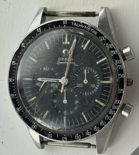

At today's rates, €3k is about $3,500.
If the movement is clean, and the number is close to known examples, then at that price it could appear to be a bit of a no-brainer.
You can make the watch look a lot better fairly easily. Fit some new hands and distress them, perhaps do something with the dial, and fit one of the repro DO90s. You then have a watch you can wear and do a rolling restoration on, picking up a genuine dial, handset and bezel over time as they appear.
Right now, my thinking on an Ed White with "Good" components would be roughly:
Movement - correct number and clean: $2,000
Case - no serious dings, properly seating caseback and pushers: $1,000
And I suspect the OP watch may actually have more valuable parts than simply "Good".
Then the things you don't have:
Bezel: $2,000
Dial: $3,000
Handset: $500
So let's assume you buy it for $3,500.
Then spend another $6,000 on parts and a service. You could certainly do it for less if you are patient.
You are now at about $9,500.
What Ed White is out there for $9,500? They are there, but not many are attractive.
However...
Now the initial excitement has bitten, we can go back and be ruthless and look for the details that might derail this whole train of thought.
The movement number looks to me to be 2052xxxx.
That is not a range I have seen in -65s. It is seen in early Ed Whites, and also in late 105.002s.
So before getting excited about the price, that is the first thing I would want properly resolved.
Next just check the pushers - they look incorrect, they might have been butchered into the case. Check if they are screw in of push fit. Ed White pushers are the smaller ones and its not always easy to see on photos.
The Dial - This may not be a service dial. It could simply be a later dial, modified, (Or not - you can just slap an 861 dial into a movement, it just wont be secured by the feet).
So my conclusion: If the movement is good, I am tempted, then check the case for damage. Offer $3000 and I would be in.
It’s a 63 and not a 65 that’s for sure/that’s what the seller wrote me.
But apart from that your reply is very insightful and helpful for me as vintage watch rookie. 😎 thank you for taking the time and analysing it like that!

Where did the jump to suggest this was a -65 come from? The pic above shows a HF mark. It is deffo not a -65 with a HF caseback. If this is remotely original (not necessarily so) it is a -63 not -65 and the 20.5m serial also suggests this. I'd take a FOIS 1 or 2 over this all day long personally but as noted, with the right hands it would look ok I guess.
The seller wrote it’s a 63 and confirmed it to me after I ask - since I also couldn’t make outing it’s a 65 or 63. 🤗😉

Usually Omega cases were made by Centrale Boîtes or Huguenin Freres, so are usually stamped CB or HF. The -65 a bit of an enigma and the case maker has to my knowledge never been identified. The logo in the back looks like a stylised RJ or perhaps FJ. The presence of the HF mark was a give away it couldn't have been a -65.

Thanks a lot! That’s even more knowledge and vintage omega input for me 😍 really happy that I asked about this piece/offer!

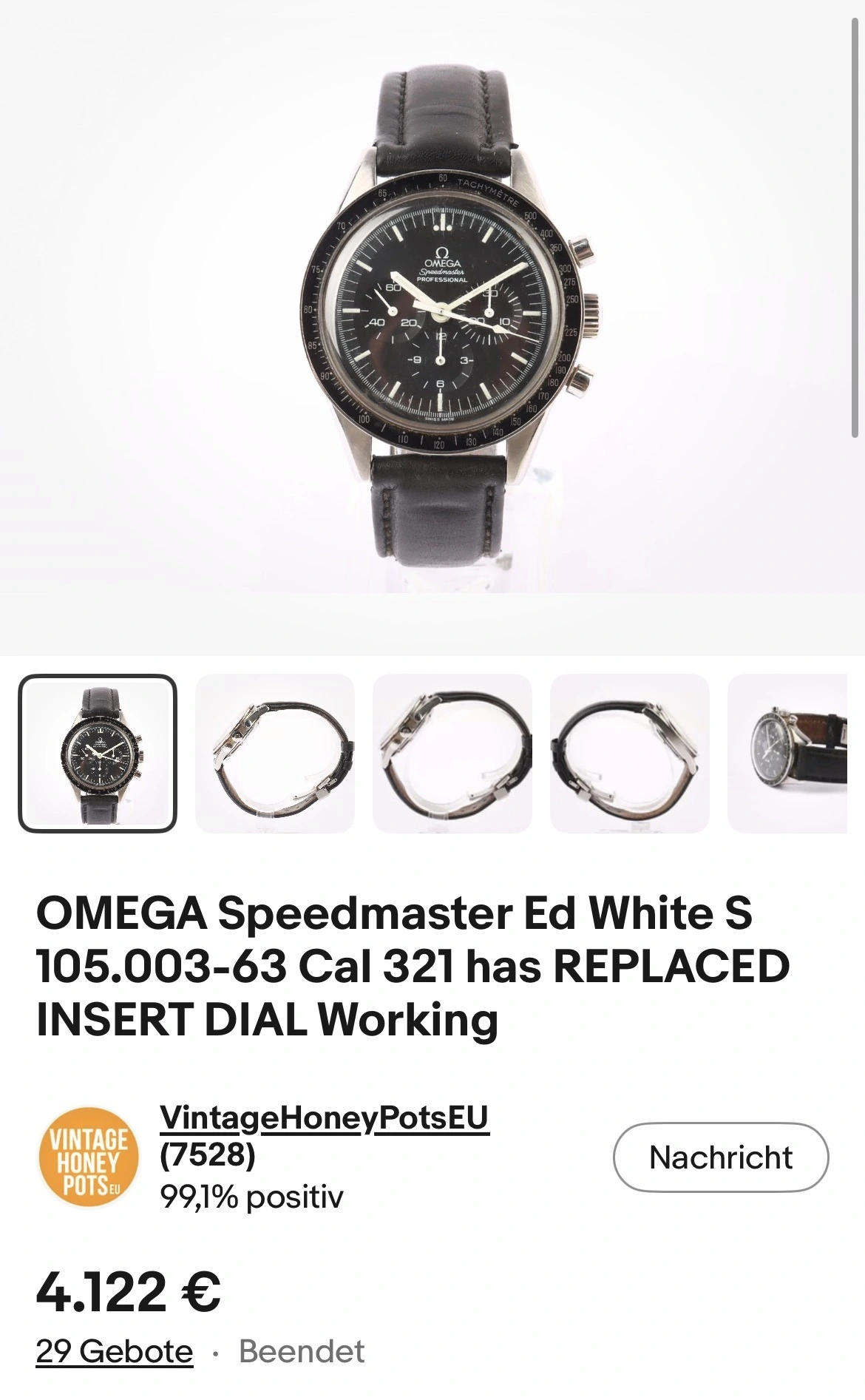

And for those who care or want to know what it went for:
It was sold for 4122€
22
15
Did you buy it ?
I was one of the snipe bidders at Euro 3k, seems like a no brainer to me. But I didnt get near. There were a lot of bidders over Eur 3k. 4k feels like too much with the obvious parts to be replaced. (Plus import duty for me).
There was another ebay 105.003 at the weekend and seemed to sell quickly, presumably around GBP£ 4k https://www.ebay.co.uk/itm/158236142617. Might have been better value as a rolling restoration (taxes aside) as it appears original and complete but poor bezel and potentially case.
I looked at this one when it came up. The buy it now price of £4163.30 made me suspicious as I associate these weird numbers with scam listings. Then maybe it is bad camera angles, but the lugs look very short and the case profile rounded. I got the feeling the dial might be nice though, but for me not worth the risk.

BTW. The watch is up for also again/was relisted by the seller.
Is it ok to post a link to it? For someone who might be interested in it/who might go for it for the parts? Or is it not welcome if links are posted in the forum?
It has the same title as in the screenshot I posted above!…
