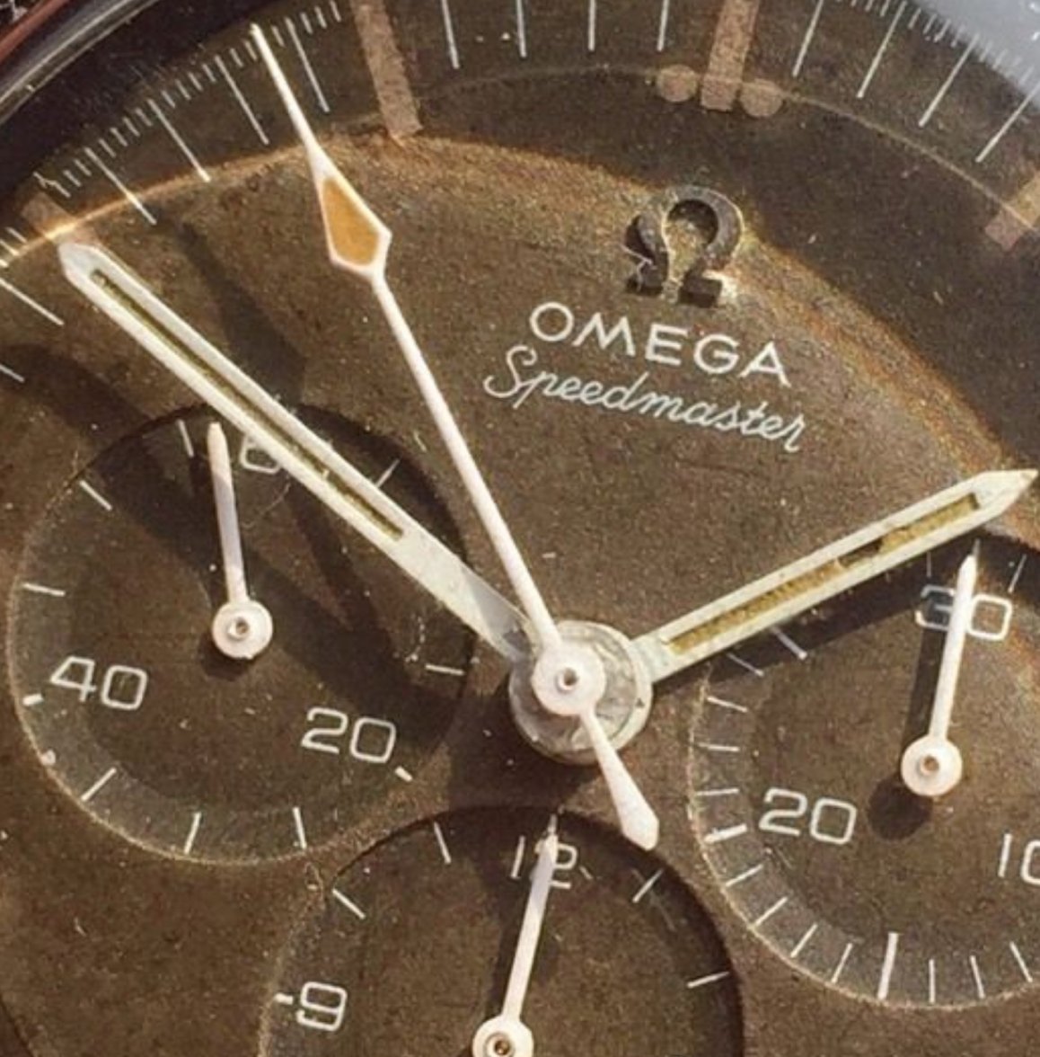

Ed White sells for over $10,000 (£7,000). The power of natural light photos!
5,860
16,788
http://pages.ebay.com/link/?nav=item.view&alt=web&id=151649652395
I suppose this is good news since I own a 105.003 but I don't see high value in this watch. To me the dial is a speckled, blotchy brown, not very attractive, the lume scraped, the bezel fair to good, no bracelet (but lately there never is) .......hands and case ok. But over $10,000?? Wow. The best thing about this watch are the photos with the watch tilted just right to be highlighted by the sun.
And the movement number is too low as well.
Am I overly critical? I didn't think this watch would break $6,000.
6,647
11,476
Others may feel differently but I think the most tropical thing about that watch is the humidity. I know some like the tropical browning of the dial - I personally don't but I respect the opinion of those who do. Nevertheless this is a bit too far IMO.
572
419
as a fellow owner of a 105.003 '64, i guess i should happy too. However, I don't think this particular offering is worth that price for the same reasons Gemini4 mentioned. when i put mine up for sale (better condition & recently serviced), should i expect 10K+??? In my dreams.

What's up with the hands? Specifically the minute hand which is lumed only in the top 2/3rds rather than the full length?
33,531
38,207
Its also too short for the point to touch the outer fifths of second hashes on the dial like a Speedmaster should and the outer diameter of the hand hole is larger than a real Speedmaster hand. I'm guessing when he was putting this one together he had a cheap Speedmaster Mark 4 hand laying around and stuck that on as a "that'll do" solution.
118
67
And again, hands are not original from factory, new replacements artificially aged. Probably the only original is hour hand, Perhaps that bidder enter in reason before paying that amount of money.
9,217
24,055
@dsio, just so I follow, the minute hand should reach the smaller 5th of a second markers? Is that true of all 321s?
33,531
38,207
There are many hand sets and dials for 321s, none of them are that length with 2/3rds lume and that large "loop" around the center hole for the hand. Depending on the angle you look at it sometimes the hand can look shorter or longer as well but this hand is shorter from every angle due to being from a Mark series.
