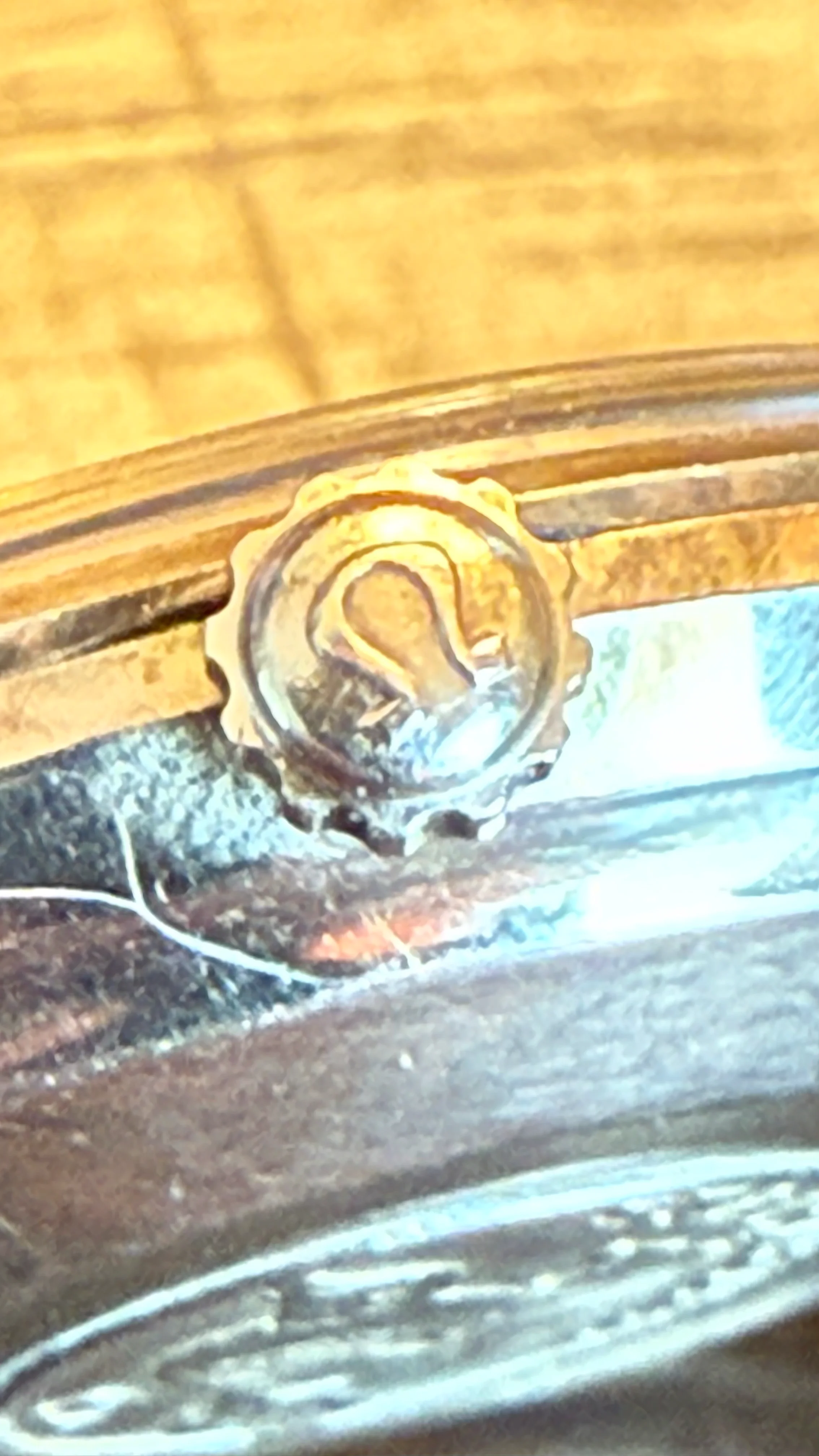

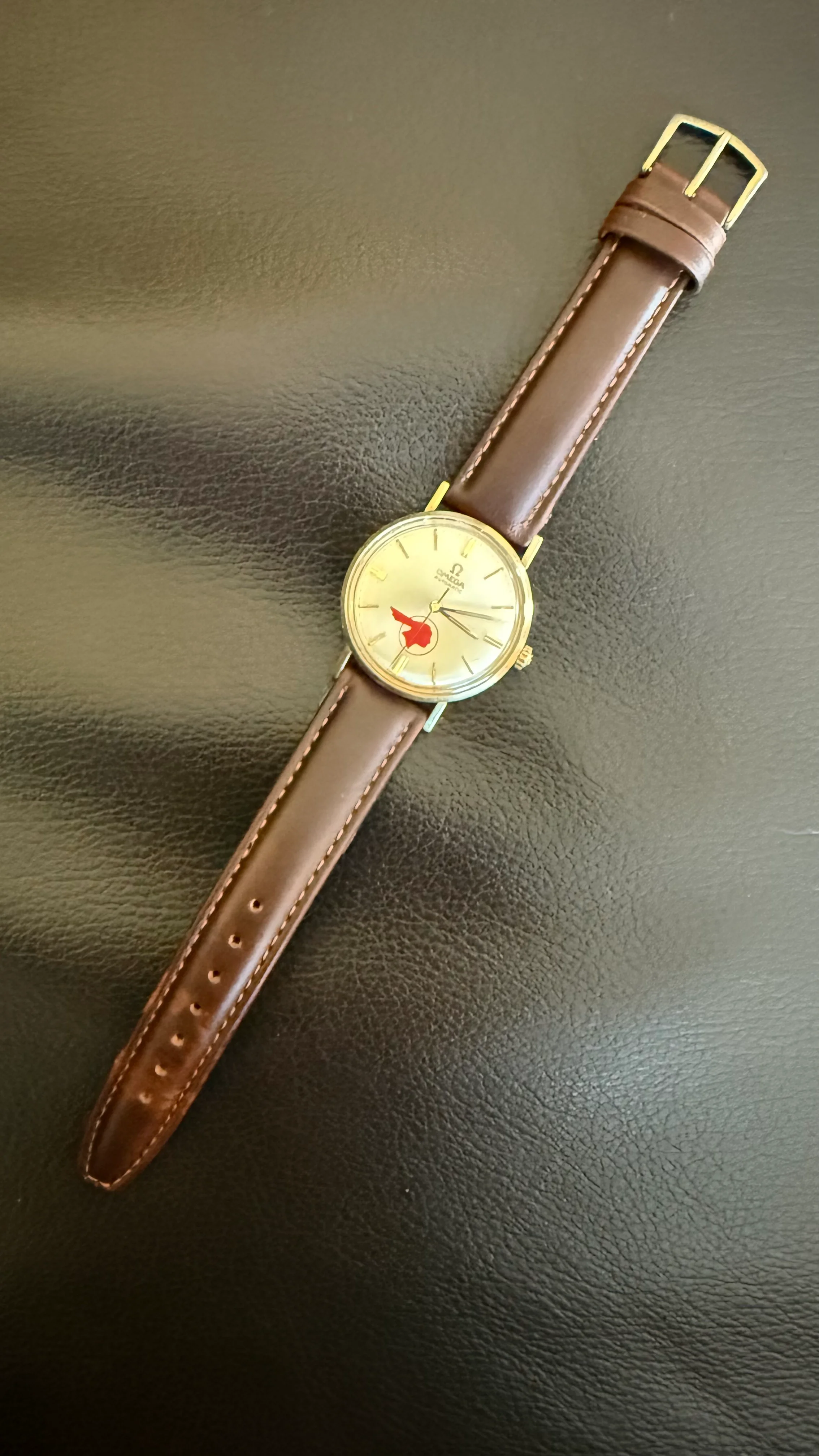

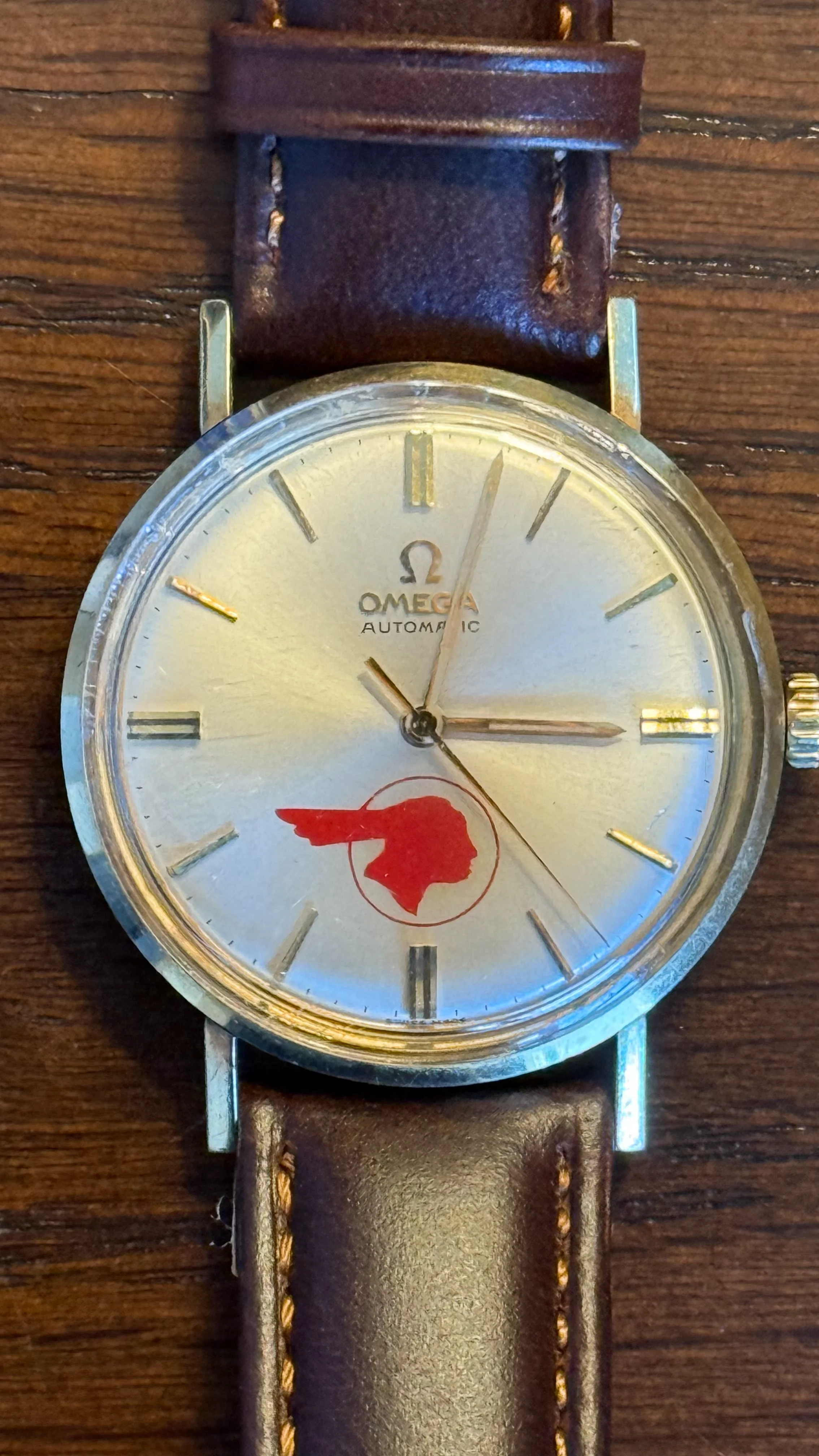

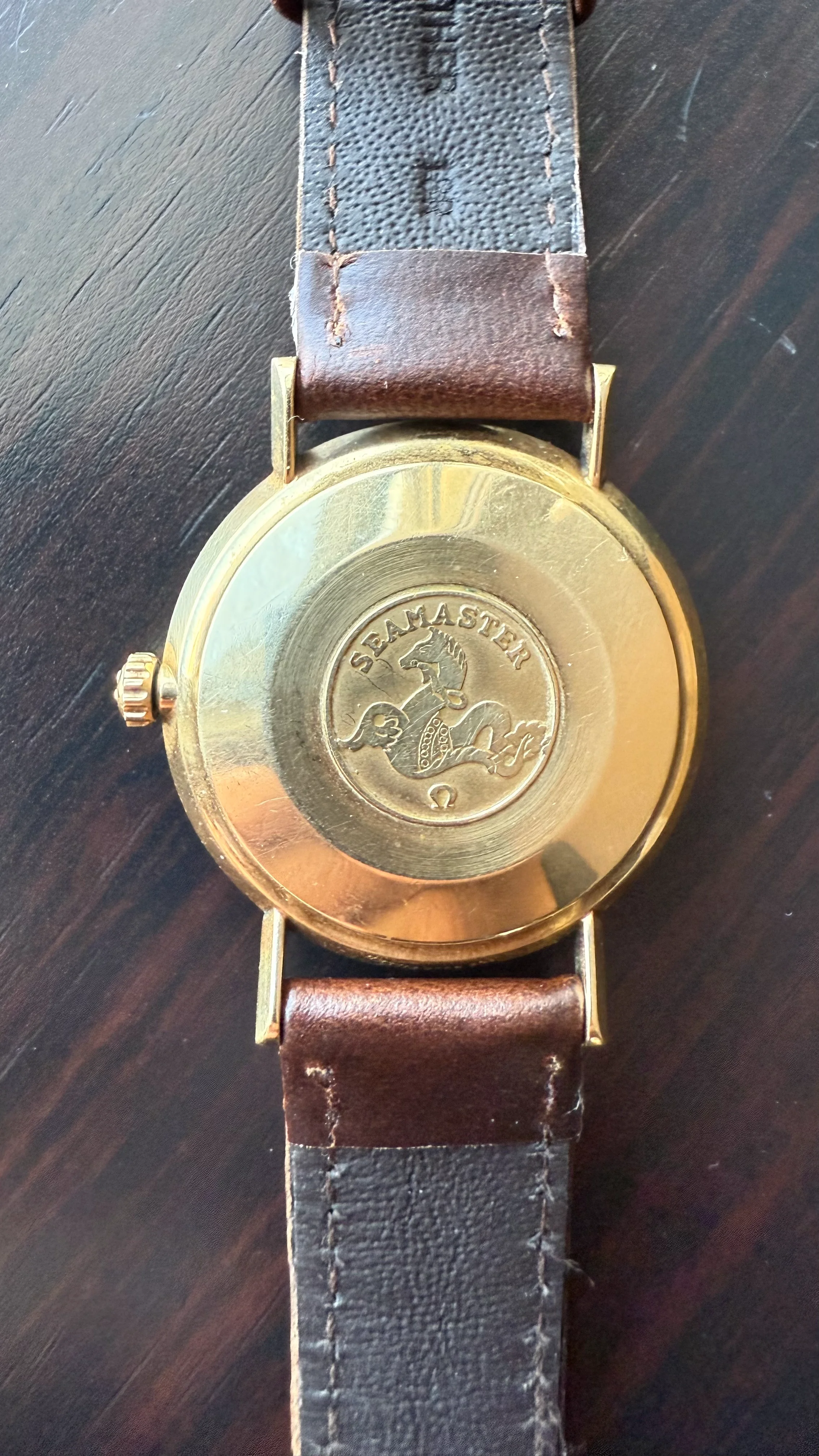

Hi all,
Took a leap of faith and bought a watch without doing all of my research.
Am hopeful some of the masterminds can help me learn more about this watch.
It looks like an early 60’s Seamaster (Deville?), and has a Pontiac Automotive logo on dial. I assumed it was given as a gift for selling cars.
Issue is that I think Pontiac retired this logo in 57. It’s a front loading watch, so unfortunately I don’t feel comfortable opening it for movement serial number. It’s keeping great time... also here’s some general info from original listing:
Movement: Omega Cal.550 Automatic, 17 Jewels
Markings to Inside: Omega Watch Co. LL 6287-1, Ross, 1235654
photos attached.
Thanks for the guidance!

Well you might struggle for a conventional case number since that is a USA made Ross cased model using a US specific 17 jewel movement. Some had the smaller 570 by the way, others the date variant 563. I believe it would be described as a Ross LL6287. A search on Omega LL6287 gets many similar looking hits, think of it as a domestic cased SMDV. As you say there may be a discrepancy with the logo since that model can't really be any earlier than around 1960 with that movement. If you had the serial number on the movement we could give a better estimation of date but my gut feeling guess is circa 1963-65.

Don't base the date of the watch on the Pontiac logo at all. They would have used that or the Pontiac arrowhead logo. The Chief Pontiac figure was used through the 1970 model year as the high beam headlight indicator on the full size models.

Too bad the presentation date was not included on the case back. If this was a presentation watch, say, for years of service, the choice was made to use the logo the recipient was most familiar with.

That 19mm strap is the wrong size, jammed in there pretty tight. It's either 18mm or 11/16th. You'll have to measure to see which.

Sorry to bump this thread after 5+ years but I have this same watch with the Pontiac logo on the face. My dad gave it to me years ago and he most likely picked it up at a pawn shop. Today I took it to a reputable jeweler who said they could freshen it up but that it was in very good shape given its age, so I passed. I treated it to a new padded leather strap (18mm) and the jeweler retained the buckle from the old strap which had some nice patina. It's too small for my nearly 8" wrist but given its provenance I plan to keep it in my collection.

The marking on the dial is pretty cool. Looks like an Indian head.
Yes it appears to be a vintage Pontiac logo just like the one owned by the original poster. Interesting piece.
