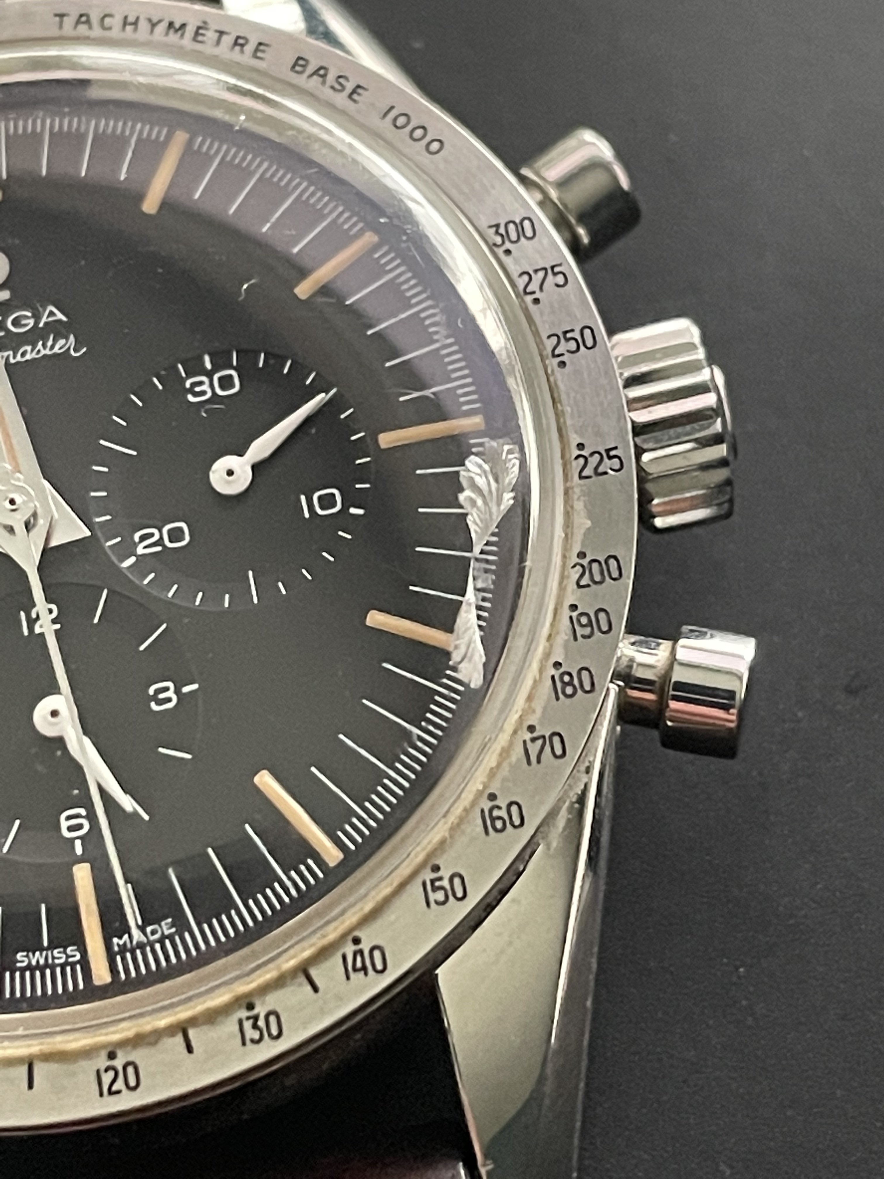

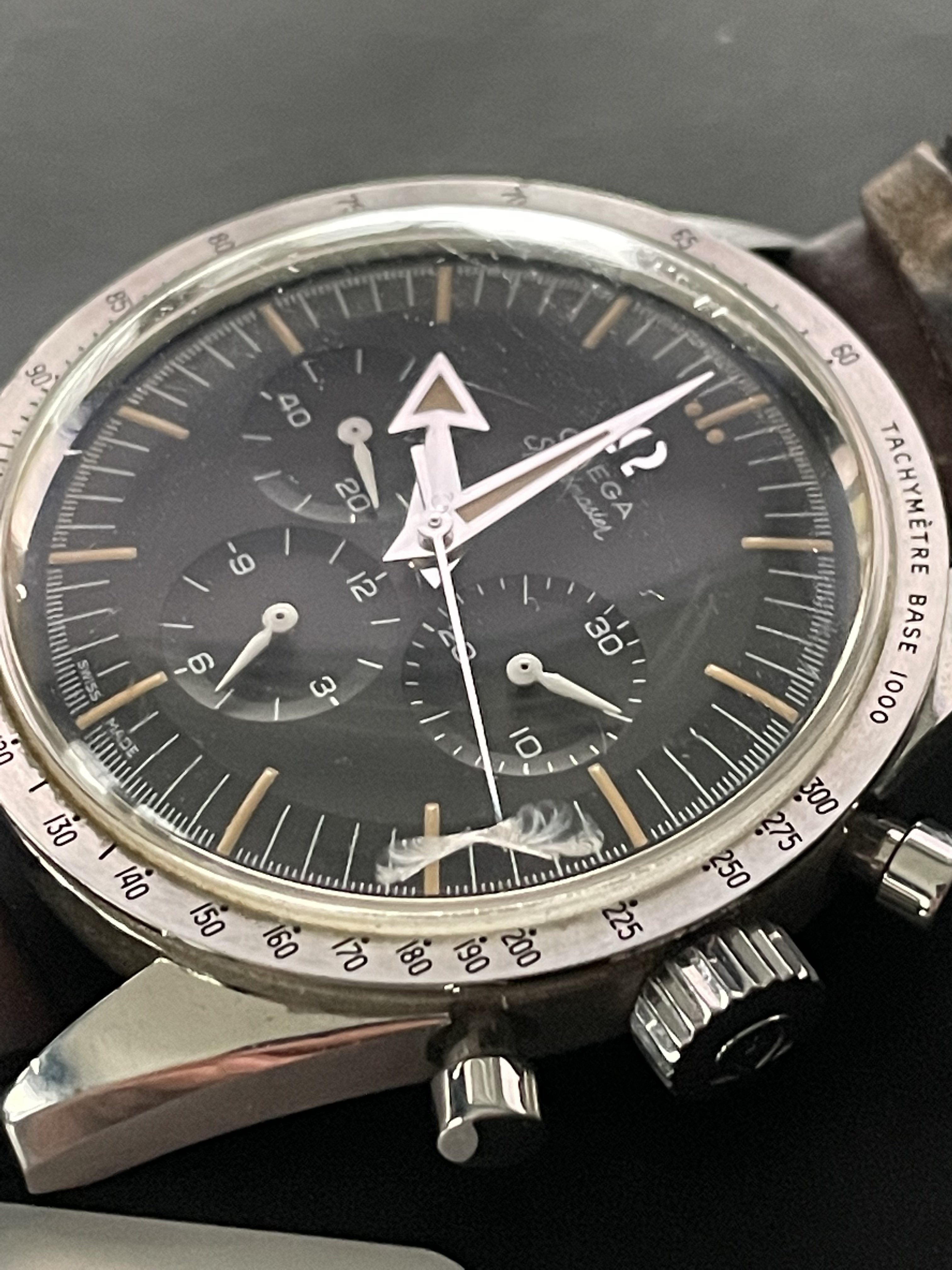

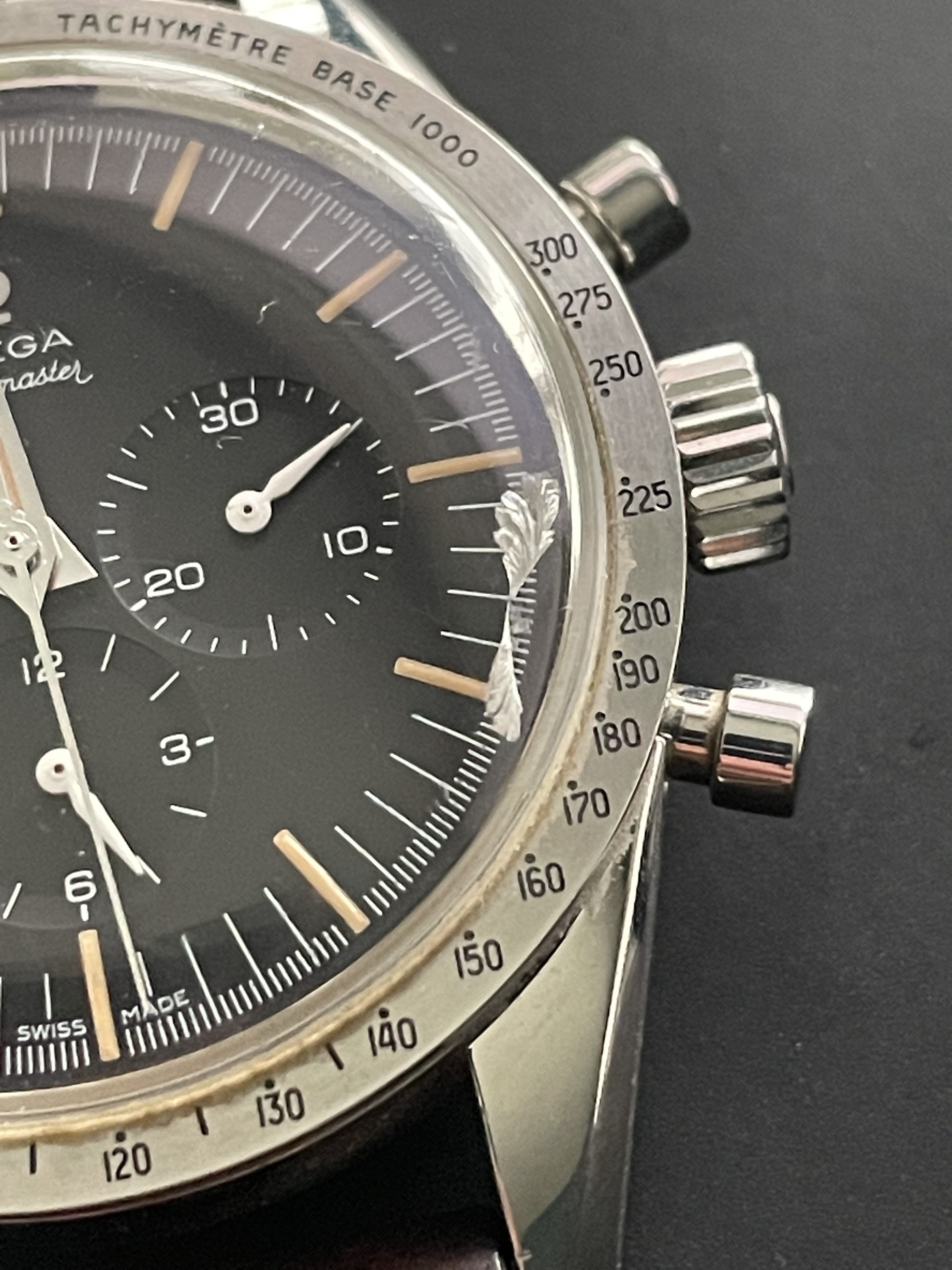

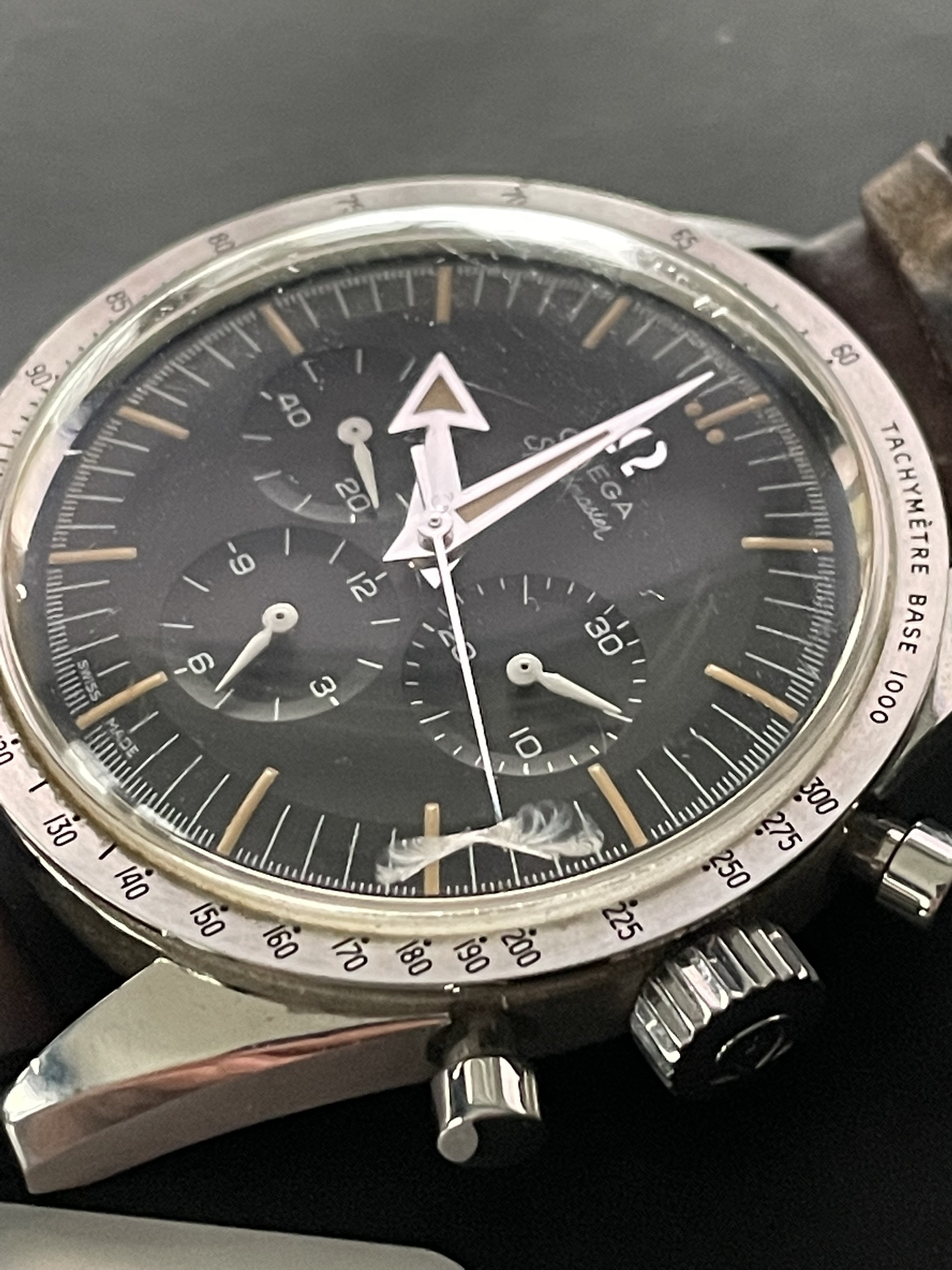

Hey guys, I recently dropped my speedmaster which is only 2 years old 🙁, and it landed on it's bezel at 6..
It's still able to keep time but when I use the chronograph and the minute hand is between 20-35 minutes, the chrono hand will get stuck behind the minute hand and the watch will stop running (including the seconds hand)
Will this be a simple repair that won't require a service, hopefully I can get it repaired under warranty?
Thanks
This will not be covered under warranty(99% sure). It will most likely show ‘shock/impact damage’ on the interior of there is exterior damage. Swatch group does have a 2 year service warranty though. It will most likely take at least 2 months for repair; parts delivery has been terrible.
9
7
I would be surprised if you could claim under warranty. There is not much they will not have seen before and will have a fair idea of what causes what damage. One possible avenue could be claiming on your house insurance IF you have the relevant cover in place. Take it to an Omega dealer, be honest and see what if anything they can do. Maybe its your lucky day and they will sort under good will. If not and
it's expensive, look into that claim.
Bingo. The watchmaker will have seen this and similar symptoms before: dinged bezel, clashing hands, bent balance staff, etc. I’d agree: be straight up with Omega, let them fix it properly, then talk to your homeowner’s insurer. Besides: if Omega detects you’re trying to take advantage, you’ll no longer be able to expect any ‘good will’ from them.

Well it happened to me yesterday. I dropped my 60th anniversary speedmaster onto a tile floor. It’s running fine but I cracked the crystal.
@Archer - do you know the part number for a crystal for the 60th case? Can I trouble you for that information please?
It’s definitely gonna bother me to look at that all time.
Thanks
30,230
78,057
063PZZ007755
Thanks
Ouch, yes that definitely needs an intervention to replace the crystal. I make it a hard and fast rule that anytime I put on/take off a watch it is always over a surface where it wouldn't fall more than a foot or two, and never over a hard surface. Stuff can happen even if it has a deployant buckle. So far I haven't damaged a watch yet.
