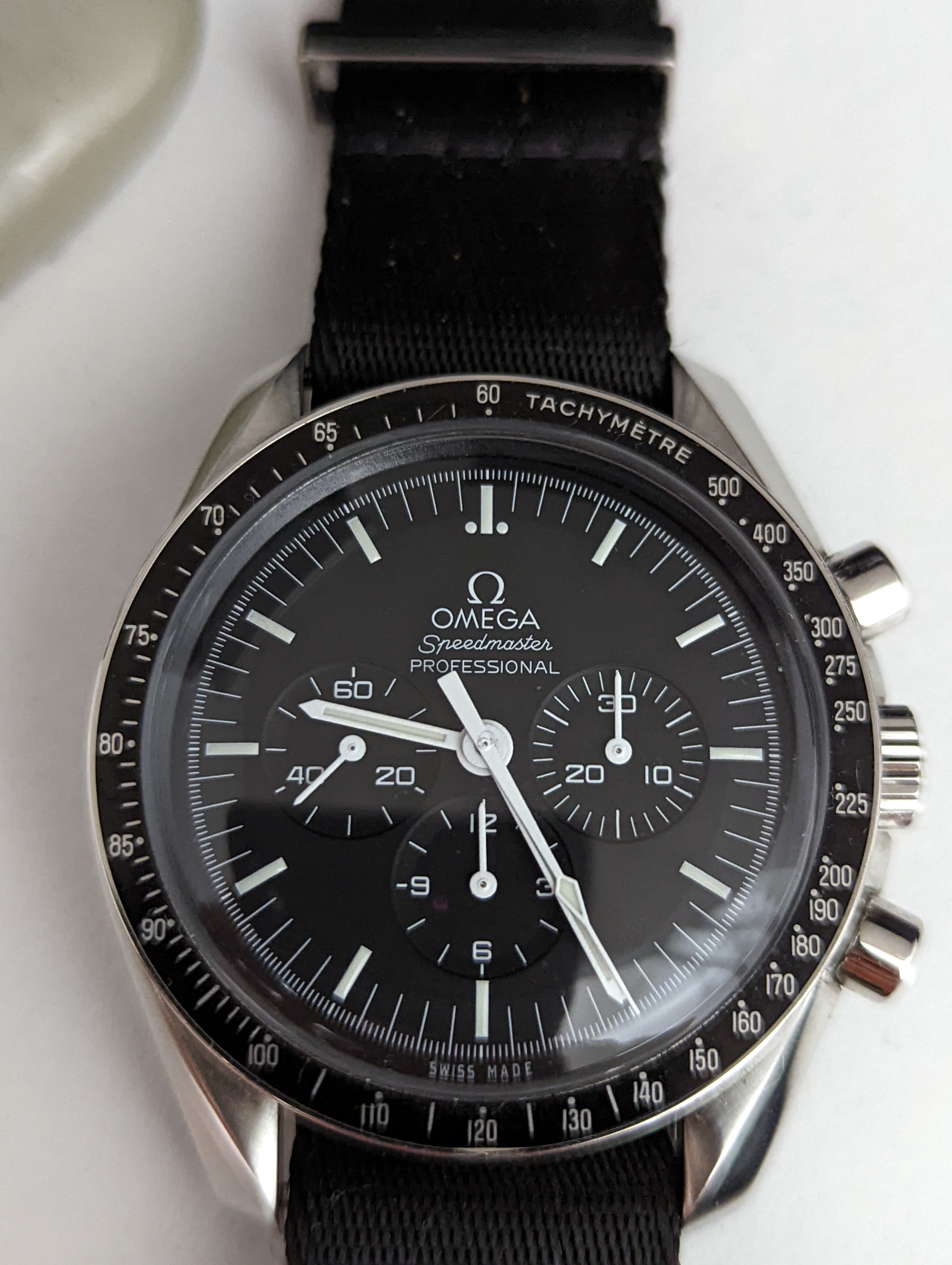

Hey guys, I recently dropped my speedmaster which is only 2 years old 🙁, and it landed on it's bezel at 6..
It's still able to keep time but when I use the chronograph and the minute hand is between 20-35 minutes, the chrono hand will get stuck behind the minute hand and the watch will stop running (including the seconds hand)
Will this be a simple repair that won't require a service, hopefully I can get it repaired under warranty?
Thanks

Warranty doesn't cover damage caused by owner so you'll have to pay for repairs. It might just be a simple adjustment of the hands to restore the proper clearance, or the posts may be bent. You won't know if there is any real damage until it is opened up and diagnosed.

Might get serviced under warranty if there is no evidence of a drop and you withhold that piece of info when you send it in and say “it just stopped working” but maybe not. It’s up to you (and karma) if you want to try that route. Personally, I’d just accept that it was my fault, find a local watchmaker who could do the work, and have it serviced and pay the price. From the description, I think a full service is probably warranted to make sure all potential damage is fixed.

The thing I'd be worried about, if this was my watch, would be voiding the warranty taking it to a local watchmaker, especially since they still have 3 years left of their warranty. I agree with Donn and get it serviced since you are noticing issues with the watch after the drop.

I would be surprised if you could claim under warranty. There is not much they will not have seen before and will have a fair idea of what causes what damage. One possible avenue could be claiming on your house insurance IF you have the relevant cover in place. Take it to an Omega dealer, be honest and see what if anything they can do. Maybe its your lucky day and they will sort under good will. If not and
it's expensive, look into that claim.

It looks like you need a repair and a replacement bezel. It's unfortunate, but when you damage something accidentally, you normally have to pay for it to be repaired or replaced, unless you have insurance. So those are your two options IMO ... paying cash or making an insurance claim. You can look into your homeowners insurance, but if it's anything like mine, the deductible will make a claim impractical. Since the watch is so new, I would personally take it to an AD/OB or send it directly to an Omega service center.

I had a close friend come to me after dropping his relatively new Breitling which had a few issues from that. I said I wasn't willing to fix it as it needed some parts so would not be inexpensive but, I said the same to him about his house insurance. They covered the full £2.5k repair at Breitling so, this is definitely worth looking into.

Choices (imo):
Independent watchmaker: $450 plus parts plus maybe shipping, probably 1 year warranty
Swatch: $800 plus parts, 2 year warranty
seems Swatch is a little hit or miss on what parts they charge for though

You dropped it you have to pay, this is not a warranty problem.
You need a service and not a quick fix.
Hoping you can get it repaired under warranty is like asking for a car to be fixed under warranty when you just hit a tree 😗
