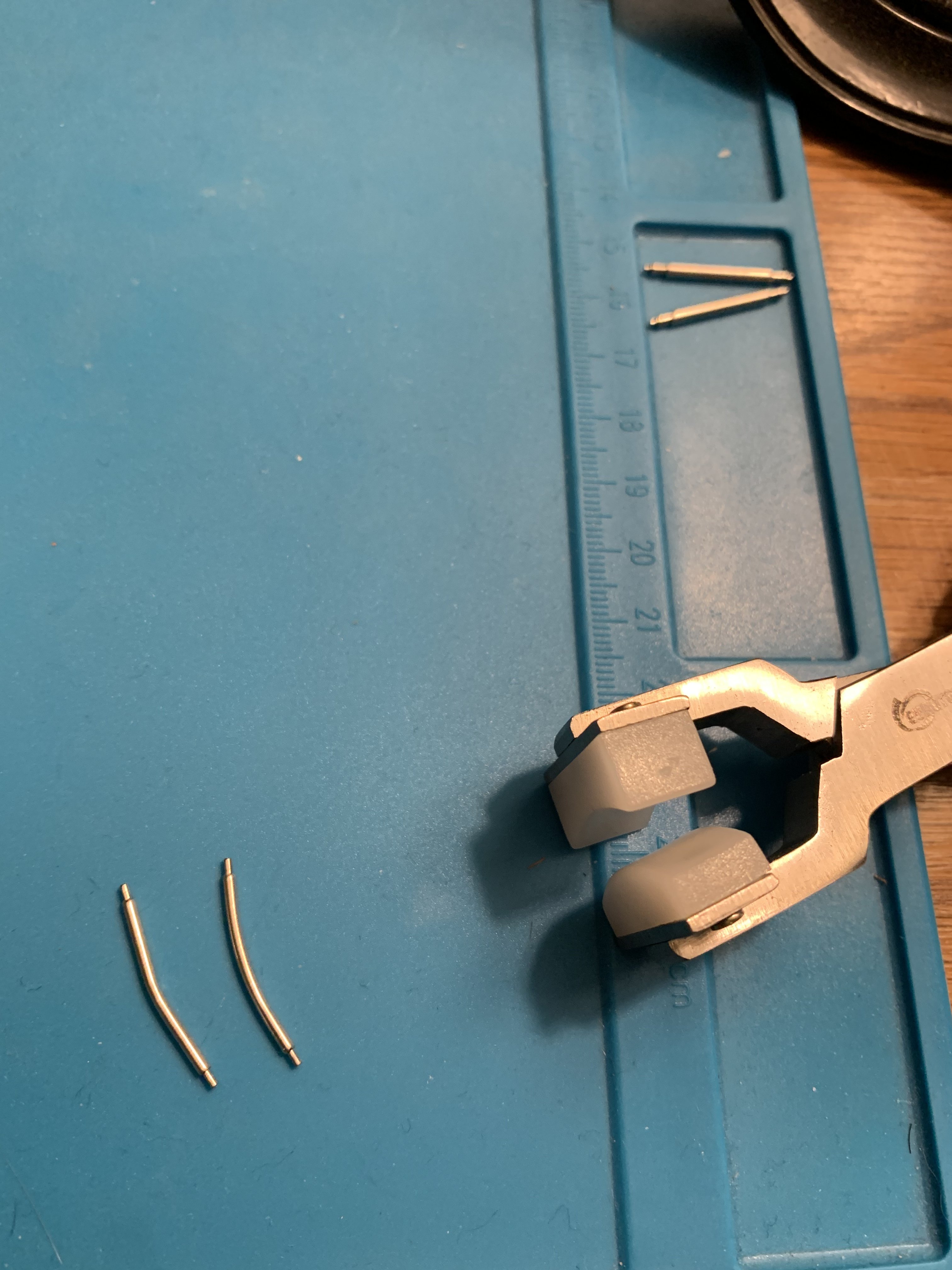

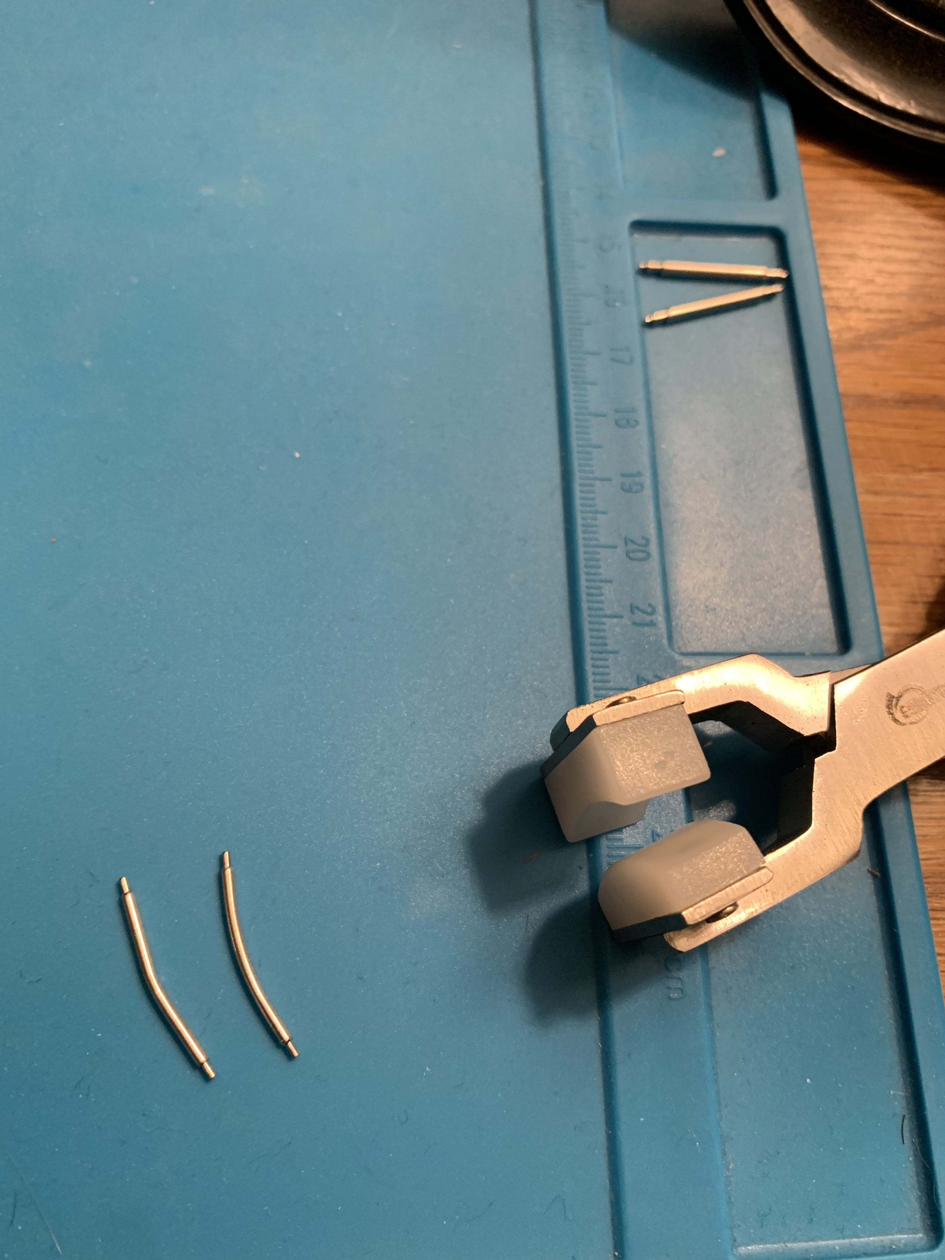

Update.
I have found a tool that works amazing for this. You can see in the picture below my before and after, trying to curve the spring bar with a spoon and then this tool. It works wonders. It’s about $15 usd plus $5 shipping. www.esslinger.com
666
2,250

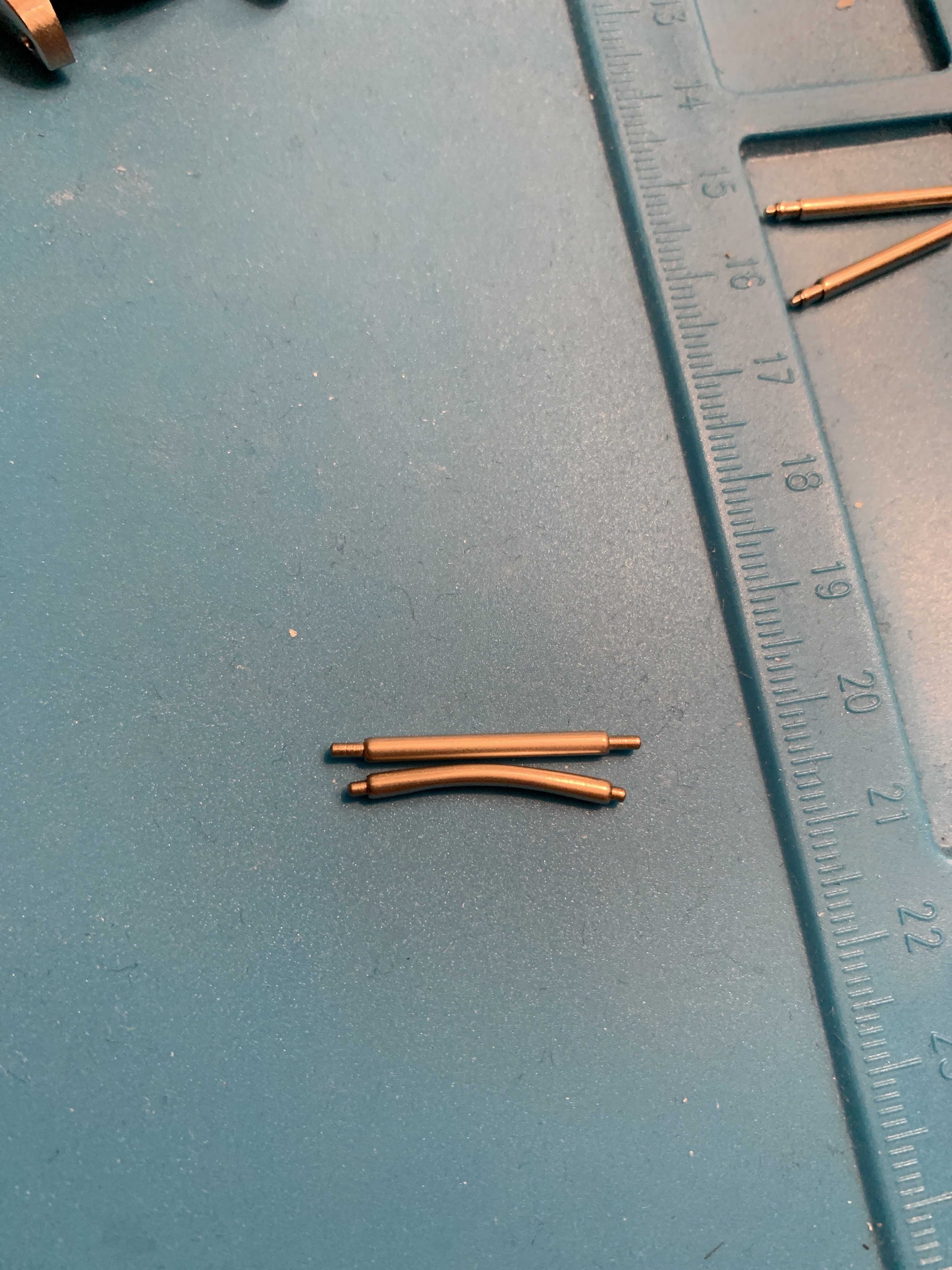

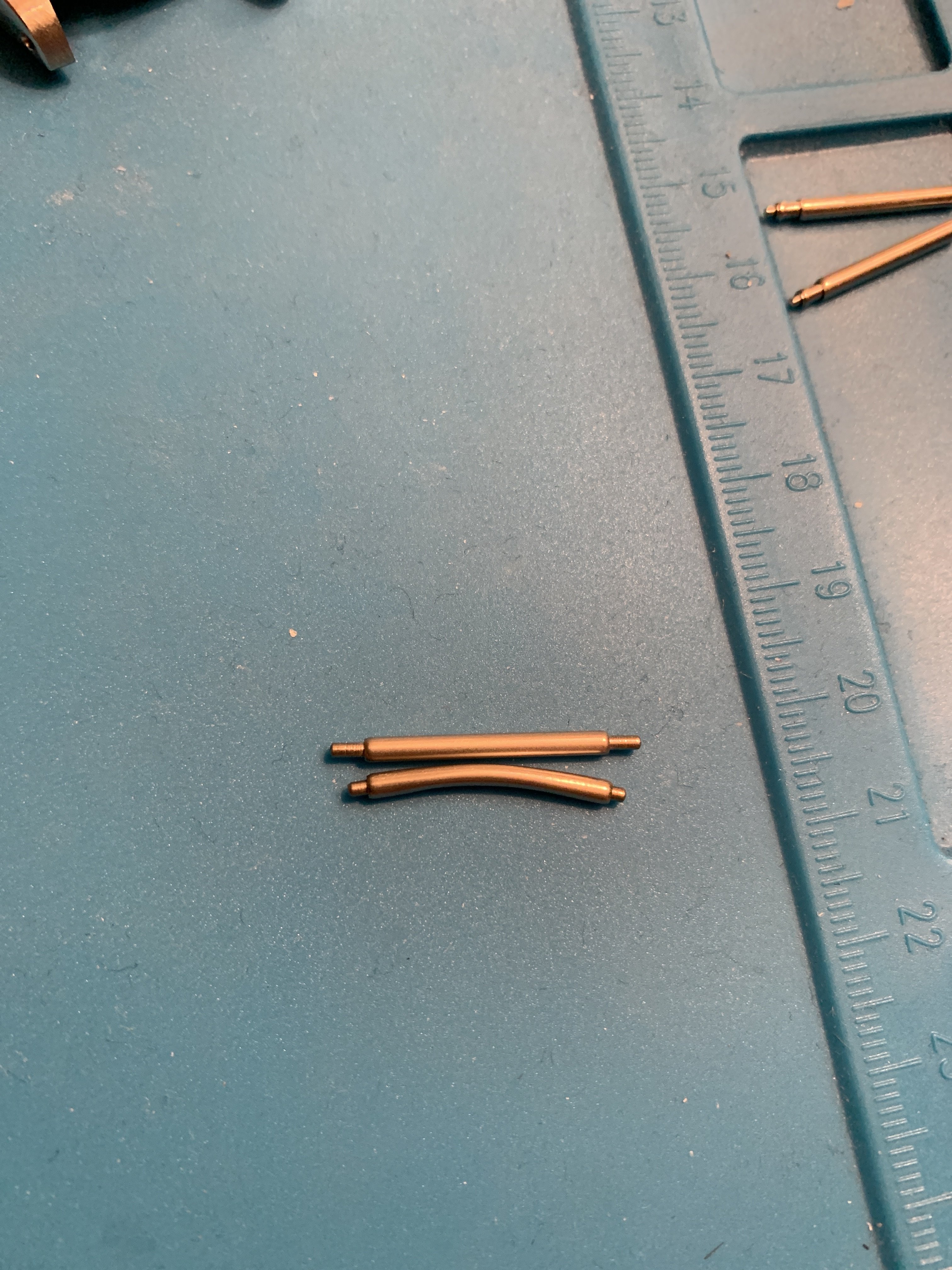

Update 2,
While this may be the spring bars that I’m using (non OEM). This tool seems to keep the spring from applying pressure after the bend. I’ve used 21mm for 20mm and they didn’t bend it enough to fit. Used 20mm and the ends wouldn’t extend fully.
666
2,250
Those are the same bars, one bent and one not. Not sure how to get a “flatter” entry from inside out?
