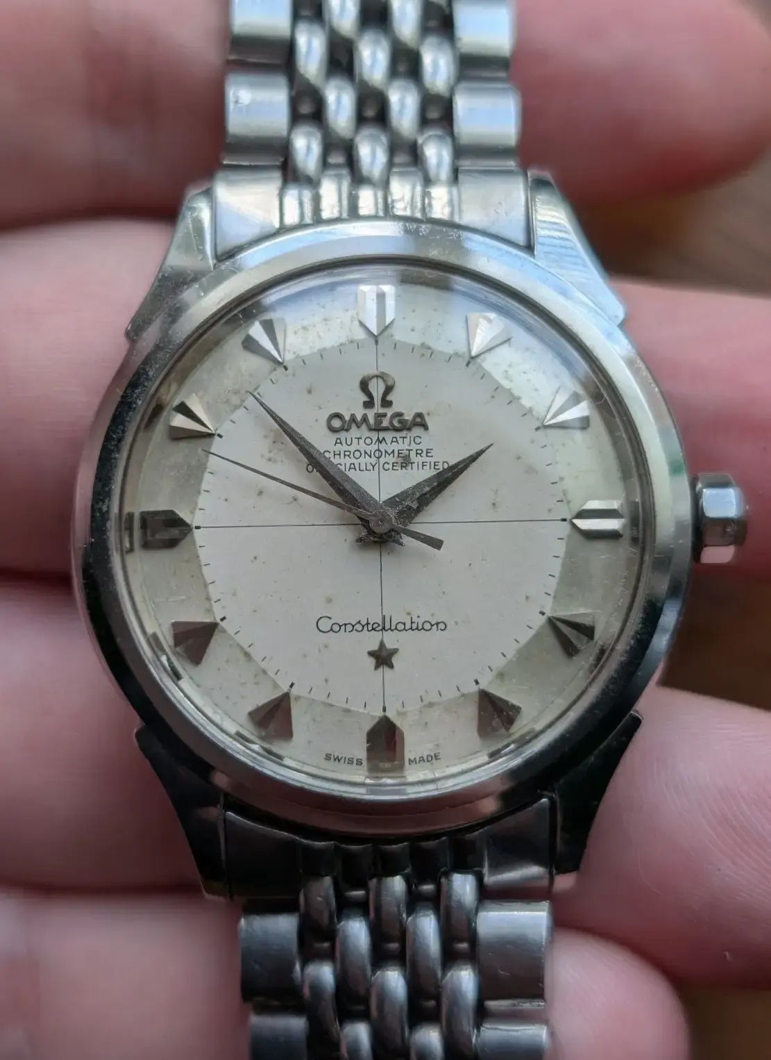

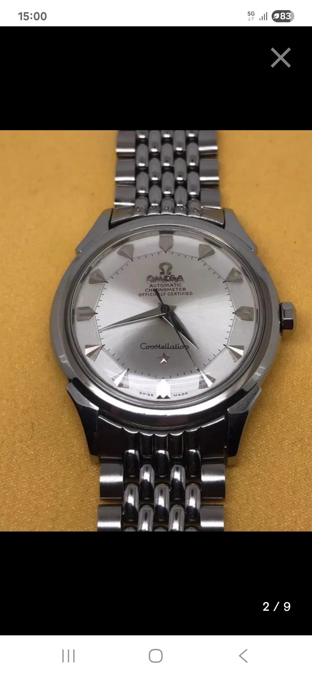

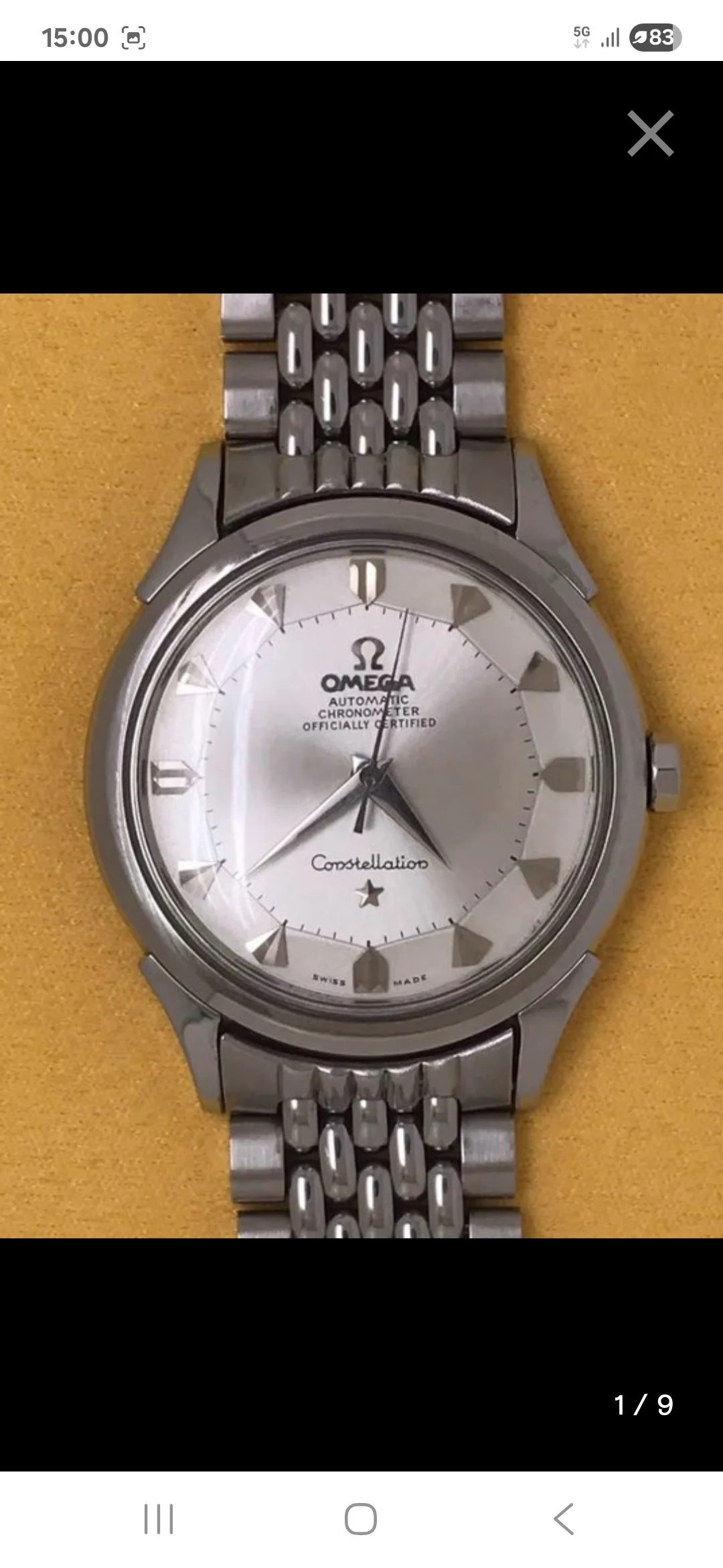

Posts 180 Likes 333 osterman ·Aug 16, 2025 Hi all. In an auction site there's for sale this nice 2852 with arrowhead makers. In the description it is stated that the dial has not been reprinted. However, I am quite doubtful. What is your kind opinion, please?

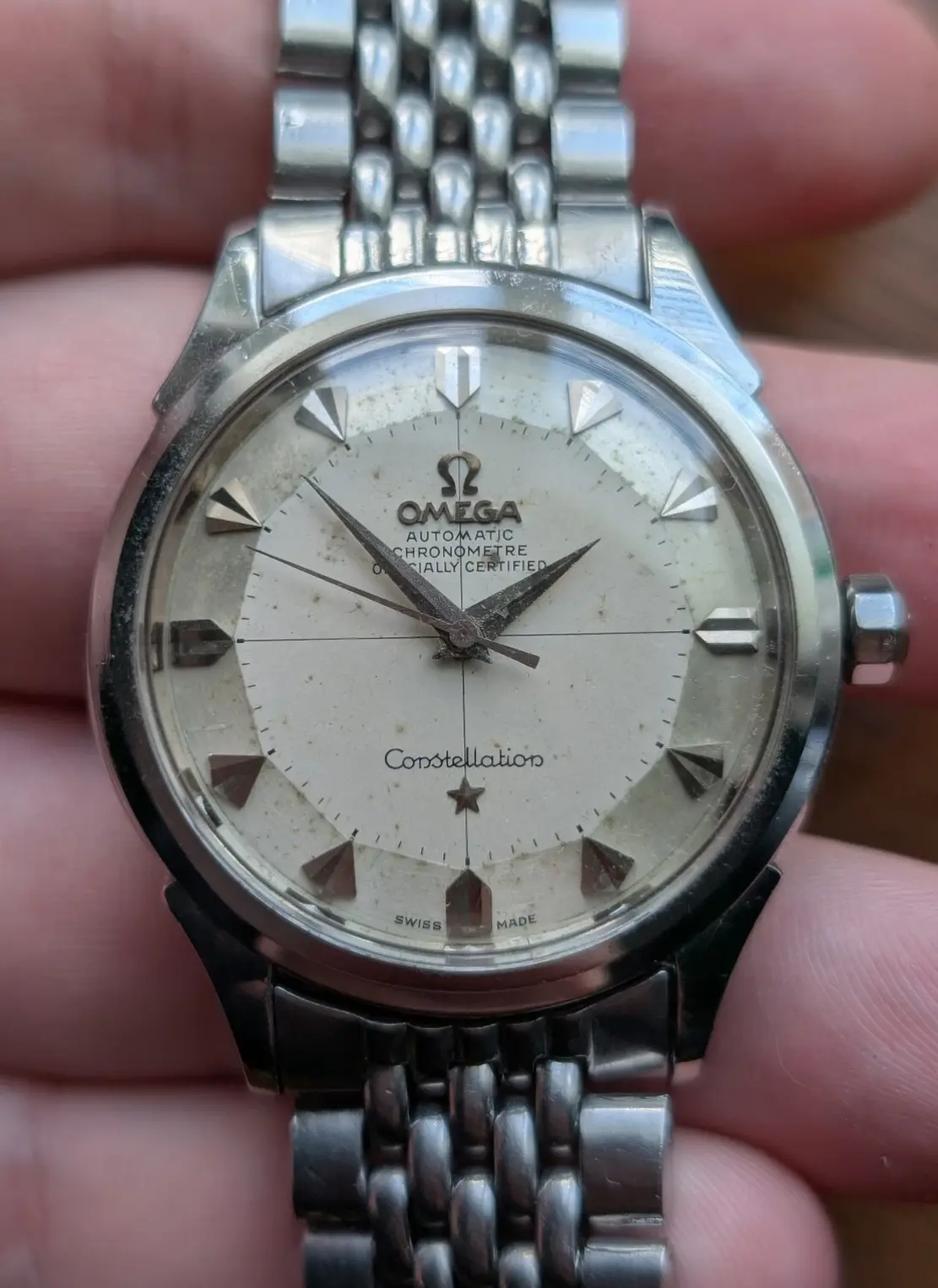

Posts 13,422 Likes 18,629 gatorcpa ·Aug 16, 2025·ΩF InvestiGator Redial for sure. Ref. 2852 dials have “Chronometre” spelling. Hands not correct either. Seller is either ignorant or trying to deceive. gatorcpa
Posts 13,422 Likes 18,629 gatorcpa ·Aug 16, 2025·ΩF InvestiGator Here’s the same watch with an original dial in the typical condition you will encounter in the wild. https://ebay.us/m/S60bS7 gatorcpa
Posts 180 Likes 333 osterman ·Aug 16, 2025 Thank you very much. In fact I didn't notice the spelling. Good to know.
Posts 830 Likes 1,161 theluckyluke ·Aug 16, 2025 I think there are some late examples with “Chronometer” but the “Officially certified” disappears.
Posts 8,618 Likes 61,345 TexOmega ·Aug 16, 2025 many things wrong with the OP dial, font, spacing, bold print style.....yuck
