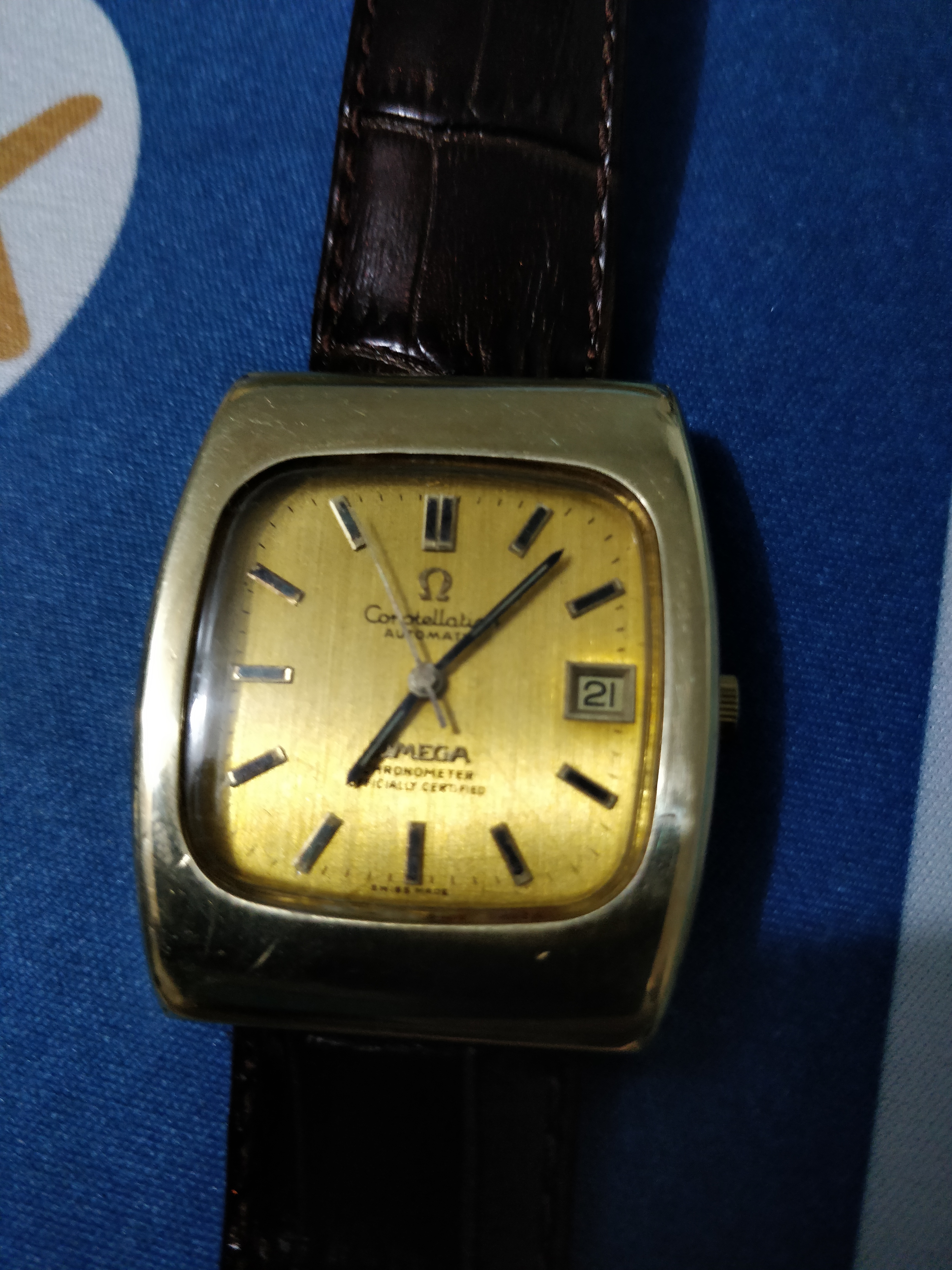

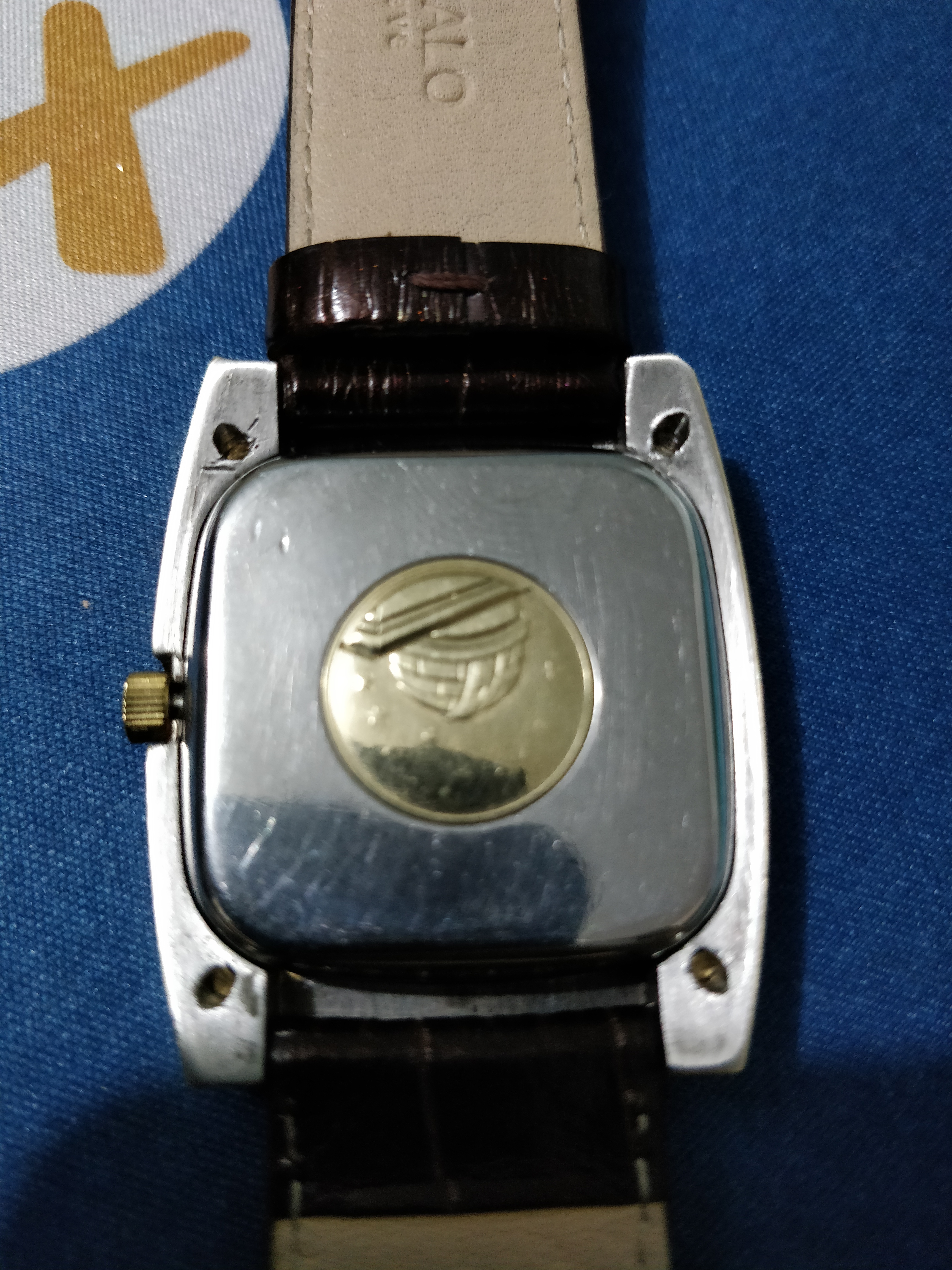

Hi! Can someone check if this is legit? It's an omega constellation ref. 168.044. Thanks!

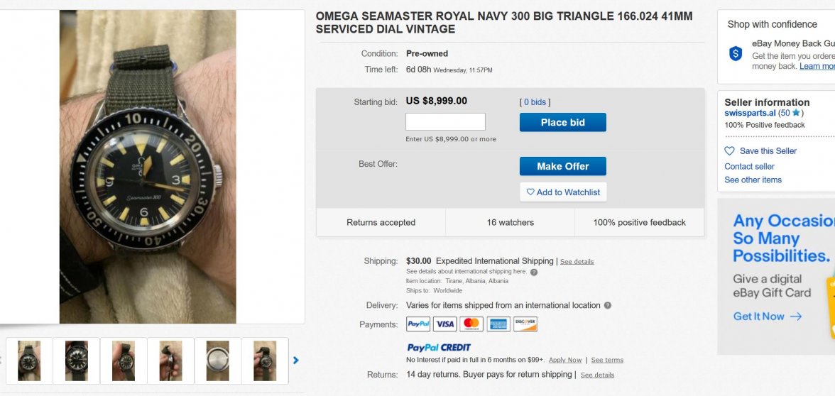

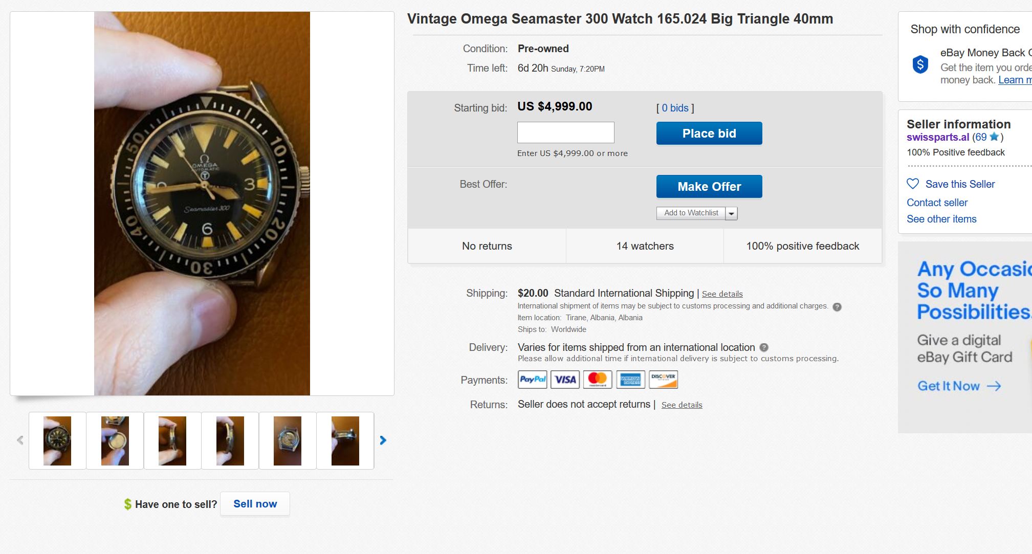

Fake Seamaster 300 "STUBBIES"
Seller swissparts.al (50 ) from Albania says it's all good but a "serviced" dial

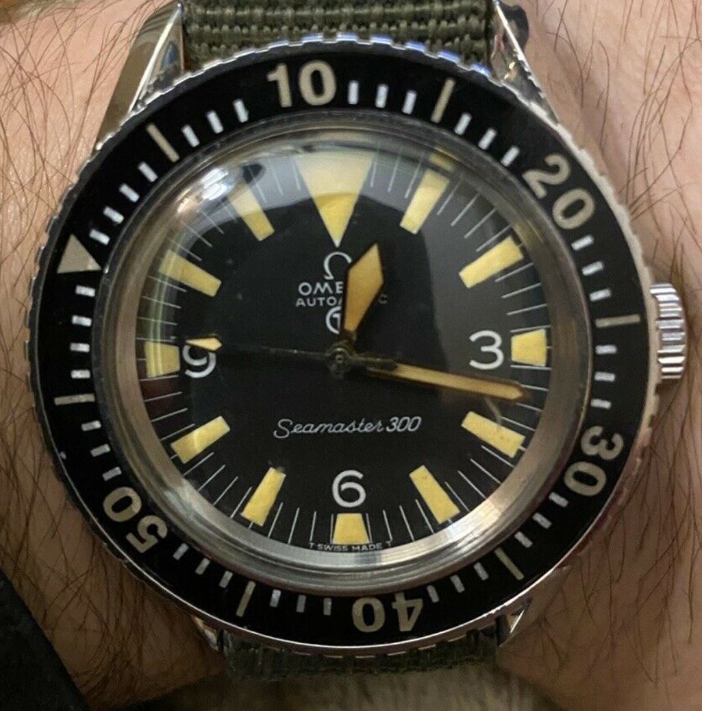

Typical fake stubbies dial
Fake hands
Typical fake bezel that goes with stubbies dial
Fake case to fit the fake bezel (real don't)

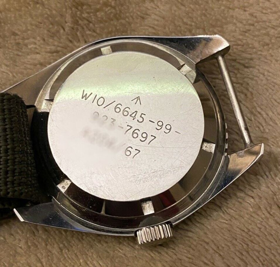

Fake caseback
Real poor omega 562 (!) movement that was never in a british military watch !!
https://www.ebay.com/itm/OMEGA-SEAMASTER-ROYAL-NAVY-300-BIG-TRIANGLE-166-024-41MM-SERVICED-DIAL-VINTAGE/223841522489?ssPageName=STRK:MEBIDX:IT&_trksid=p2060353.m1438.l2649
Good reference for Stubbies fakes: http://scubawatch.org/hallofshame.html

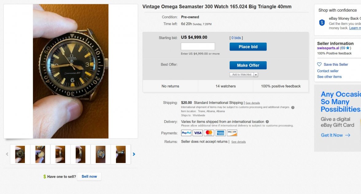

Fake Seamaster 300 (stubbies) again and again from Tirana, Albania
great seller !!
swissparts.al (69 )
https://www.ebay.com/itm/223954149292
