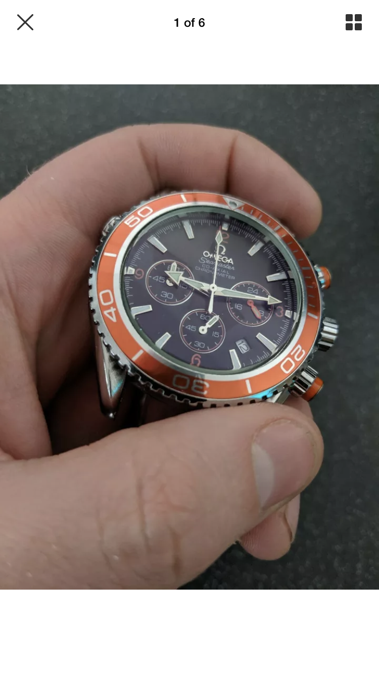

Trying to say it’s a homage!
Homage To Omega Watch Seamaster Dead Link/rover/0/0/0?mpre=https://www.ebay.co.uk/ulk/itm/113751527990
Yeah

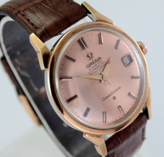

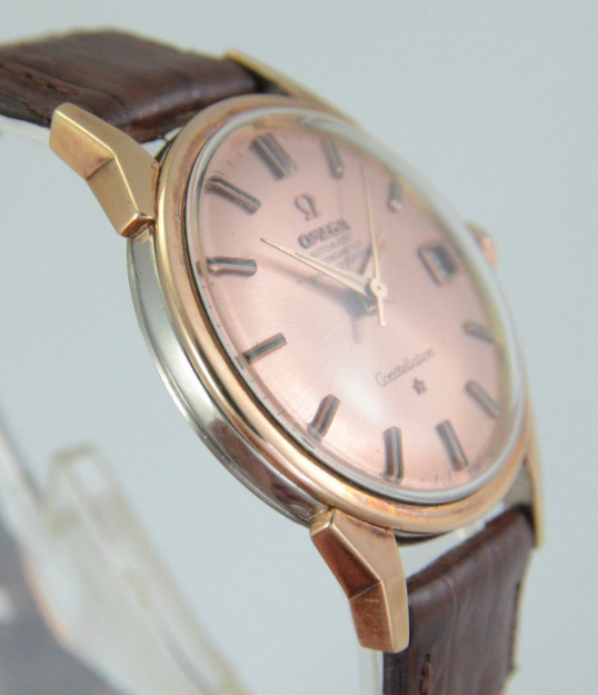

Not a fake but at this level with professional seller on chrono 24 it’s the same and a shame
Let me present you an « authentique » 105 003
Please note the littérature section on the certificat

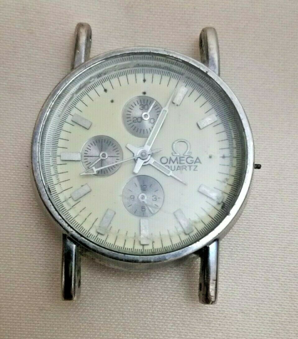

That’s some bad stuff, and incredible sad that people are bidding without doing any research. What sucks is they will realIze they got burned at some point and scare them off from enjoying the hobby further

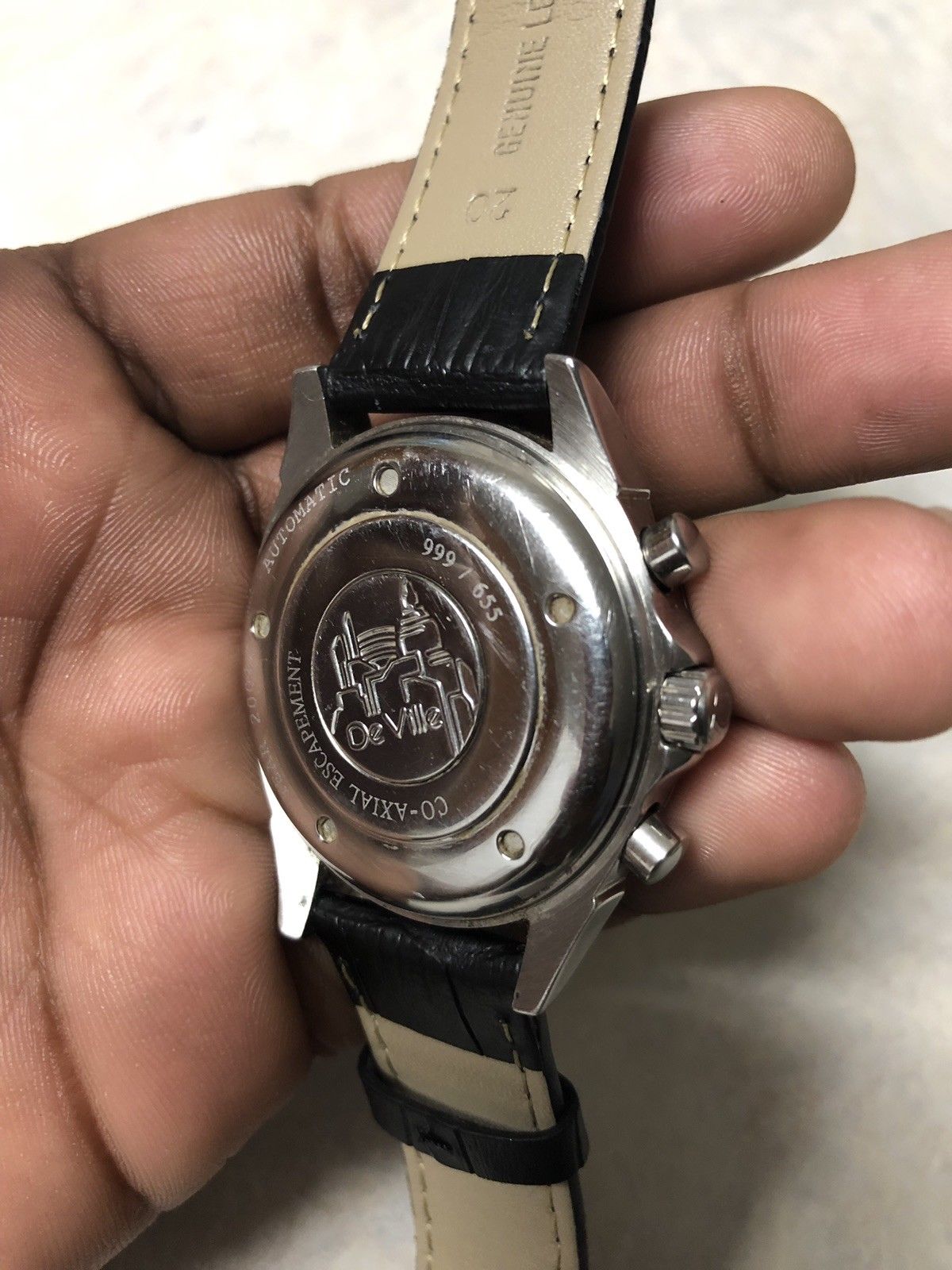

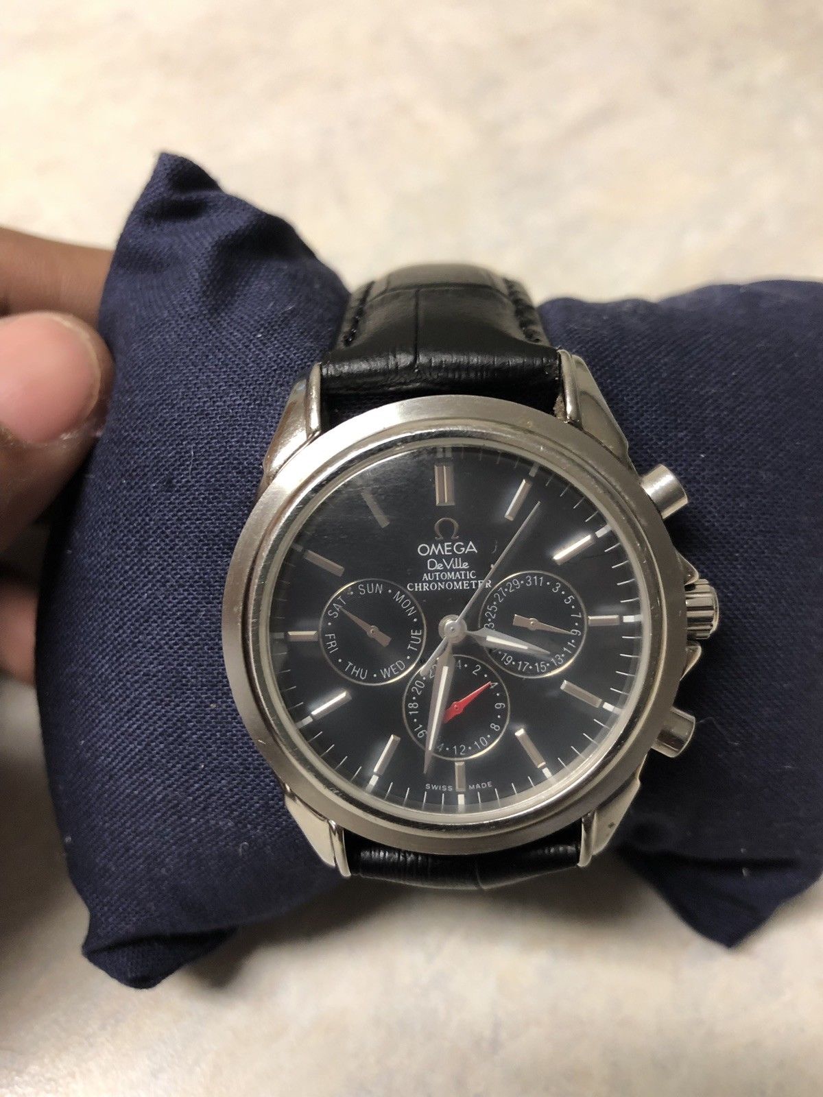

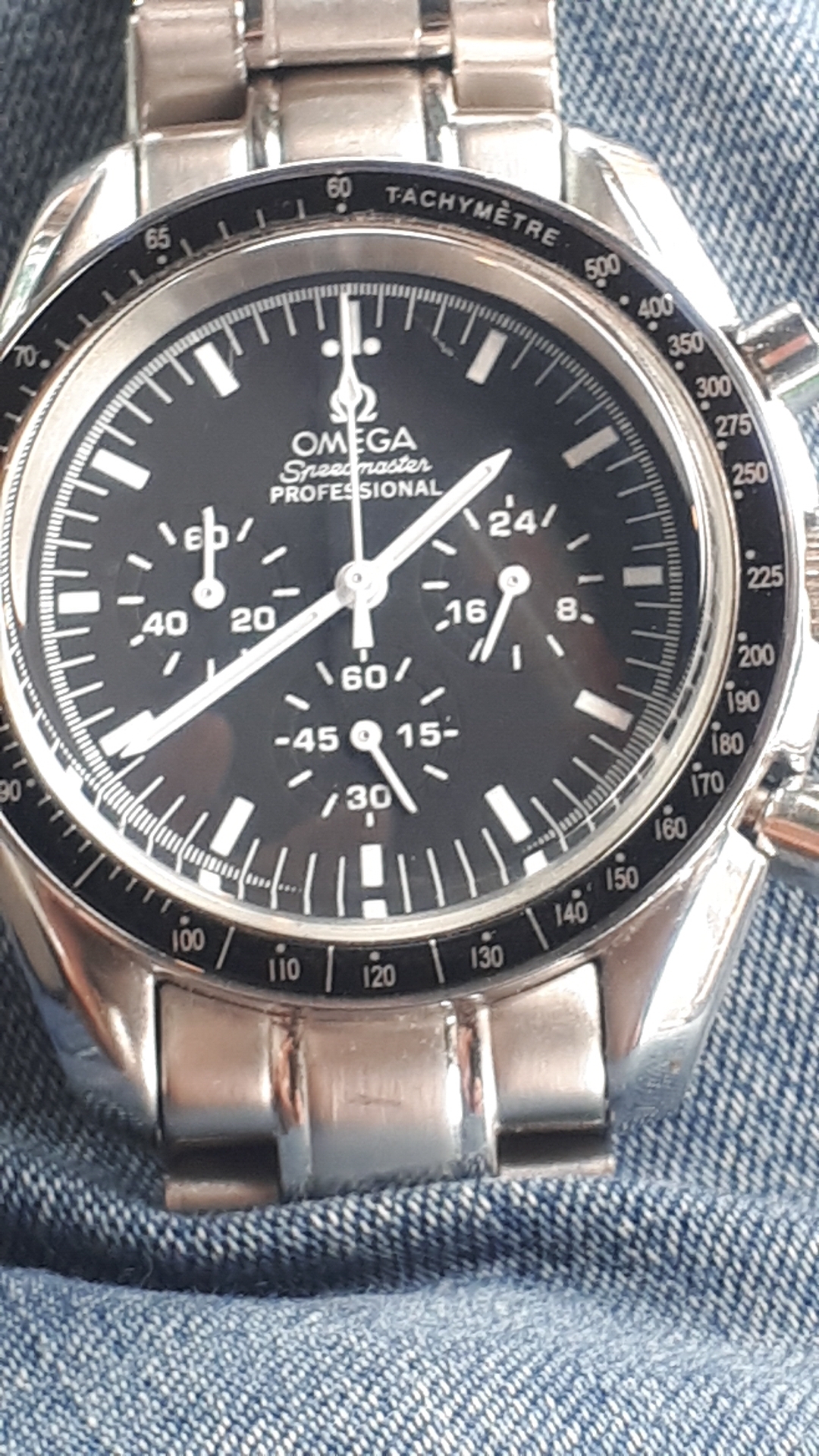

I hope this is not Fugazi
If you’re asking, you want to make a new thread in the modern omega forum for the inquiry. This thread is for known fakes to warn others.

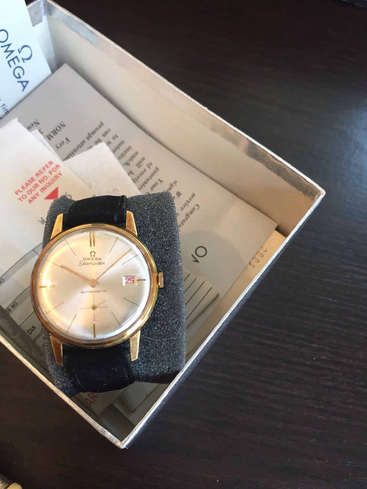

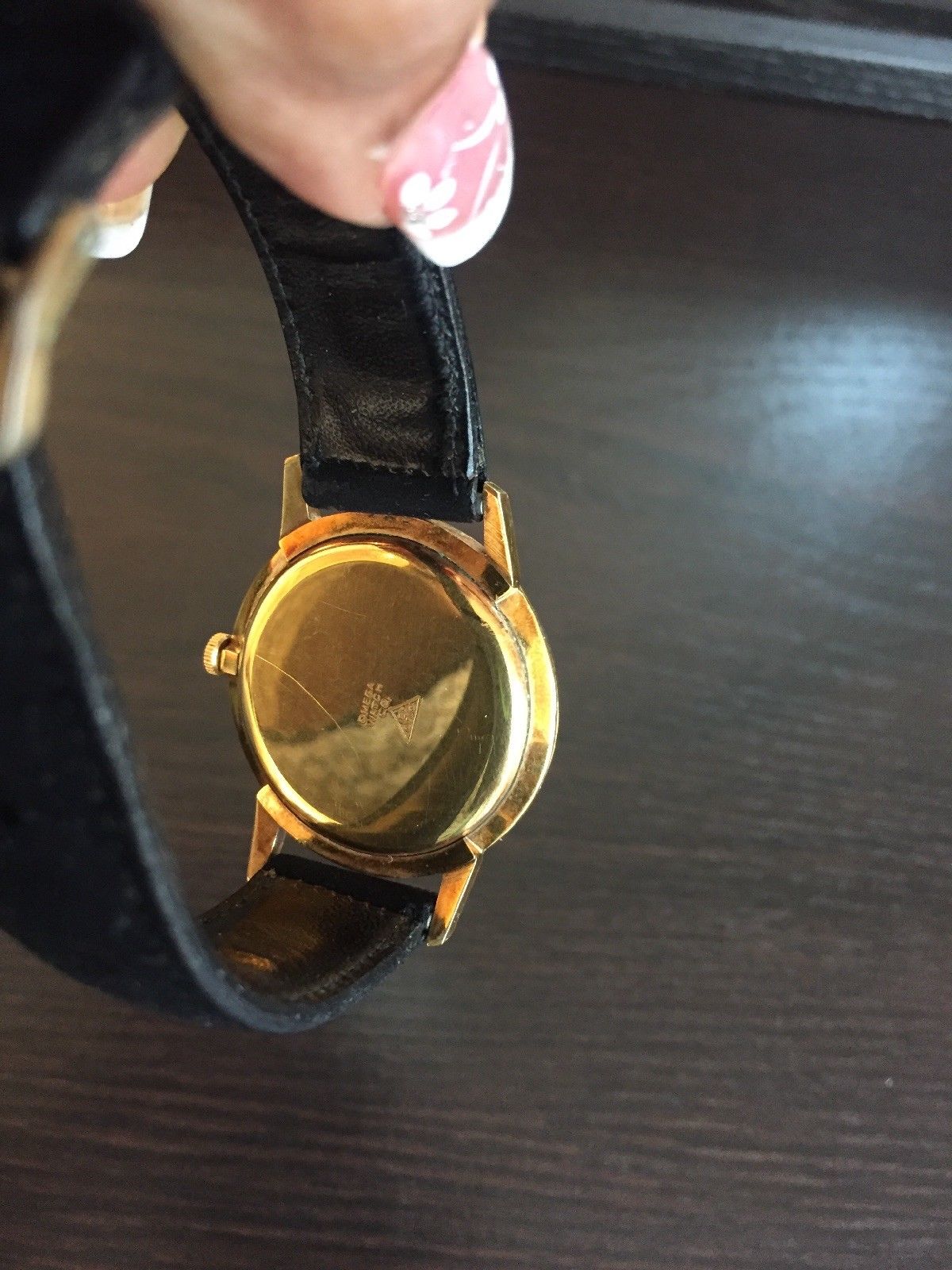

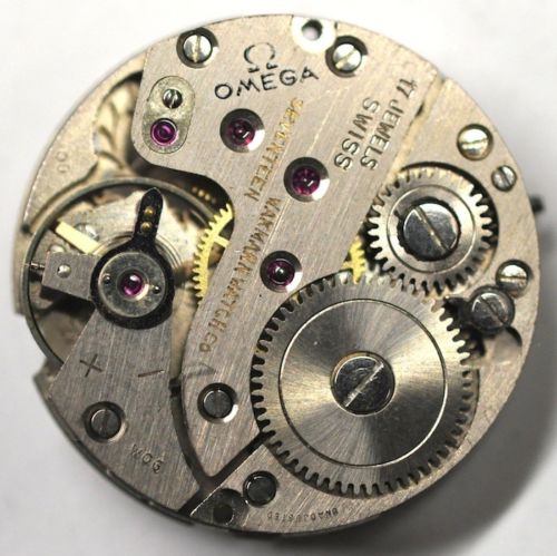

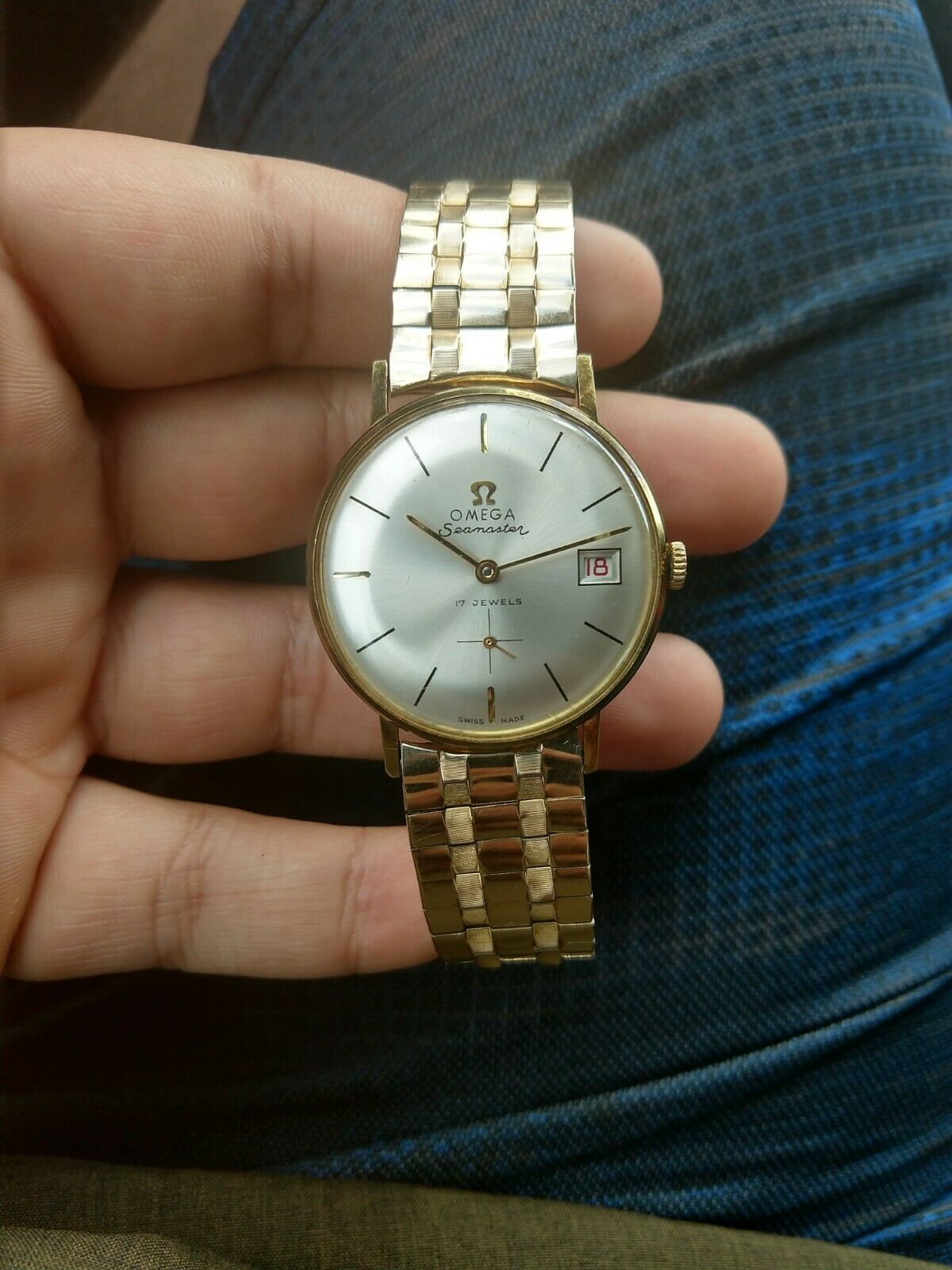

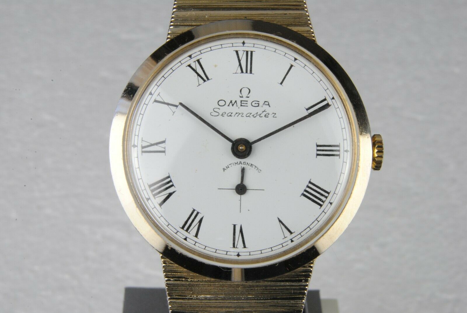

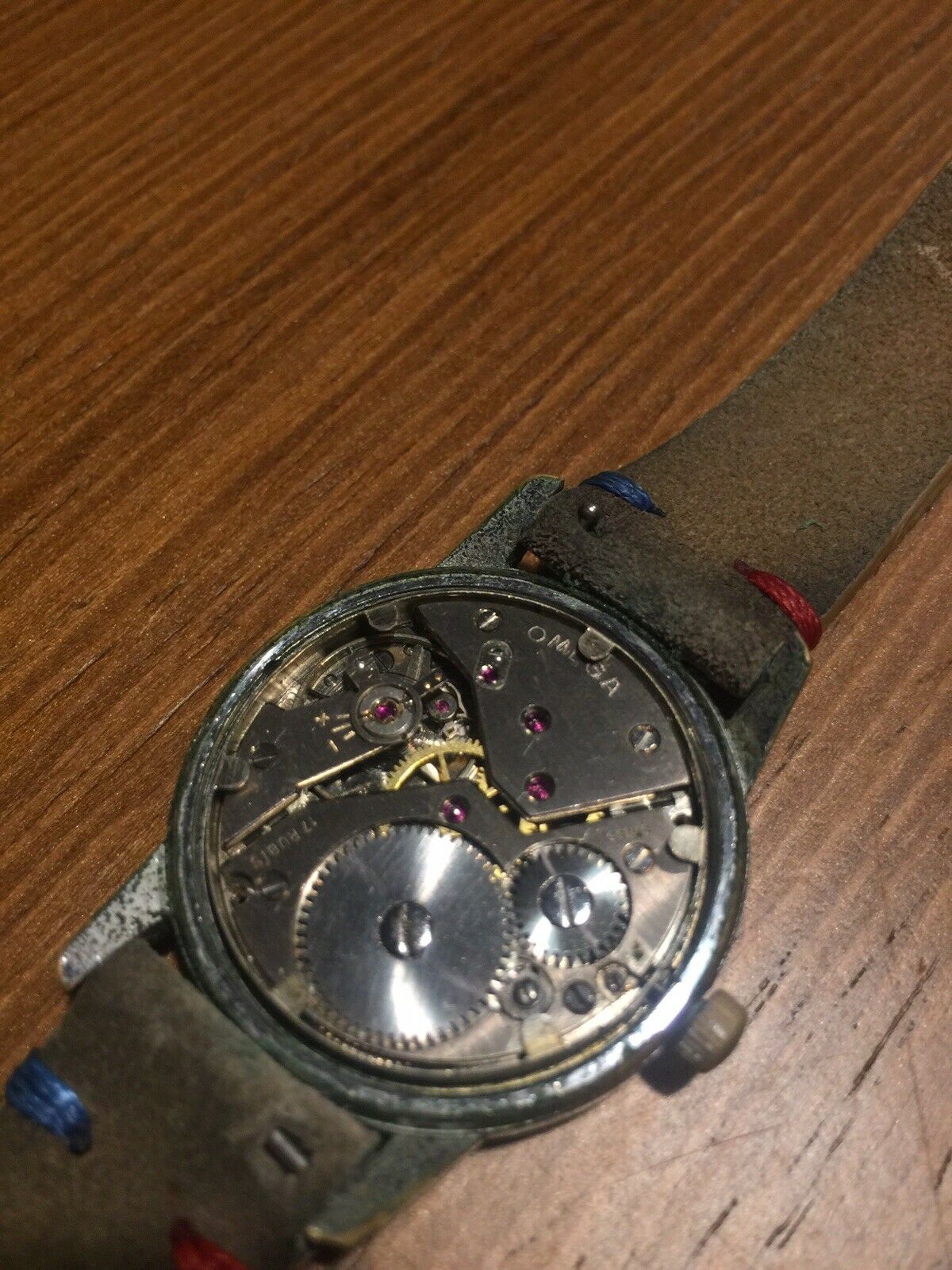

Here are some tips to help you avoid purchasing a fake vintage Omega.

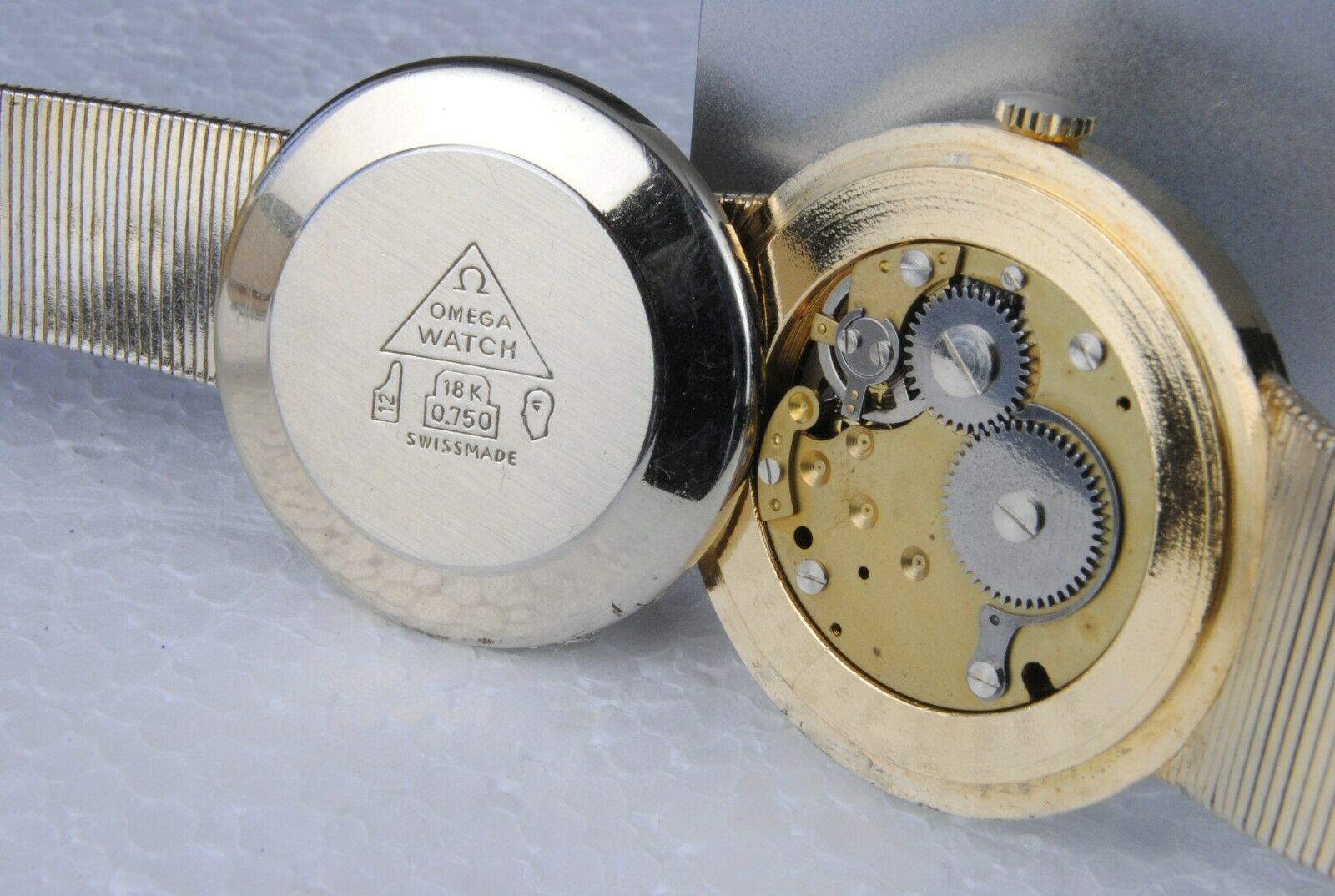

Here's a classic fake Seamaster:
First, you won't find "antimagnetic" or a jewel count on the dial of any Seamaster. Second, that's one crappy movement. Omega copper plated their movements since the word Seamaster has been used on the dial. Third, Omega never put the hallmarks (like the Ω WATCH Co inside the triangle or the 18K 0.750) you see on this watch's caseback on the outside - they were always on the inside.
Thread it came from: http://omegaforums.net/threads/seamaster-elecromagnetic.6234/

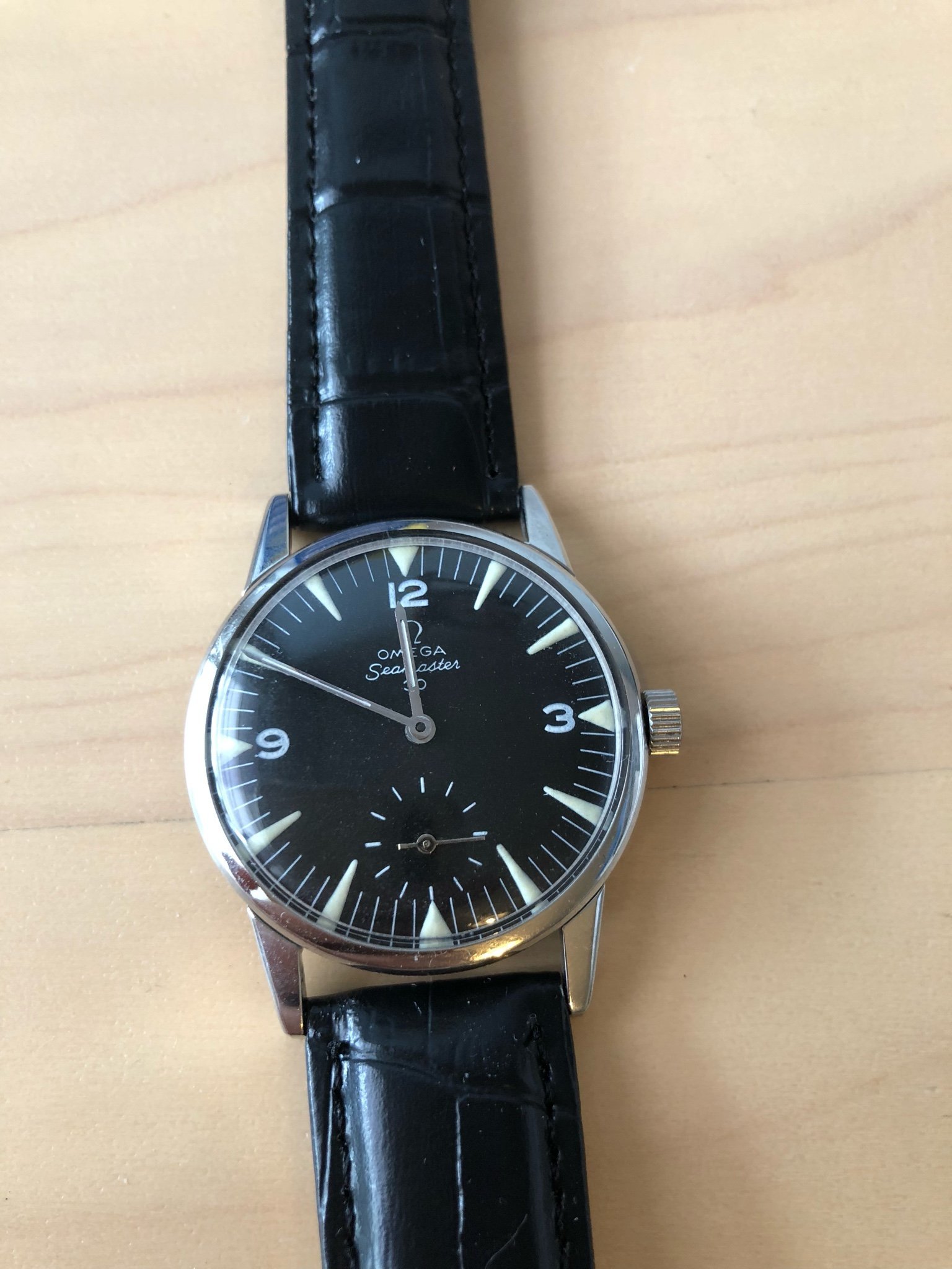

Here's another example in a different case:
The thread it came from:
http://omegaforums.net/threads/seamaster-not-found.6152/
Bottom line: ASK BEFORE YOU BUY! Part of the reason this forum exists is to help less experienced people buy decent vintage watches without getting ripped off. We don't even charge! It's a FREE service!
