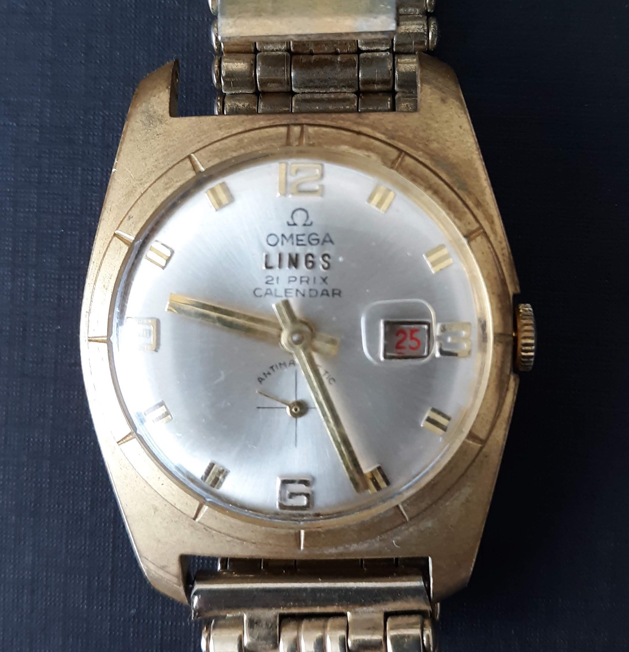

The De Luxe version of the first watch Dennis Posted.
http://www.ebay.com/itm/261253673313
That’s a LINGS $50 pin pallet « 21 Prix » (looks like « 21 rubis » from a distance) masquerading as an Omega. They also made chronostops that look like real chronographs which people sometimes pay silly money for.

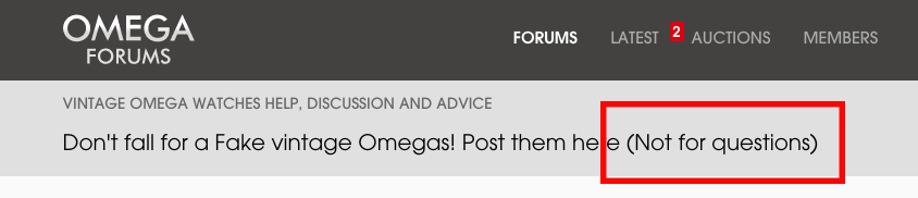

Please come back when you've learned to read.

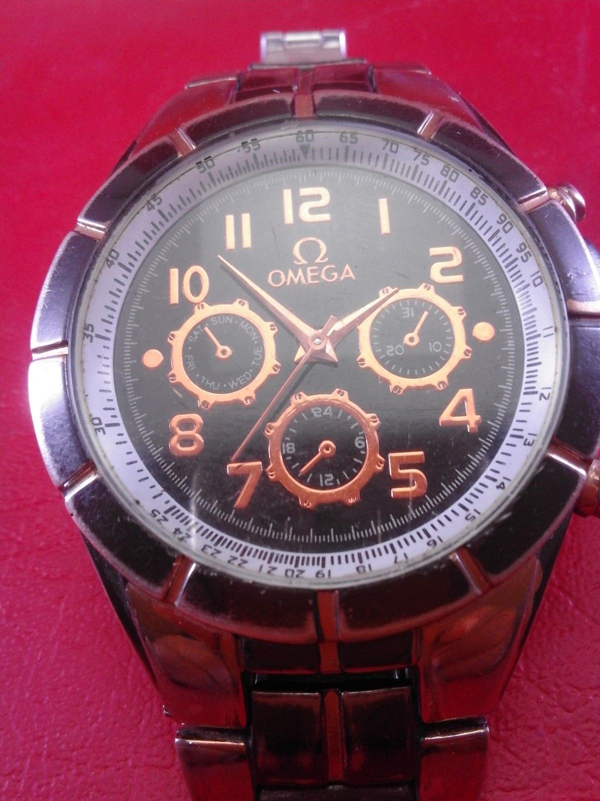

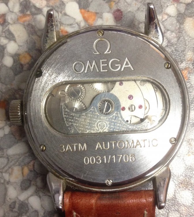

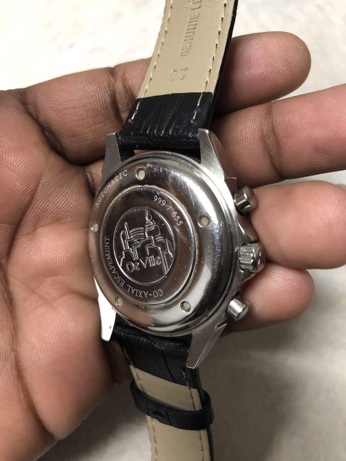

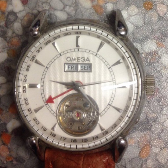

I almost feel like if any unwitting buyer falls for some of these (at least the ones on this page), they deserve it. These are so egregiously fake!

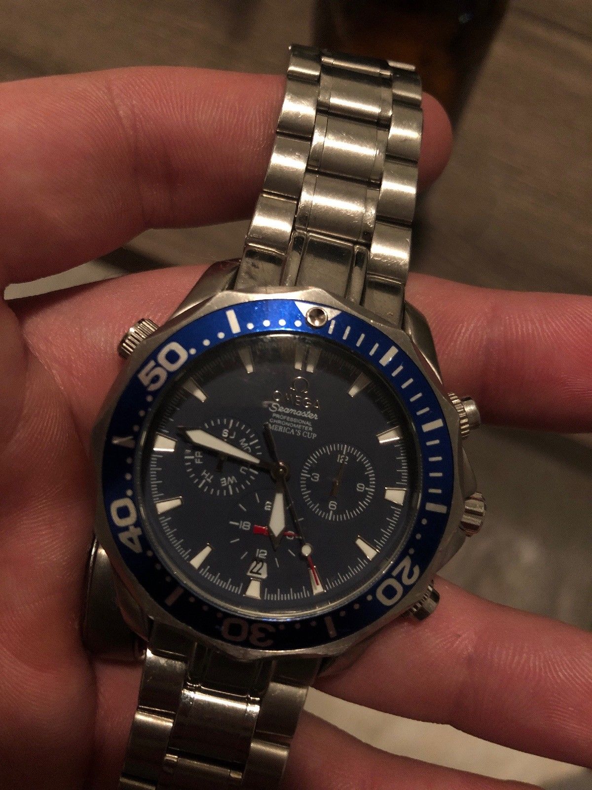

@Foo2rama i could be wrong here, but the helium escape looks far too low. The spacing between the bottom right lug and the end link looks too far apart. Also the 30 minute marker is properly aligned on the bezel and dial, but at the 12 it is too far to the right, not properly aligned.
