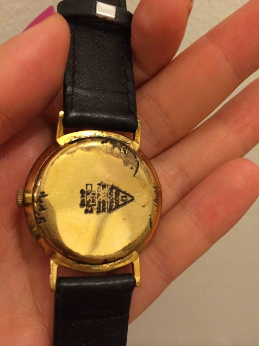

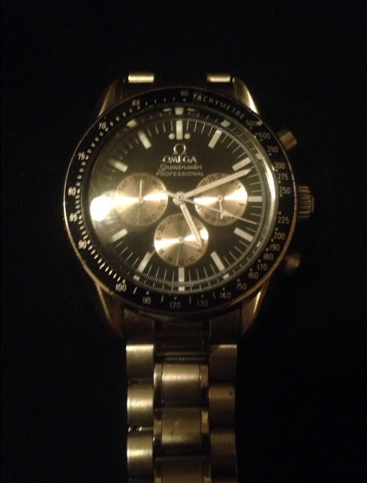

I almost got caught last year..... here the pictures:
omega2-mr-jpg.9568
omega1-mr-jpg.9569
Thats the best fake so far I reckon 🙁
5,752
2,942
.......and at that time I am only two months to the game. If not got screamed by several experienced members in here at once I would buy the watch ::facepalm1::. I was sorely tempted.
178
95
Well I probably would have got caught last year! ... And owned it for years before someone told me "Sorry , But ...." 🤬

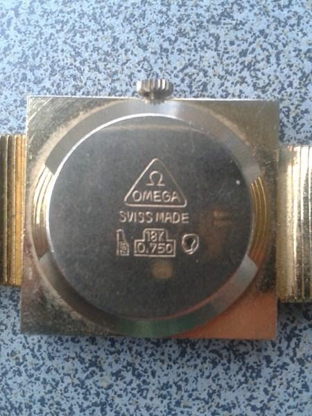

An obvious fake for sale on a Swiss site (reported). Or perhaps I should say " SVISS" site?

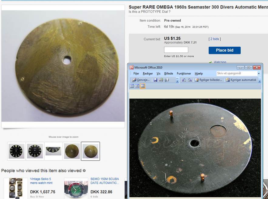

WatchCo is selling off a fake SM300 dial as a "rare prototype" dial :whipped: They really do or should know better than that.
Besides the obvious and normal tell tales as "stubbies" on the dial etc., the dial-back is a clear giveaway. Feet positions (what's left of them) does not fit a cal. 552 and there is no number engraving etc. Should be 68*552 (BT dial).
Take care and be aware.
http://www.ebay.com/itm/121432820683?ssPageName=STRK:MEBIDX:IT&fromMakeTrack=true
Auctioned dial-back on the left and a correct one on the right

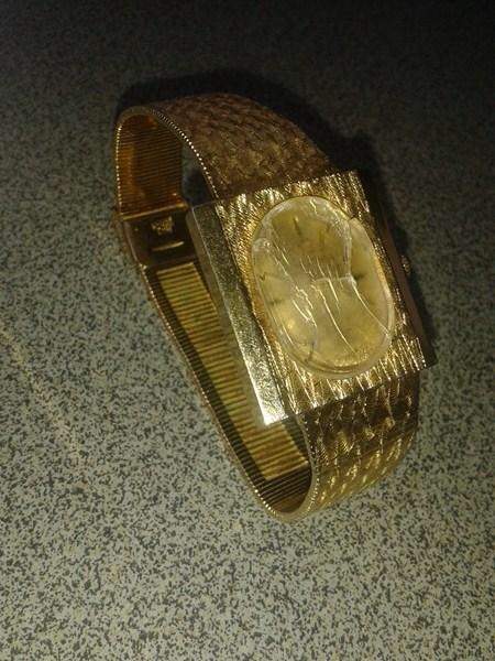

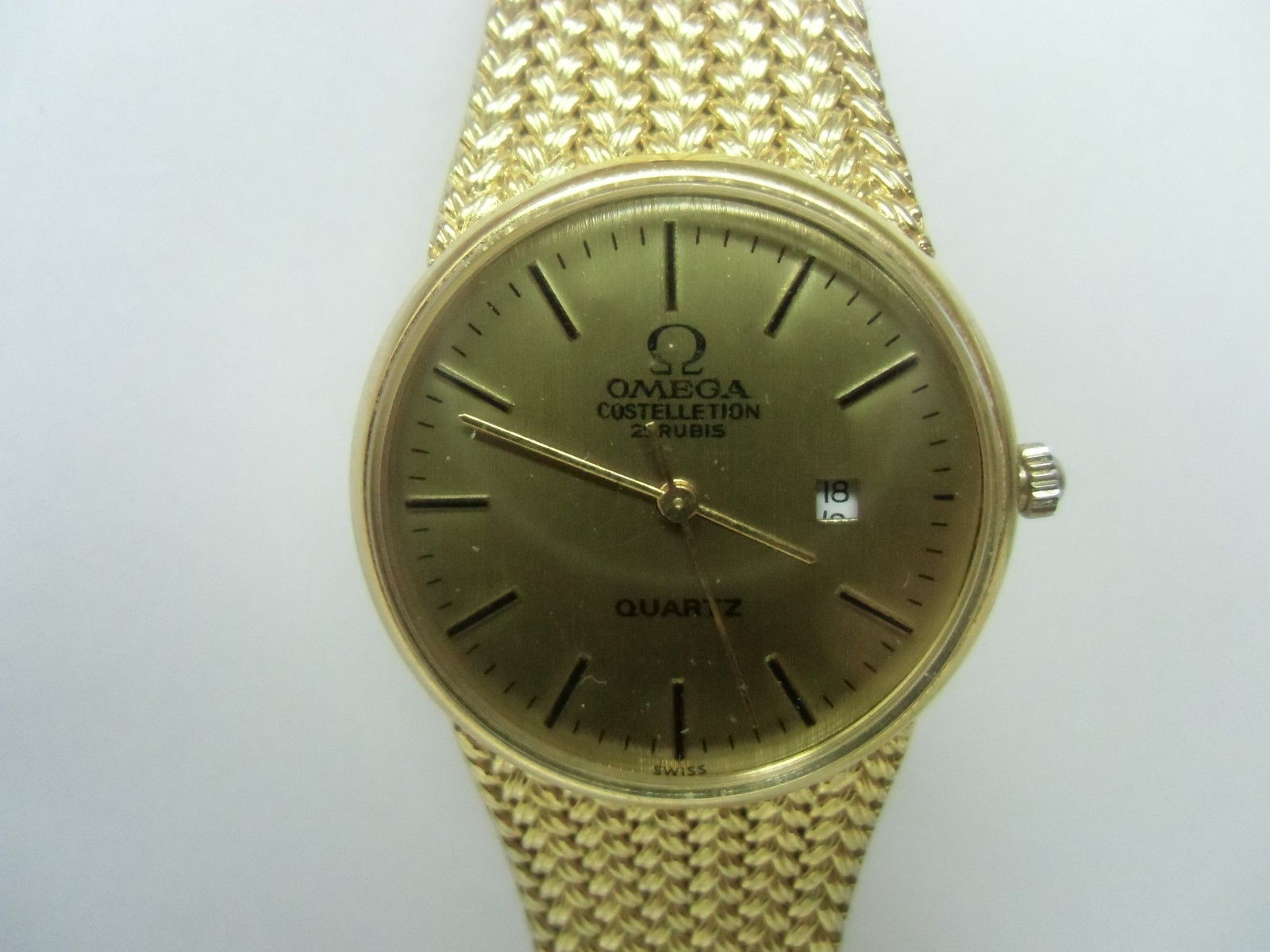

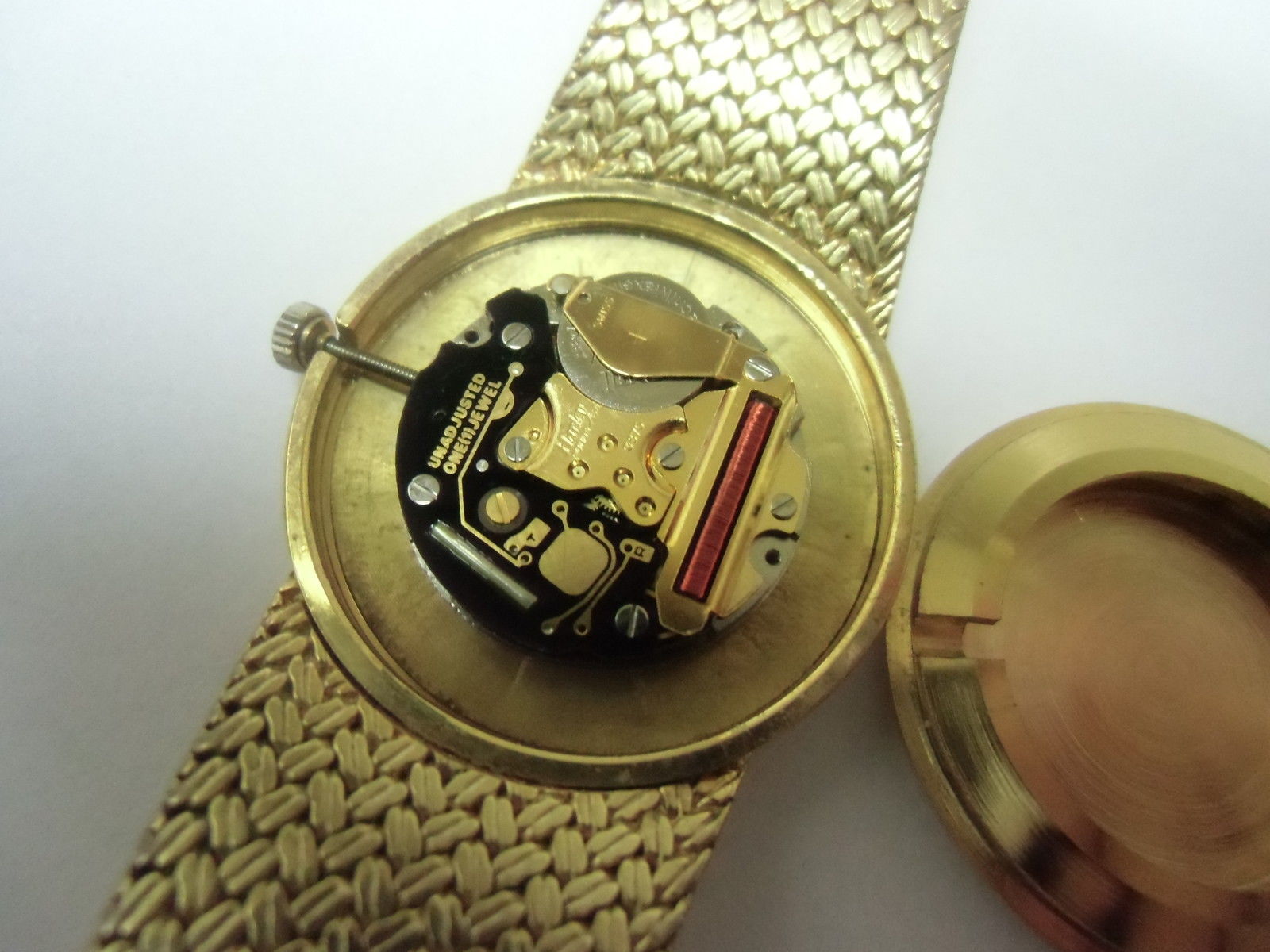

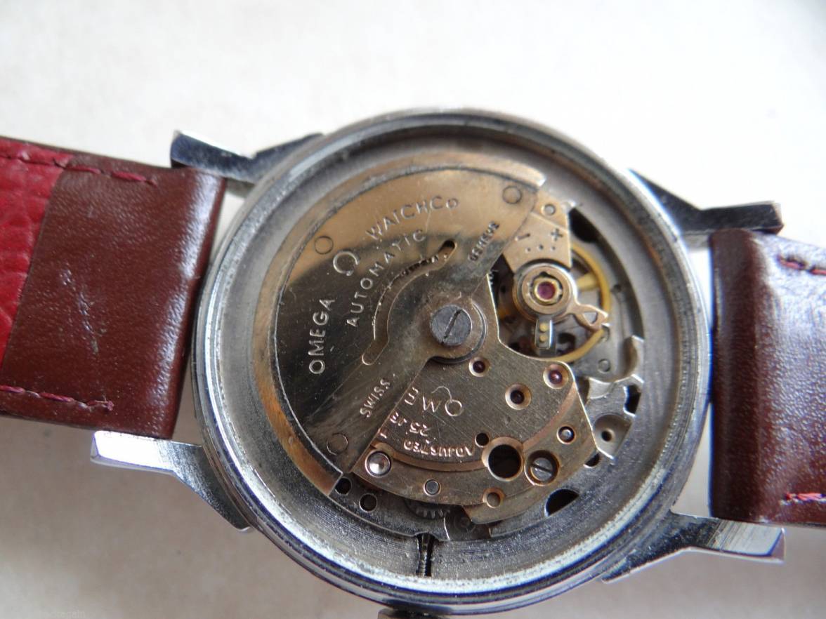

Brought you by eBay, one of the worst pieces of junk I've seen recently.
“Very good condition some wear to the back and crown please note not original movement” No shit!

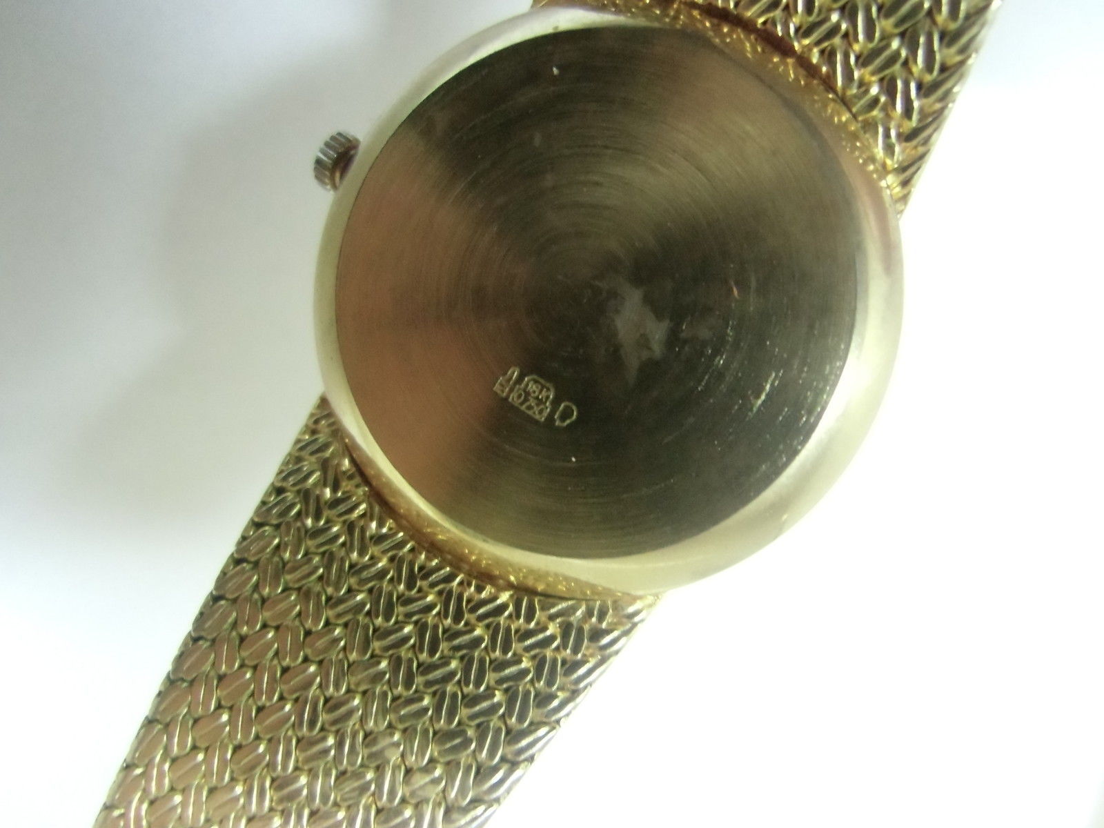

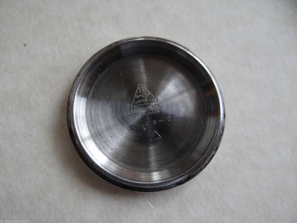

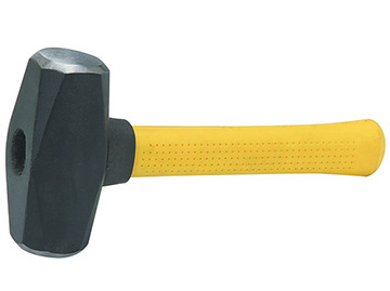

OK, one more just for the description alone.
"Great Mint Condition. Works perfectly fine. Minimal scratches on a face. Few mark on a back due to improper opening. Could be cleaned up even more."
15,046
24,049
75090
Yep, anyone knows you open these with these,

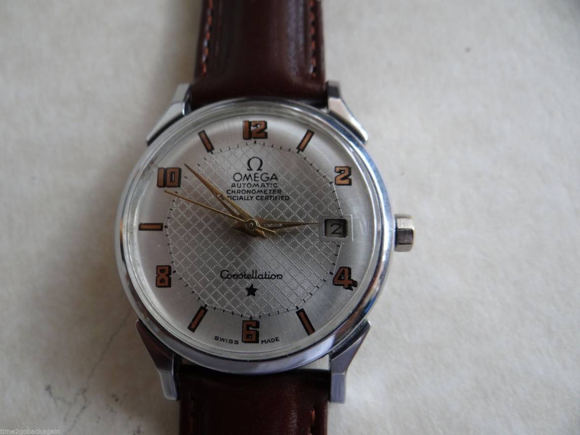

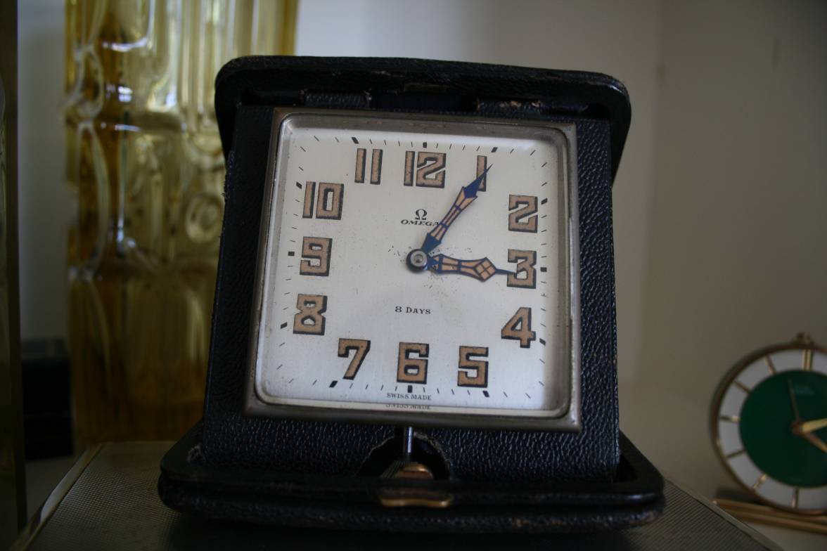

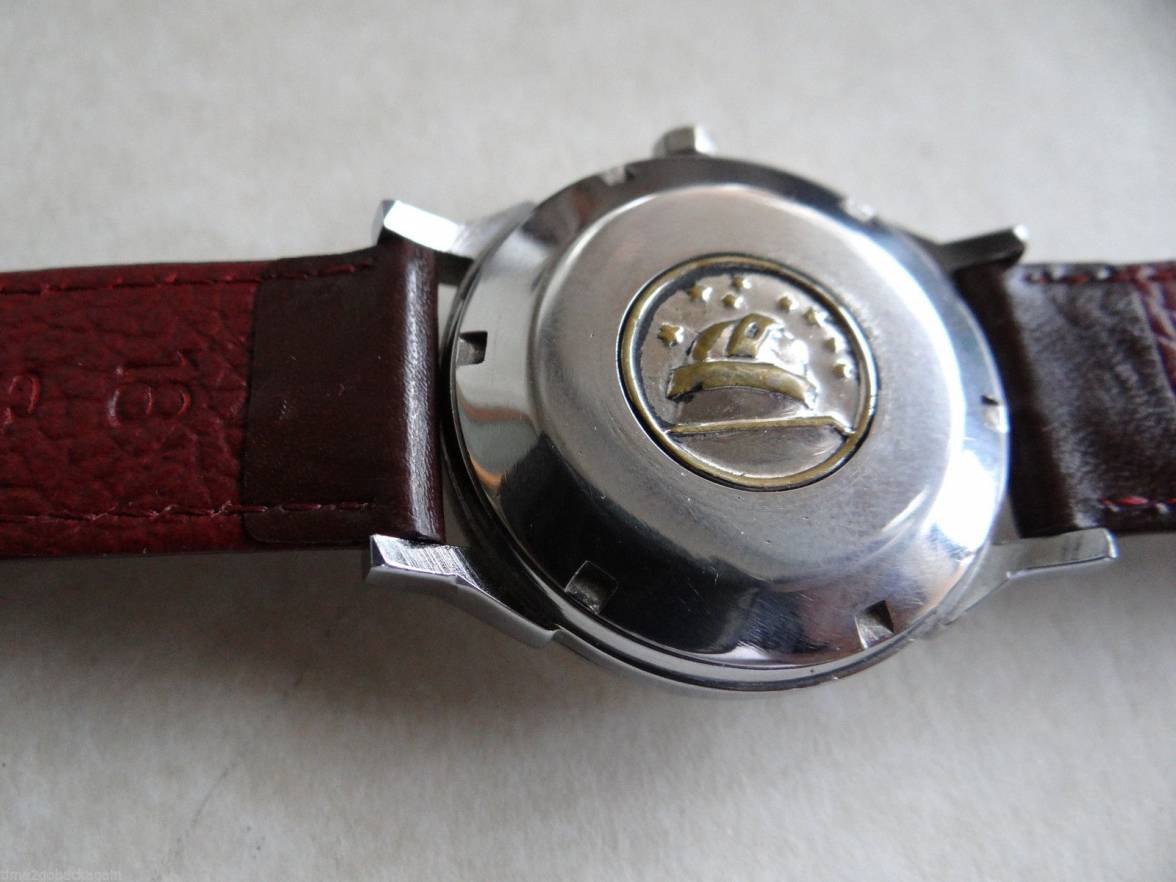

Looks like the clever re-dialer took his inspiration from this 1920s travel clock....

I'm surprised it wasn't advertised as "Genuine Omega Constellation from the 1920s" 😁
