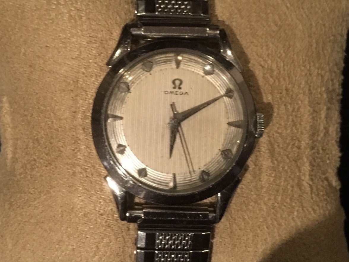

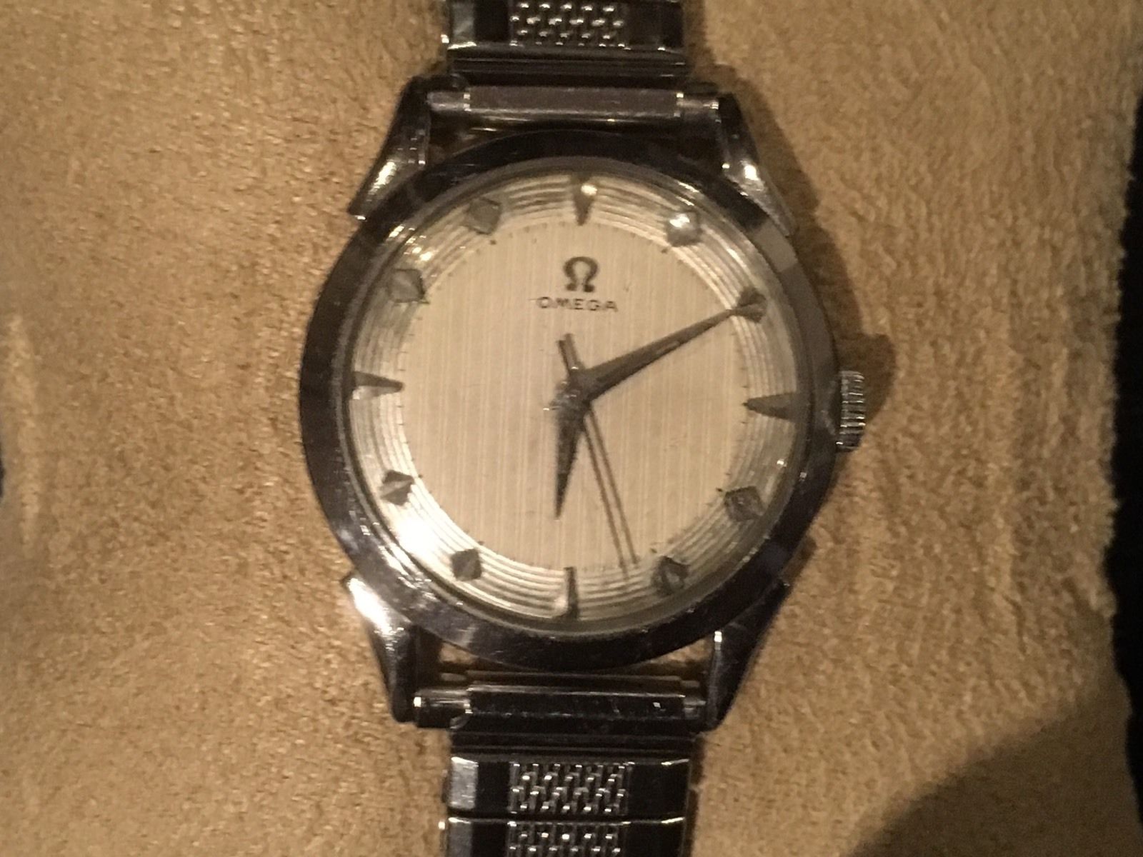

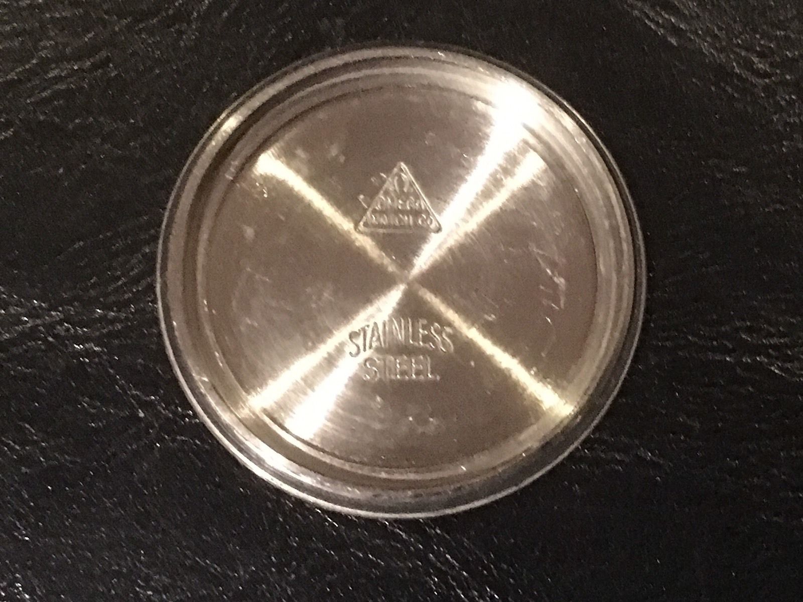

Movement and case are genuine, dial probably is too.
Just because you've never seen one doesn't mean its fake.

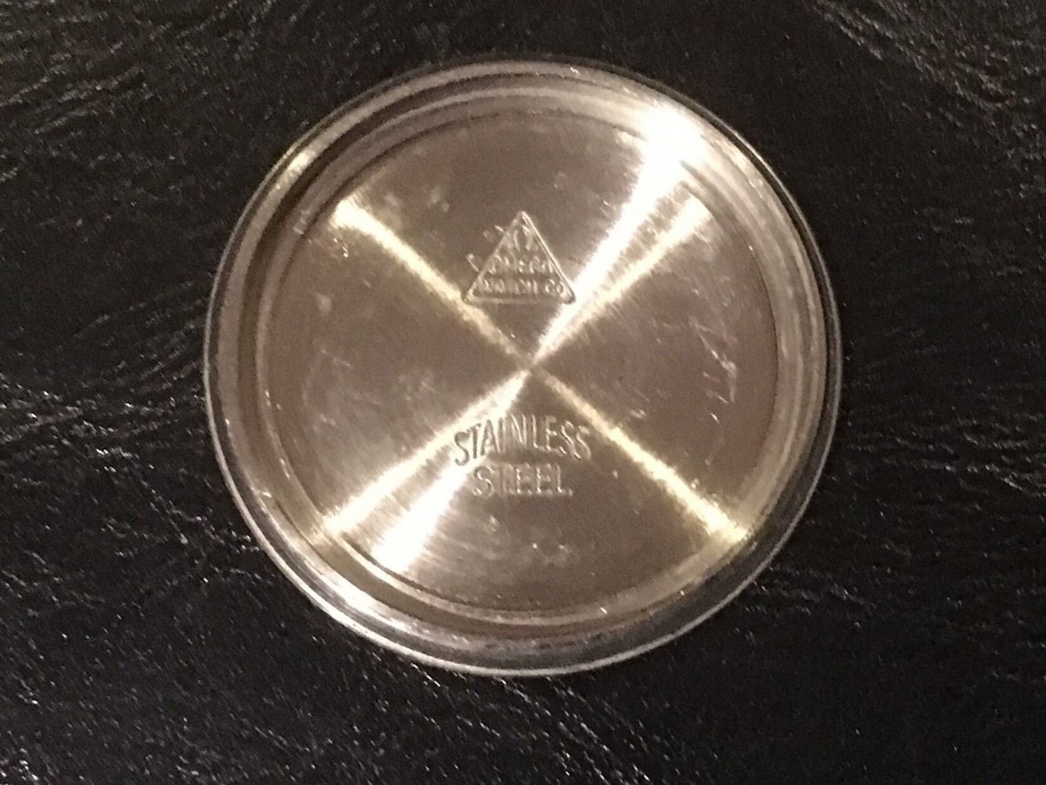

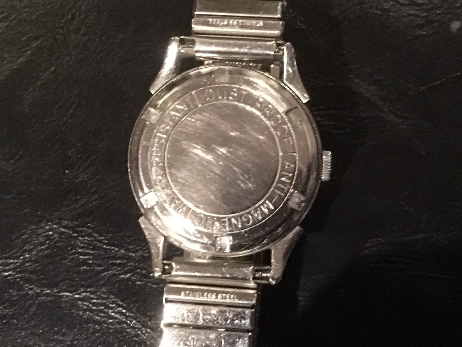

What about the caseback?
13,492
31,811
Again, just because you've never seen one doesn't mean its fake.
Not your typical markings but genuine just the same.

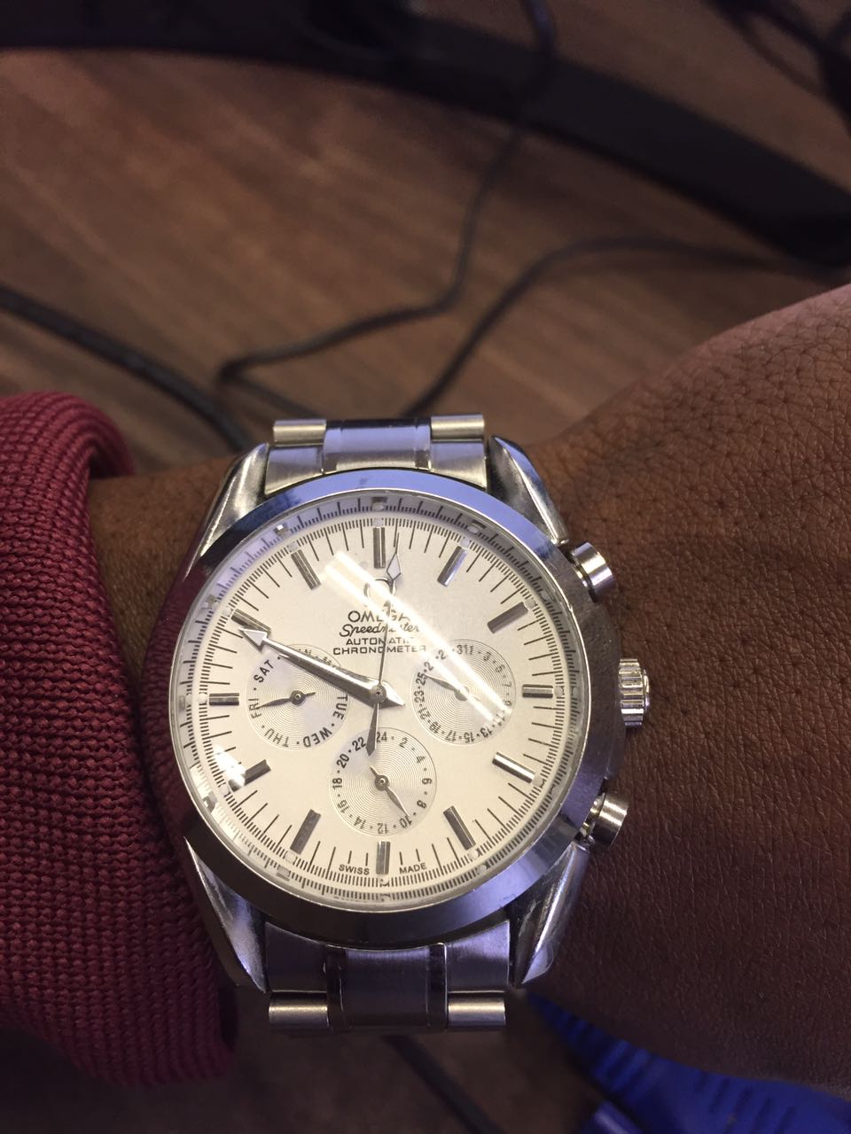

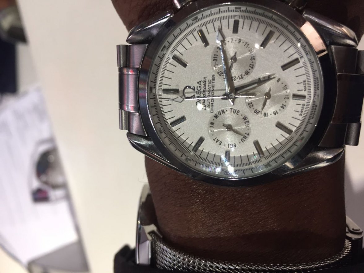

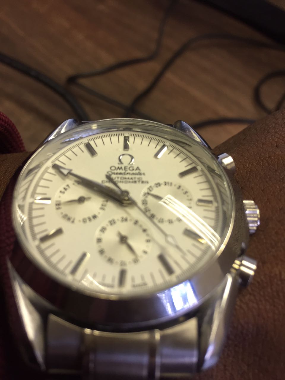

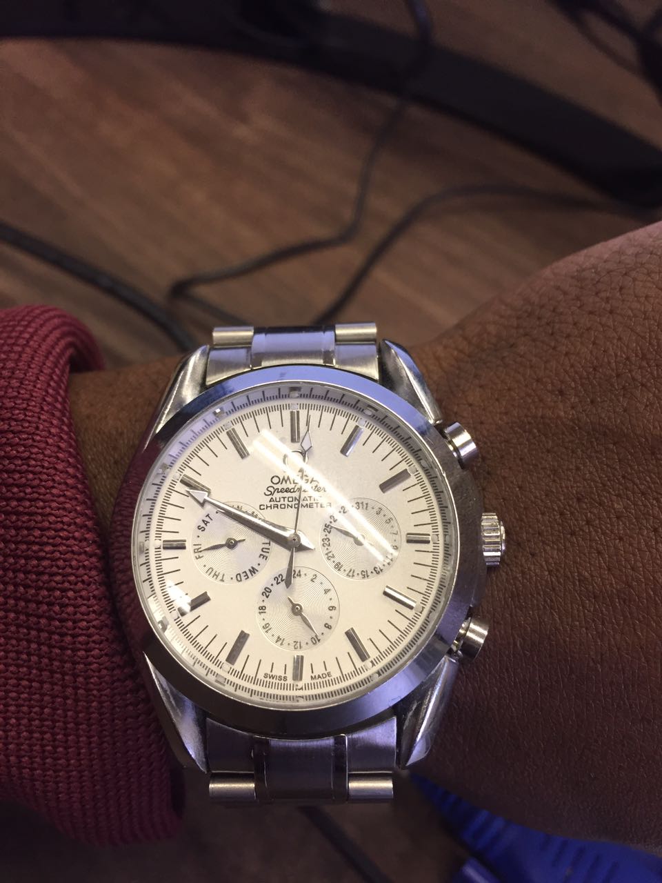

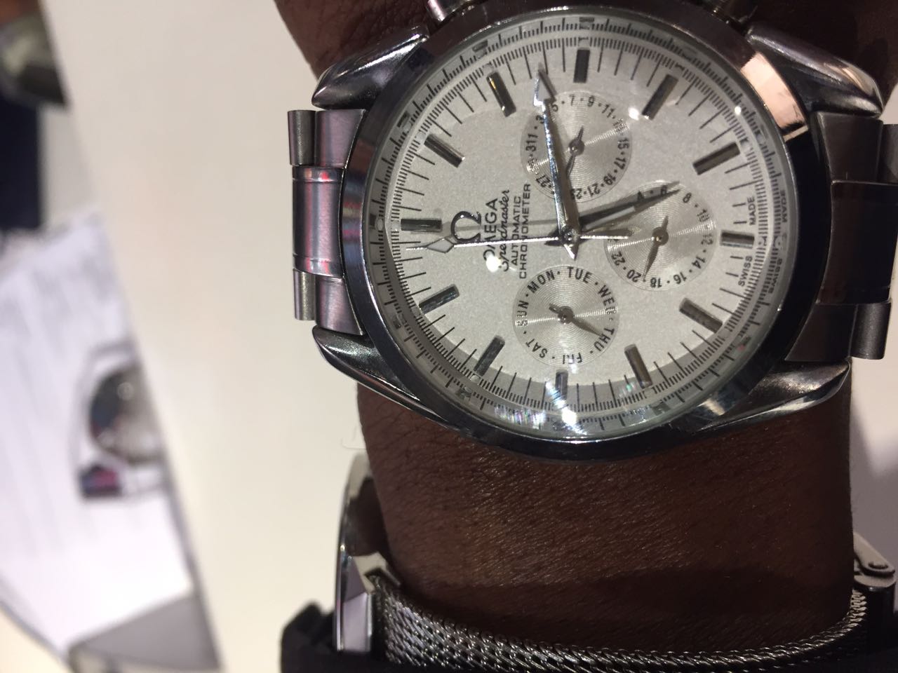

Hi guys, i recently bought this OMEGA at a pawn shop.. please verify if its fake
READ THE TITLE OF THIS THREAD!!!

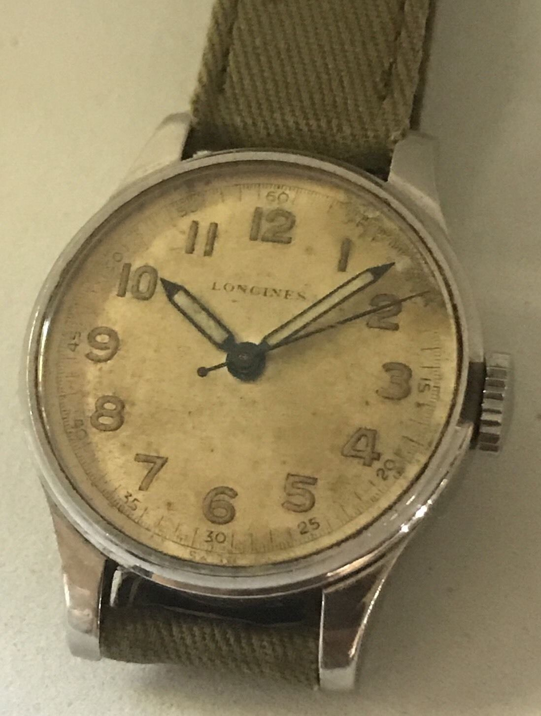

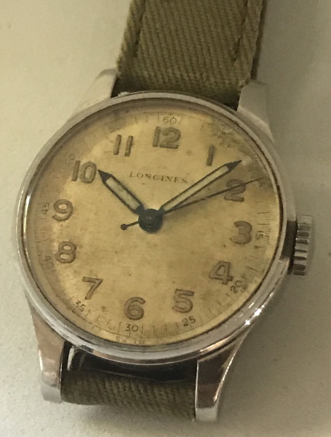

OK ok.. its not a fake but i love the liberal application of the phrase NOS literally "New Old Stock" < (mint never worn 40s factory / shop floor condition)
Vntg Longines Military Style SS All Orig Cond NOS Vintage Military Canvas Band
Condition:
Used
Dont get me wrong its not a bad watch! but its not a NOS watch... Thinking people just see the term and add it in without knowing what it means?
"well if his watch is a NOS my watch damn sure better be a NOS to!"
"hey i found this watch with my metal detector i hope its a NOS!"
"Are you wearing a NOS?"
"i inherited what i think is a rare NOS! i remember my grandad wore it EVERY day for over 60 years.. "
NOS NOS NOS!
Yes, very fake.

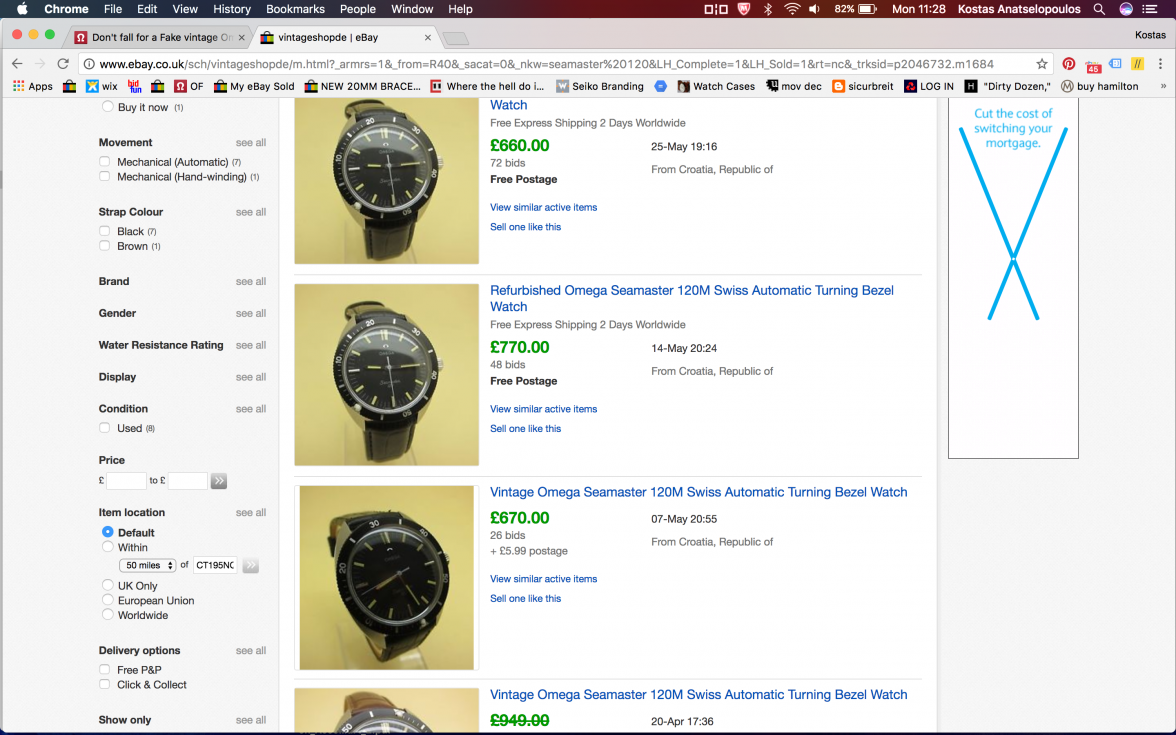

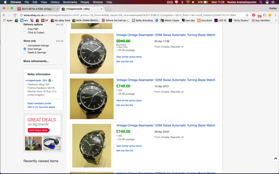

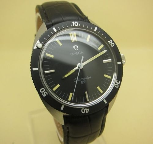

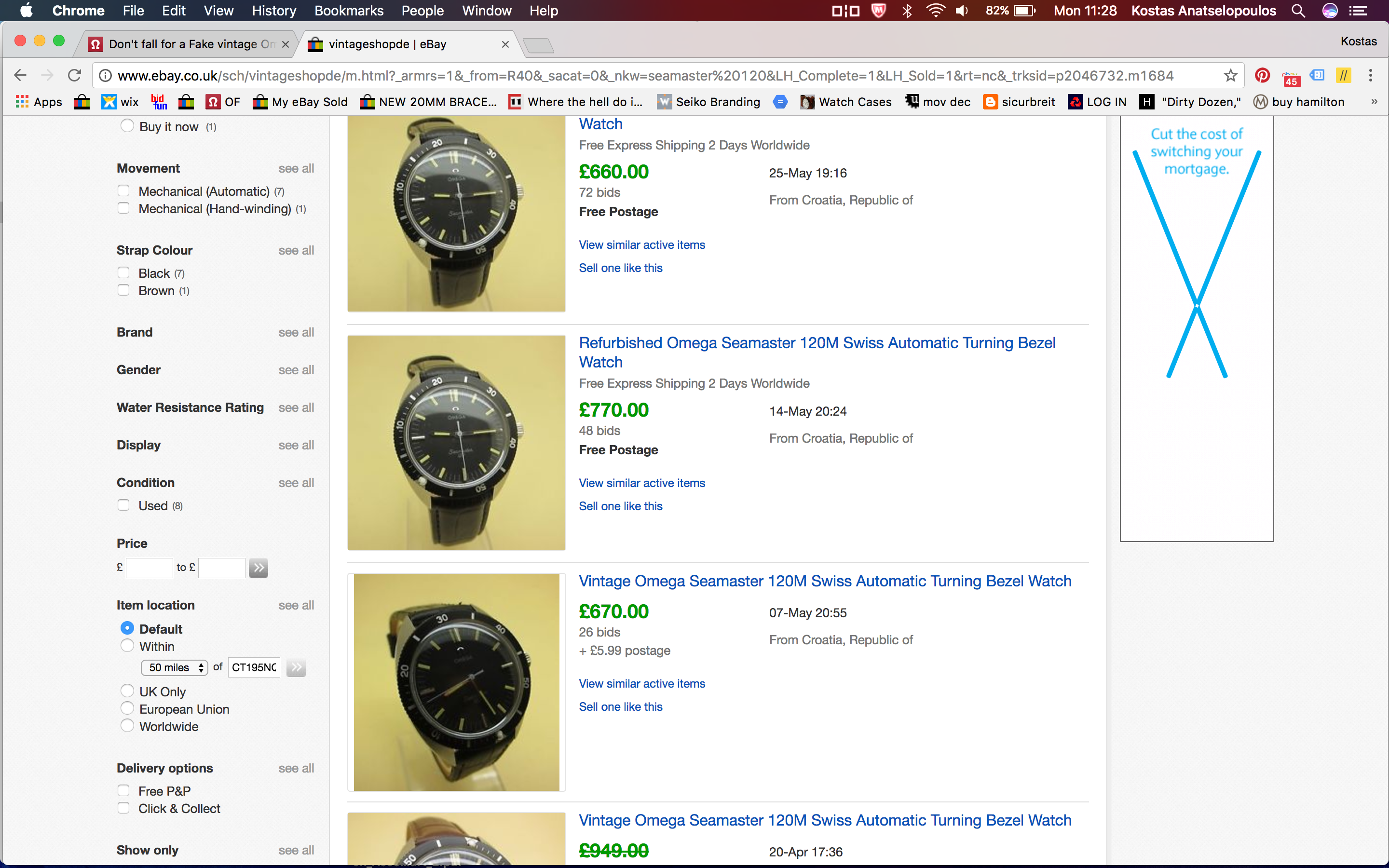

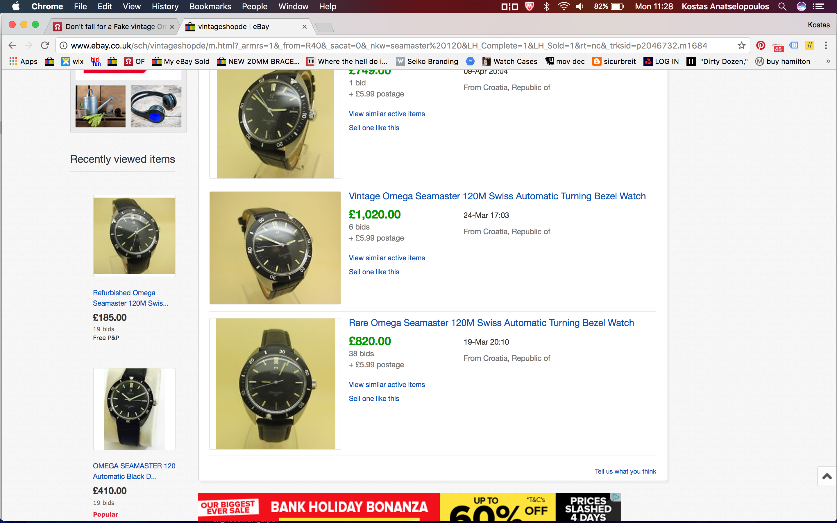

http://www.ebay.co.uk/itm/OMEGA-SEA...239601?hash=item3d3c557931:g:y6wAAOSwtGlZKHa9
http://www.ebay.co.uk/itm/OMEGA-SEAMASTER-120-Automatic-Black-Dial-Watch-/262987079471?hash=item3d3b405f2f:g:Ji0AAOSwaEhZGe-5&nma=true&si=MYvdSd4xcj94EOHu9pQ3daL2ZjE%3D&orig_cvip=true&rt=nc&_trksid=p2047675.l2557
http://www.ebay.co.uk/itm/Refurbish...713306?hash=item1c86af33da:g:pggAAOSwYlRZKaTw

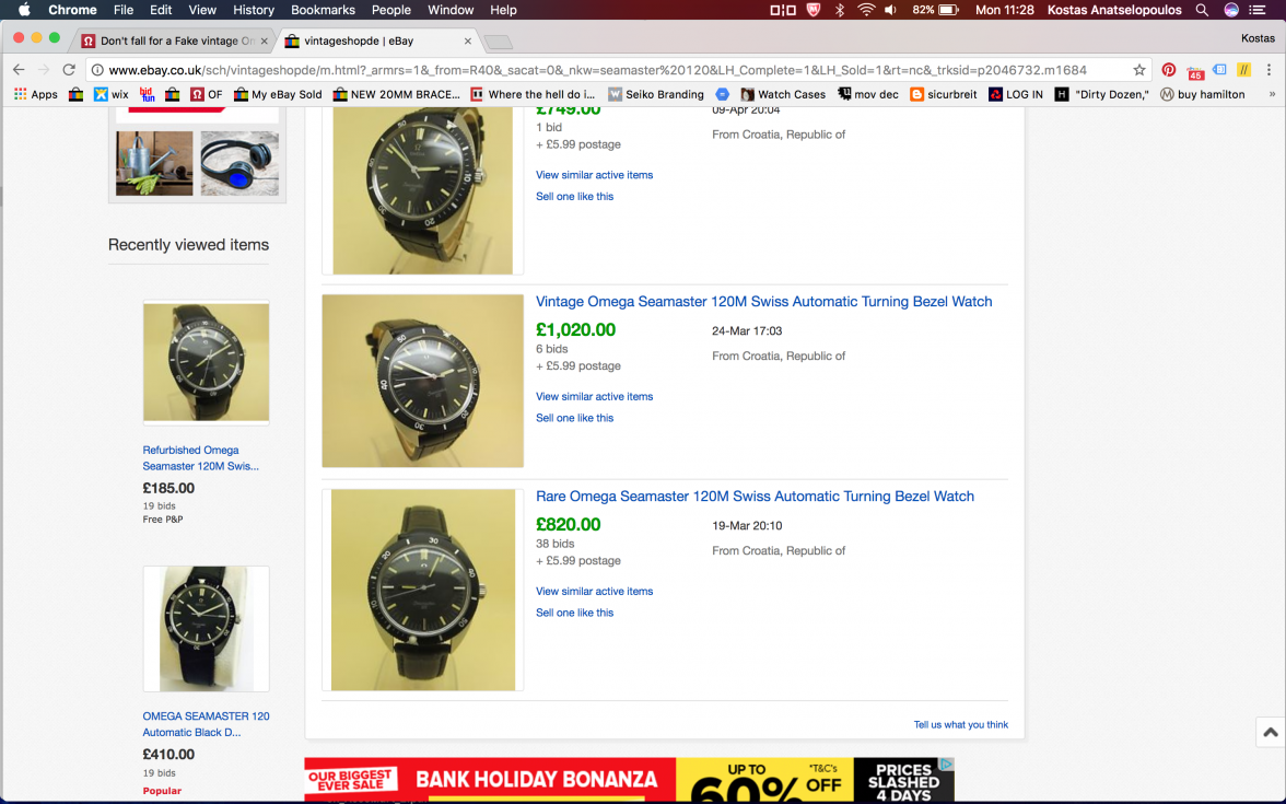

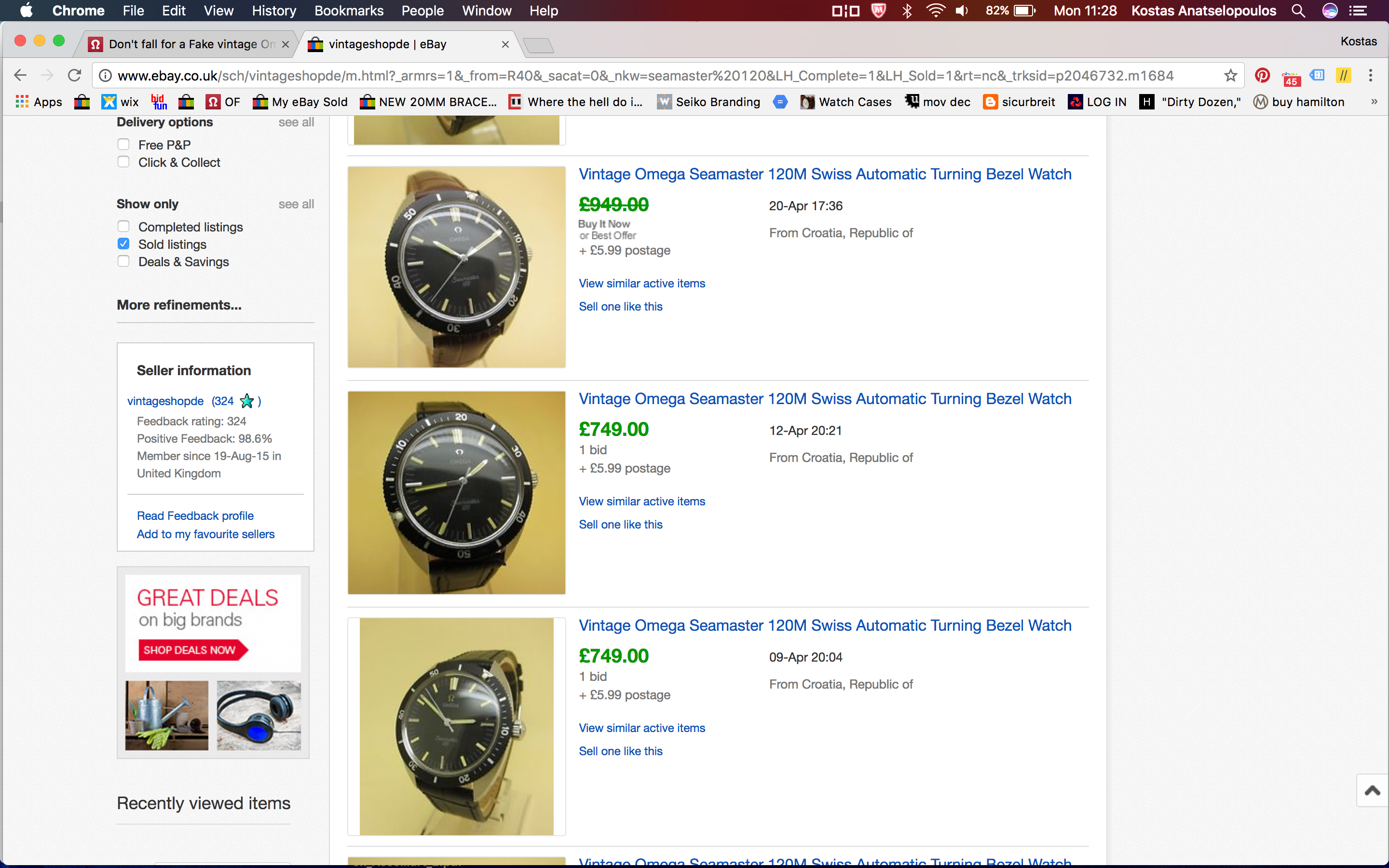

vintageshopde

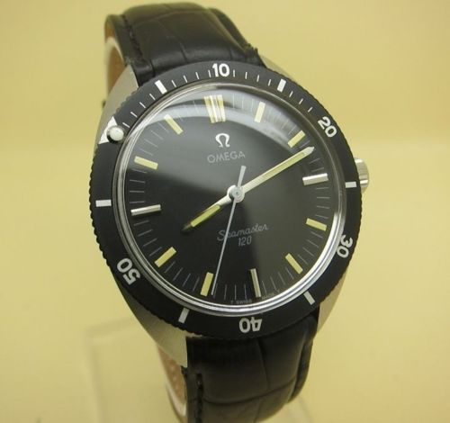

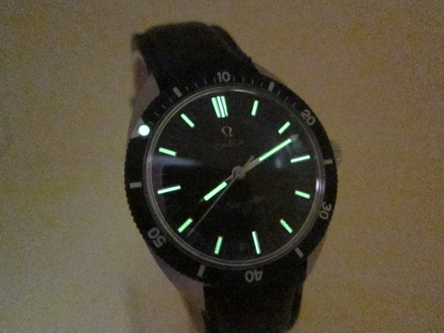

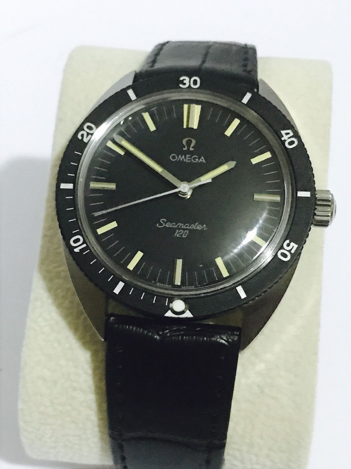

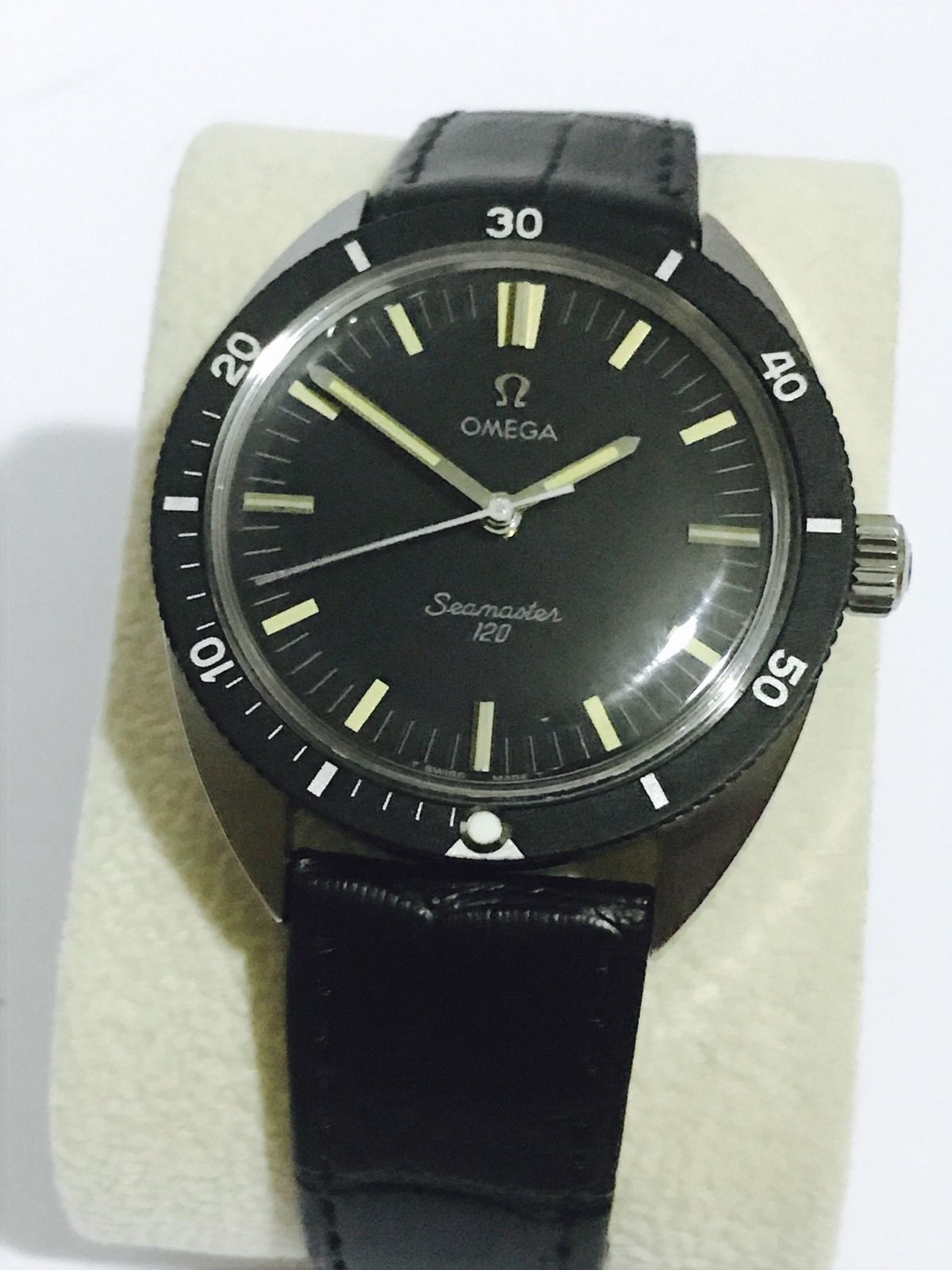

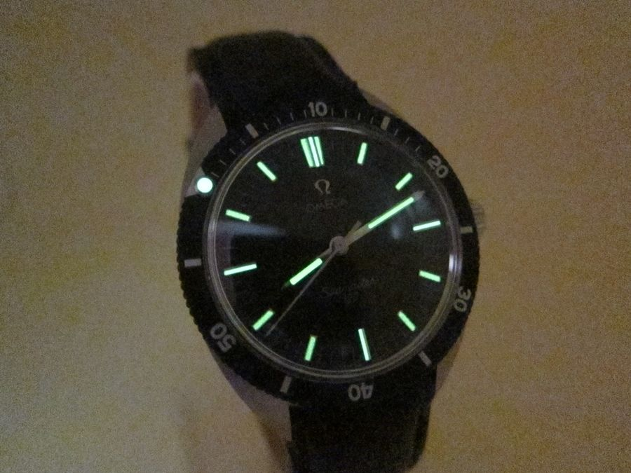

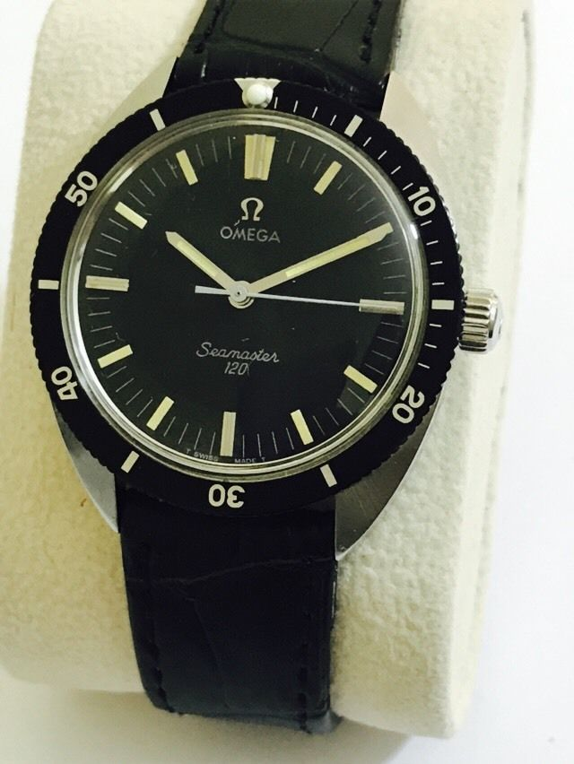

heed caution when buying a seamaster 120 165.027 these seem to be pretty flaky franken / fakes
fake yet well printed dials T-T's but all luminova Fake Cases Fake Dials TOTALLY Fake bezels
and the VOLUMES they are selling in is obscene the seller above has sold like 12 since march
8 Next pictures are one of mine (SOLD) the rest are all "Dodge"
There are maybe 5 genuine articles on ebay (but not all great examples) the rest are ALL Weird

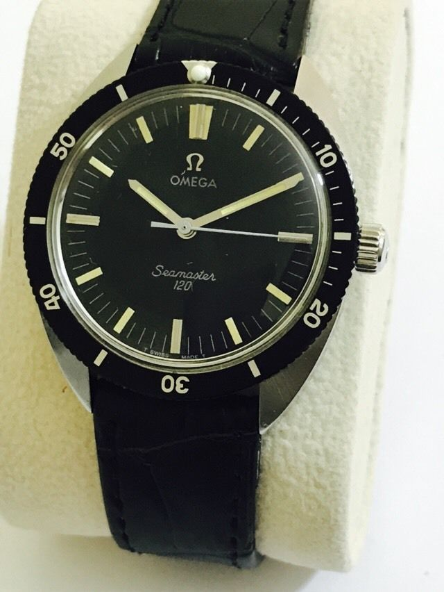

Other than this what is this weird franken! thats an 861 alright yea! (no ones got that good at faking these have they?! but in a fabricated case and bezel.. probably the strap too.. tho this could be ok added later strap looks 19mm case looks 20mm no fit good..
is that a 29 serial ?
1970 29,000,000 etc
but the step dial hands and movement look good no? i mean i know its not "what it says on the tin" by a longshot! but im gonna offer £400 hehe

http://www.ebay.co.uk/itm/like/222527344450
...original papers made 50 years later ::facepalm1::
yea this watch is NOT all that fake but its not "right" either bezel is 100% fake movement is good dial hands good case iust suspect but it could be the photographs its really hard to tell..
Ive messaged the seller he seems reasonable. I dont think anyone wants to hear their watch is fake especially if they really dont know.. I think he too has been somewhat duped into buying it possibly he has plenty of OK watches but is an inexperienced seller (by feedback)
Im going to try to help!
